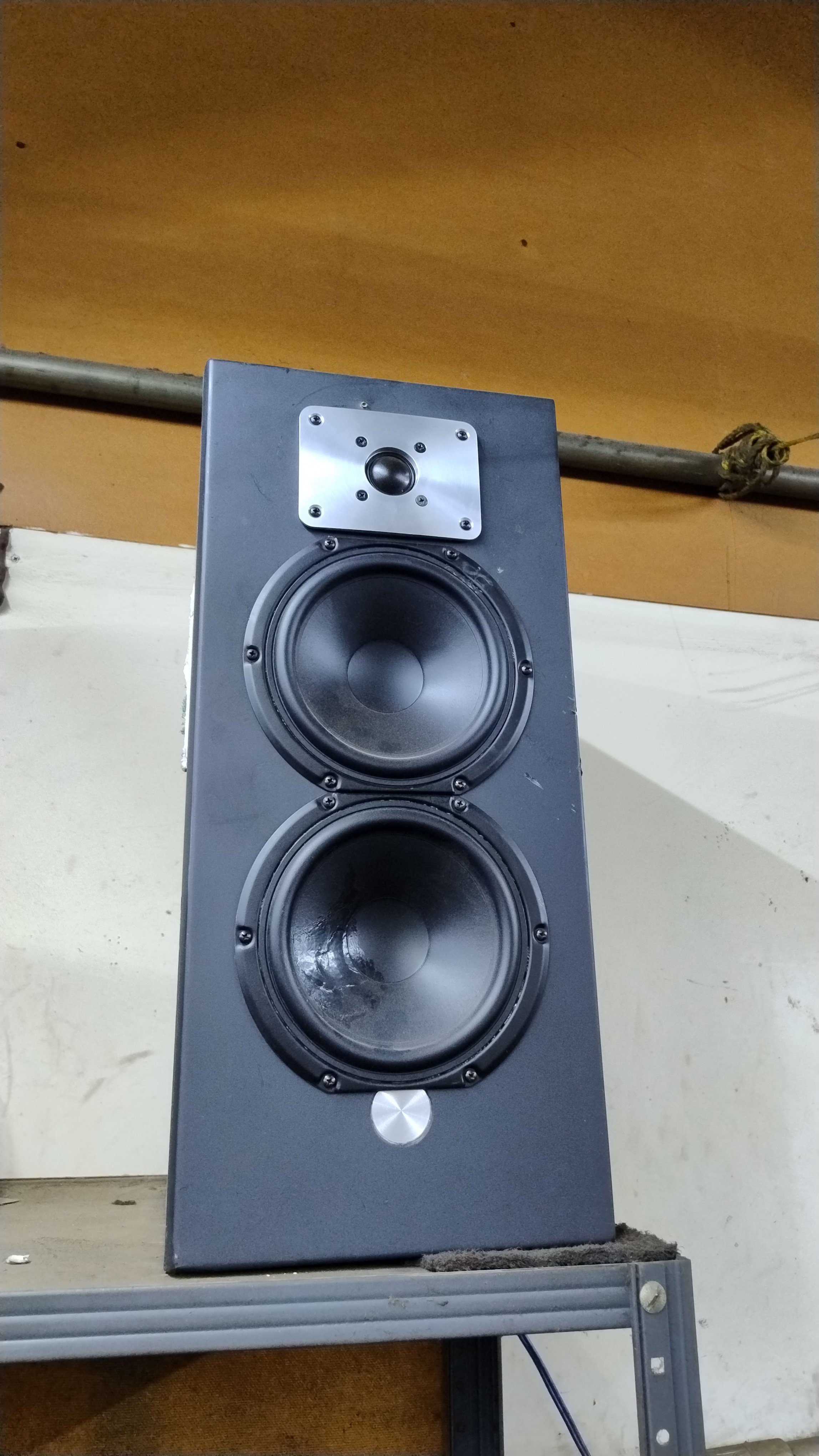

    Settled on X-over bracket design. Ordered some stronger black oxide M4 low-profile button heads. They'll bolt to female end of standoffs thru the thicker acrylic plates and be electrically isolated. Don't trust the 35 y/o pcb coating.
    Installing a single stainless barrel nut with copper antiseize and a large solid brass thumb screw for the outside bling...

    Started the drivers...
    xschop Posts: 5,920
    edited May 22
    Stay focused...
    Had some time and knocked out the brass
    grill pegs...
    Made a couple extra rings 0.540" tall for some MW6500s...😁

    About 0.050" clearance all around...

    xschop Posts: 5,920
    We'll see if the 0.020 sag is gone permanently in a couple days from this 6511.
    Used the weighted coil centering spud and heated the spider gradually. Its back to normal for now...
