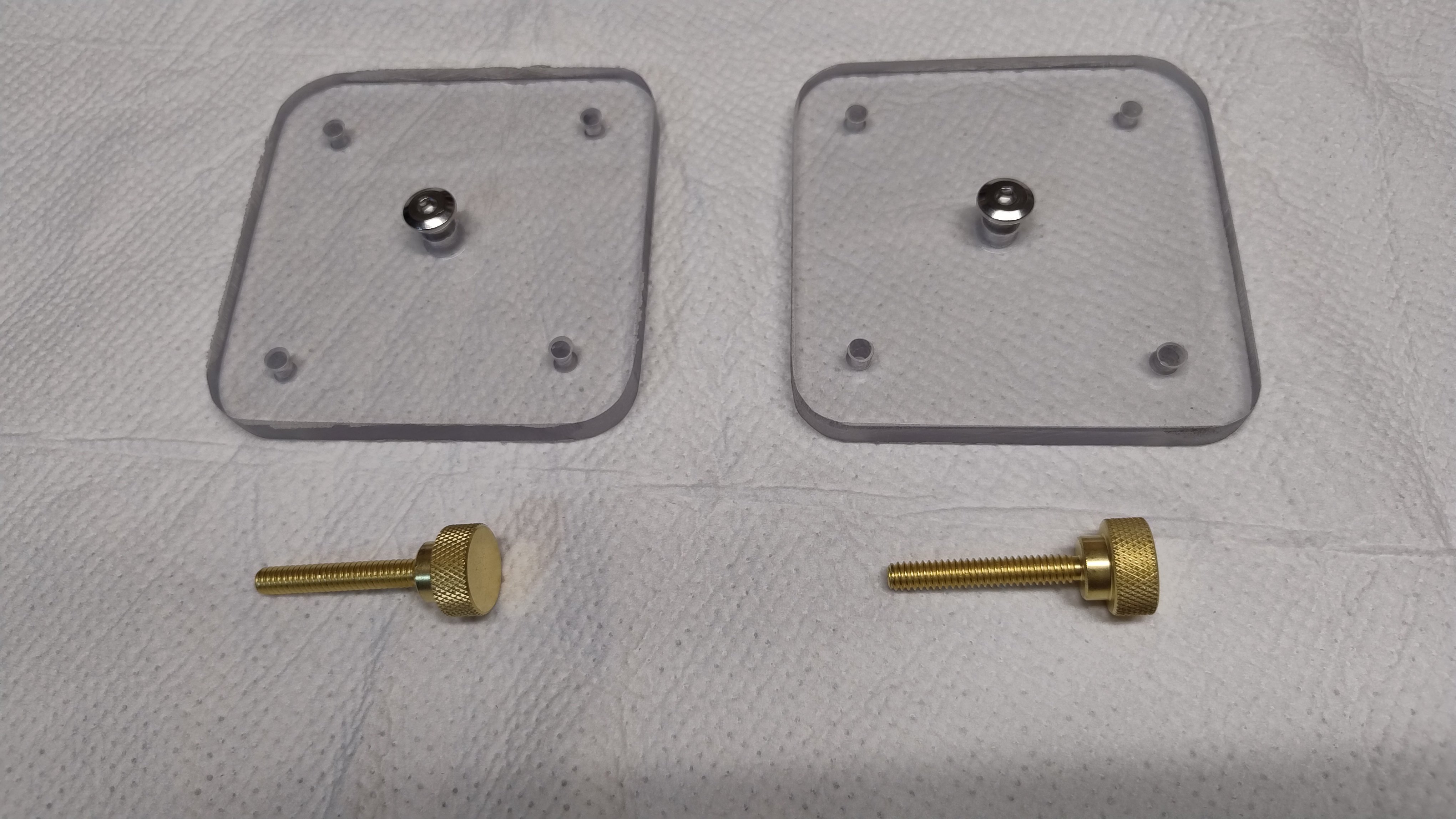

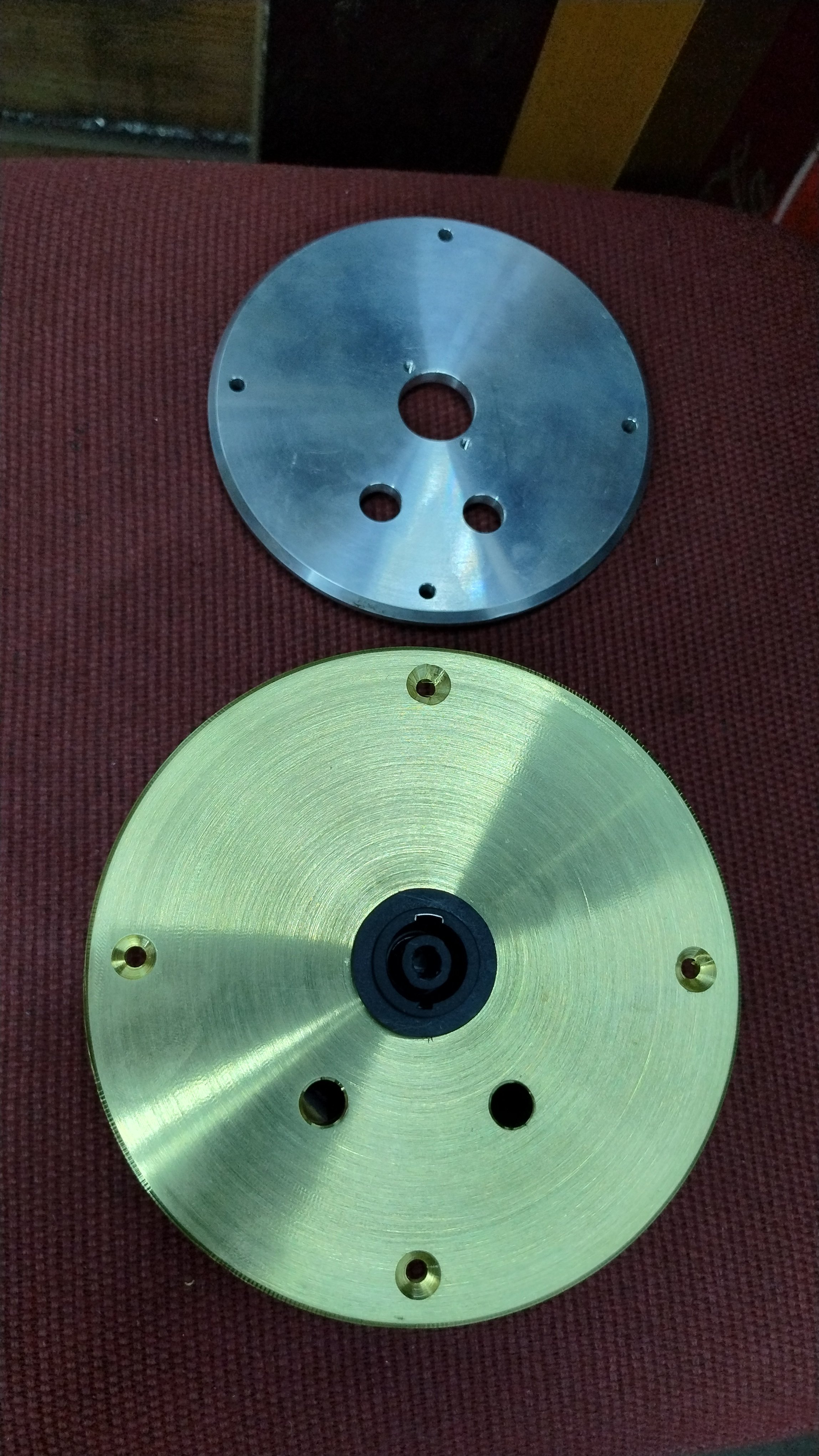

    Settled on X-over bracket design. Ordered some stronger black oxide M4 low-profile button heads. They'll bolt to female end of standoffs thru the thicker acrylic plates and be electrically isolated. Don't trust the 35 y/o pcb coating.
    Installing a single stainless barrel nut with copper antiseize and a large solid brass thumb screw for the outside bling...

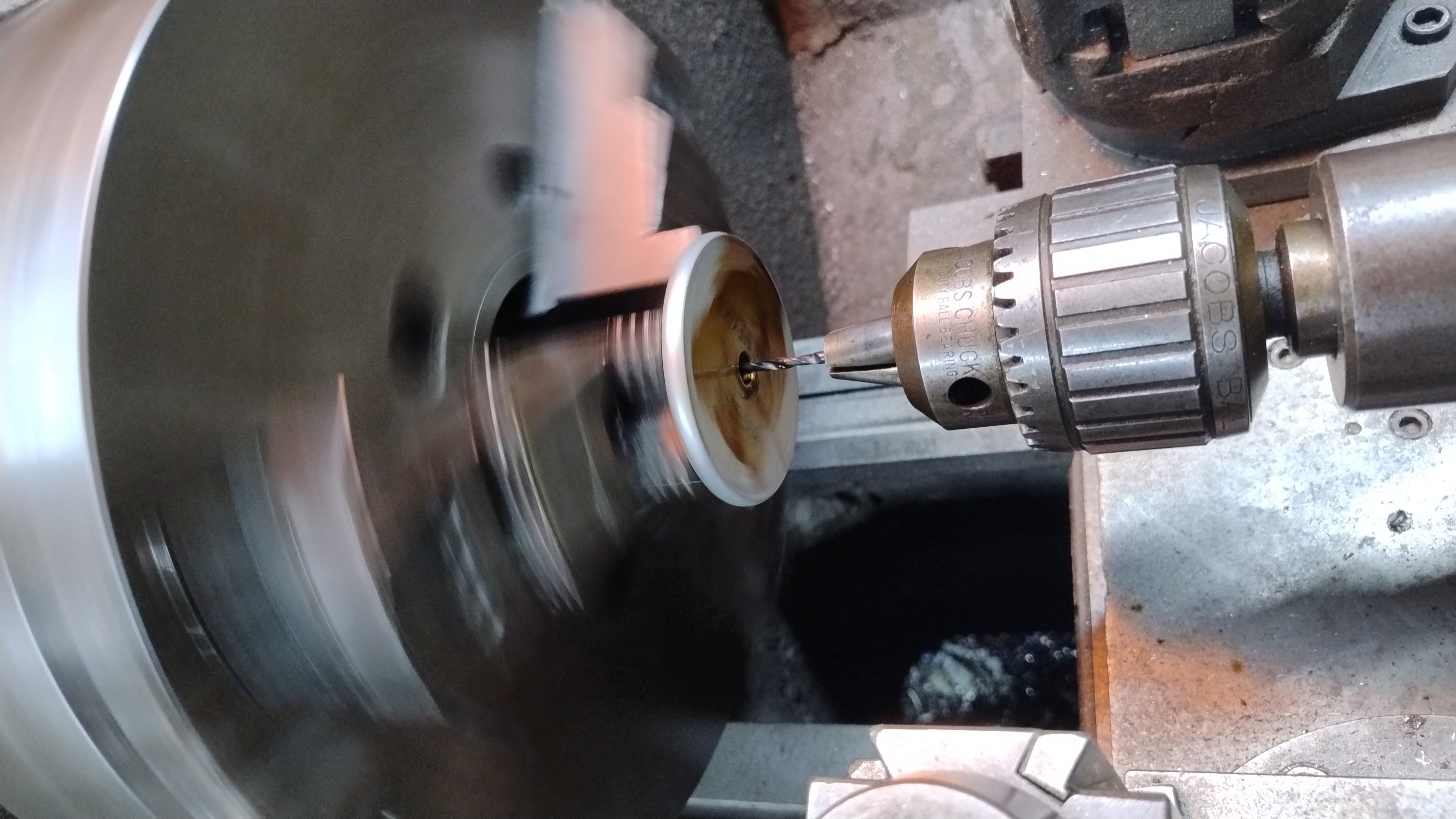

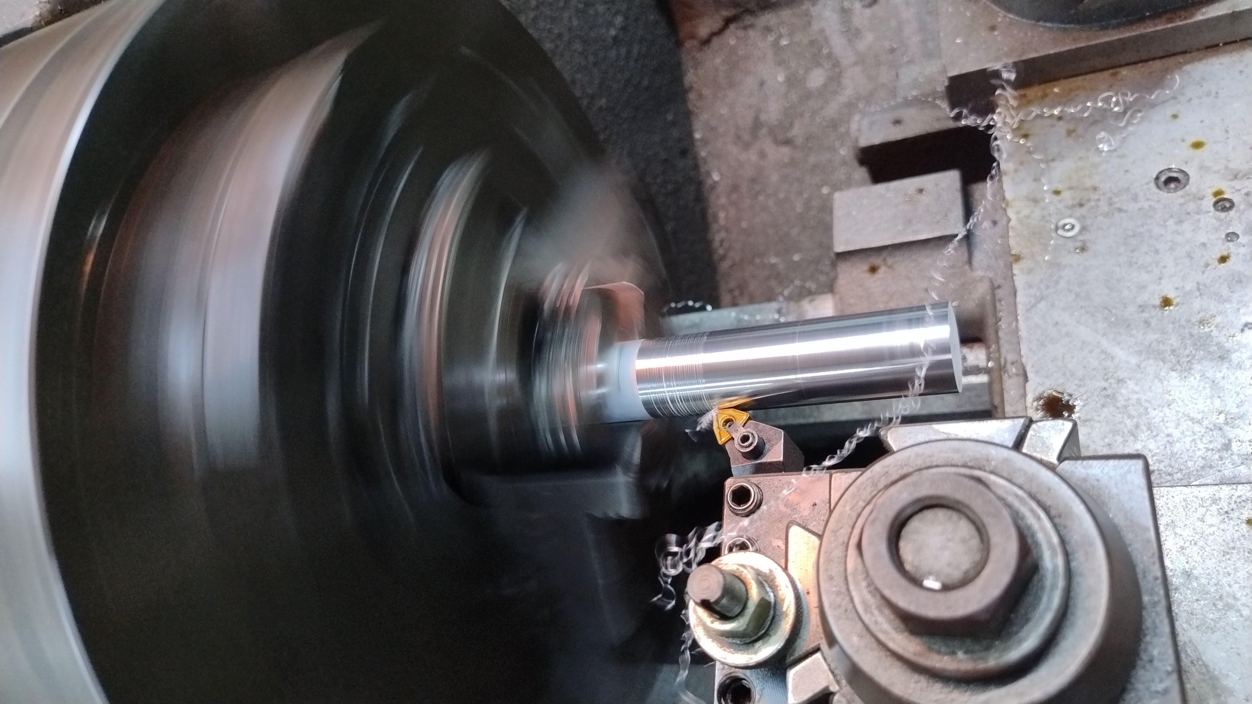

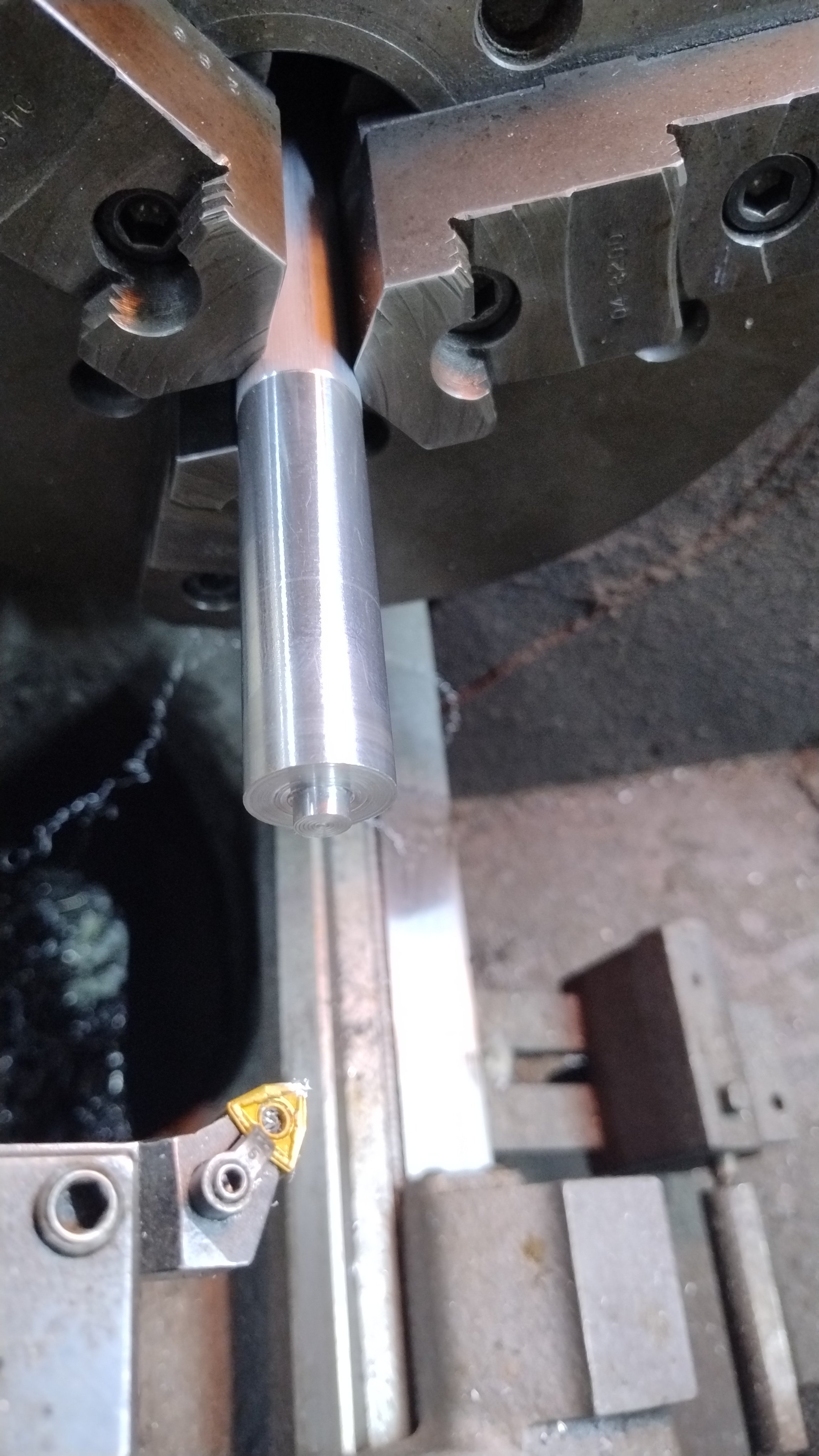

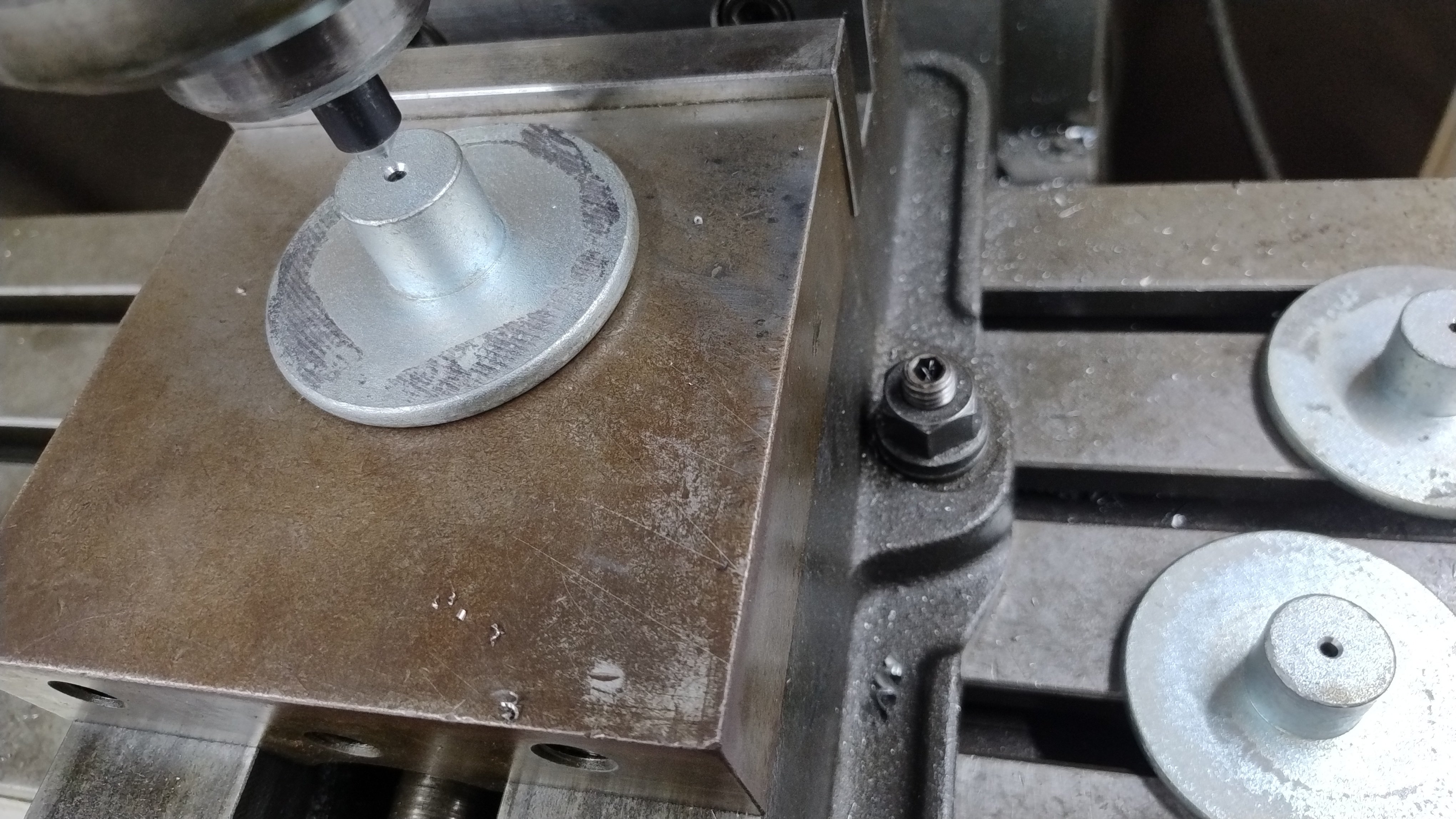

    Started the drivers...
    xschop Posts: 5,796
    edited May 22
    Stay focused...

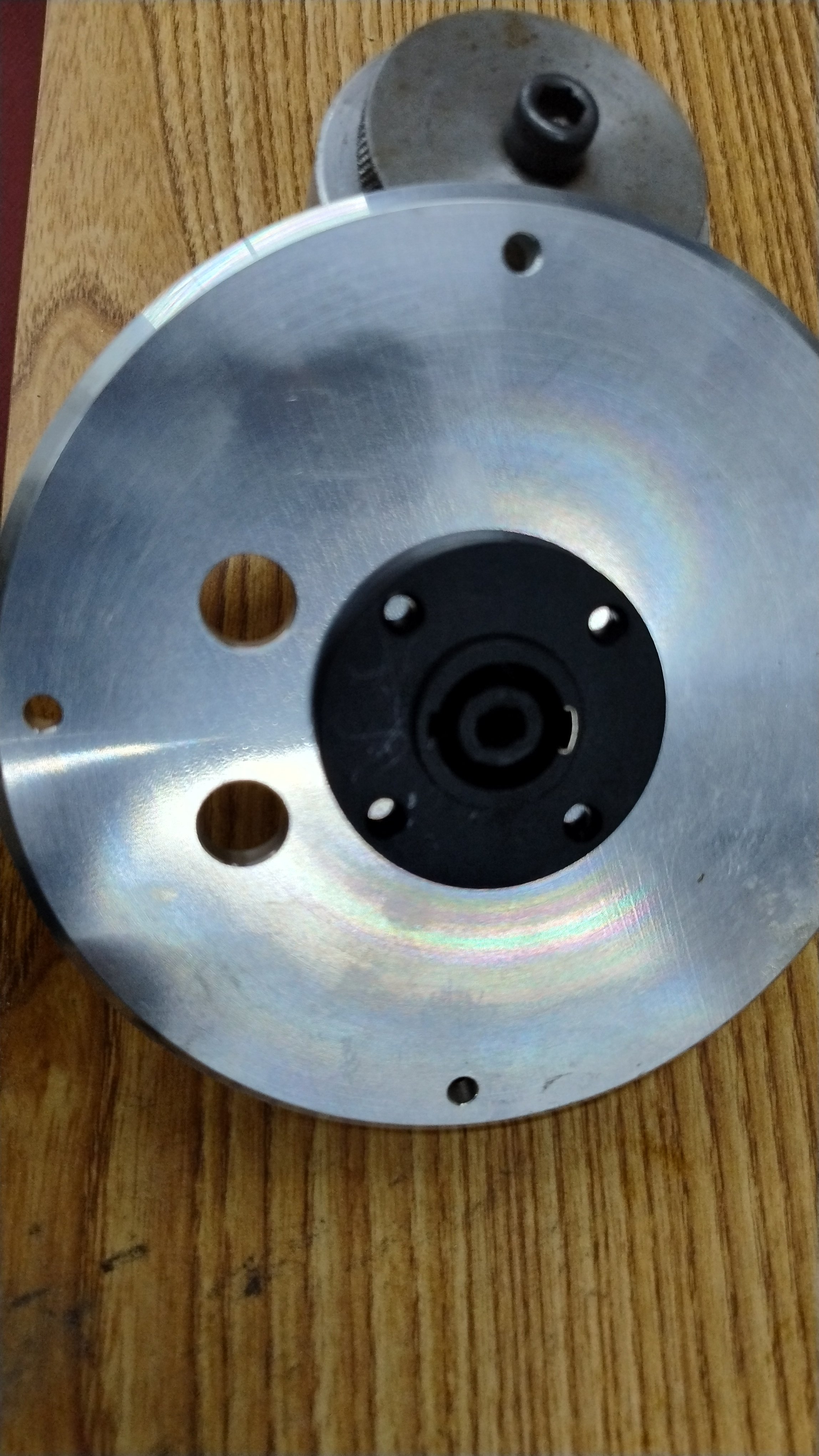

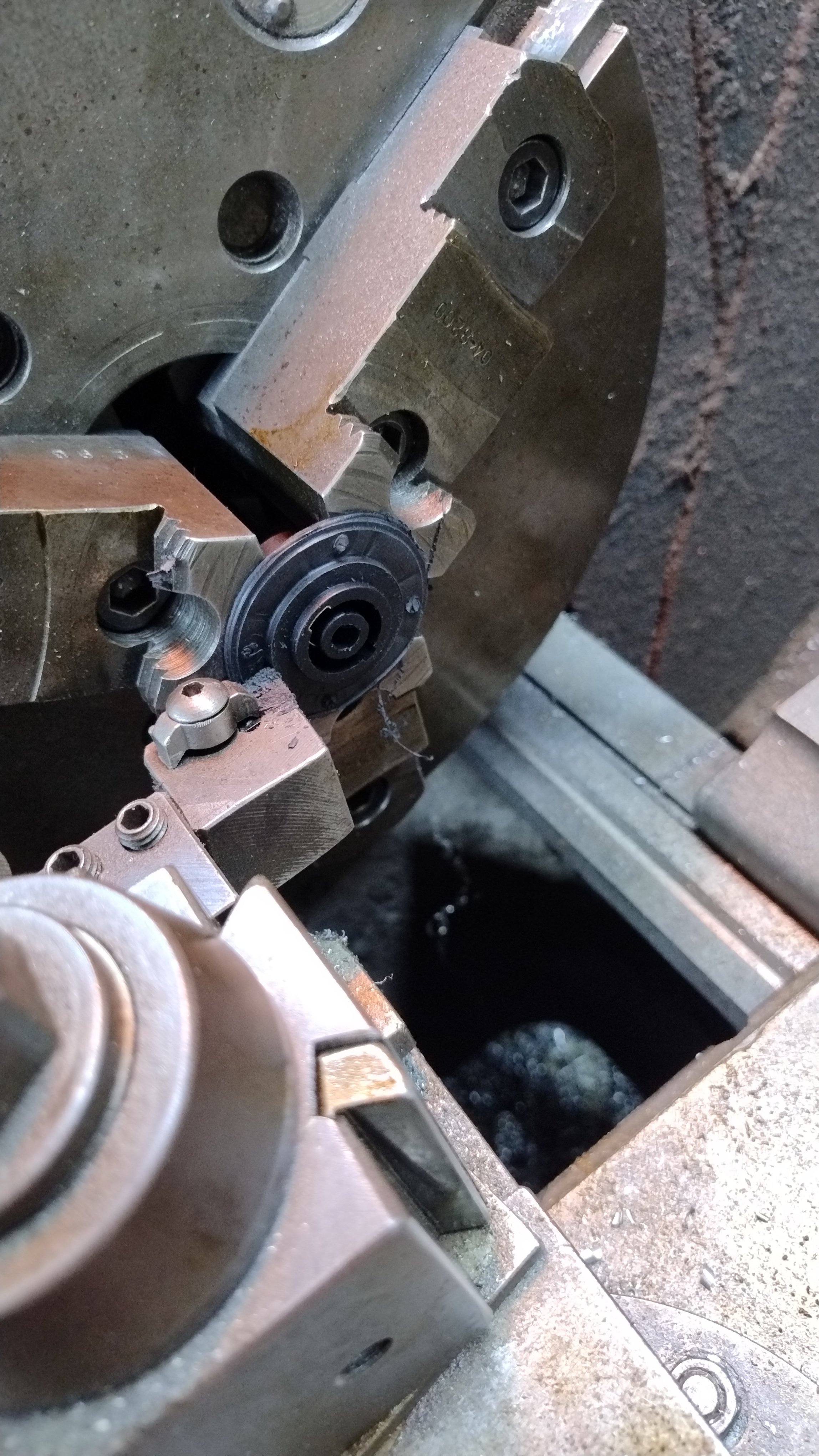

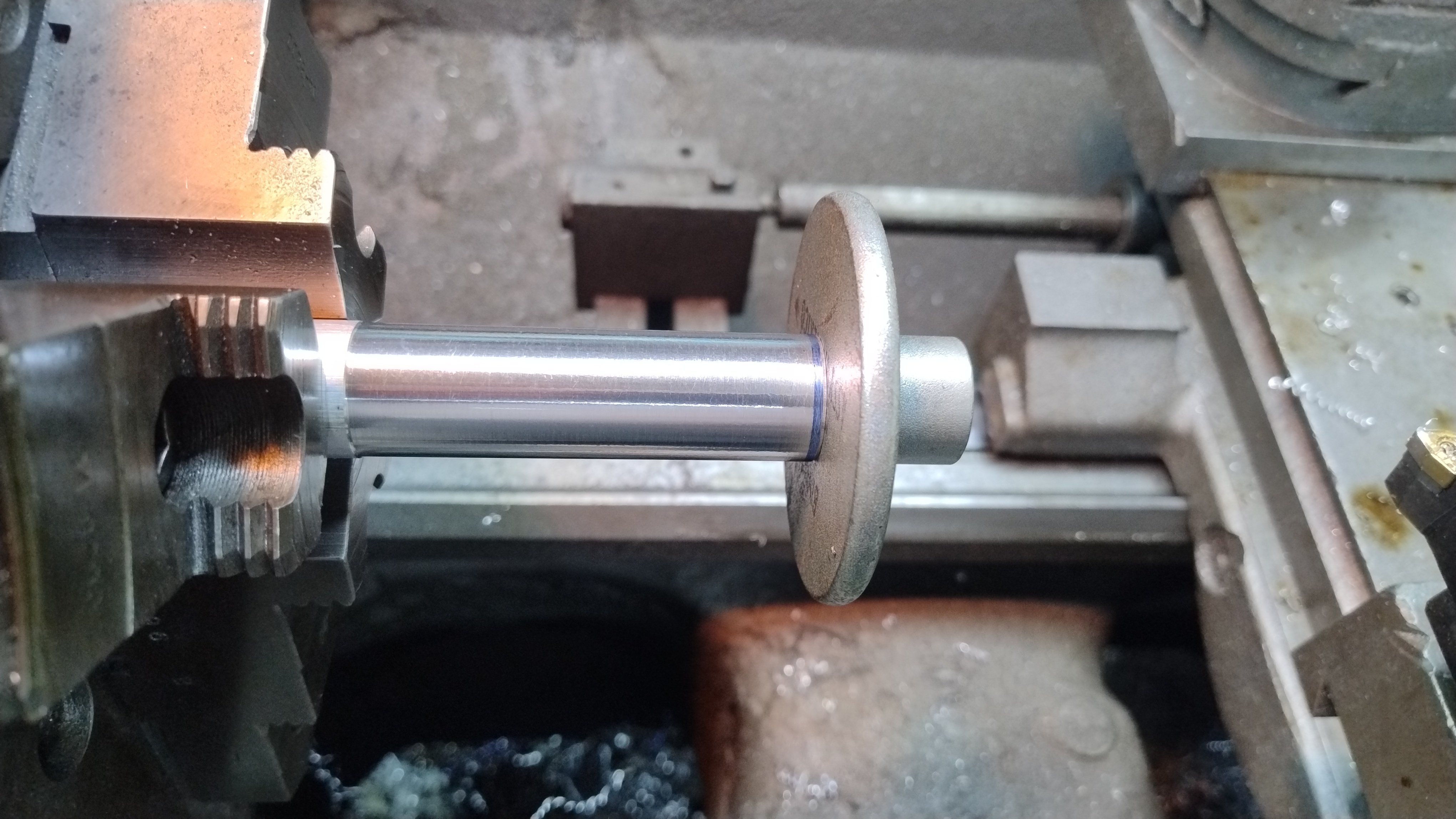

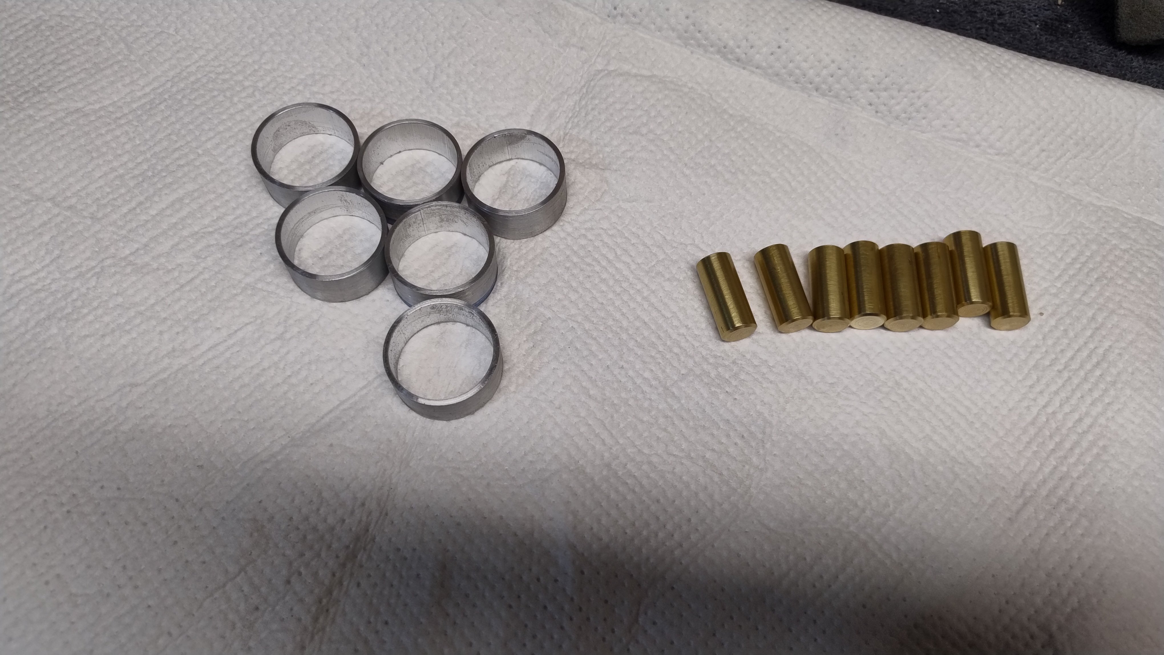

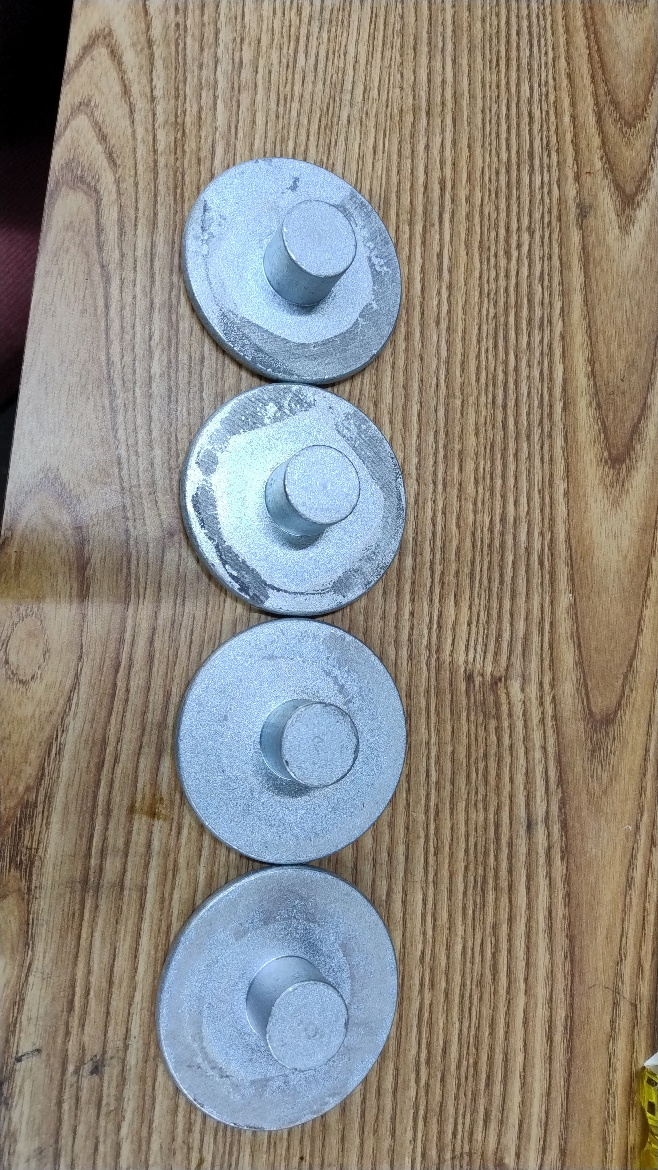

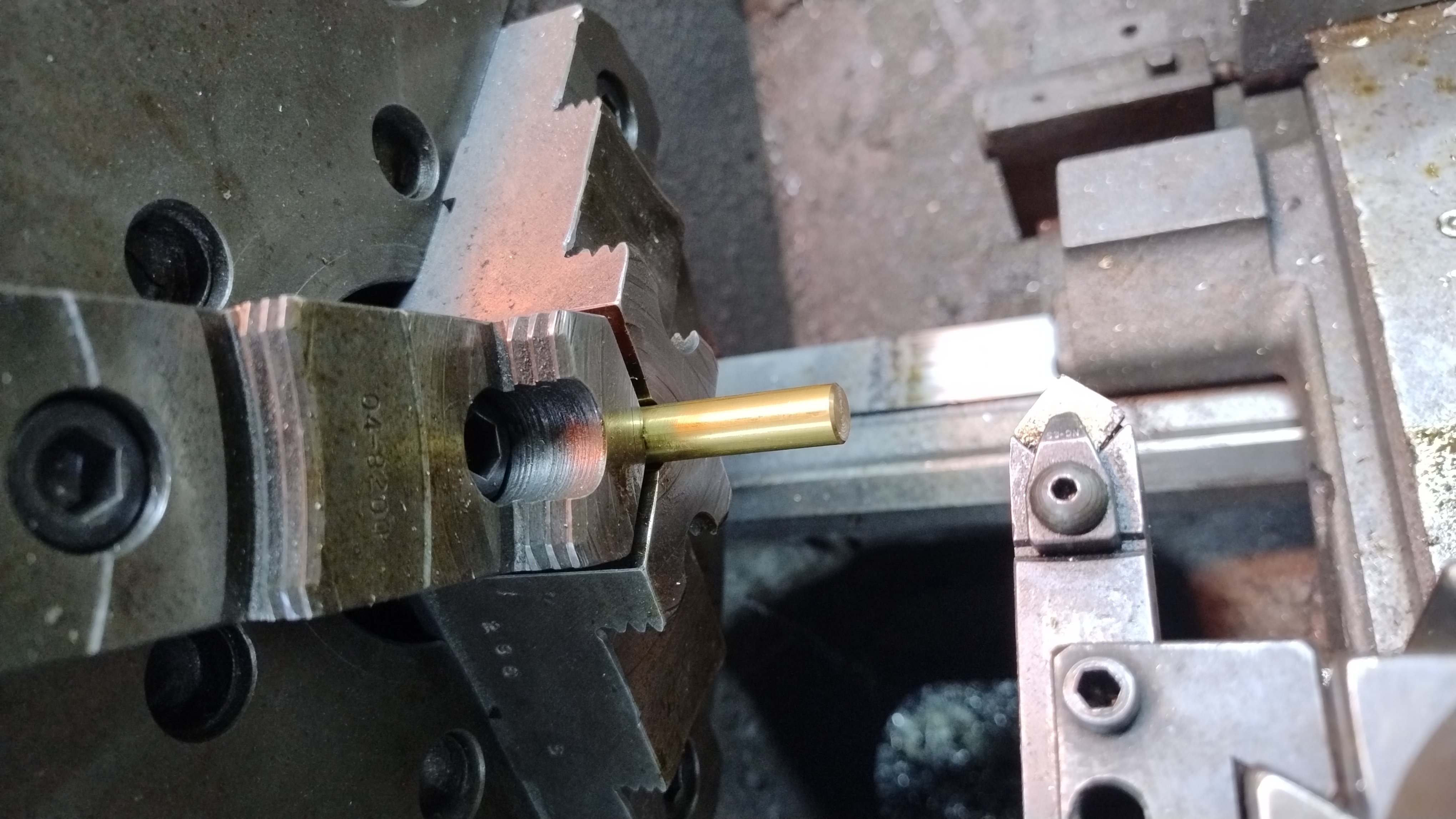

    Had some time and knocked out the brass
    grill pegs...

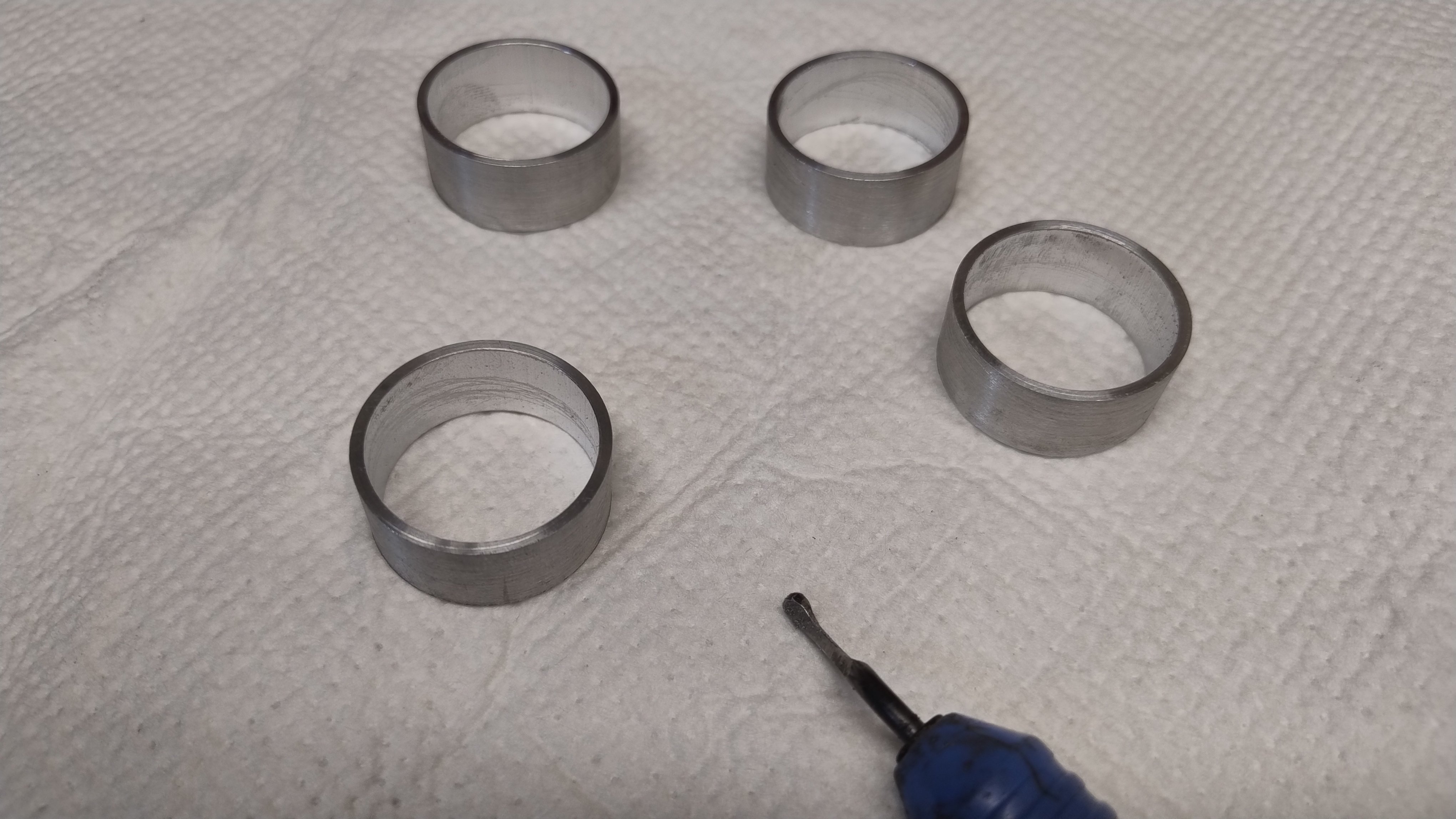

    Made a couple extra rings 0.540" tall for some MW6500s...😁

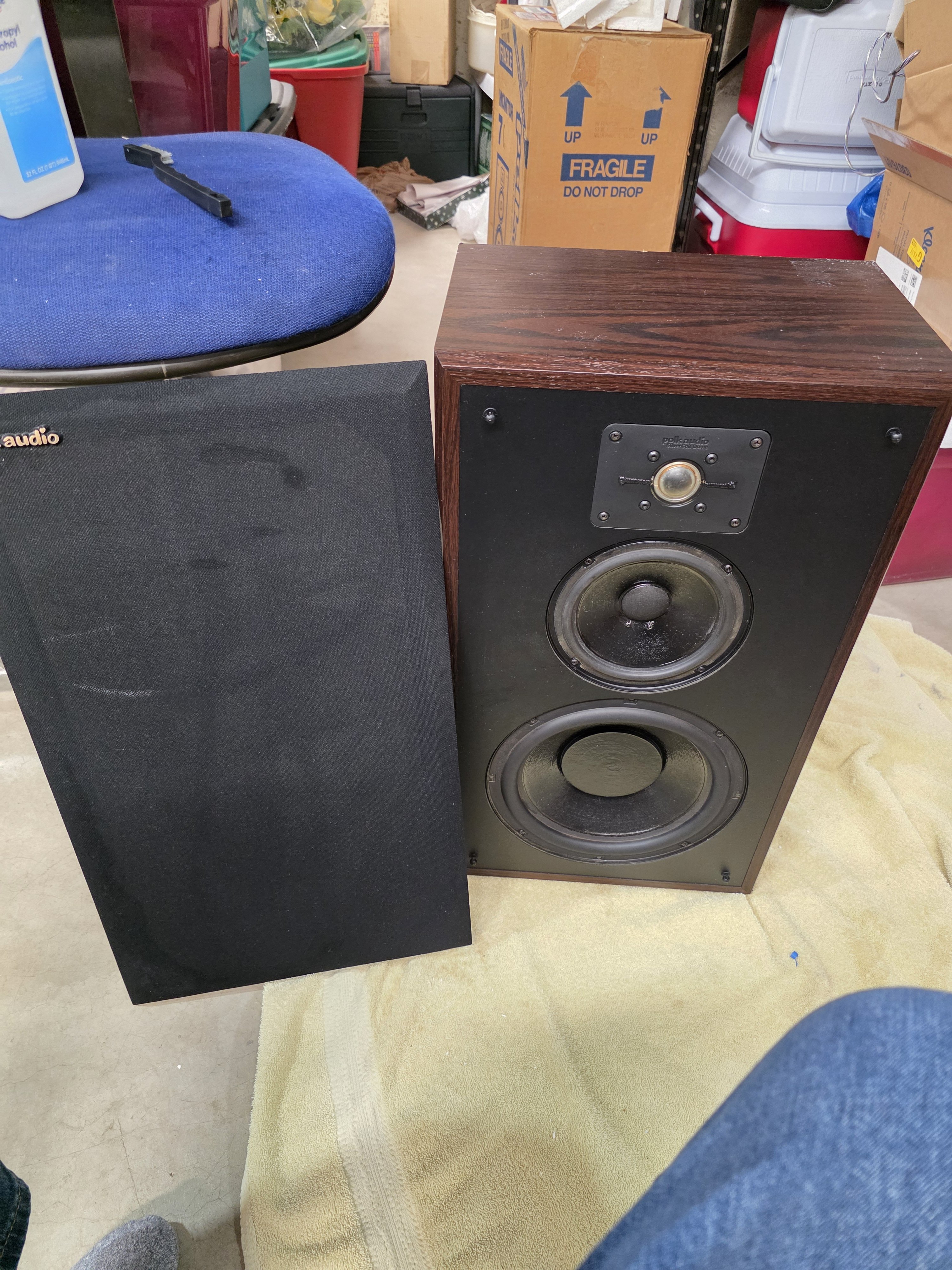

    Boxes say 7C but speakers have what looks like the sl2000 tweeters. Serial numbers of speakers match serial on boxes.
    Styrofoam stuck on corners, other wise in nice shape.

    The first year the 7C came out, it had the SL1000, then all the ones after that had the SL2000. According to @DeRod the enclosure walls are thicker on the 7C, than the 7B.

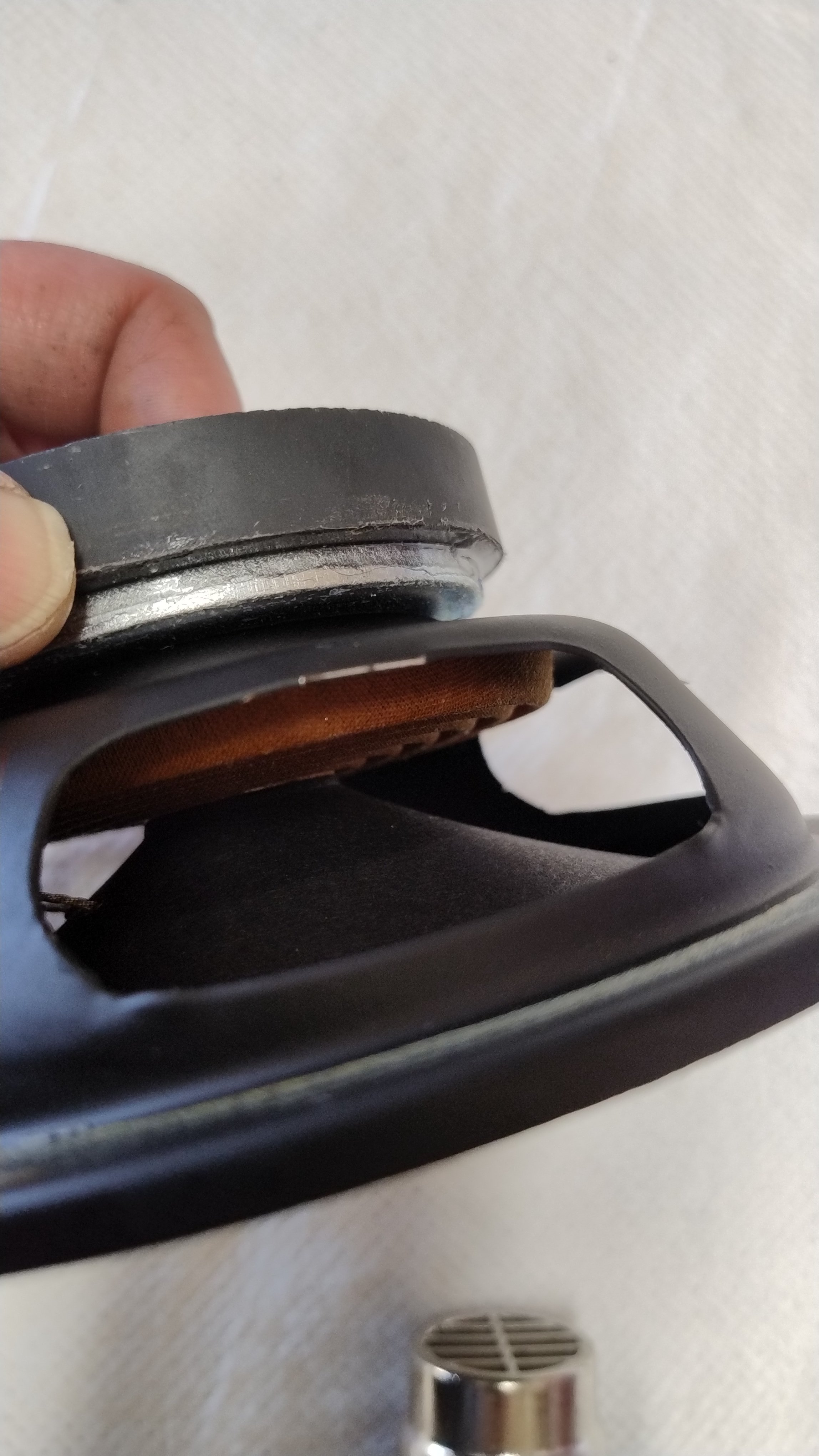

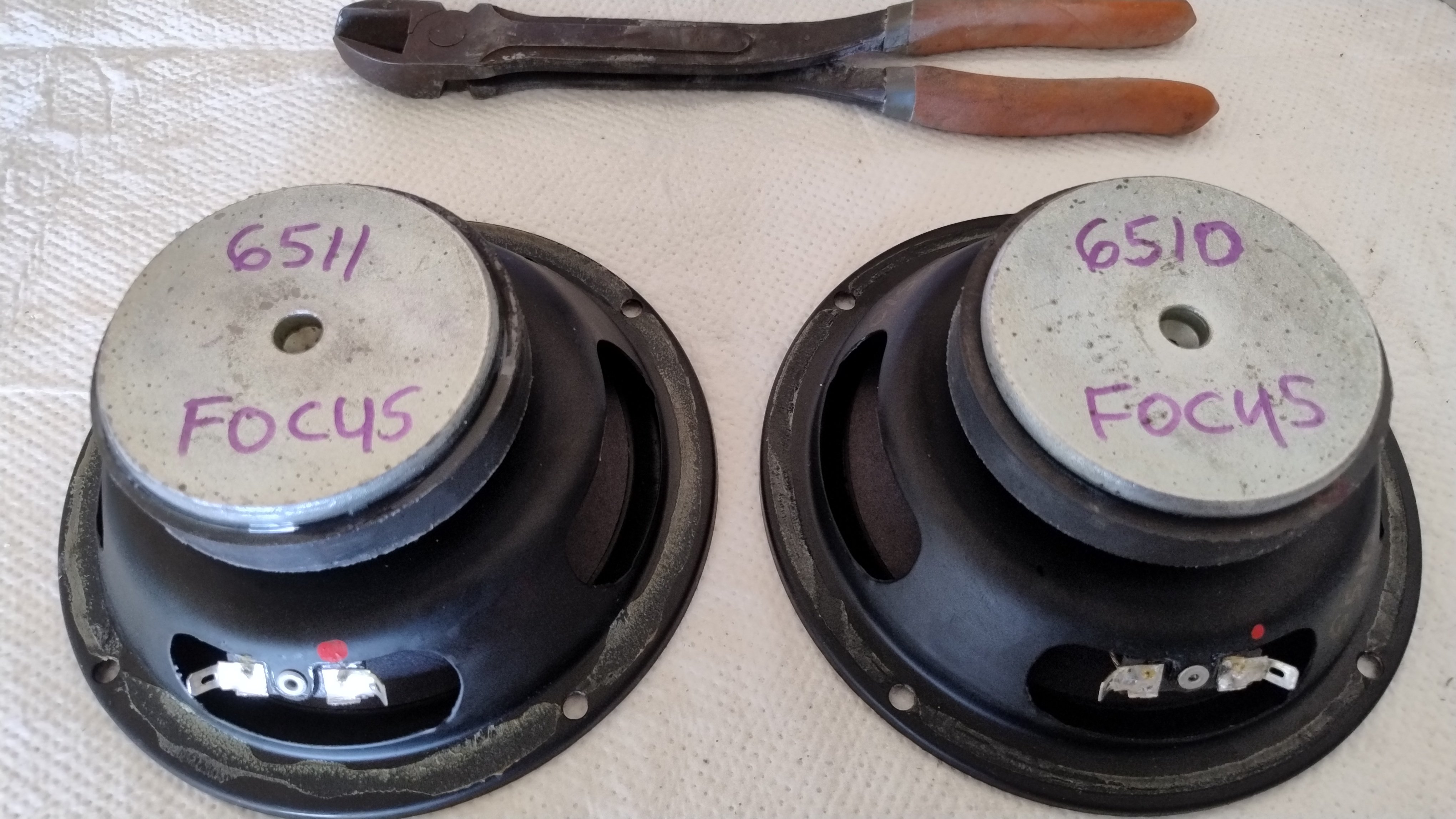

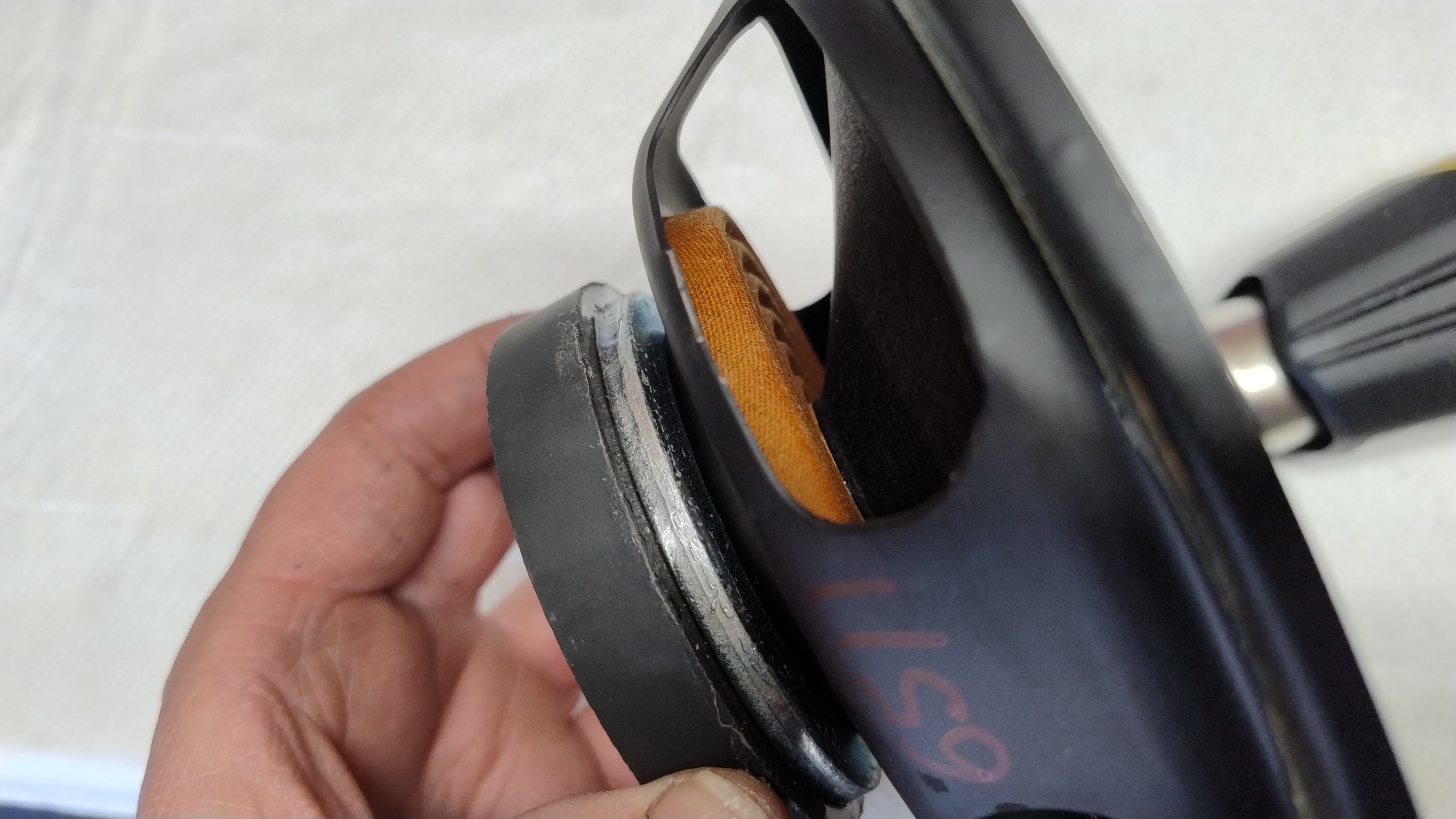

    xschop Posts: 5,796

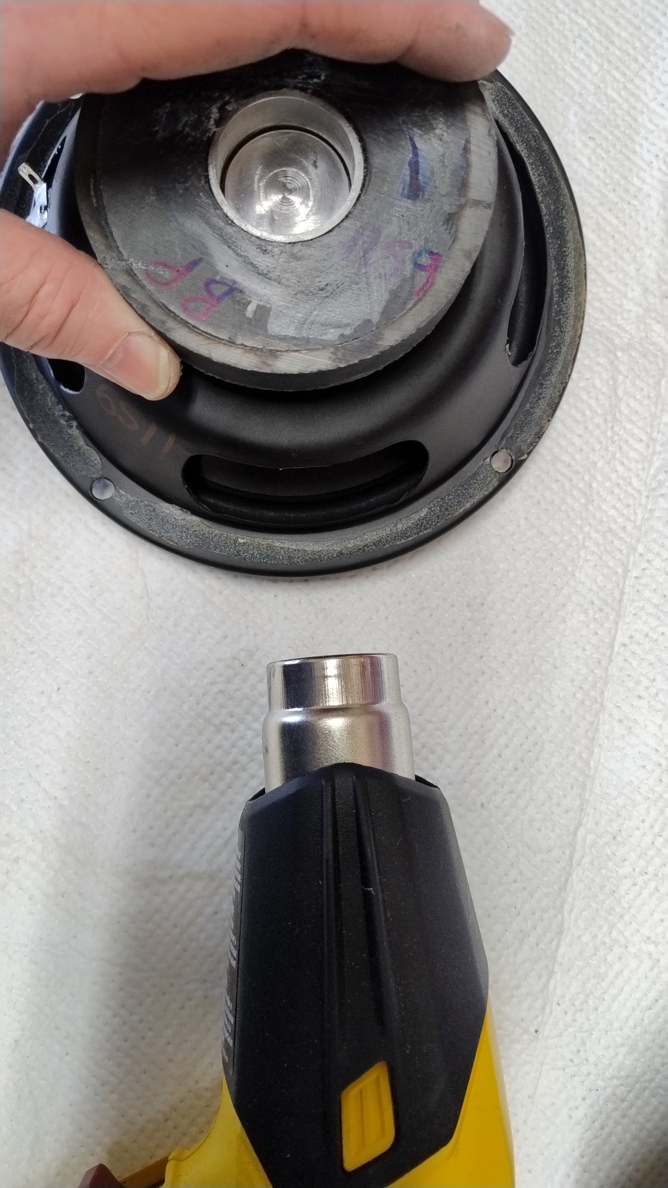

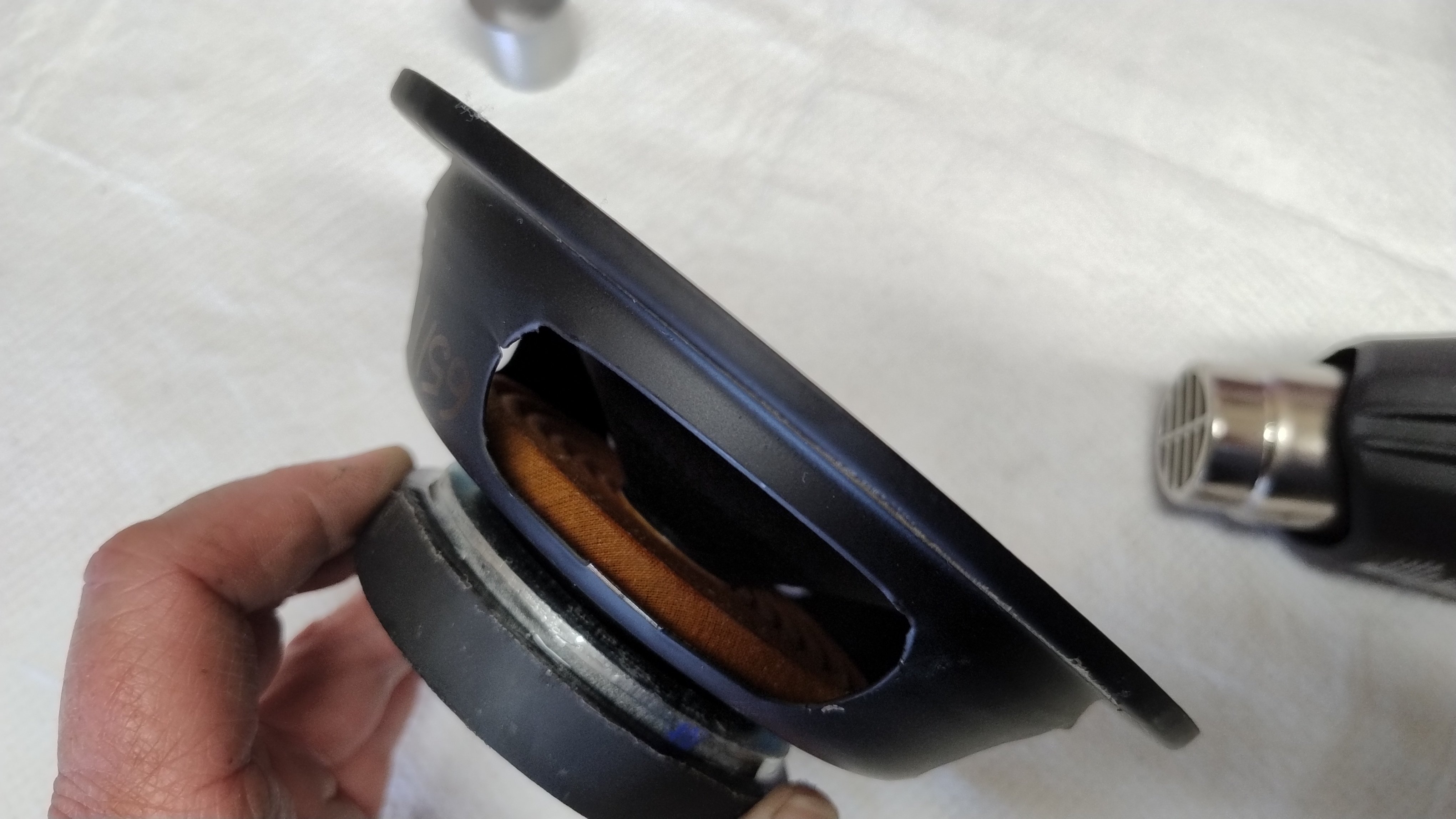

    We'll see if the 0.020 sag is gone permanently in a couple days from this 6511.
    Used the weighted coil centering spud and heated the spider gradually. Its back to normal for now...

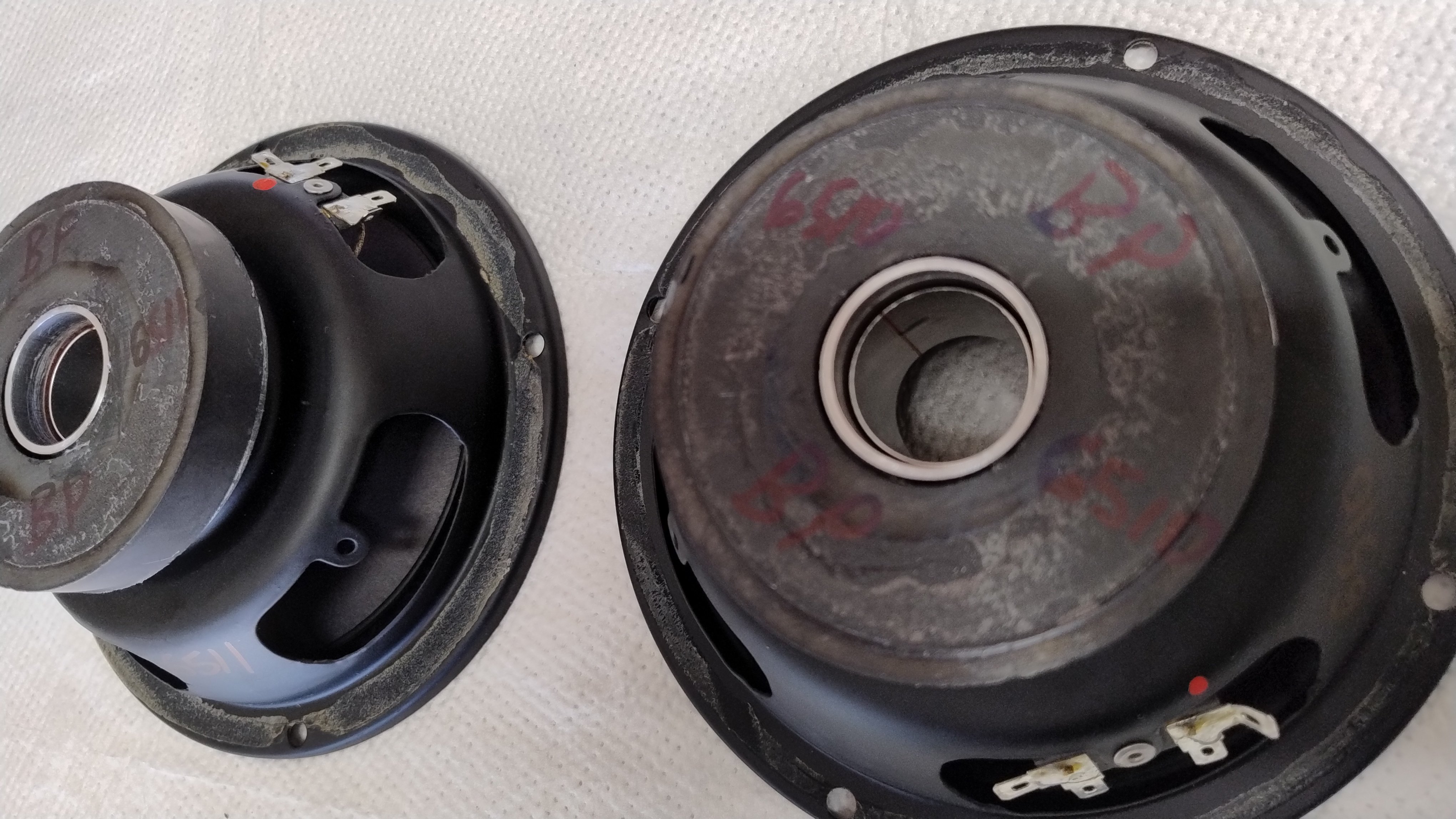

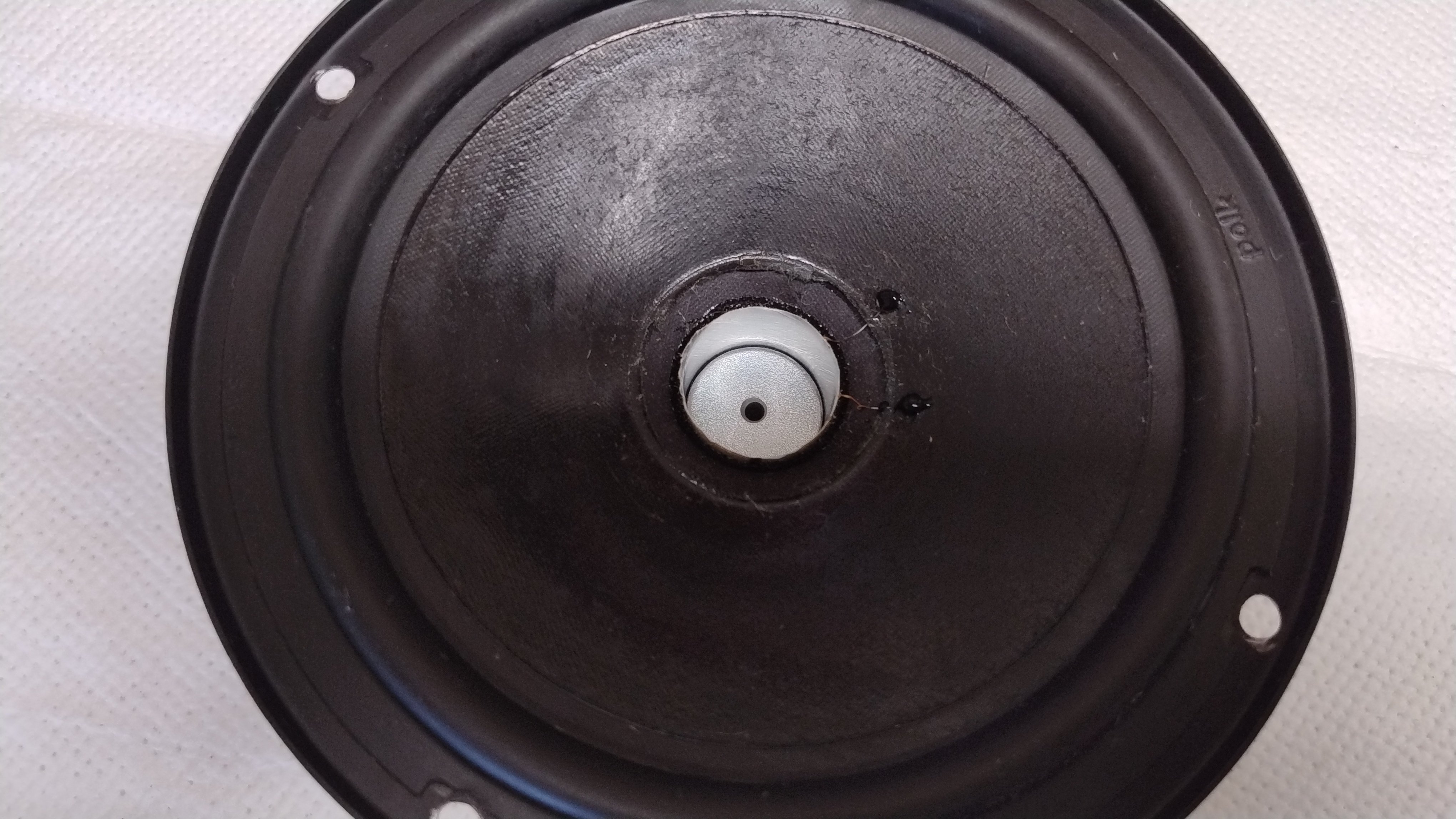

    First of their species...

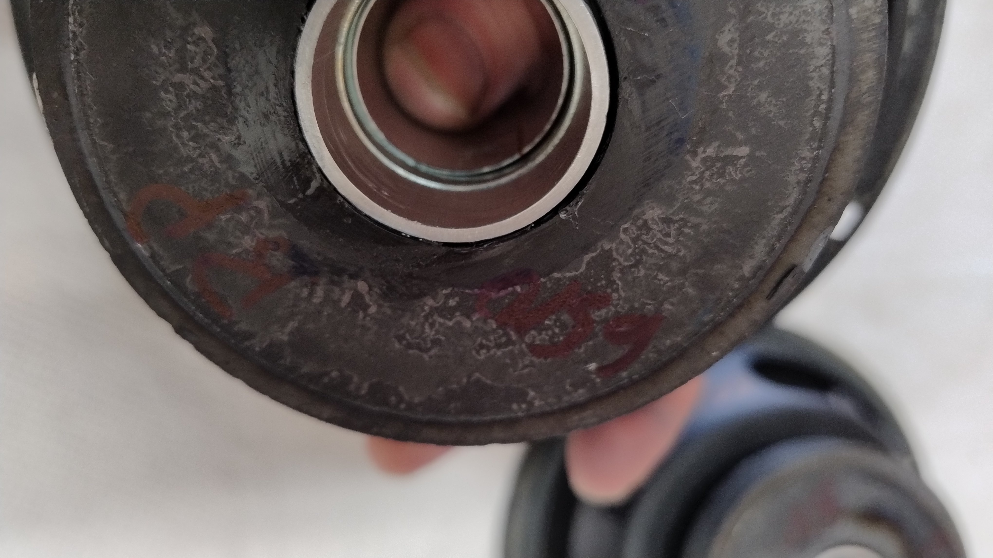

    xschop Posts: 5,796
    xschop Posts: 5,796
    xschop Posts: 5,796
