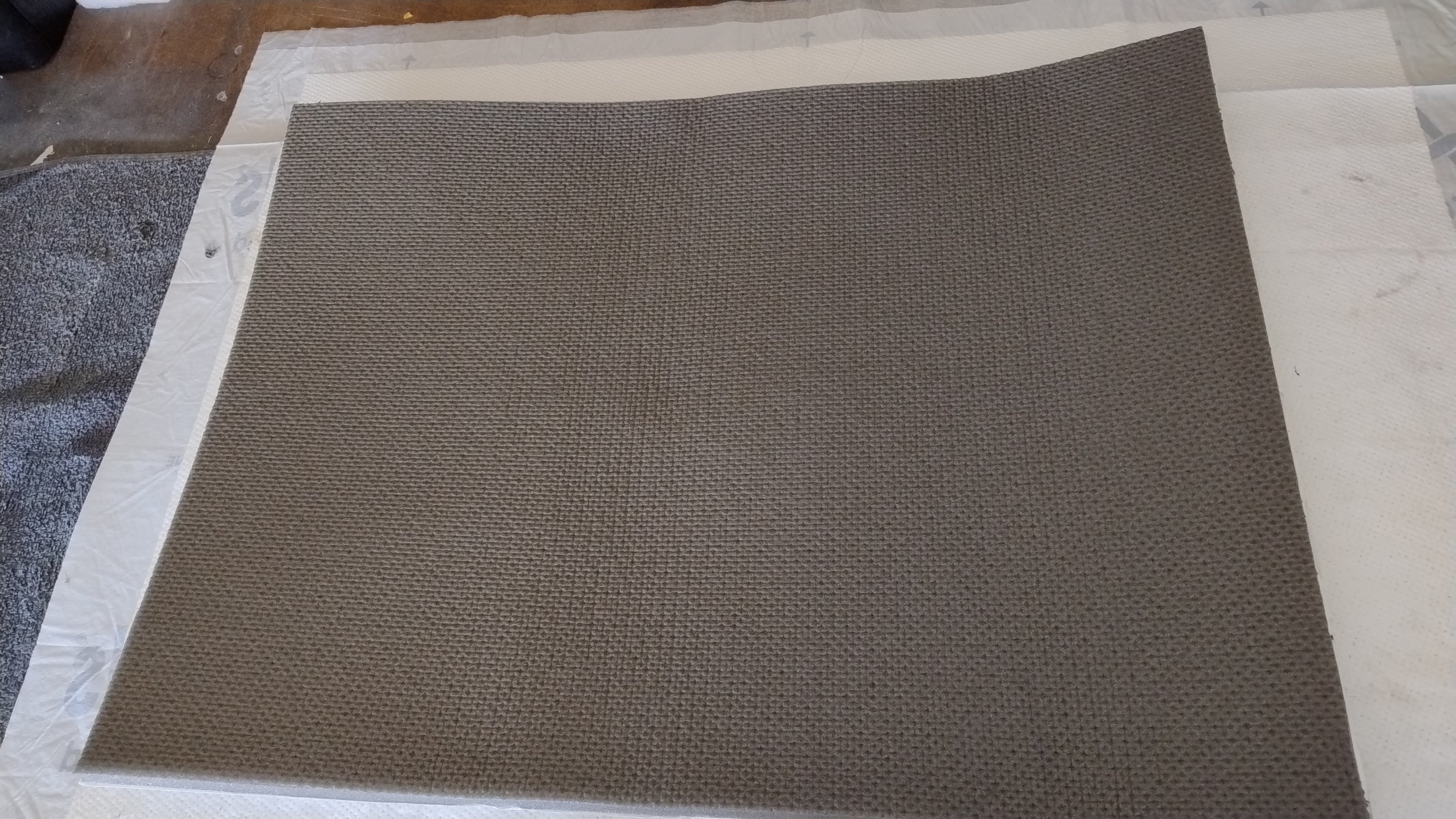

First question for the hive is what speaker grill cloth is best for sound transparency in white?

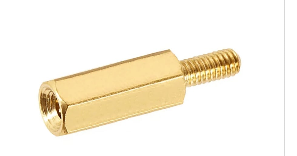

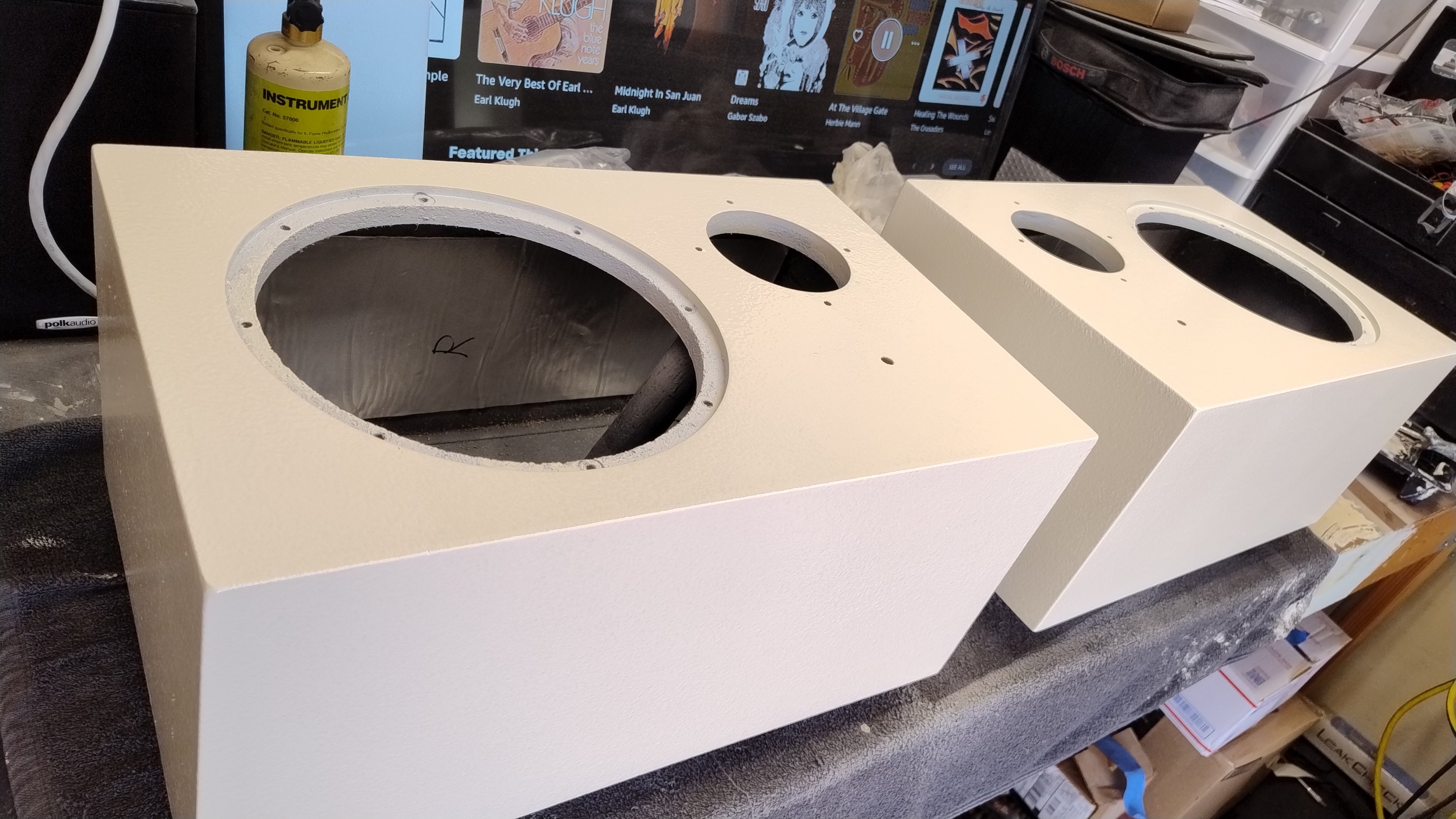

I'm going to strip and shoot the cabs white with all 100% machined brass parts and fasteners.

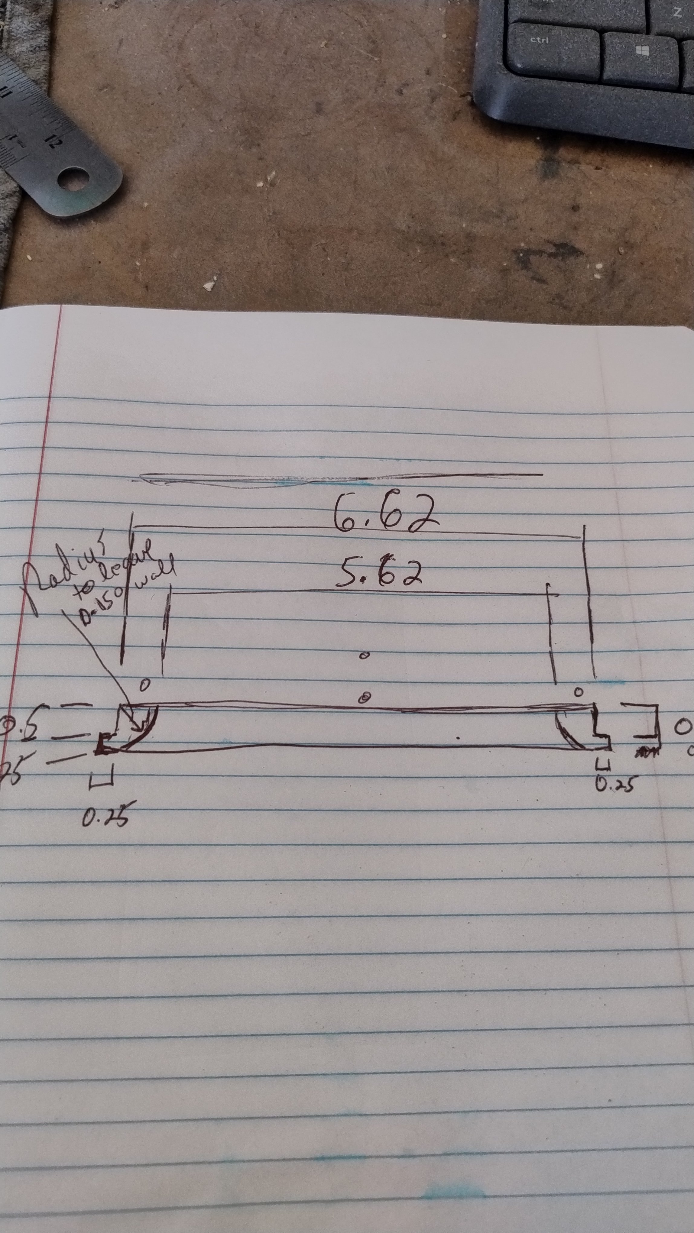

Already started the grill frame update...

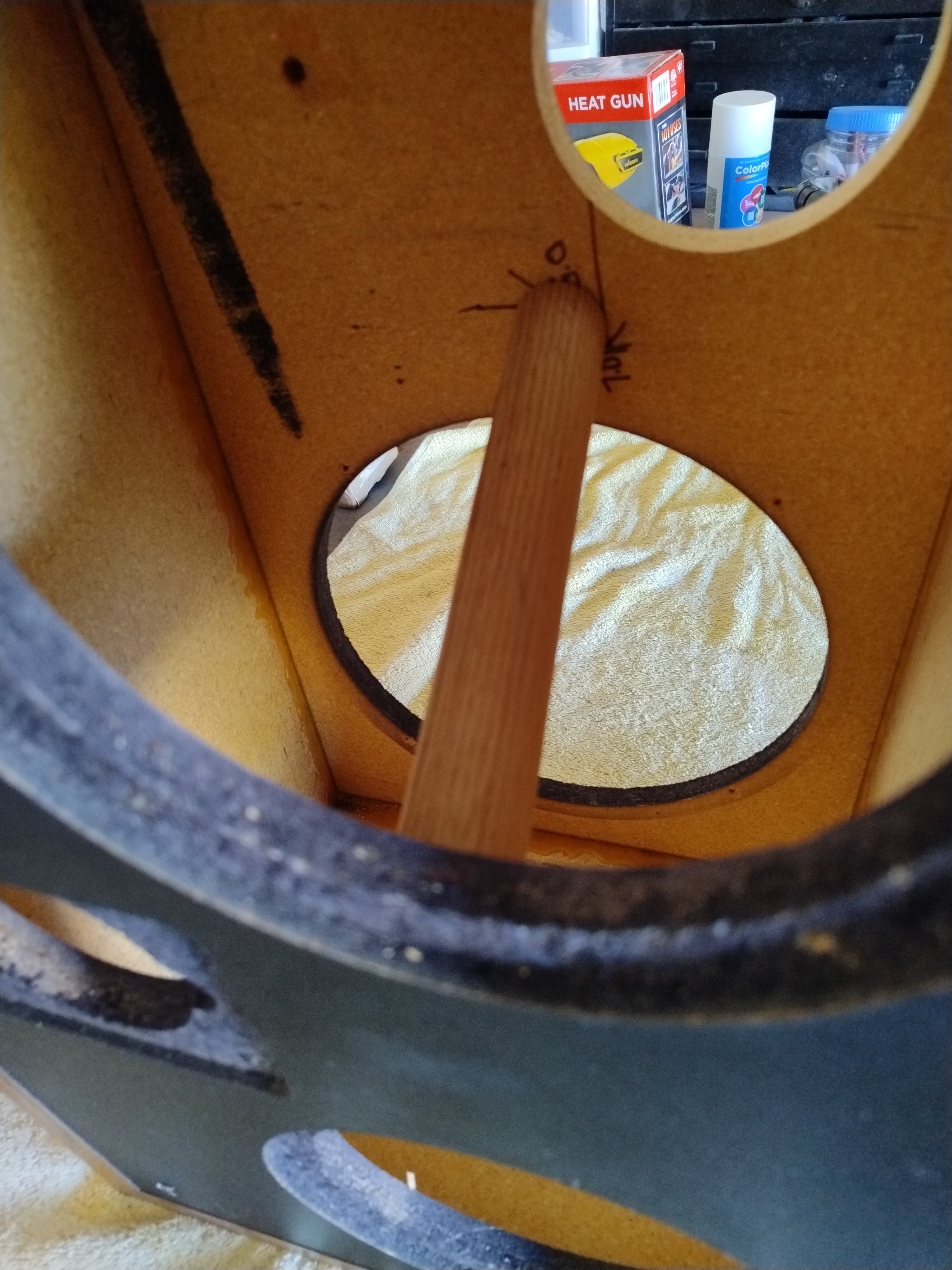

    xschop Posts: 5,811
    edited May 7

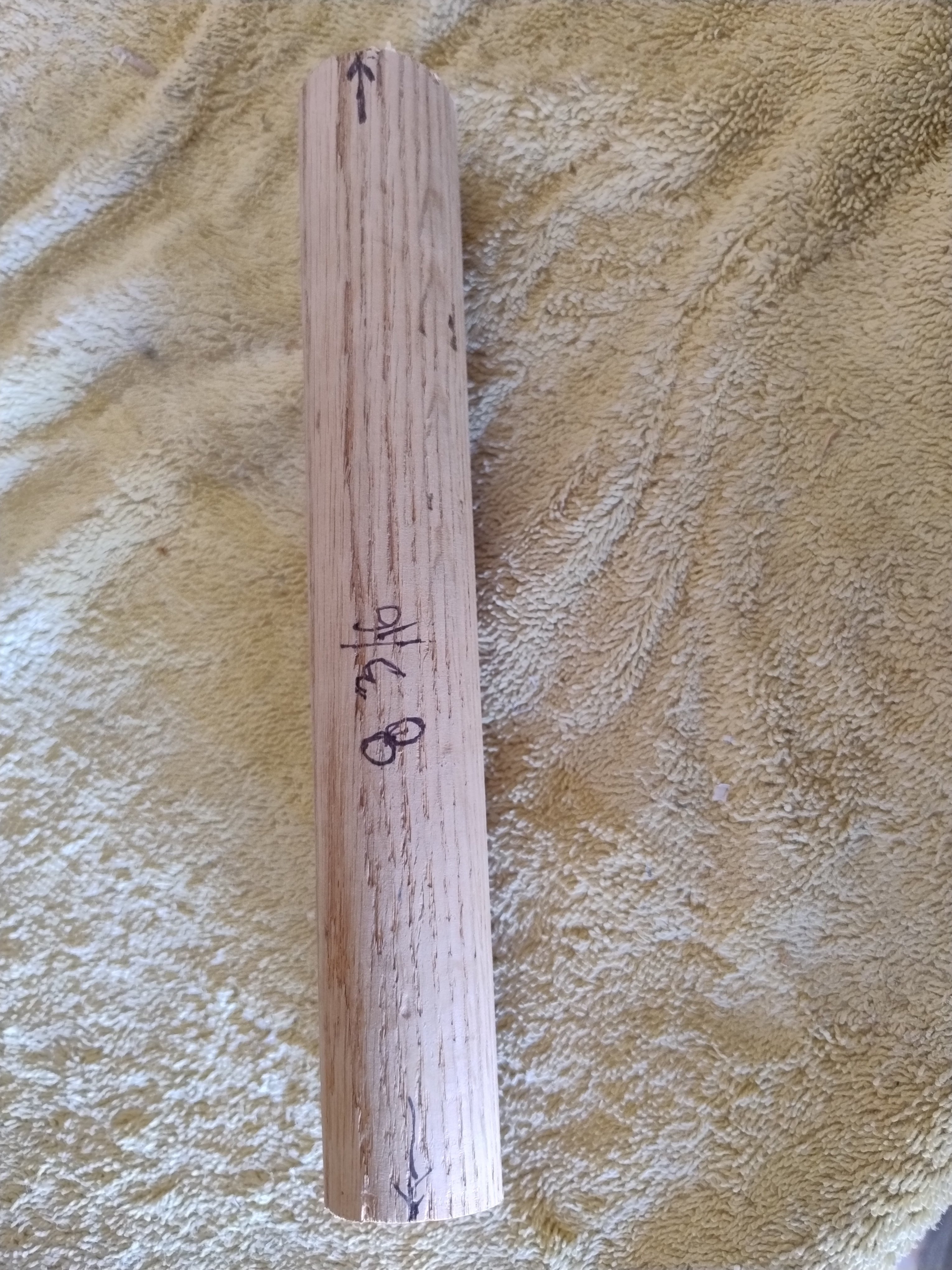

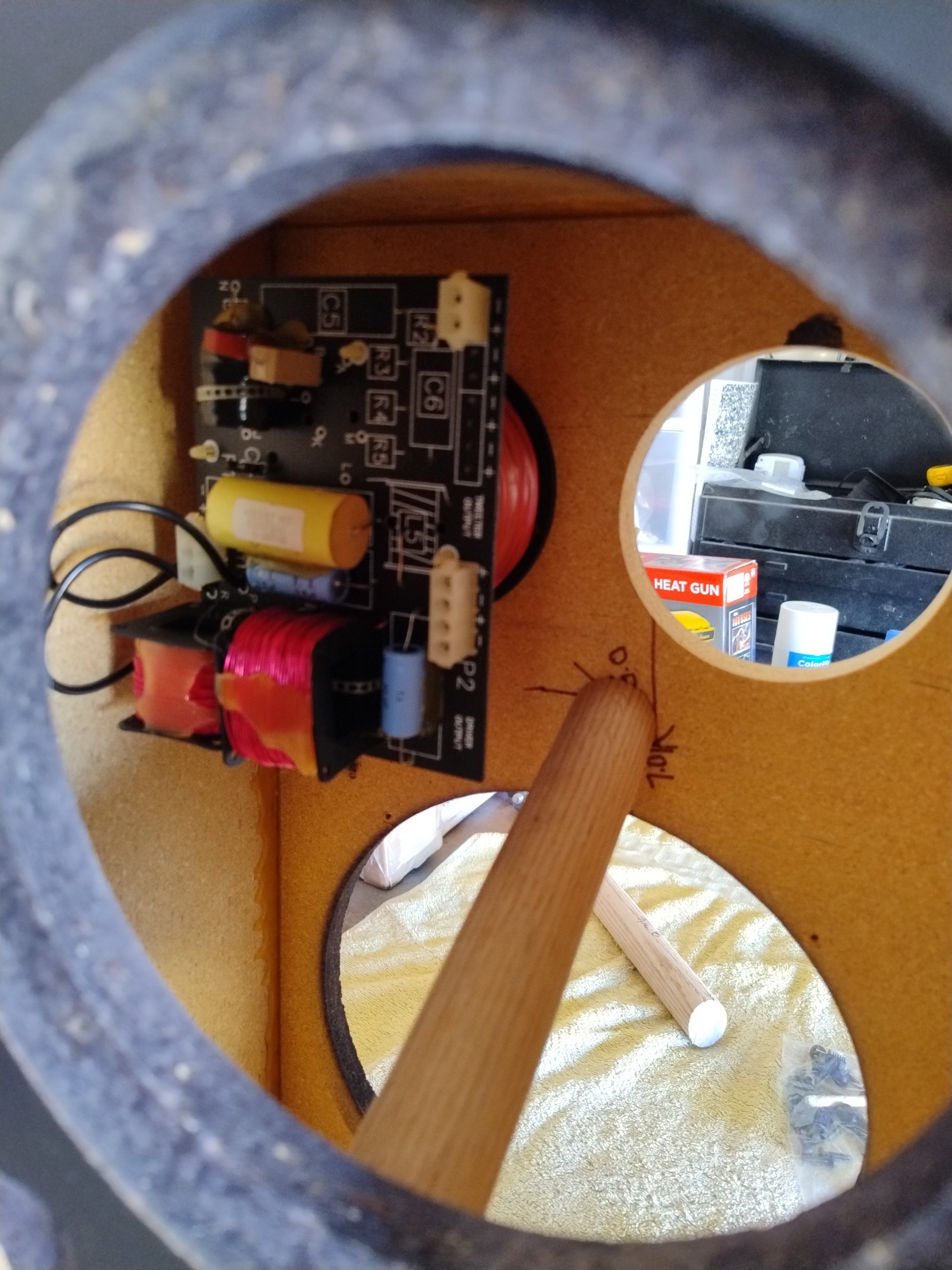

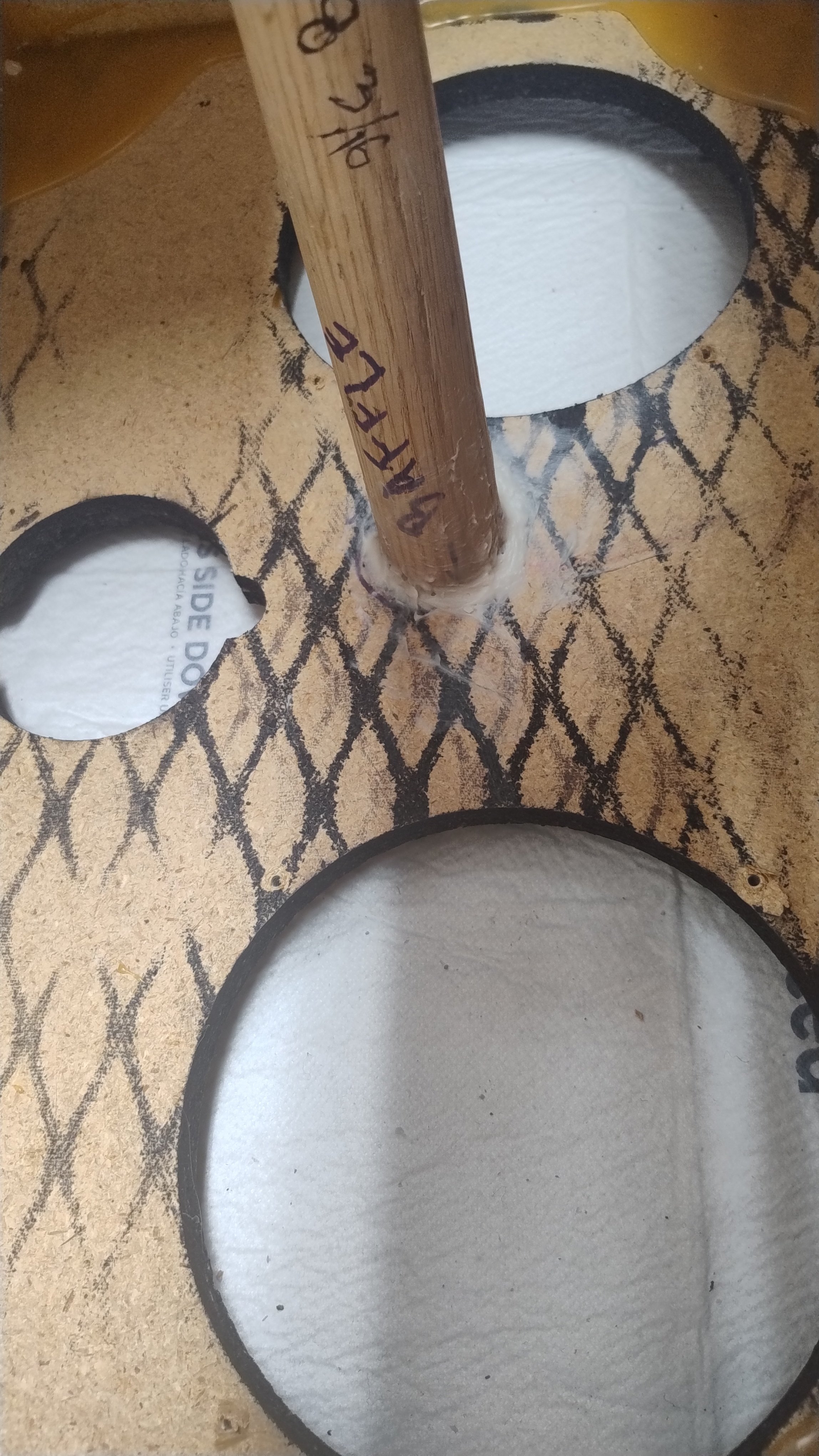

    1.25" solid oak dowel
    cross-cut 8 3/16" offset either side puts it angled and centered between front and back weak points...
    This clears all drivers and factory crossover.
    Reason why I cannot use the larger point to point board....

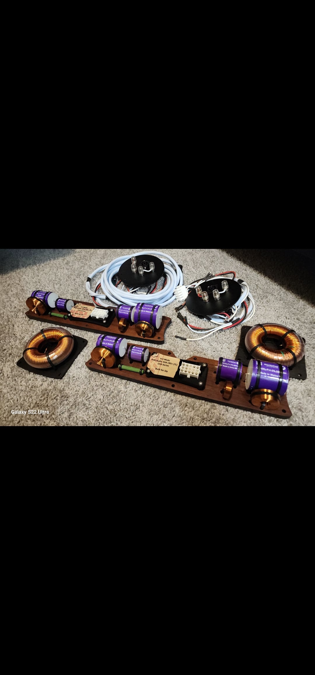

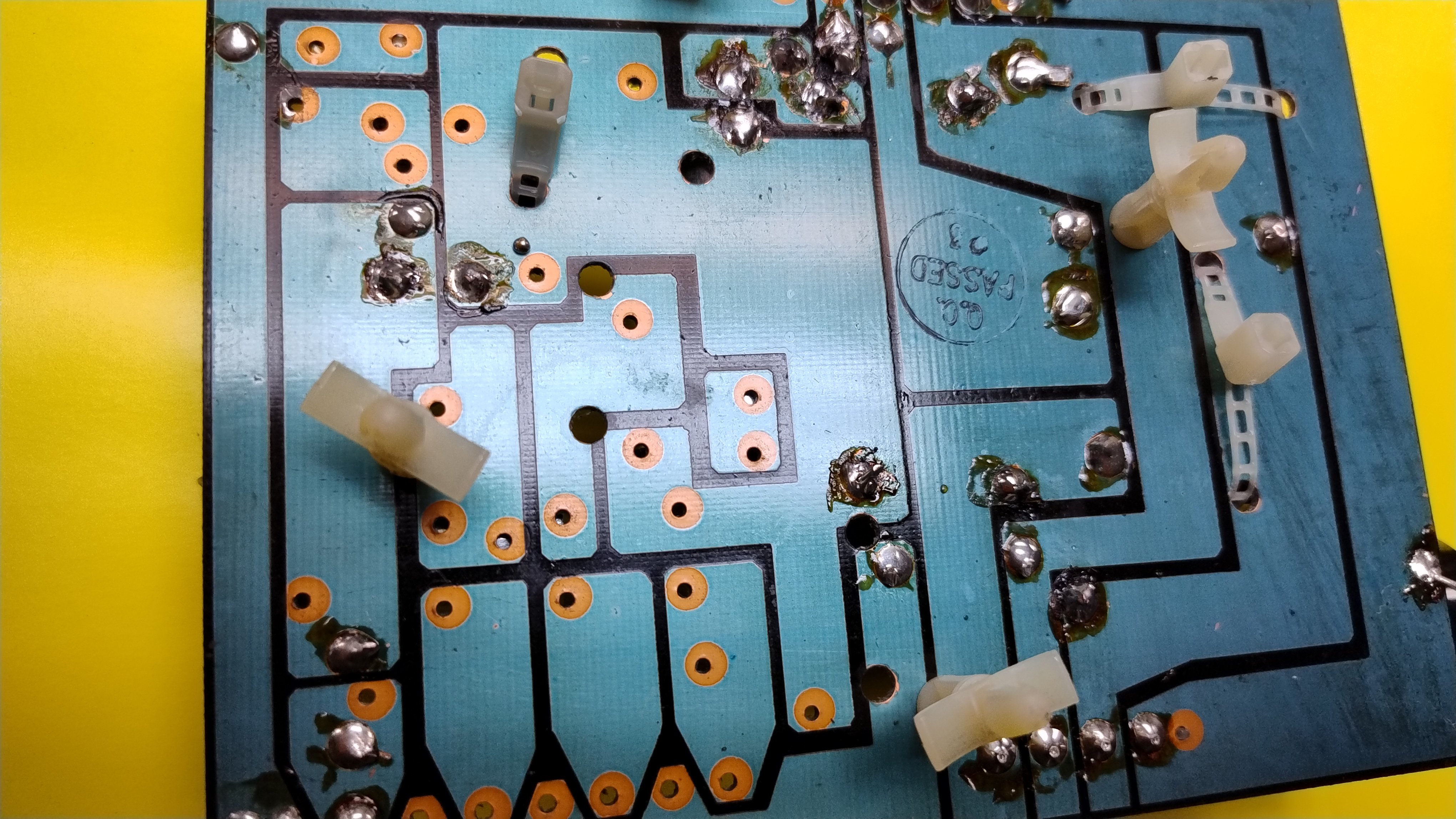

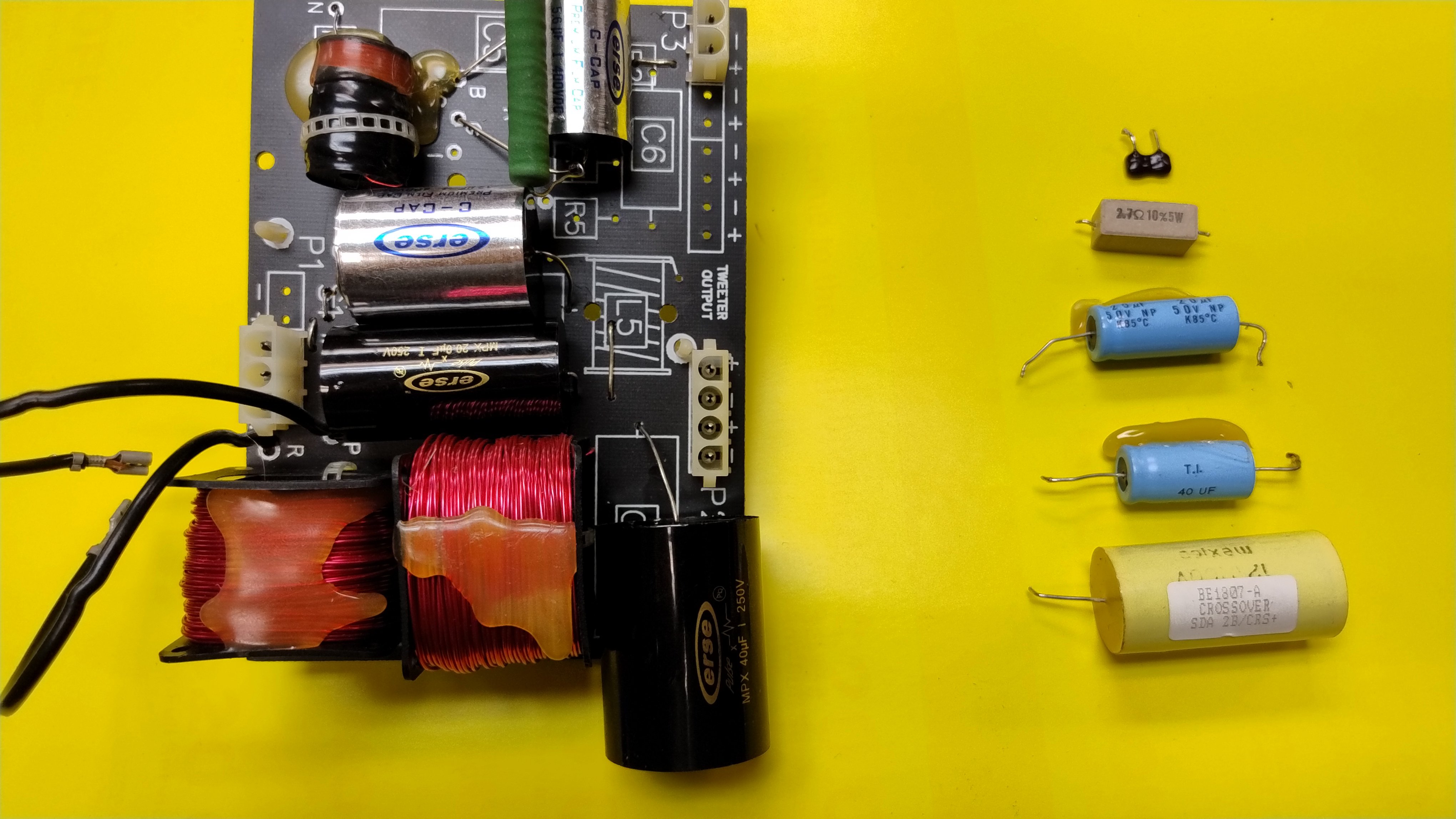

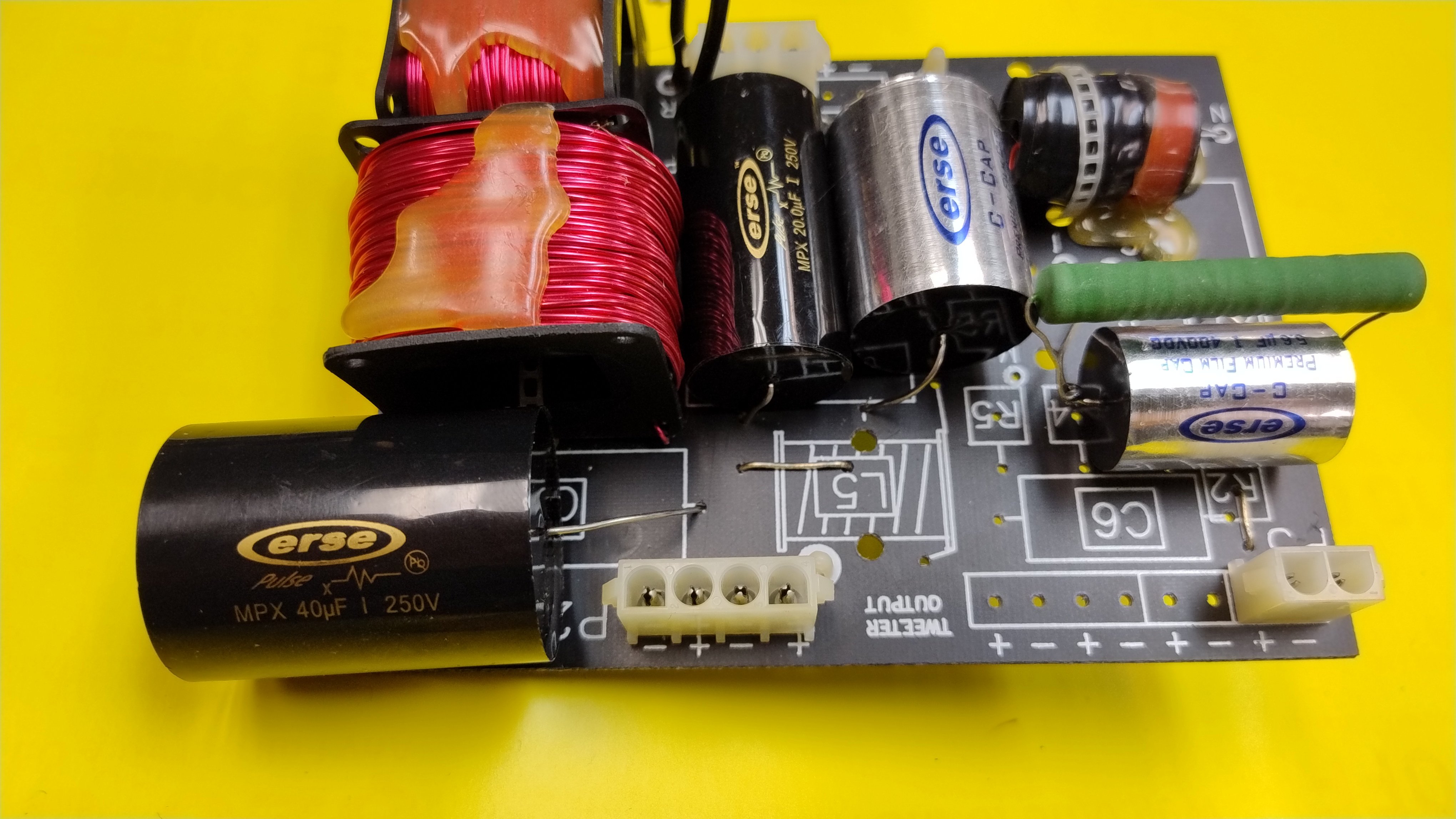

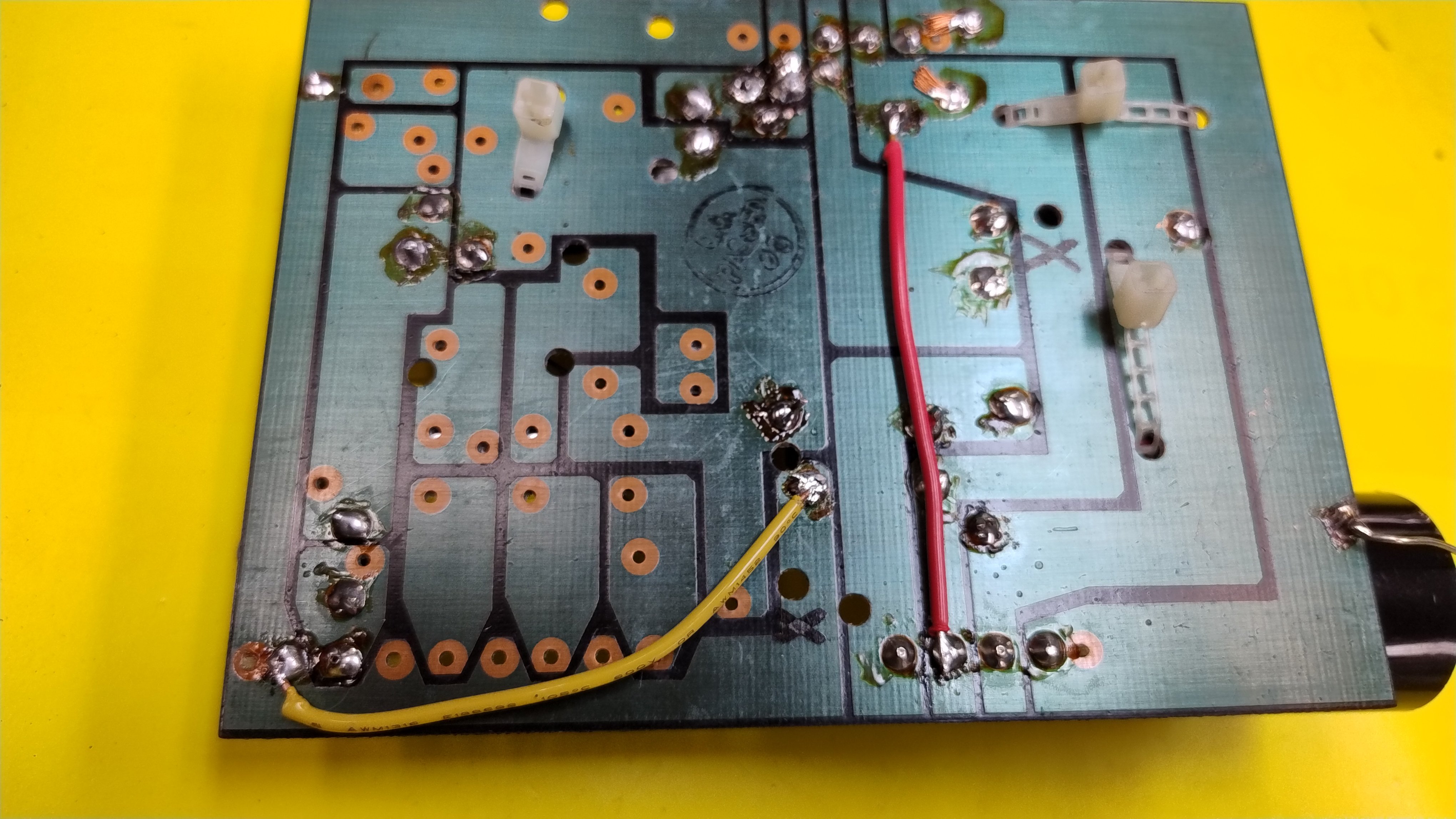

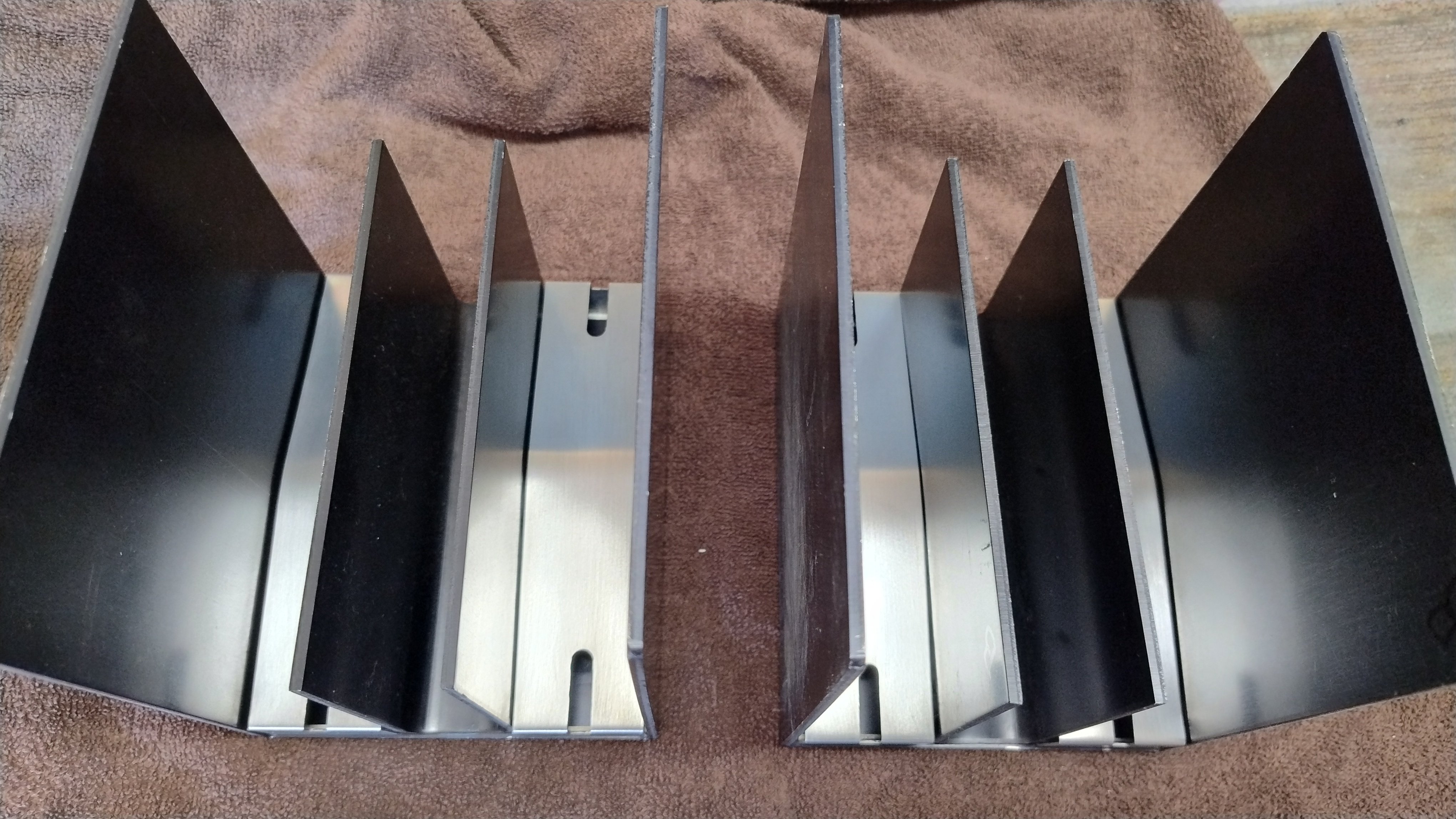

    Power Grab time.
    VR3 Posts: 29,740
    Something like this would still fit
  • invalid
    invalid Posts: 1,559
    VR3 wrote: »
    That's awesome, problem solved.
    VR3 Posts: 29,740
    Yes, the inductor fits where the old crossover fit
  • invalid
    VR3 wrote: »
    You are definitely creative and meticulous.

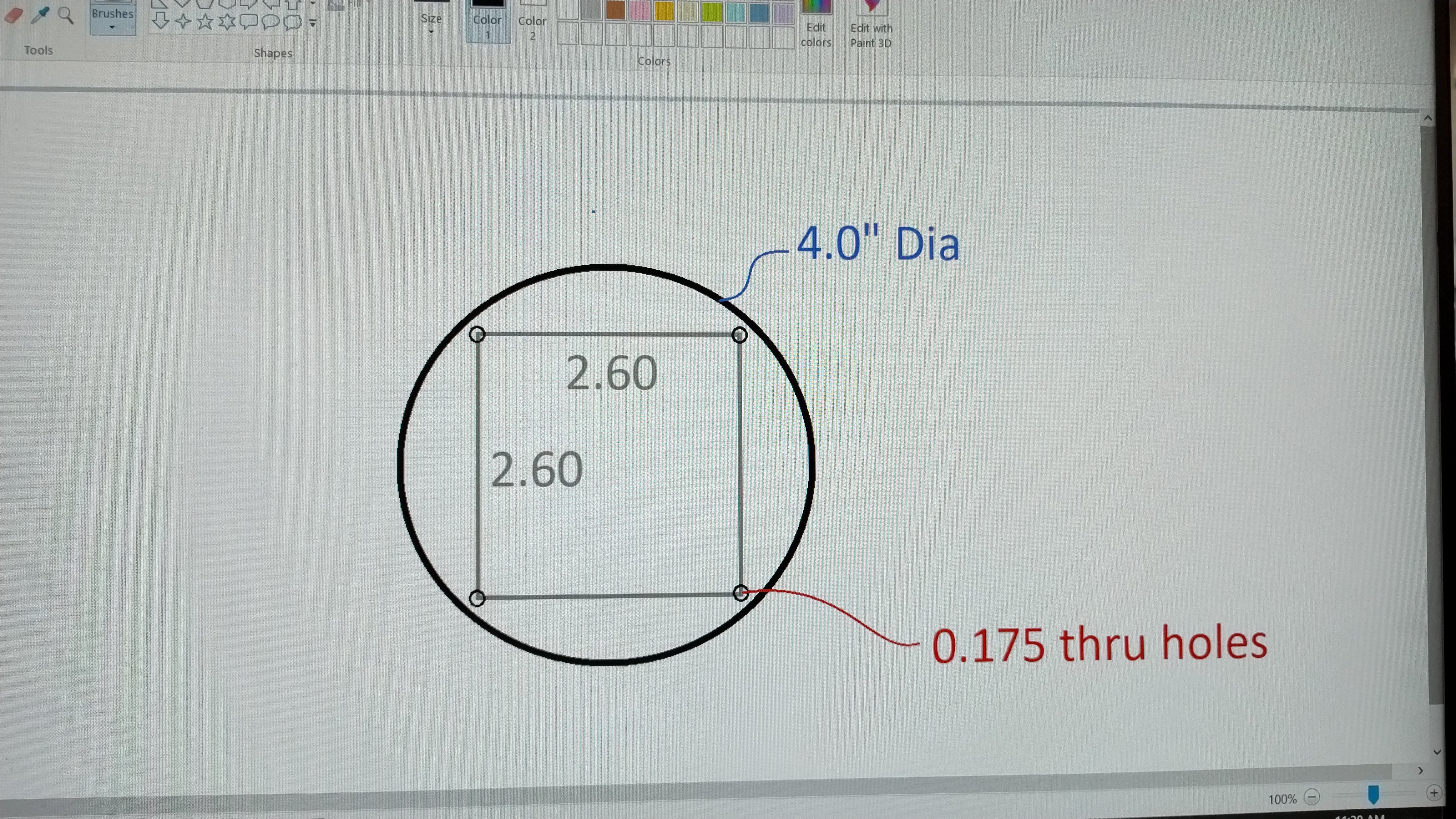

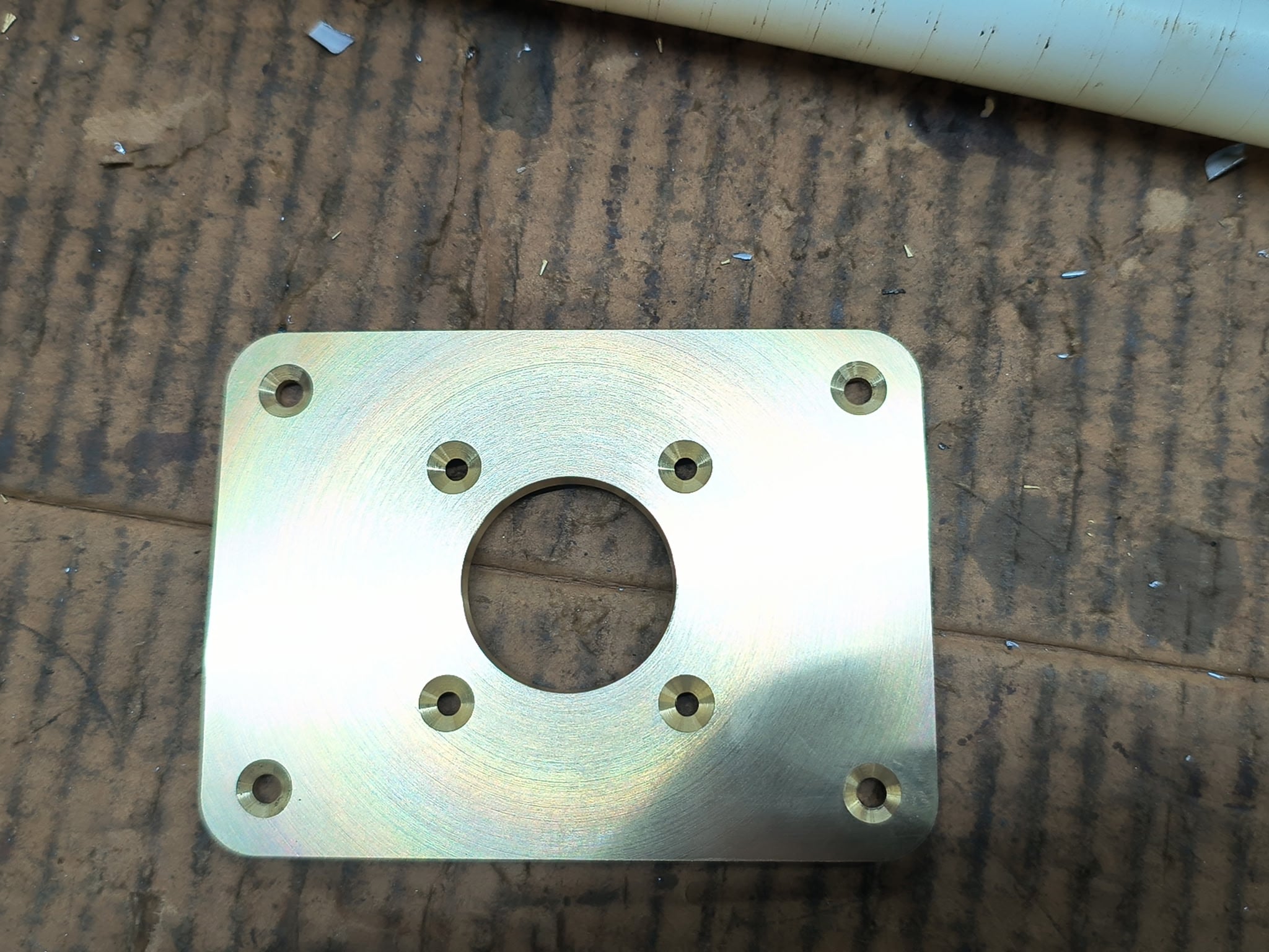

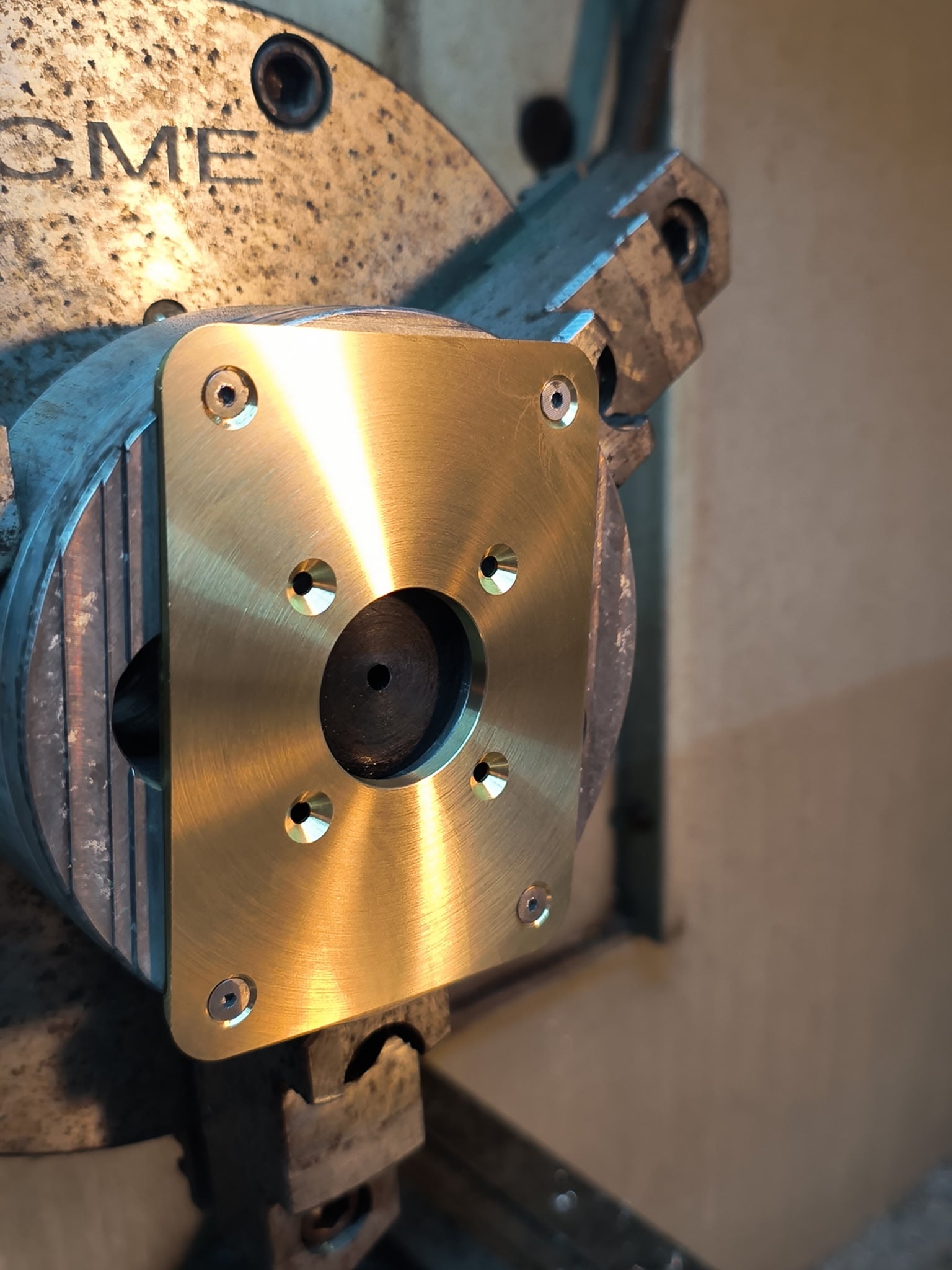

    Very nice. I'll machine an adapter that mounts the Erse Super Q/factory X-over in factory location as well, mounting with 1 bolt. All other hardware will be machined solid brass, including the terminal plates, tweeter plates, and custom grill pegs.
    VR3 Posts: 29,740
    edited May 7
    Thanks for the kind words :)
    really need to get the big sda inductor far away from the smaller ones for best performance

    xschop wrote: »
    Power Grab time.
    What is the angle you cut this at? Definitely following along with your build.
    VR3 Posts: 29,740
    Lol I'm far from the inductor police but pools handling of the large sda inductor was... Maybe not the best.
    Mounted right behind the small inductors and mounted directly to aluminum on the big boys.
    An inductor mounted directly to aluminum will decrease in value by over 10%

    xschop Posts: 5,811
    xschop wrote: »
    Power Grab time.
    On it's side view it is a parallelogram with each long side 8 and 3/16" long.
    I started with a 8.5" length then gradually cut each end til it fit snug.

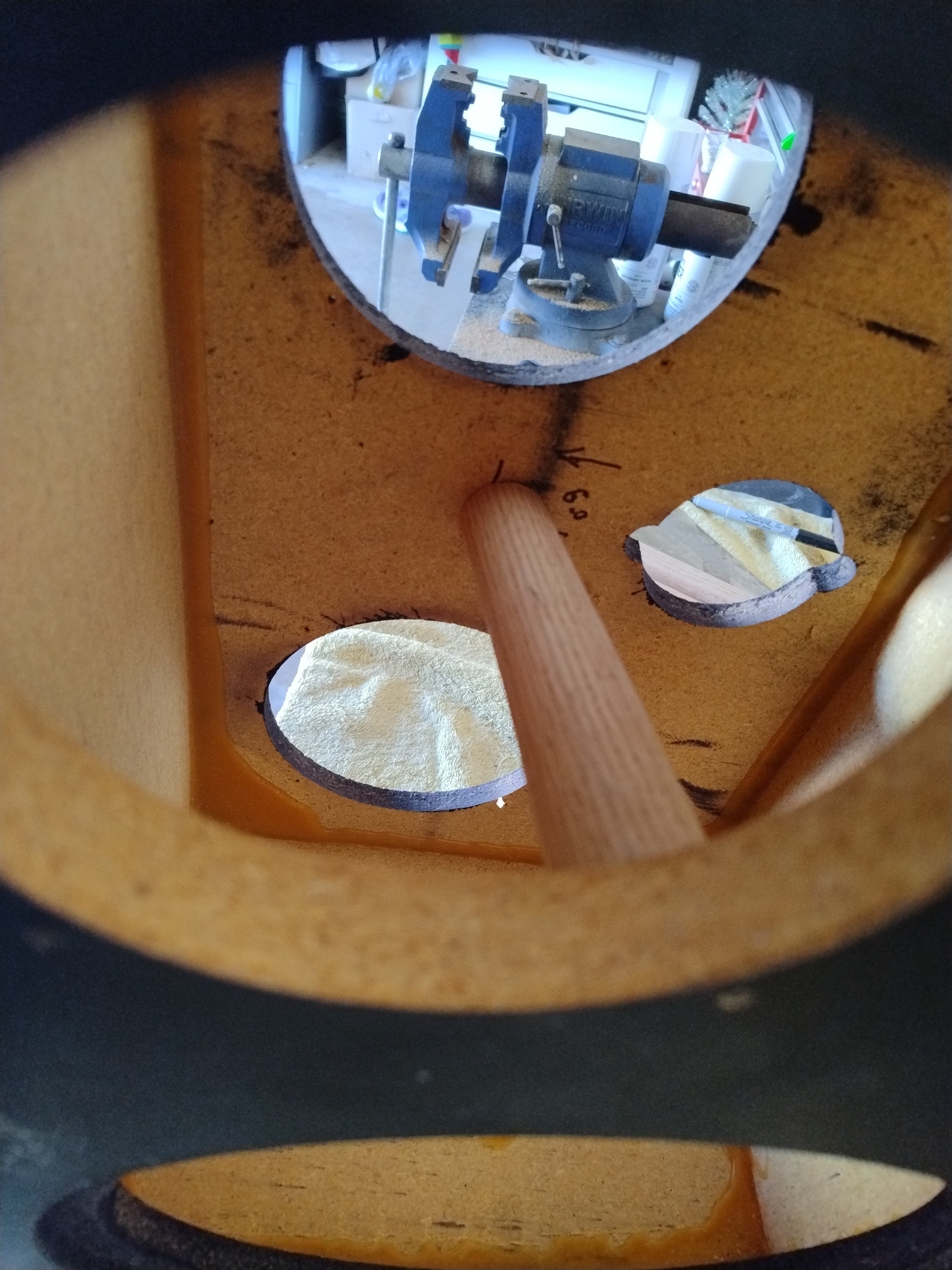

    xschop Posts: 5,811
    edited May 8
    I rasped on it this morning. (Pug Master need not comment) Rock solid now. This will translate to much improved midbass.

    No need to denigrate these further other than the factory wiring terminals were ready to short and cause havoc....

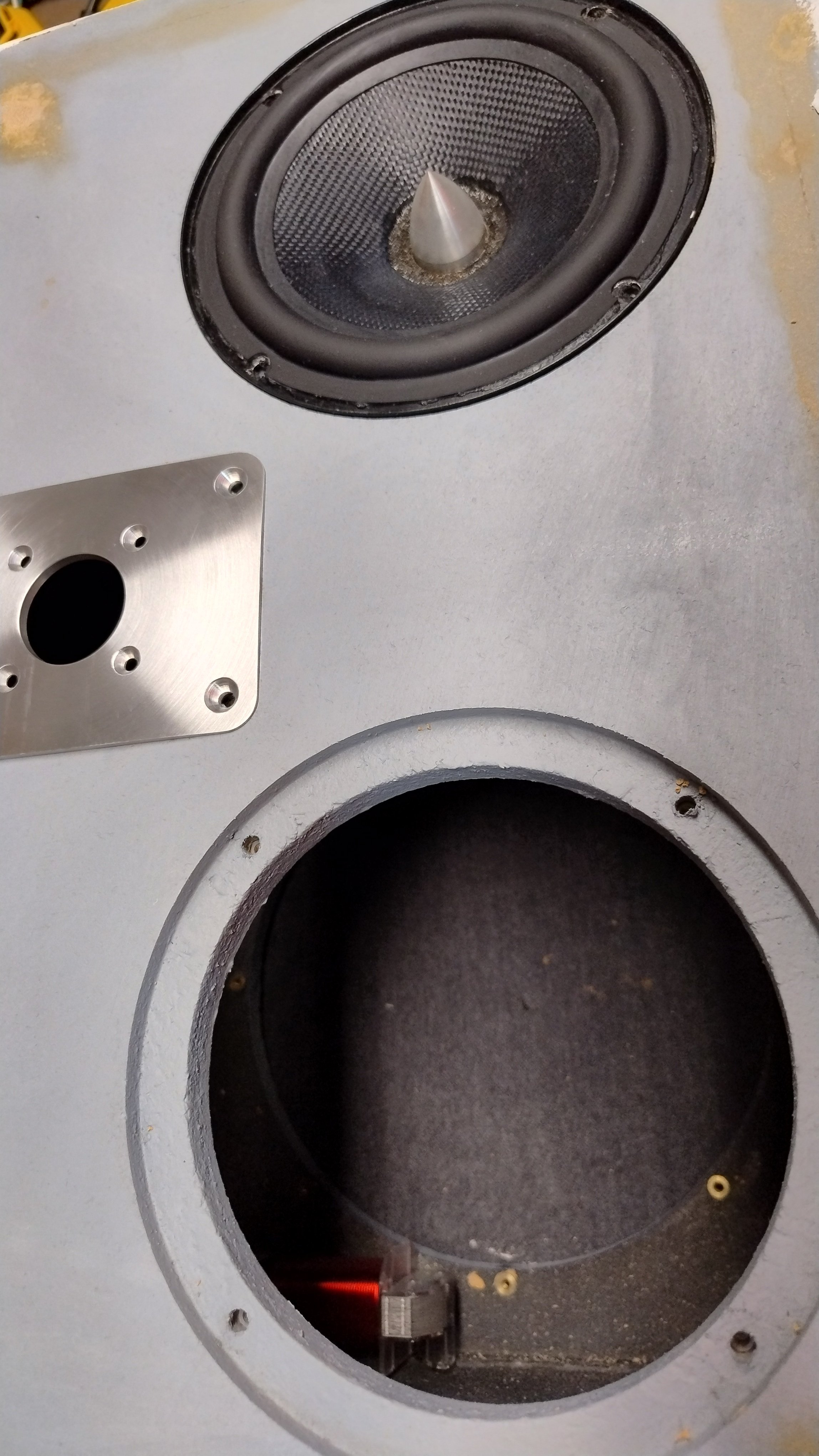

    xschop Posts: 5,811
    edited May 9

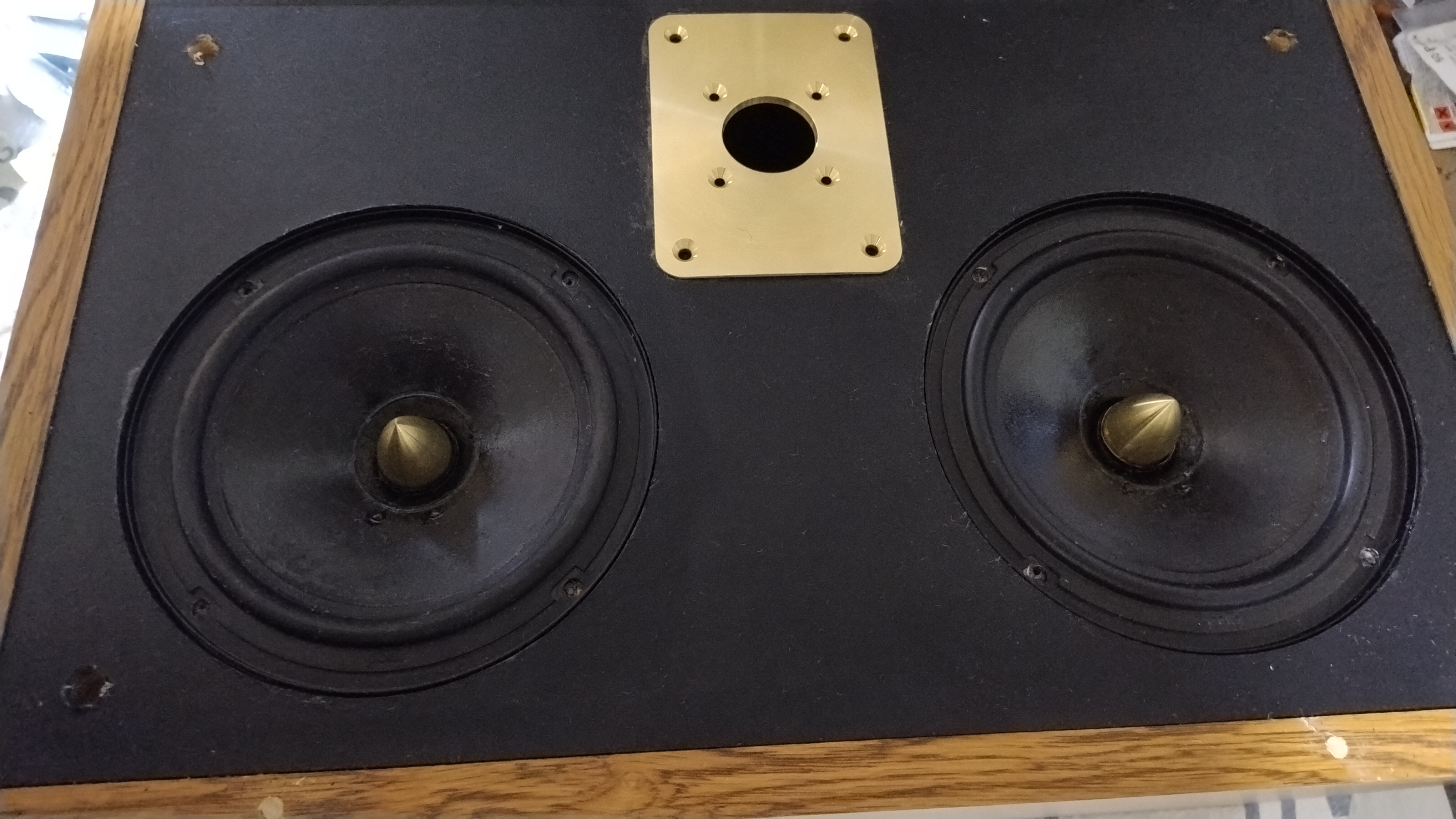

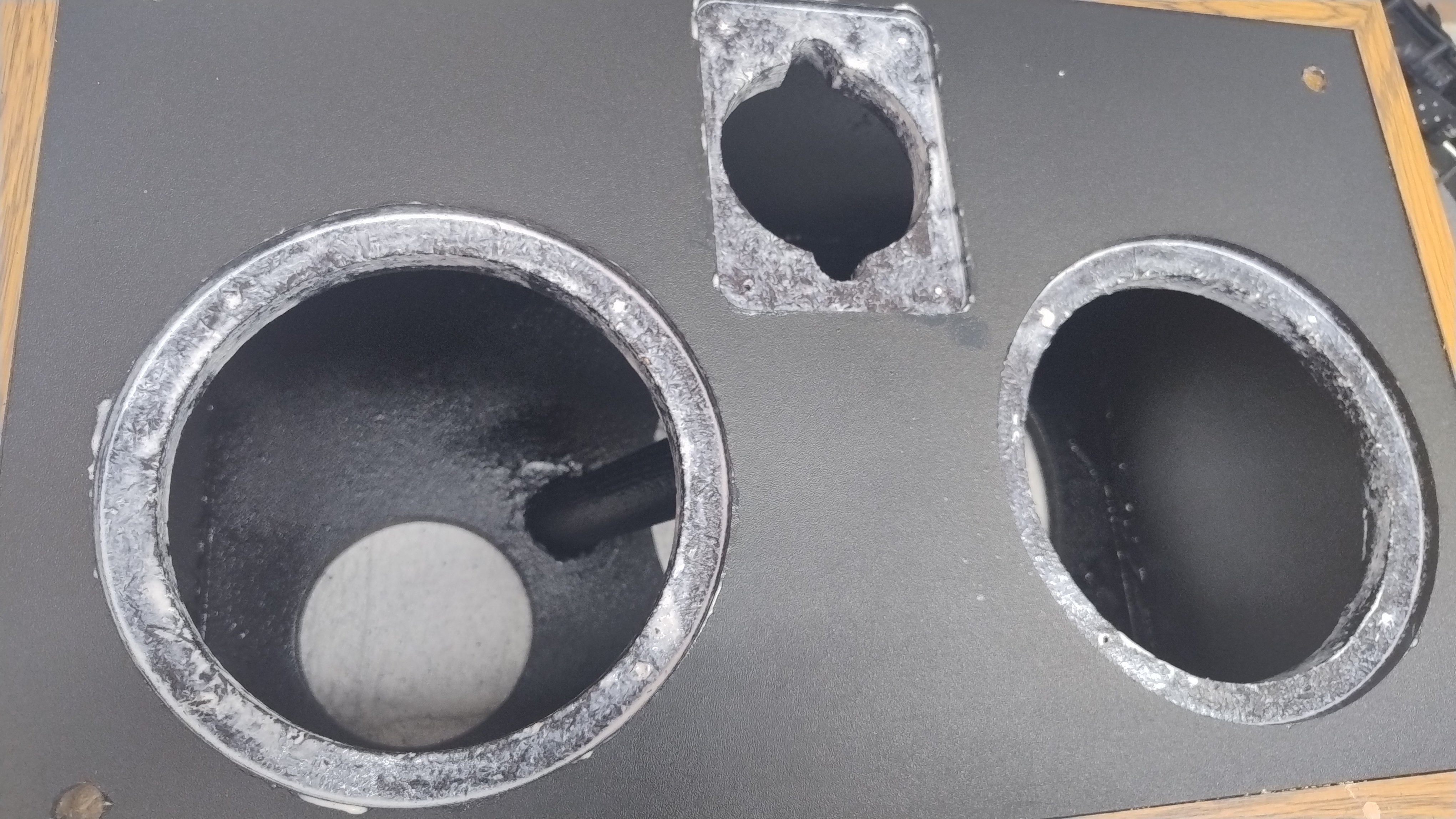

    Had a couple hours to work on them today.

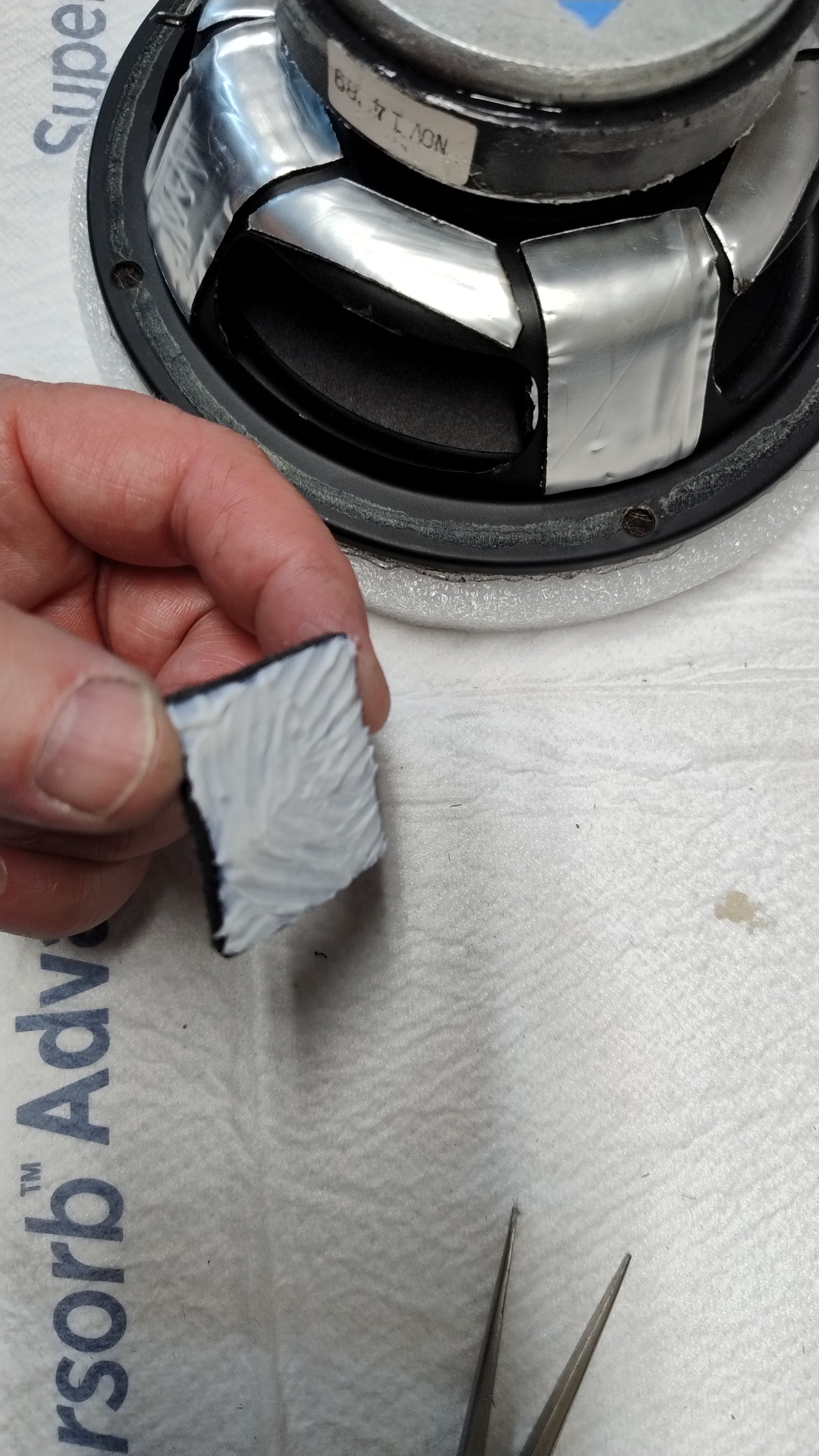

    Love that toasty vinyl smell. The front fascia was slightly peeling up around the drivers. Front baffle was actually congruent around perimeter although inset about 1/16". Filled seams with Gorilla Glue and driver recesses to aid in gasket sealing. Will shoot interior with rubberized paint.
    I'll leave the rear fascia on until after I take an aggressive grit belt sander to rear edges....

    I must say, the @VR3 crossovers are amazing in build quality and sound quality and they mounted up great in the bottoms of my CRS+ cabinets. I used some 10/32 tapered head bolts with Aileen’s to seal from the outside and neoprene washers between the standoffs and the crossovers’ substrates to isolate and seal the cabinets further. Everything is cinched together and secured with nylock nuts. They’ll never vibrate loose and they’re airtight. I used the same method for mounting the inductors. The screw heads ARE visible, but they’re on the bottoms and backs of the cabinets…. So, you don’t see them unless you go looking. 🤷🏻‍♂️

    I flipped the crossover orientation after initial mockups to place the inductors as far away from the voicecoils as I could.

    edited May 9
    We need a BADASS button B)

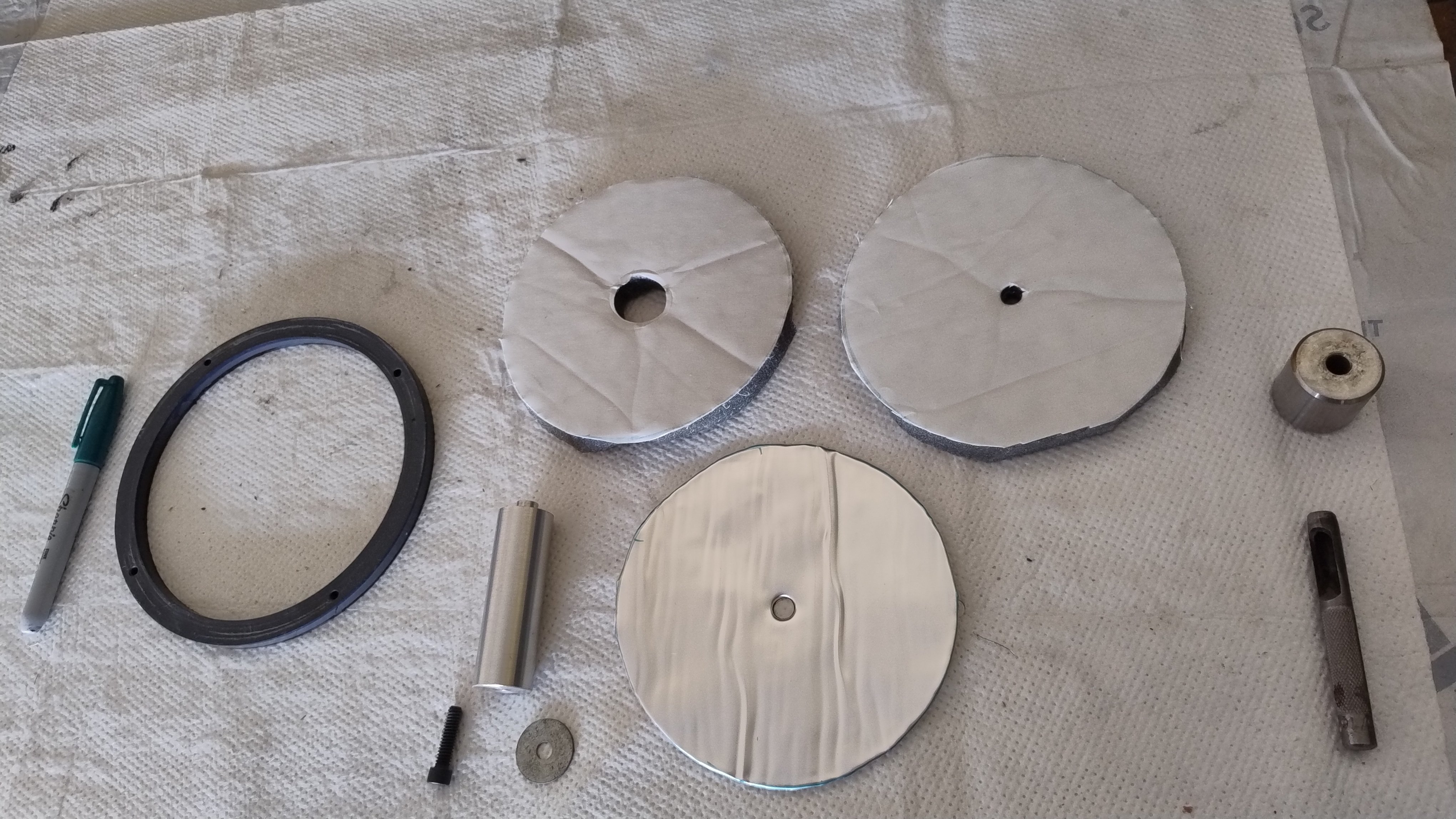

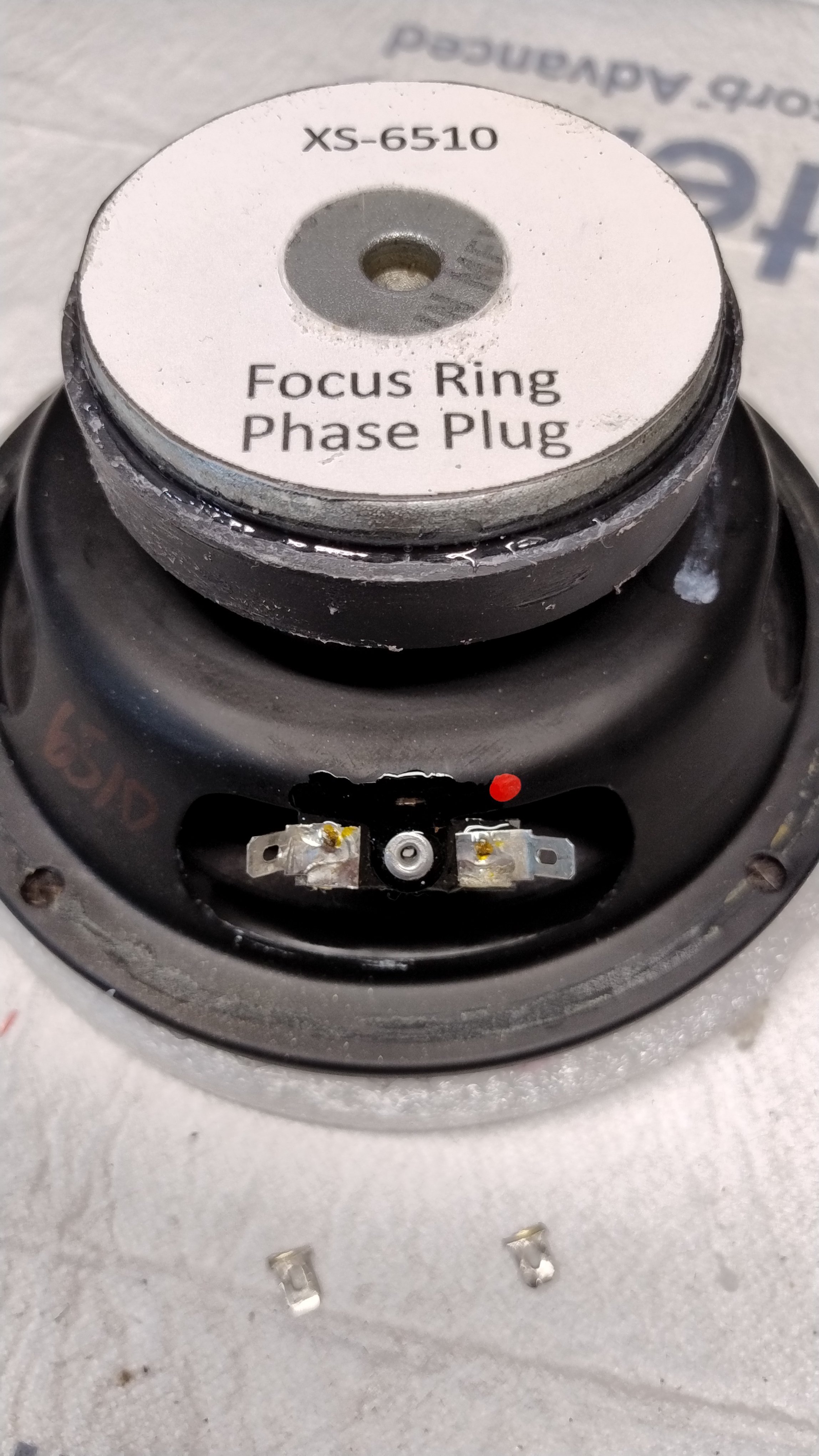

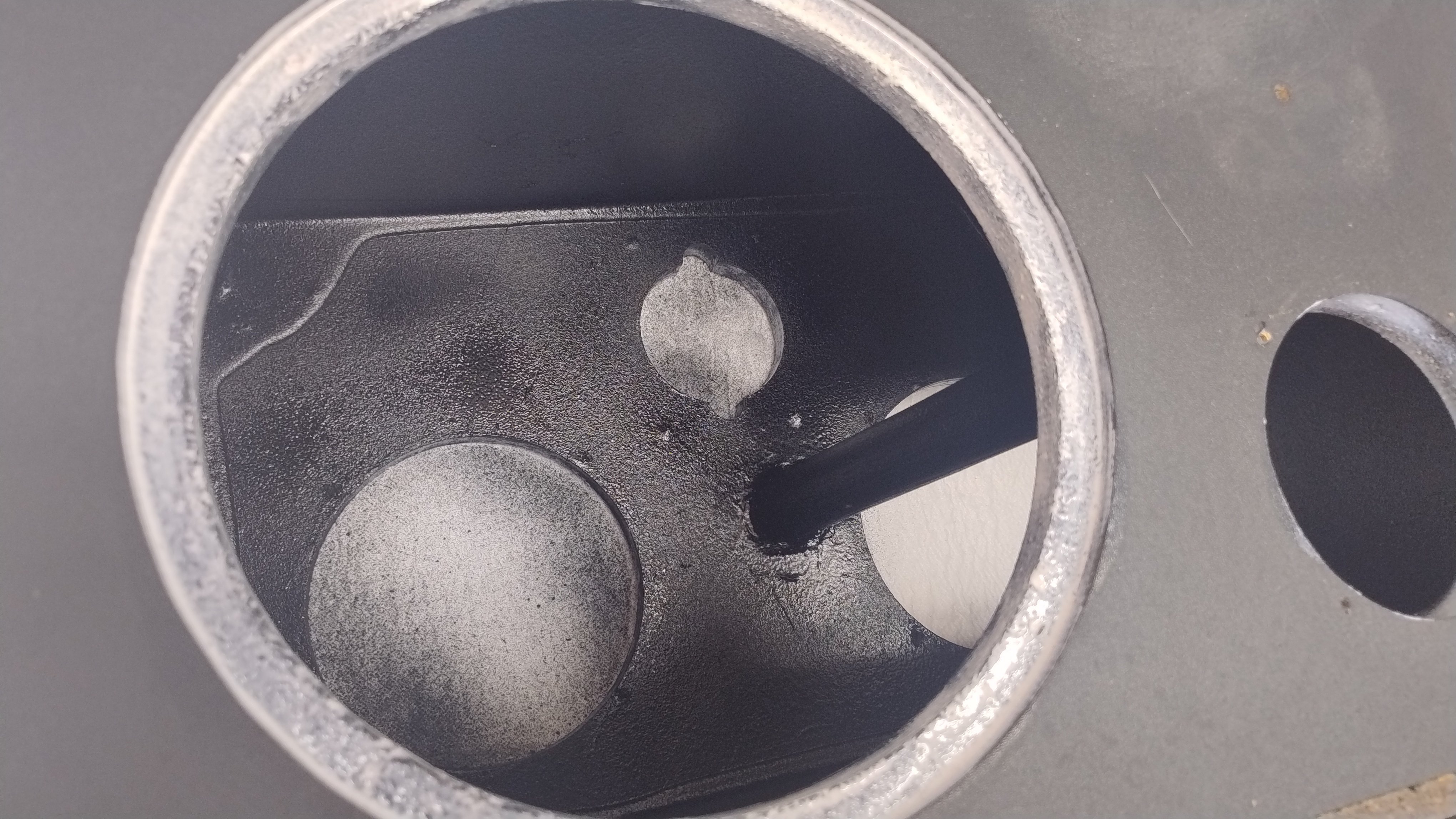

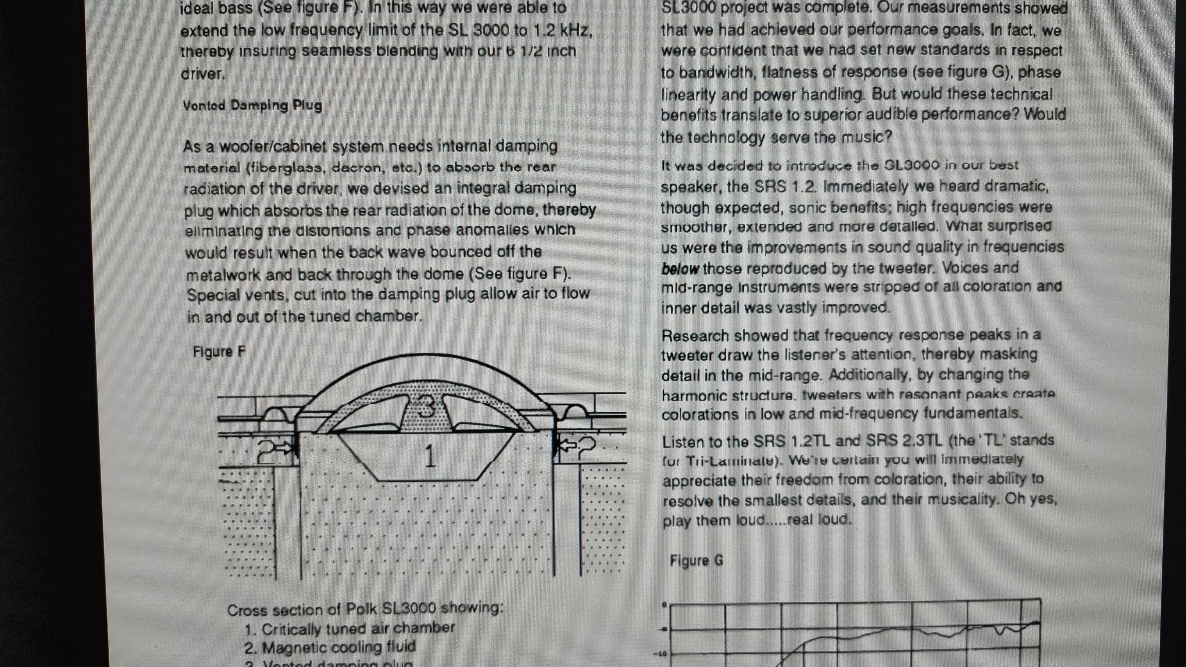

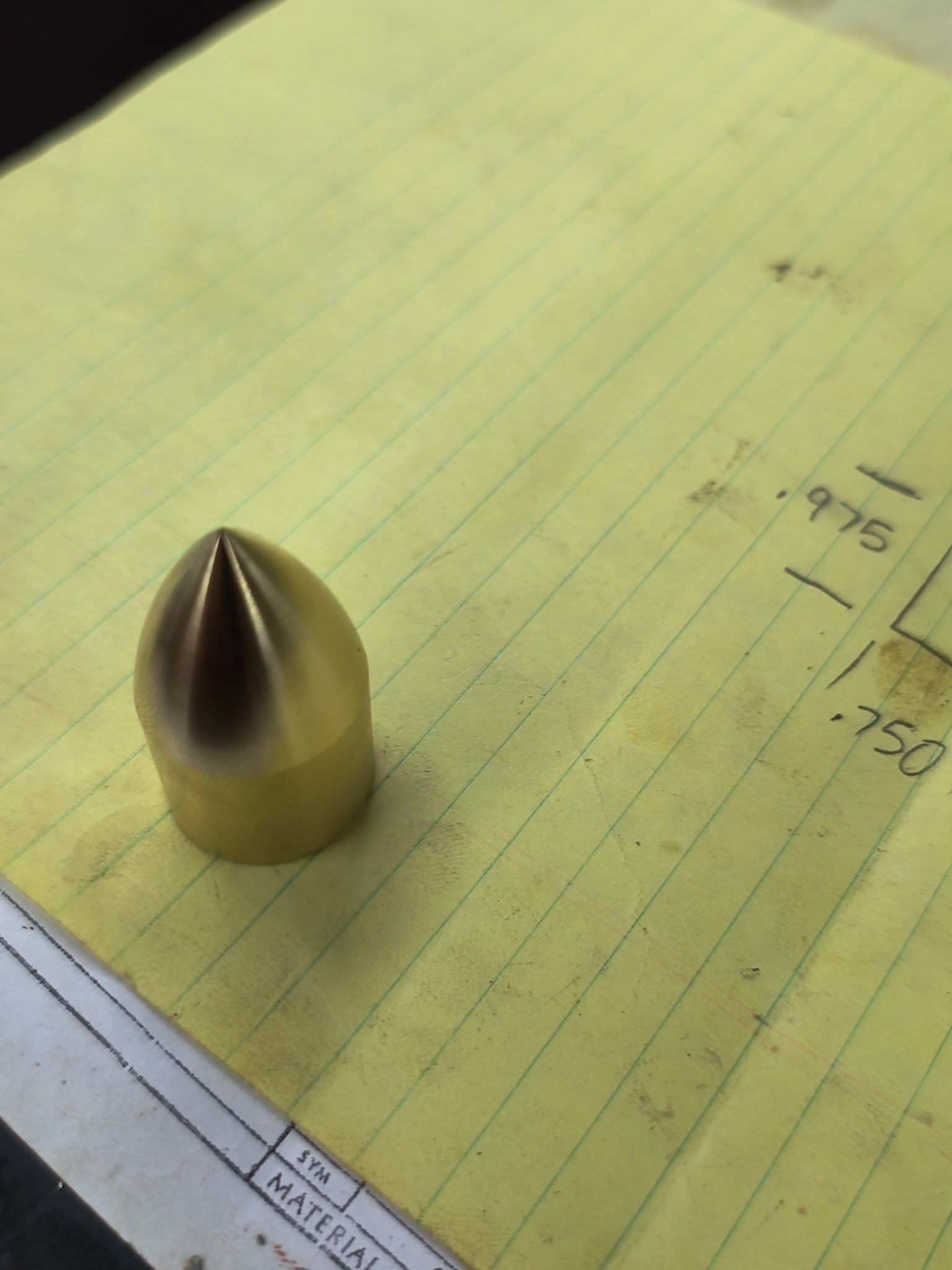

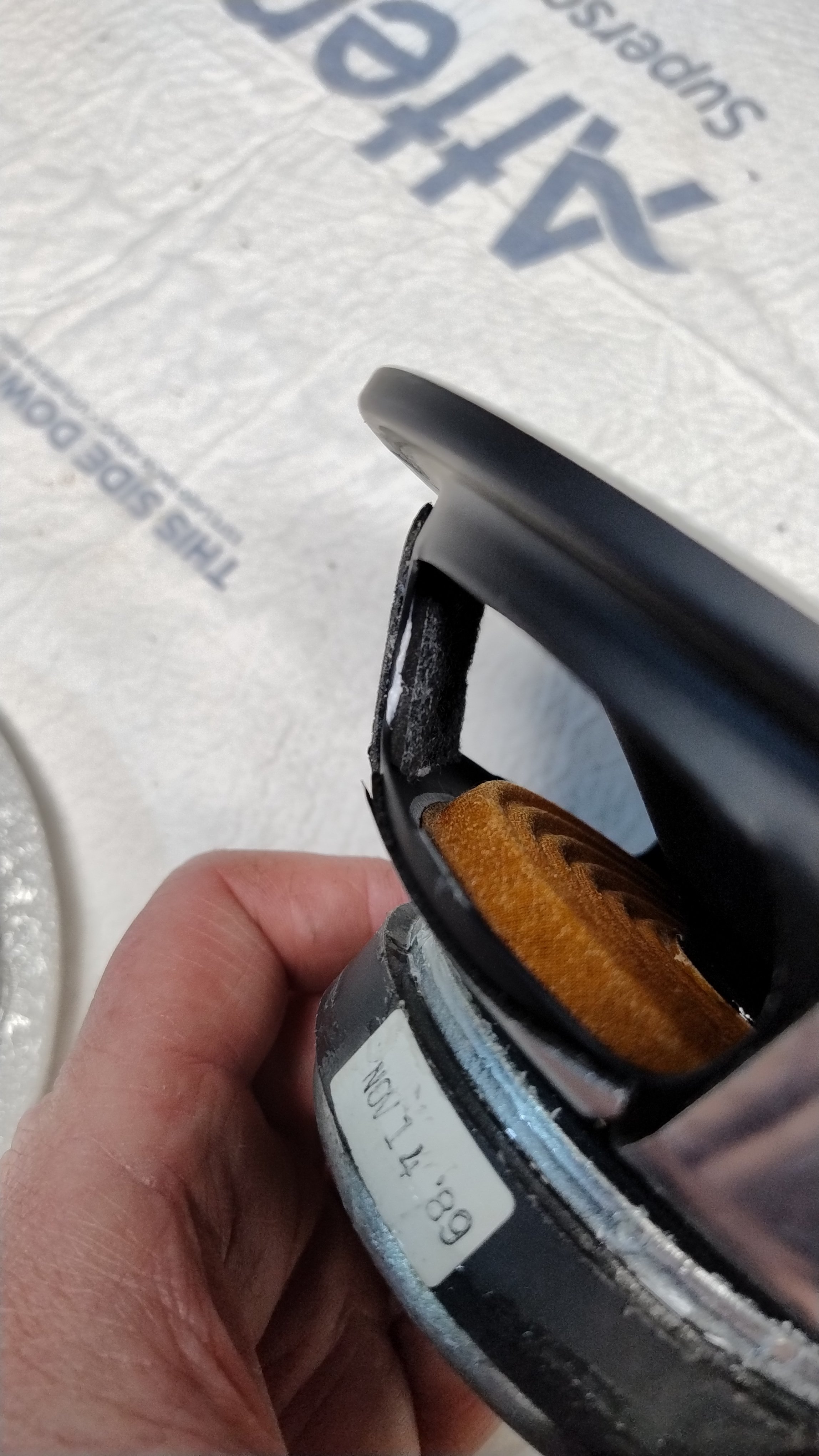

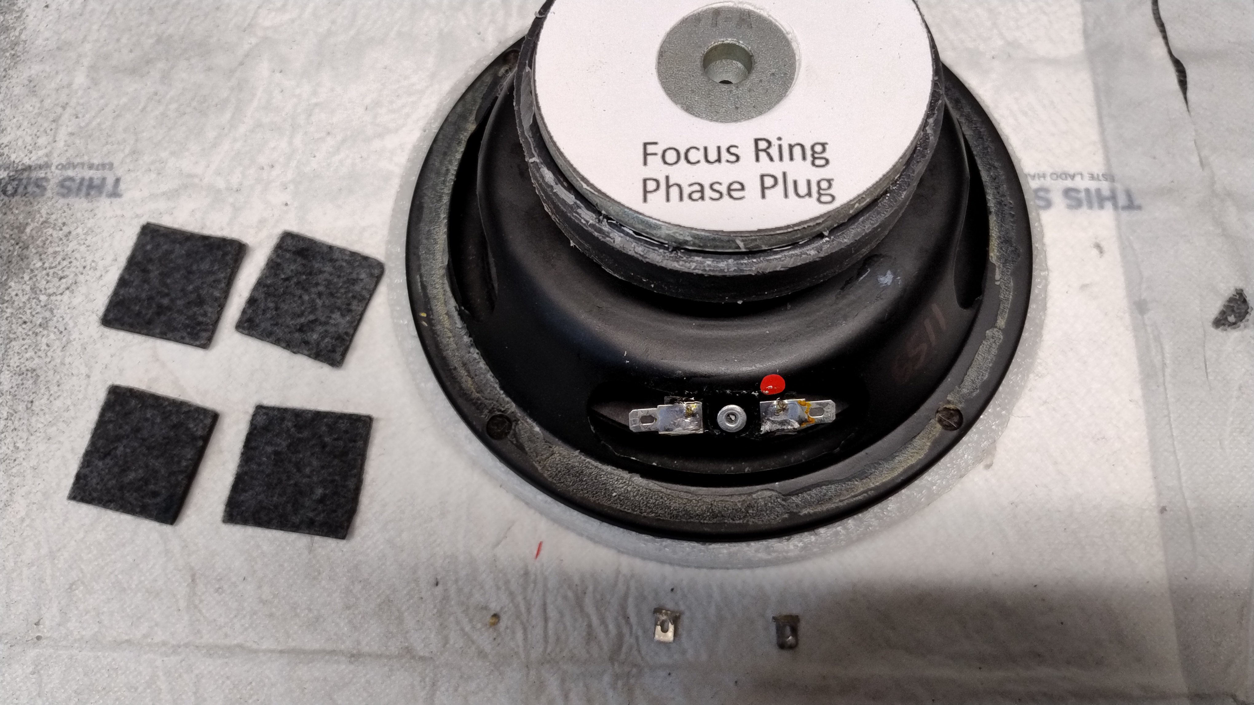

    I will be doing every mod to date on these drivers. Think I will err on side of caution and add focus rings to all the MWs instead of electroplating their pole pieces with copper. I'll test run an electroplated MW6502 soon and see if it exhibits the same behavior as the focus rings.
    I will also drill the MW pole pieces of 6510s and 6511's for an 1/8" punch to quickly try a different/shorter phase plug shape if I hear any anomoly.
    The 198s are already done, focus rings and back-chambered. Will make brass bezels soon too...
    Mesmerizing detail having just tested out in the XS-8TLs.
    These drivers in this set are actually not as worn as many I have come across, so I'm hopeful.
    I can also say that bone-stock, the factory inner curvature of the grill frames do help them "disappear" better.

    xschop Posts: 5,811
    edited May 10

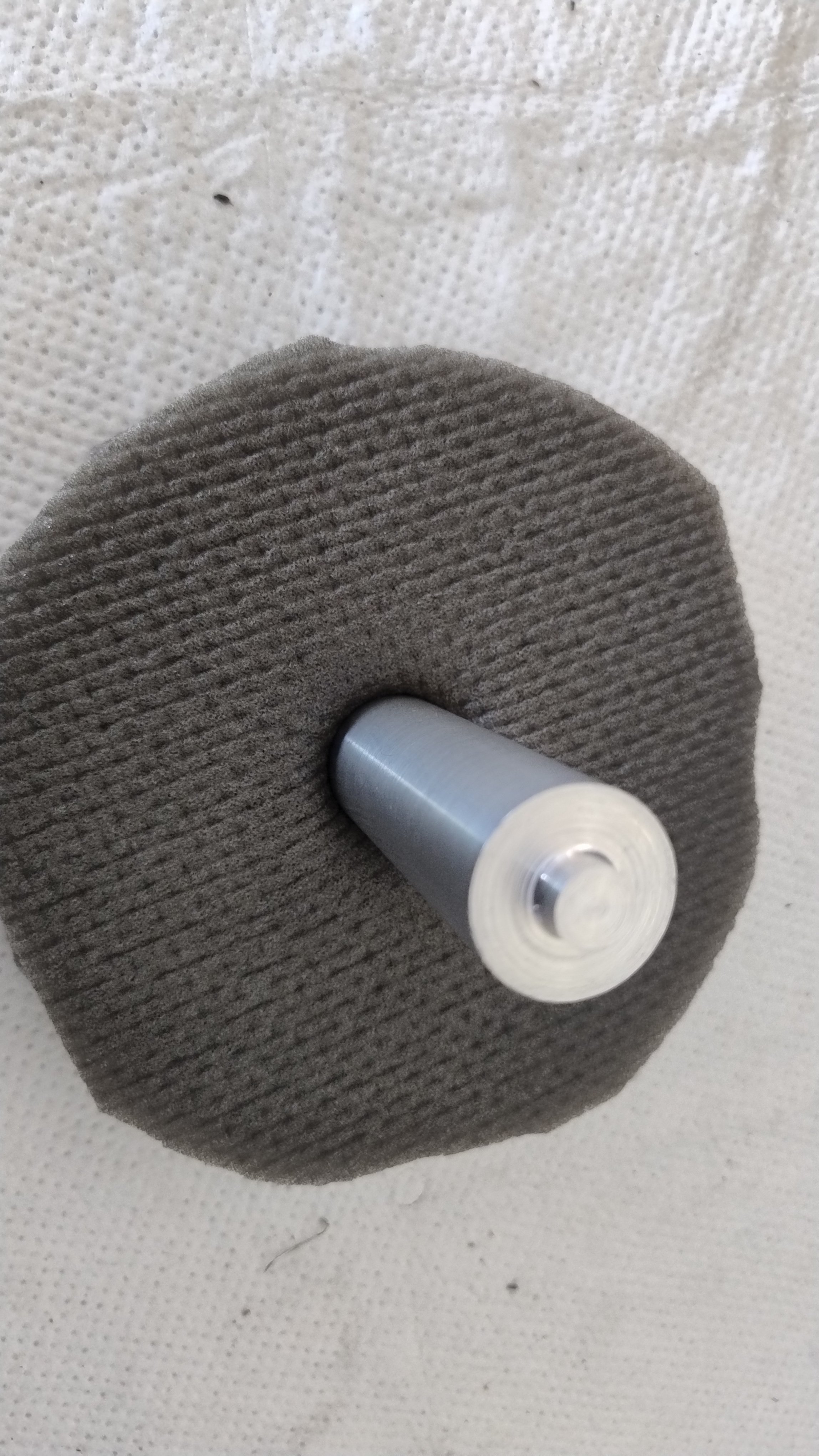

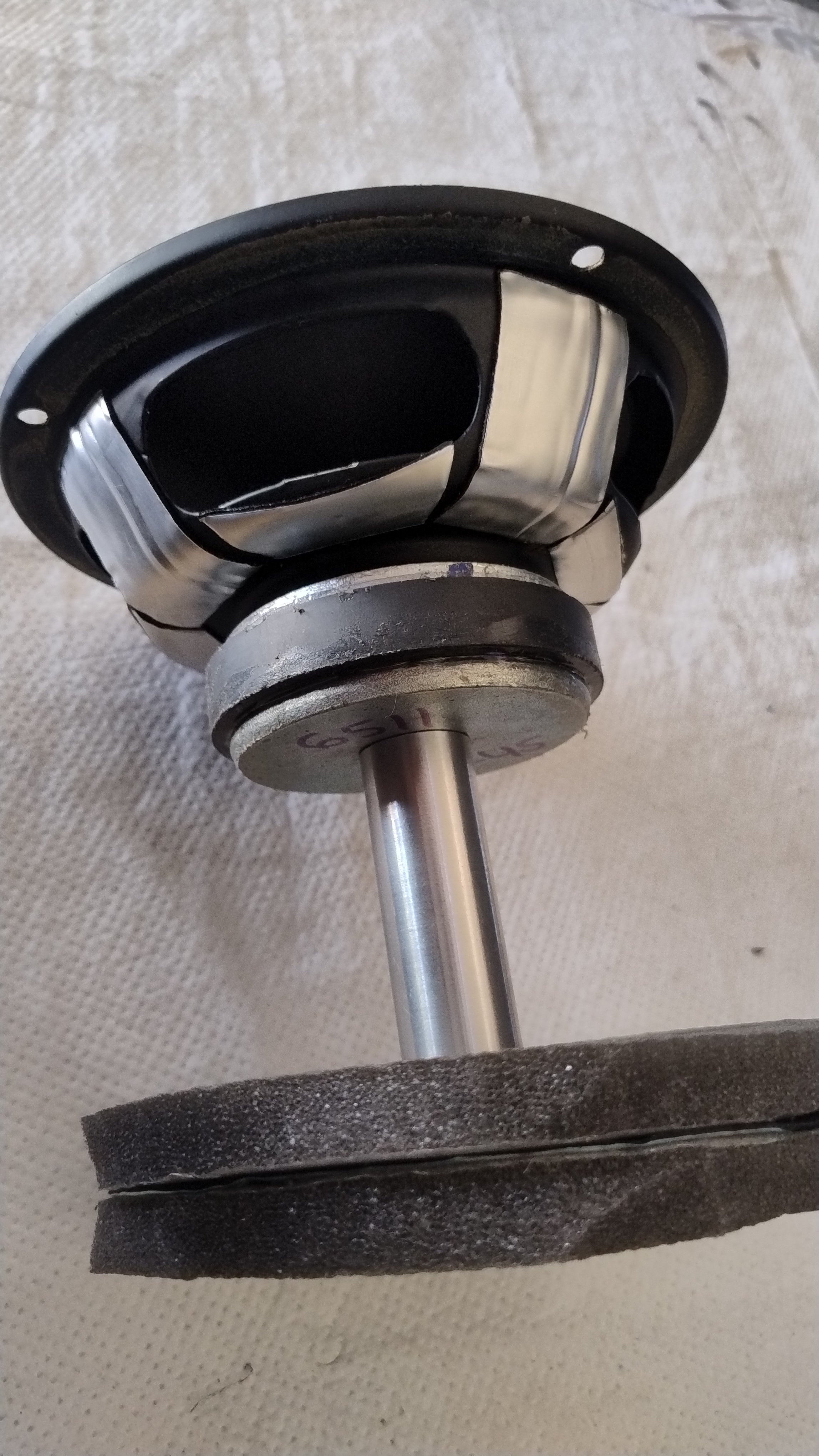

    With the Power Grab set, I'm able to pick up the enclosure by the dowel and it's taken up minimum cab volume....

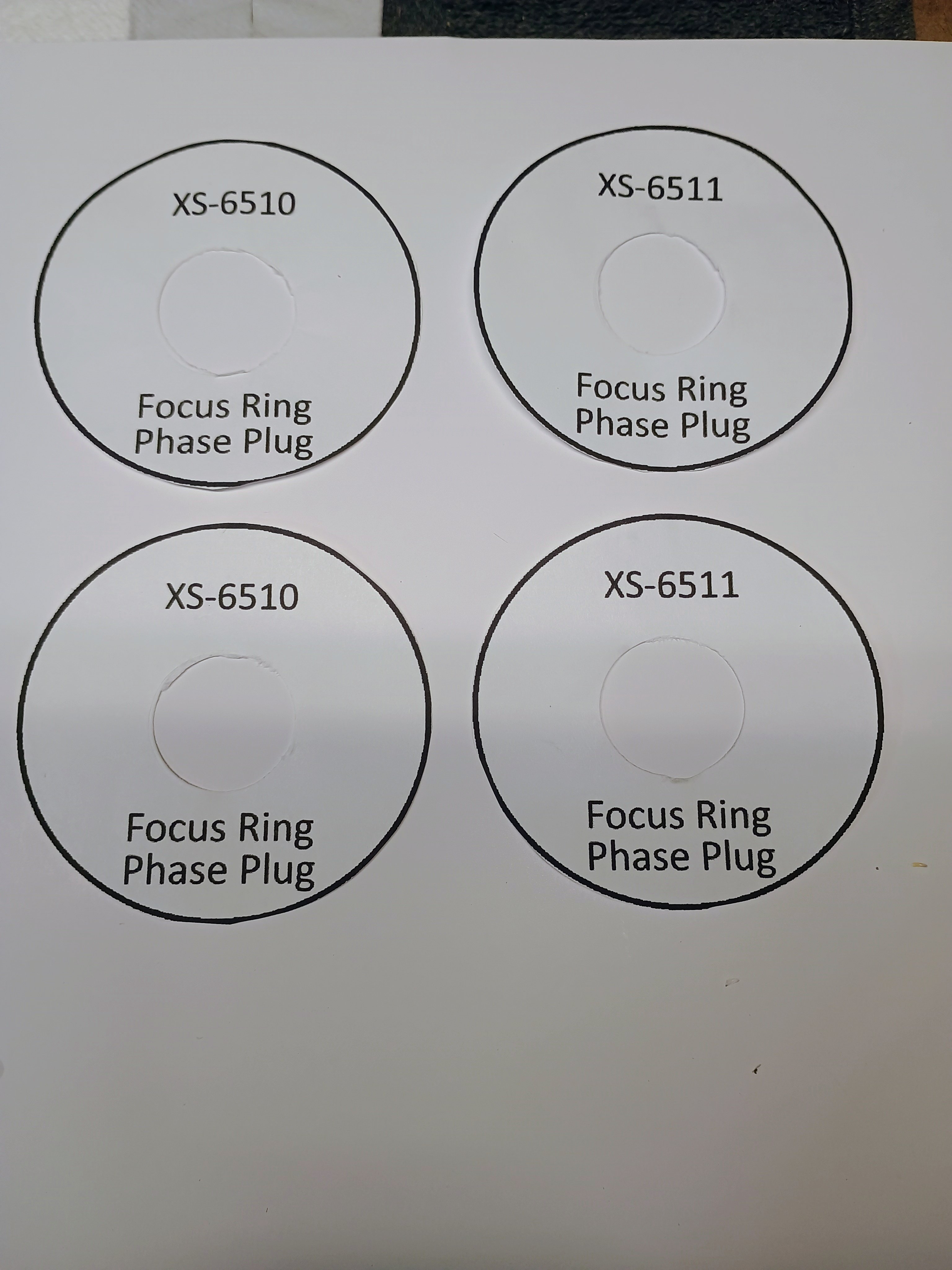

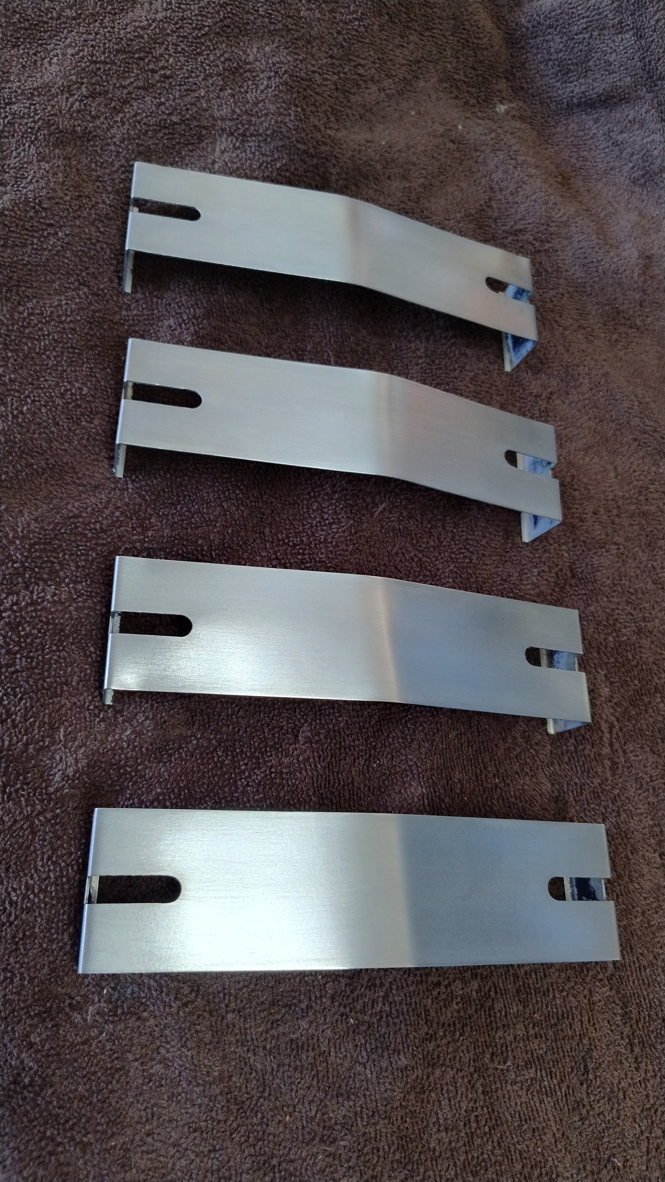

    Revising previous CRS+ Driver mod....
    4ea needed.....

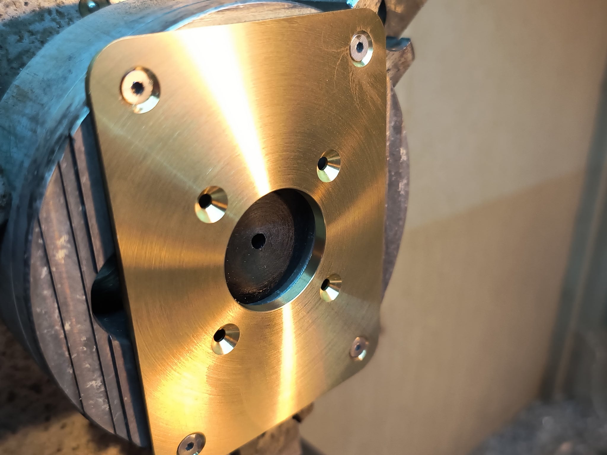

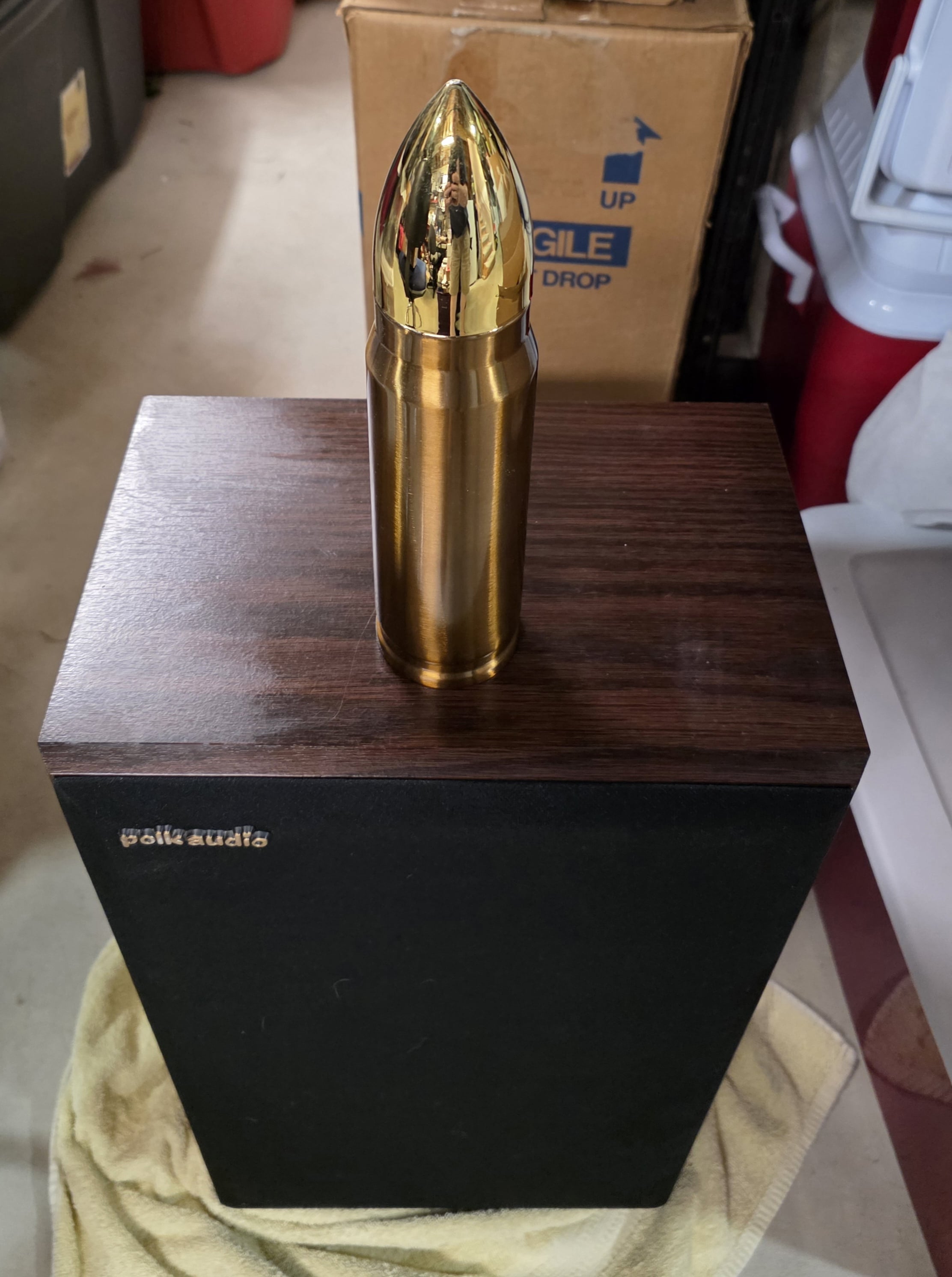

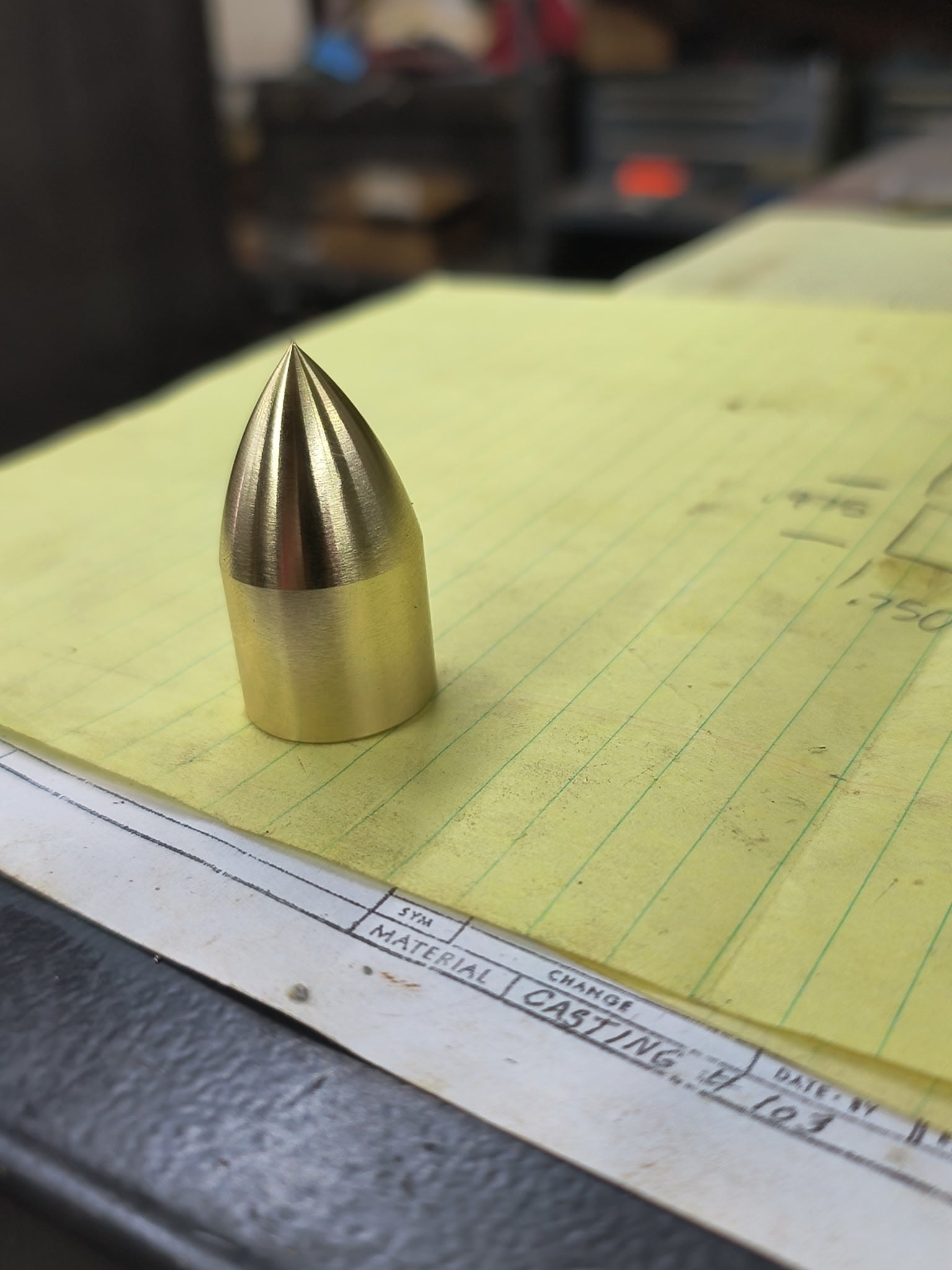

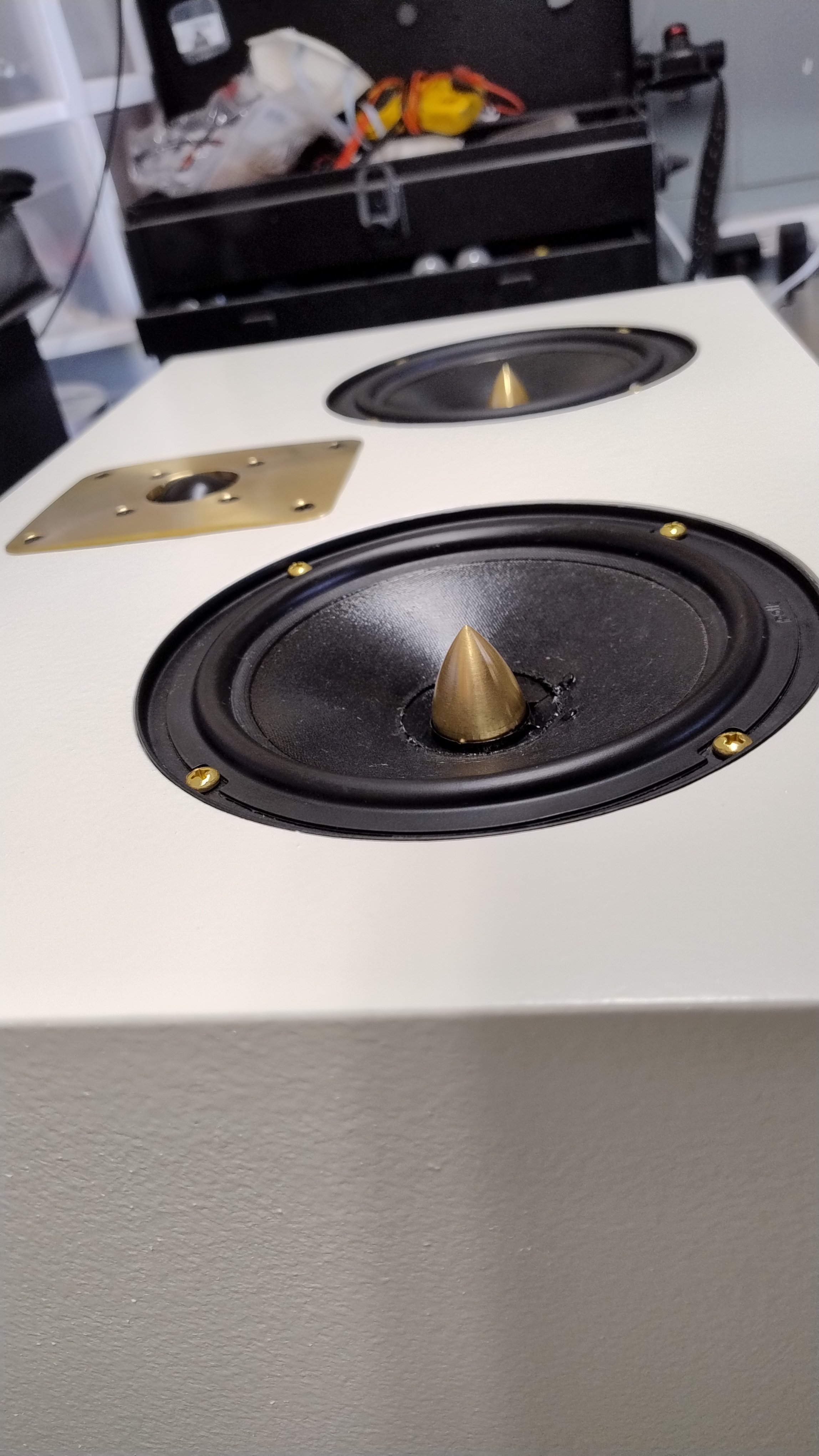

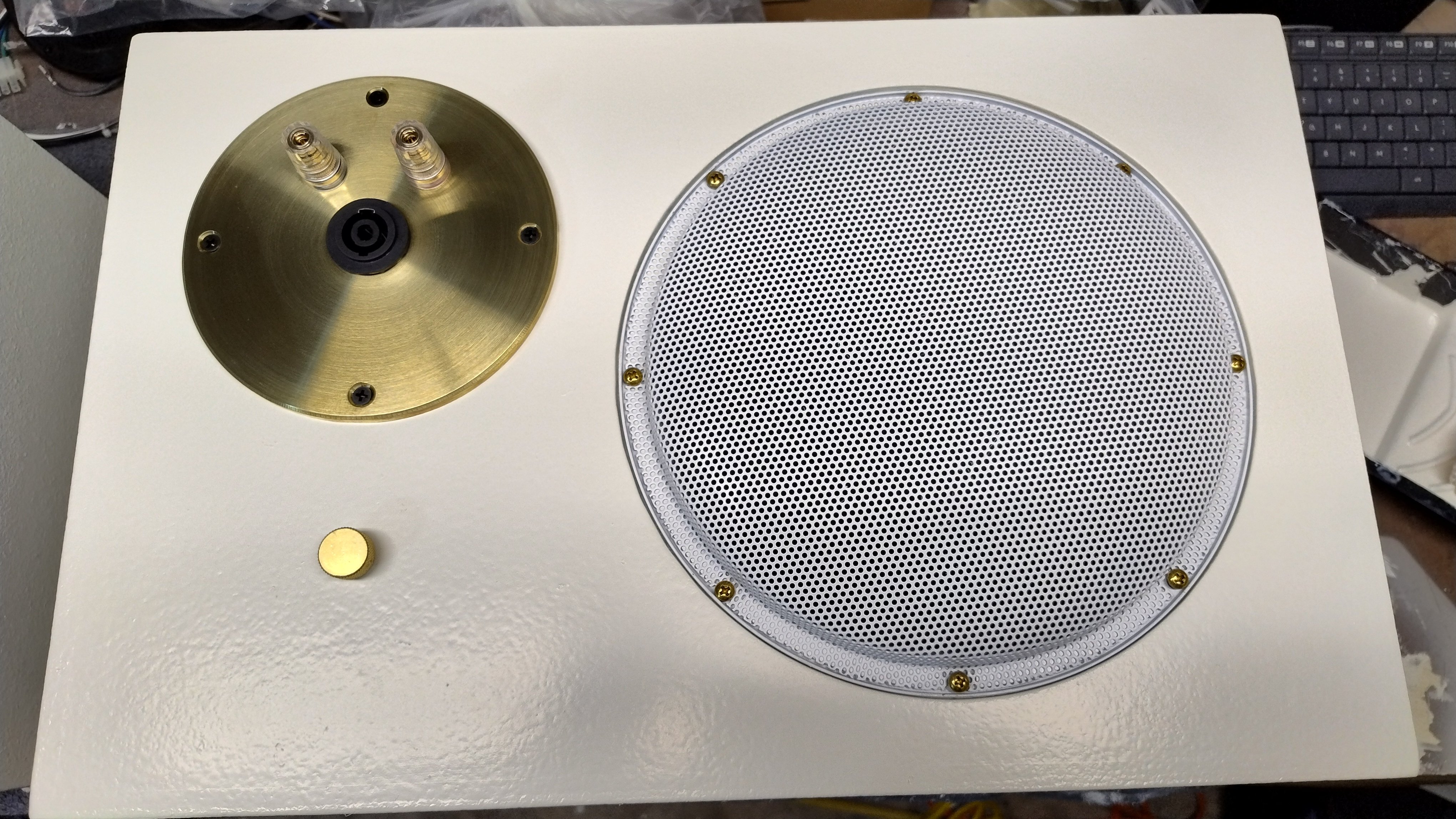

    Collecting more solid brass parts...
    Grill pins will be machined to dia. 0.430 full 0.9" length and glued to factory locations with 0.45" showing.

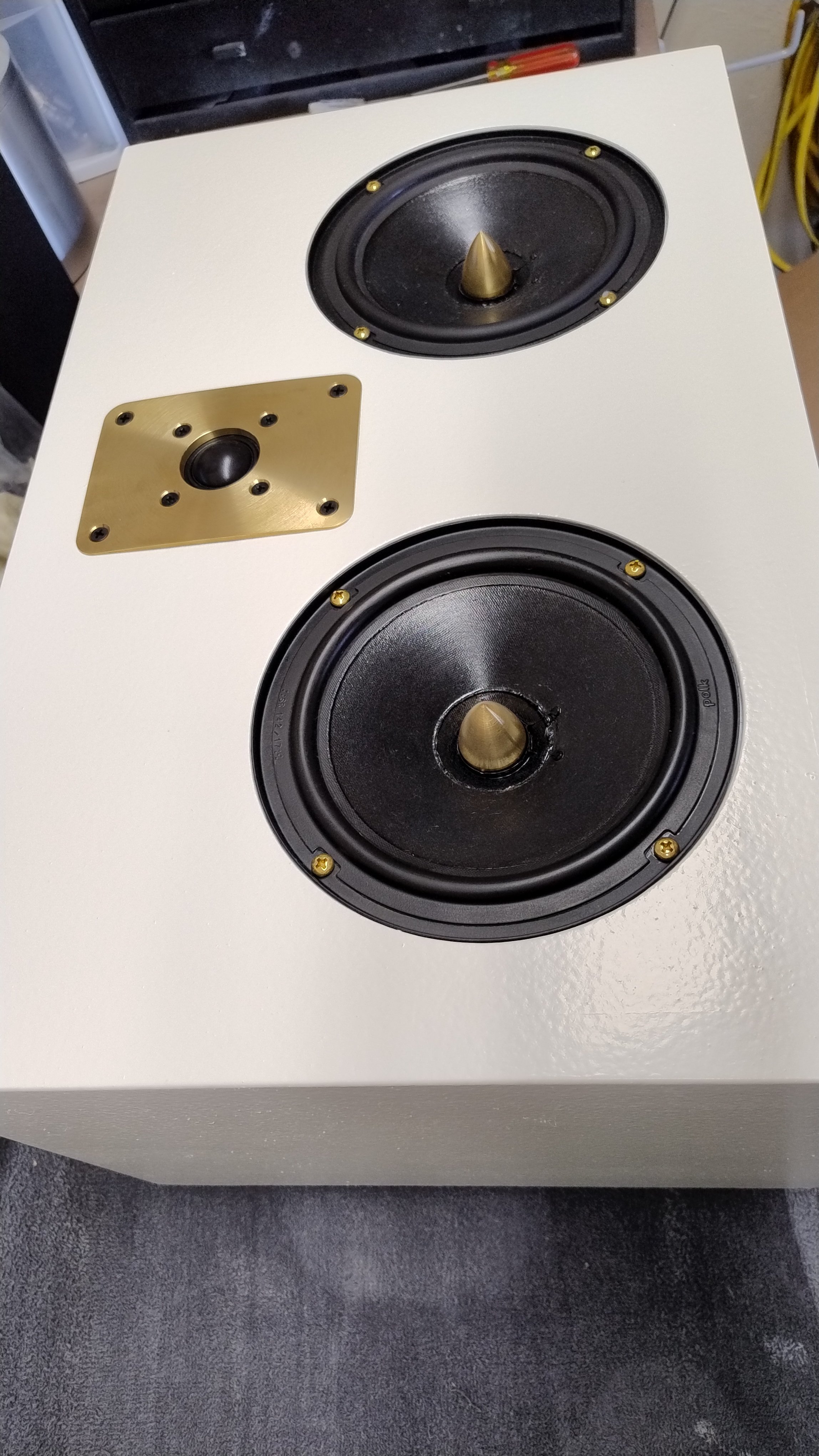

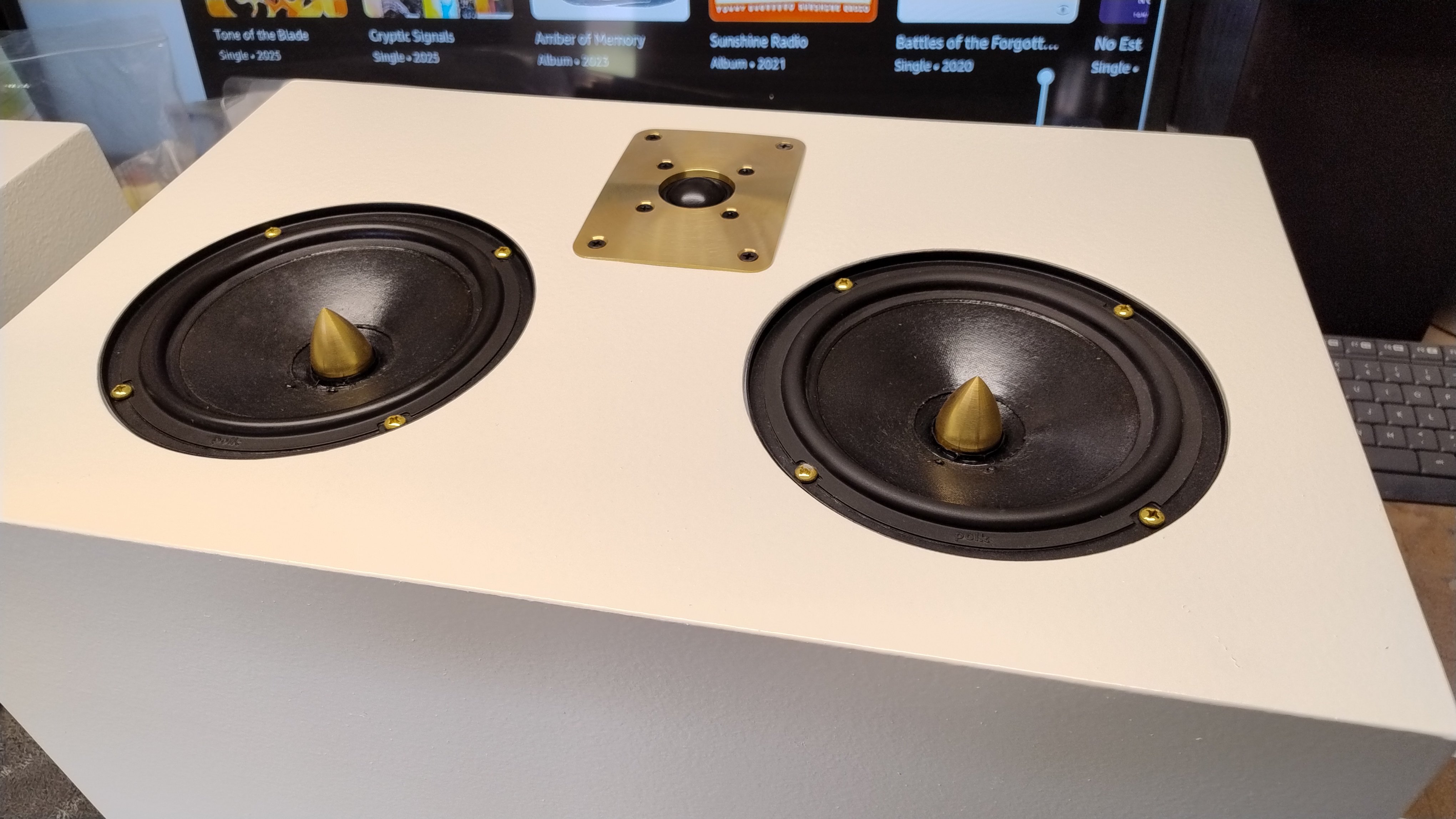

    xschop Posts: 5,811
    xschop Posts: 5,811

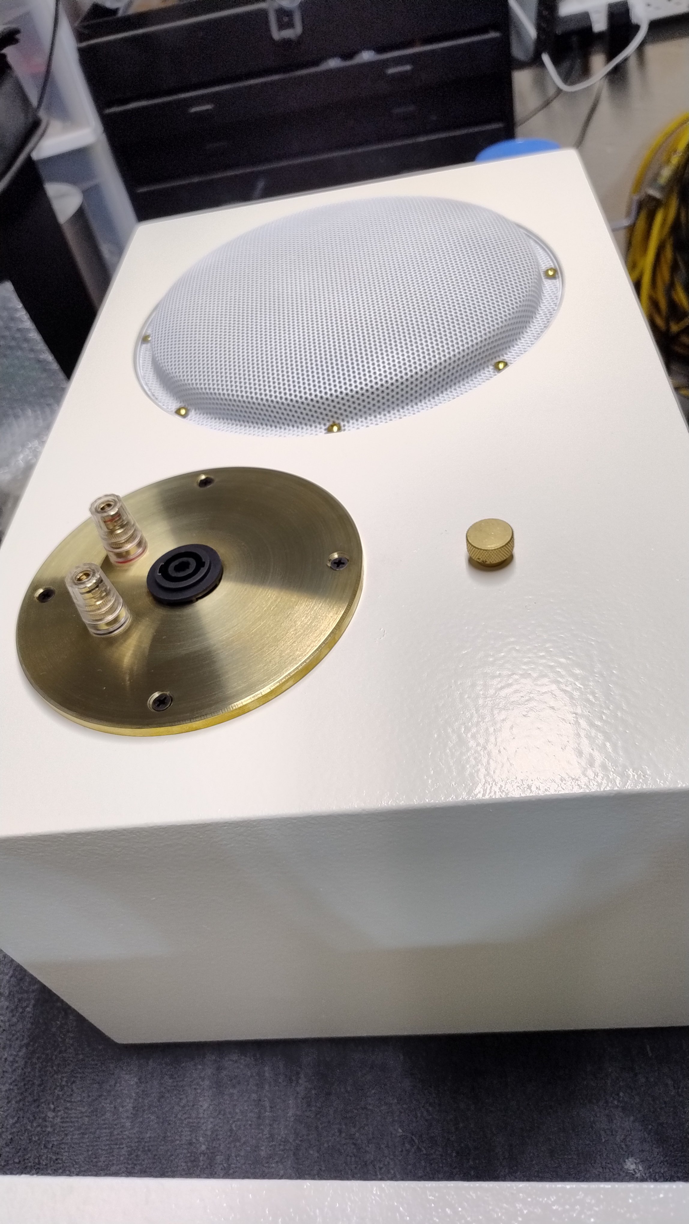

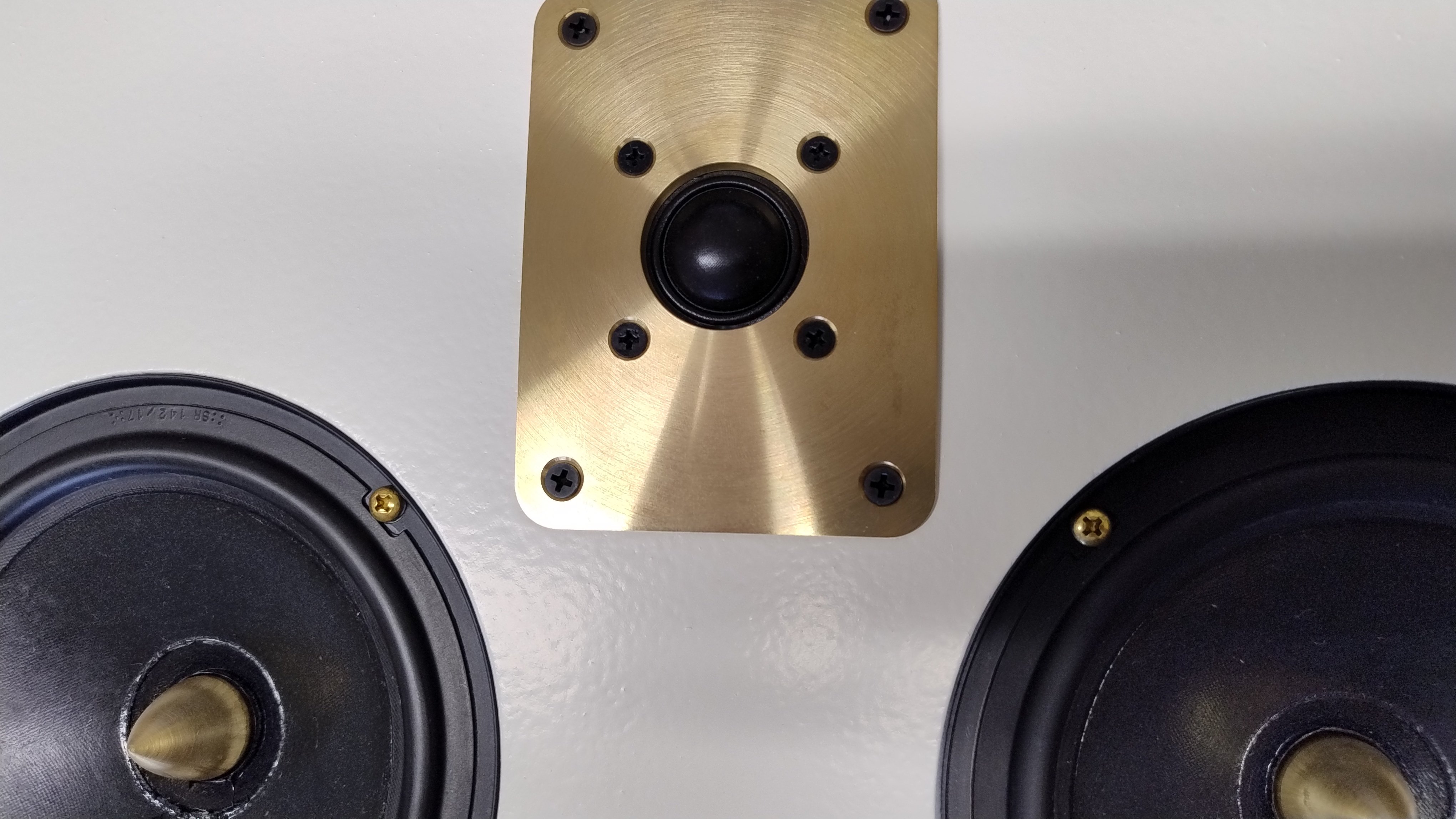

    Think I've settled on the final aesthetic.
    Matte brass drivers with antique white cabinets along with black oxide and matte brass fasteners for contrast...
    Flat white is a second option, but satin white is too much...
