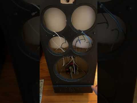

I know what I want to do, and I trust the owner about the condition of the speakers, so I don't even bother testing them before I get started on the tear-down.
It'll be easier to clean the cabinets and all the drivers once they're out.
I decide to find a way to put the 1c and my Monitor 12 Series 2 on wheels. That will have to make it easier to swap them out with each other for A/B listening. And, surely, wheels will act like spikes to a degree, yes?
Oh, and the empty boxes weigh a solid 50 pounds. Empty, the things weight almost as much as my Monitors. BEAST!

With the drivers and crossovers out, I can work to put everything in its place for cleaning, upgrading, and modding.
I can see the cabinets are in good shape underneath the grime, which is GREAT.
- The passive radiators need rotated. I did the same thing with all the speakers/radiators in my Monitors. You can see where 30 years of gravity pulled the cones towards the ground. No biggie. Just something everyone should consider.
- The dust caps are in sad shape. Only means I have incentive to try out the phase plug mod. I wonder if I could 3D print them, if I can't score some of the metal ones a guru here made...
- Tweeter domes are crinkled, like slightly crumpled paper. Planned to replace tweeters with RD0194 versions anyway. No one had any! Found an excellent thread on upgrading the SL2000! Decide to try the Wuhan mod to replace the domes on the SL2000 with some silk ones. Parts on order from China. Likely take 4 weeks to arrive.
Did you know there are 2 different kinds of faceplates on the SL2000? I didn't... So, after some schooling from forum gurus, I found out mine are the easier to mod versions! Woot!
And some came with a hard dome behind the tweeter dome, but others came with felt. Consensus is, take off the dome bits and replace with felt.

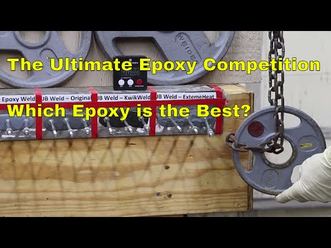

    @lawdogg stated his testing he came to the conclusion that Gorilla glue epoxy held stronger than JB weld and Power grab adhesive.
    Maybe he'll see this and chime in. I've not used the GG epoxy but he (@lawdogg) in a thread stated a two part epoxy was stronger than both PG and JB and he used Gorilla Glue in the same sentence.

    Will not hurt to do it again flat on a table to double check, then glue.
    I think the 2-part epoxy I used in the drop test was from Harbor Freight. I use whatever is on the shelf at the hardware store.
    Analysis of adhesives is fun but at the end of the day - no need to overthink it.

  • Epoxy vid = Interesting!
    OG JB Weld or Devcon from that test.
    I wonder if torsionally pliable is better for this application over torsional rigidity?
    Engineers?
    It would be interesting if he had tested something like West Systems G-flex with a filler like colloidal silica. I think that would have beaten all of them, at least with the Impact Test, because of its flexibility.
    One important thing if you want to be *anal* about all this is that the pole pieces are steel but they are probably zinc chromate plated steel and also ferrite may not be the ideal bonding surface either unless it is ground roughly. Not really a good bonding surface at all. Peel strength over time is the key and especially if there will be repeated thermal cycles if it isn't stored in a climate controlled situation. If you wanted to take the time to grind it a little with a dremel wheel it would probably hold up over the coming decades a bit better. Especially important if you are going to live to 100 or so :) Slow cure is the way to go. Never 5 minute 😒 and you have plenty of time, especially if you are living to 100.....

    What else?
    Outside of these suggestions, what's left?
    I know I can:
    - Replace the binding posts
    - Replace the wires inside (how much and is it worth it?)
    - Make a new interconnect cable (but I don't know how much that will cost...)
    - Make my own Dreadnaught modification (but that's like $500, right? I might have to put that on a wishlist)
    What else is there?
    What did I miss?
    What say you?

    You're going to royally screw up those speakers. For example, Dynamat on the inside of the cabinet wall is the wrong thing to do. But hey, if you don't want to listen to those of us with 10...20 years of experience inside and out with vintage Polk speakers knock yourself out. Just don't say you weren't told what not to do.

    You have certainly compiled a list of everything that you could possibly do to these speakers. I would suggest you get them back together to determine what is needed. Replacing the gaskets and other tasks you list are generally considered "as necessary" rather than required.
    Glue the magnets
    dynamat the baskets
    refresh the crossovers
    do what you will with the tweeters
    Then see where you are with the sound. You may have some cash left over that would be better spent elsewhere. If you are anything like me, there is 0% chance you will spend a grand on these 1C's and sit back thinking "well, that's done, no need to spend more on the stereo." I'm sure you already know this deep down.

    F1 is right, don't waste your time and $ on Dyna/butyl matting the inside of enclosures.
    Do Dyna/butyl mat the SL2000 tweeter bezel, making sure no alum foil backing touches the Wuhan leads when done.
    Do add retinoic acid/retinol in a small sheen to the domes via q-tip after a long break-in.
    Do perform Gardenstater's inner basket frame foam mod (you just need to do the uprights).
    Do install MW backer rings, mine or make your own. Those baffles would definitely see the benefit.
    Do Dyna/butyl mat the MW and passive frames.
    Do use Blackhole 5 behind MWs on back wall. Many recommendations here.
    Do have fun and experiment, then share your results, it's a hobby after all.
    I can highly recommended saving some more inflationary dollars using this in lieu of Dyna mat...

    Navy_Goat wrote: »
    Yeah. I tried to scour for every tweak someone made that had at least some others who also tried it and liked it. Some of them have REALLY in-depth work that was done testing. Some are anecdotal. Some are proven tech used in other speakers.
    I'm not dismissing anyone's experience. I'm counting on it!
    [smiles]
    I certainly hope I don't mess them up!
    I want a master list for anyone thinking about modding/repairing the 1c. And I want the pros and cons!
    A lot of those proposed tweaks address quality and tech issues. And will absolutely change something about the character of the speakers.
    I don't think these speakers were designed to have active enclosures like the Mission clamshells I fixed up a few years ago, Is it the excitation of the air that is key to the passive radiators, or reflected and off-timed waves bouncing around the plywood (grid in the back, flat elsewhere), crossovers, wires, and baskets, that's important?
    I know exactly the audible, subjective effect on the Monitors. Mechanically, they are almost identical in concept. So, I'll go ahead and Dynamat the interiors and see how they sound. It's not hard to take it back out if I make a mistake on that one. Maybe the design of the SDA passive takes into account the flaws of a resonant bass chamber/cabinet more than the Monitor passive does? We'll find out!
    Oh, in case anyone thought otherwise, I did not remove the polyfill from the Monitors. I also did not Dynamat in the upper chamber where the polyfill was.

    Your truncated list is absolutely fair and reasonable. Add Dynamatting the enclosures, and those tweaks/fixes what I think I should concentrate on.
    Then it's phase plugs and maybe wool on the front (I have ideas about that on an SDA I'd like to experiment with), for fun.
    And you are 100% correct. Even without much fun money in the bank, I have thrifty-audio'd upgrades every chance I had for a very long time =)
    I had to scrape and scrounge to upgrade the Monitors over 10'ish years. Since I have some play room on the 1c, I'm going to dive into the deep end. AND! It's also a project my oldest is going to help with! She'll be a senior next year, so it's a very meaningful project for me.
    Then I'll finish building my transformable omni/uni directional homebrews...

    For the third time
    DO NOT LINE THE WALLS OF THE ENCLOSURE WITH ANY TYPE OF DYNAMAT.
    This is not something you do!
    A few pieces of Blackhole 5 or sonibarrier behind the active woofers only. If you get carried away with BH5 or sonibarrier it will seriously be counter productive.
    One of our members did line their cabinets with a LOT of BH5 and it sucked the life right of them. They had to remove it it was that bad.

    Didn't see anything about installing hurricane nuts and machine screws in place of wood screws into the baffles. The more you are in and out of the cabinets, the more important this becomes.
    I think you need to also make sure all the cabinet seams are well-sealed.
    If you need to replace driver gaskets, Armacell is good stuff.
    Regarding your question about a new SDA interconnect, think about building the cable yourself with whatever speaker wire you'd like (match your speaker cables, ideally), and terminate it with Neutrik SpeakOns. You'll need to install the female Neutriks in the cup housing the binding posts. Good time to think about replacing the posts, too, and someone here used to make beautiful plates pre-drilled for all of this. Knowing how to install the SpeakOns will come in handy if/when you get to assembling a Dreadnaught.
    I think removing Dynamat from the inside of the cabinets will be much harder than you anticipate. If you insist on experimenting with more dampening than recommended above by xchop, consider SonicBarrier (sp?) - relatively inexpensive, easy to cut into pieces, install, and remove.
    Just based on my limited experience with some CRS+ TLs. Good luck!

    Help me out, guys. Let's talk it out so I can get a better picture.
    I'm taking what I know of recording booths and applying it to cabinet interiors, so I come at this from a different place.
    I use Dynamat-like materials to reduce the resonance, the actual vibration of an enclosure due to less-than-optimal design. That resonance is not what is present in the original excitation of the air from a mouth to a mic.
    I use sound-absorbing foam materials to actually absorb sound, or trap it, or diminish its reflections, so those off-timed echoes do not influence the excitation of the air from a mouth to the mic. The distance between the mic and mouth, and the size of the room and the amount of air excited to carry the vibration between the two, affects the tone. You can have an over damped volume of air. I think, based on what I'm hearing, is a different affect from a different process (foam vs. dynamat).
    Dynamat-like materials have a minor damping effect, because rubber reflects sound less effectively than the dense internal ply or mdf of a speaker cabinet. But, that absorption of reflected sound is minor compared to a foam product. Dynamat helps prevent the absorption, excitation, and reflection of sound energy from the interior of the cabinet, to its structure, and back to the air inside the enclosure. And, it helps keep outside vibrations from penetrating as strongly through the cabinet to the inside (which is why it works so great at keeping road noise out of your car).
    Absolutely, a foam-based sound-absorbing material will have a deadening effect on the air itself within an enclosure, but the Dynamat material has a different function.
    O.k., help me translate this to speaker enclosure interiors from your perspectives! Everyone else's turn =)
    OH!
    I don't want to make this thread all about this one mod, so if anyone has other thoughts, chime in!
    I want it to be a repository so it can be whittled down later to a guide.
