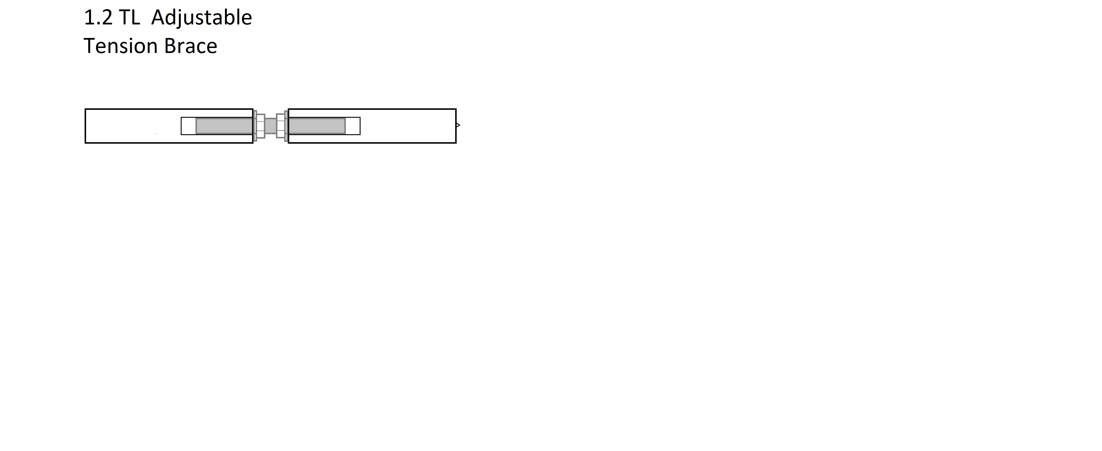

    Updated the design to omit one of the pointed detents. This will let the other end self-align perpendicular while pressure is increased. Will make install a breeze....

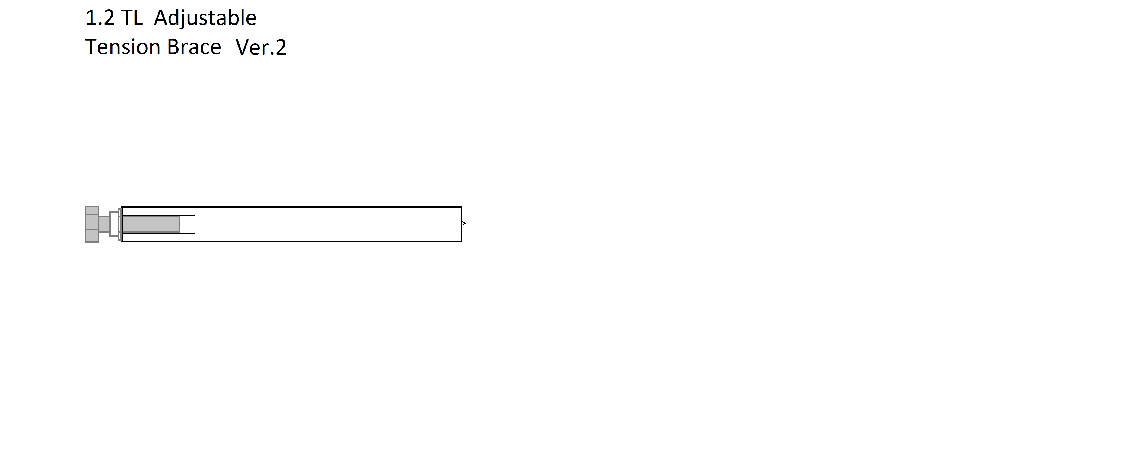

    Hey Sean, version 2 can be accomplished by machining the large bolt head flat. A 9/16-18 bolt head would have same contact area as 1" round dowel....

    Nice work Rob B) . I'll get that measurement soon ,What materials will you use and which glue do you recommend?

    Plan on using 7075 alloy and Grade 8 zinc plated bolts and nyloc nuts with copper anti-sieze.
    you'll just need a 13/16" (21mm for you Blokes) wrench to install after a good dab of Loctite Powergrab or Liquid Nails.
    A spring-loaded punch will make for pinpoint placement accuracy as well.

    Im looking into using 1.25-1.5 Dia. Black Delrin too for damping and resonant characteristics vs. sand filled alloy.

    The point would be pointless as it wouldn't penetrate the particle board under compression. Would be a smudgey affair I'm afraid.
    Think I'll go the extra trouble to butyl wrap the alloy rods just for good measure. B)
