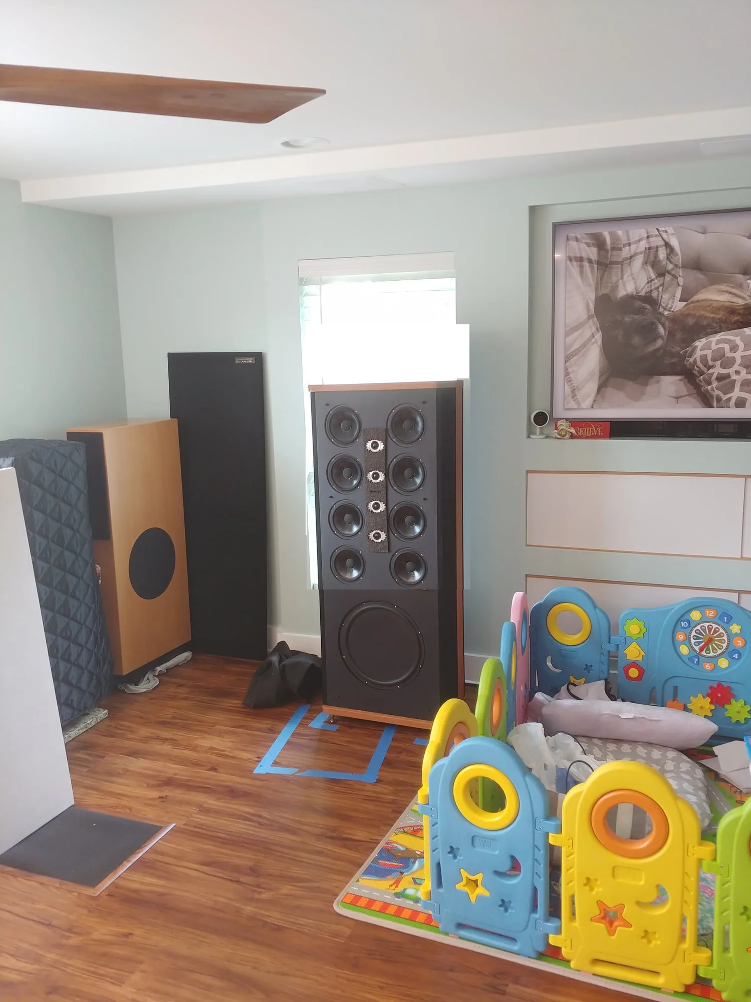

    You can tell when the dad is left with the kids at home and mom is out for the evening.

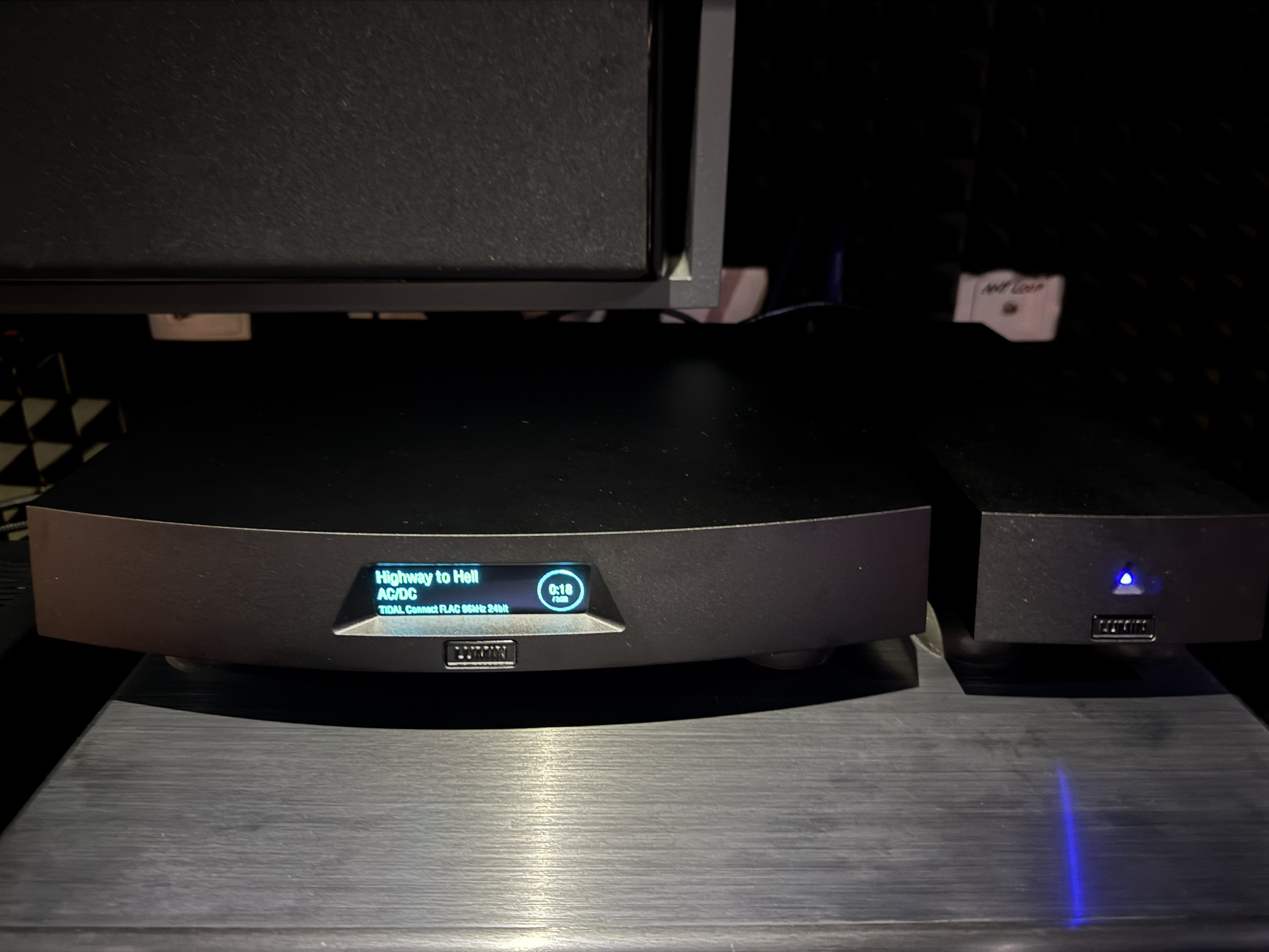

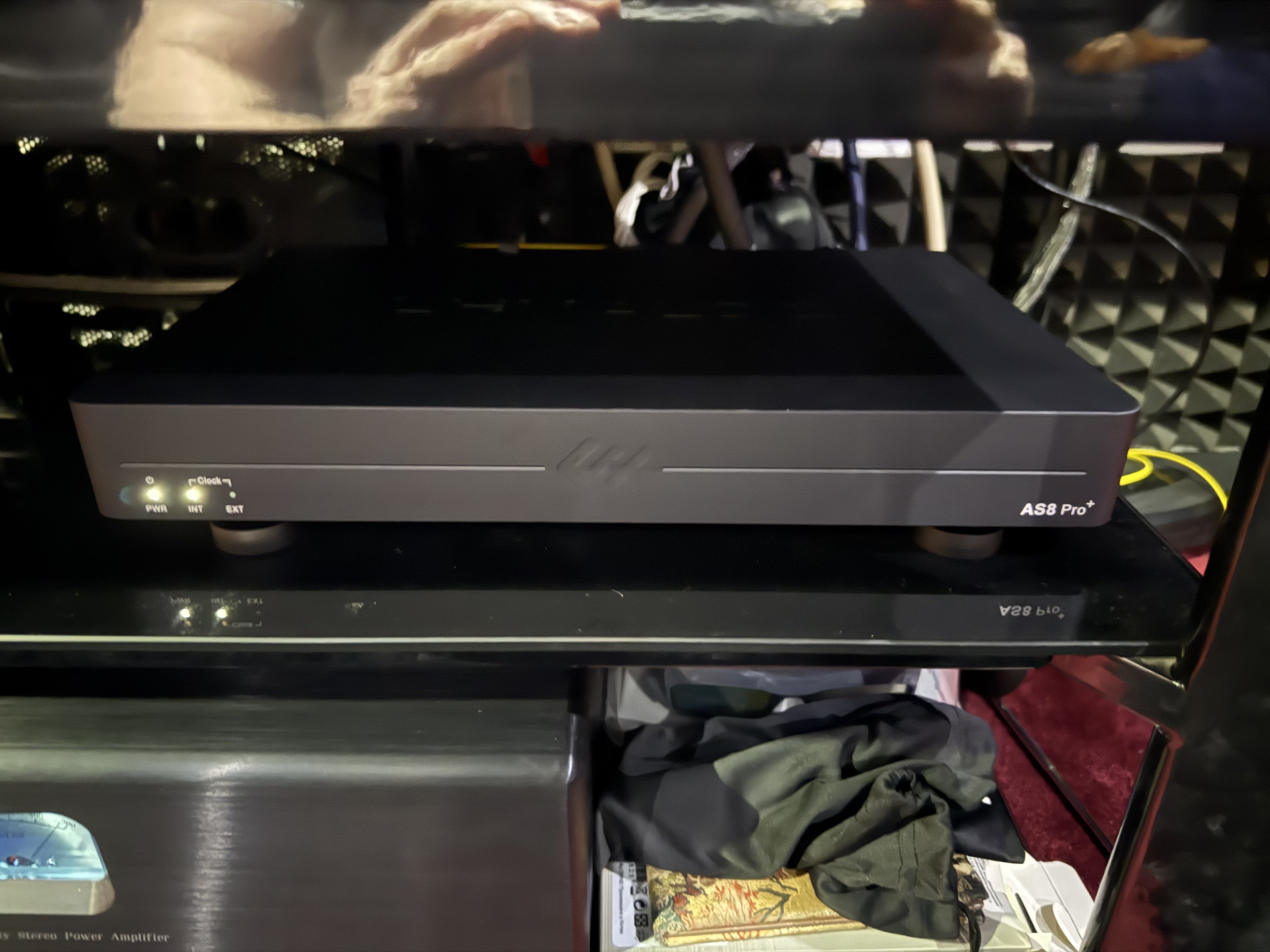

    It’s confirmed. I’m on the
    Lumin u2x and lhyas8 pro +
    Wife: what’s the little box ? That’s the x to the Lumin 2 i answered 😜

    What kind of footers are you using on the Lumin?
  • ptrooper
    ptrooper Posts: 704
    edited August 25
    Just for now , I am using sorbothane as my ocd won’t let me install an unlevelled pair (Lumin and its power supply), I only have 4 Oreo isoacoustic feet. I’m happy I don’t suffer ocd from writing , I find that’s more cbf for me.
    The three shelf glass television rack has 3 layers of extreme dynomat topped with dynaliner.
    I know the Sunfire theatre sig is supporting the Lumin but it’s not used or on in stereo mode.
    When I buy the dac in the near future,the theatre setup will be phased out and the stereo begins..
    It’s done 40 hours burn-in and the difference between the u2 and u2x is to say that ,they are nowhere near the same ball park❤️
    The Lhy and Lumin are heavily mechanically dampening and are also sfp connected so won’t suffer from vibes between them . I do believe they also don’t need a clock cable, correct me if I’m wrong.
    Kiss theory

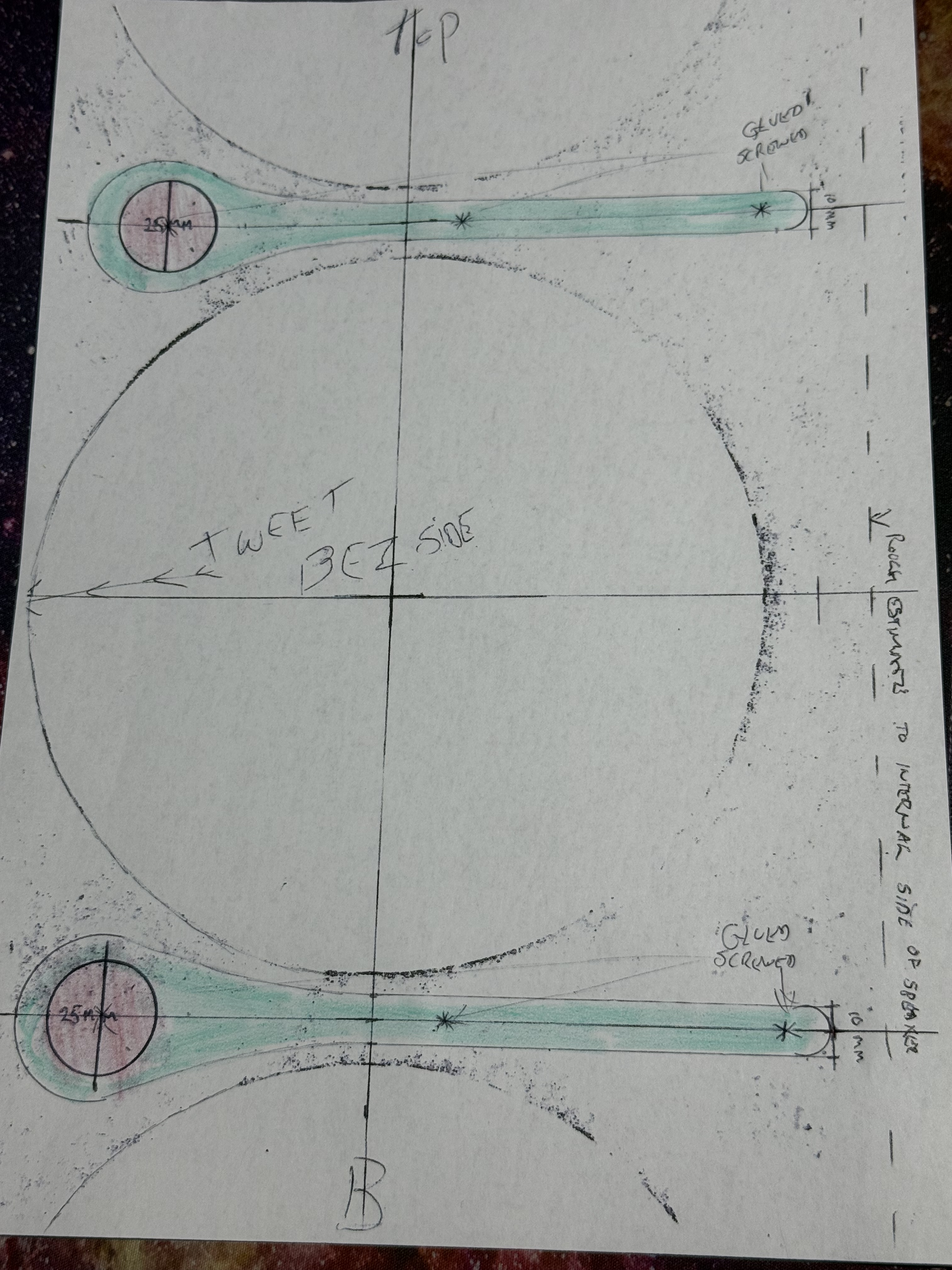

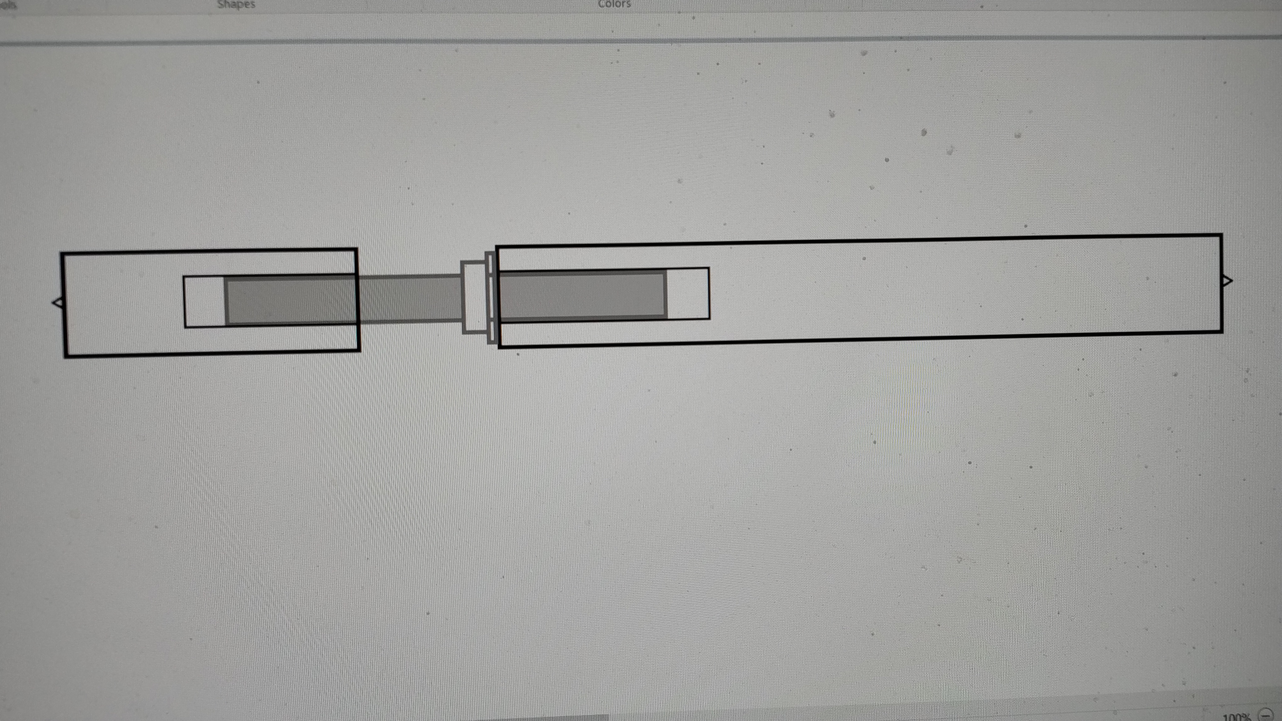

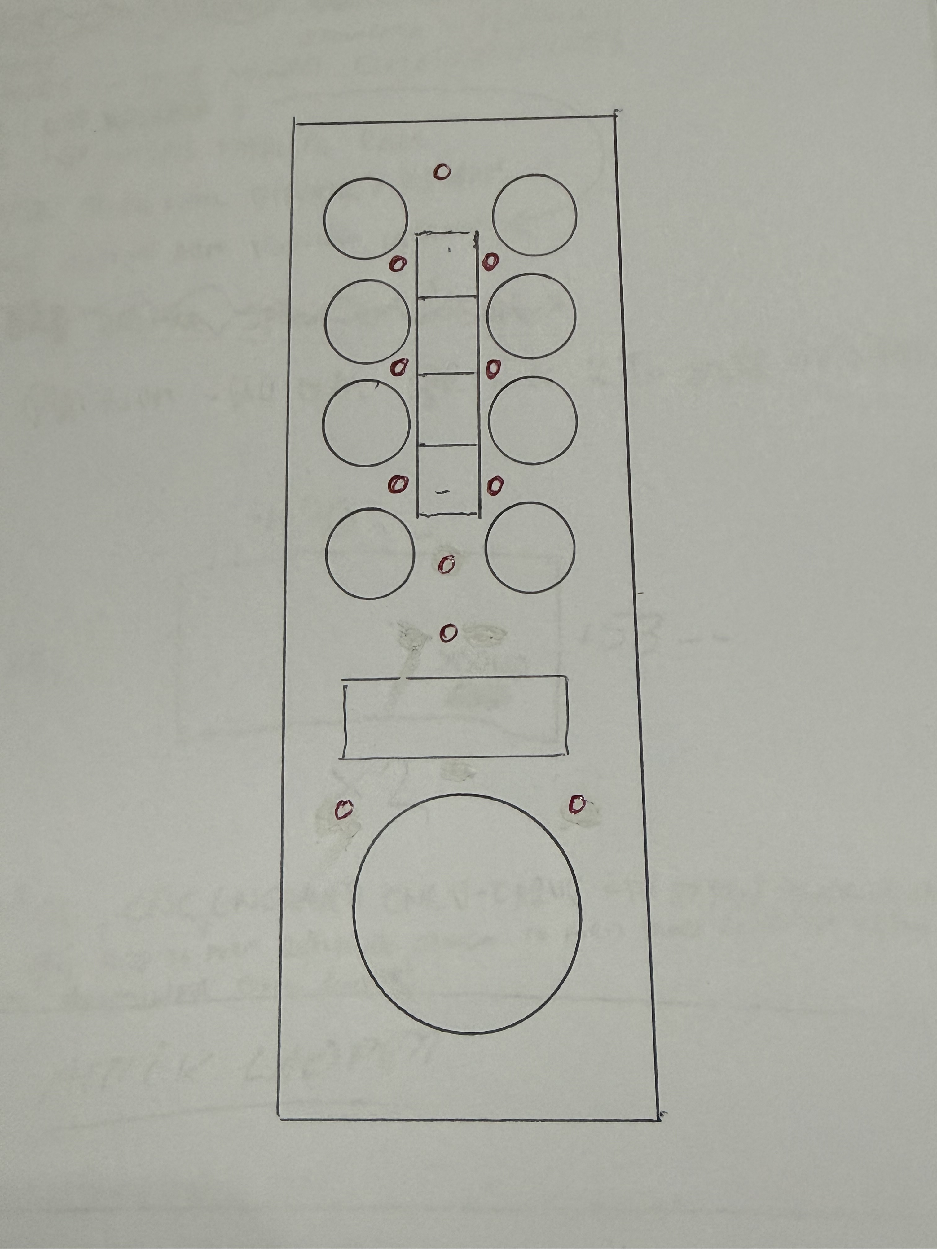

    SDA SRS 1.2 TL Monolith: Front and Rear Baffle Brace Upgrade.
    Now that I'm finally moving towards some serious gear, the Monoliths have started absolutely hammering it out down under.
    They are running much faster and deeper now, but I reckon they will benefit immensely from some extra bracing.
    This is an area we should fair dinkum concentrate on for one of the next updates. I want to focus right between the MW drivers and ensure it has some form of asymmetrical bracing.
    My plan is to make sure these big boys are completely sorted by the time the final pieces of the puzzle—the power amps—are incorporated.
    I'd appreciate any top ideas, internal photos, or past experiences to support this next no-limits build.
    From here on, as per usual, all metal fabrication will be handed over to Xschops' department to keep production in the USA.
    I'd love to go full Magico on an enclosure , but I don't think xschops CNC machine is big enough. :p
    Cheers!

    Not sure about how the tweeter rows are braced on yours. You can probably leave those factory or update. However, orientate your steel semi-rings (red) horizontally and use 1" dia. solid oak dowels (yellow) front to back. This will fix any baffle flex and not take up much air volume. I'd even swap out the rectangular brace/s between the Passive and X-over plate...
