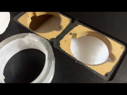

    After a lot of thought, I changed up the Dacron/BH5 arrangement.
    [gasp]
    Yeah, I get it.
    [Dune paraphrase]
    'Others have tried.'
    'Tried and failed?'
    'Tried and *died*.'
    It bothered me- the arrangement of materials, in relation to the openings on the baskets, the path of reflected sound, and air movement.
    So, I decided on some blaphemic experimentation.
    There's not a lot of room in the mid chambers to tame reflected waves bouncing off the sides of the chamber and back to the cones, but I believe a better arrangement is splitting the BH5 into narrower pieces and mounting them to the sides of the drivers.
    Putting the BH5 blocks behind the Dacron, behind the drivers, increases the absorption of energy within that chamber, but I wondered how effective the inconsistent rolls of material (butting against the basket areas) are compared to lining the immediately adjacent surfaces and filling the tweeter chamber.
    So I changed the arrangement.
    https://youtu.be/mAXnKge0n3o?si=qa29EqK2UQdt77mA
    It uses 1 6x6 inch cube less of Dacron, leaves a better path of air to the passive, puts something in the way of sidewall reflections, and sounds pretty good- anecdotally.
    I believe the Armacell mod does a lot for those internal basket reflections, and getting the angled reflections intercepted appropriately from the outside is *potentially* better with a different take.
    My love of 8 and 9-ball might have something to do with my obsession with reflections and how things bounce around...
    By-ear evaluations will continue when both Real Wood cabs are up and running.
    (Thanks to the usual suspects for inspiration.)
