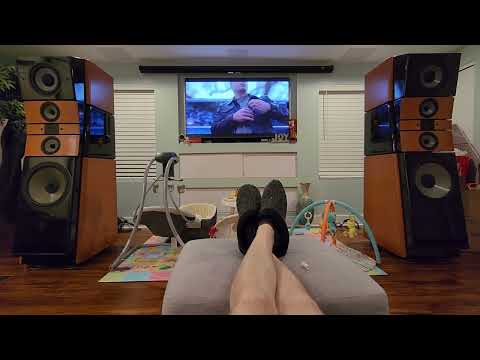

    Guess it's time for my yearly update on how I'm done yet have changed everything!
    Optical in from road
    3 x Dedicated 20 amp circuits
    Provider provided ont
    >Audiolund true silver Ethernet Cat8 and audiolund reference DC power cable
    Netgear MK83 Tri Band Mesh router hub
    > Netagear devices powered by Teradak W200 linear power supply with Audiolund Reference PC
    Netgear s8000 switch
    Network acoustics muon filter and cable
    Mini dsp sdh
    >s booster linear power supply
    >Audiolund Signature PC
    >Audiolund Xtreme 1.5M Digital Cable with BNC ends
    Abbas 2.4se dac, 6sn7
    >stock tubes
    > Audiolund Xtreme RCA Cables, 1m
    Mark levinson 335, fully rebuilt
    >Audiolund Xtreme Power Cable, High Powered Version
    > Audiolund Xtreme 6 wire version speaker cables with Furutech ends
    1998 Jm Lab Grande Utopia with partially modded crossovers
    VR3 wrote: »
    So funny to return back to this thread and see this comment from April and how different the system is now... I am very close to doing everything I can think of sans replacing stuff inside the components... lol
    Setup now...
    RG11 belden, 14 awg OFC copper from outdoor cable box to modem direct wired
    Netgear CM2000 modem
    >Audiolund Reference Ethernet Cat8 and DC power cable
    Lumin U1
    >Lumin X1 Power supply, stock umbilical
    ANK PRO5.1 DAC
    >Emission Labs Mesh 5u4g rectifier tube, Tung Sol 12au7, JJ Ecc99
    Musical Fidelity KW750
    >Revelation Audio umbilical cables
    VR3 wrote: »
    I believe the rig is where it needs to be.
    Lumin U1 with Kenneth Lau umbilical using LEEDH processing volume
    Wireworld Starlight BNC
    ANK DAC 5.1 Pro with Quad C Cores
    Duelund Dca 16 awg ICs
    Musical fidelity kw750 amplifier with revelation audio umbilical cables
    Duelund dca 12 speaker cabling
    JM Lab Grande Utopia with the band aid mod
    Duelund Dca 12 600v power cabling thru out
    All network components have linear power supplies, supra ethernet. Nighthawk mesh system and modem.
