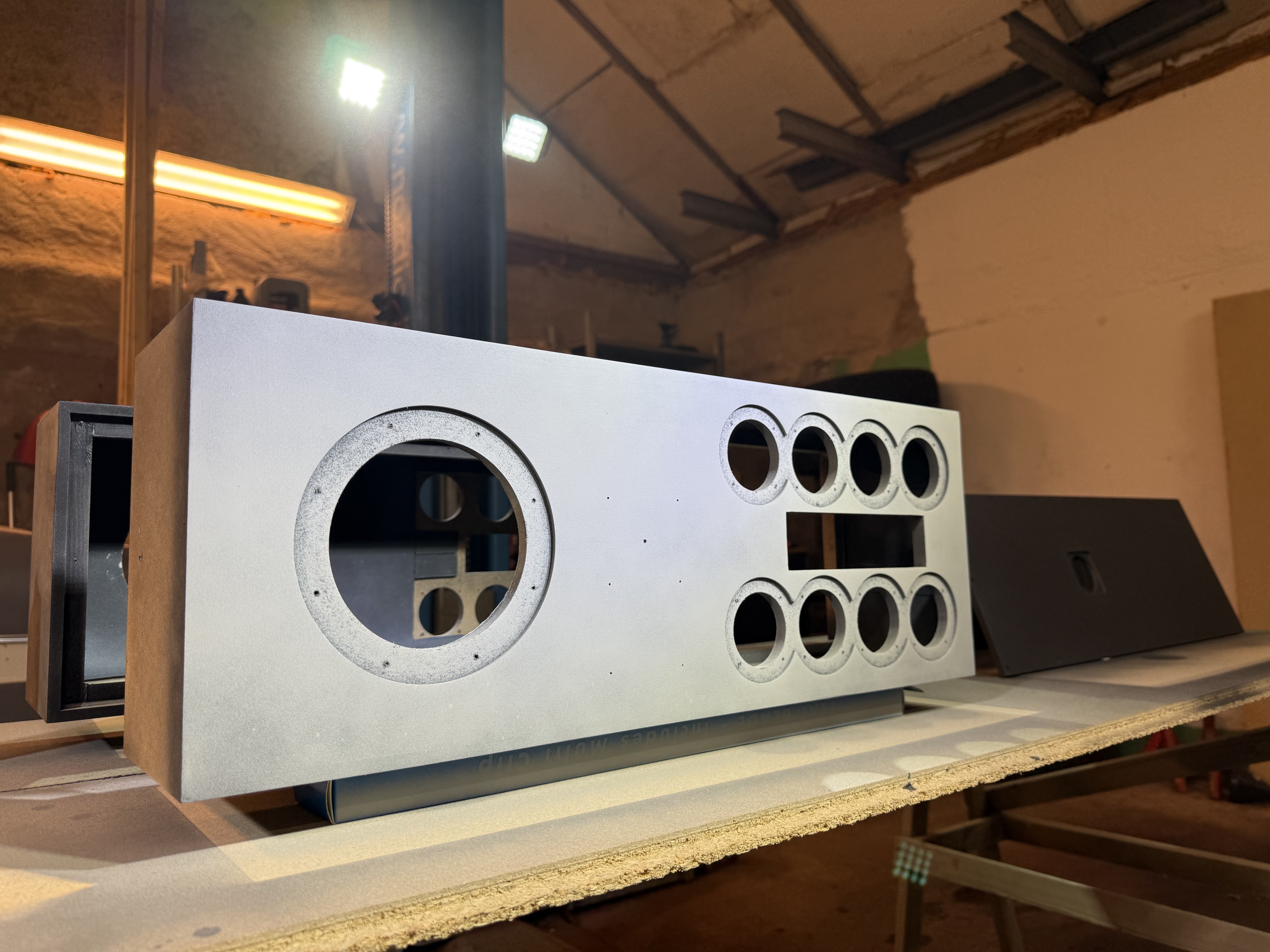

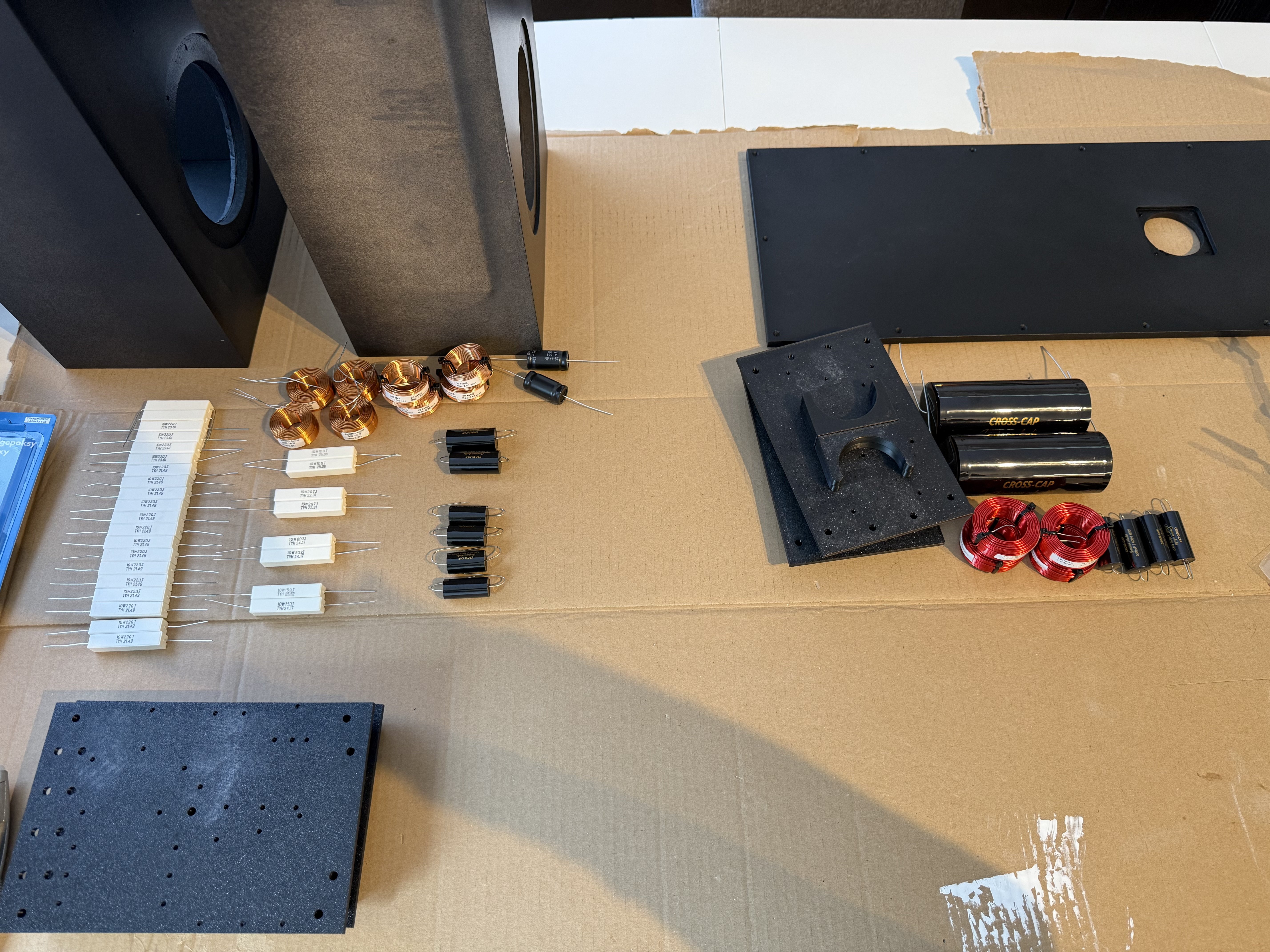

Mini models of the SDA SRS. i need help with crossovers.
    xschop Posts: 5,796
    Great job. One day there will be a set of Shorty 1.2 TL's with 1-piece faceplates in that same fashion. I'm a fan.

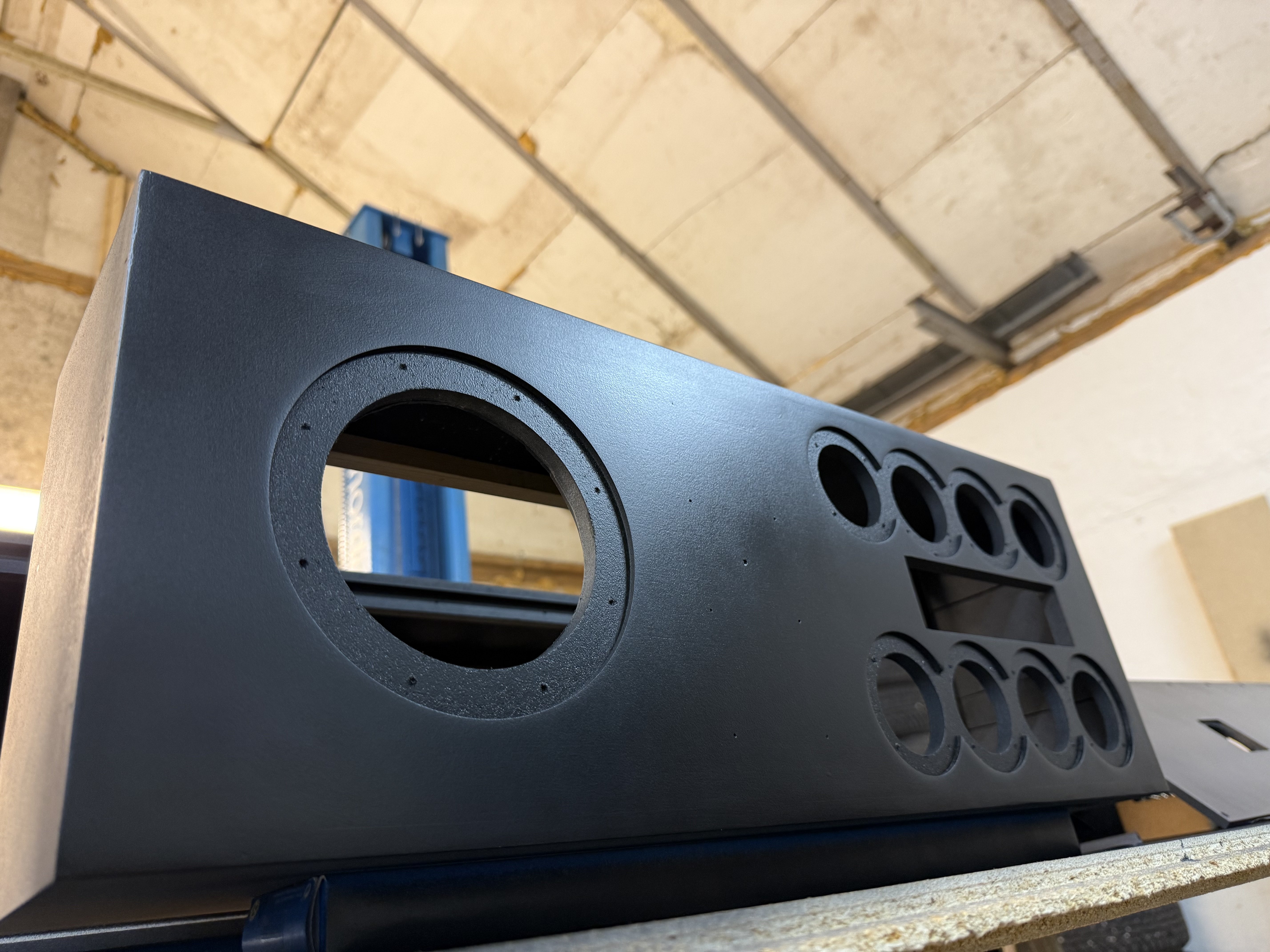

    Update
  • Lerjebrink
    F1nut Posts: 52,381
    Sure are putting a lot of work into those. I hope they turn out ok.
    What is all the black stuff inside the cabinets?
    heiney9 Posts: 25,672
    edited September 12
    The cabinets look really narrow (depth). Did you do calculations for frequency response of the box and PR? Where's the bracing? Just wondering.

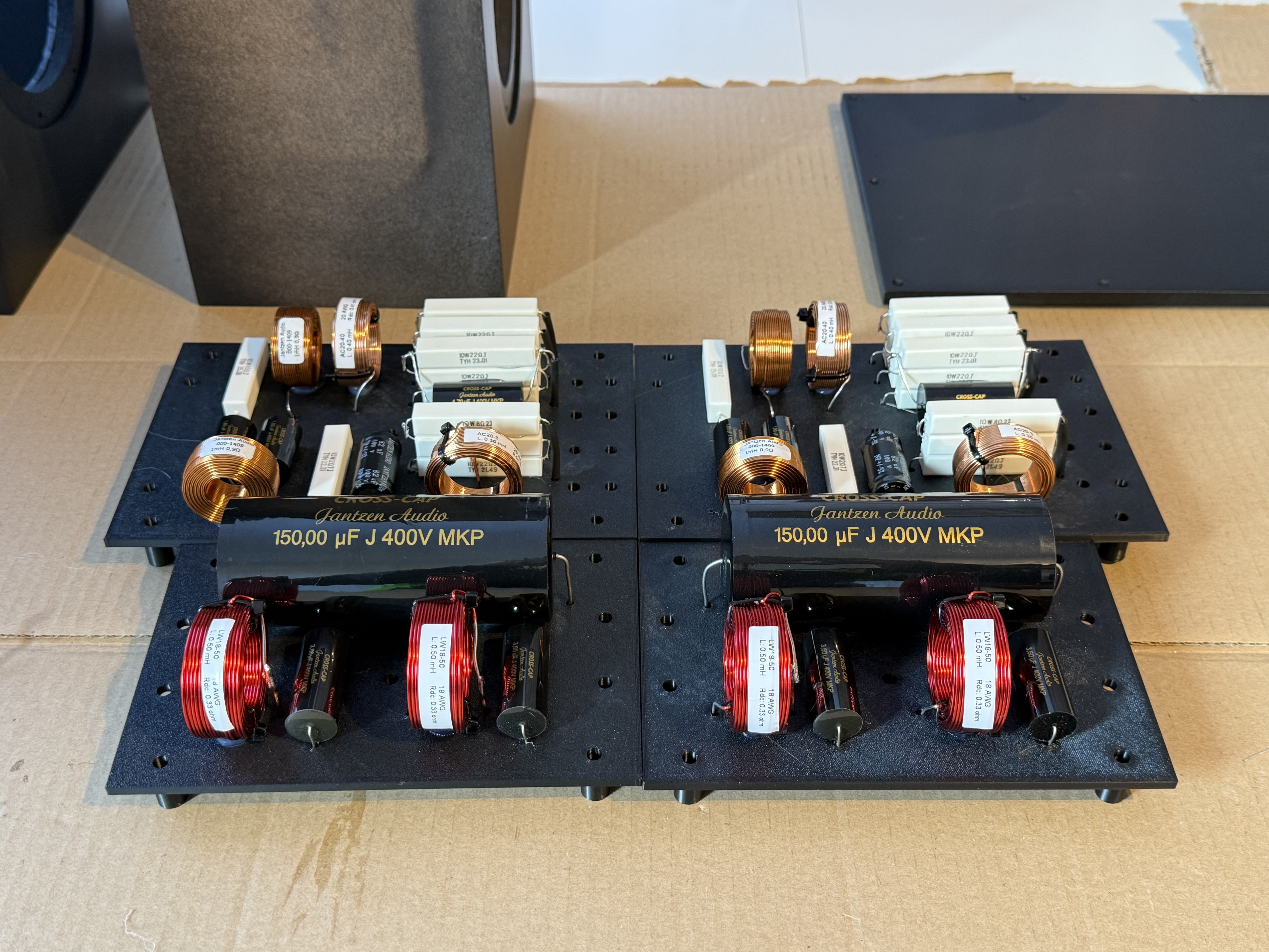

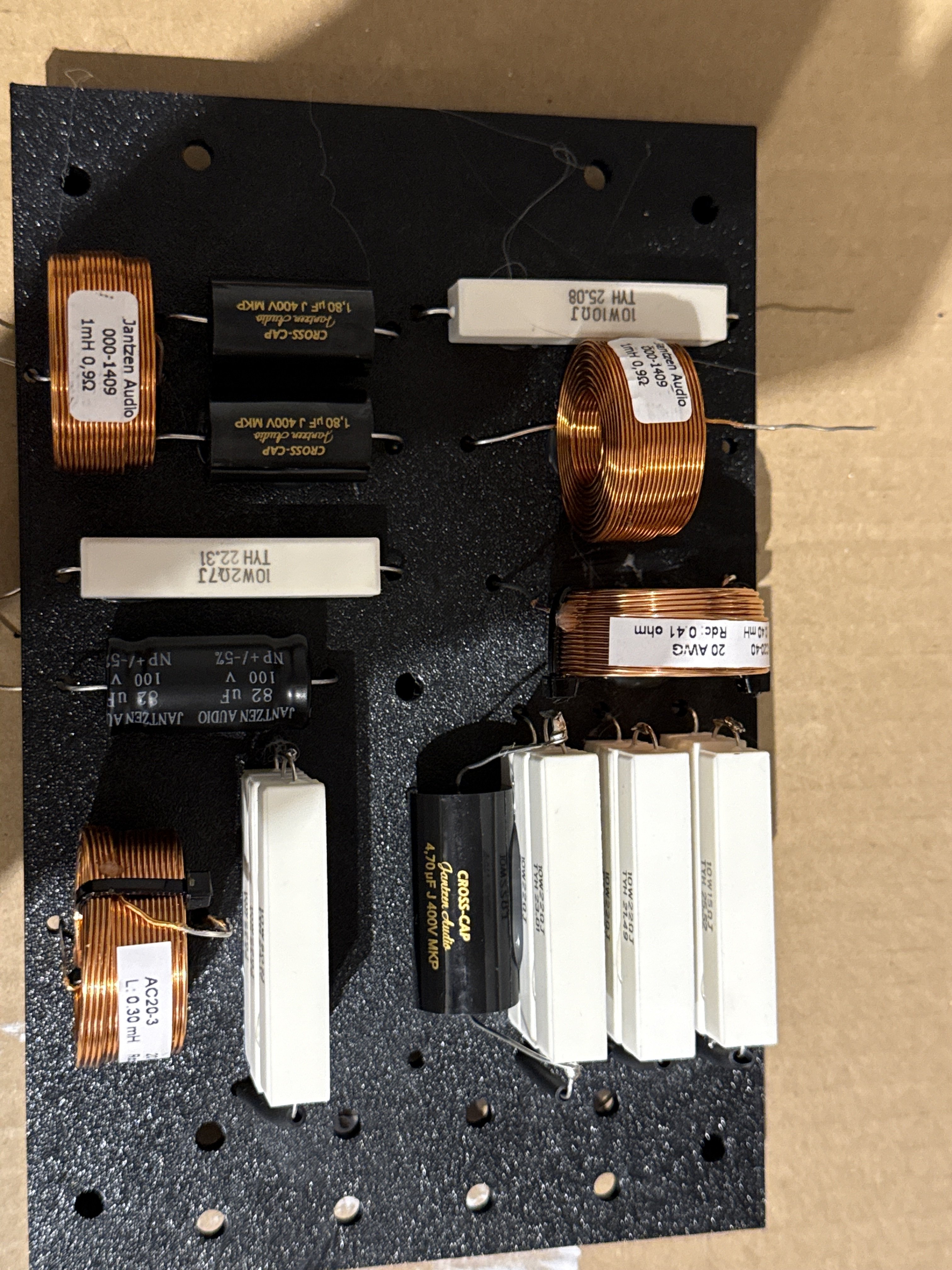

  • Gardenstater
    Gardenstater Posts: 4,921
    Looks great! 3D printed boards and cap holders? One thing I noticed is you have 2 inductors that are pretty close to each other without aligning one magnetic field perpendicular to the other one. Those will interact with each other.

  • Lerjebrink
    I think i solved it, thanks man
