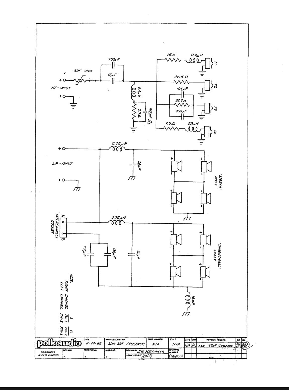

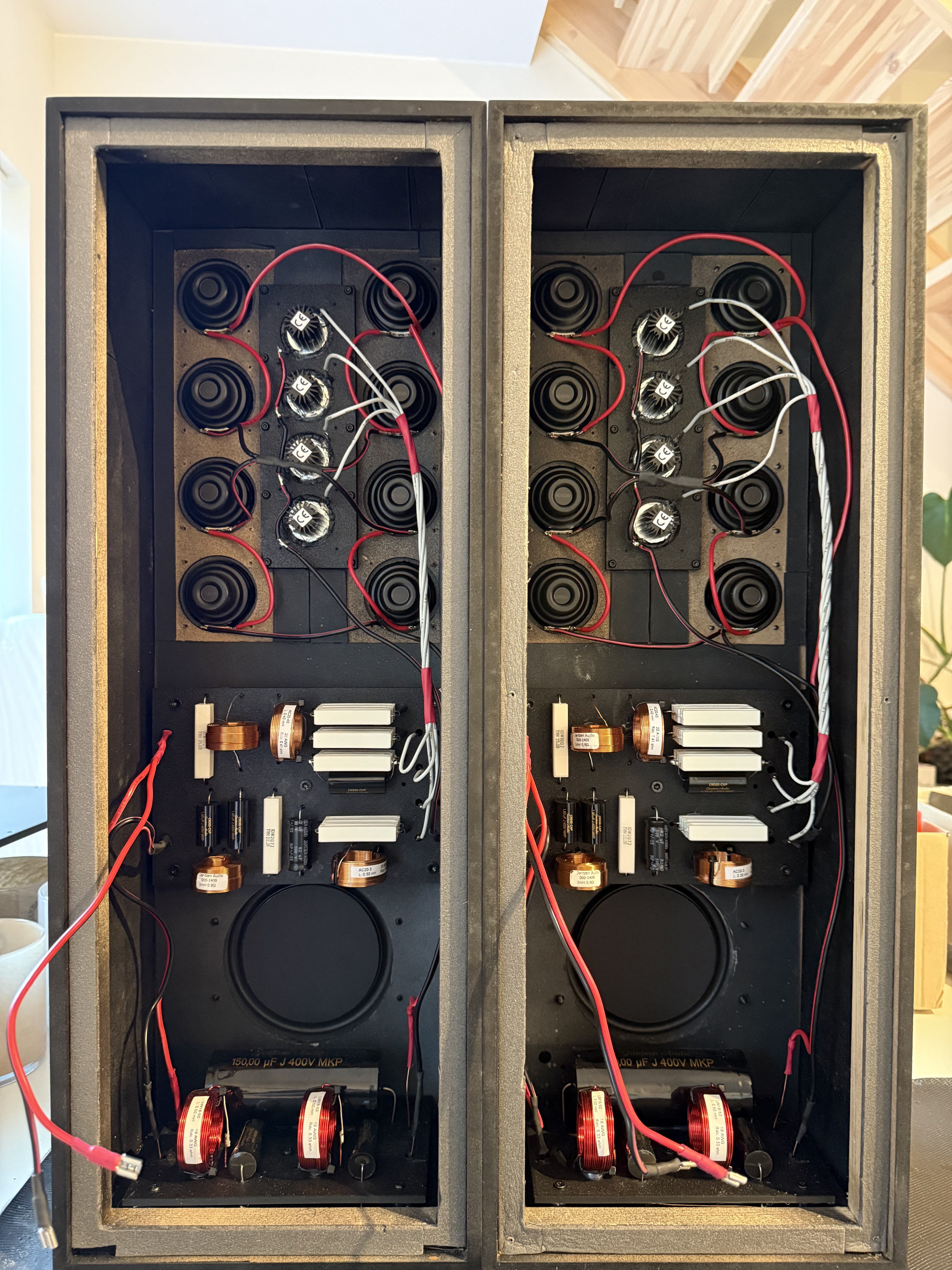

Hi everyone! I am building miniature versions of my SDA SRS speakers. I would like to have some pro help in my project. I have ordered mid and tweeters, and i am going to design the crossovers now.
I don't even know where to start. Every calculator is for 2-way systems, but i want to include SDA in the speakers. I know that it is impossible to get it exactly right with these components, but i want to try to get it as close as i can.
Down below are some images of the original wiring scheme with all the component values, and also the new speakers/tweeters for my mini build, along with pictures of the original speaker/tweeter specs.
Please message me or answer here in the discussion.

    If you want smaller SDA speakers find a pair of SDA CRS+. Otherwise, you are wasting time and money.
    heiney9 Posts: 25,711
    edited April 7
    The front baffle of full sized SDA's play a part, not sure how'd you even calculate that. I'm sure you could make min-replica's after much time, expense and effort. But they will not sound anything...........anything like larger SDA's. They might not even sound good playing 2ch music.
    What size passives are you using and how are you calculating the volume of the cabinet? How do you know your mini driver choices will even excite the PR enough to get the freq response nec? That's one of hundreds of questions.........
    The drivers that create the SDA have to mathematically be positioned a certain distance apart. How wide is the front baffle on your mini's? Thats why CRS's are on their sides.
    It's a waste of time and money

    The old SDA's are an acoustic experience. It can't be scaled smaller easily because certain physical parameters and ratios of those parameters are needed for the process to work effectively. SDA- CRS's are about the smallest you can go physically.
    If this were an electronic issue it would still be difficult, but perhaps with enough knowledge, they could be scaled down to somewhat work.
    Polk makes sound bars with an electronic algorithm (along with some physical attributes) that simulates the acoustics of SDA. Honestly my soundbar is like that, and it's not very convincing.

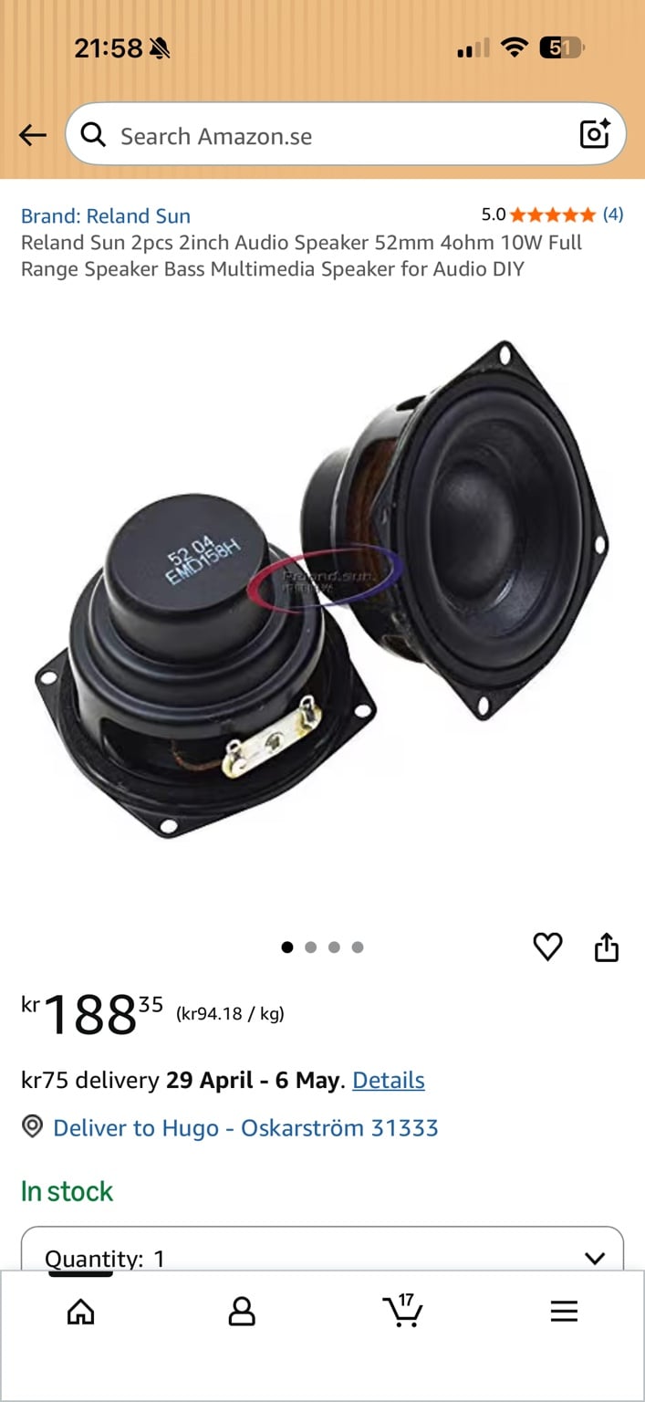

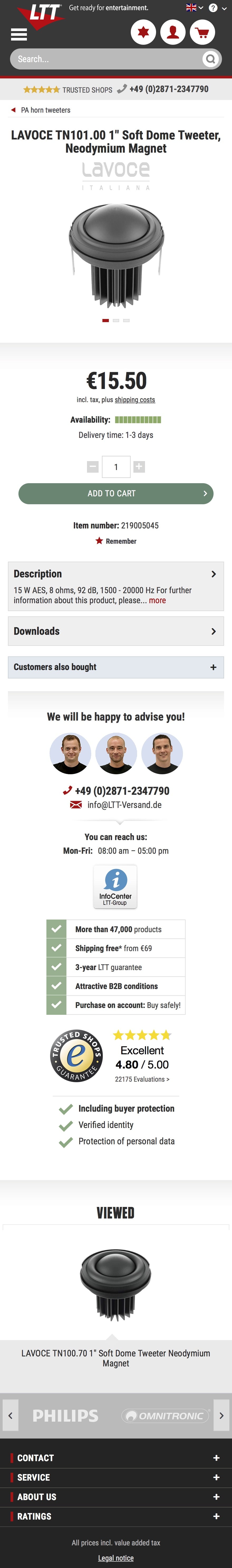

    Im taking every measurement and multiplying by 0.35. This results in 2 inch drivers instead of 6.5 inch. And the passive radiator in the bottom will be a 5.25 inch.
    I think i will buy one seperate 8 inch Sub to carry the heavy hz, so that won’t be a problem.
    In mm it will be 577.5mm in height, 192.5 in width, and 115.5mm in depth. Mostly made of MDF, and the top and bottom in pure oak.
    The SDA cable will be a gold plated 3.5mm AUX just for simplicity.
    I know i make trouble for myself by buying no-name speakers off amazon. But i don’t want the homage minispeakers to cost more than the original speakers… lol.
    i think with the right crossover, i can make it kind of playable. At least i want to try!

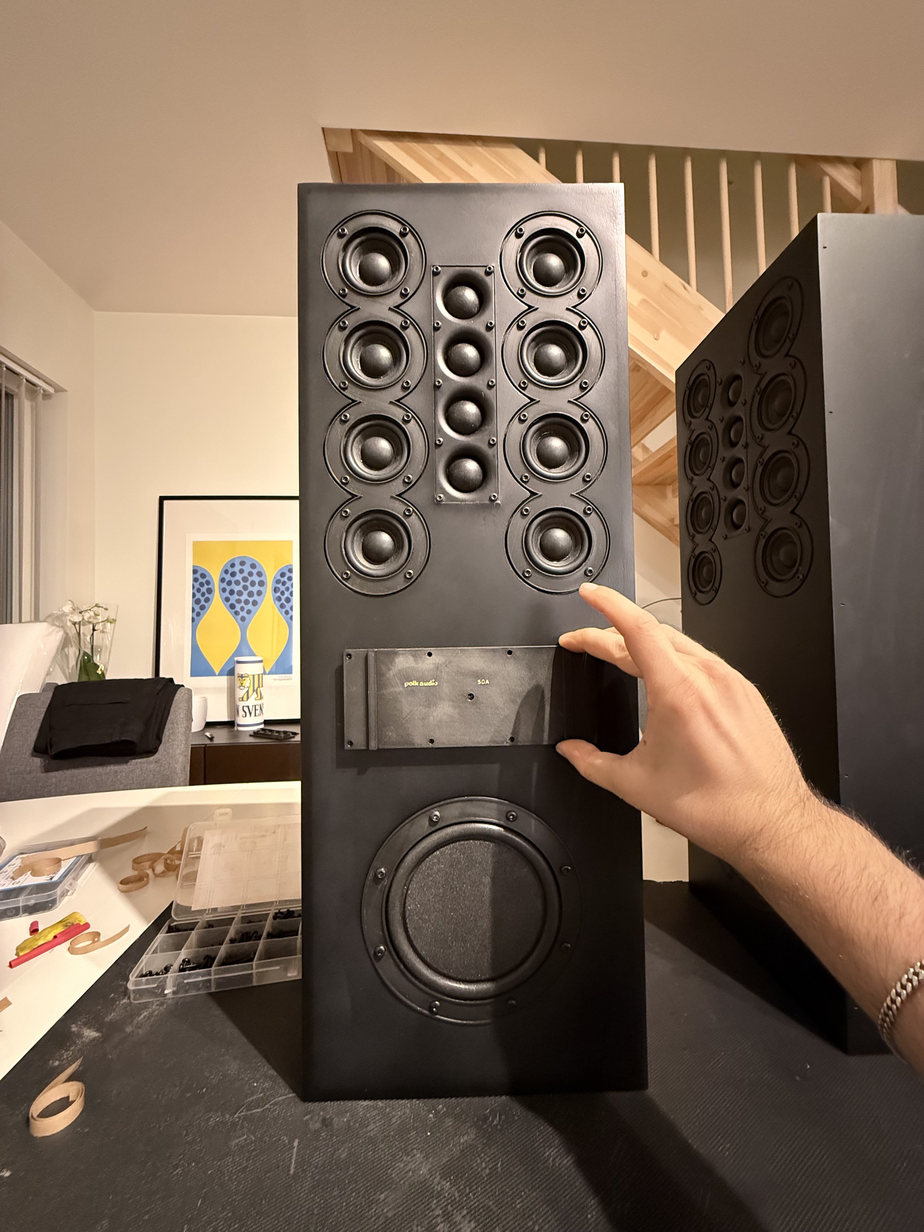

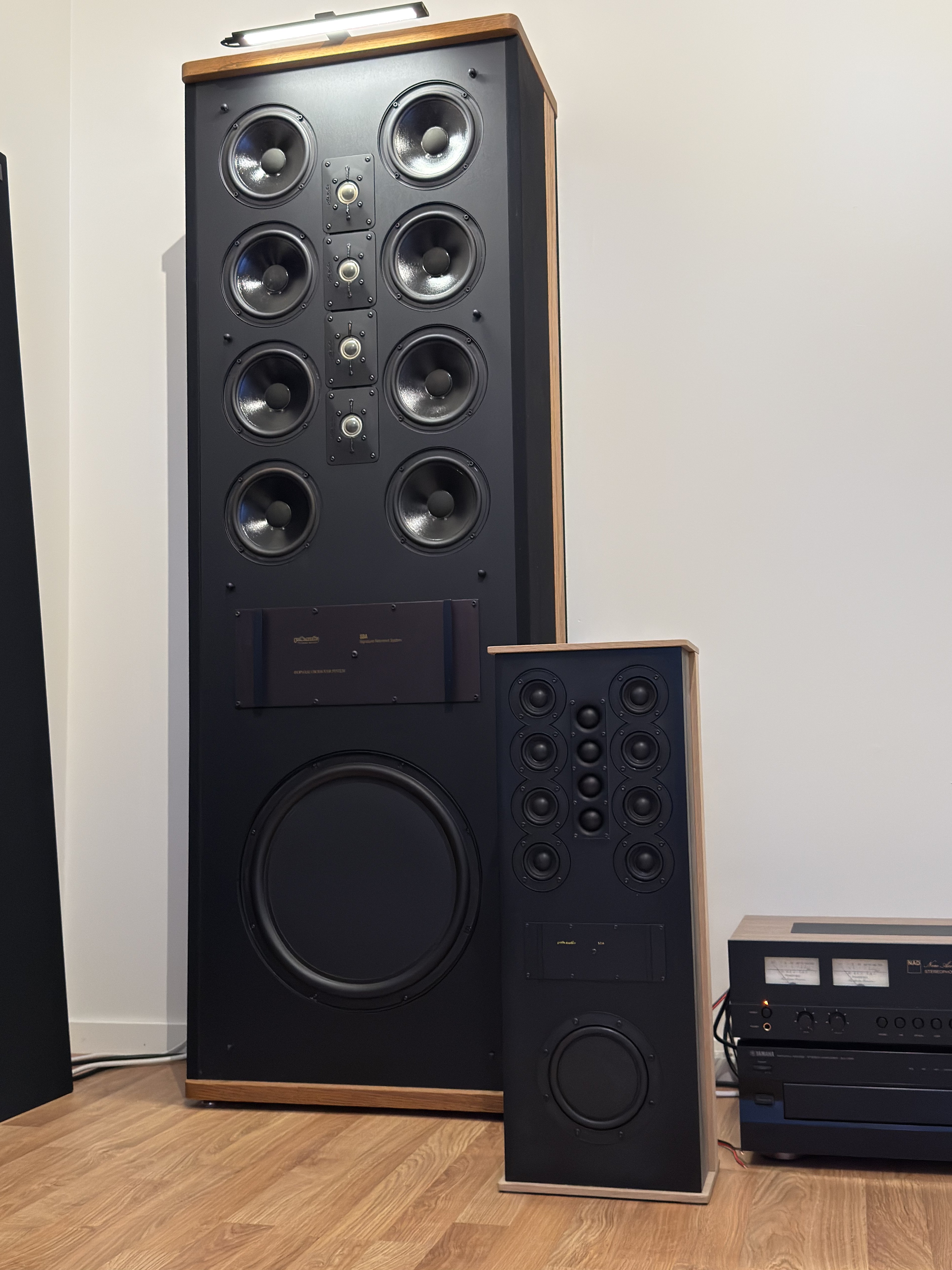

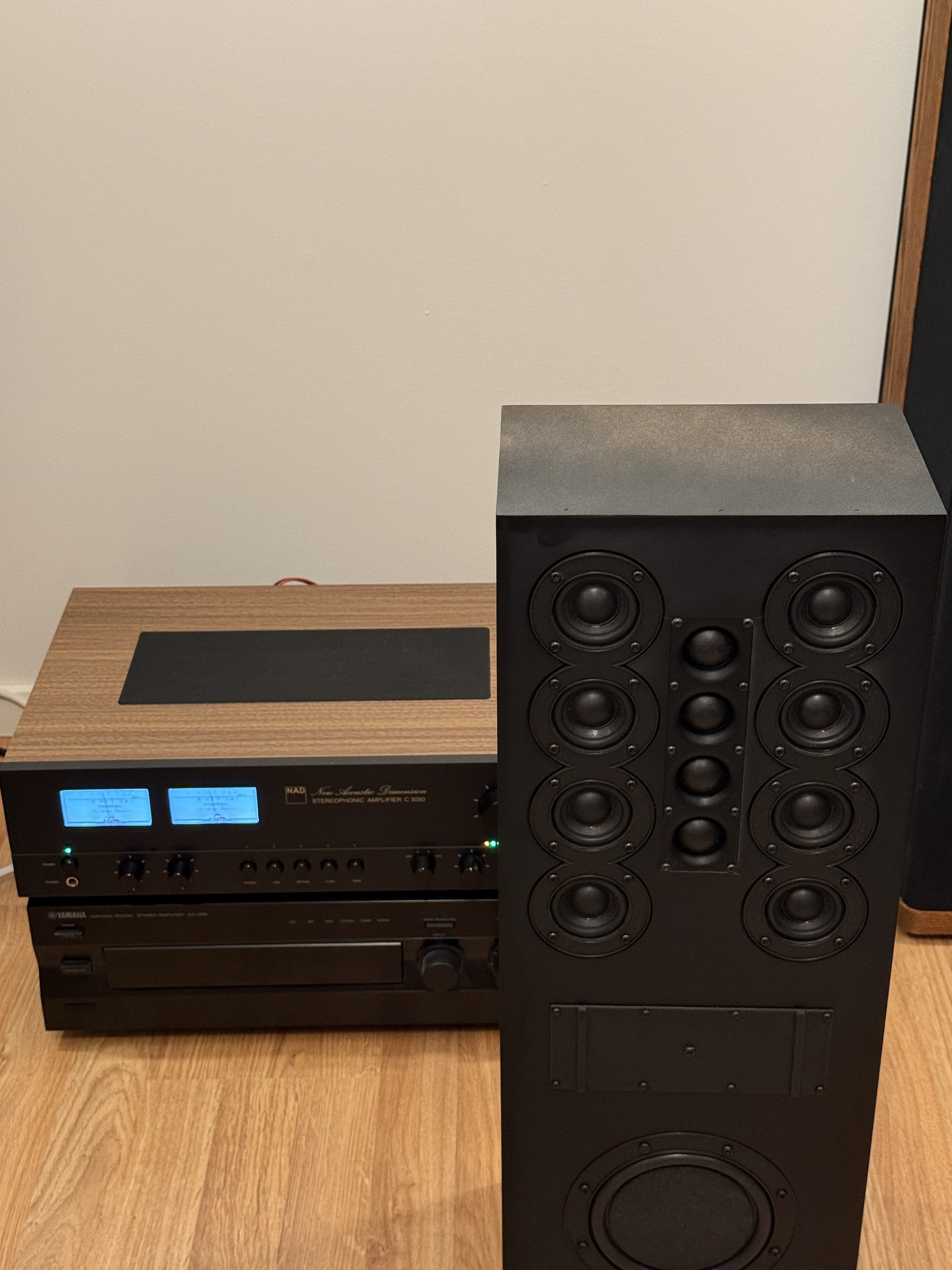

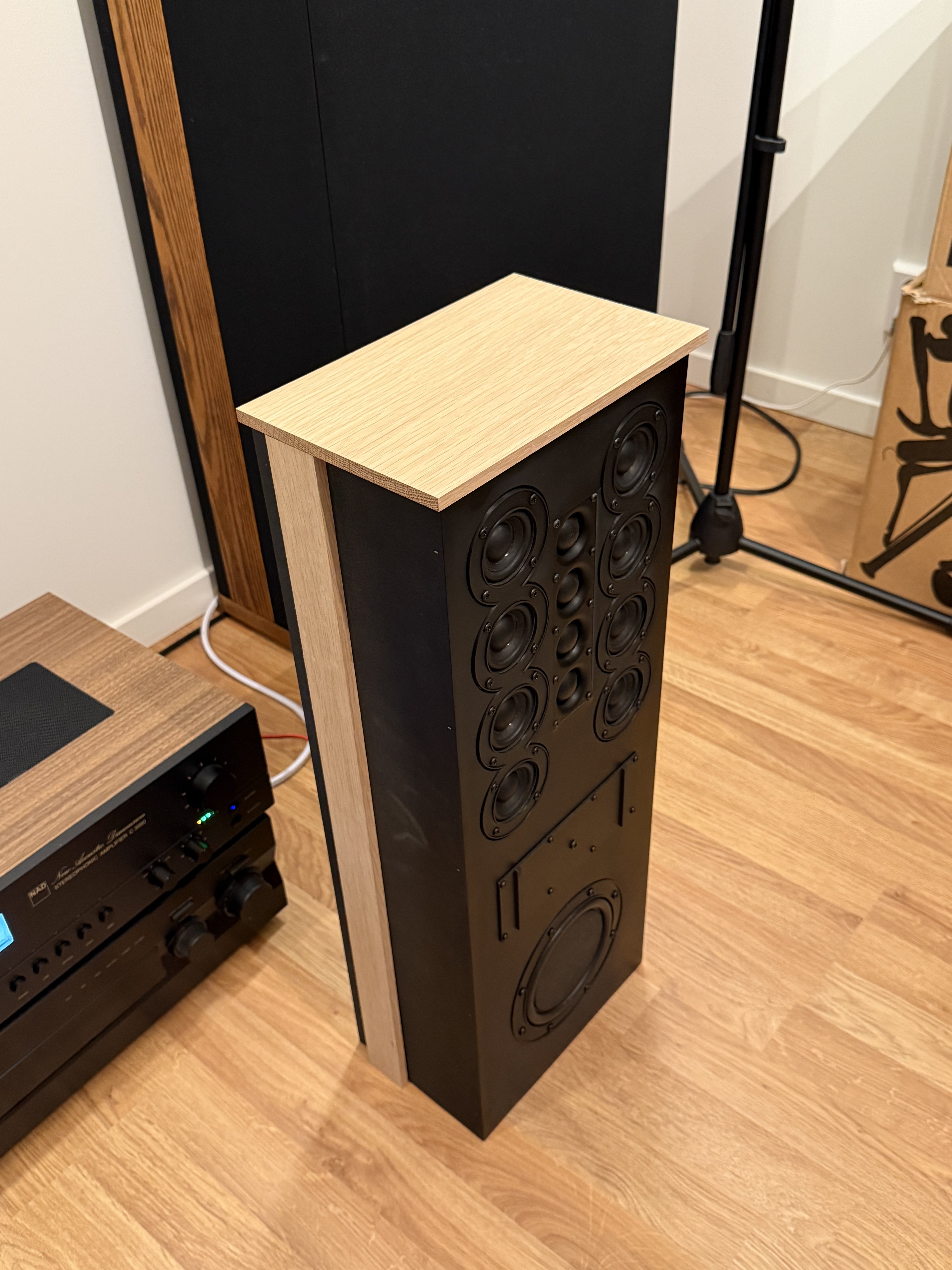

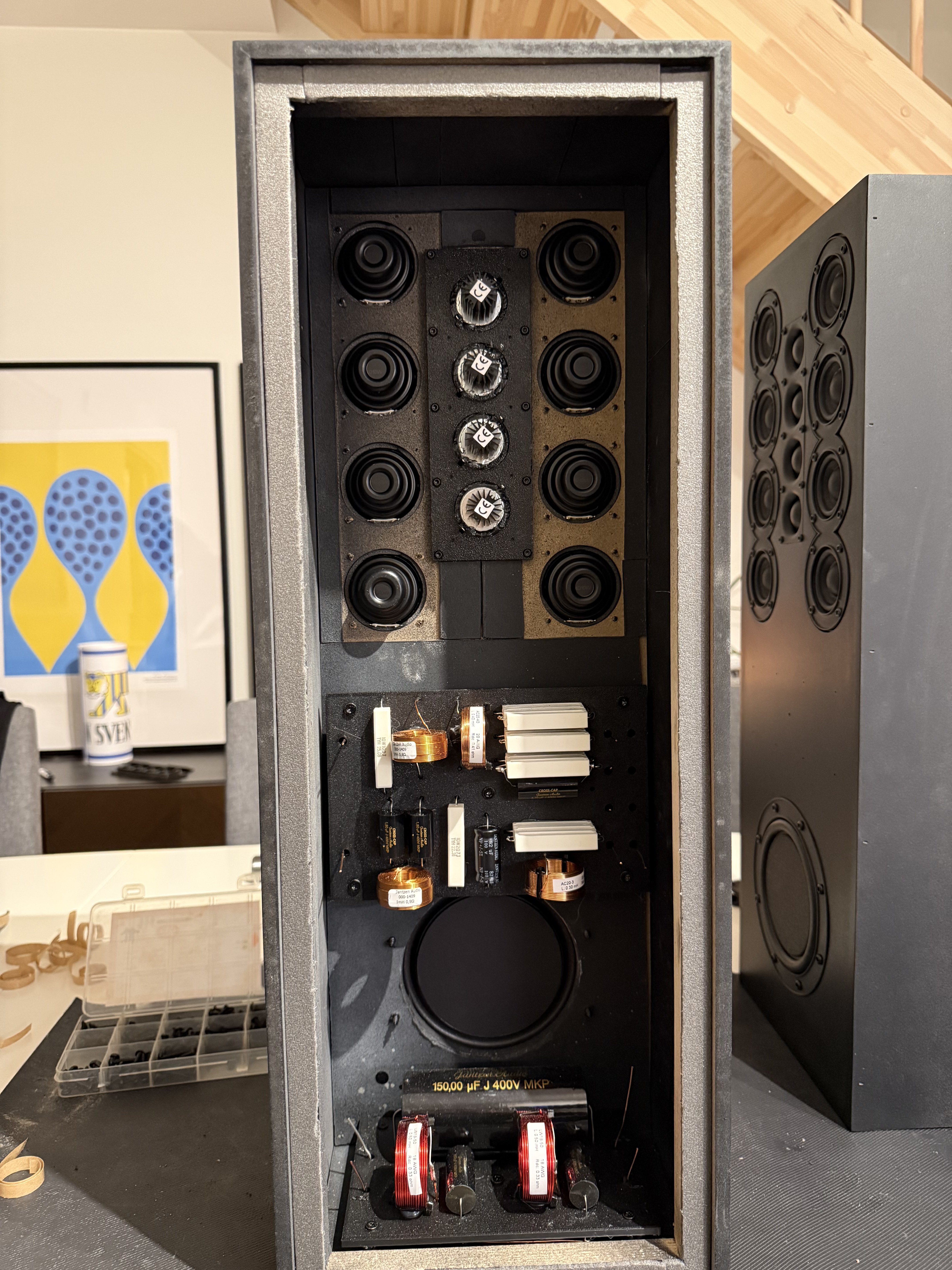

    Here is a small update for you guys
