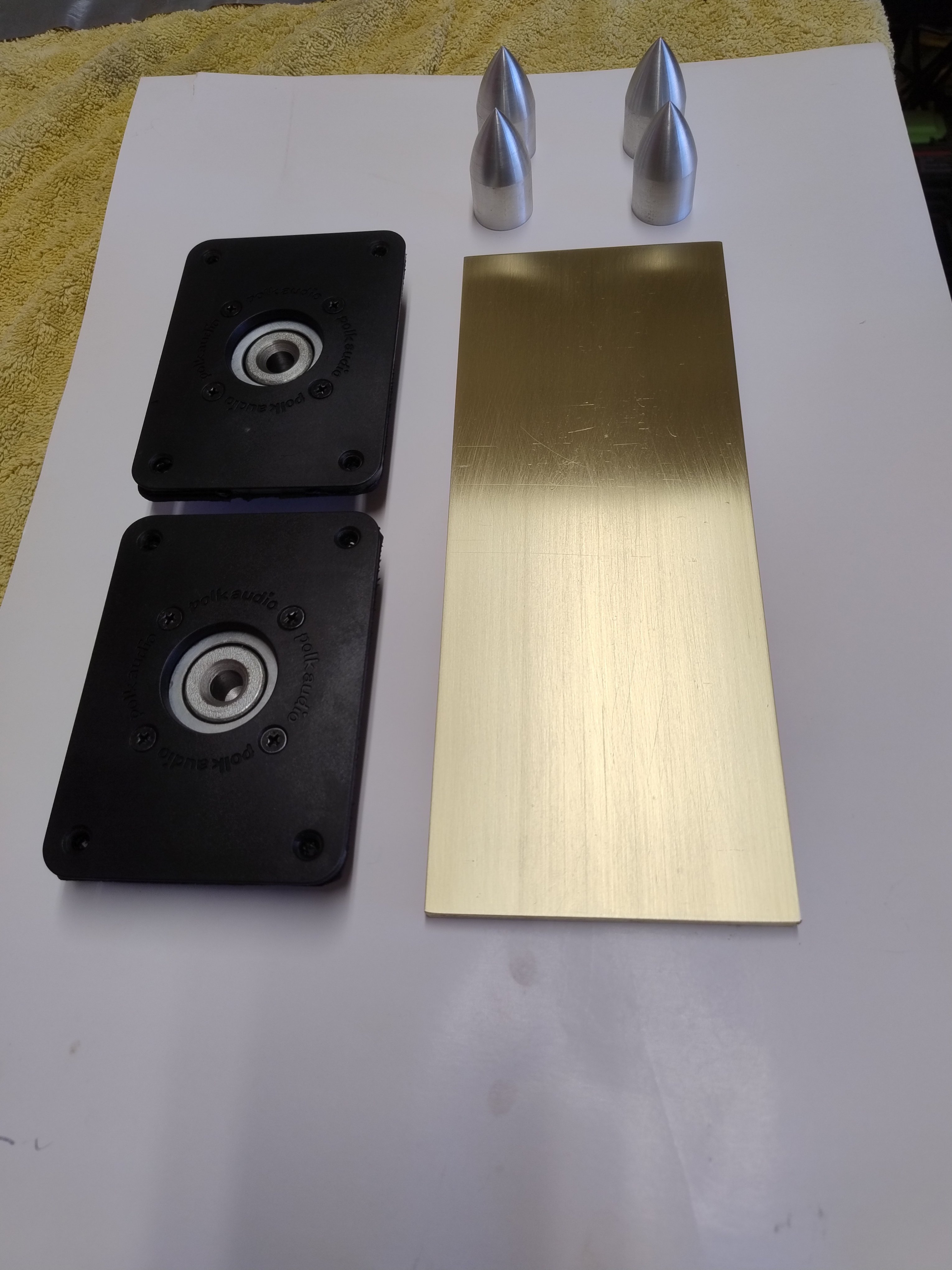

    It's that time of year, shop is thawed and I have a time window in a couple weeks to make another batch of these, so need a head's up. Already have a couple SRS owners on the list.
    They will be $55 ea. with a flat $12 shipping fee anywhere US-48 and AK.
    Just PM/chime in.

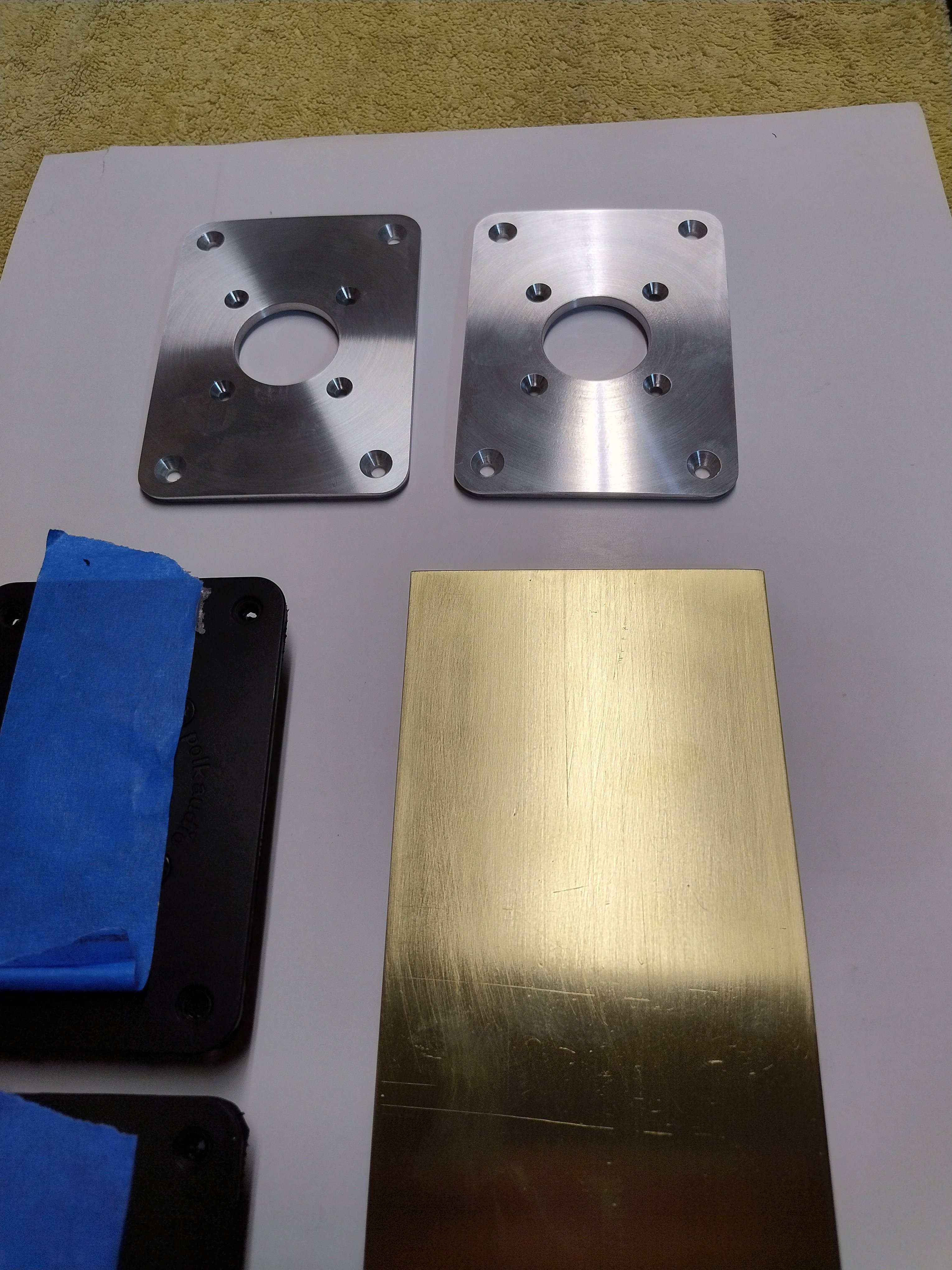

    Last tidbit detail. I machined the coil lead channels to accommodate any common 1/2" wide electrical tape.(White tape used as reference) Simply snip 1.25" lengths for each side and place over wire lead while slightly overlapping silk dome fabric.....
    Bump for those asking about the swap procedure...
    Everyone FYI, don't forget the two small strips of electrical tape before bolting the magnet and diaphragm to the plate.
    Very simple. Just need two small pieces electrical tape over the dome leads to insulate from the alloy plate. Re-use your factory RDO magnet screws as they are metric.

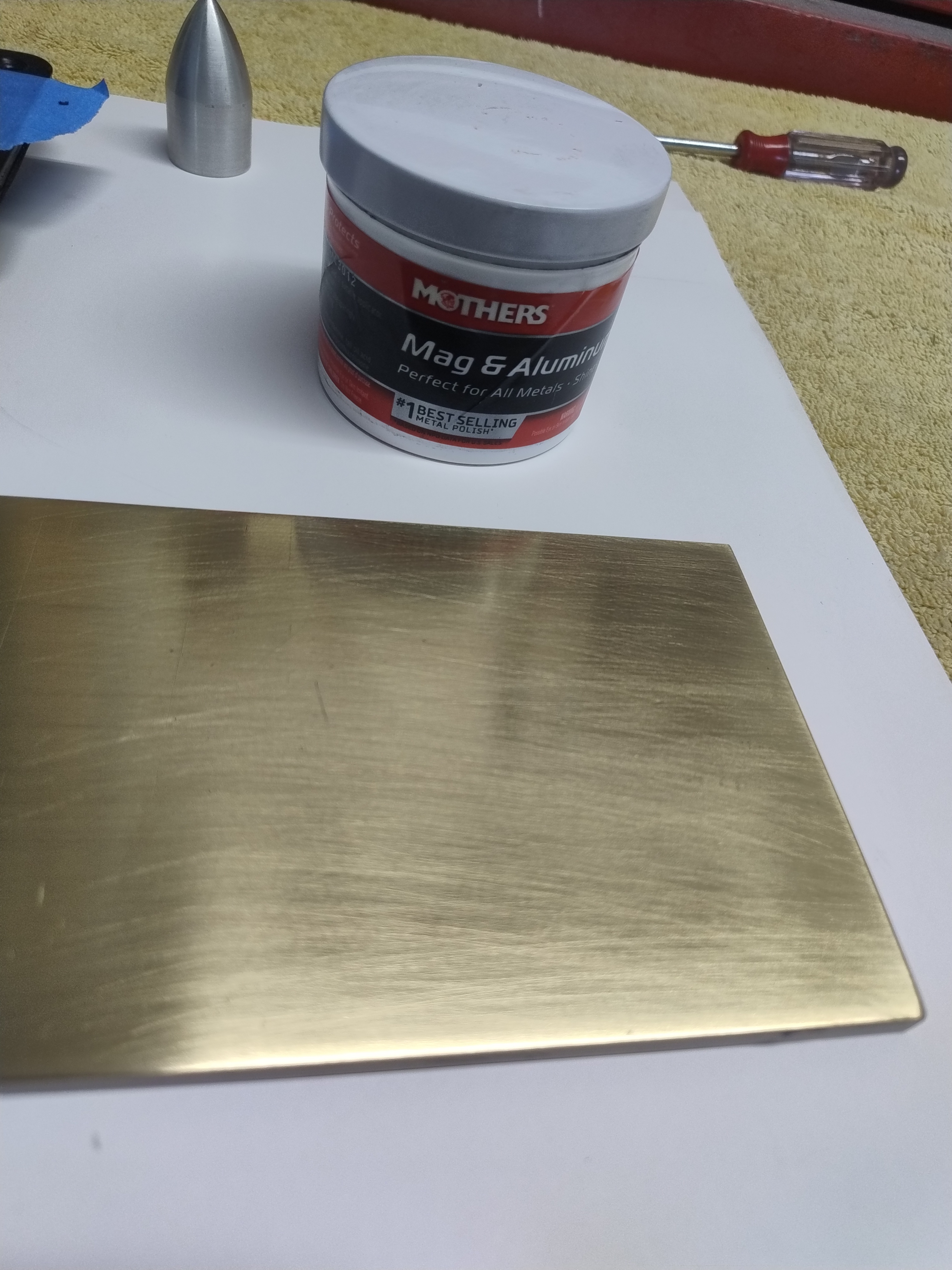

    Been almost a month since I cleaned this machinable brass plate and brushed it. Looks promising, hasn't oxidized...
