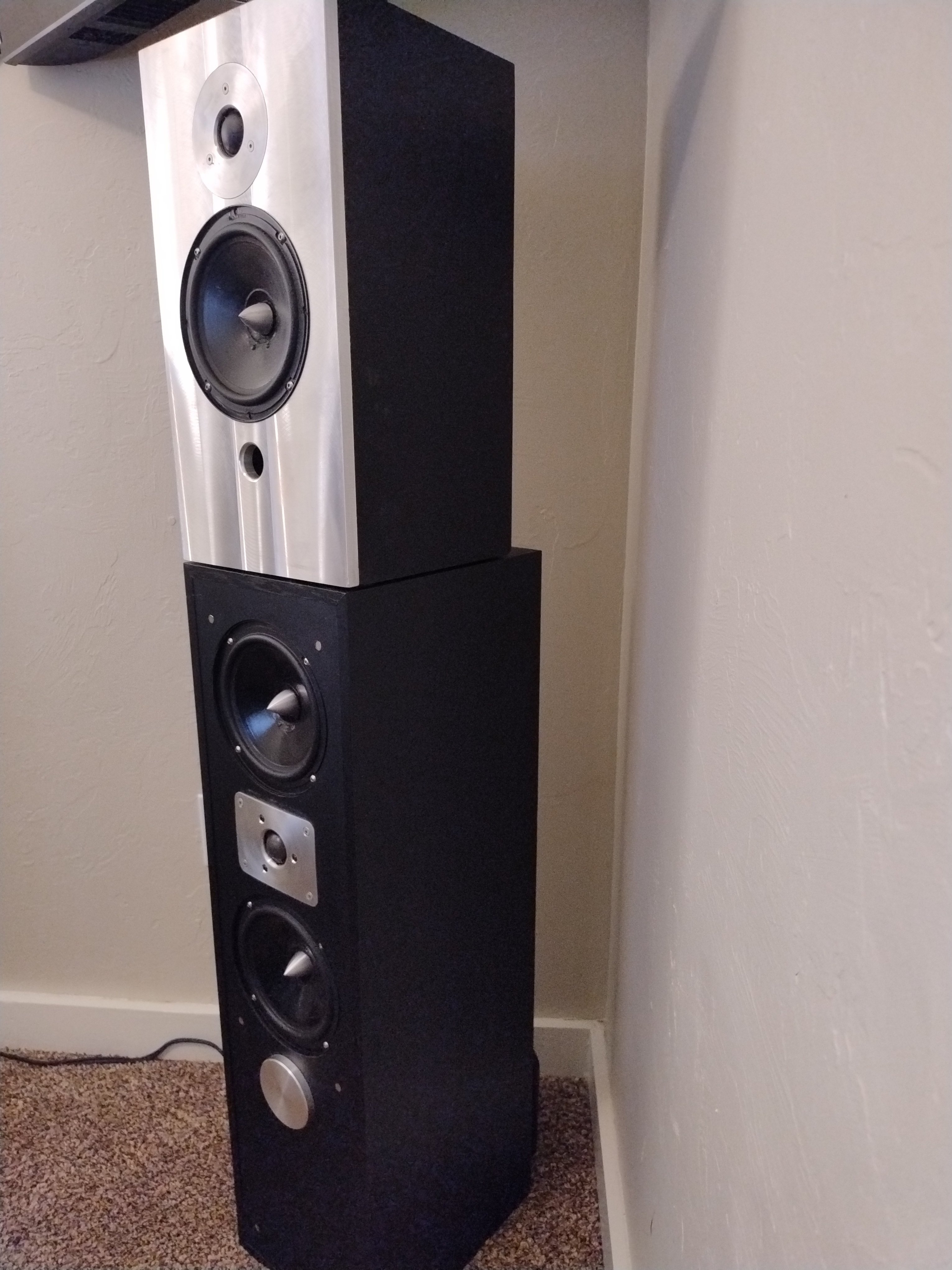

    xschop Posts: 5,838
    Cabs are done. I'll have to throw the other one together in the morning and have a listen. Only spare plugged 6502 I have on hand has the 8 hole mod and a carbon fiber one....

    Really could care less what anyone thinks. Best sounding vintage midrange from these. Just gotta dial in the highs. Looks like this tweeter just needs an extra 0.5 ohm on the circuit.

    I like the look of the aluminum bezel. How thick is it?
    xschop Posts: 5,838
    edited March 22
    All of them were 5/8" 6061-T6. Think I stated it before. The KSi of the alloy versus the particle board is a huge difference.
    Got a couple 2 ohm resistors to swap out later this evening. It's really hard to say if its even needed.
    Amazing the bass these put out too with the extra air space and port size.
    WAF factor is a hit too and I like I dont have to build stands...bonus

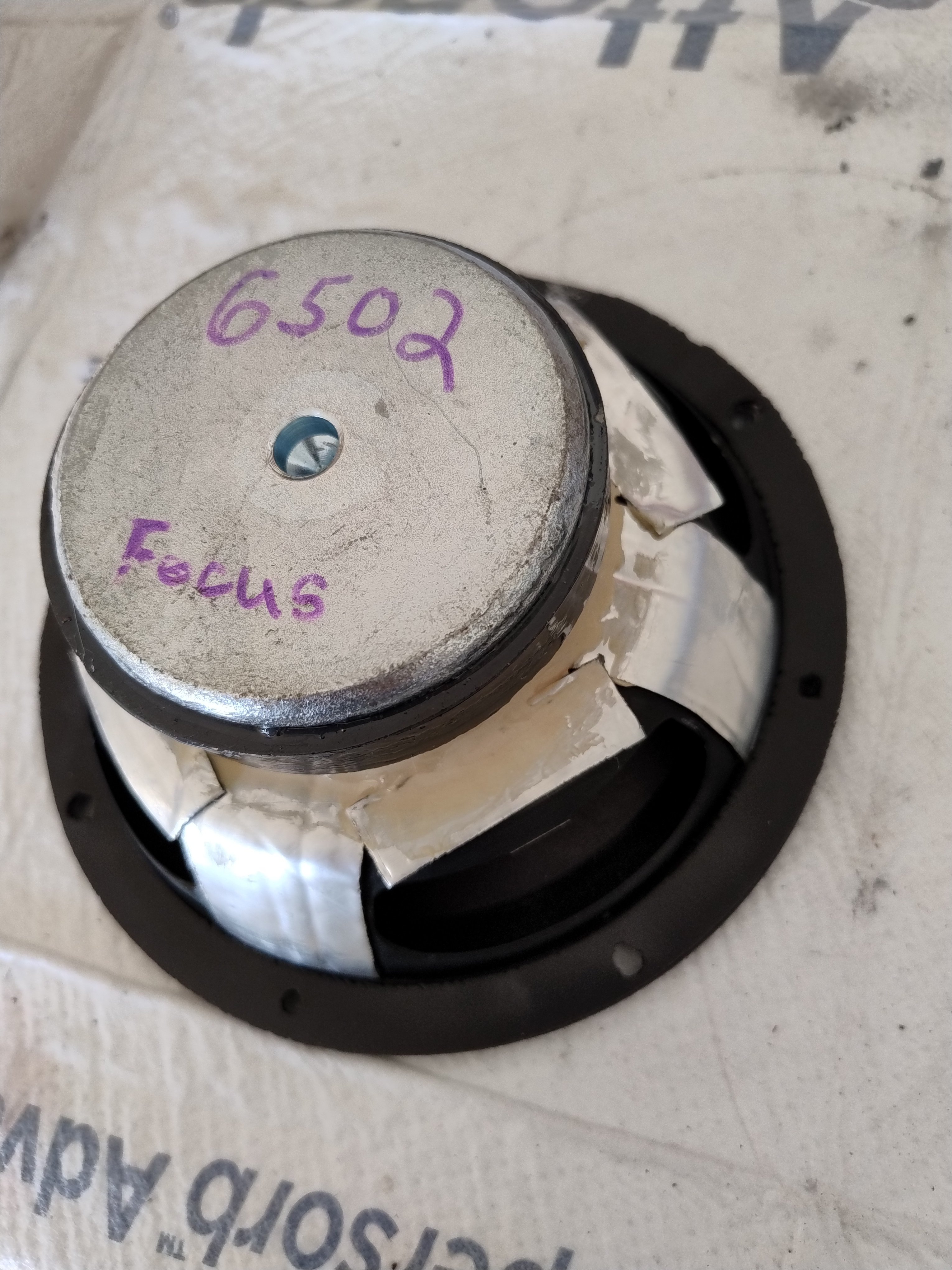

    Installed the focus ringed and plugged mids from donors that @toolfan sent me a while back.
    Was on a Hiroshima binge late evening. These are the best sounding mids I've heard from all the Polks I've experienced including R200's.
    Found some cool stands too and set them up in guest bedroom to do critical listening....
