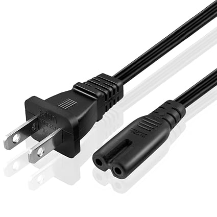

    Pardon my ignorance, but does this just plug into an outlet like a normal piece of gear, or does it have probes?
    It simply plugs into an outlet and uses a detachable cable that looks like this:

    EndersShadow Posts: 17,715
    Clipdat wrote: »
    Wow..... for some reason I thought you need probes or something stupid like that....
    Any chance I could get in on the demo then? I'm curious how my loft setup (using outlets on a shared circuit) compares to my family room (3 dedicated circuits, on the other side of the breaker box than the loft).
