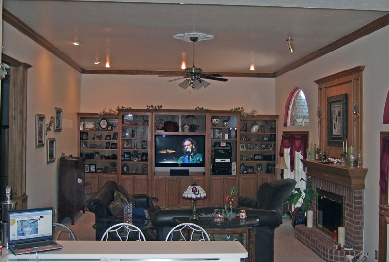

    Okay so let me get this straight. I think I will buy new front speakers for the time being..(I'm considering the rti10 and I like the monitor 70's) ..are you saying for me to put the fxi3's on my side walls and my rti4's on my back wall? Please be patient with me, I want to make sure I understand this before I give the info to my husband.Also if the fxi3 go on the side walls, how important is it that they are directly across from each other? I have a fireplace on one side wall and a 9' opening on the other side wall. The speaker on the fireplace wall would line up with my seating area (if placed 6' from ground) but the wall with the large opening would have the speaker 4' in front of our seating area...now if I have them at 11' from the ground, I can put them anywhere. My ceilings are 12'. What do you suggest? I think I attached a pic of my livingroom but I'm not sure:)
  • ohskigod
    ohskigod Posts: 6,502
    edited August 2007
    I would try like hell to keep the side surrounds as close to across from eachother as possible, if you gotta mount them 11 ft up, then so be it (but get a mount that will allow you to fire them down a little bit.

    Ummmm...Are there speakers in the room right now?
    ...I think I see a center channel or a shadow of one...
    I hardly ever say "bigger is better", but In your case, you deffinatly need to get bigger line of speakers.
    In your setup, I would try to stick with bookshef speakers (for looks manely).
    You have a beautiful room, big floorstanders in front of that beautiful entertainment center would just look ugly.

    Yes the rti4's are on the second shelf from the bottom. My sub is in the far right corner and stands 2' tall, the recliner is hiding it..You guys are much more savvy on all this than I will ever be and with that being said I don't know enough about these things to purchase speakers without a warranty.Plus my husband would never agree..I'm sure it's our loss but someone will snatch them up if it's a good price..

    Well considering I have 10 grandkids under the age of 11, bookshelf would be more practical for sure:) I'll have to read up on bookshelf speakers again.. but I'm sure I'd have to have two subs to go with them too:) I think I could convince my husband we need new fronts pretty easy but to say we need two subs "now" might take more convincing than I'm able to do:)
    Oh and thanks for the compliment on my livingroom. We had to have the whole wall rebuilt for a large TV cause the people that built the house didn't believe in having a TV in the family room...they designed it so their family could visit:) Now isn't that old fashioned:)They didn't have cable or a phone line ran to that room which seems kinda odd since they had 10 cable lines and 10 phone lines ran to other parts of the house.
