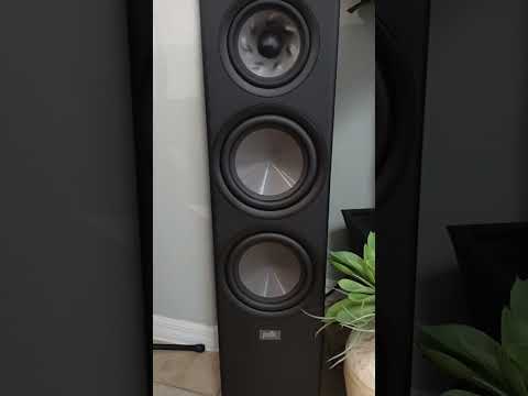

    I tried to post a link..tried like 3 or 4 times. Then I realized it said it had to be approved..so it might load up 3 or 4 times 😂.

    msg Posts: 10,490
    Nice, man, rockin'.
    So what do you think?
    I noticed significant improvements with the L800s when I cleared at least 1ft around them. Currently at least 1.5ft.
    Much better bass detail, where it was congested and smeared before.
    How much room to the wall? I'd also be interested to see hear how things sound for you at various distances. 6", 8", 12-15", and just for giggles, an extreme at 24-36".
    If you clear the baffles to where they're forward of all other furniture, clarity and separation should improve, which should also provide easily noticeable improvement in imaging and stereo play presentation. It can and should be like a wall of sound that you can follow with your eyes if you were able to see the notes you're hearing.
    Do you have them toed? With various placement adjustments, try sitting in your listening triangle with them toed to cross just behind your head for starters.

  • HalfOhm
    HalfOhm Posts: 51
    I've been much happier with them. If I would have thought to record anything when I first had them you would have been able to hear the softness or tone of the bass.
    As far as placement and axis there is more I can still try. I felt they sounded a little better when I pushed them back a hair into that rear cutout. Initially I pulled the TV and the speakers out way further than normal, but found myself inching back for a fuller sound. The TV stand was a hair in front of the speaker baffle, good eye picking up on that. I've been pushing and pulling on everything so much I lost track of it. At the moment if you were to imagine on-axis being straight forward the speakers are only slightly toe'ed in. One difference between these and the R200's is the 700's disappear nicely when sitting in the center position, it's definitely a shining point of the towers.
    With some treatment and carpet/rugs they obviously would perform better in my opinion. I also think they would be better suited for a larger room, large rectangle room. Kinda is
    what it is though. Tweeters are about 8 feet apart, couch is 8 feet away.
    Since adding some EQ I've been running the one sub cut off around 55hz and I've been content. I'll experiment more with that, see how going higher works out. Same with positioning, I'm not set on that perfect spot yet..but I'm also a little limited on
    how wide and how far I can come out due to wife
    constraints and layout of room.
  • Emlyn
    Emlyn Posts: 4,839
    I think they sound quite good given the placement constraints which is not uncommon.

  • ChrisD06
    ChrisD06 Posts: 929
    HalfOhm wrote: »
    Now I know you said a lil bit ago that they weren't producing as much bass as you were expecting...
    That's a LOT of bass for a full range tower speaker. I've heard some bassy towers but those are outputting quite a damn bit. Honest to God I think you fixed the initial wiring issue and just realized that a flat tune wasn't it for you.
    It's not it for me either though, I like a nice boost of bass. Glad to see you're liking them more.
    Remember that EQ is always an option too!

  • HalfOhm
    HalfOhm Posts: 51
    @ChrisD06 yes, my lower bass is more than adequate now. Especially if I run the subwoofer. I feel like the 700's have even improved over the last week or so..as I've been runnin' these sucka's about 18 hours a day. I can assure you they sounded nothing like they do now.. before switching the upper and lower post wiring, adjusting the EQ, and putting some real hours on them. I do feel the lower mid bass could use some tweaking, seems a bit recessed compared to the low bass and very clear midrange, maybe when I get a chance I'll record some tracks that highlight what I'm talking about..although I'm hoping this issue will improve with more time played on the
    speakers. I think I'm going to hook up a dedicated preamp (tube) in this system instead of running off the dac/pre, that should make some overall improvements as well. I've been pretty happy with the speakers, they've turned out much better than what I initially thought.
  • ChrisD06
    ChrisD06 Posts: 929
    @HalfOhm sounds like your placement, fixing the polarity, and allowing the woofer spider and surrounds to loosen up has all come together for you! I'm really happy to hear that.
