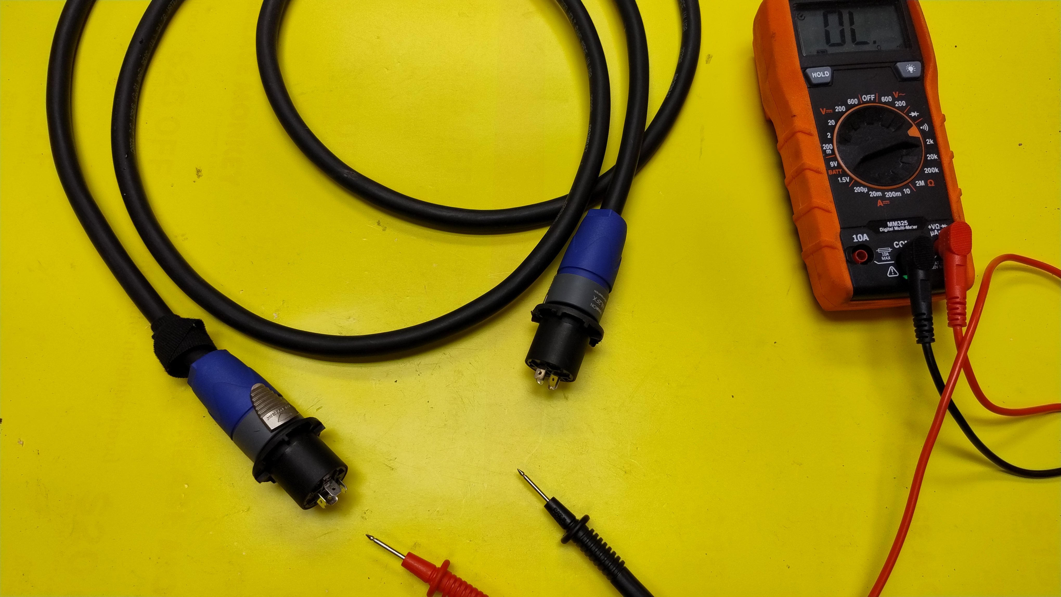

    Note to self and maybe help others. Tested the continuity, and the Neutrik male NL2 whips I have on hand match the female NL4 (for new terminal plates). The "Pin" being 1+ and the "Blade" being 1- respectively....

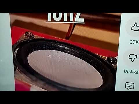

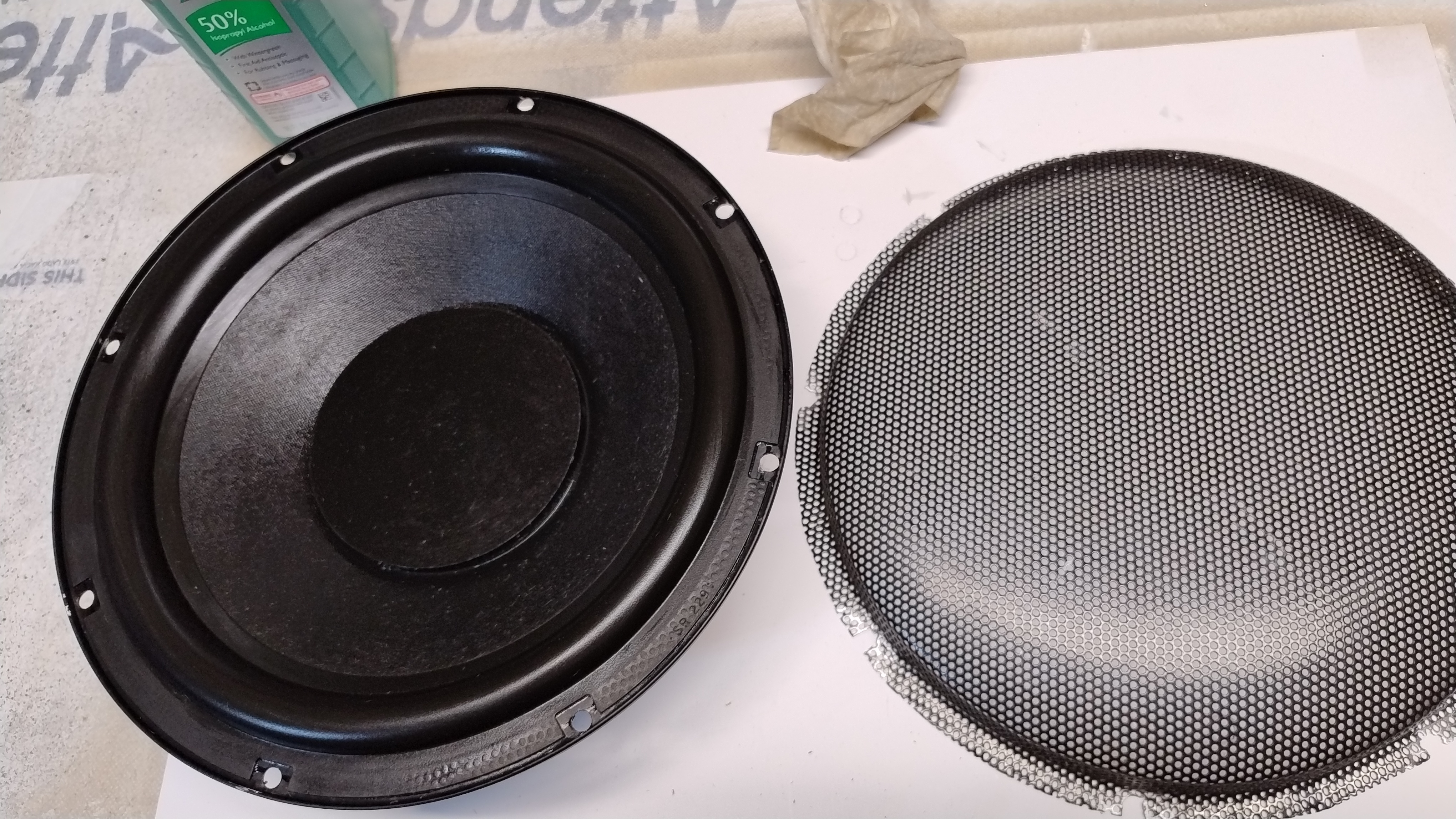

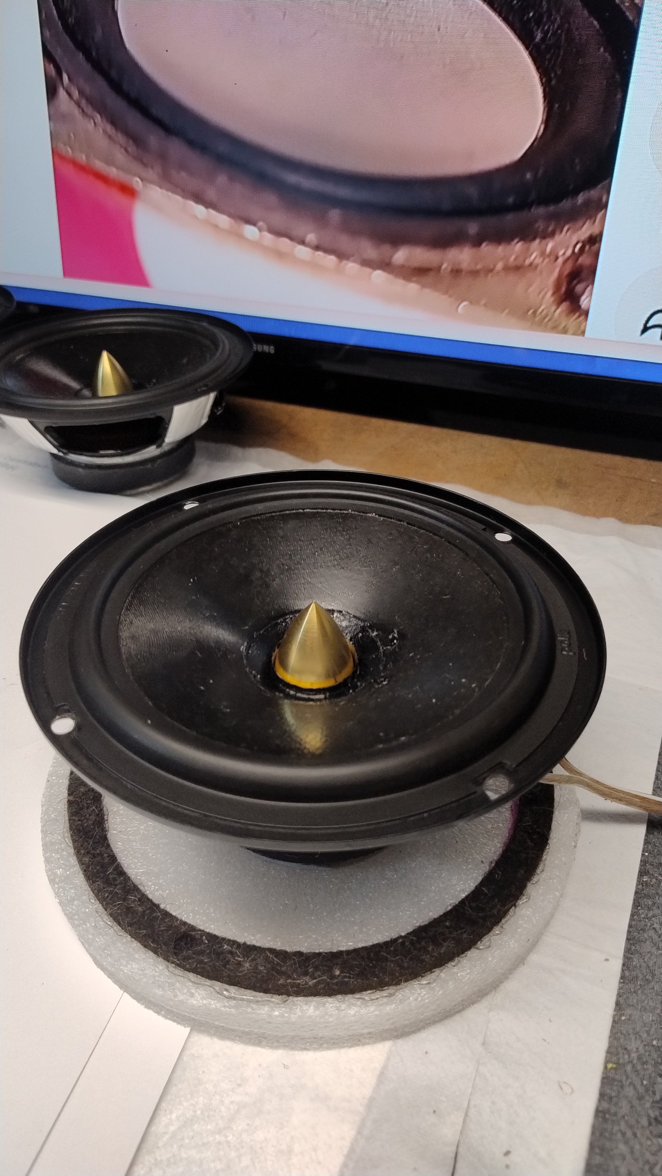

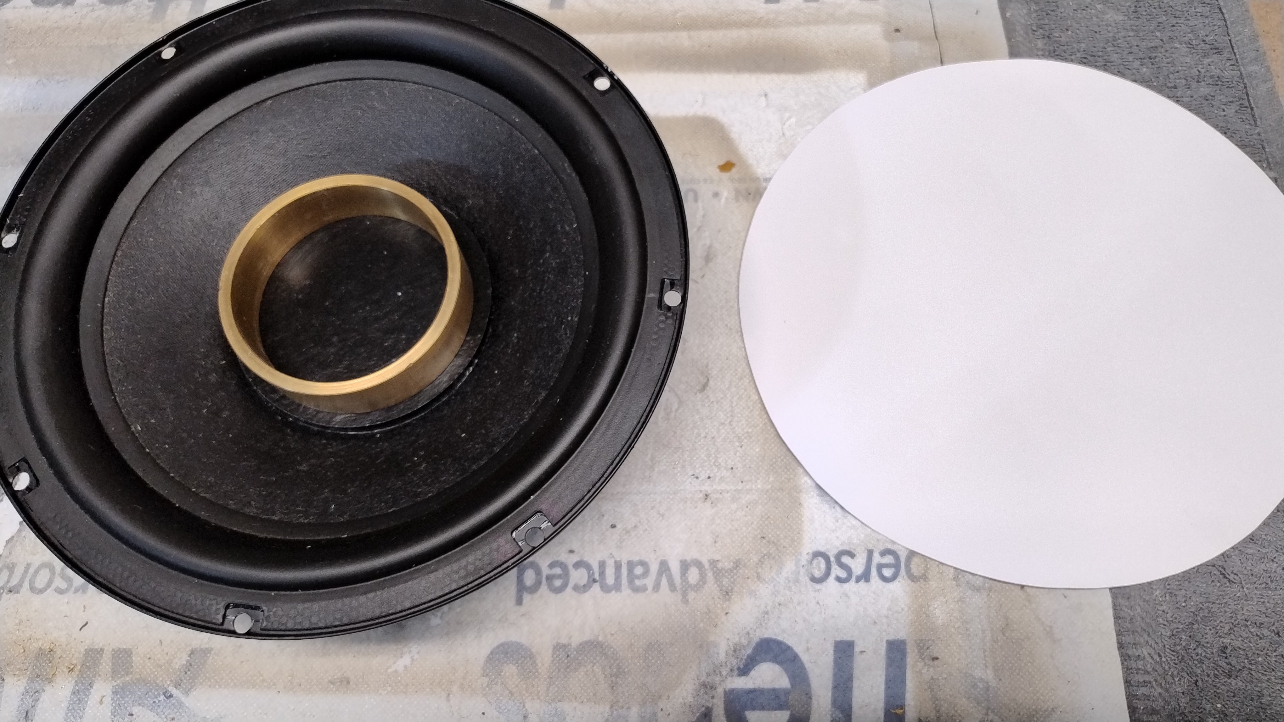

    I'm ecstatic to say the least after running sweep tests. The questionable 6511 is staying dead center at clearly over max excursion. I'd never play these that loud, but by eye sight I can see the cone base traveling a quarter inch or more both ways...
    xschop Posts: 5,677
    edited June 3
    Best vid I could do. This is after I turned volume down on amp too. Ran about 20 cycles on all drivers.The pop is in the bass tone recording at end.
    I believe a factory driver would have over extended and crashed the coil on the base plate...
    https://youtu.be/fGaQL44KR0Y?si=RJmNnSVw6ZOF302w

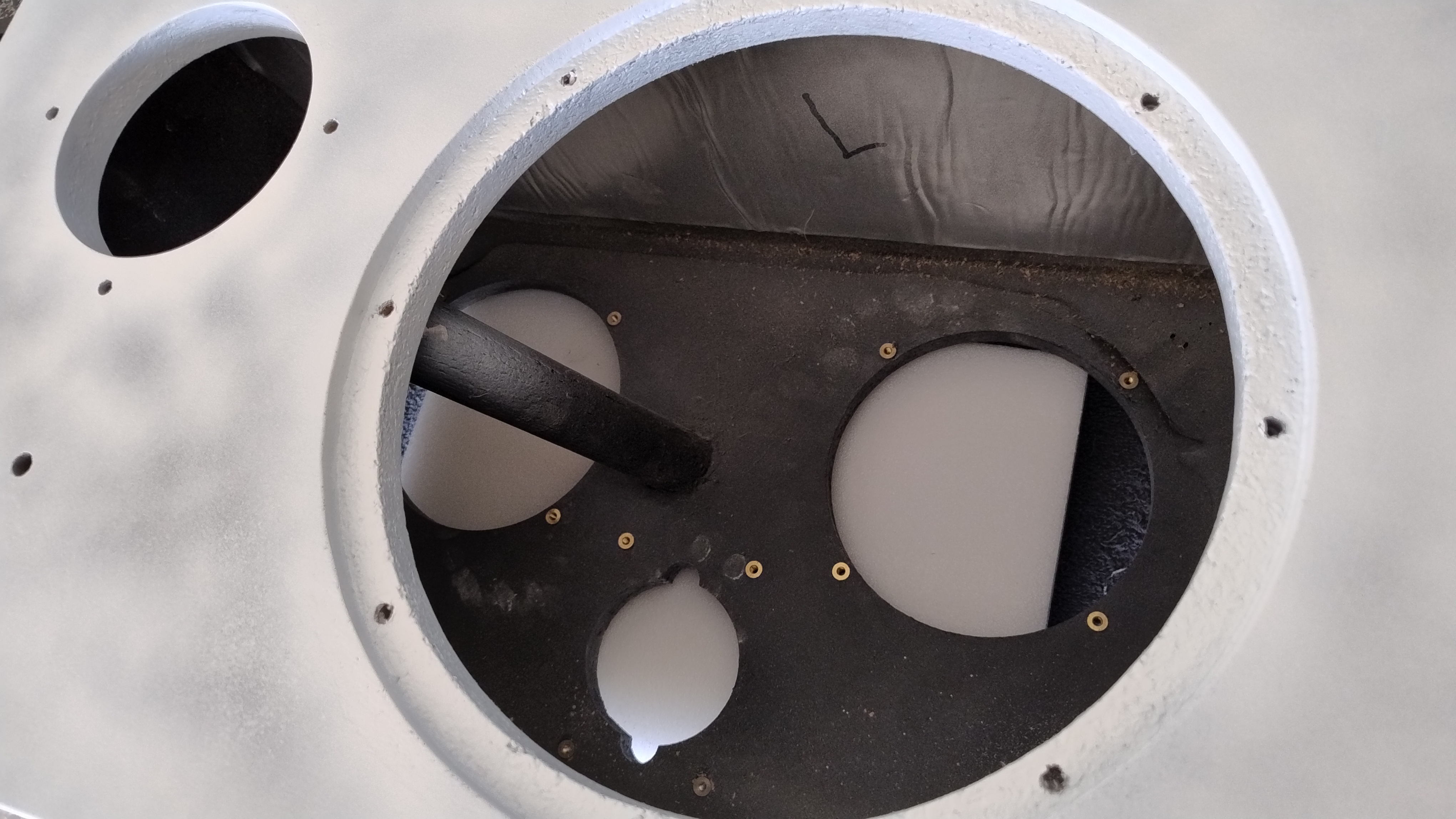

    Only thing I could work on today.

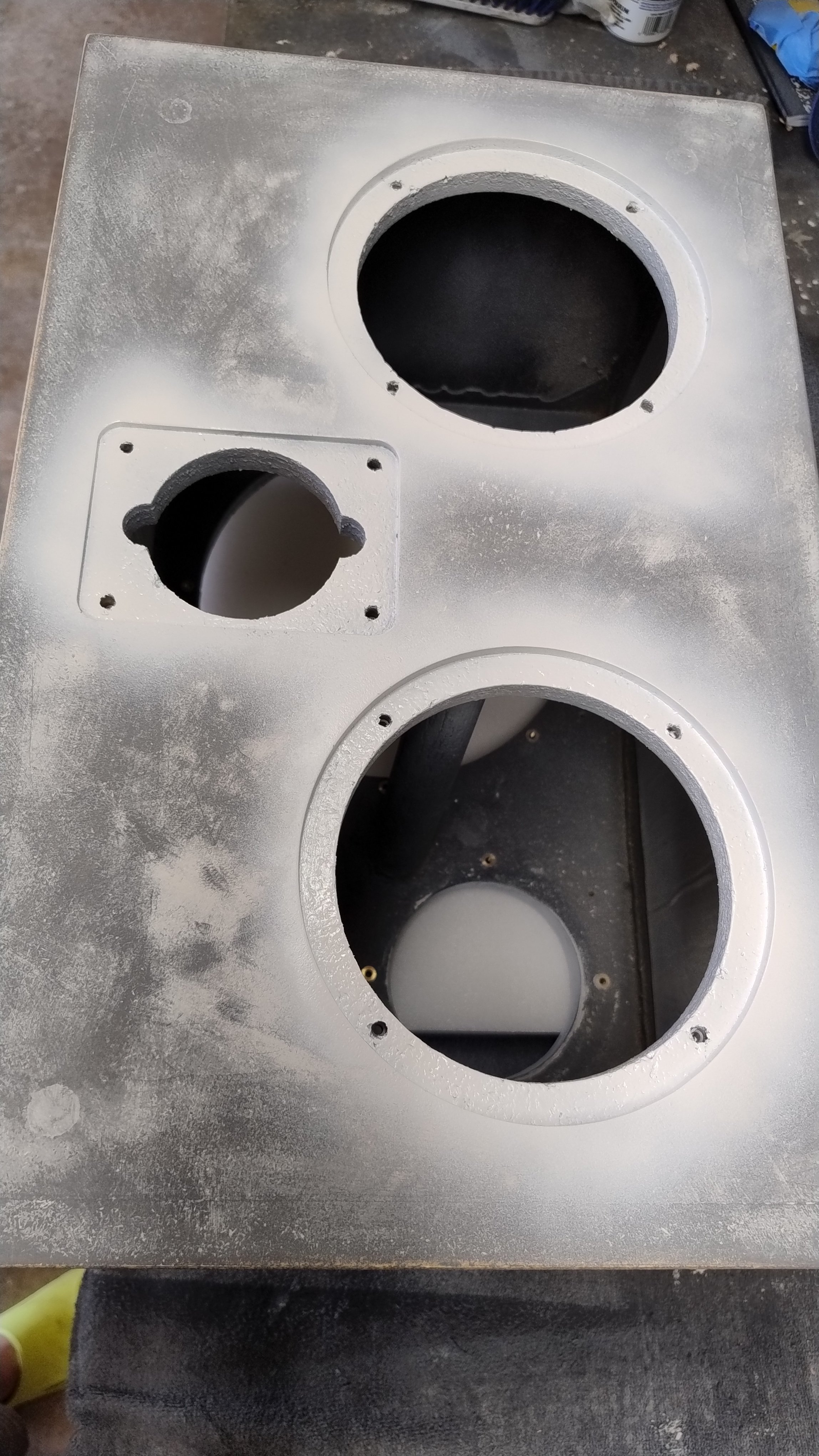

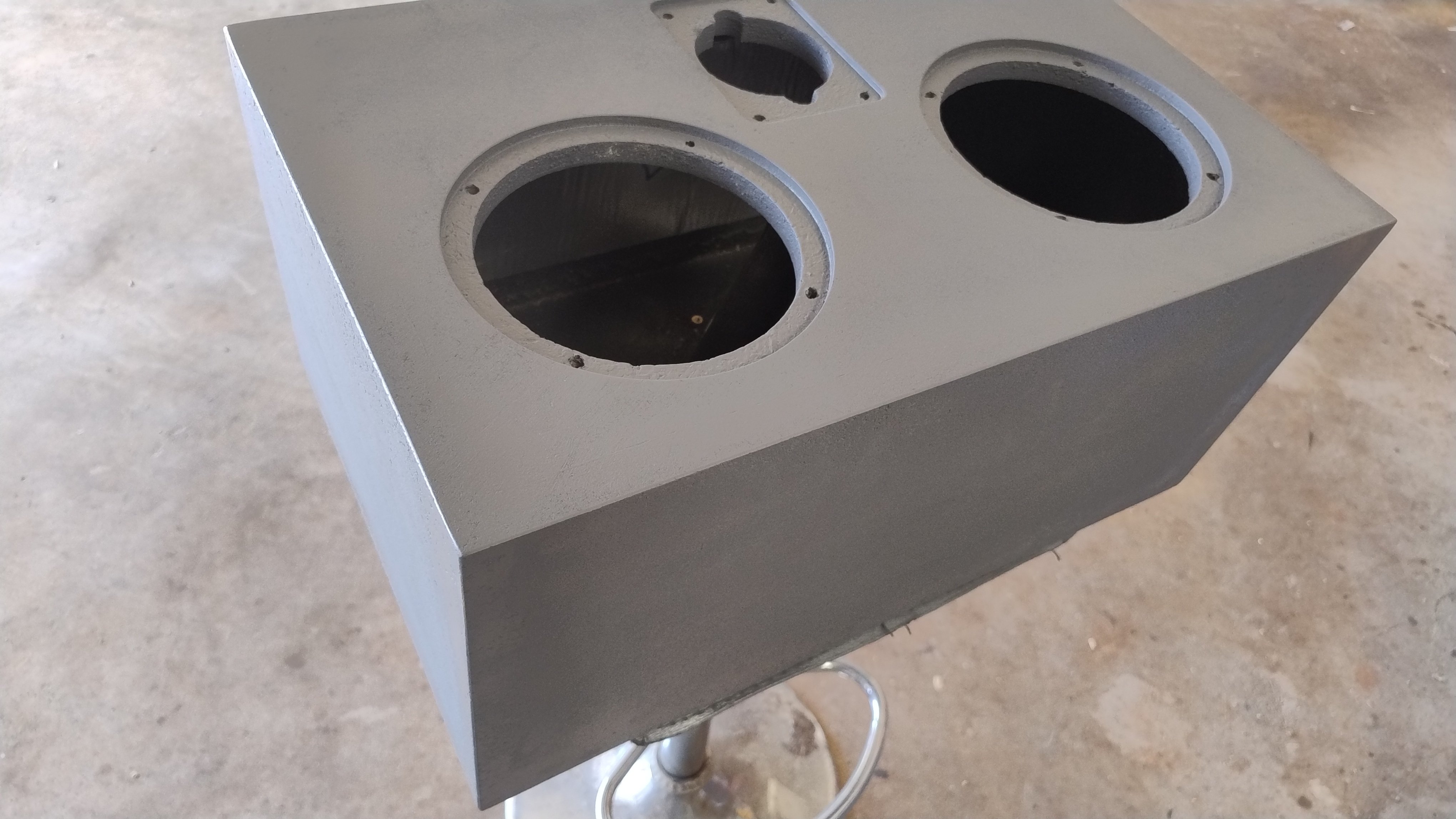

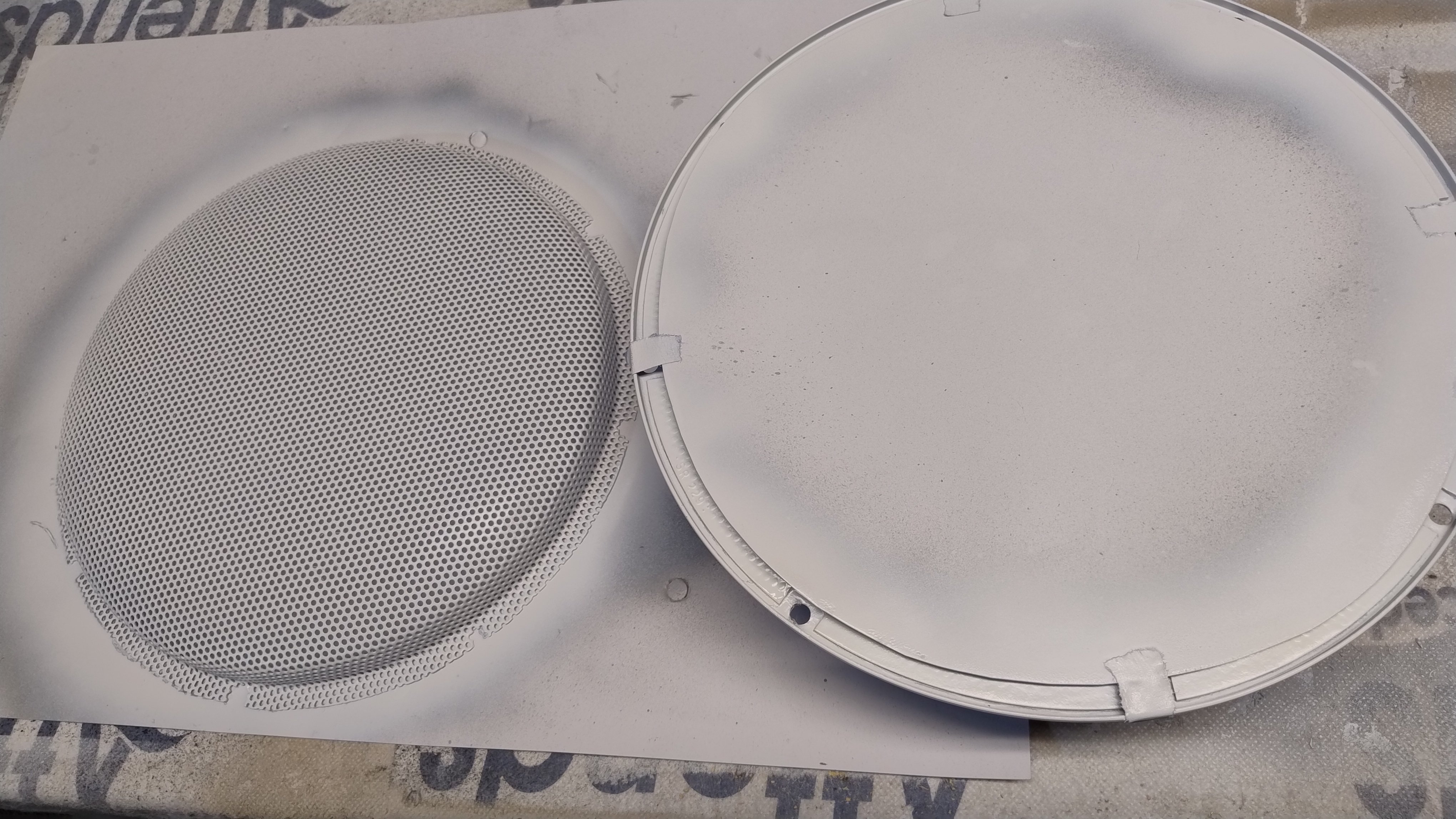

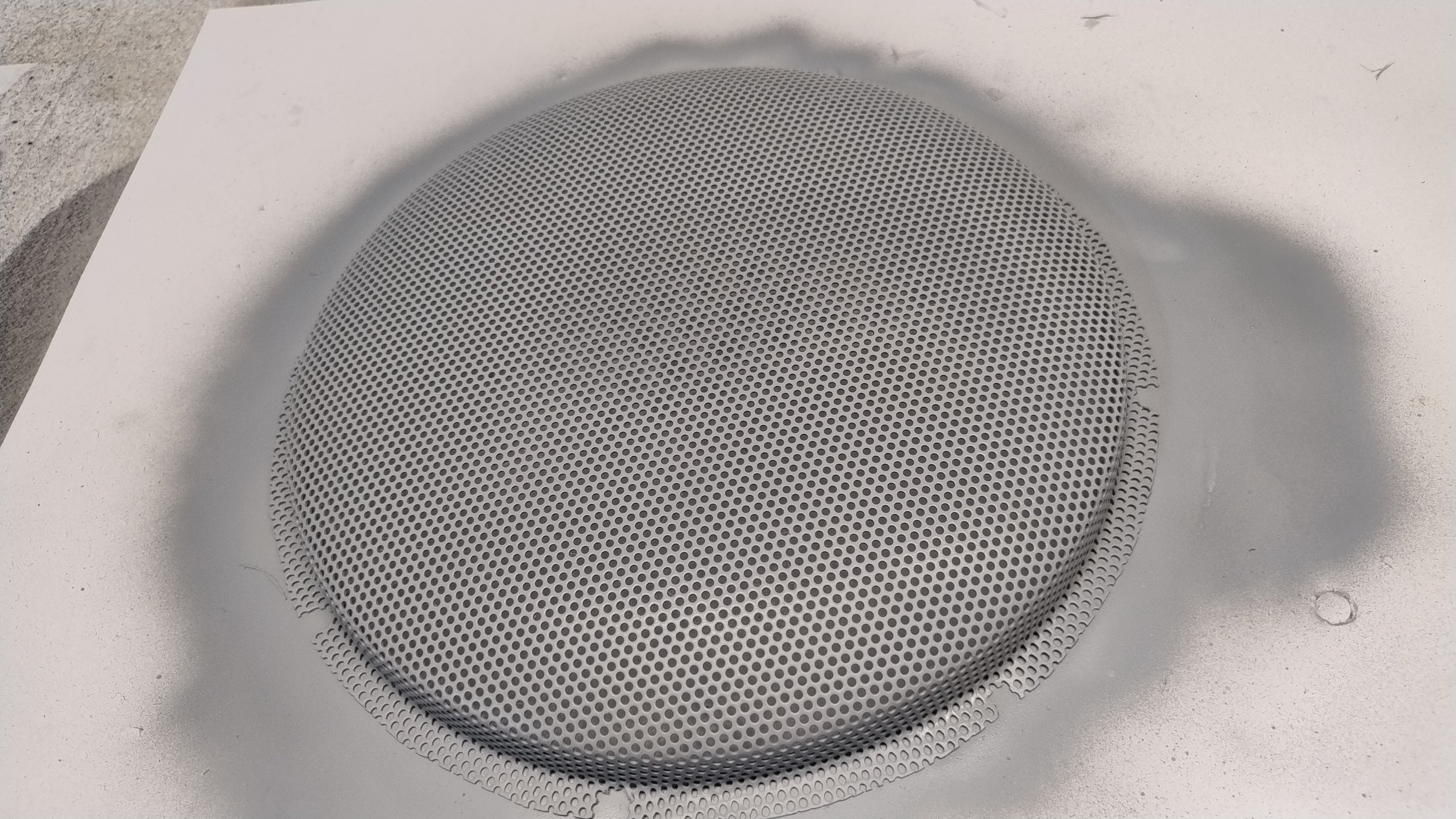

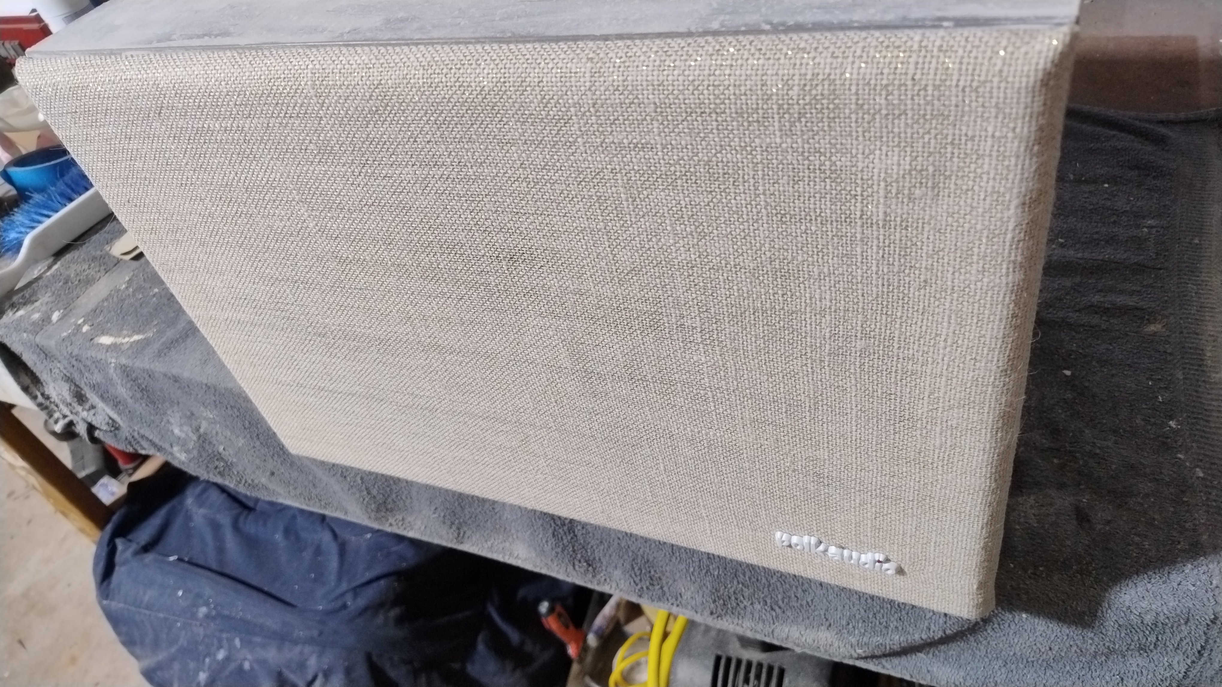

    Large upright belt sander cleaned up overhang of attached piece. Thick coat of flat white primer, then smokey beige hides the frame under the grill cloth nicely.
    I'll lightly Dremel the peg holes out like I did for the first one, then attach cloth...

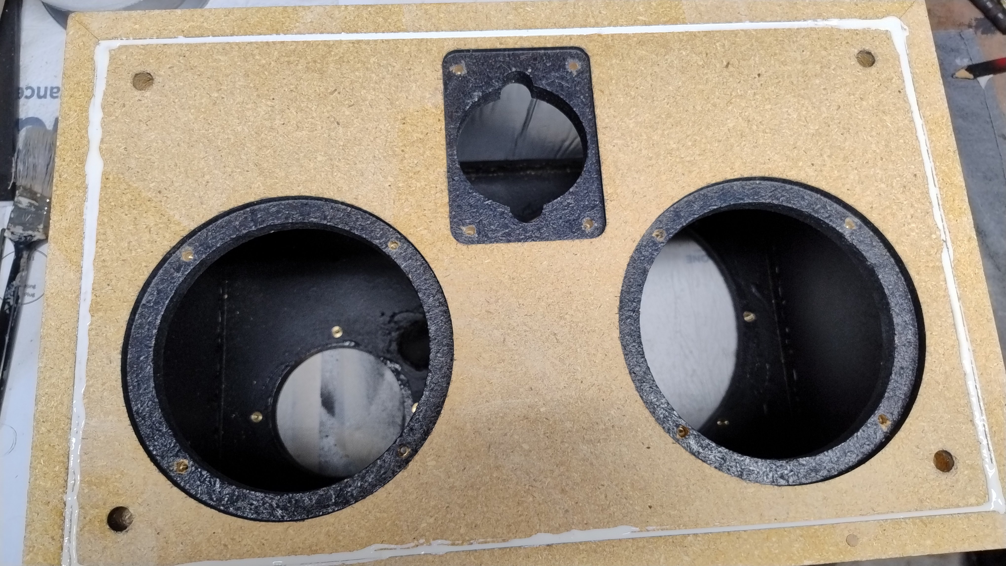

    xschop Posts: 5,677

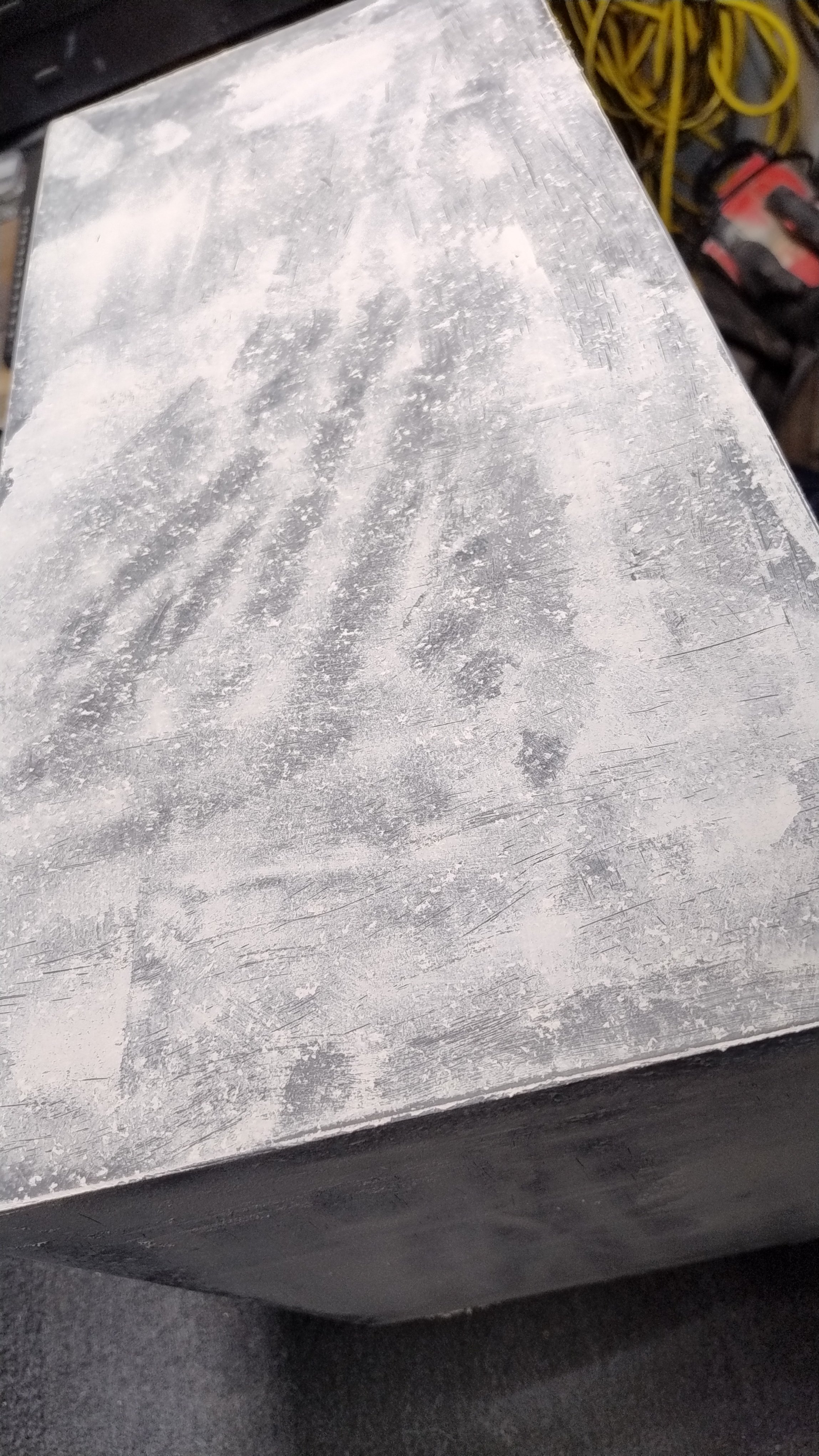

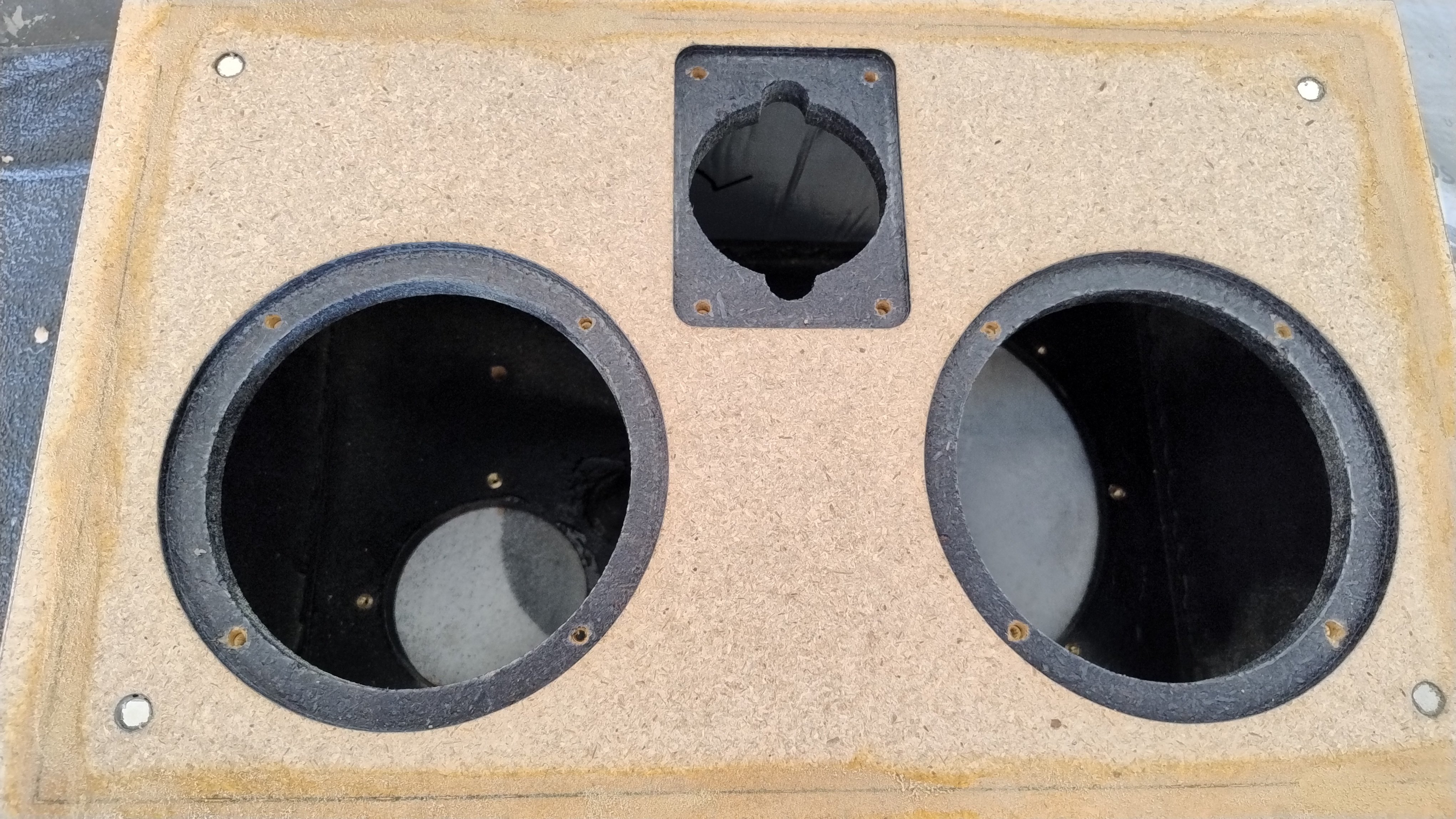

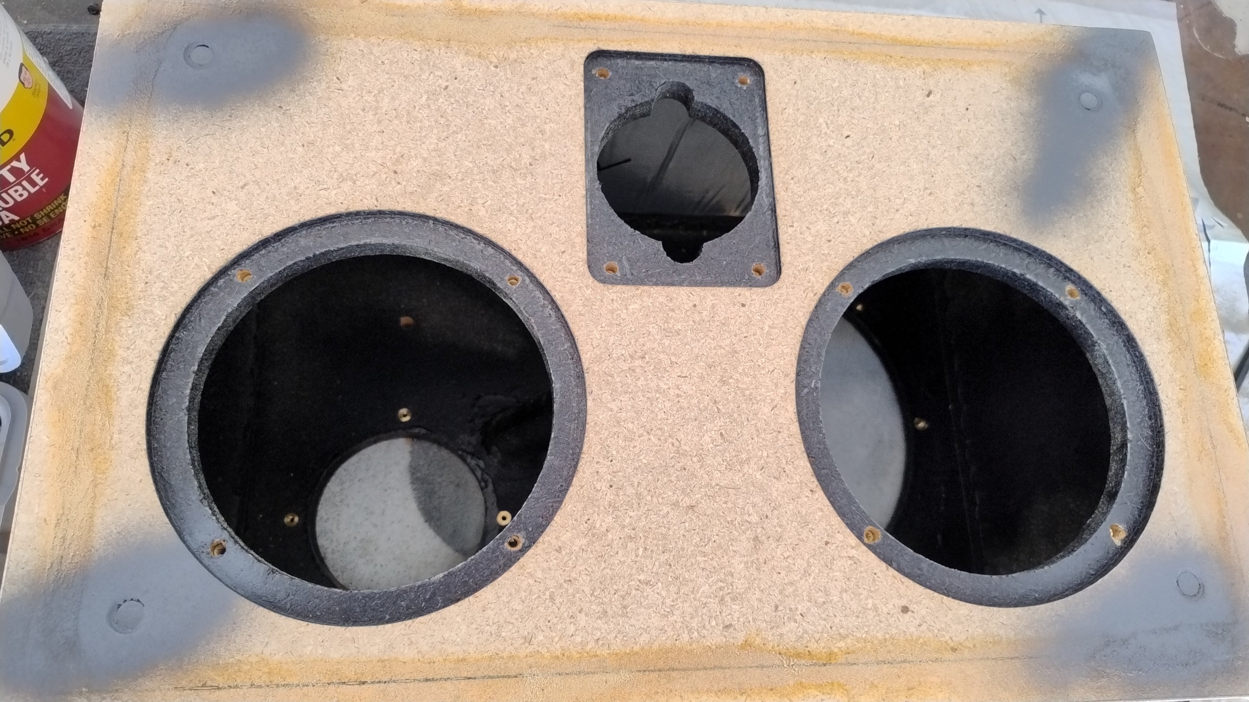

    Filled the seams before sanding this time....

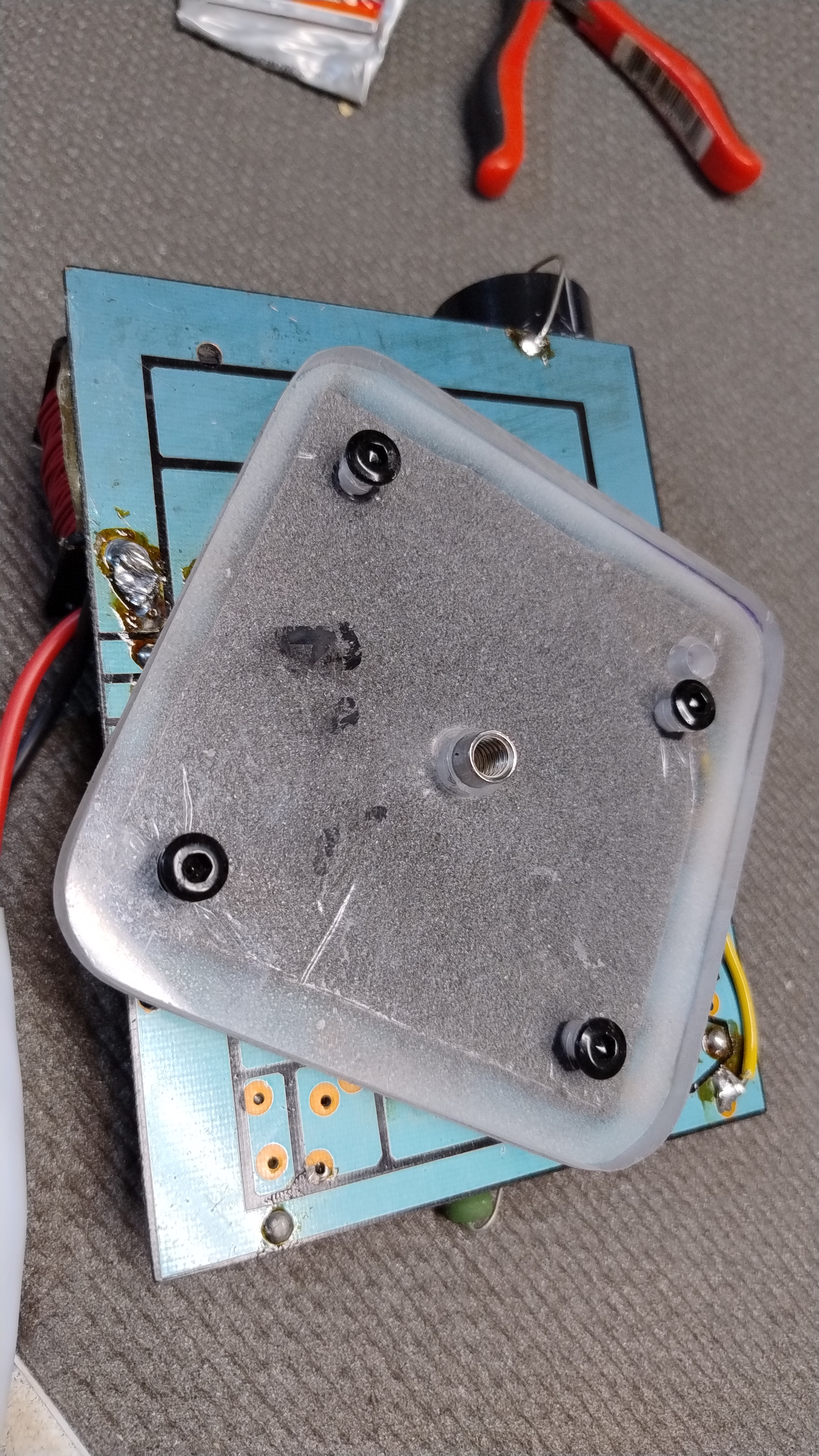

    xschop Posts: 5,677
    edited June 6

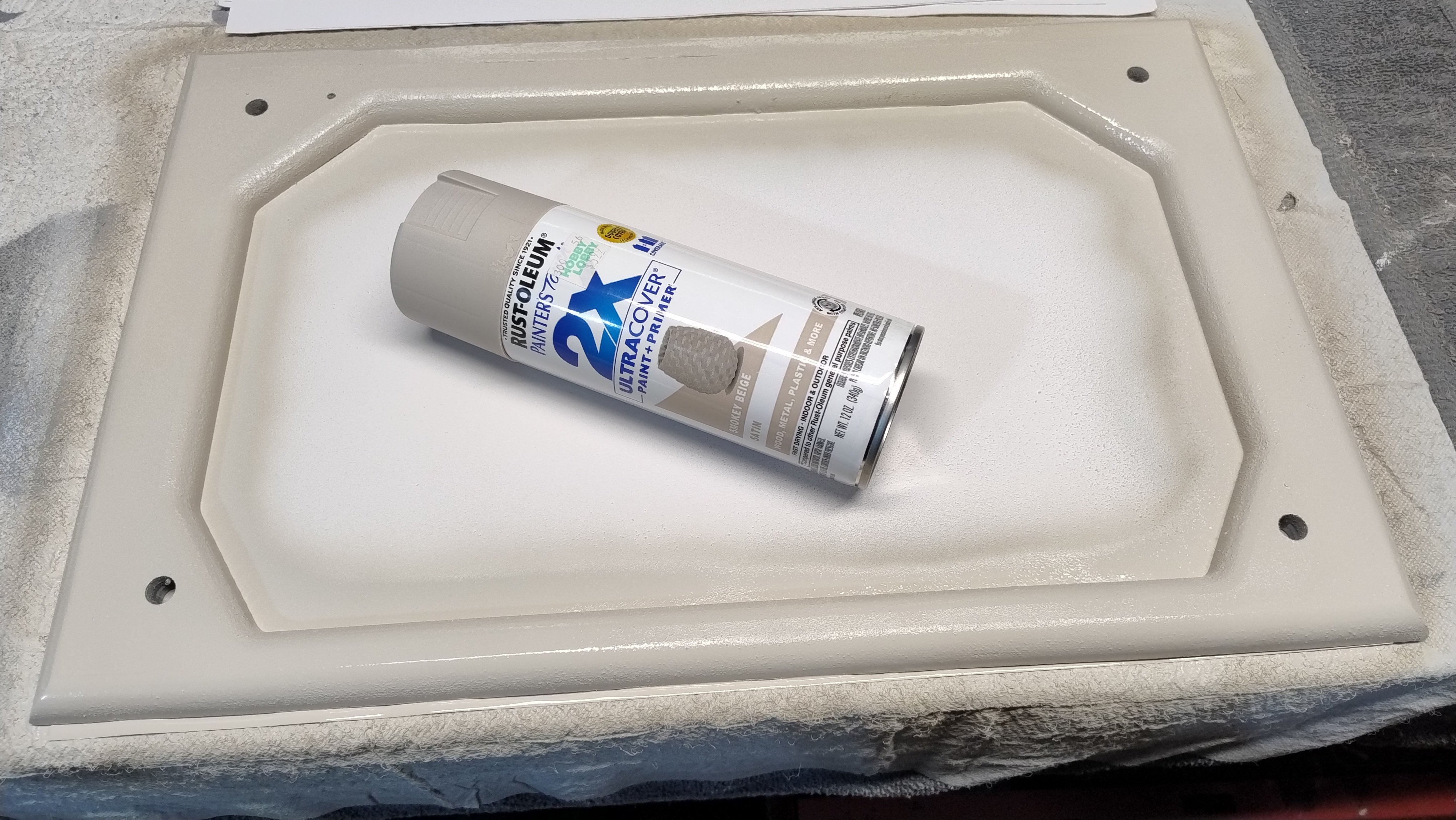

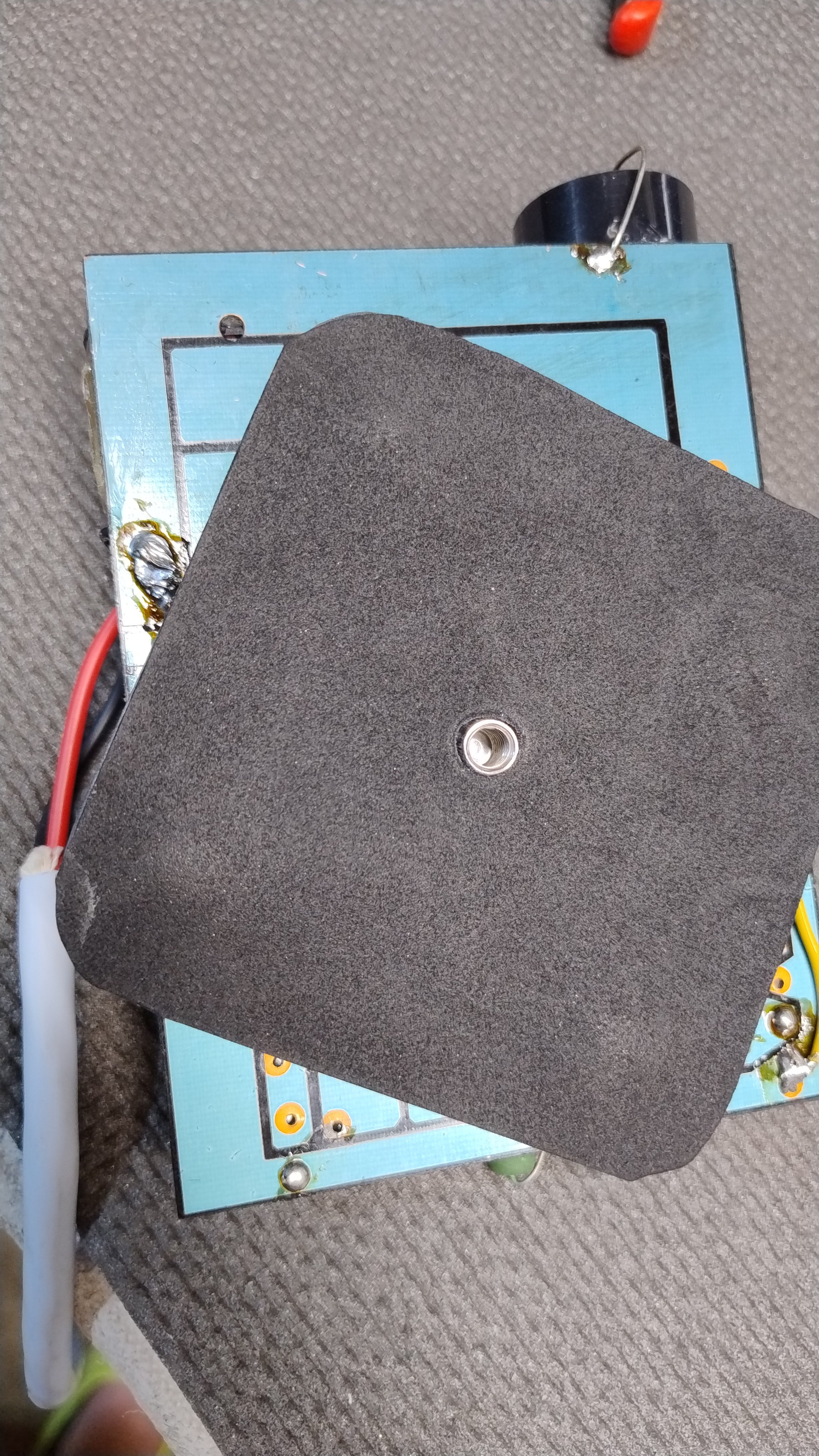

    All joking aside, I did tidy up the X-over adapter. The M4 standoffs were ideal (props to @pitdogg2)
    I had to redrill the plate to move one over to an adjacent hole because the original was too close to the pin terminal plastic housing to fit the nylon nut even.
    Added damping foam front(under compression) to back (1/8" PVA) so no vibes will rear their ugly head.
    I'll simply have to drill the factory location to 5/16" so the barrel nut is self-guided thru the rear baffle....

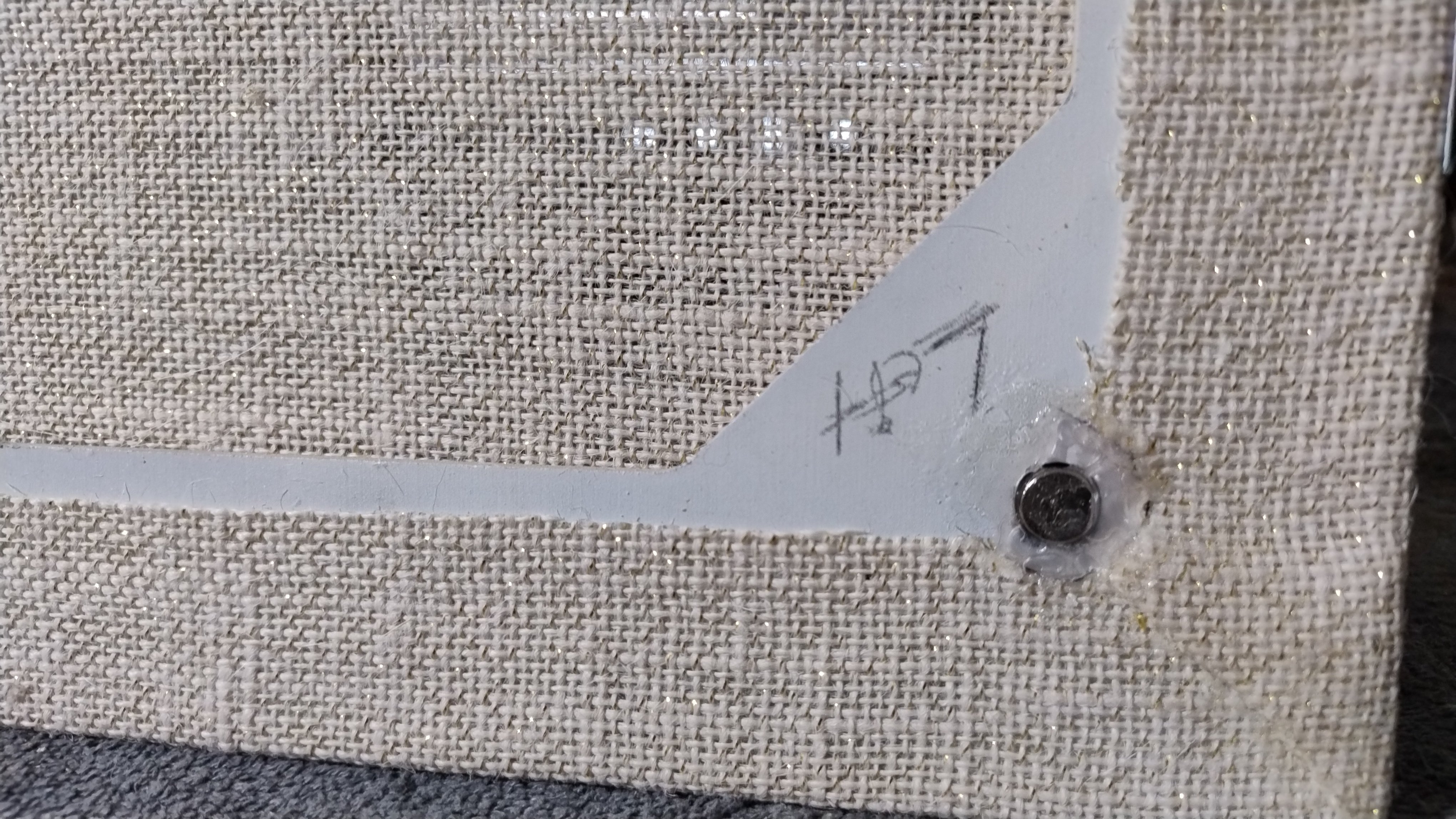

    Another midnight run. Detoxing from all the triglycerides.

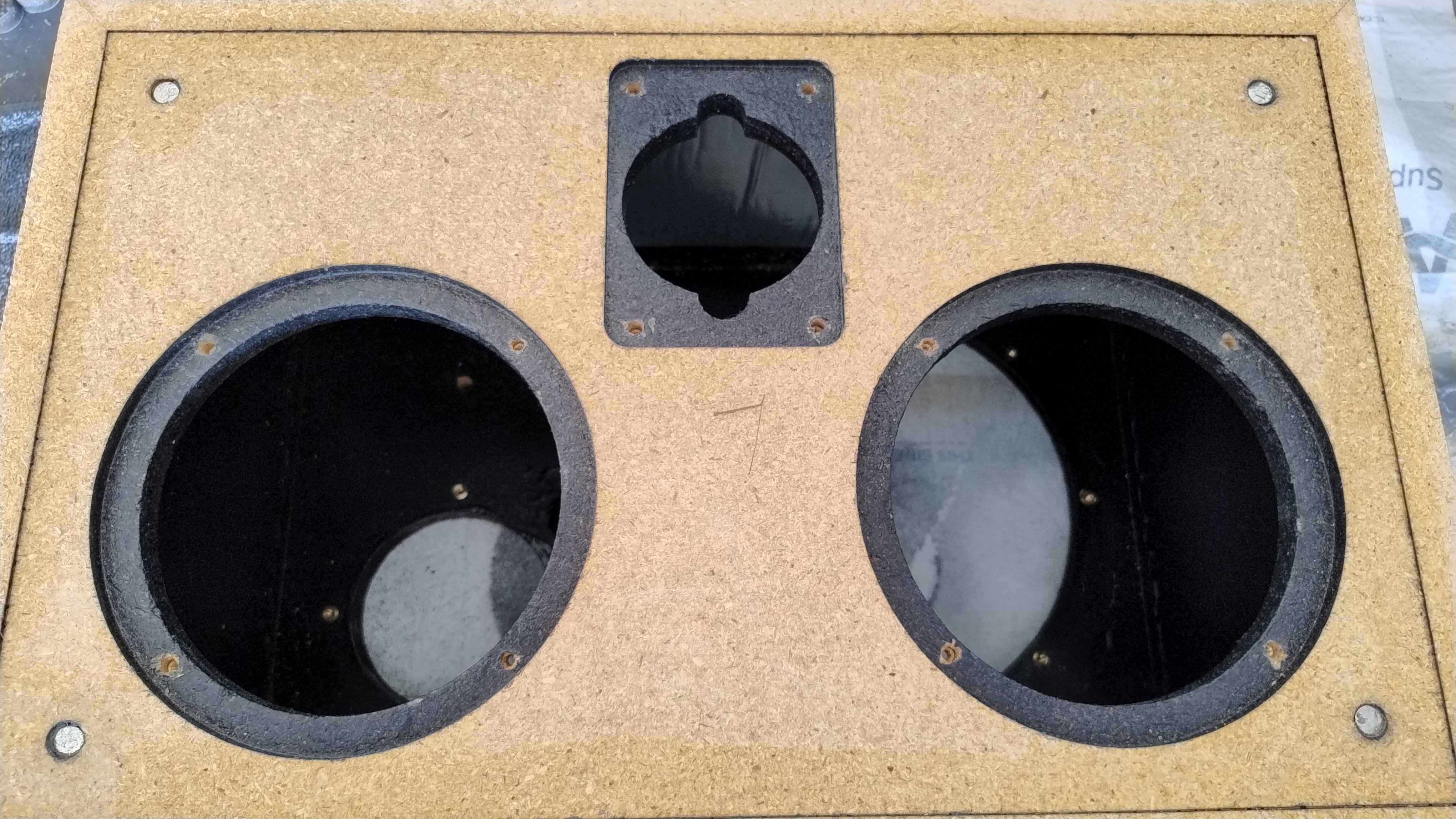

    Got one done. Had to dremel each slot corresponding to where Polk drilled each PR attachment hole. A couple were slightly off from each other. Joy...
    I can't see the black PR thru it was goal...

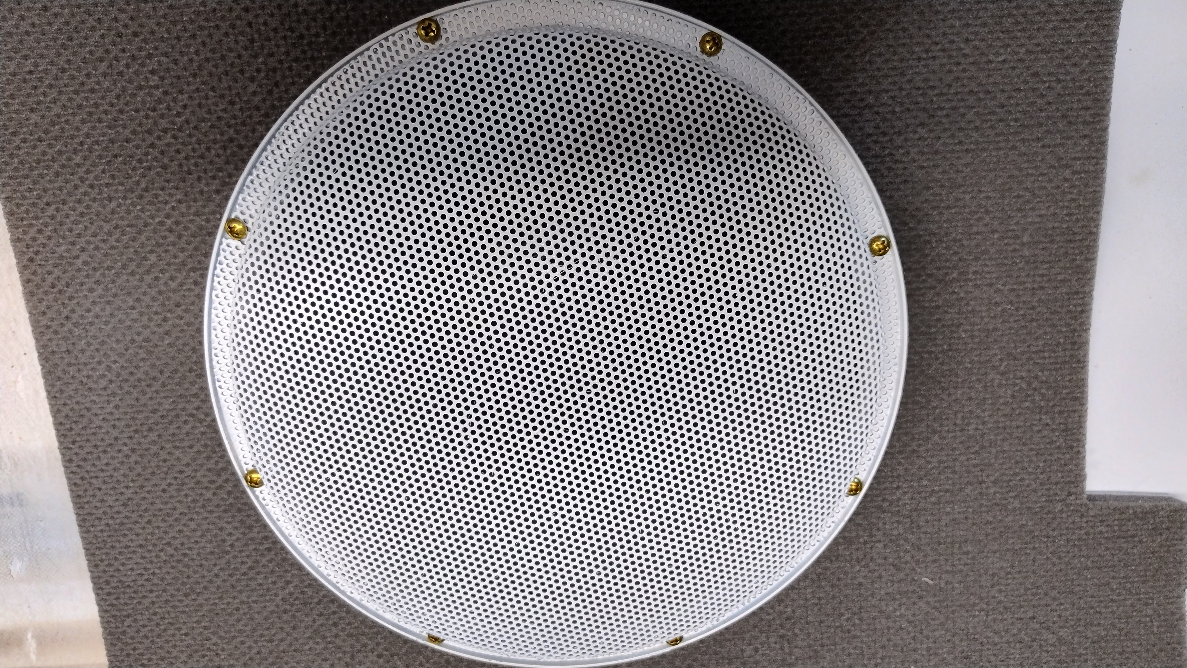

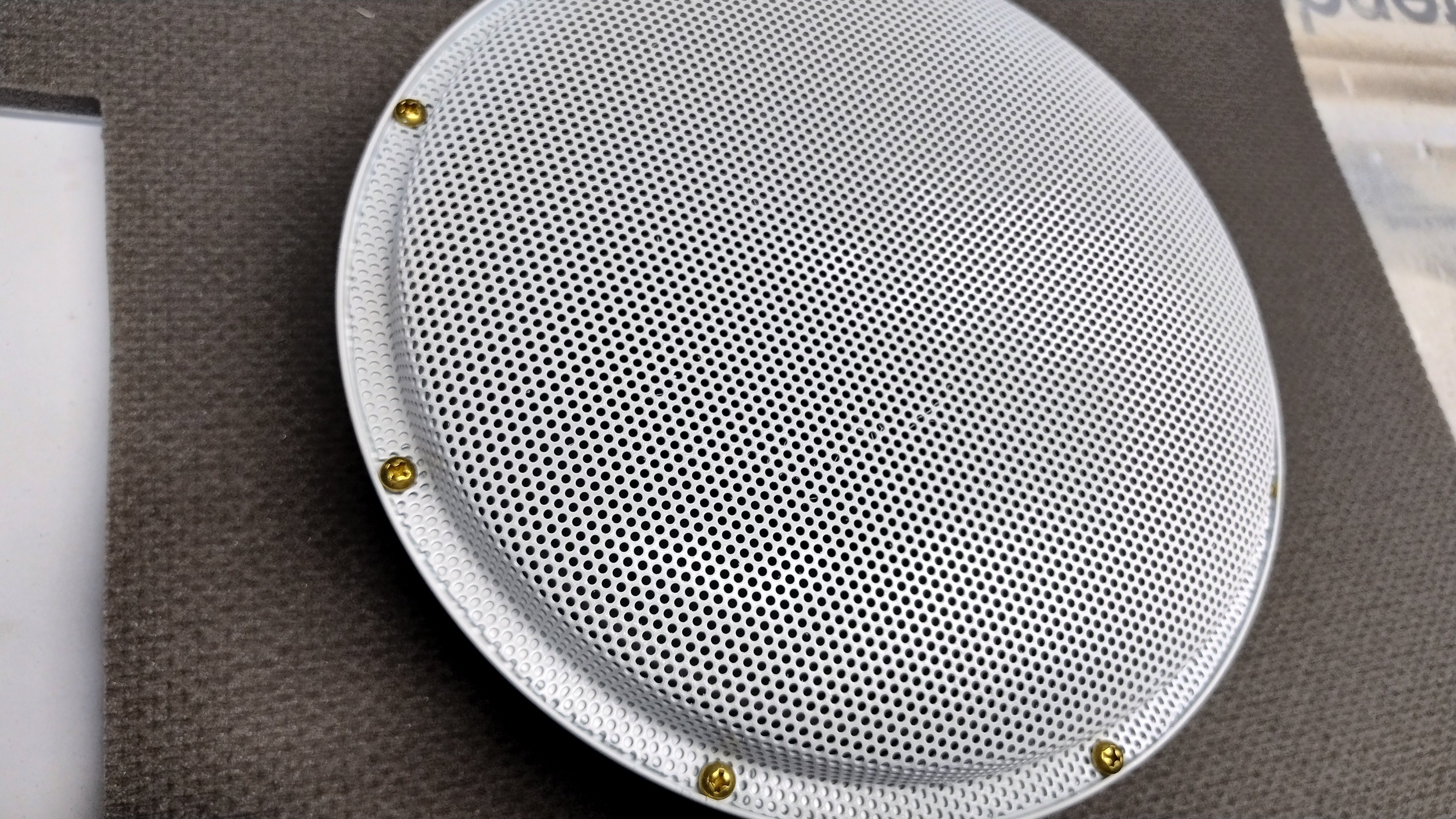

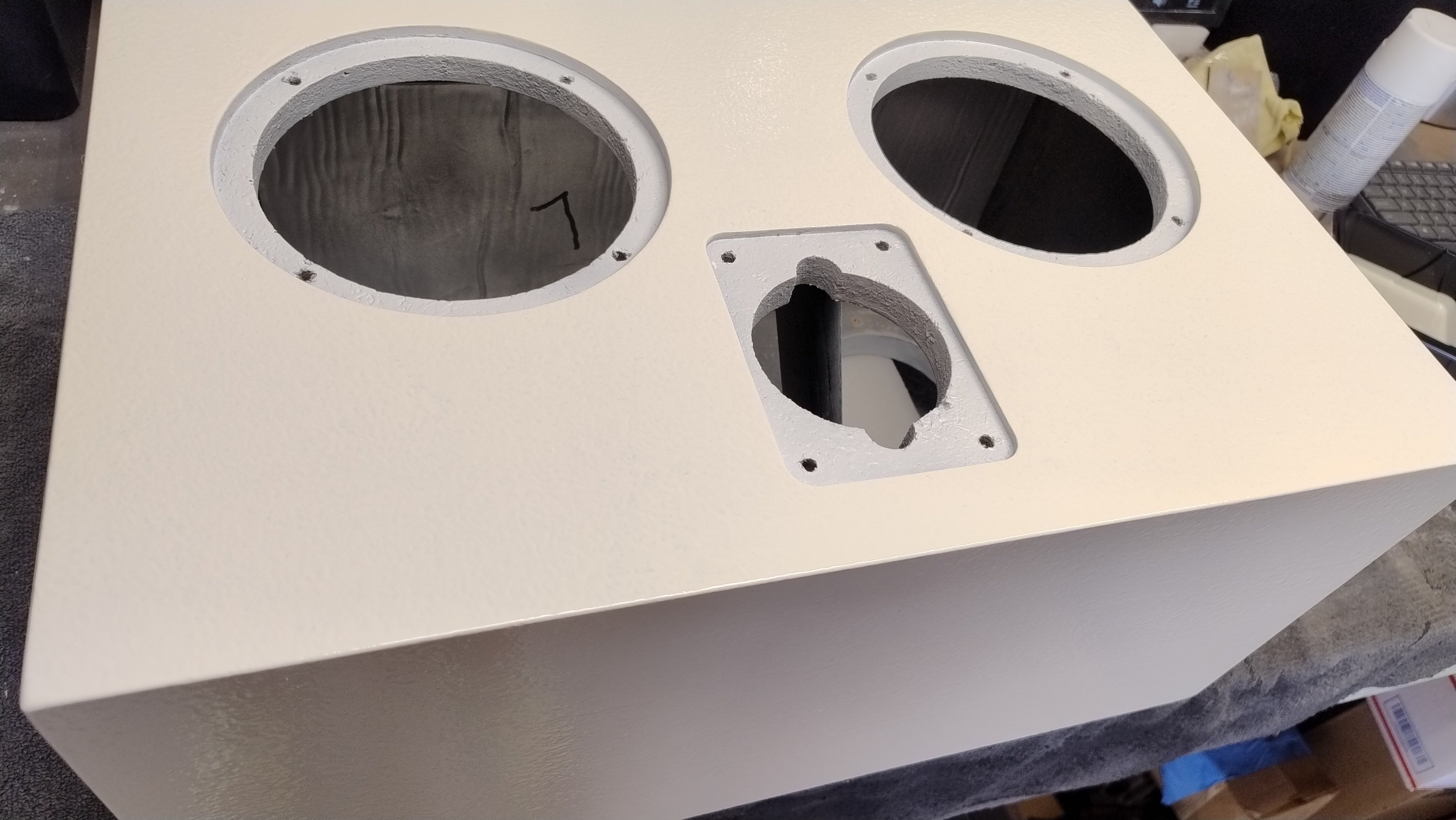

    xschop Posts: 5,677
    edited June 10

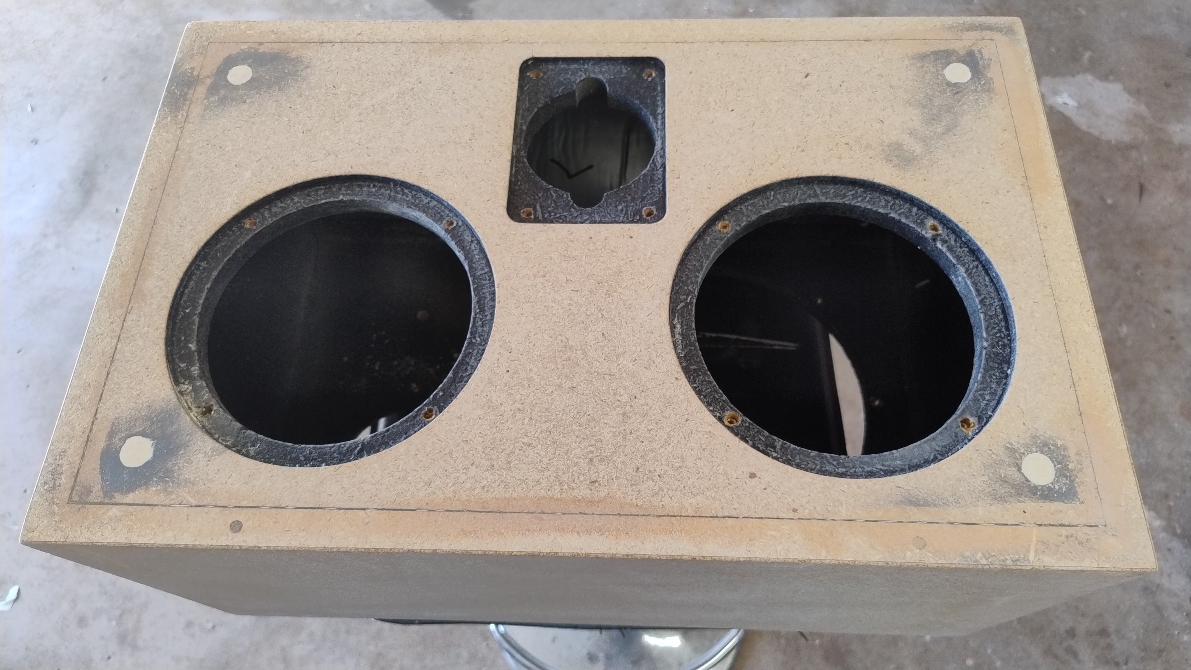

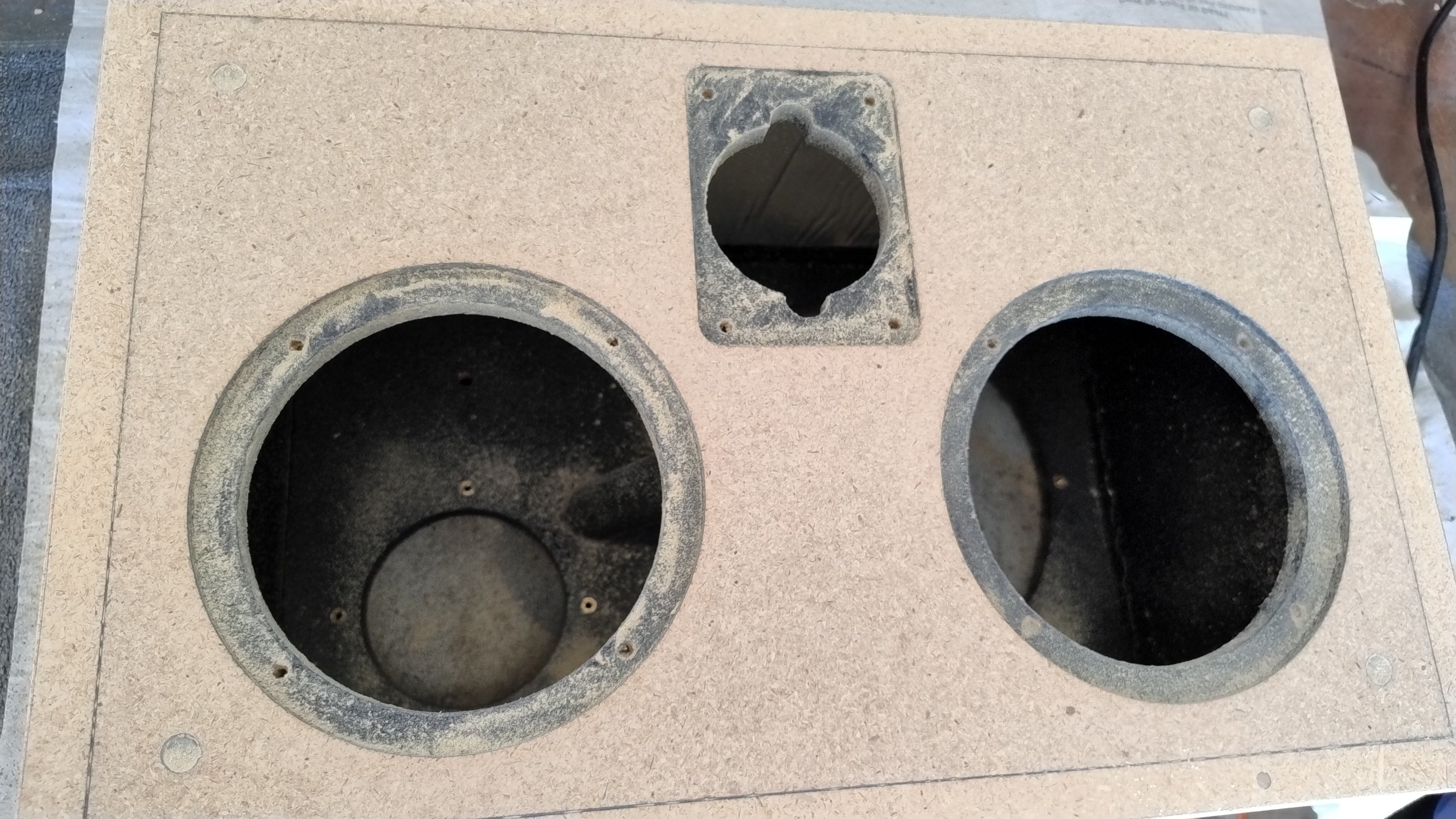

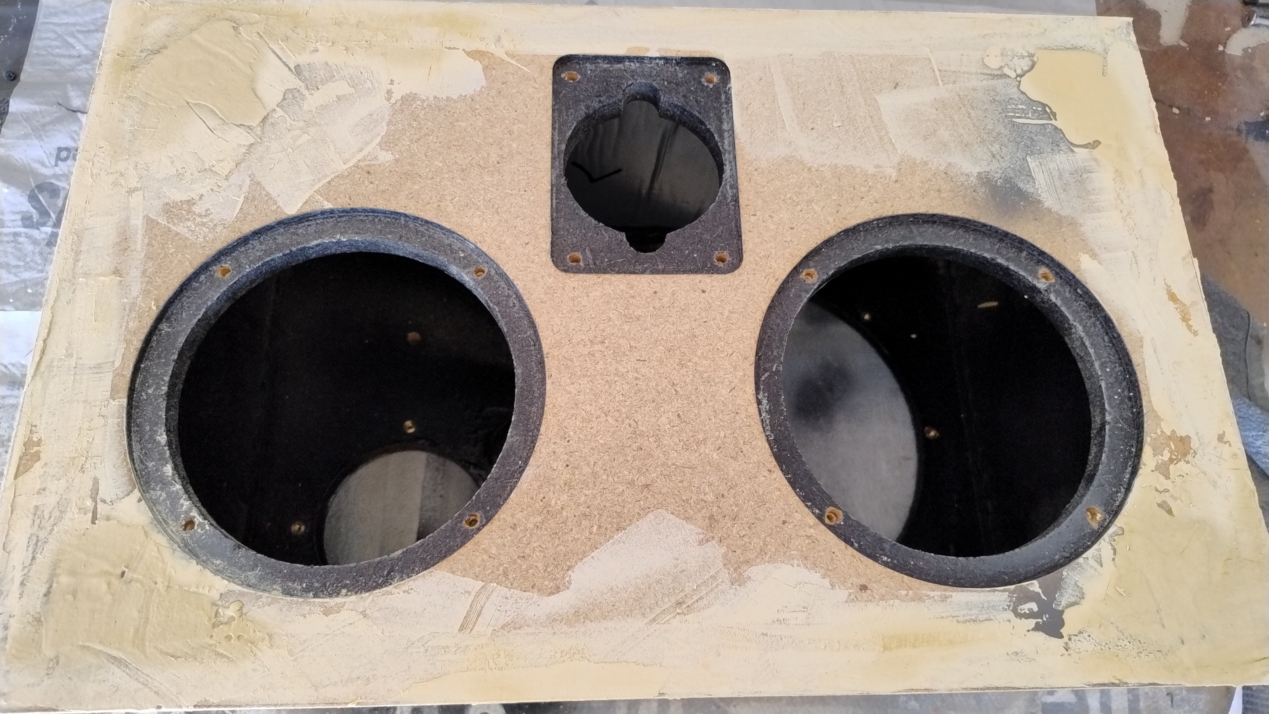

    Was on fence, so went with @VR3 suggestion for magnet attachment since I'll be listening to them with grills off most the time. Polk relied HEAVILY on the larger plastic grill pegs compression as their drilling/matching of grill holes to baffle peg centers were also not accurate.
    3/8" cylindrical neodymiums glued in countersurface by @1/8 depth so I can fill and hide them.
    Just remembered why I preferred metal shop over wood shop. A lot of prep work. I decided to give them a 1/16" round over for looks and better paint adhesion.

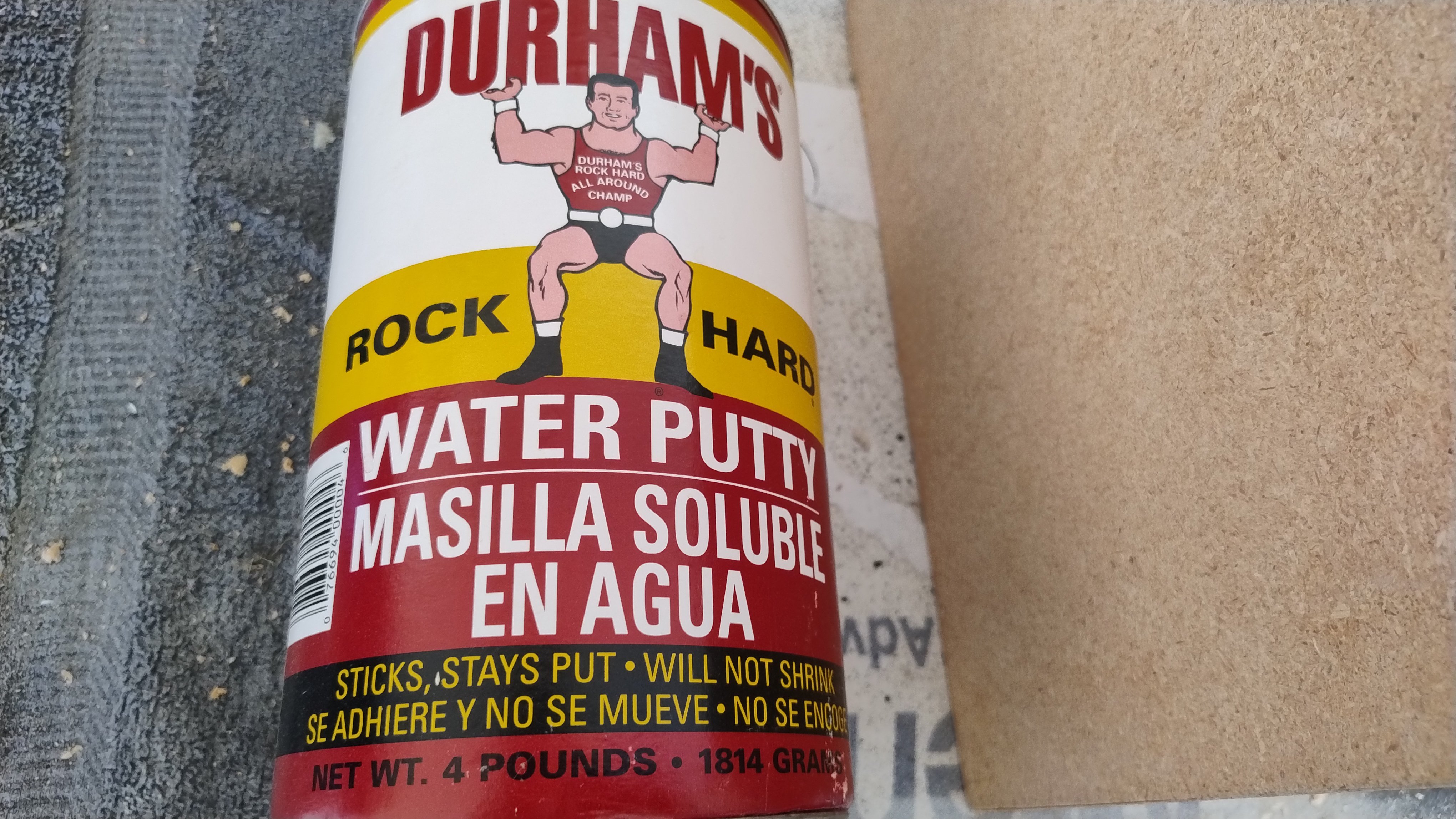

    @F1, forgot I had this tucked away from the shop speaker build years ago... Will fill in the mag holes...
    Post edited by xschop on
    F1nut Posts: 52,182
    I've never used that product.
    pitdogg2 Posts: 27,618
    I've used it several times. It worked very good for my projects.
    xschop Posts: 5,677
    Takes a couple hours to fully dry being water based, but equivalent to bondo on hardness I remember...

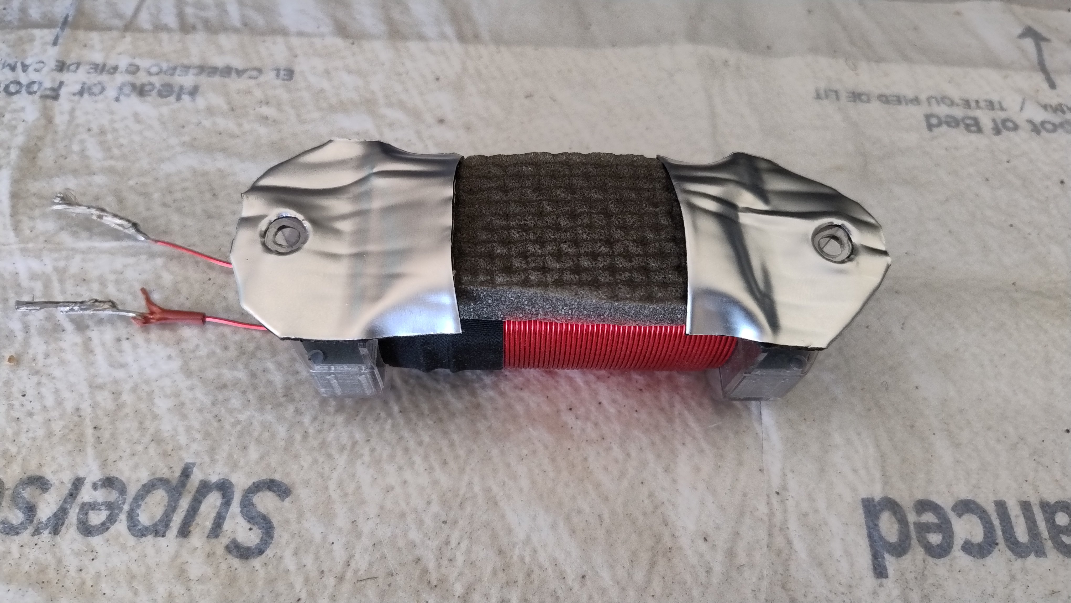

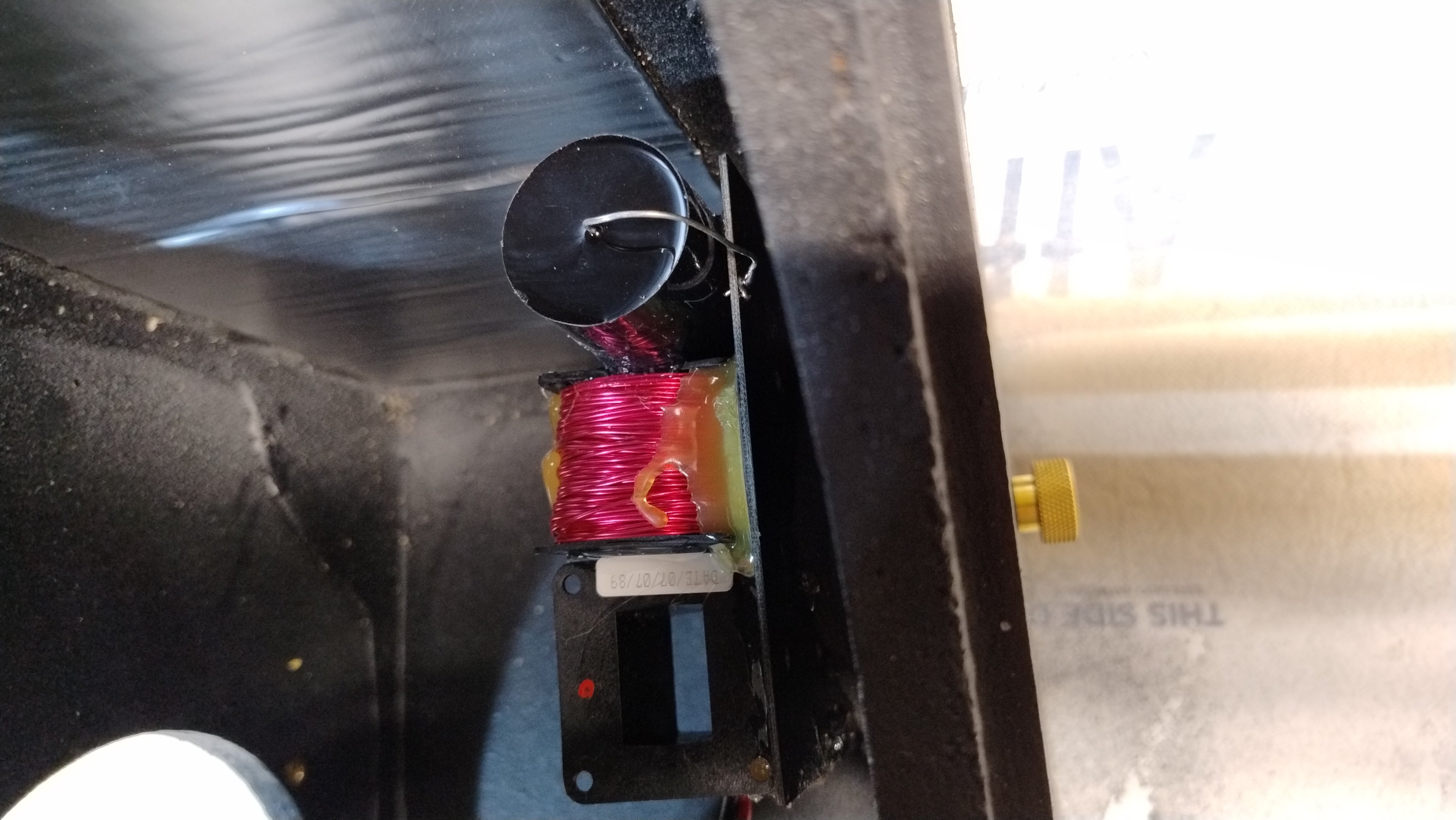

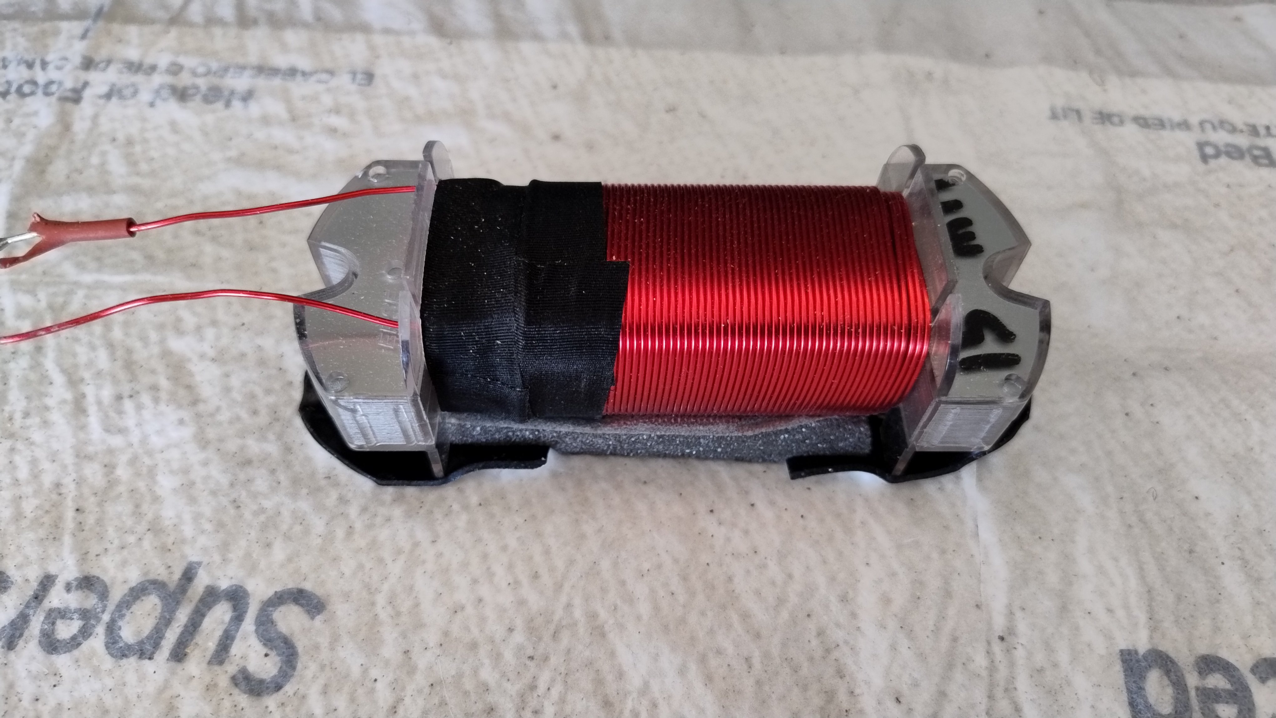

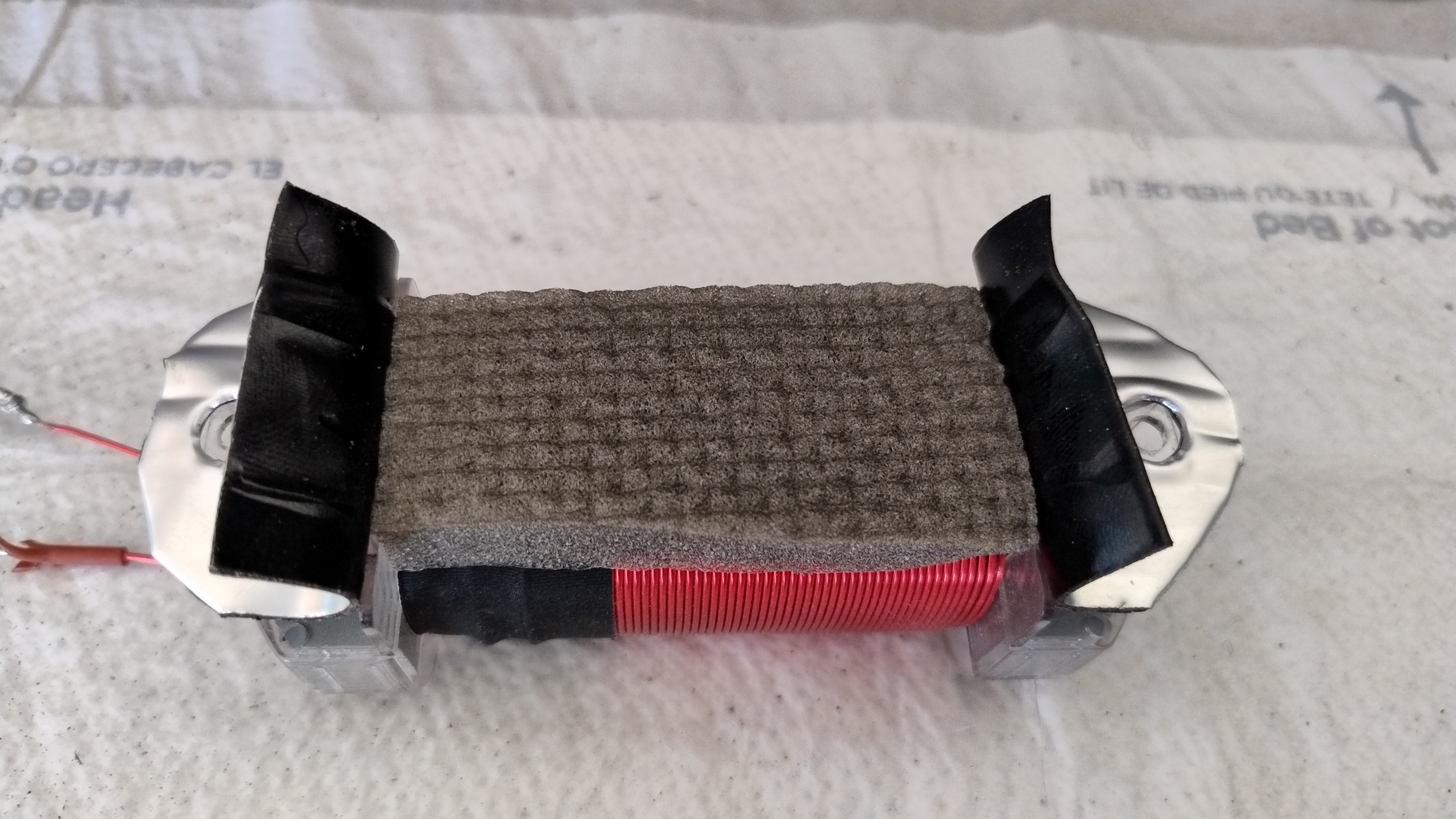

    While that's drying, prepping Erse inductors so there's no vibes going on as they only mount with 2 small screws...

    Can barely see the indention of the magnets. Should only need a 2nd coat of primer then light sand and they are incognito...

    xschop Posts: 5,677
    Final fill of all dimples....and 400 grit sand tomorrow then final primer....
    These little guys are heavy and can still pick up with the cross-brace and shake....

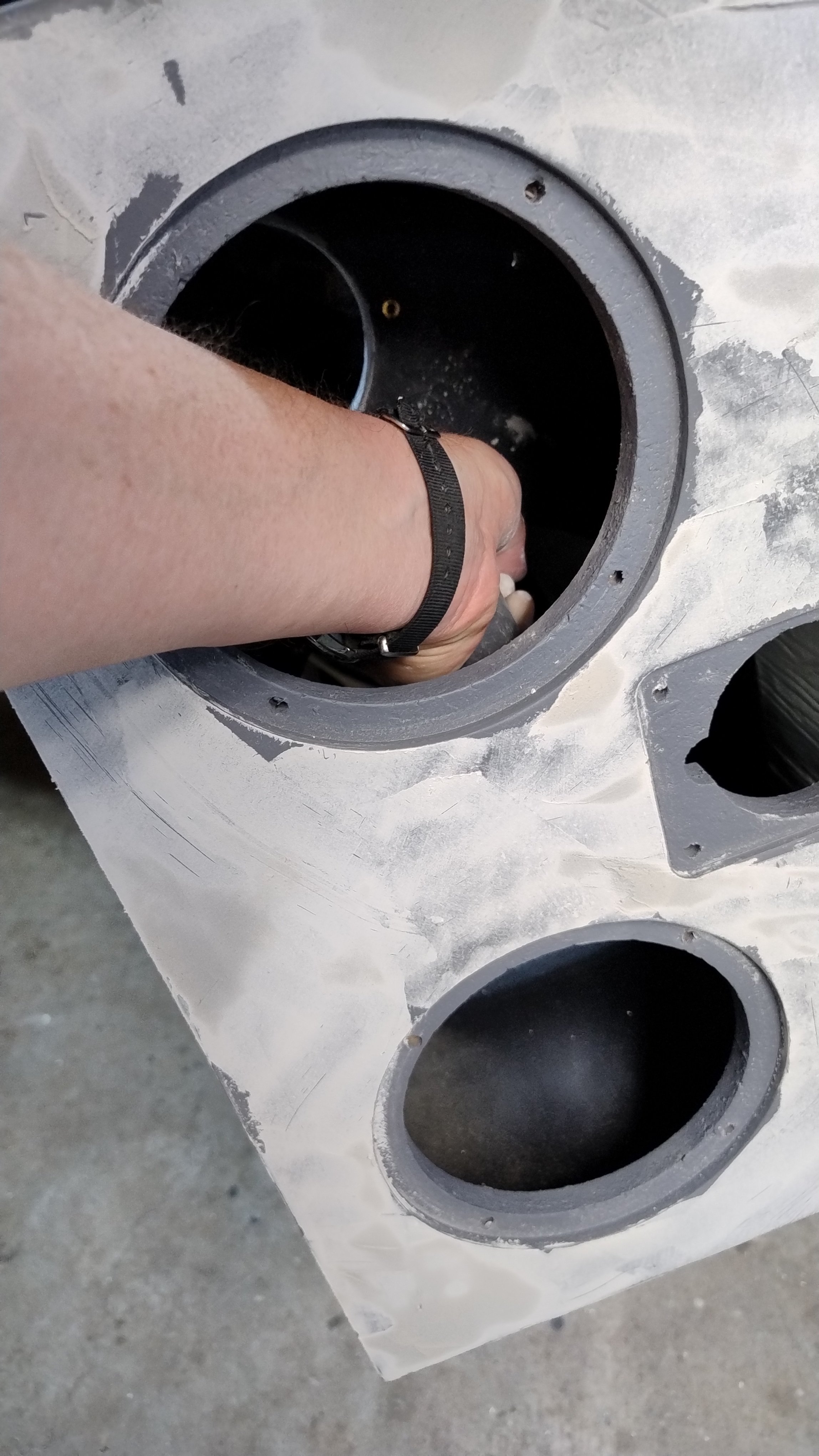

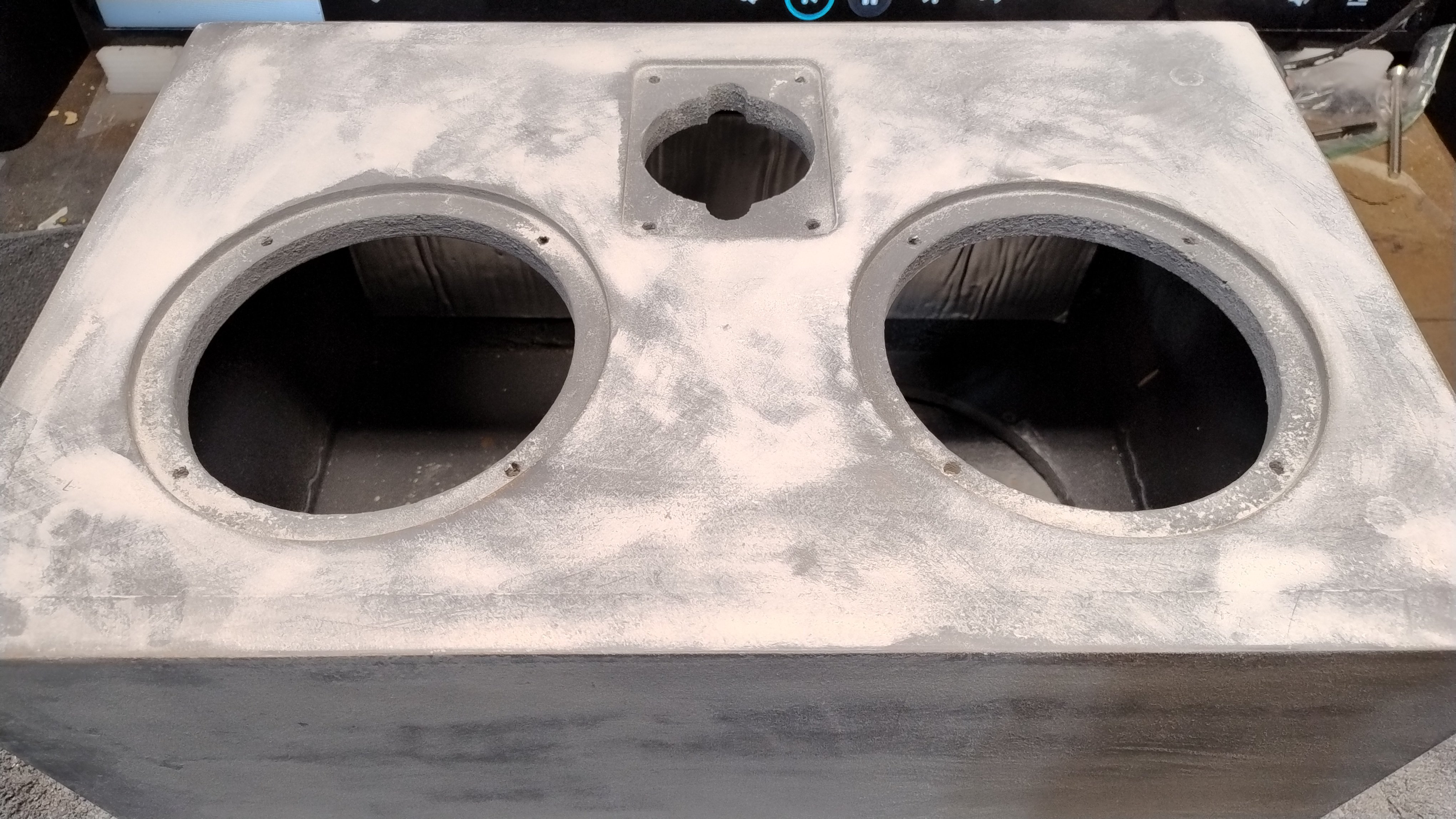

    Shook out the drywall crumbs and demonstrated brace/Powergrab effectiveness B)
    Not needed here, but a set of reinforcement semi-rings would only need to go left/right top of the MWs in any CRS without a brace.
    xschop Posts: 5,677

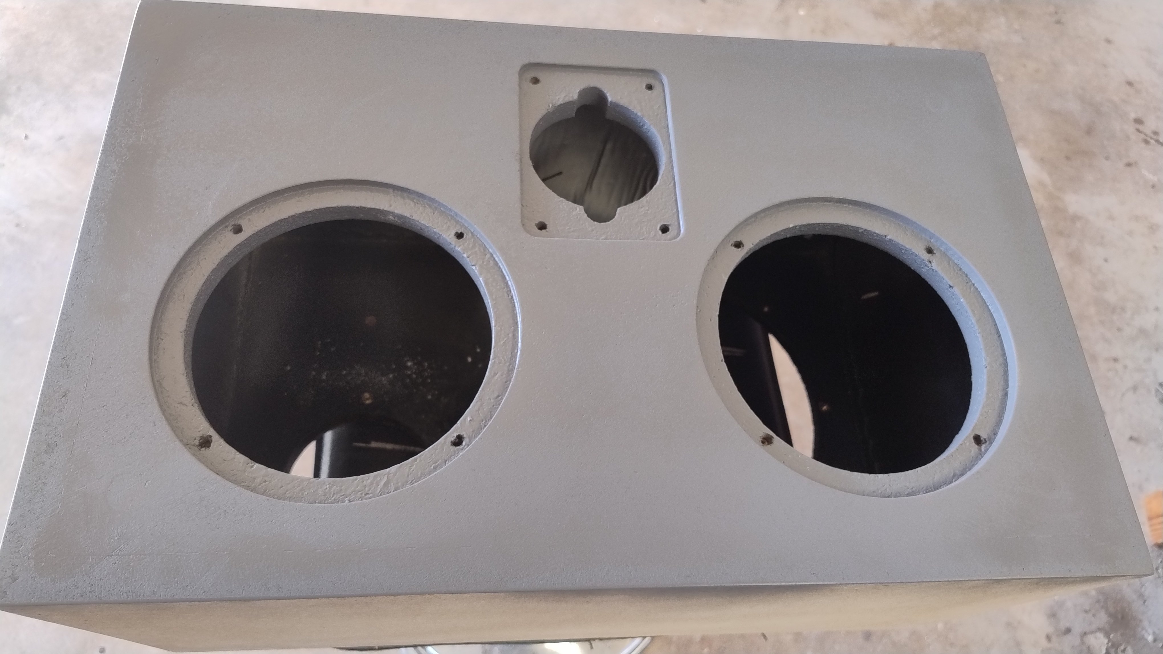

    Final sand and test fitment. The 3/8" barrel neodymiums are solid...

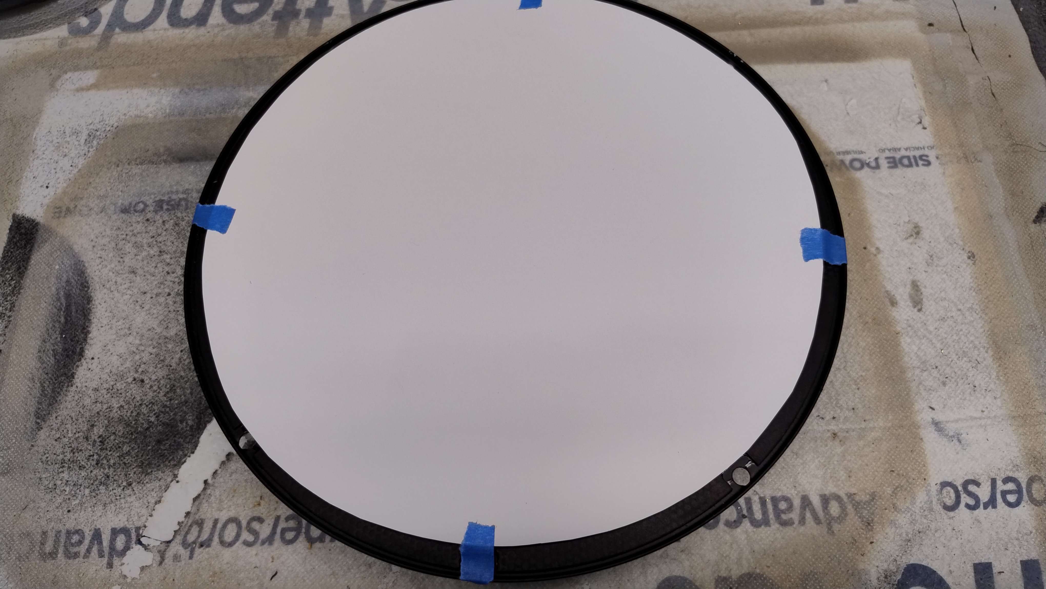

    Final coat of flat-white primer just for the driver insets...
    xschop Posts: 5,677
    edited June 12
    Found 1/4 gallon tucked away from last home touch-up. 1st coat and I like that hue....
