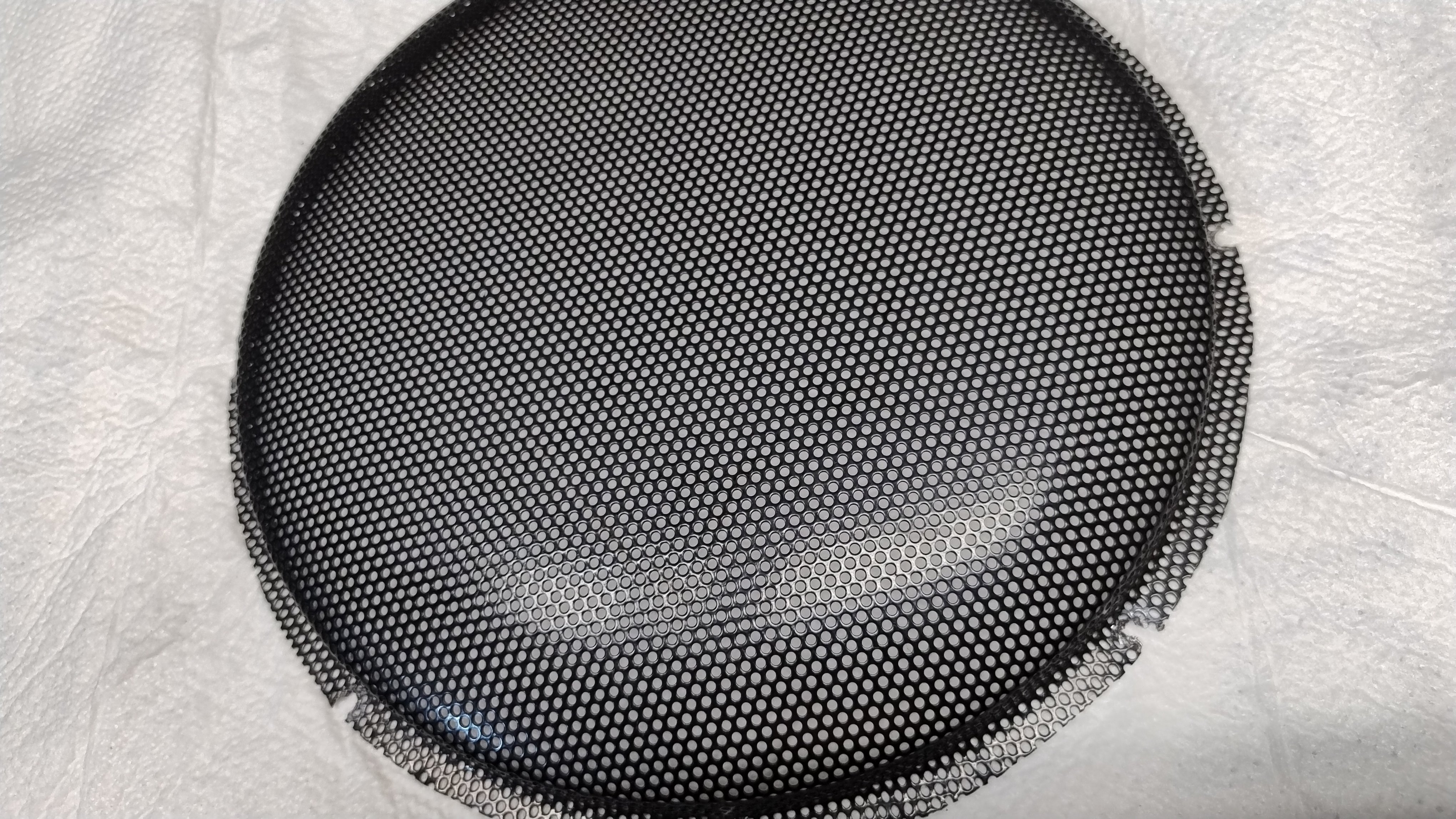

    The small metal one, I call it pot metal, very easy to break the tabs
    pitdogg2 Posts: 27,686
    Maybe zinc alloy.

    Toolfan66 Posts: 18,333
    Like a pot metal, they are painted..
    xschop Posts: 5,691
    Well the Krylon Kid can oblige.

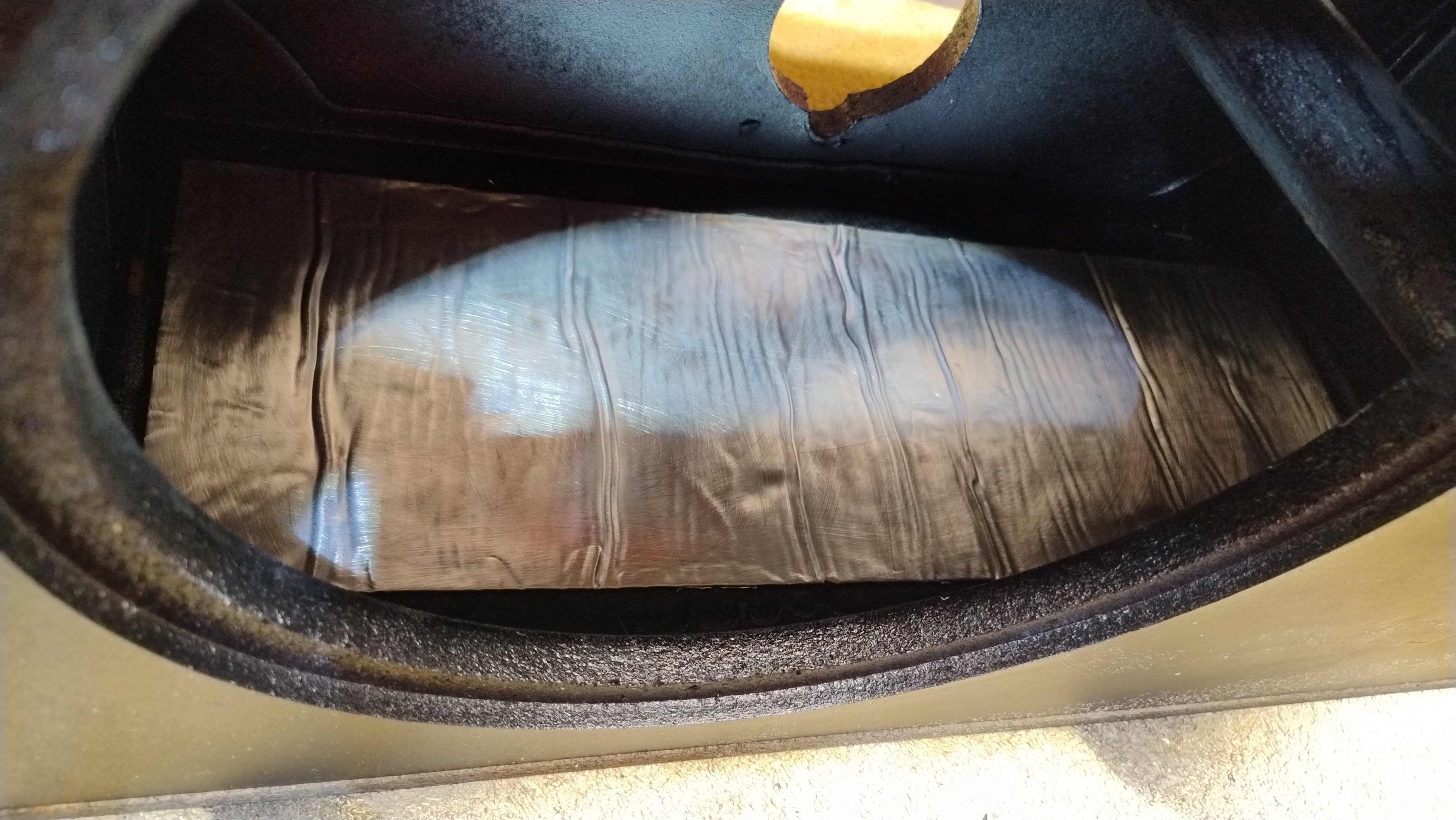

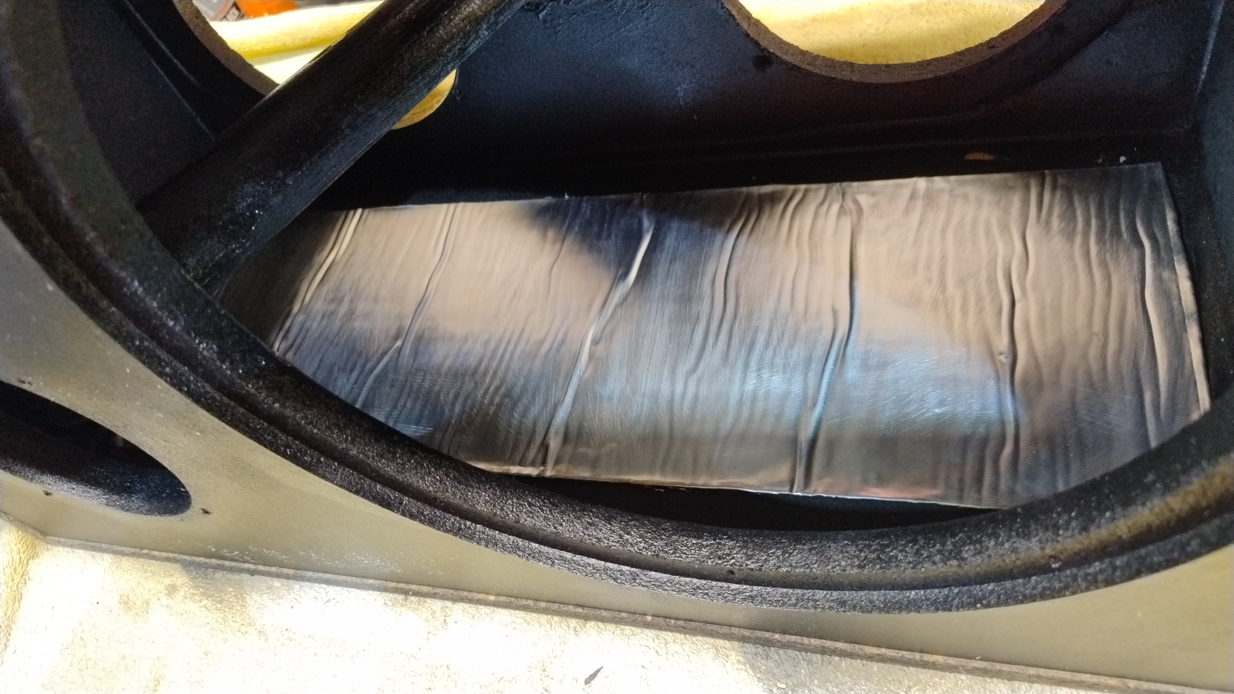

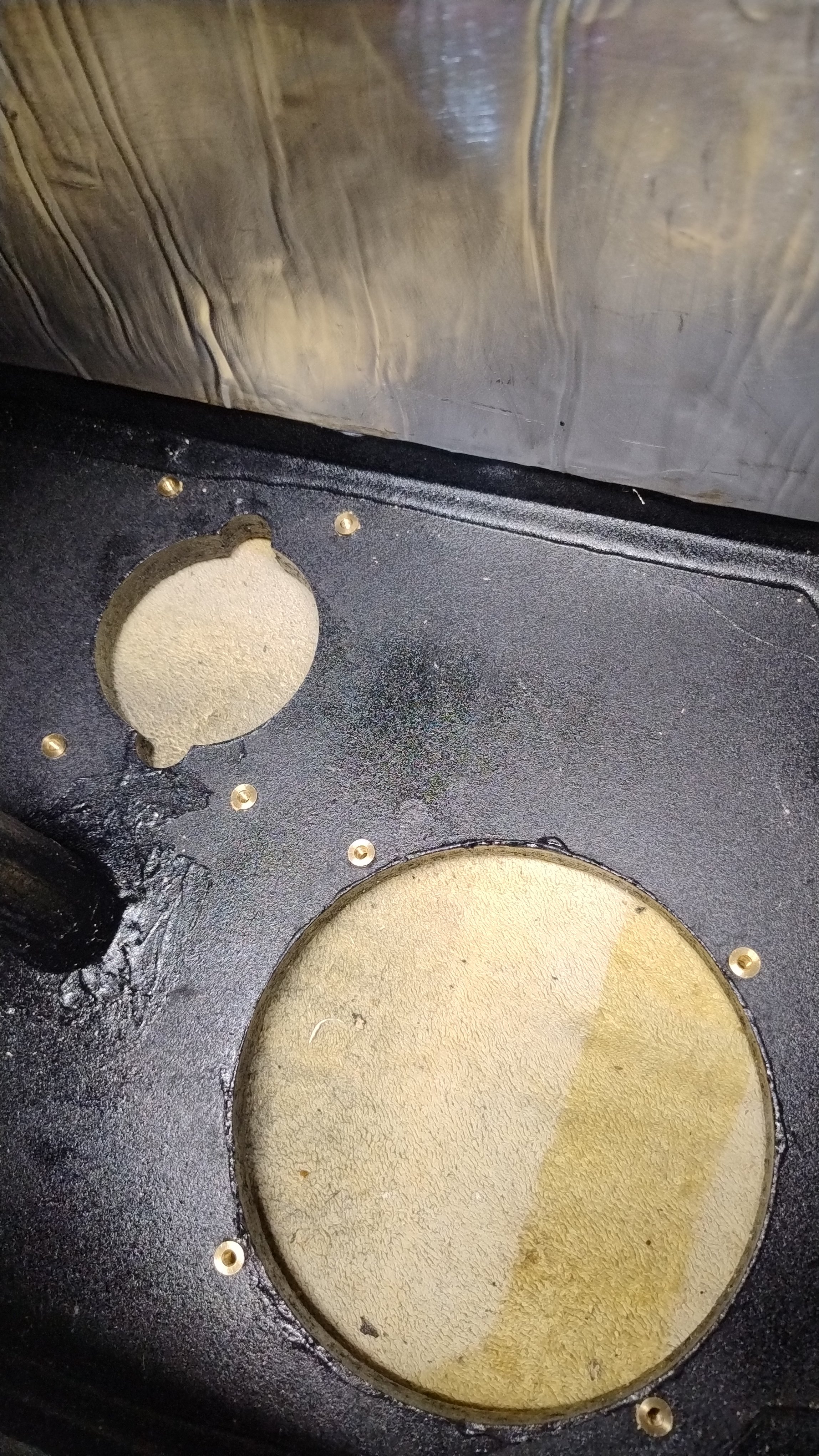

    Shot a coat of Flex Seal Max to entire interior. This is to stop the oxidation process of the formaldehyde glue of the particle board. Also makes the butyl mat adhere much better. I will put a single damping layer on tops and bottoms to take the last bit of hollow out of those areas...

    VR3 Posts: 29,659
    Check the cure time on that stuff... I k ow it says 24 to 48 hours in normal applications but this will be sealed. I wouldn't seal that enclosure completely for atleast 2 to 3 weeks.
    xschop Posts: 5,691
    edited May 15
    VR3 wrote: »
    Can't argue with that. It's been 24hrs now. I shot like 3 coats of this stuff on the interior of a set of CX100s and it tooks a few days for the tack to go away. But the butyl mat stuck like super glue.

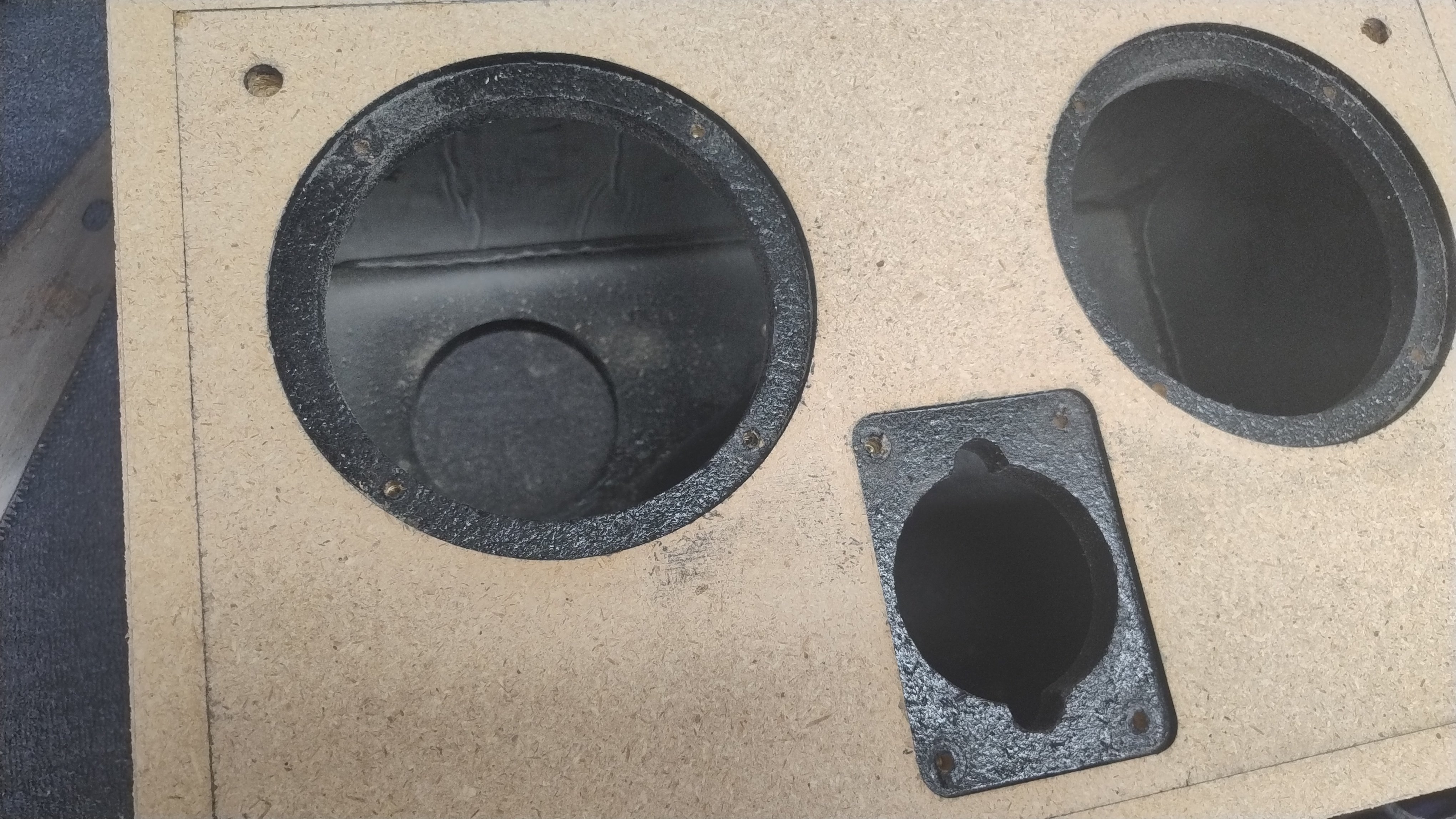

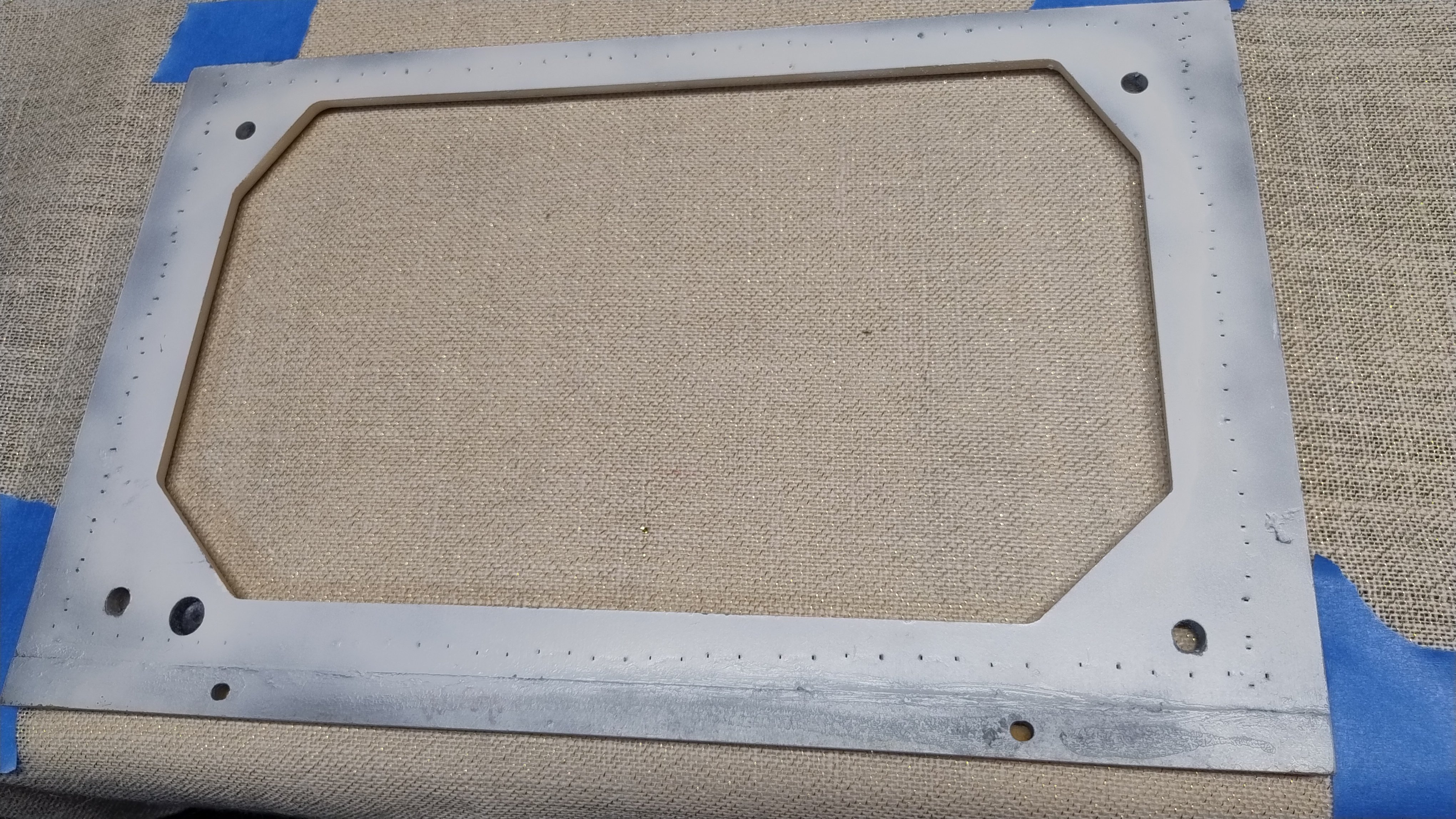

    Wonder why Polk didnt drill and install the 4 extra fasteners on the covers. They pre-drilled the PRs however...
    PITA getting them accurate with a 3/16 bit....

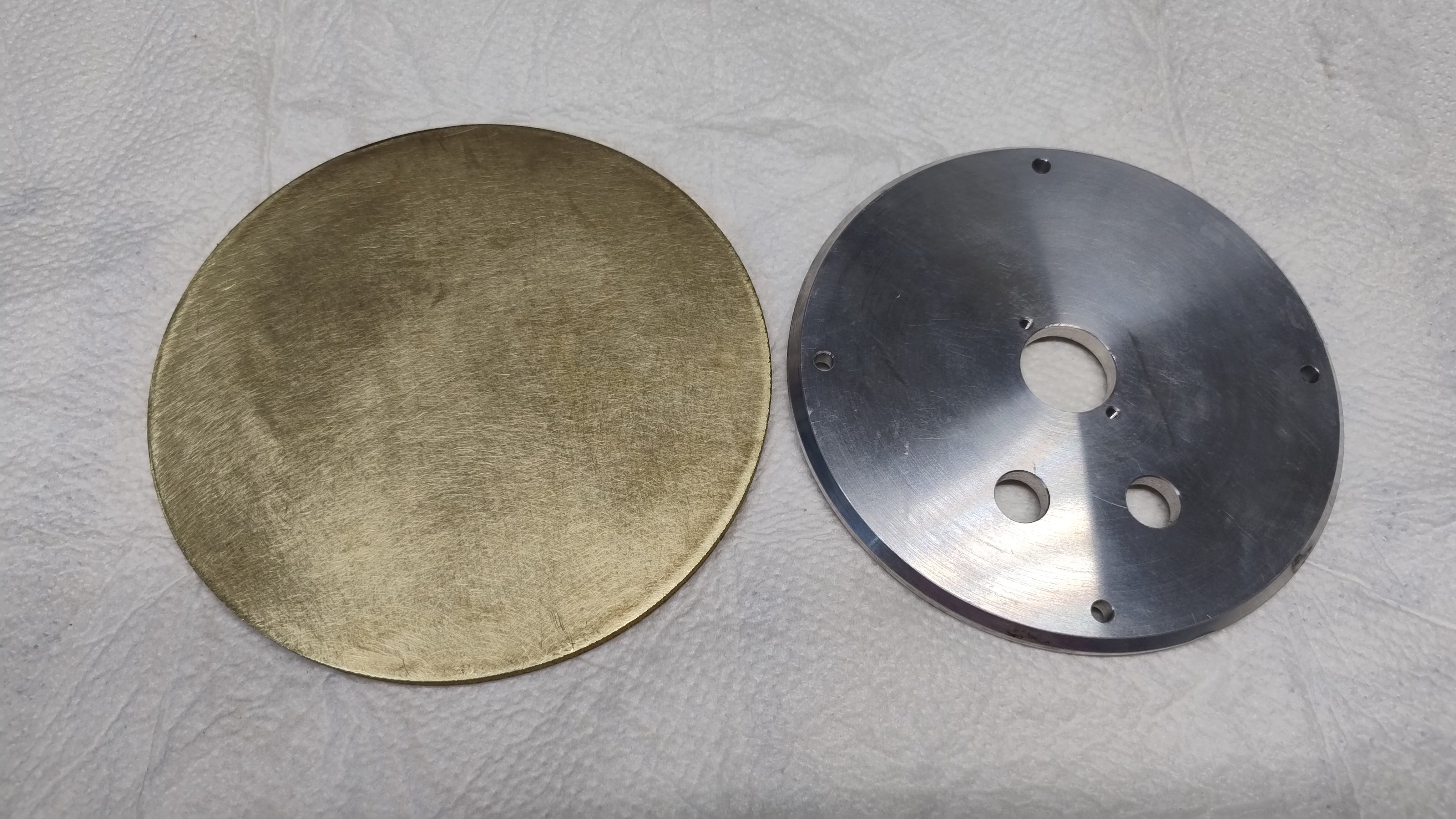

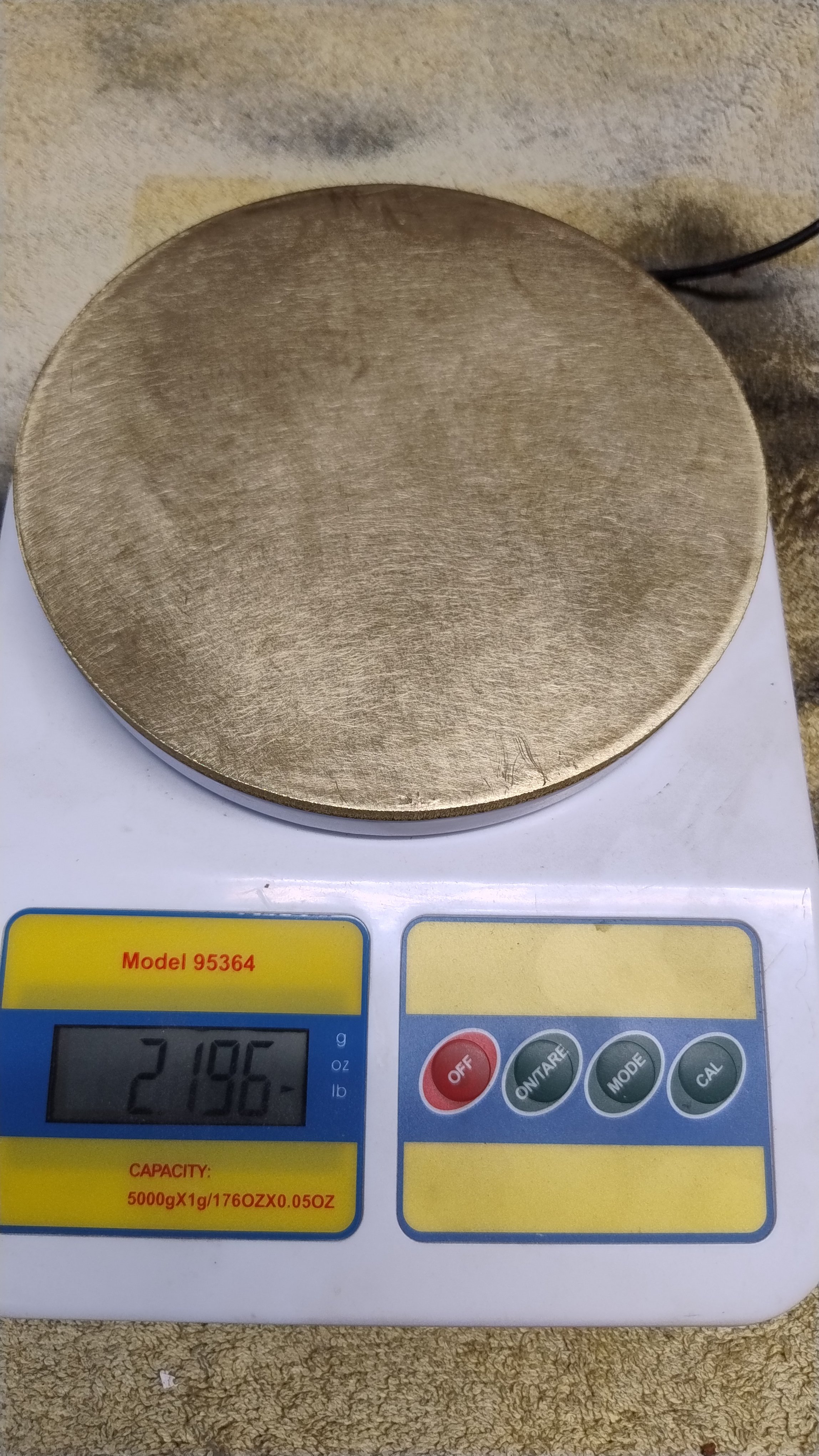

    Makes sense why 360 brass is 4x the cost of 6061...

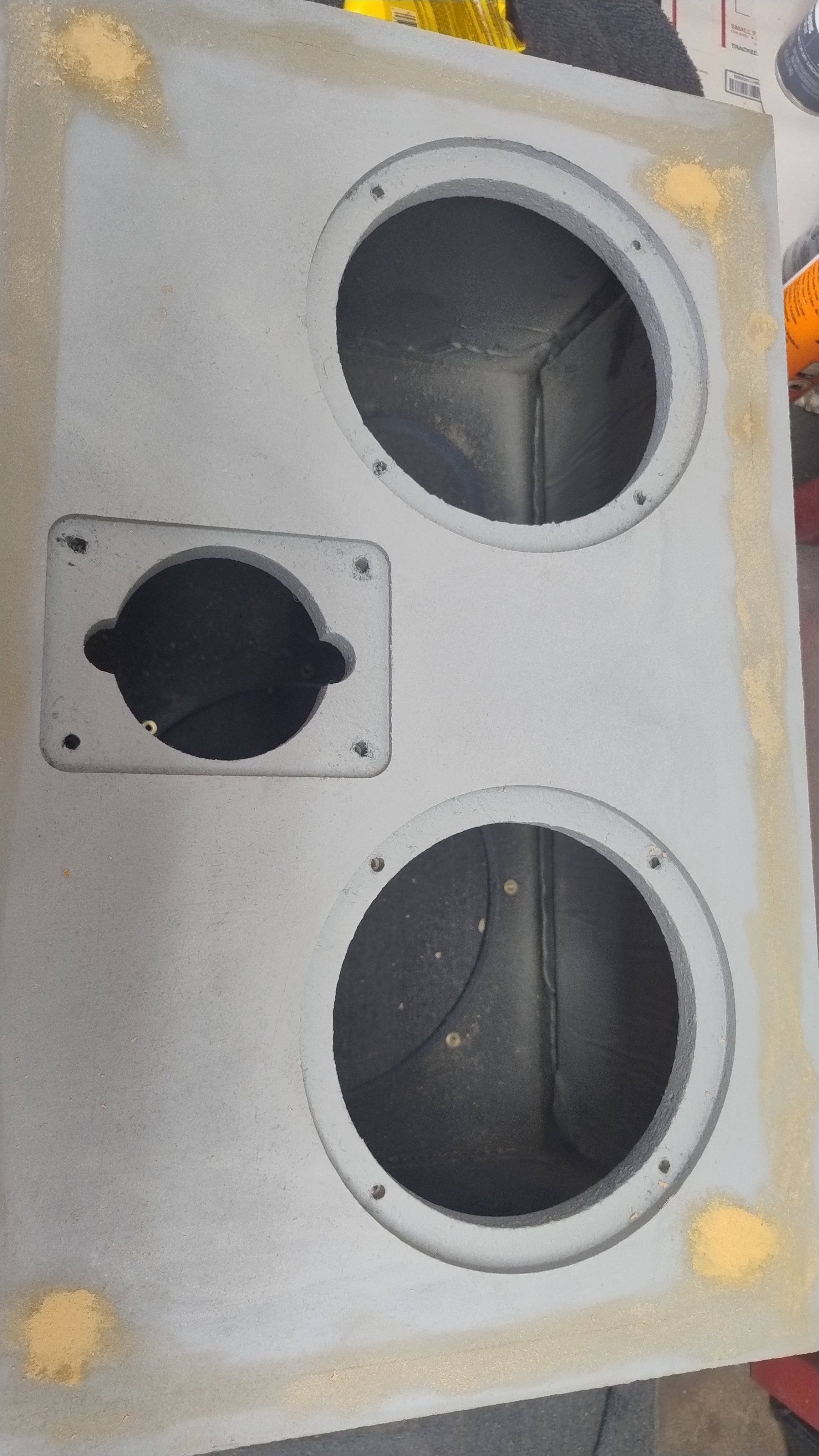

    I guinea pigged these 8-32 brass inserts. Mainly because I want to avoid any galvanic reaction with the brass screws. They're more accurate than the Parts Express hurricane nuts. Those teeth dia. are not consistent I've found.
    A 0.190 drill is perfect and they don't split the particle board or need trimming near the thru holes....
    I heated the base and top with a heat gun. The butyl mat is now permanent....

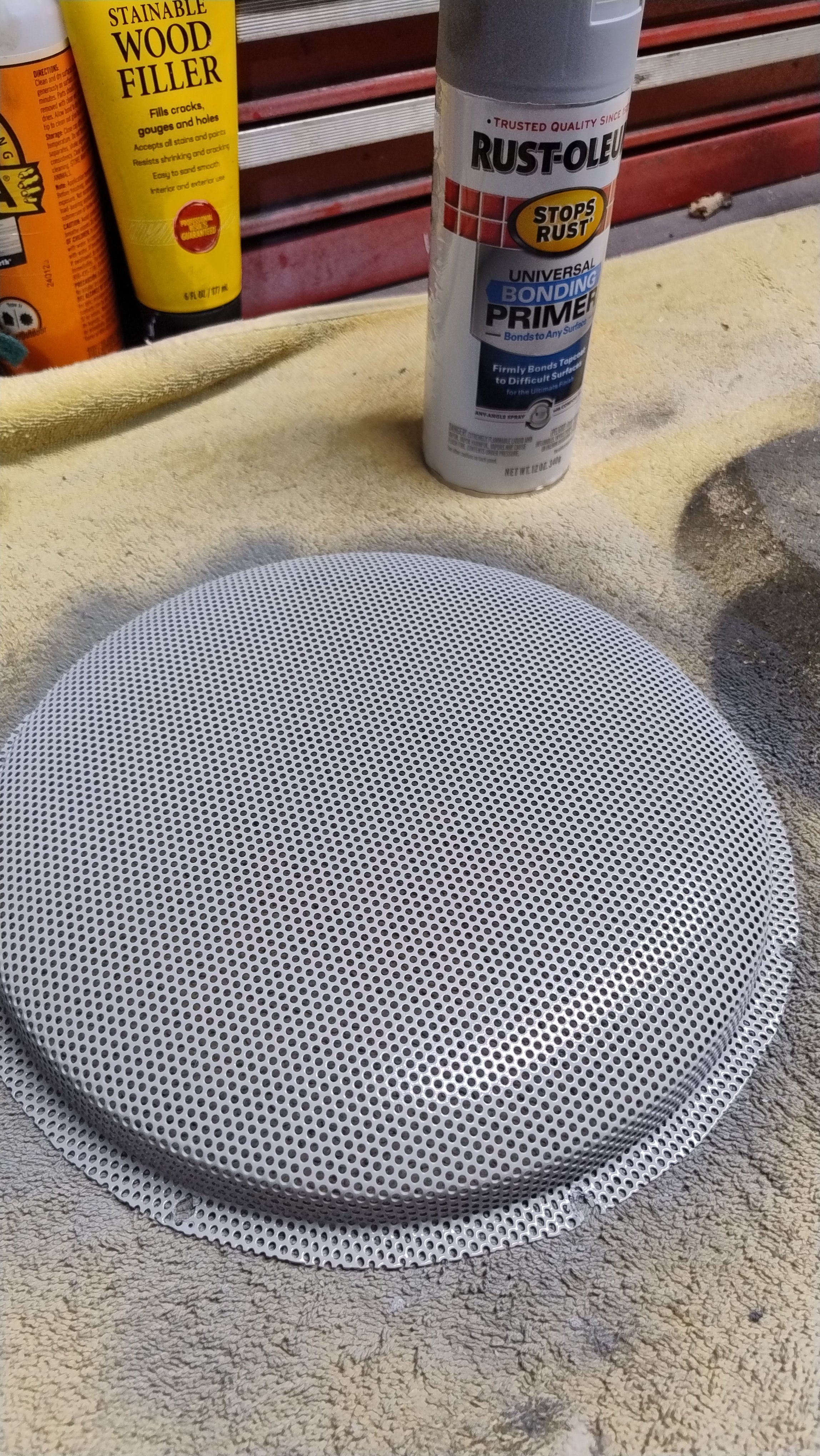

    And the primer is drying F1😉....

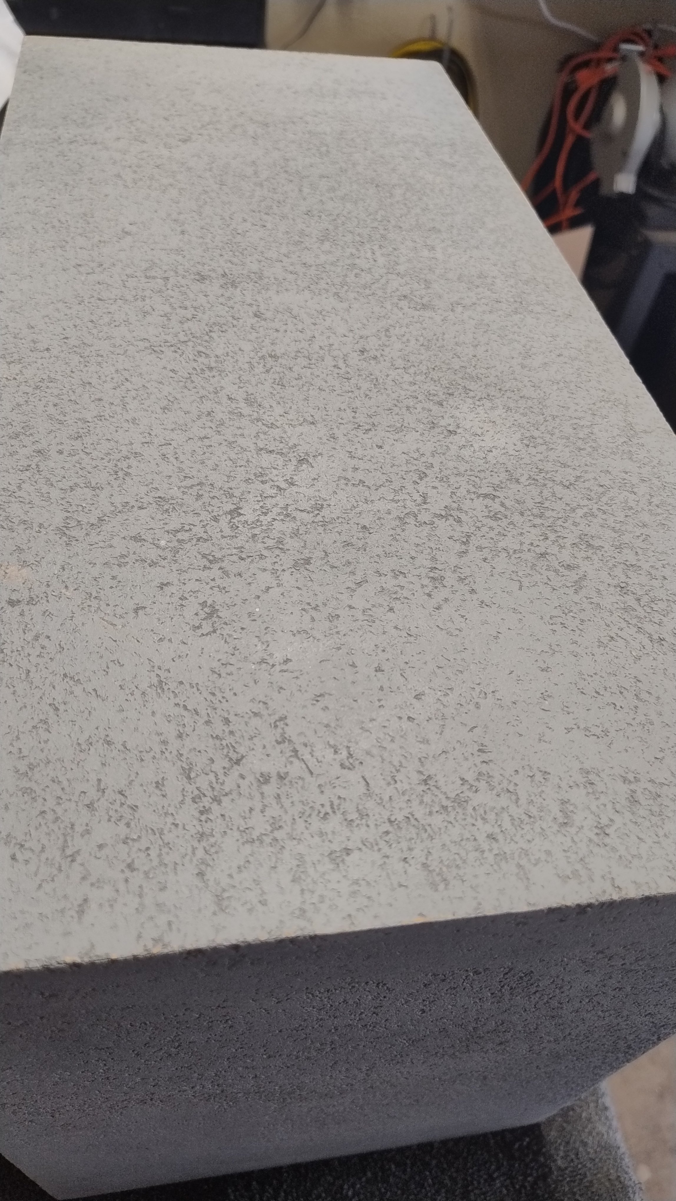

    2 new belts snapped on me.

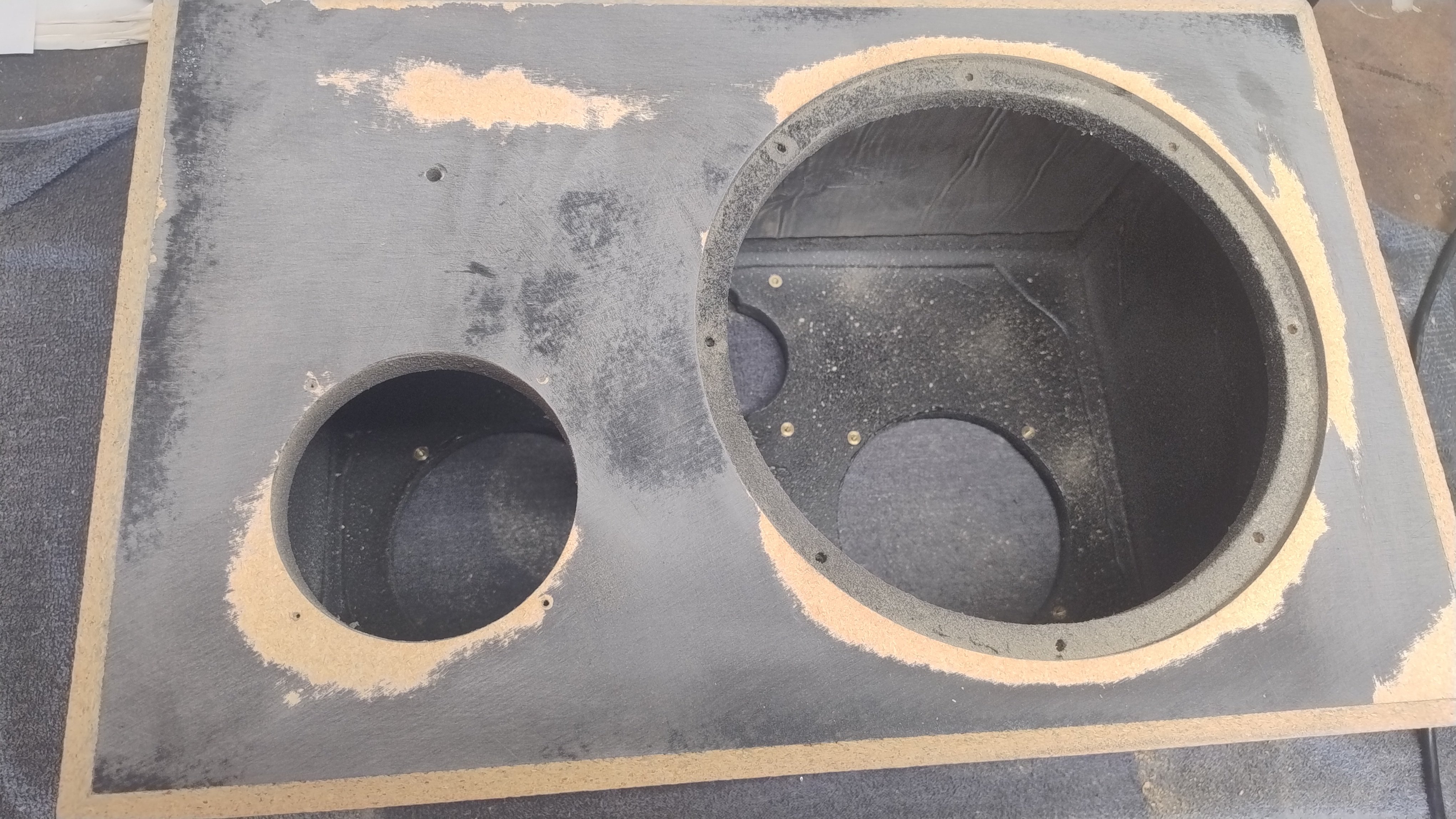

    It's either the brand or Polk particle board doesn't like 50 grit. 120 and took a little longer...

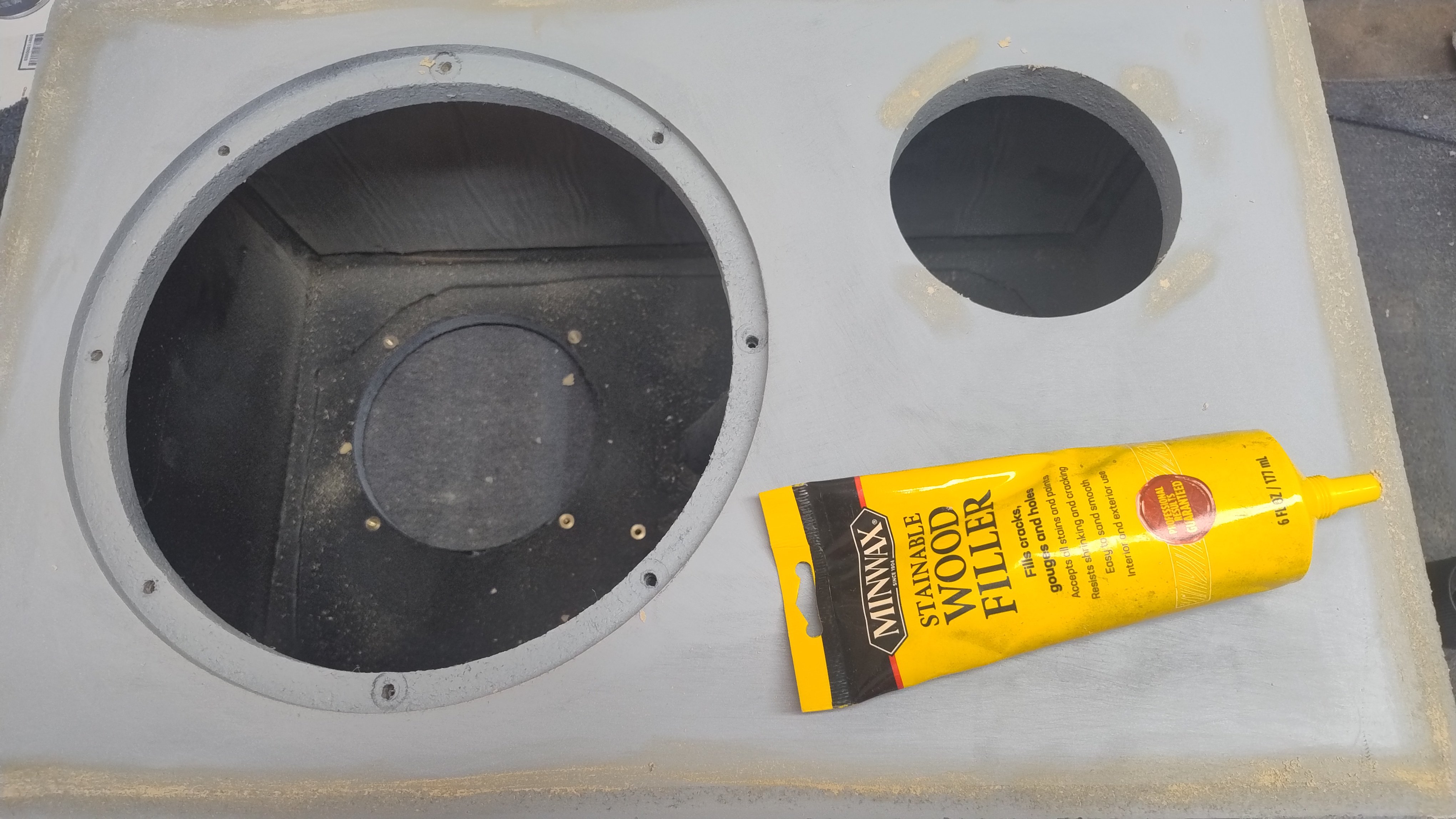

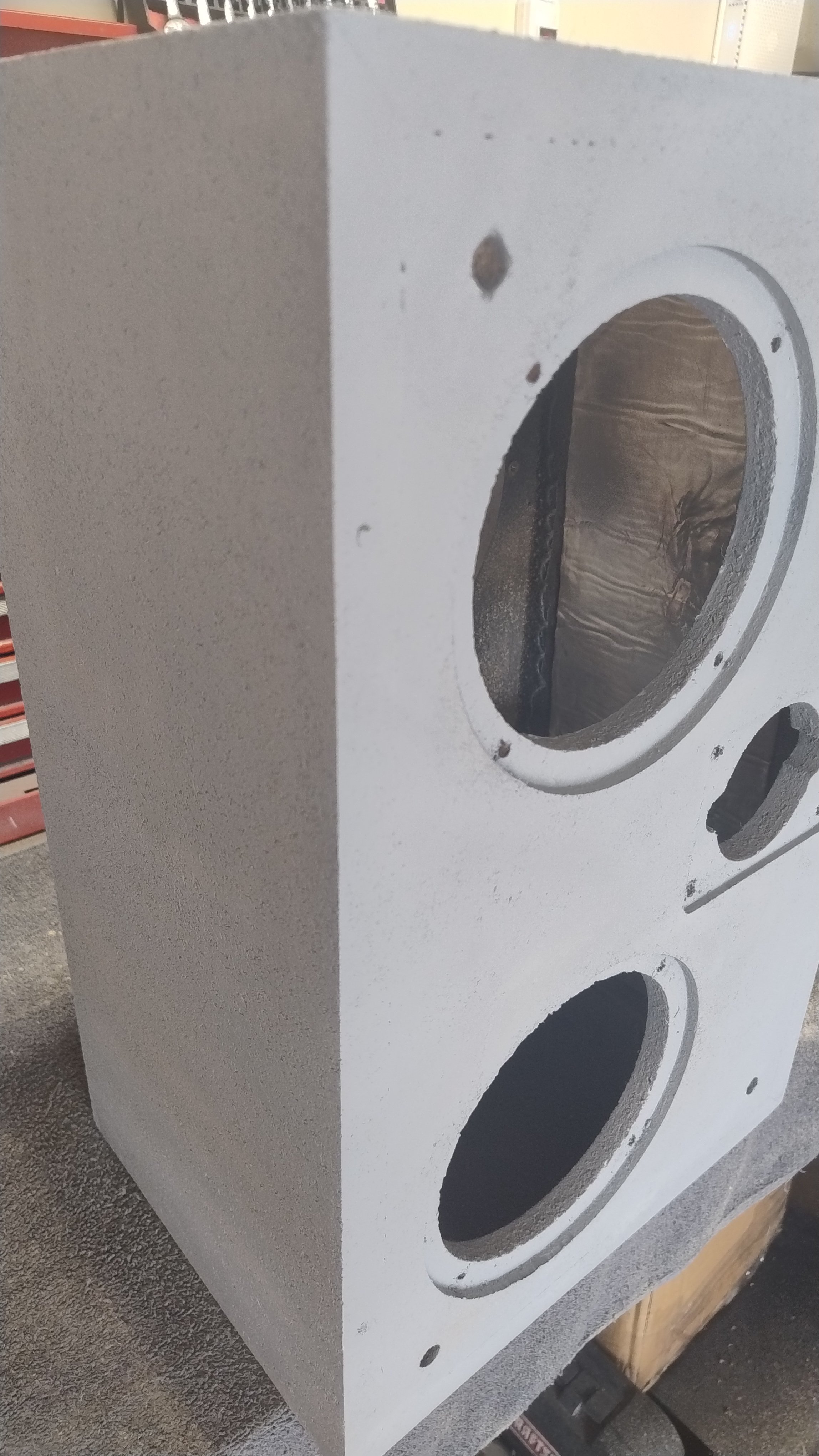

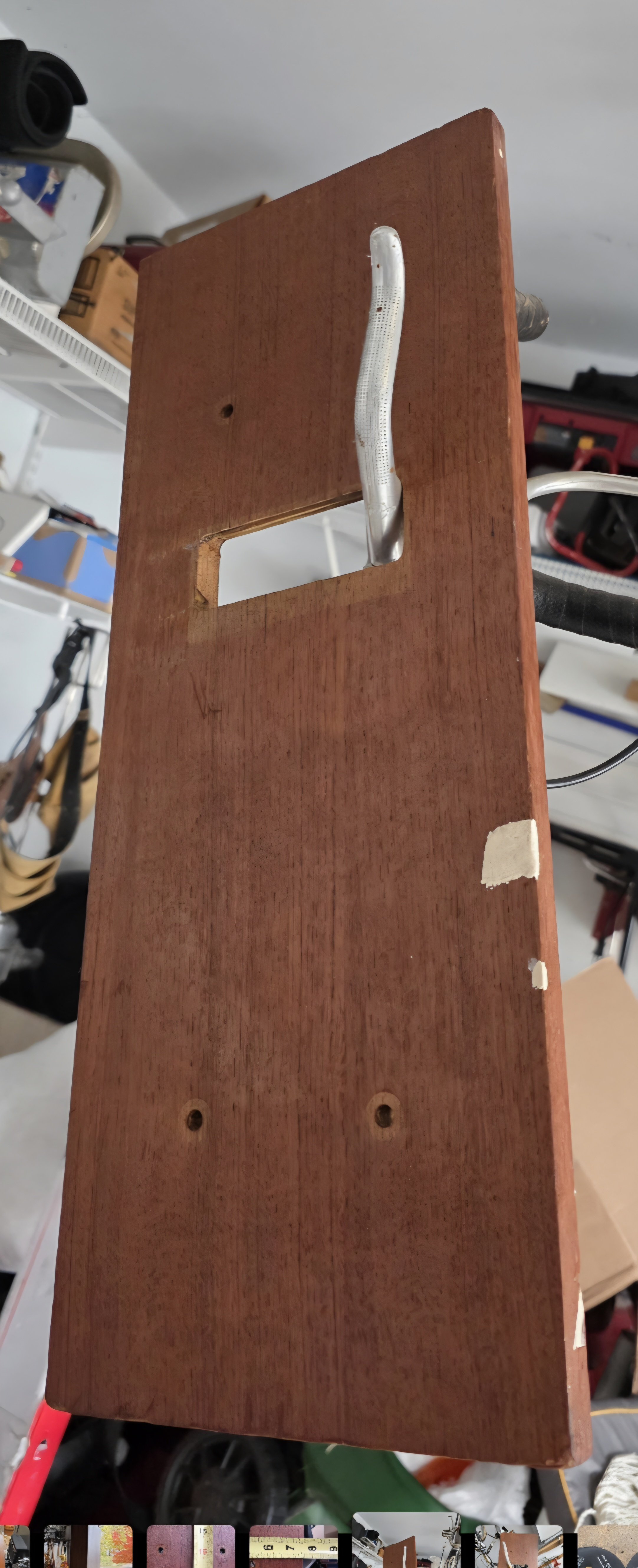

    shot a coat of primer before wood filler. Those little pegs that held the front wood trim on were 2.5" long and one glued in, other popped right out with pliers...
    Just glued it in and sawed it off...

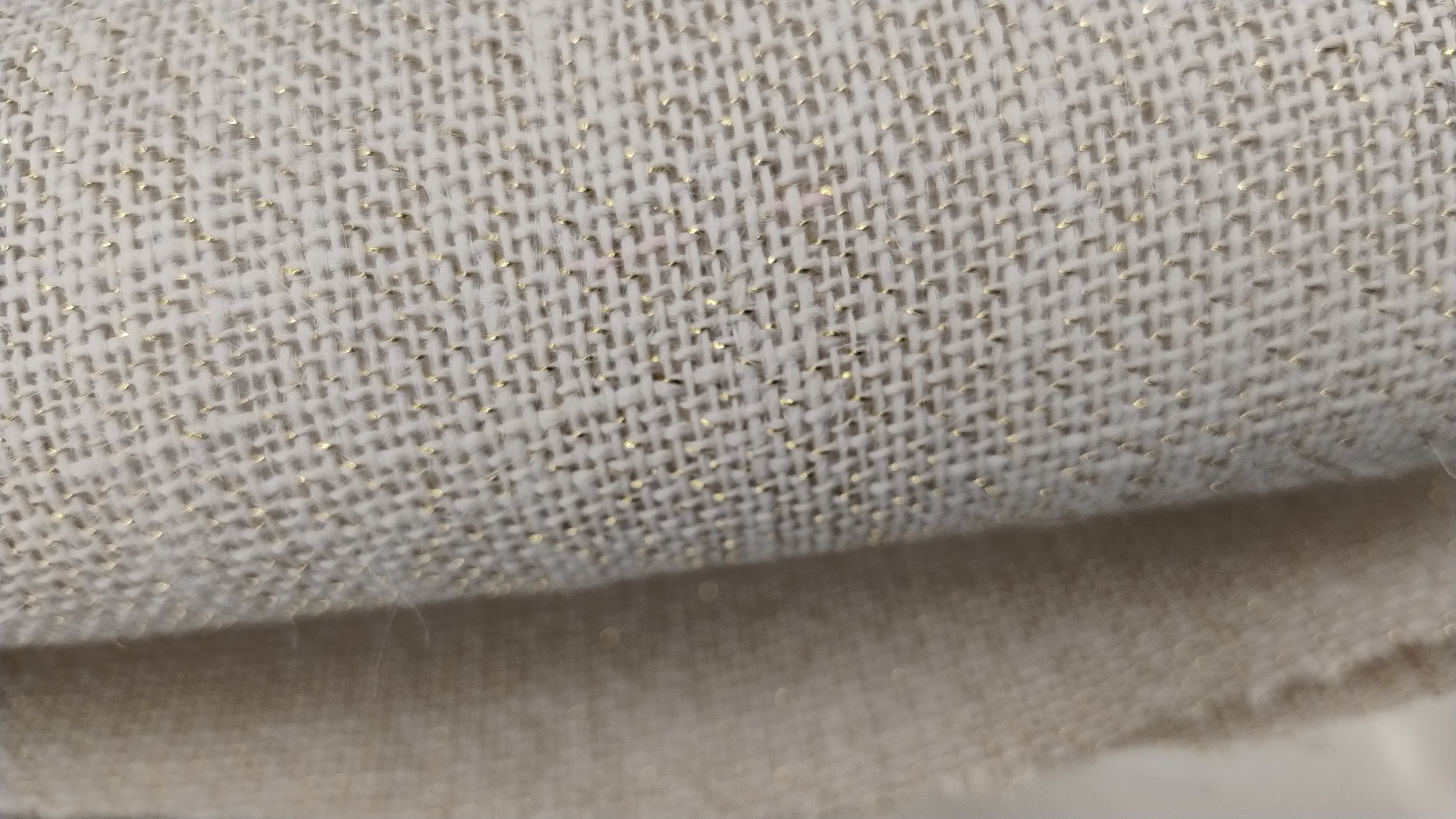

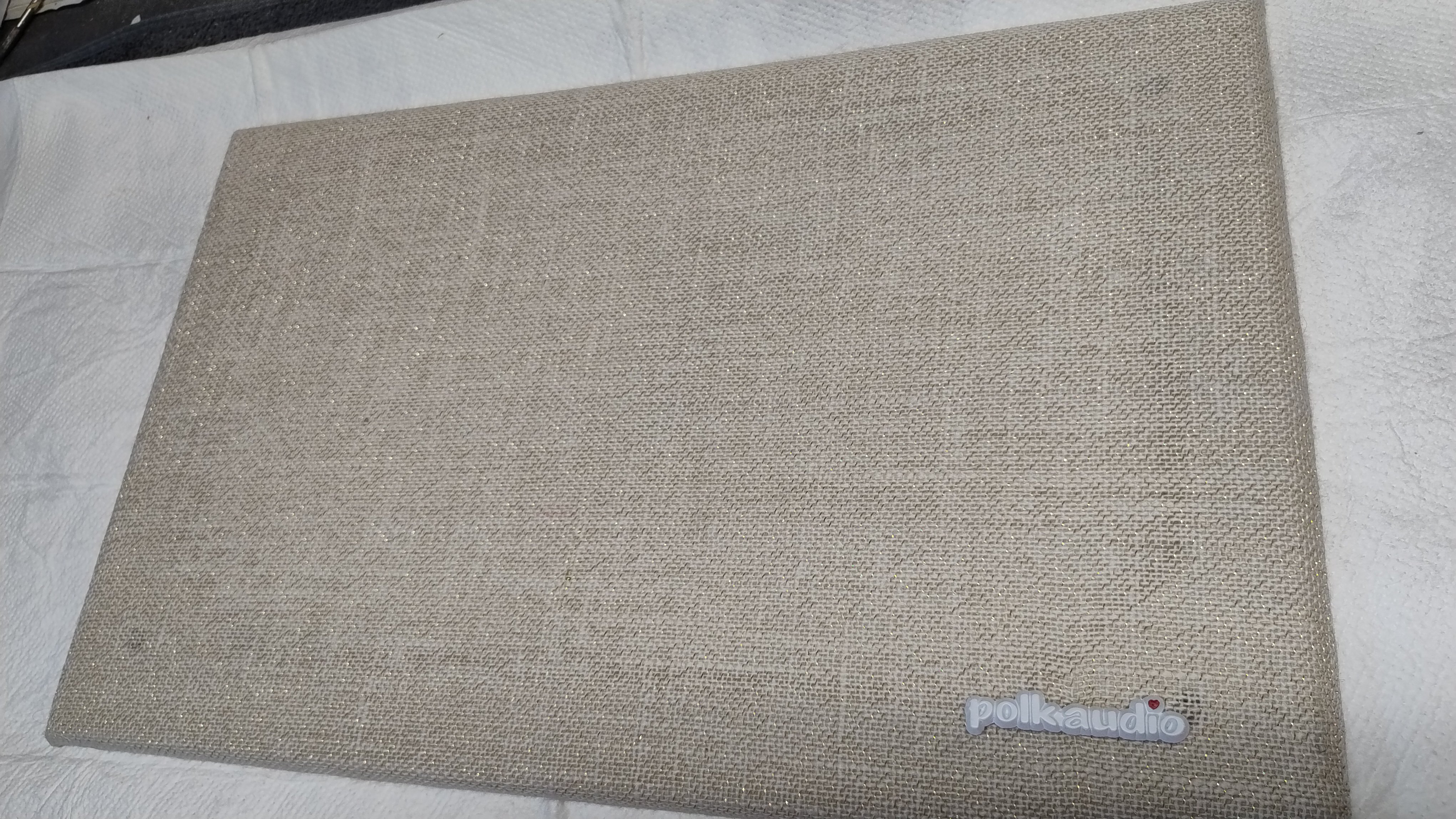

    Think I'll go with a diffent grill cloth. I guess acoustically transparent accompanies visual transparency with the linen style cloth...
    No likey...
    xschop Posts: 5,691
    Not sure if I'll have to go back with Bondo in the dowel holes to keep their edges clean when I redrill for brass inserts...

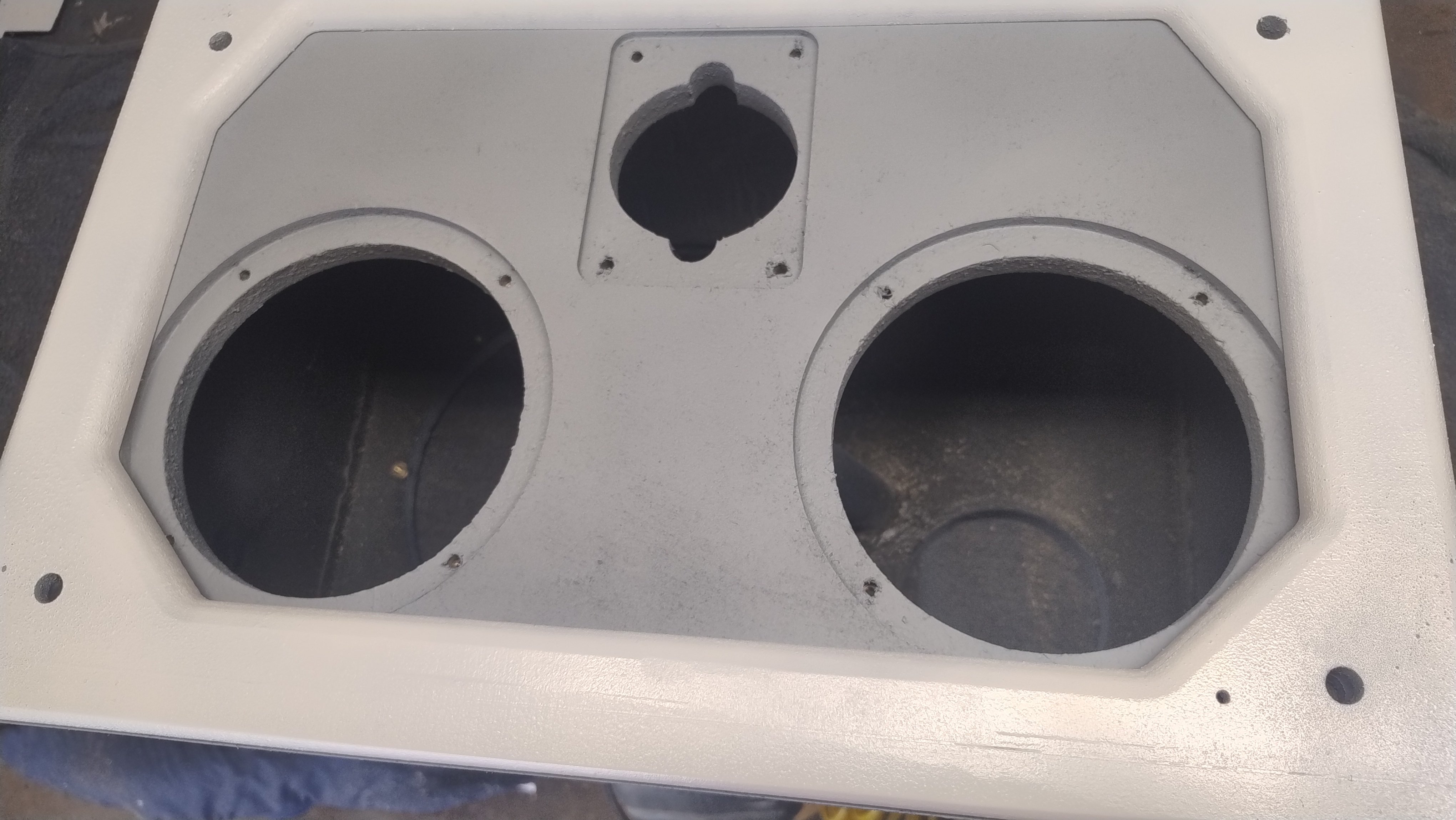

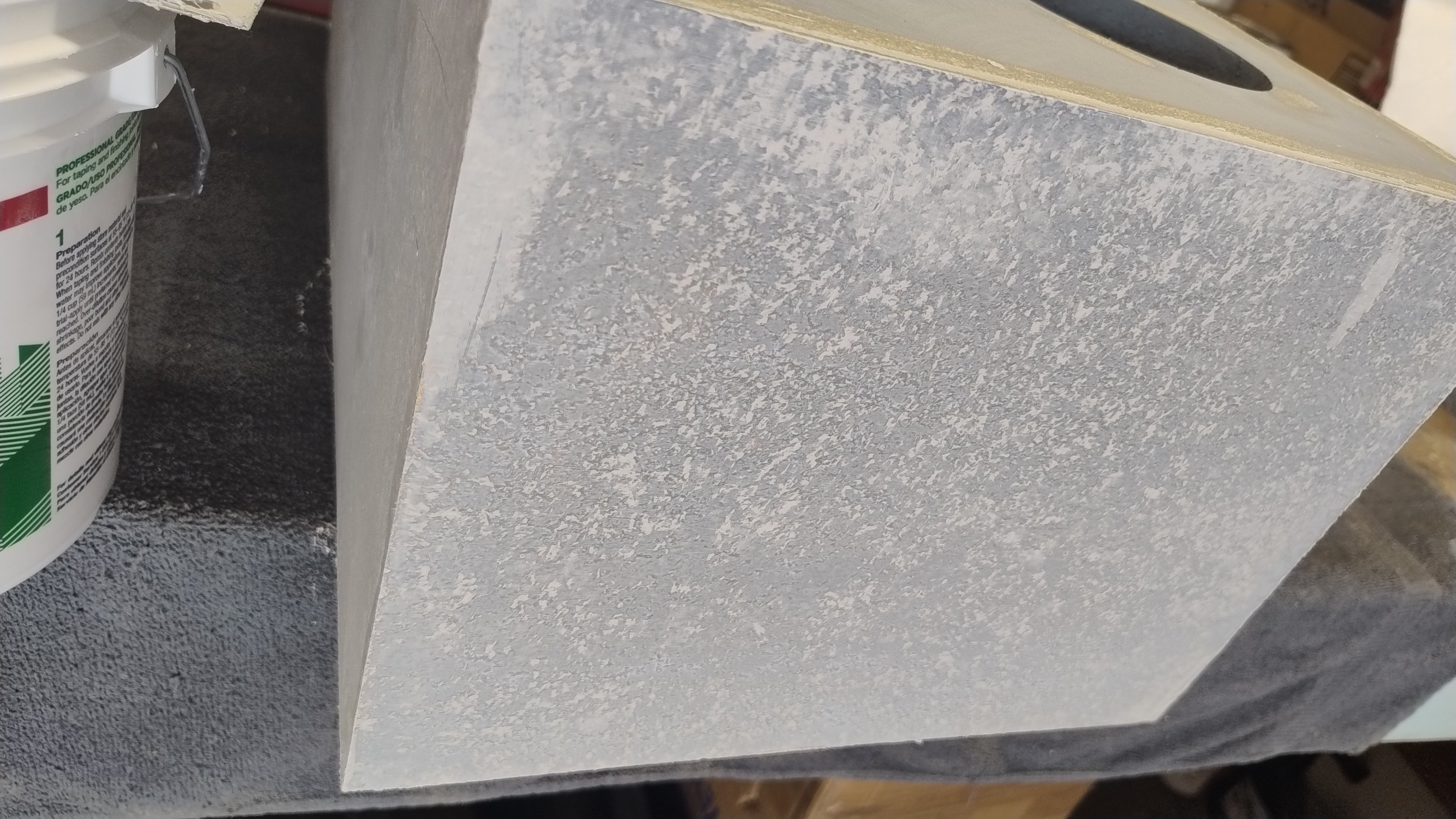

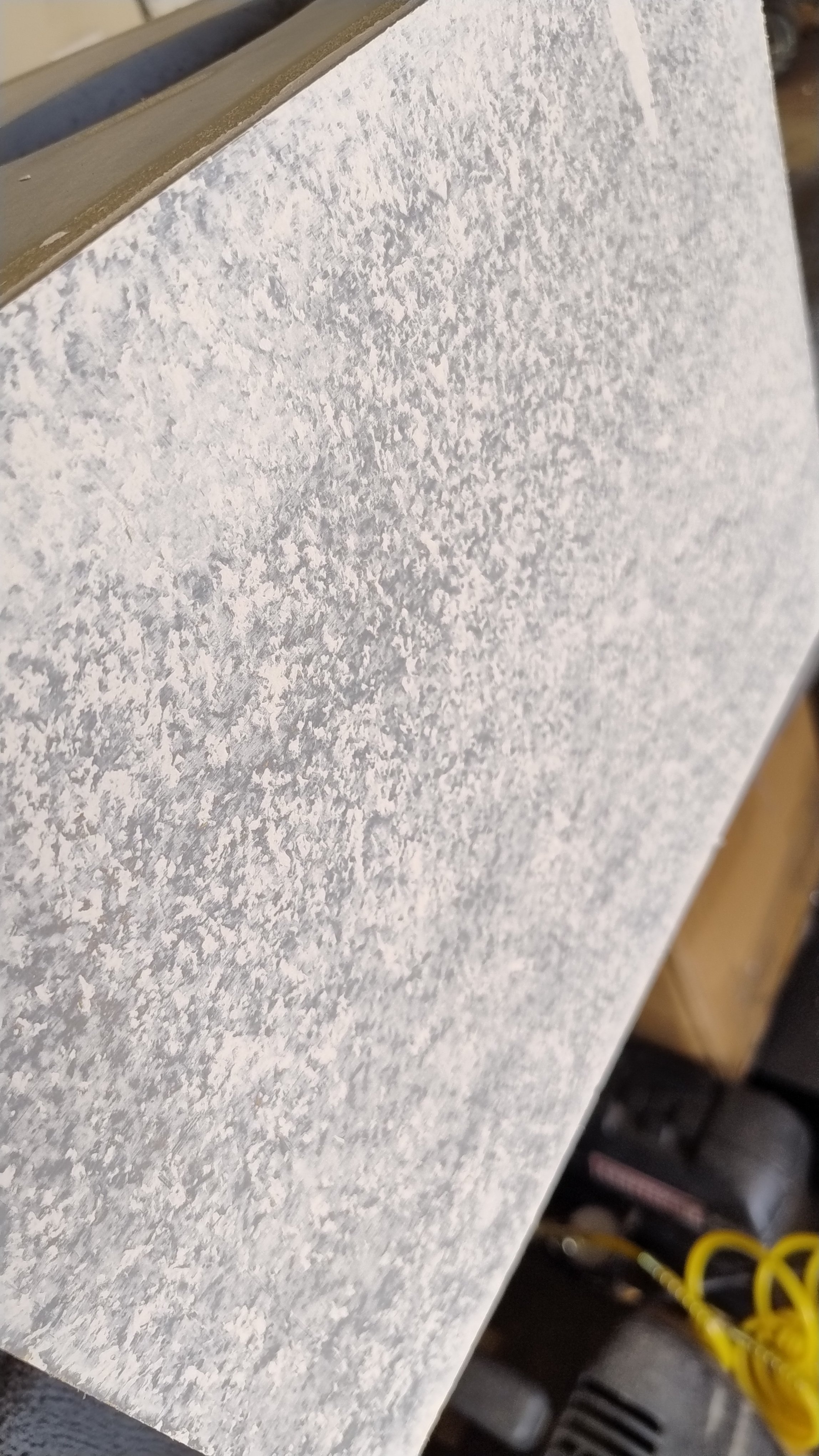

    To fill in the small microdimples left behind from the old vinyl removal...drywall compound and 12" blade foots the bill quickly. Ready for light sand and final primer, then paint....

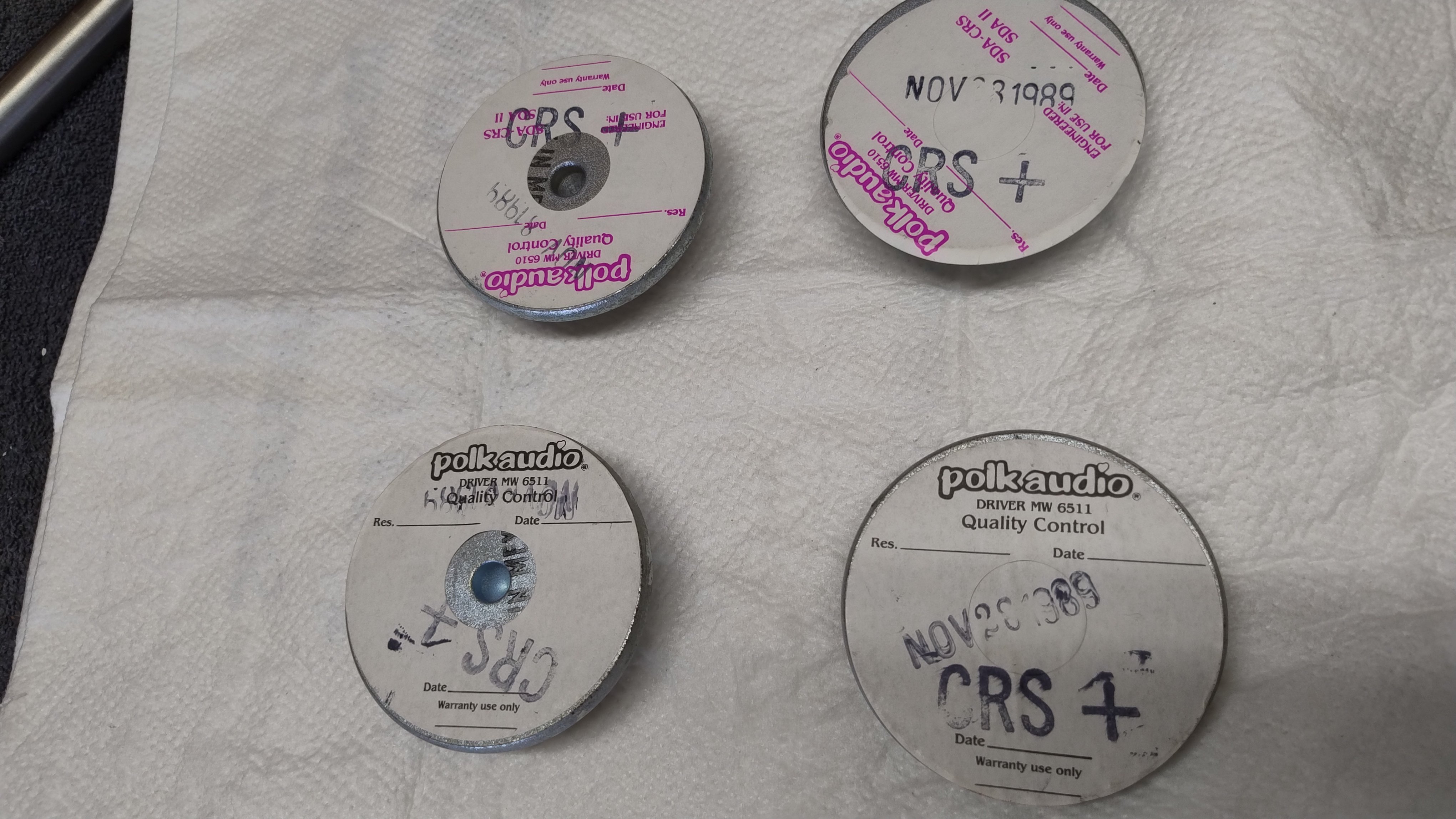

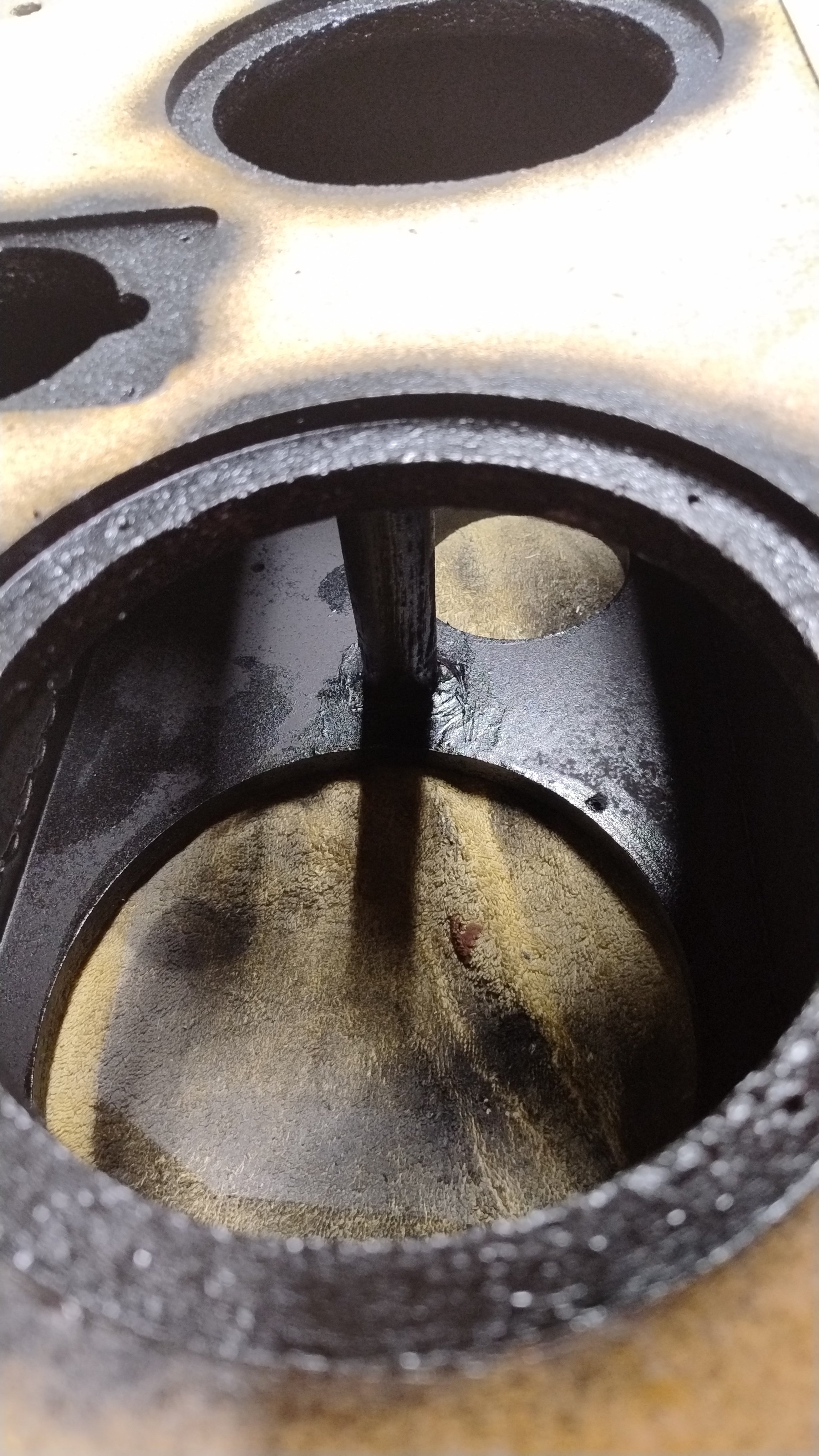

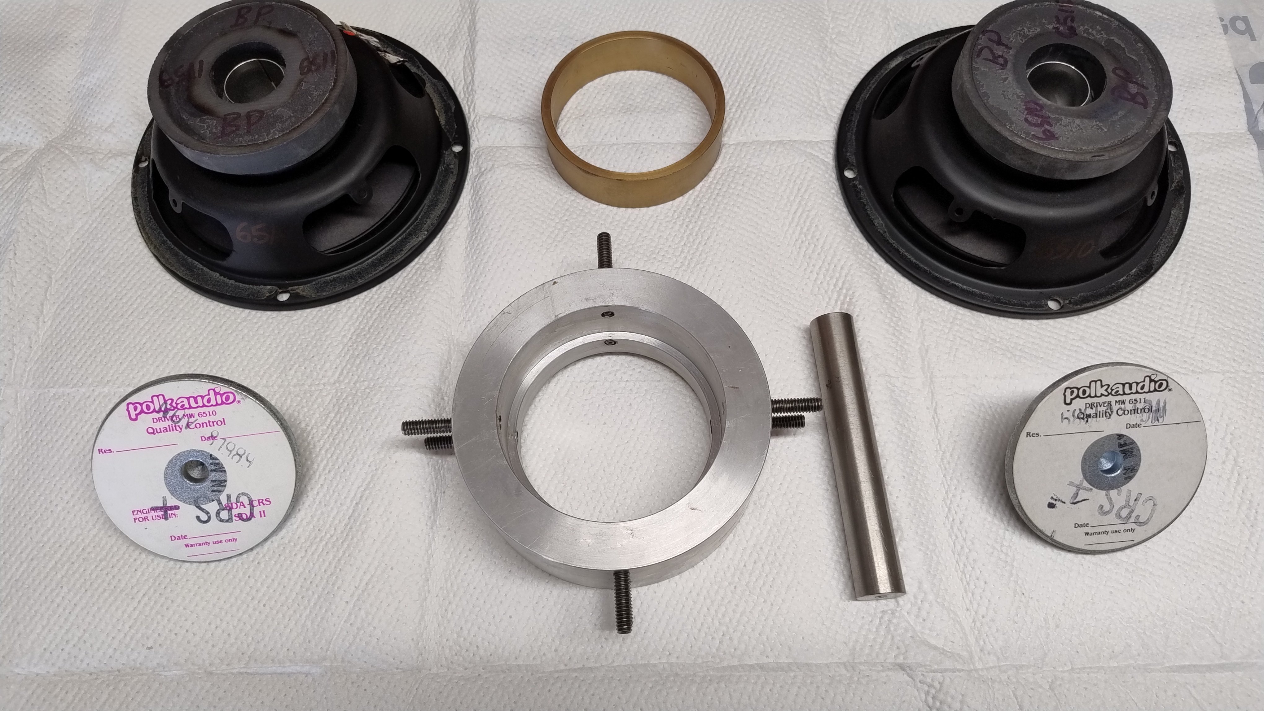

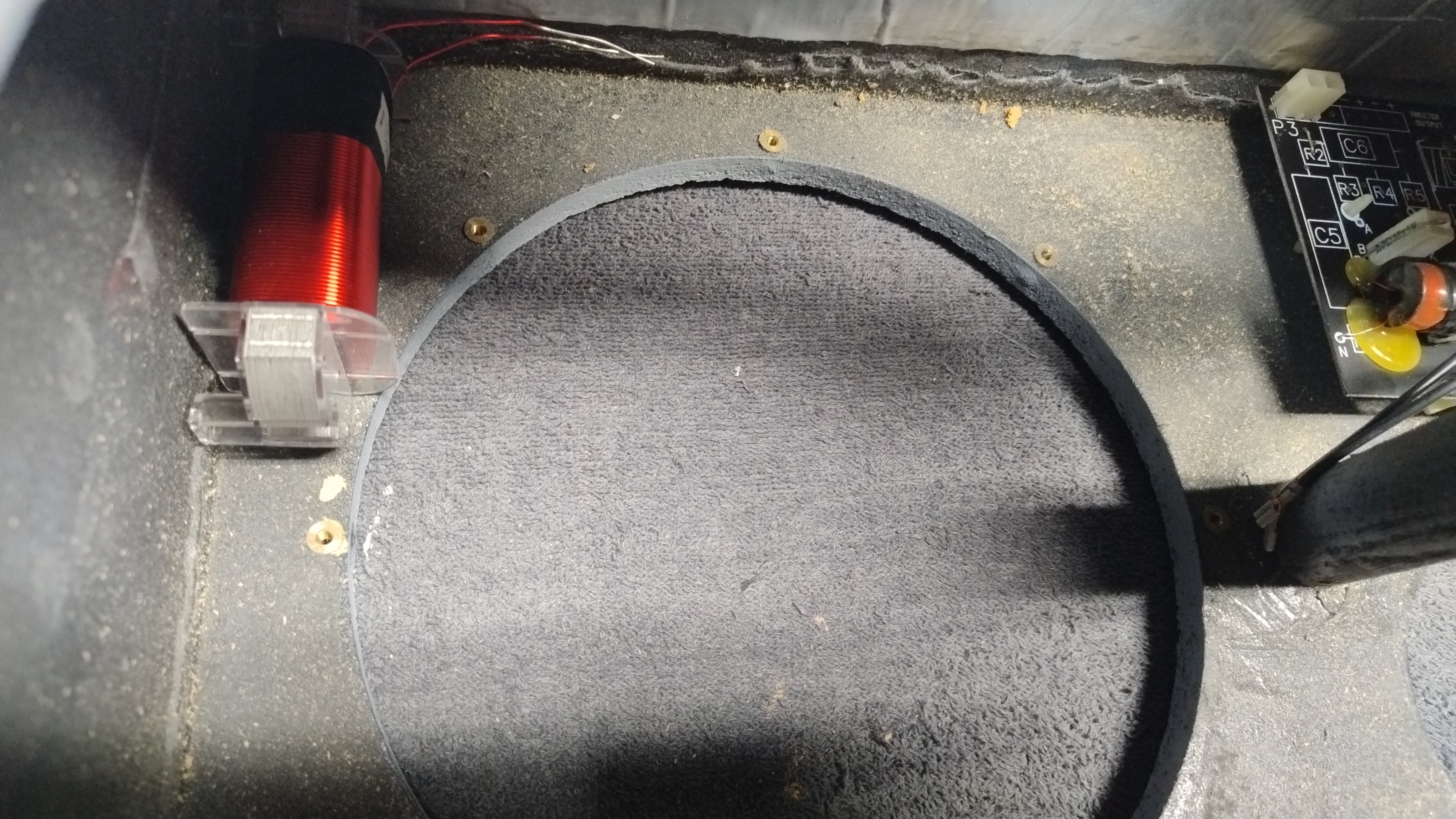

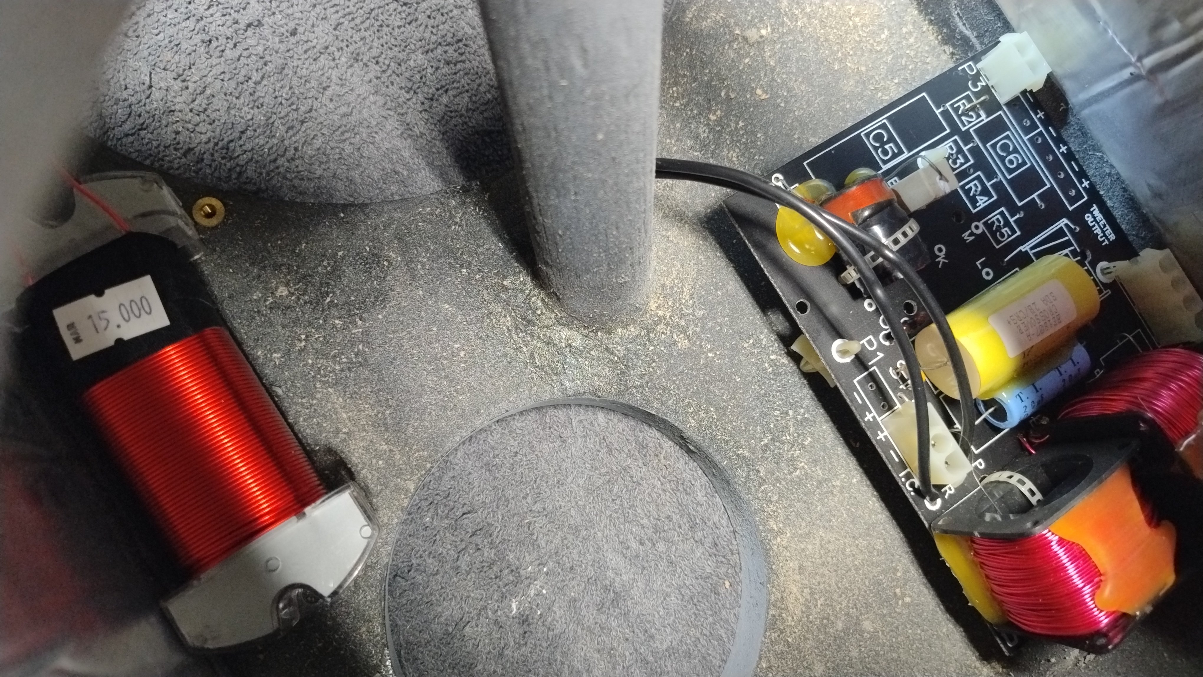

    Trusty mag tool made quick work of removing the pole-pieces....
    Next shop visit will get 1/8 pinholes thru centers and oxidation cleaned up with some fresh focus rings...
    The MW sticker applicator position at Polk must have been a DEI hire lol...
    Forgot to mention, the new grill frame dimensions are 12.625" x 19.875"
    And I only have one 6511 with 0.020" suspension sag (seen alot worse). All others are good.

    F1nut Posts: 52,244
    That wood filler stuff is crap. Wood epoxy is much better.
    xschop Posts: 5,691
    Yeah, think this stuff is only good for small crevices and the seams where the boards are folded together.

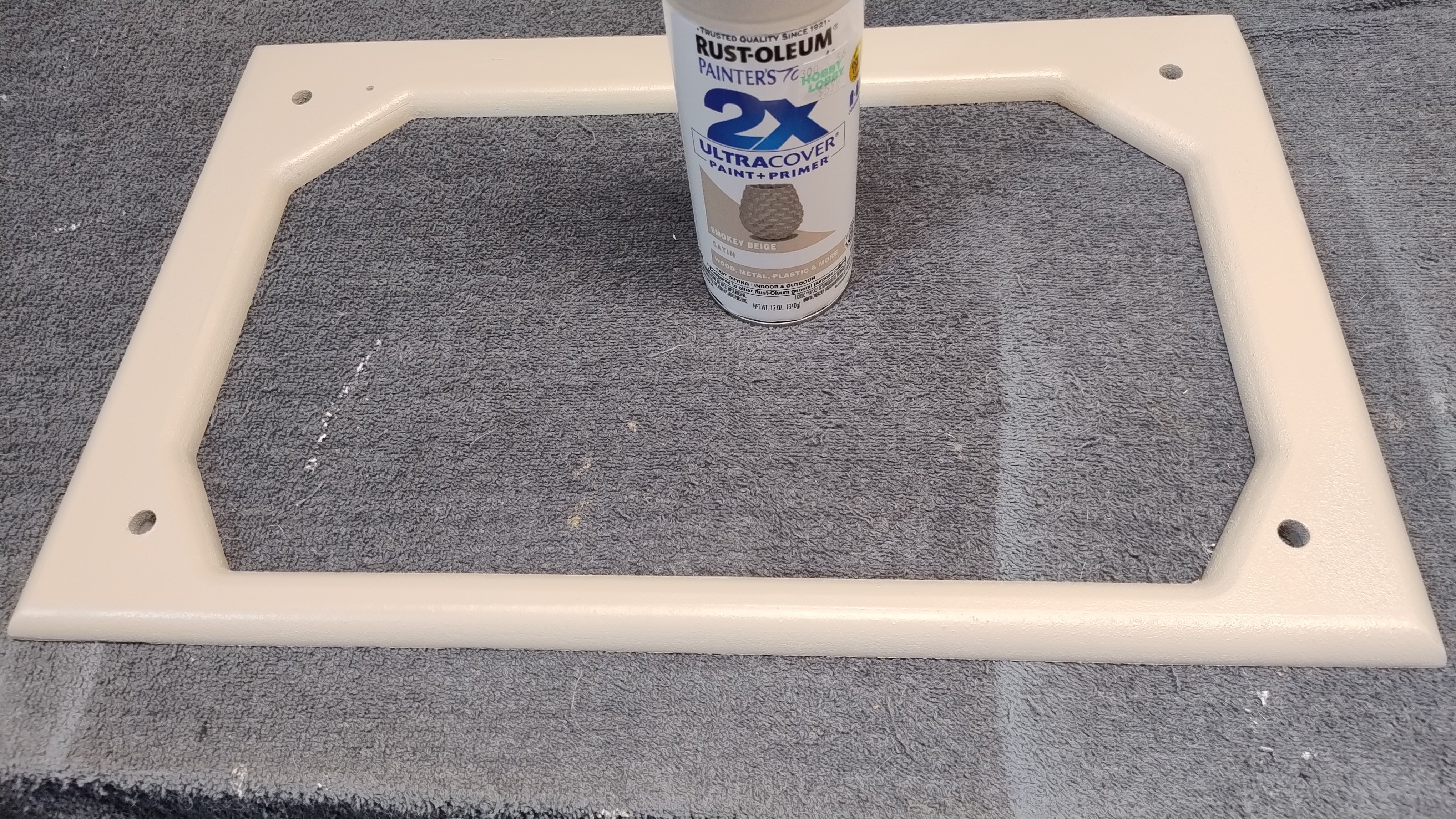

    Picked up some beige spray paint to coat the frames and bought a test patch of that first cloth to place over 8TLs to see how it changes sound. Its WAF approved.

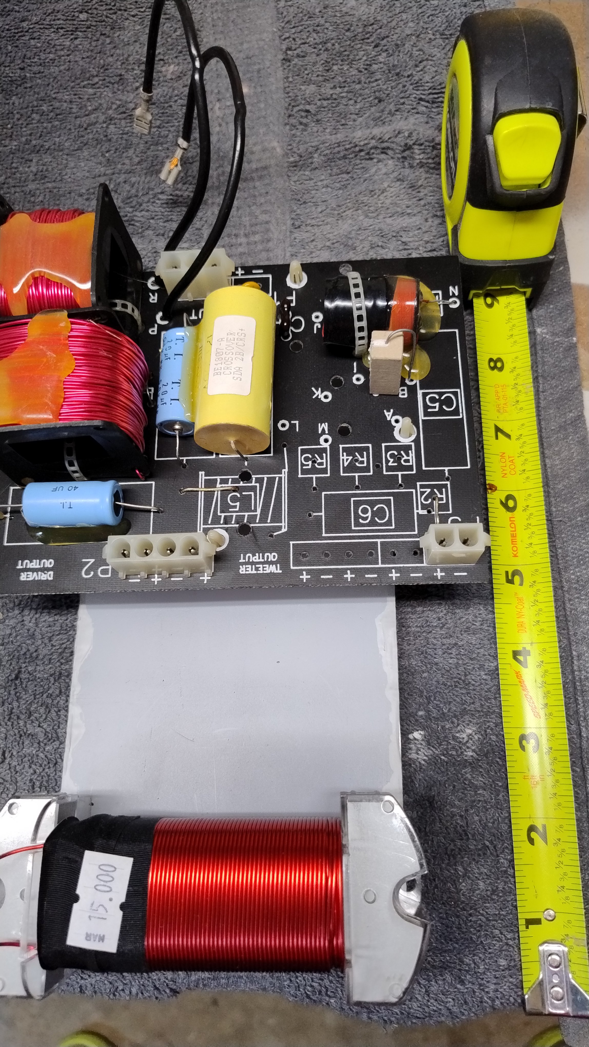

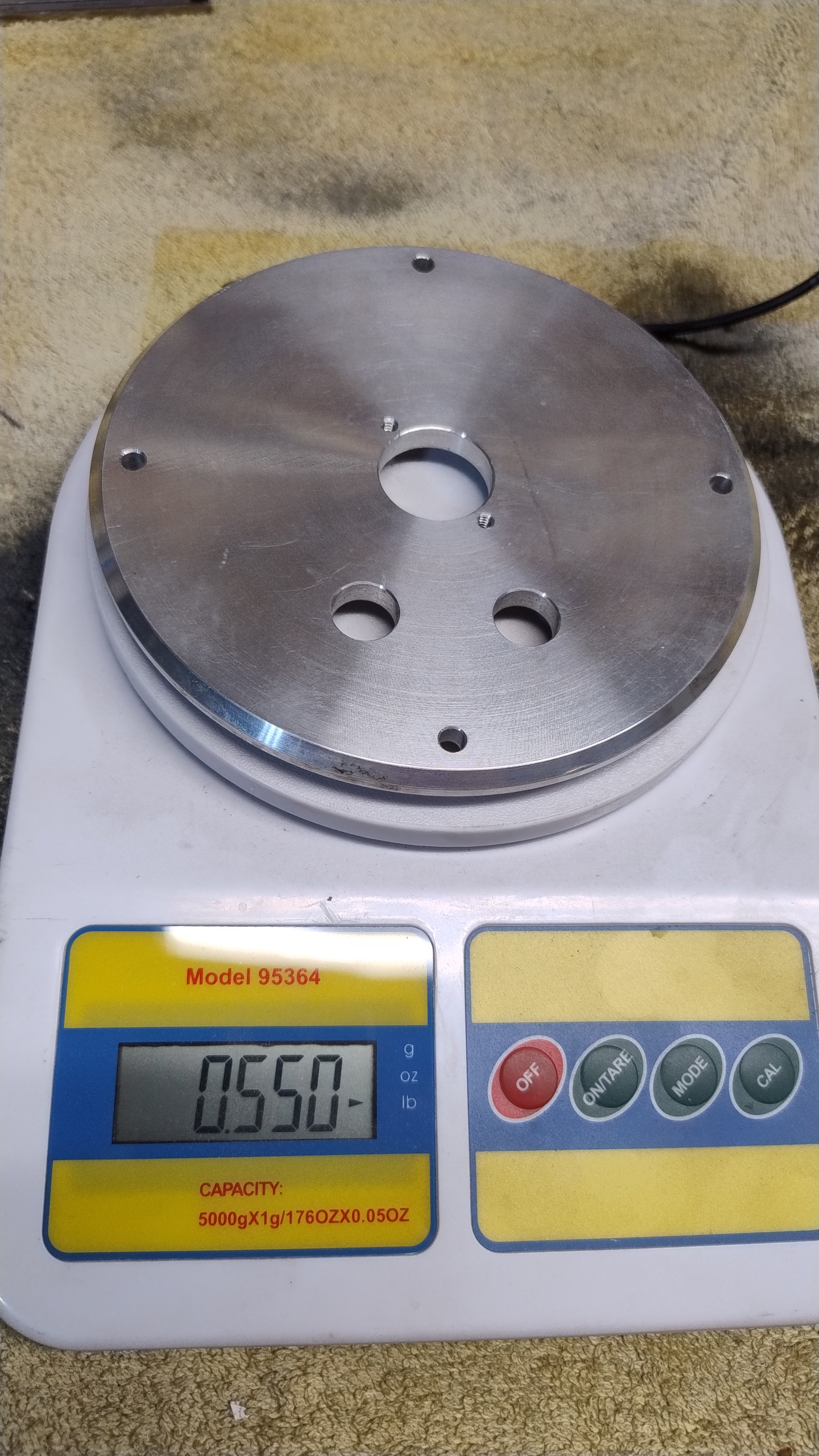

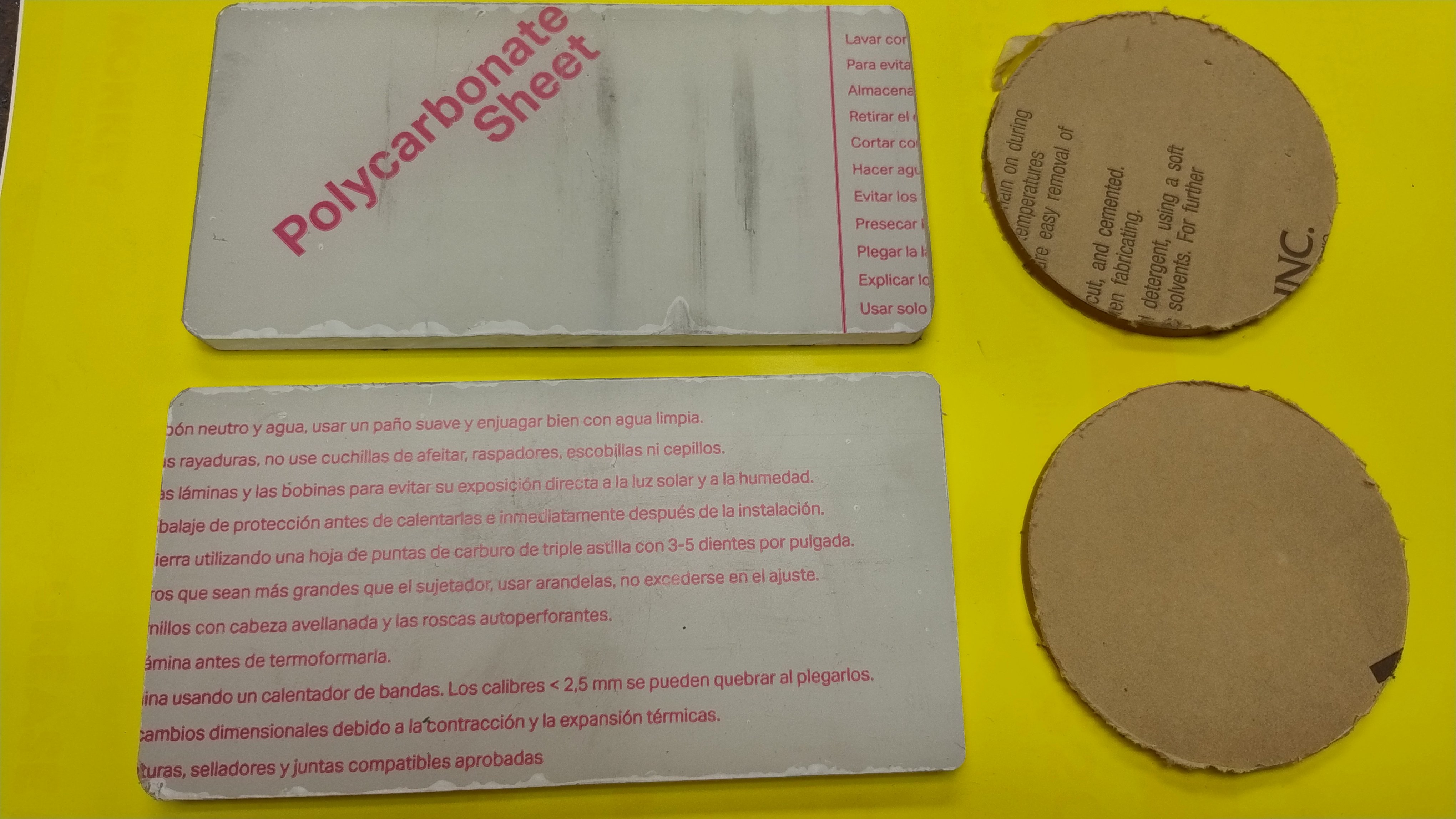

    Enough wood shop talk, how 'bout some plastic subject matter. Made both shapes to try best orientation of the SBDI, yet have quick access of X-over to test a couple different tweeter caps...
    xschop Posts: 5,691
    Too close?
    Got two other options without adapter plate...

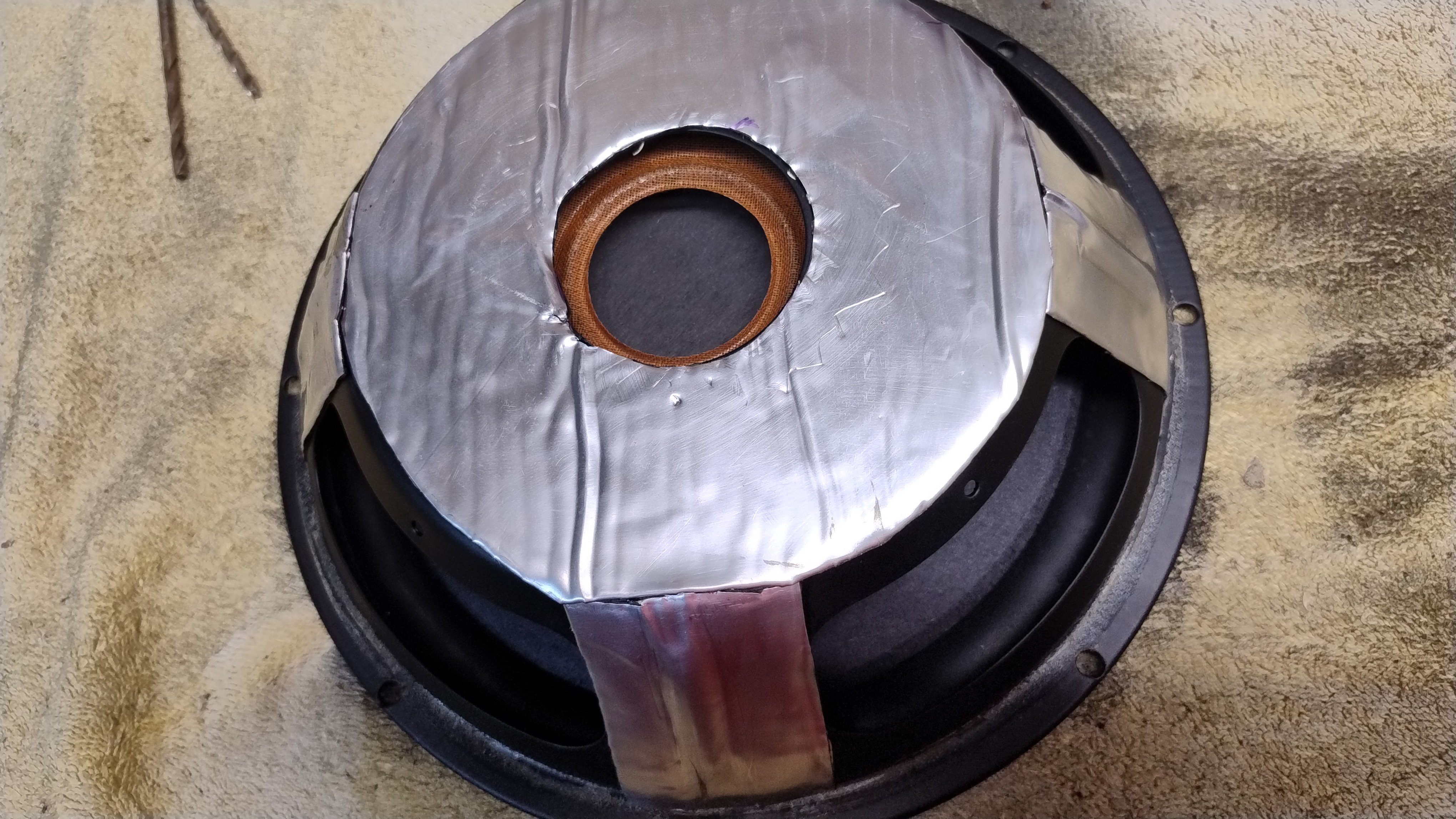

    Taped a patch of this material over one of the XS-8TLs. Not bad. Maybe only knocks down the tweeter output a wee touch...
    Used 3M spray. Hard part was getting it taught, yet weave aligned...
    There is a hint of brass colored accent interweaved into this one.

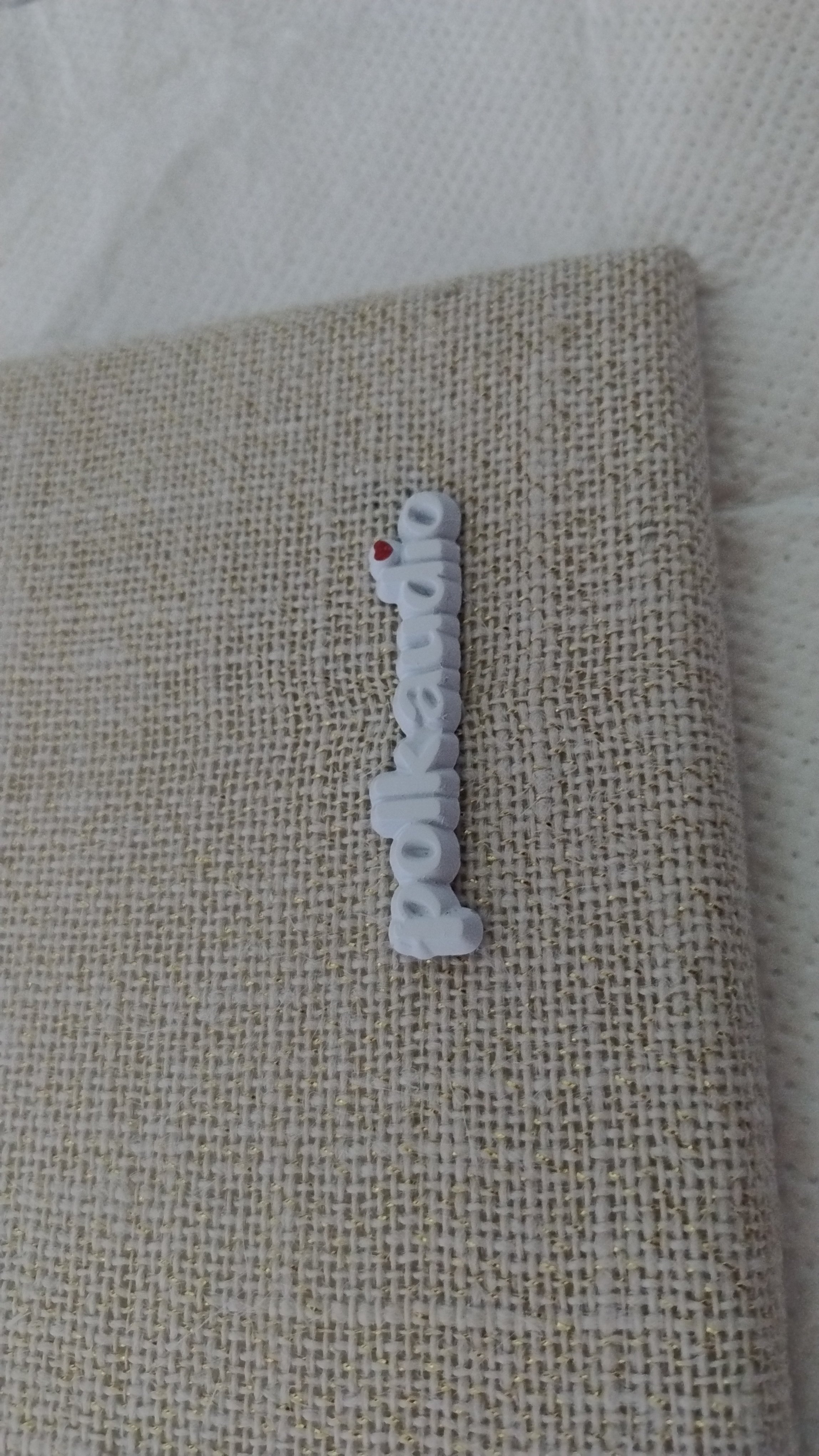

    Embled will get final color match to cabinet....Wifey approved.

    I would take the emblem, face sand it to bring out the silver, paint the heart red, and clear coat it..
