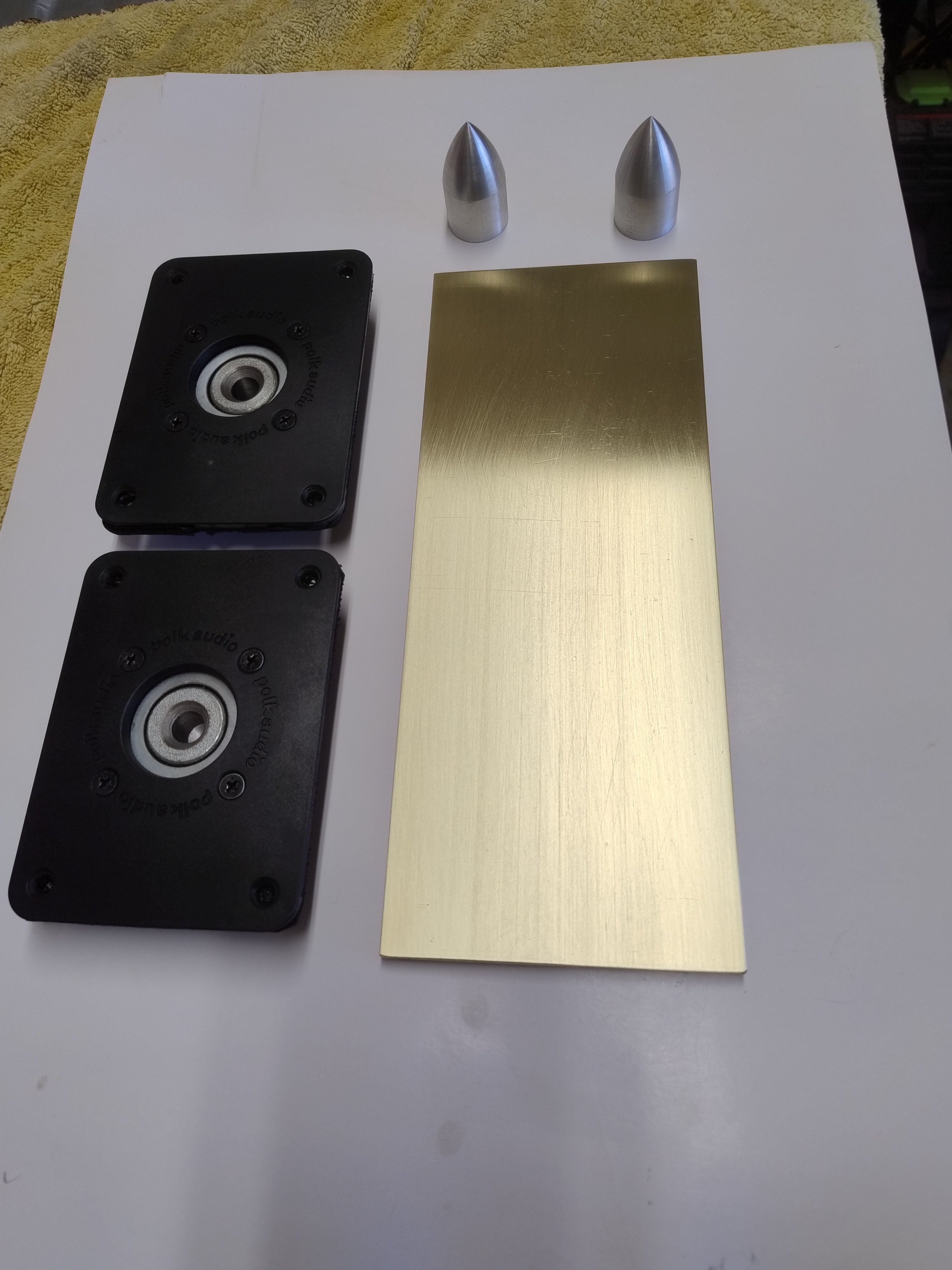

    xschop Posts: 5,690
    Will test a satin vs. flat white paint....Honorable mention goes to KSM.

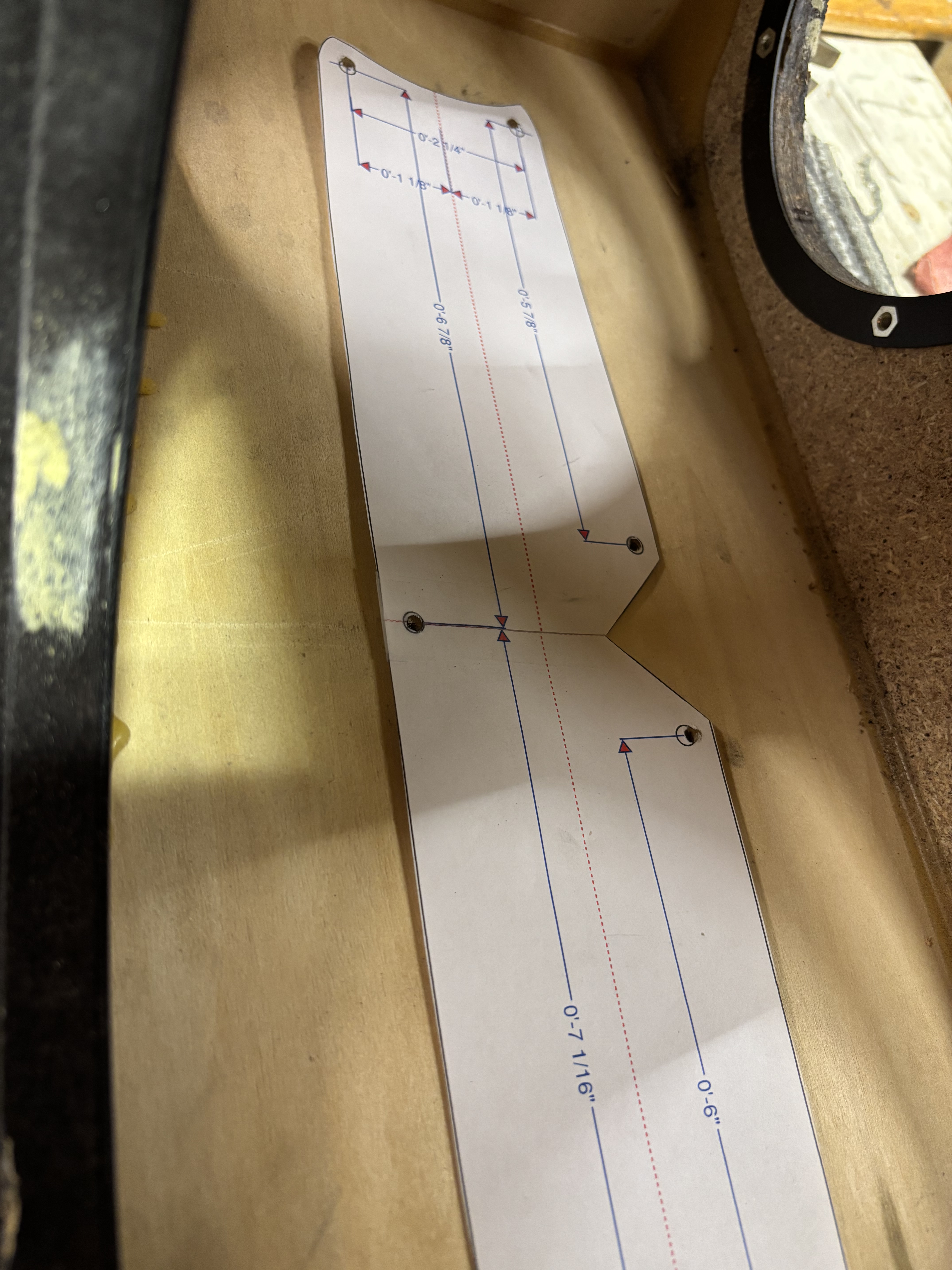

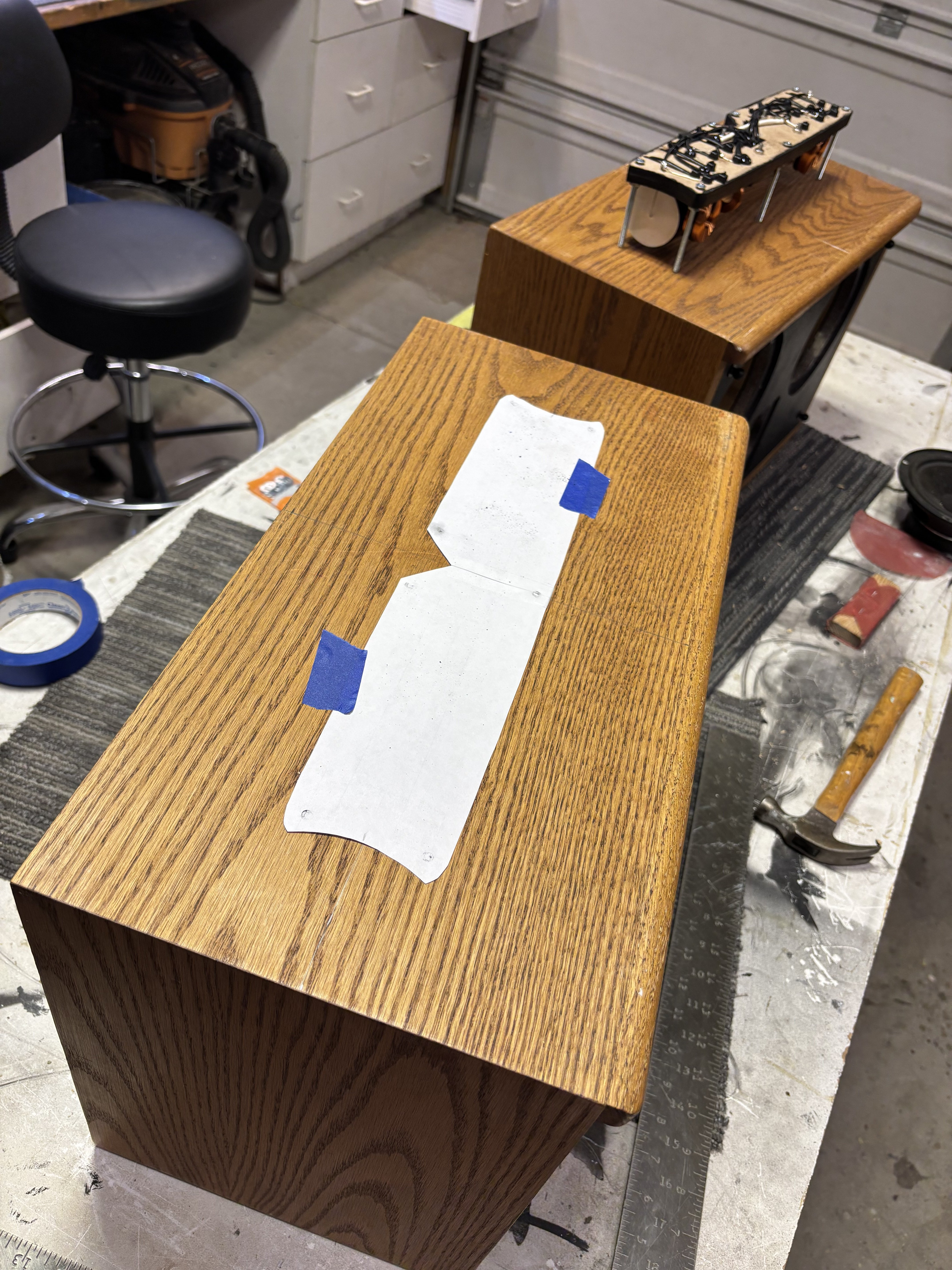

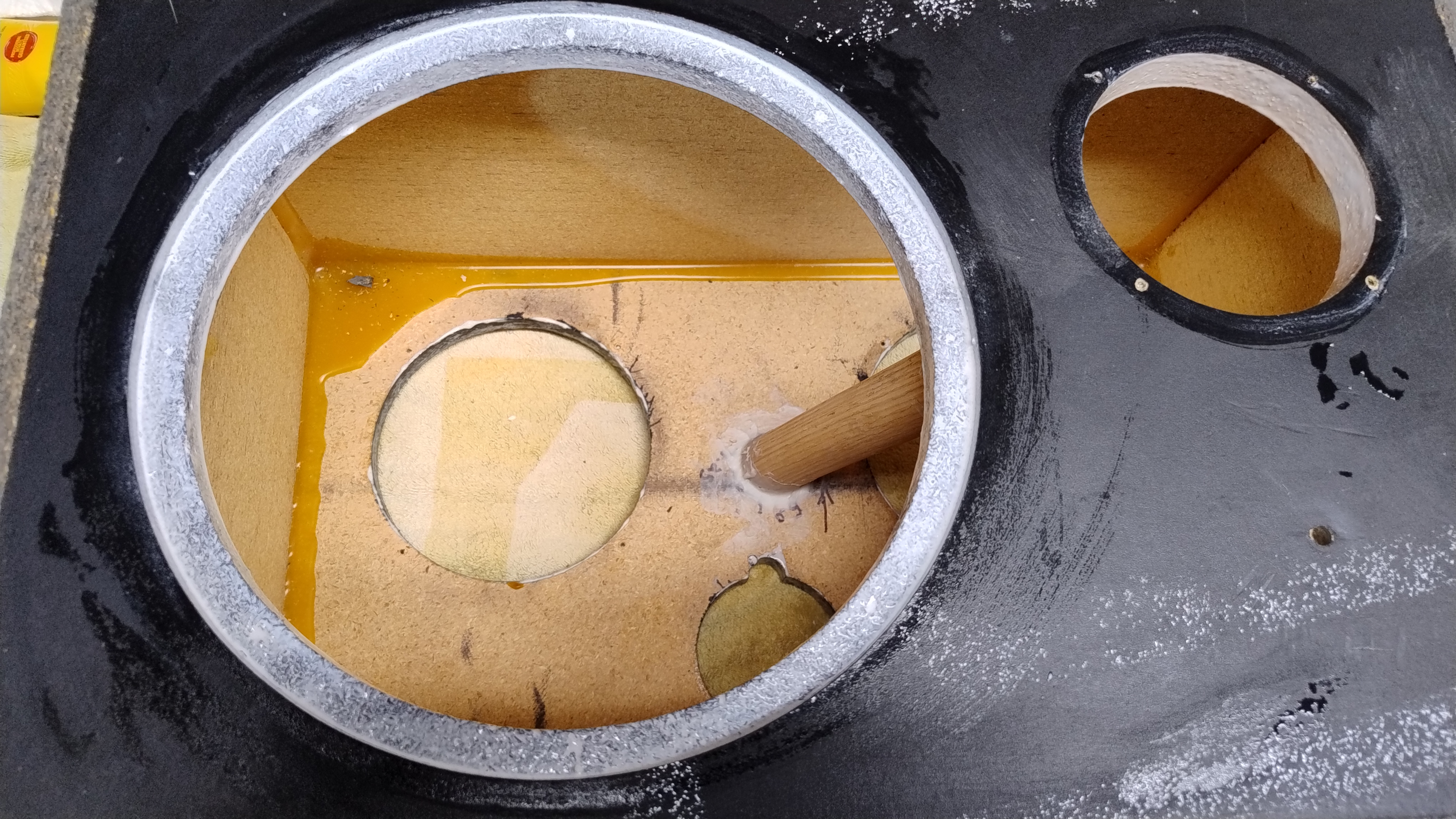

    1.25" solid oak dowel
    cross-cut 8 3/16" offset either side puts it angled and centered between front and back weak points...
    This clears all drivers and factory crossover.
    Reason why I cannot use the larger point to point board....
    Power Grab time.

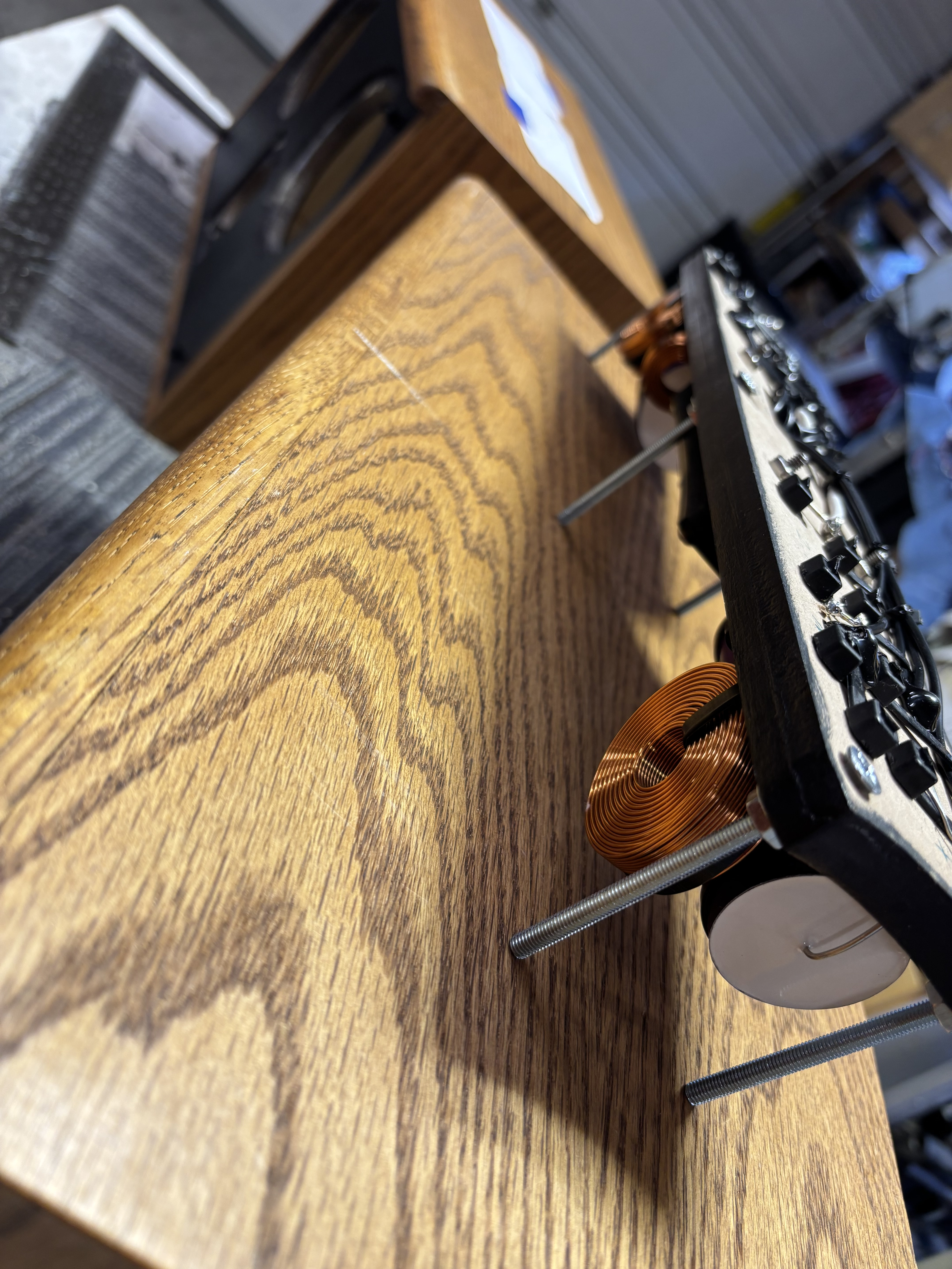

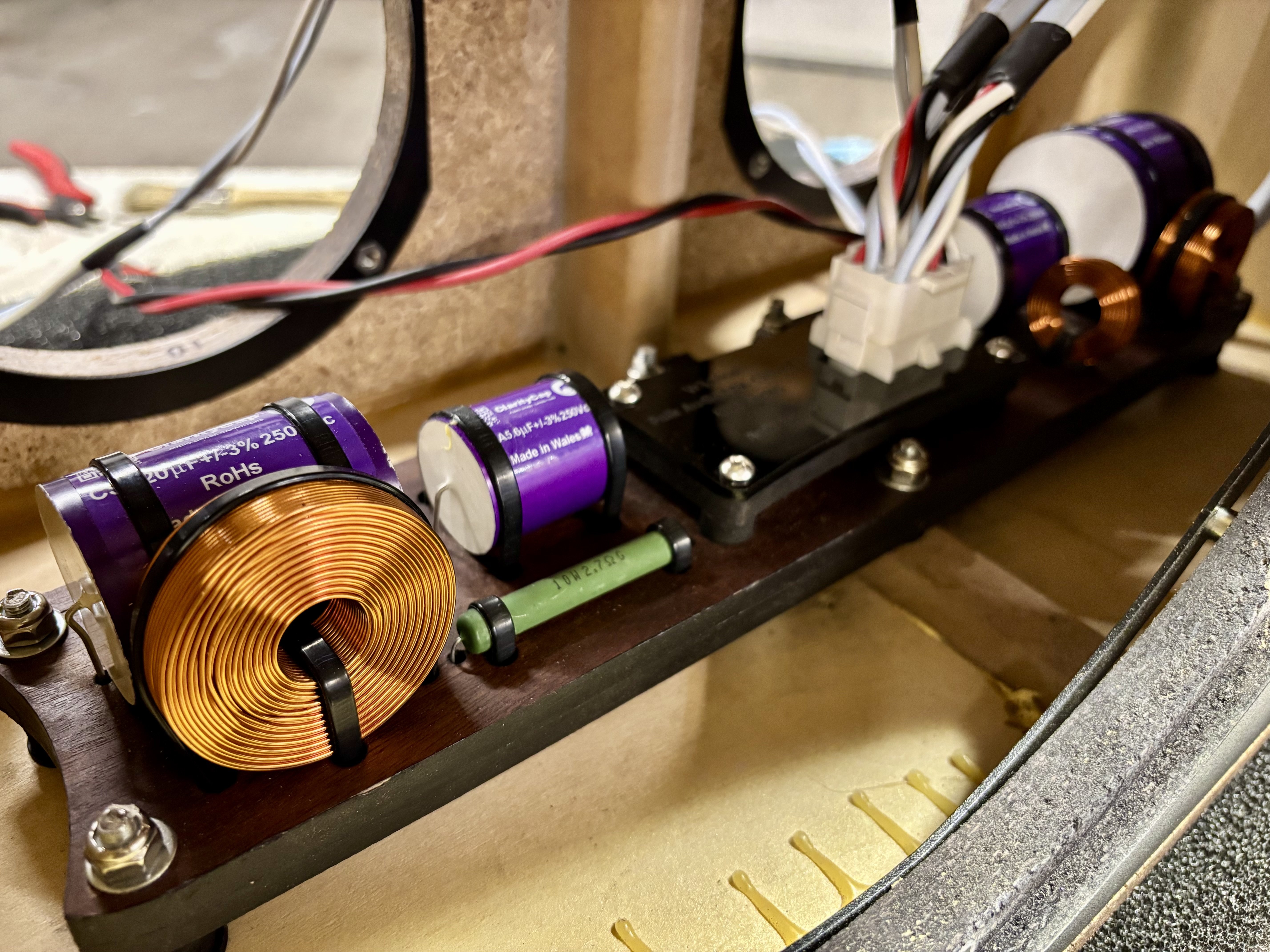

    VR3 Posts: 29,658
    Something like this would still fit
  • invalid
    invalid Posts: 1,554
    VR3 wrote: »
    That's awesome, problem solved.
    VR3 Posts: 29,658
    Yes, the inductor fits where the old crossover fit
  • invalid
    VR3 wrote: »
    You are definitely creative and meticulous.
    xschop Posts: 5,690
    Very nice. I'll machine an adapter that mounts the Erse Super Q/factory X-over in factory location as well, mounting with 1 bolt. All other hardware will be machined solid brass, including the terminal plates, tweeter plates, and custom grill pegs.
    VR3 Posts: 29,658
    edited May 7
    Thanks for the kind words :)
    really need to get the big sda inductor far away from the smaller ones for best performance
    Toolfan66 Posts: 18,333
    VR3 wrote: »
    Yet Polk put it directly behind the crossover board.
    I’m not disagreeing with you..
  • HzTweaker
    HzTweaker Posts: 1,082
    I thought as long as they were in different orientations you'd be in the clear?

    pitdogg2 Posts: 27,686
    edited May 8
    Correct me if I'm wrong.
    The big C-coil or laminated Erse are different critters than the original bobbin type Polk used behind the XO.
    As far as the field they produce.

    xschop wrote: »
    Power Grab time.
    What is the angle you cut this at? Definitely following along with your build.
    VR3 Posts: 29,658
    Lol I'm far from the inductor police but pools handling of the large sda inductor was... Maybe not the best.
    Mounted right behind the small inductors and mounted directly to aluminum on the big boys.
    An inductor mounted directly to aluminum will decrease in value by over 10%
    Good info!
    xschop Posts: 5,690
    xschop wrote: »
    Power Grab time.
    On it's side view it is a parallelogram with each long side 8 and 3/16" long.
    I started with a 8.5" length then gradually cut each end til it fit snug.

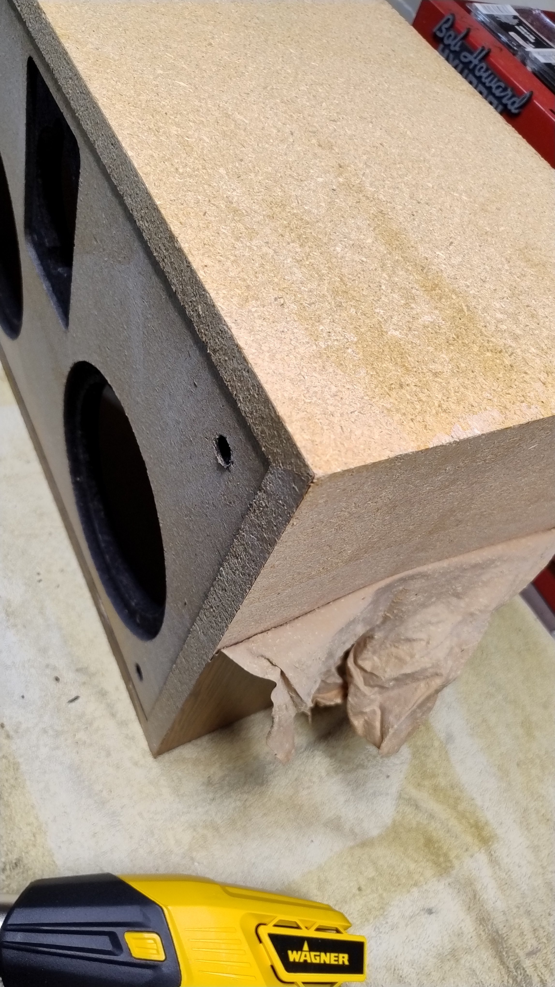

    Had a couple hours to work on them today.

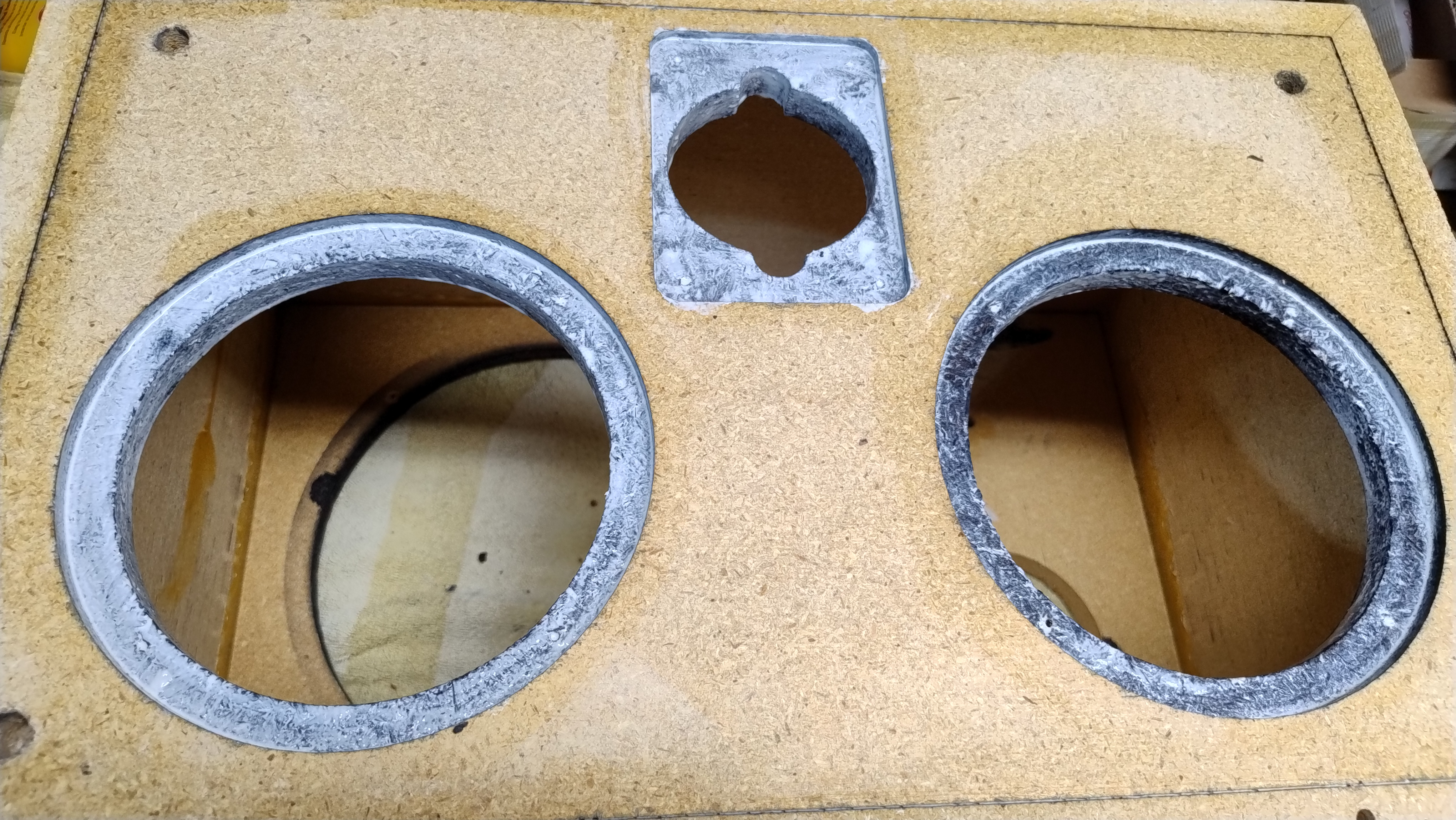

    Love that toasty vinyl smell. The front fascia was slightly peeling up around the drivers. Front baffle was actually congruent around perimeter although inset about 1/16". Filled seams with Gorilla Glue and driver recesses to aid in gasket sealing. Will shoot interior with rubberized paint.
    I'll leave the rear fascia on until after I take an aggressive grit belt sander to rear edges....

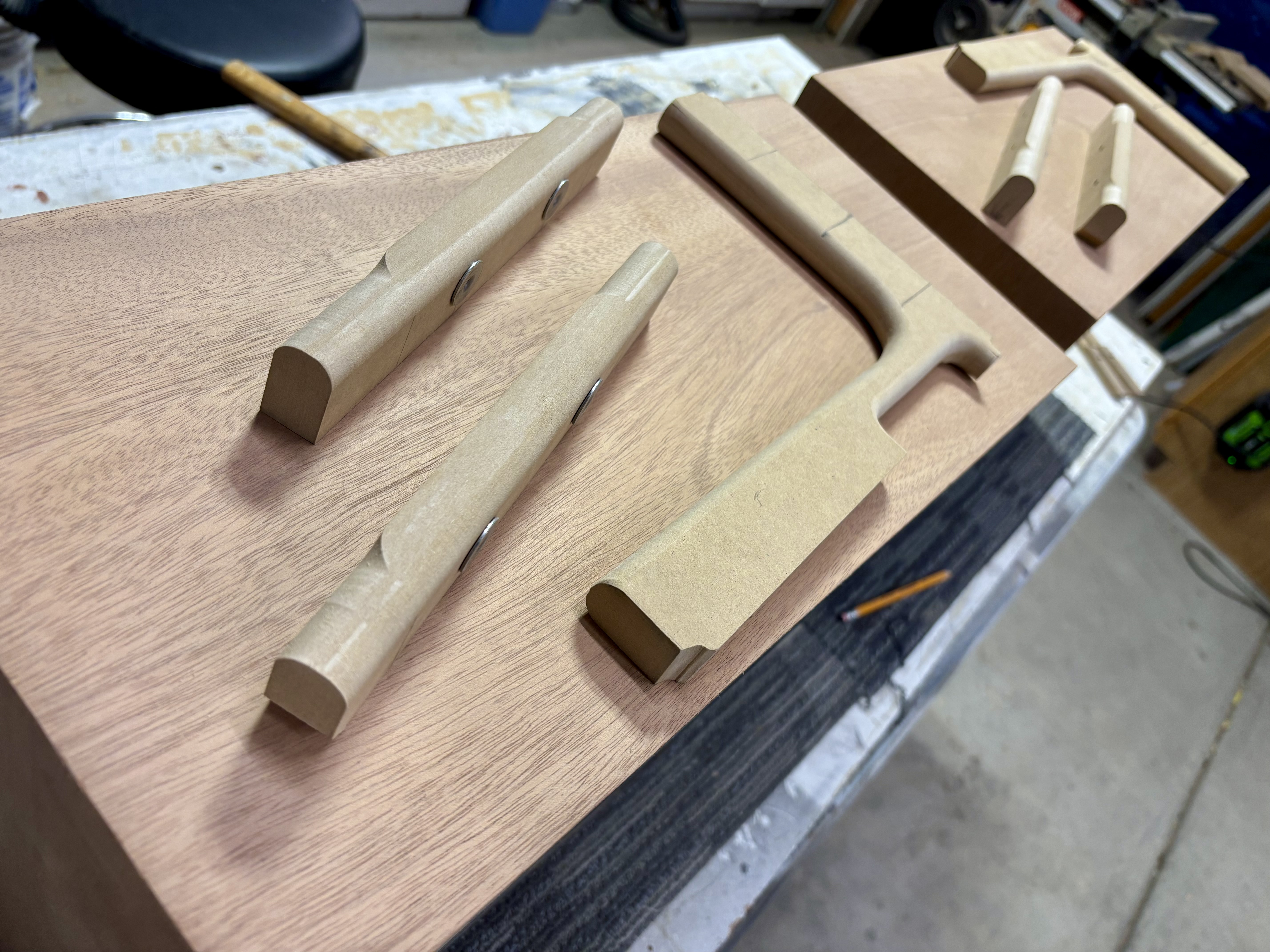

  • JayMX

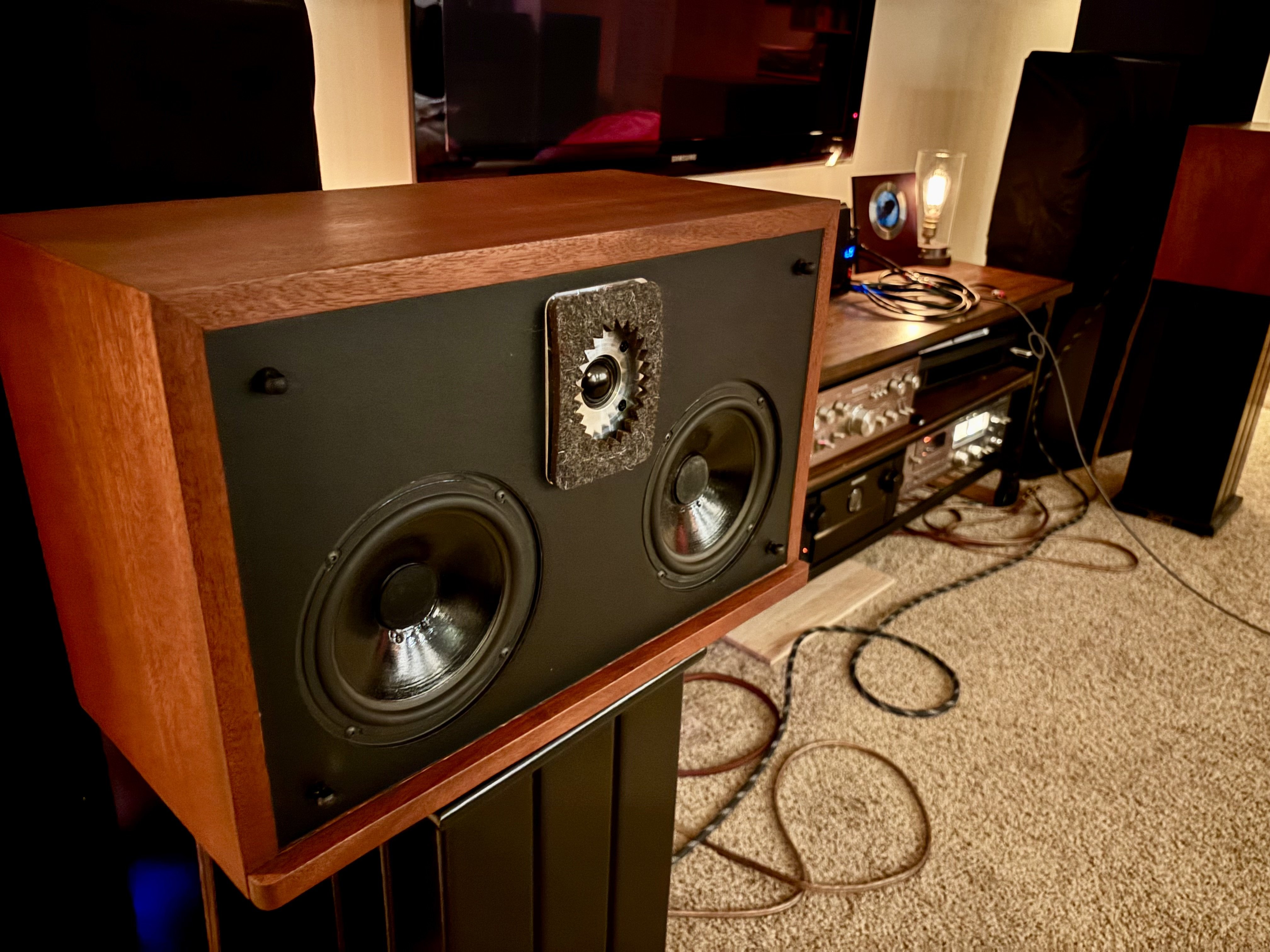

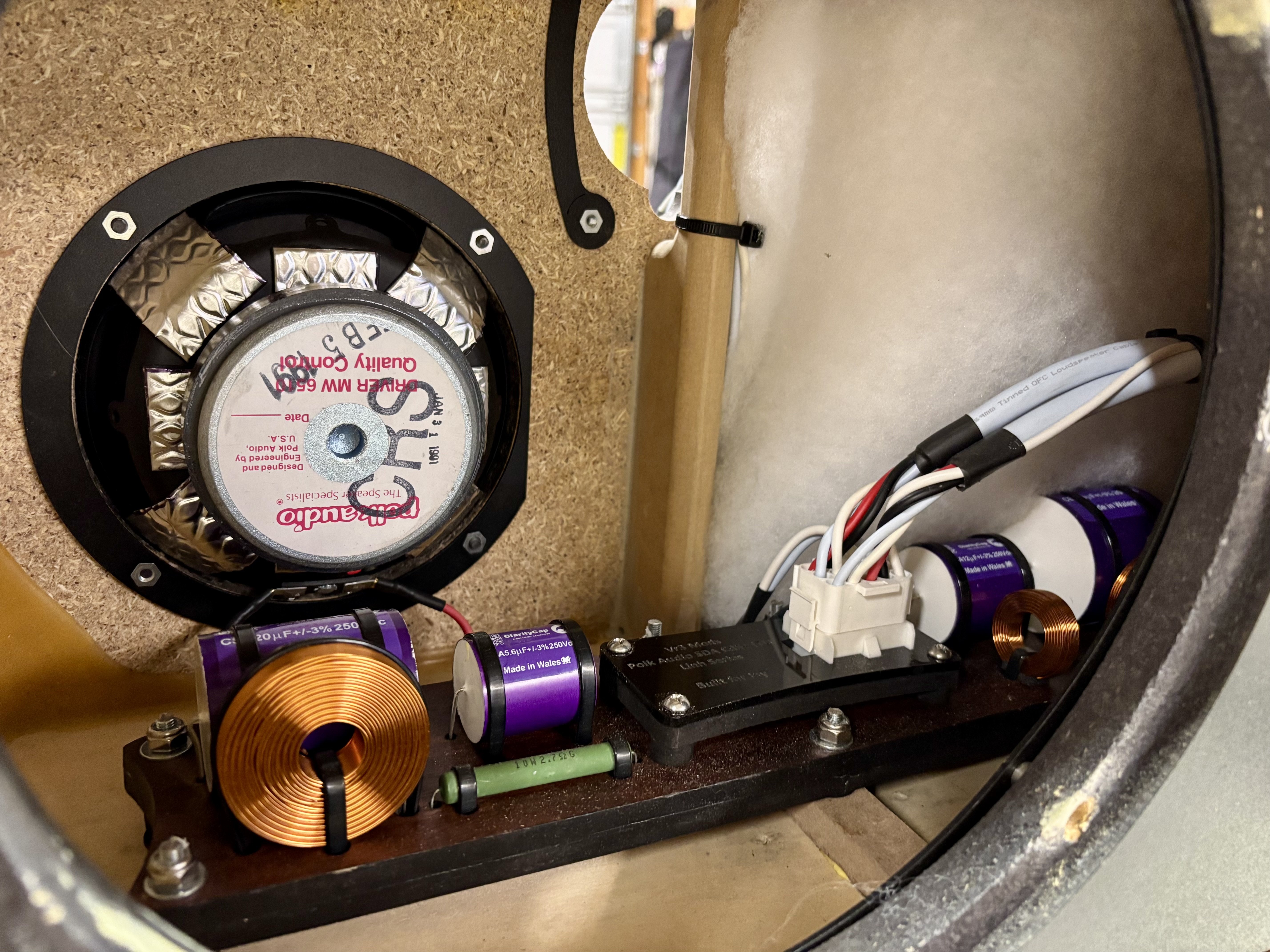

    JayMX Posts: 461
    edited May 9
    I love that you’re doing this build. I mostly finished mine and have been absolutely loving them with your tweeter plates and the 198’s. You’re gonna be in heaven. I have been lax posting my build thread - will do it once I complete the Dreadnaught.

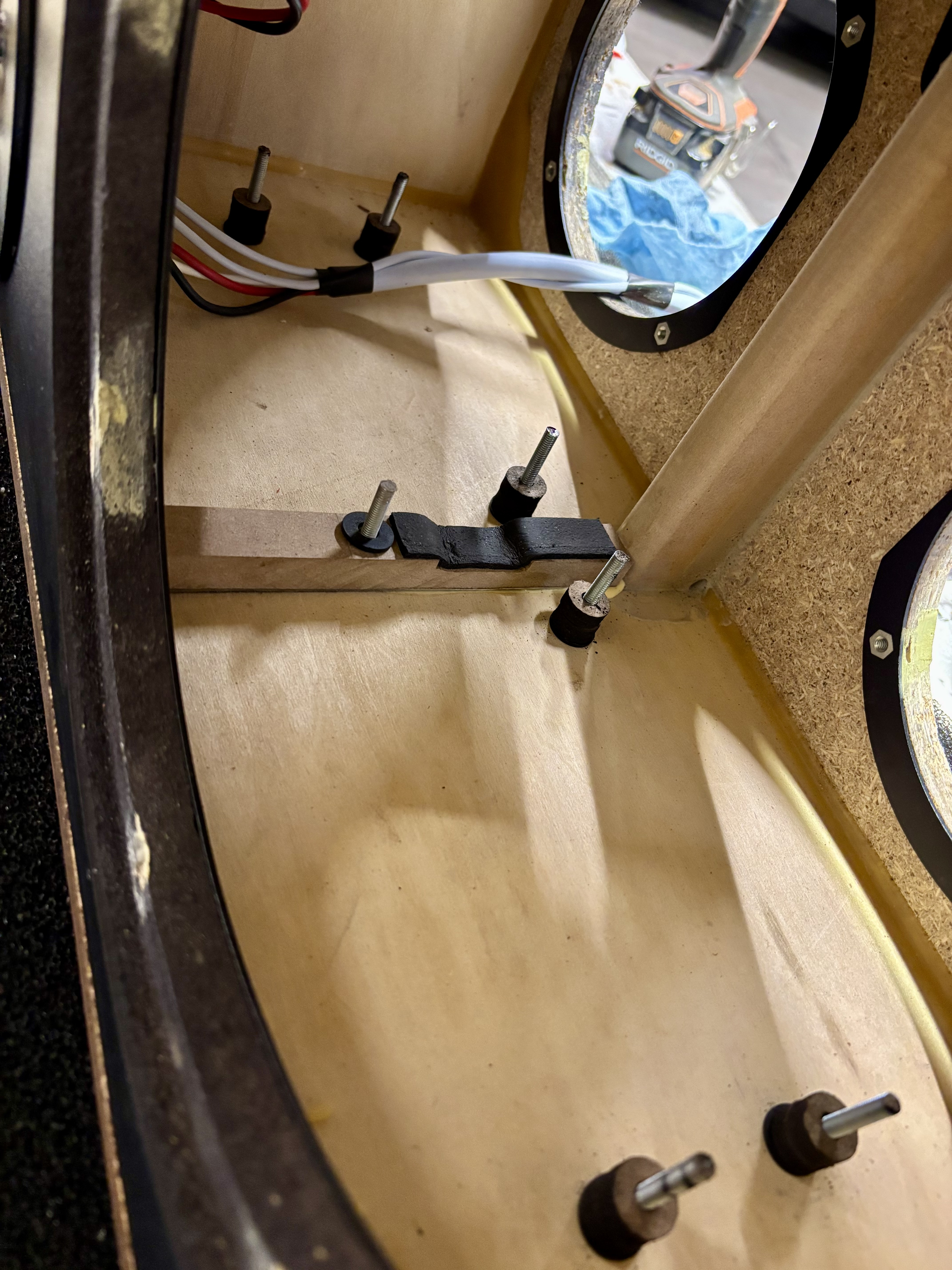

    I must say, the @VR3 crossovers are amazing in build quality and sound quality and they mounted up great in the bottoms of my CRS+ cabinets. I used some 10/32 tapered head bolts with Aileen’s to seal from the outside and neoprene washers between the standoffs and the crossovers’ substrates to isolate and seal the cabinets further. Everything is cinched together and secured with nylock nuts. They’ll never vibrate loose and they’re airtight. I used the same method for mounting the inductors. The screw heads ARE visible, but they’re on the bottoms and backs of the cabinets…. So, you don’t see them unless you go looking. 🤷🏻‍♂️
    I also built internal frame systems (glued in with liquid nails) which greatly stiffened the fronts and tops of the cabinets. They brace front to rear top to bottom. Only the back didn’t get a brace but it’s tough to do with the PR opening eating up most of the back of the cabinet. The frames also run lengthwise along the tops of the cabinets, each frame structure has four hurricane nuts installed so I can add some BH5 on 1/4” mdf plates behind the MW’s. I haven’t done this yet…. but one of these days I’ll get it done. Life has been busy lately. 😅
    Needless to say these are the best speakers I’ve owned to date. Mindblowingly good on my Bryston 4B. Me love them long time. 😎
    I flipped the crossover orientation after initial mockups to place the inductors as far away from the voicecoils as I could.
    Your tweeter plates with Tre’s pads looking and sounding s e x y together!!
    Veneeered the over the original oak cabinets with mahogany. Very happy with how they turned out. 🤩
    Current Collection: Monitor 4a (Peerless), Modified Monitor 7b (Peerless), RTA15TL (SL3000), Full mod SDA CRS 4.1TL (198’s), SDA SRS 2.3TL (198’s), R100's, R200’s, R300 🤩

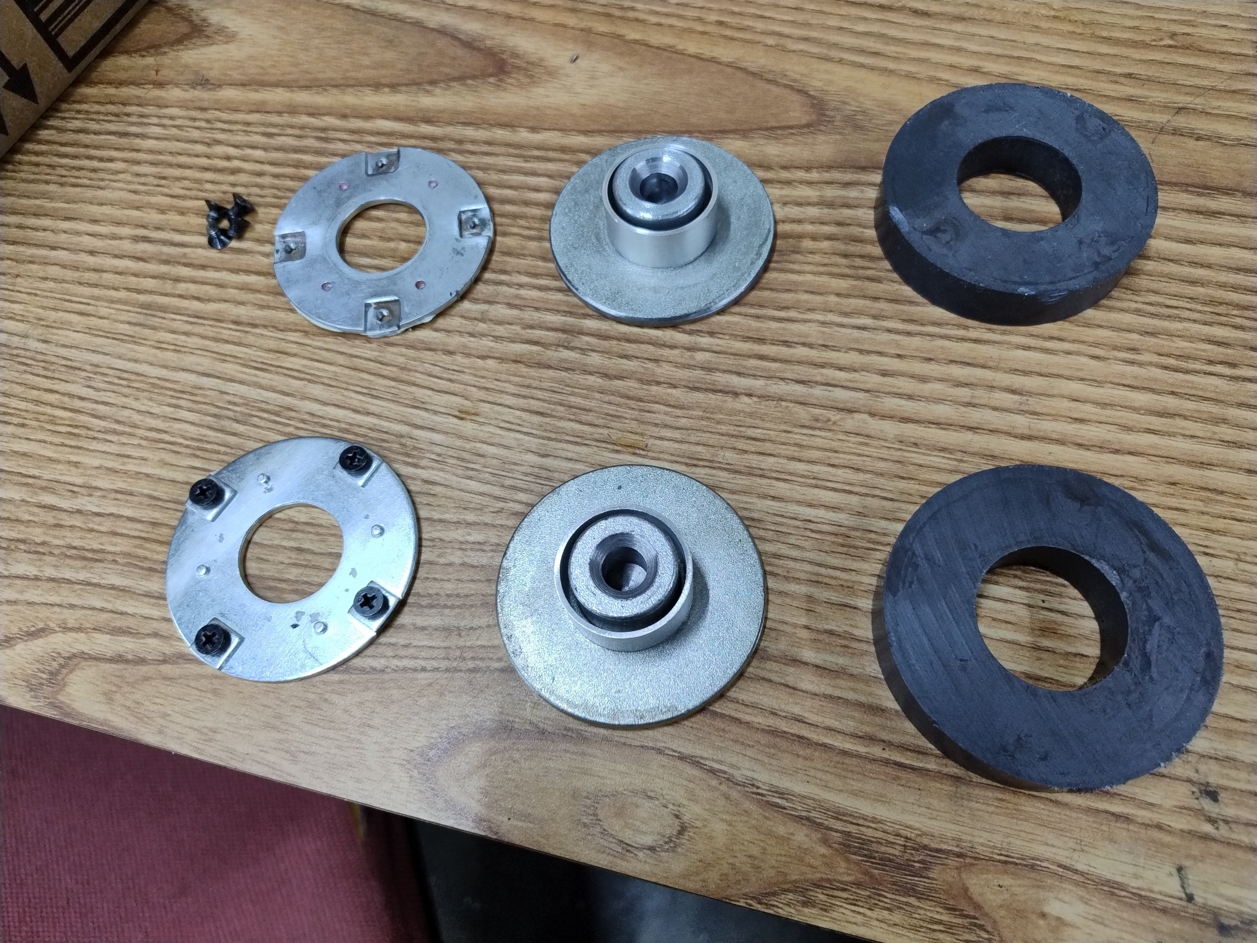

    I will be doing every mod to date on these drivers. Think I will err on side of caution and add focus rings to all the MWs instead of electroplating their pole pieces with copper. I'll test run an electroplated MW6502 soon and see if it exhibits the same behavior as the focus rings.
    I will also drill the MW pole pieces of 6510s and 6511's for an 1/8" punch to quickly try a different/shorter phase plug shape if I hear any anomoly.
    The 198s are already done, focus rings and back-chambered. Will make brass bezels soon too...
    Mesmerizing detail having just tested out in the XS-8TLs.
    These drivers in this set are actually not as worn as many I have come across, so I'm hopeful.
    JayMX wrote: »
    Nice Work!!!! Love It!!
  • Conradicles
    Conradicles Posts: 6,404
    That Polk and Bryston has to be a great match. I'm sitting here with some of those modifications myself.
    xschop Posts: 5,690
    edited May 10
    With the Power Grab set, I'm able to pick up the enclosure by the dowel and it's taken up minimum cab volume....

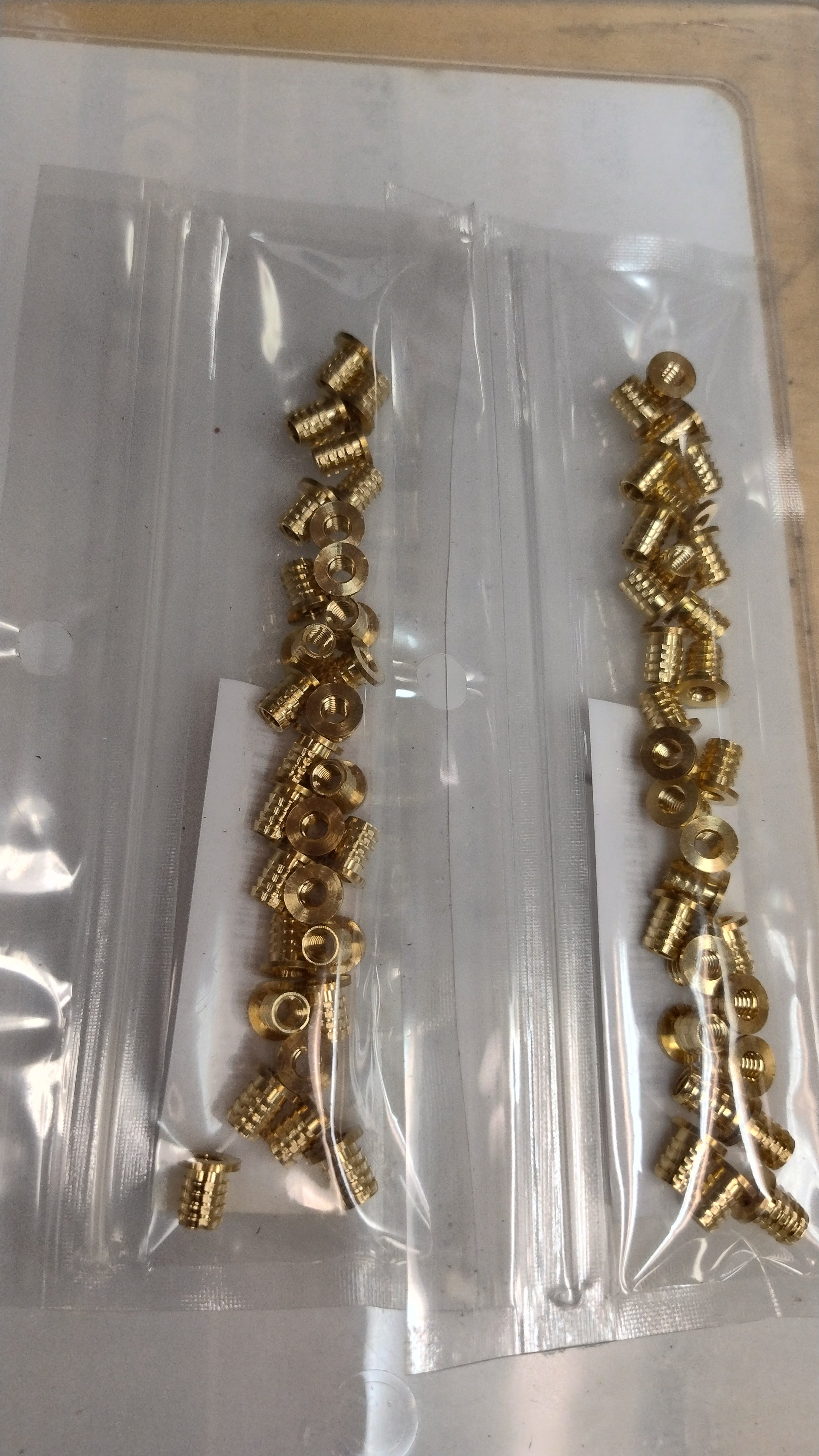

    Collecting more solid brass parts...
    Grill pins will be machined to dia. 0.430 full 0.9" length and glued to factory locations with 0.45" showing.

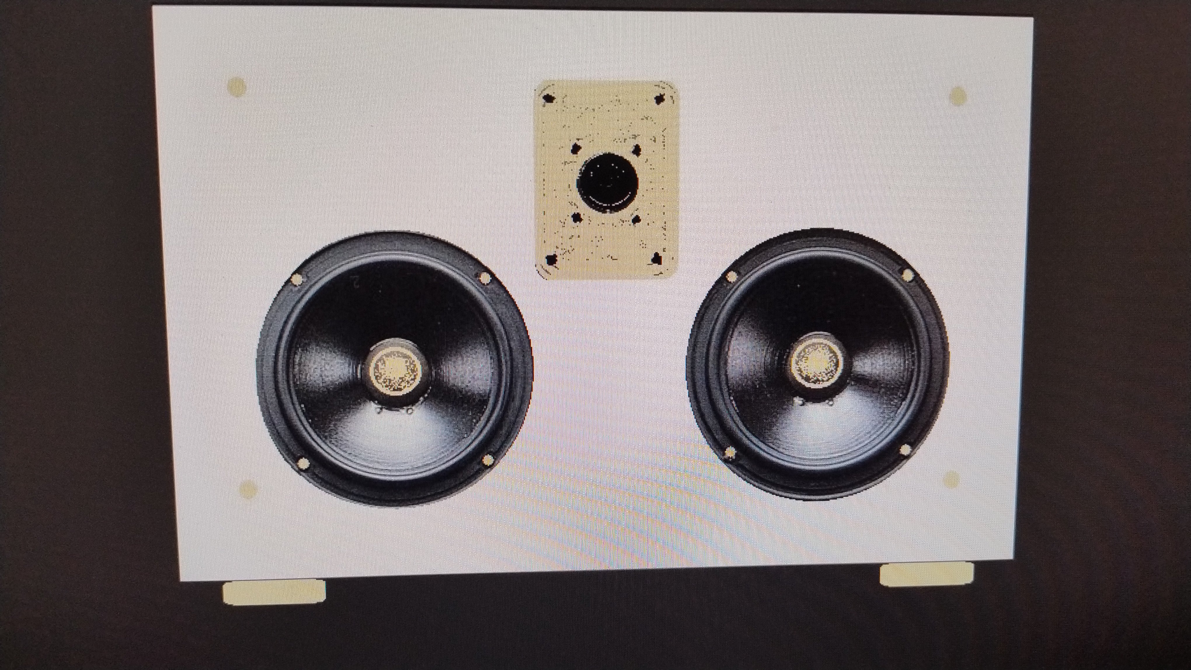

    Think I've settled on the final aesthetic.
    Matte brass drivers with antique white cabinets along with black oxide and matte brass fasteners for contrast...
    Flat white is a second option, but satin white is too much...
    VR3 Posts: 29,658
    I dig it
    Go magnetic grills to really go all out 😁
