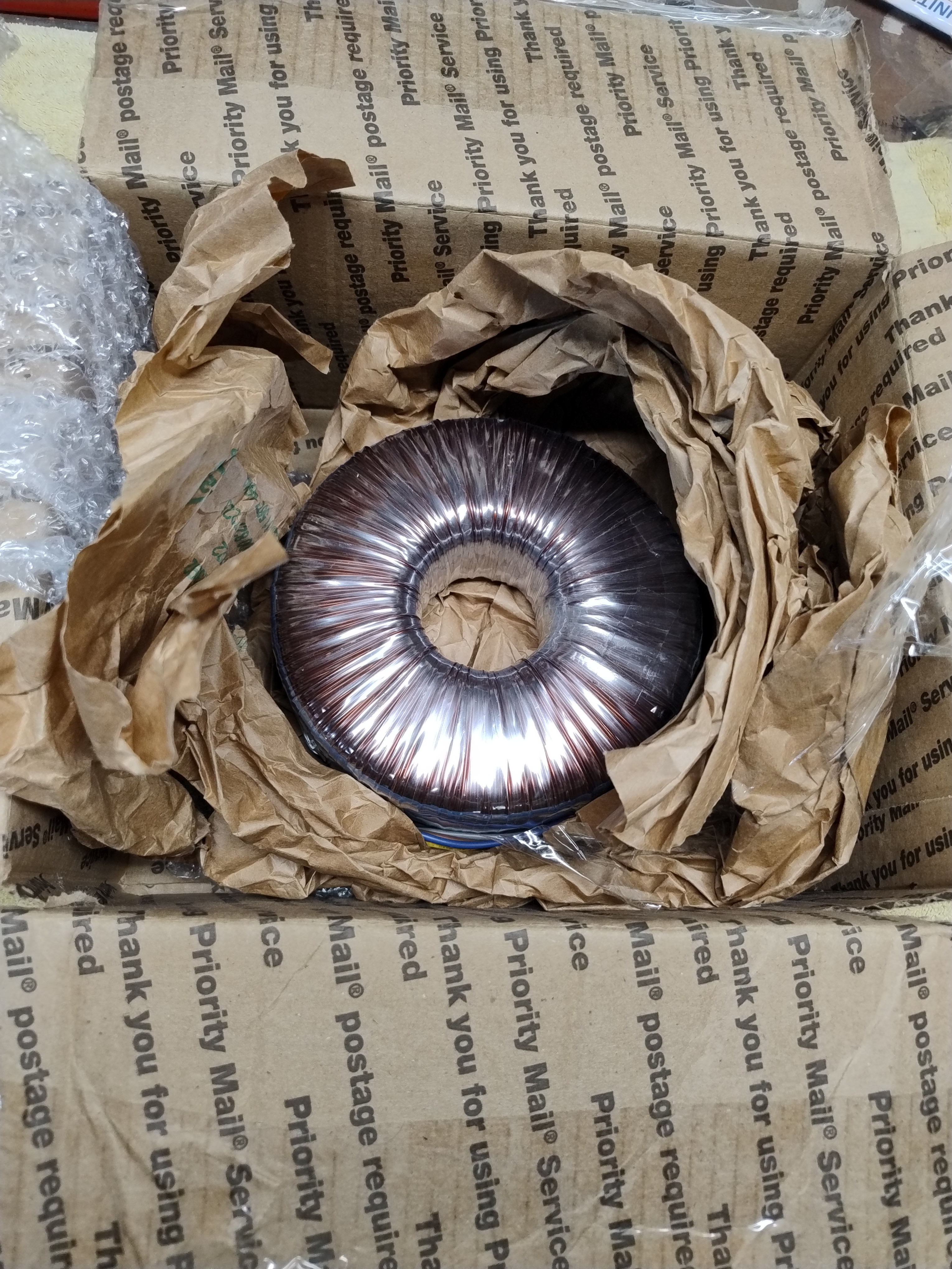

    Ordered the Super-Q 15mH inductors as I found a thread or two where others did the same. Besides, my SDA's are Power-Ported :)
    xschop Posts: 5,474
    One done. Hopefully the SBD inductors show up before the weekend and I'll drop these in the XS-8TLs, and set them sideways...

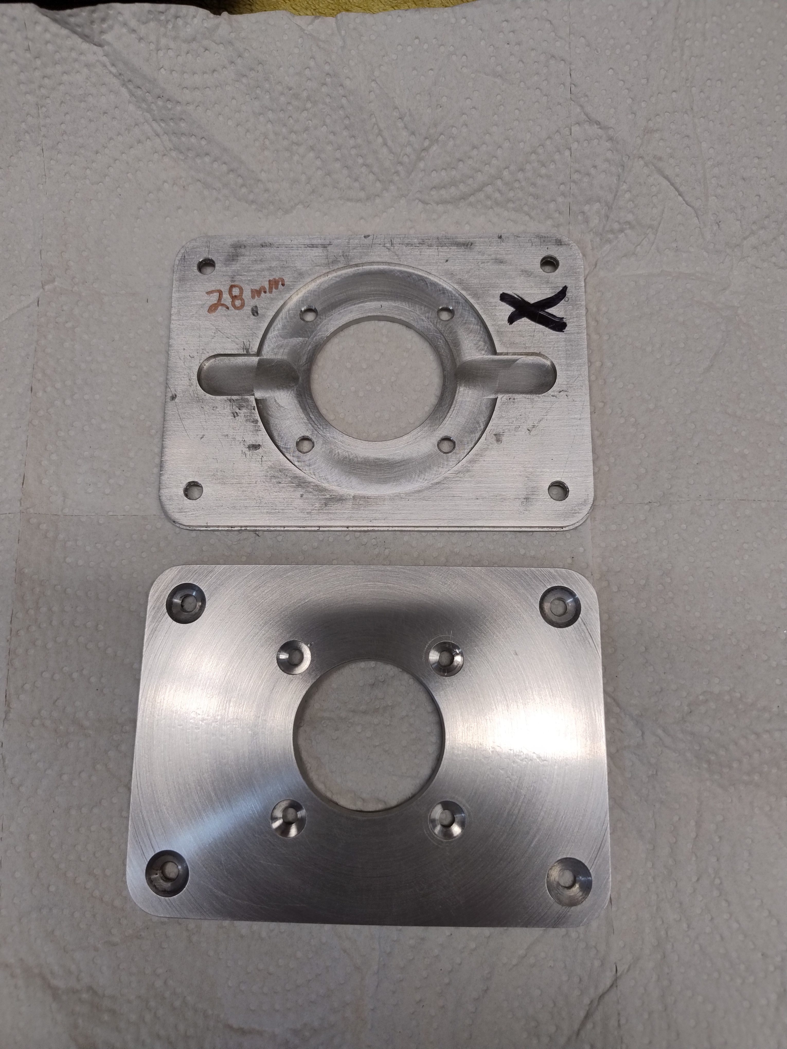

    You guys think the SDA soudstage width would be less if I moved the SDA driver closer to the MTM vertcal centerline?
    I could get a 14" width baffle this way and make them taller for tweeter height.

    If I make the RDO tweeter plate circular, I can squeeze the SDA driver closer to centerline. All the old POLK white papers say that the MWs were placed a "head's width" apart for the IACC to work. By default they could only get them 6.630" center to center. My ear canals are 5.7" C2C and I"m a big guy. Must have been some Neanderthals at Gallagher Mansion.
