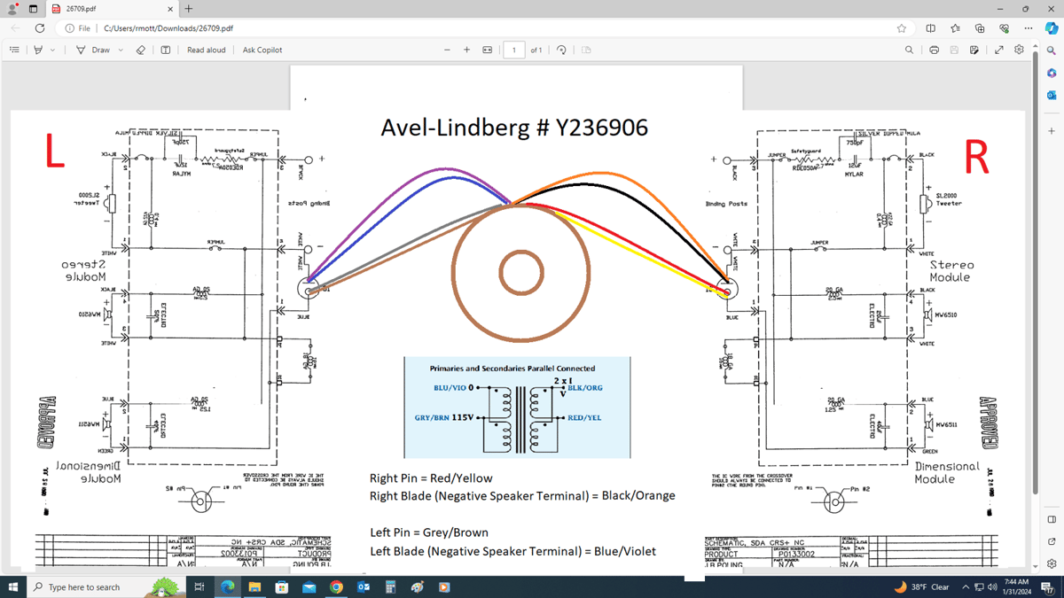

    They are pin/blade so just making sure I can use the dreadnaught with the factory terminals by connecting the only the single pin to red/yellow and grey/brown?
    xschop Posts: 5,655
    I played it safe and used wire nuts and speaker cable to the blades as well. Didn't wanna fry my amp.

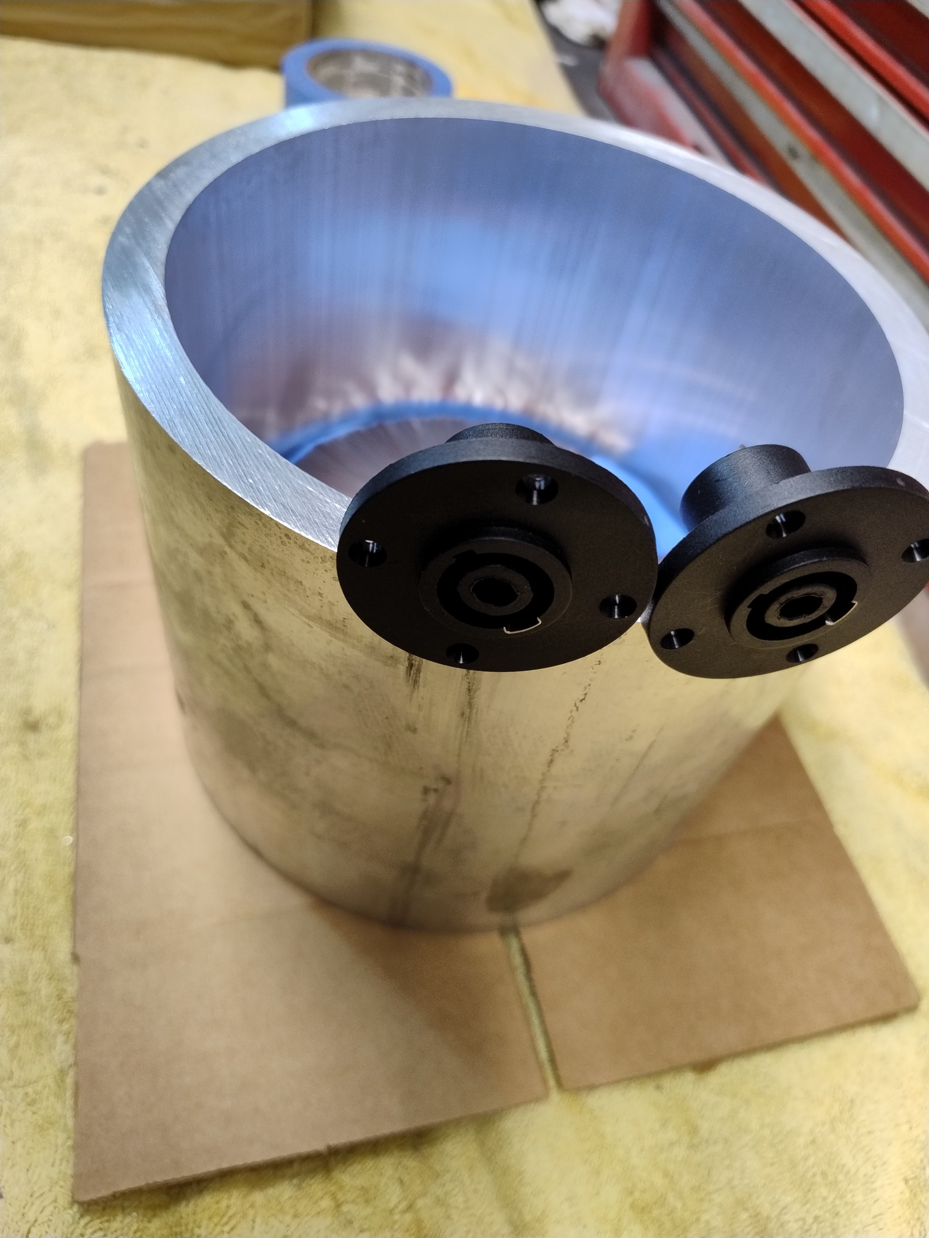

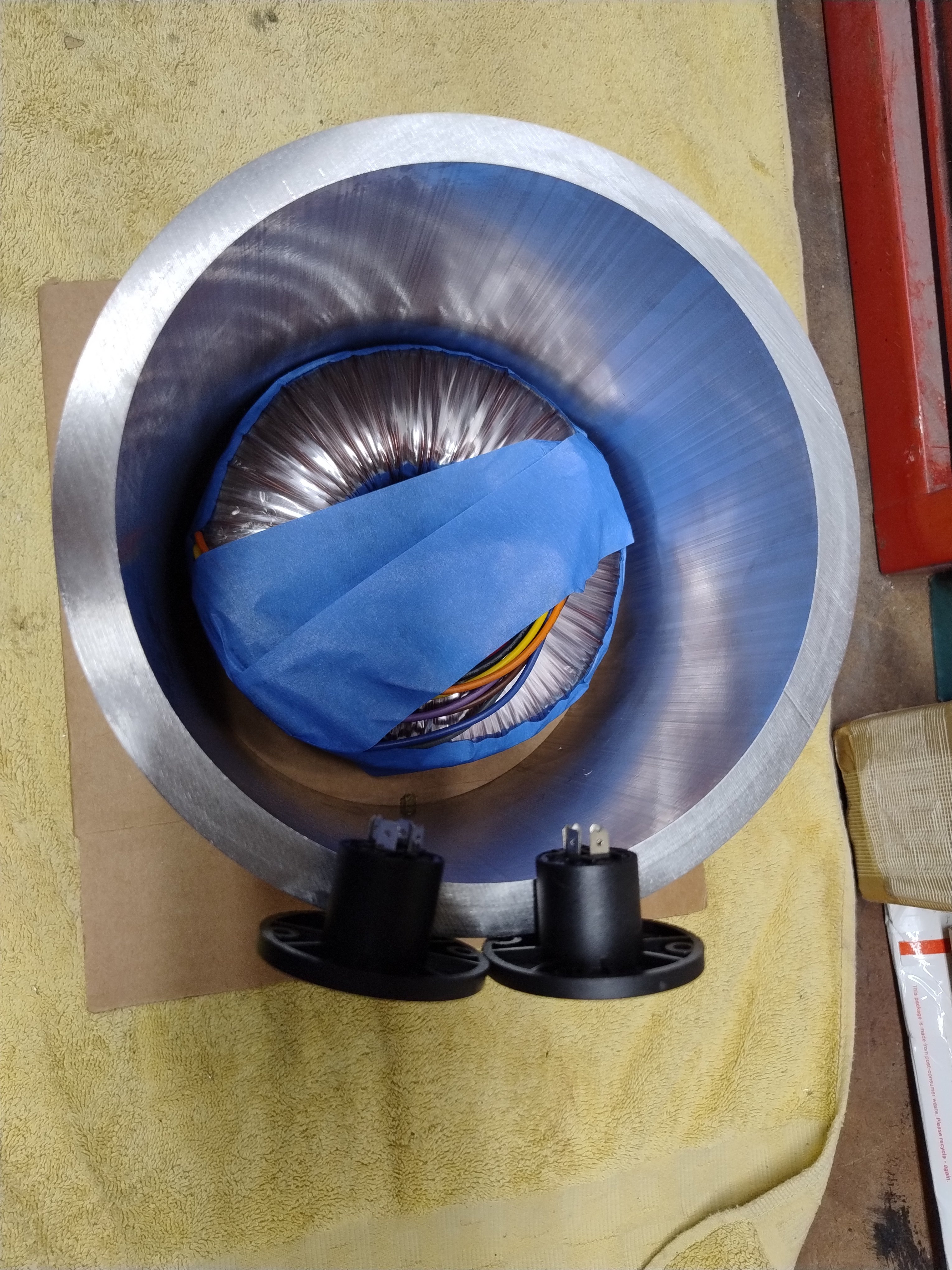

    The larger 8" Dia. 6061 alloy tube showed up today. Round 3 coming up soon...
    Will only be 3.5" tall this time and match my ribs lol.
    Going to spin out some custom Neutrik housings too...

    Will the transformer generate heat?
    I'm late to the party, sorry if this question has been answered already. :#
    xschop Posts: 5,655
    I dont think so. Maybe run on larger amps/SDAs?
    No.

    HzTweaker wrote: »
    No heat no matter how hard I've try :) . I've used high current 1200 wpc monoblocks on my dreadnaught equipped sda's for many years with no issues.
