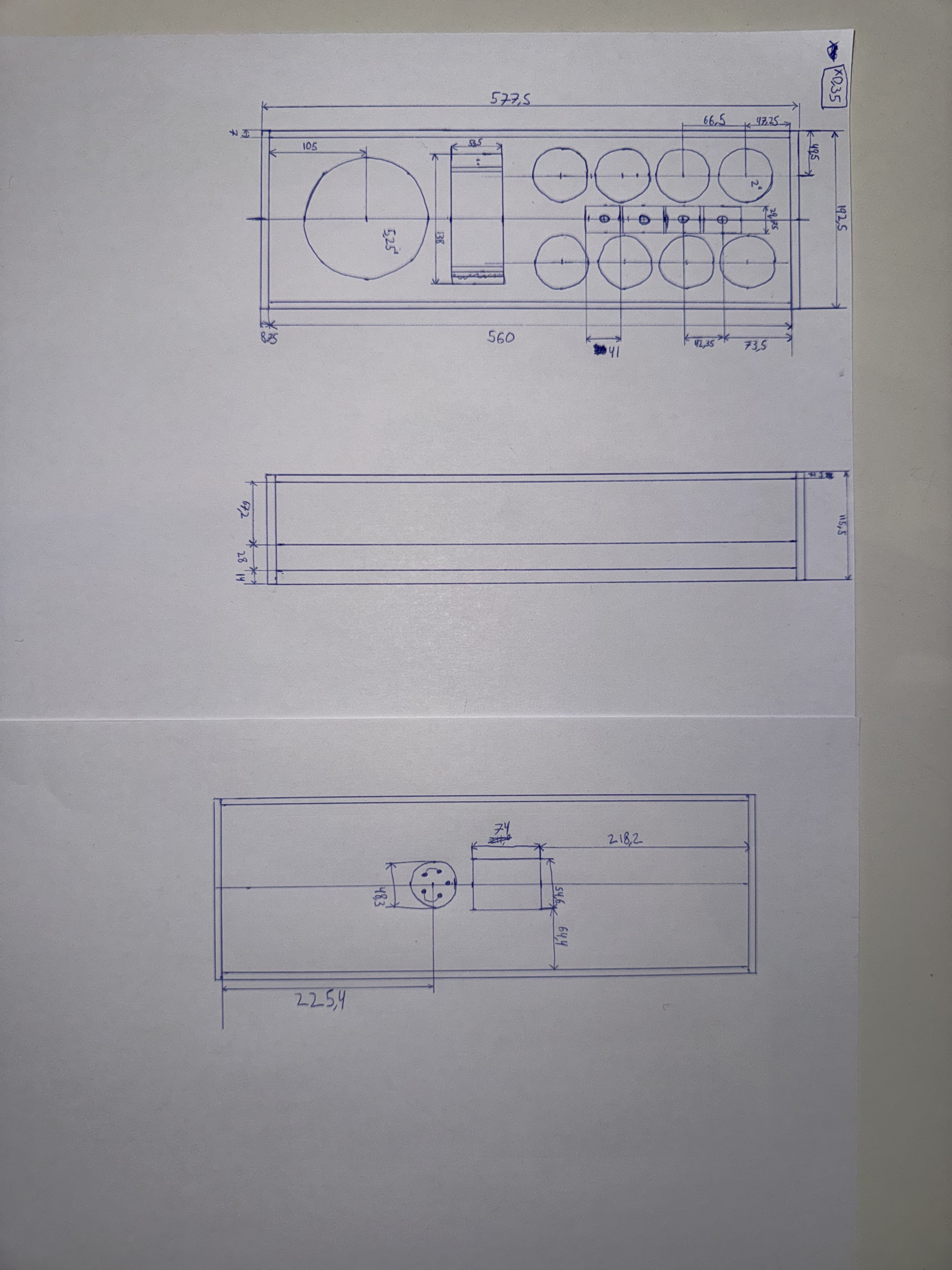

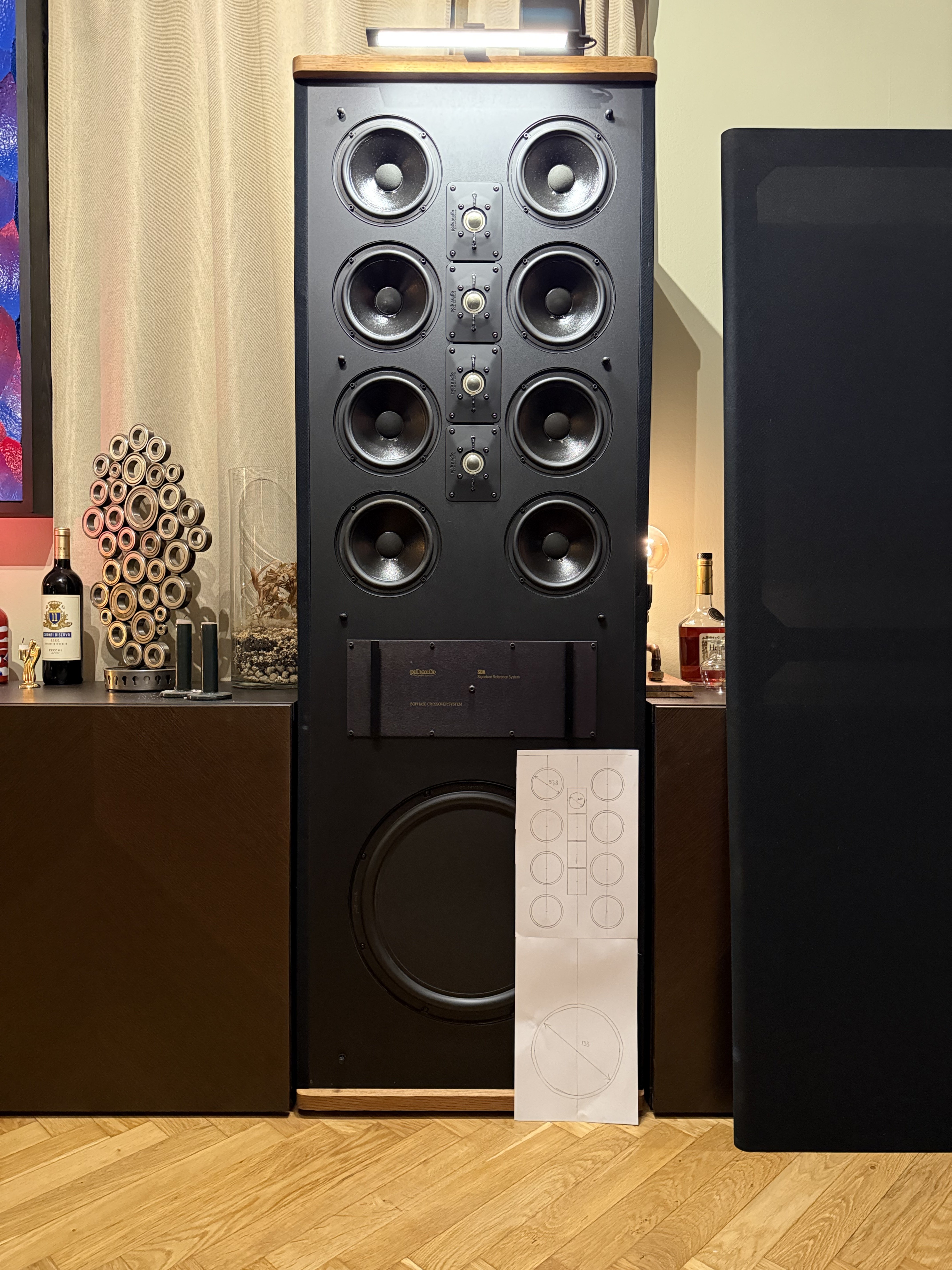

Hi everyone! I am building miniature versions of my SDA SRS speakers. I would like to have some pro help in my project. I have ordered mid and tweeters, and i am going to design the crossovers now.
I don't even know where to start. Every calculator is for 2-way systems, but i want to include SDA in the speakers. I know that it is impossible to get it exactly right with these components, but i want to try to get it as close as i can.
Down below are some images of the original wiring scheme with all the component values, and also the new speakers/tweeters for my mini build, along with pictures of the original speaker/tweeter specs.
Please message me or answer here in the discussion.

If you want smaller SDA speakers find a pair of SDA CRS+. Otherwise, you are wasting time and money.
The front baffle of full sized SDA's play a part, not sure how'd you even calculate that. I'm sure you could make min-replica's after much time, expense and effort. But they will not sound anything...........anything like larger SDA's. They might not even sound good playing 2ch music.
What size passives are you using and how are you calculating the volume of the cabinet? How do you know your mini driver choices will even excite the PR enough to get the freq response nec? That's one of hundreds of questions.........
The drivers that create the SDA have to mathematically be positioned a certain distance apart. How wide is the front baffle on your mini's? Thats why CRS's are on their sides.
It's a waste of time and money

The old SDA's are an acoustic experience. It can't be scaled smaller easily because certain physical parameters and ratios of those parameters are needed for the process to work effectively. SDA- CRS's are about the smallest you can go physically.
If this were an electronic issue it would still be difficult, but perhaps with enough knowledge, they could be scaled down to somewhat work.

As long as the centers of the MW drivers are the listener's ear-to-ear width, the IACC will be achieved.

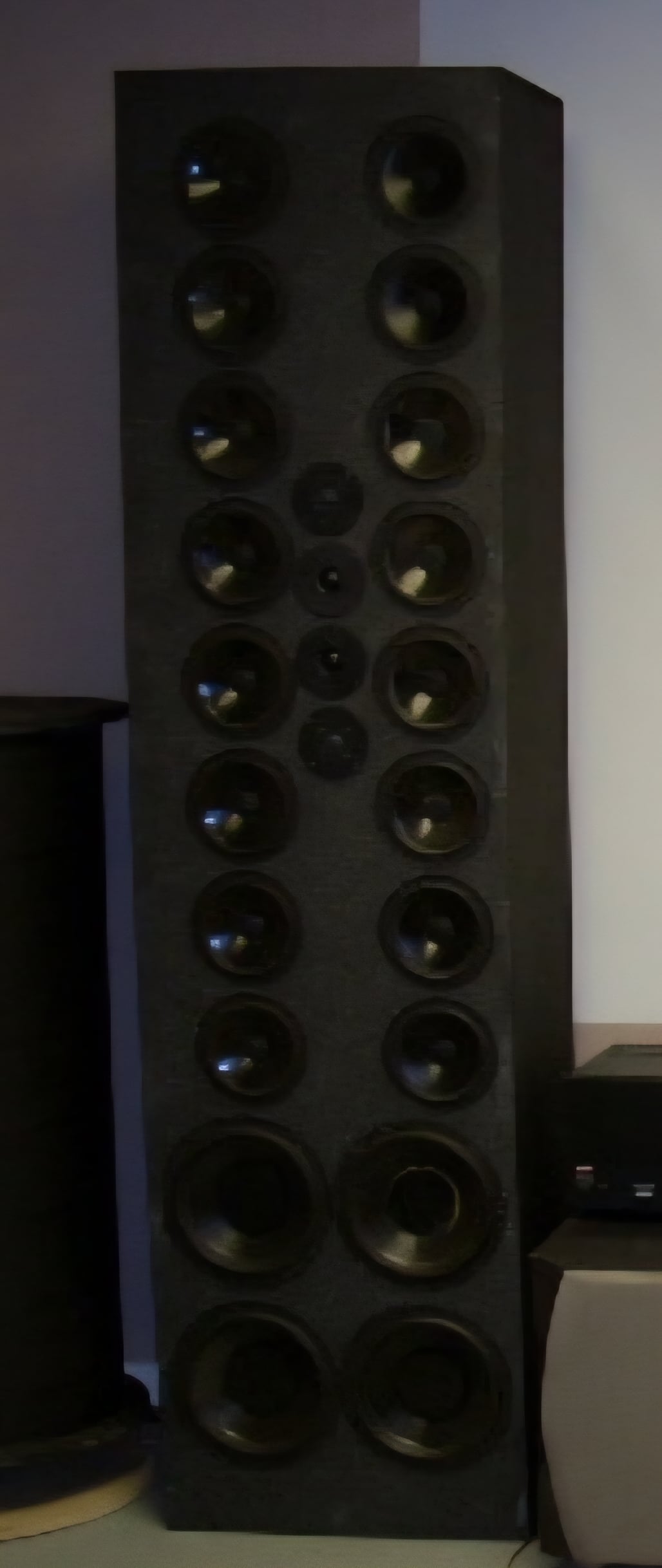

I recall a member built a homemade pair of very large SDA speakers years ago with MWxxxx drivers properly spaced. By all of the many accounts they sounded like crap.
He's not using MW drivers and to me "mini" means smaller than CRS's.
I guess the OP needs to define what 'Mini" means. He's showing 2" speakers
H9"Appreciation of audio is a completely subjective human experience. Measurements can provide a measure of insight, but are no substitute for human judgment. Why are we looking to reduce a subjective experience to objective criteria anyway? The subtleties of music and audio reproduction are for those who appreciate it. Differentiation by numbers is for those who do not".--Nelson Pass Pass Labs XA25 | Galion TS P75 Pre | Holo Audio Cyan 2 Dac | MIT Shotgun S1 | Puritan Audio PSM136 Pwr Condtioner & Classic PC's | Legend L600 | Roon Nucleus 1 w/LPS - Tubes add soul! -
Found them.

Just a disclaimer. This build is just an homage to my real pair. I know nothing will be exactly right, because of MANY factors. But i kinda want to try to get it as close as i can, just for fun, just for the nerdiness.
My first thought was a usual 2-way crossover, and to scrap the SDA totally. But… then i thought. Why not make it as close as possible?
So.
Im taking every measurement and multiplying by 0.35. This results in 2 inch drivers instead of 6.5 inch. And the passive radiator in the bottom will be a 5.25 inch.
I think i will buy one seperate 8 inch Sub to carry the heavy hz, so that won’t be a problem.
In mm it will be 577.5mm in height, 192.5 in width, and 115.5mm in depth. Mostly made of MDF, and the top and bottom in pure oak.
The SDA cable will be a gold plated 3.5mm AUX just for simplicity.
I know i make trouble for myself by buying no-name speakers off amazon. But i don’t want the homage minispeakers to cost more than the original speakers… lol.
i think with the right crossover, i can make it kind of playable. At least i want to try!
I Will keep you guys updated. As soon as i get speakers and tweeters in the mail I Will start with the cabinets. -

I think for the IACC to work the stereo and dimensional speakers center to center distance should be at least the distance between your ears. You will have only 3.6 in. Not trying to be negative but it is something to consider.George / NJ

If you can get the center to center distance of MWs 145-170mm from each other, IACC will work assuming your head is positioned in proportion to the SDA setup diagram.Don't take experimental gene therapies from known eugenicists.

You guys have a point. If the SDA effect depends on the distance, it is game over for the sda idea.
My first thought now is to instead do a 2-way. But i wonder.. should i do a real 2way or should i try to make the tweeters seperate like the original? And if i do that, should i do the same for the mids? Or should i just aim for a regular 2-way -
Even at @100mm distance (as you have in your tech drawing). The IACC will be there, just diminished, soundstage not even as wide as a set of 2B's.

Found them.
I rember those from way back. I had looked for the post but couldn't find it. ThanksStan
