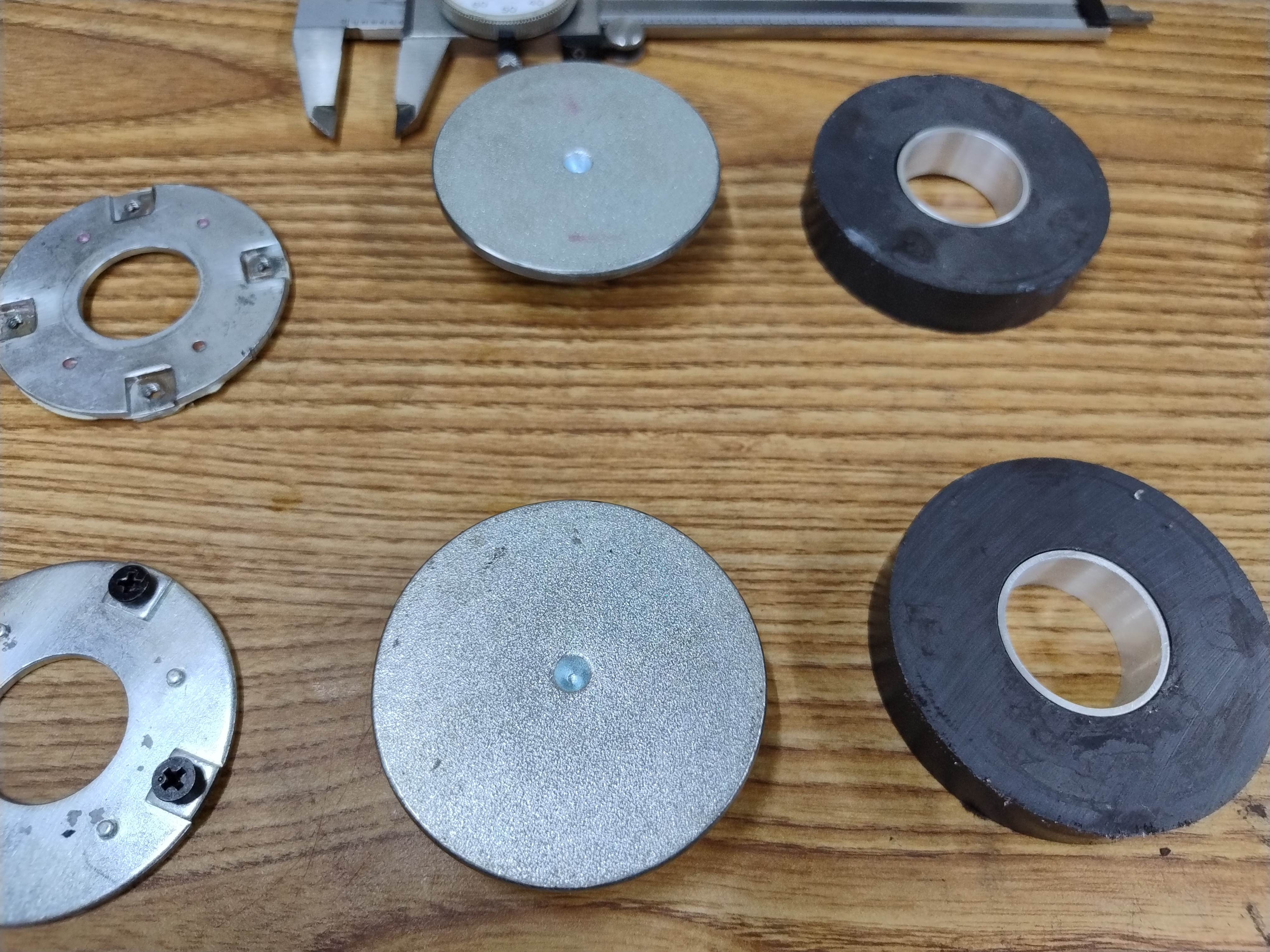

    I just measured another teflon? ring RDO gasket that sits between dome and magnet to be 0.008" thick. If a thin material could be applied between the SL1000 plate and magnet top-plate, you'd eliminate/isolate any resonance eminating from there.
    The trick is to get the coil length centered right between the top-plate thickness.
    xschop Posts: 5,362
    edited April 2023
    Made some non-ferrous focus rings for the XS-8TL project and will be able to swap in fully modded Billet plate RD0198's and compare sonically...

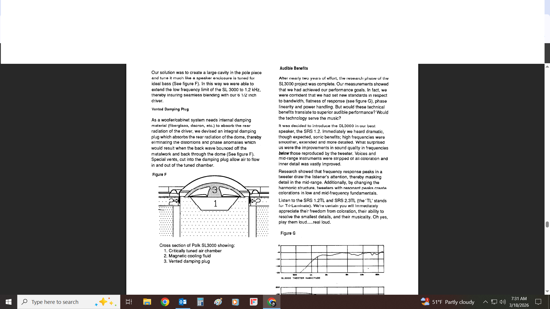

    Riddle me this, why didn't Polk carry over the SL3000's pole piece design when they went to the RD0-194?
    Just happened to read The SDA Handbook's description of the SL3K redesign with the back chamber and wonder why they didn't add the feature to the 194?
    From experience, the back chamber smooths the 194 out at the Xover point and in general in the 5Bs.

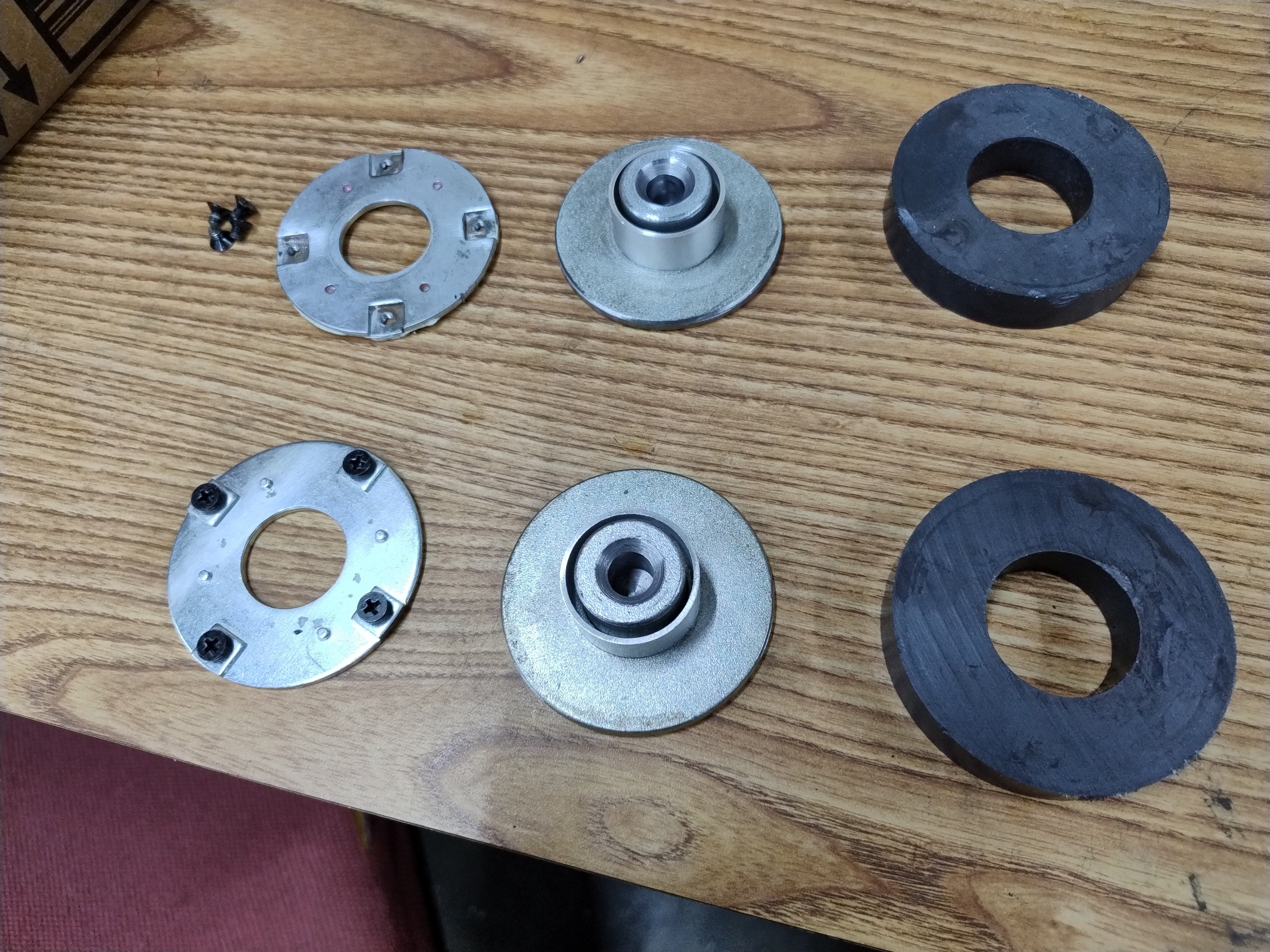

    This is at the top of my top 5 threads lol. I still have the shallow RD0 pole-piece housings at the shop.
    Before I sent off the billet back-chambered/lamb's wool housings to Vsat, I A-B'd them with the shallowed pole-piece (and lamb's wooled) housings and both accomplished the same goal of smoothing the Wuhans and 194's in the 5B's. Did quite a few listening sessions that day.
    IIRC, the perfectly good working SL2500's that I took apart to inspect from the 8TL's also had this feature...

    Your full back chambered design must have a much lower -3dB point than this shallow cavity design.

    IIRC, I drilled them 0.6" deep with a 135 deg. HHS bit without opening to rear atmosphere, then stuffed with lamb's wool.
    Pertaining to your diagram/calc. above, would the aluminum focus ring be affecting the equation in terms of inductance?
    Another caveat/observation is that the factory damping plugs are hard/brittle and detach (must be a Polk glue thing). Can't imagine what it does to the response laying up against rear of dome after so long.

    Glad I never toss anything. Forgot I used a 13/32" and 45 deg. countersink on these to leave more pole-piece area near the coil...
    xschop Posts: 5,362
    Drilled 0.60" deep (shank only) ensured they didn't punch through Polk's factory center divet....
