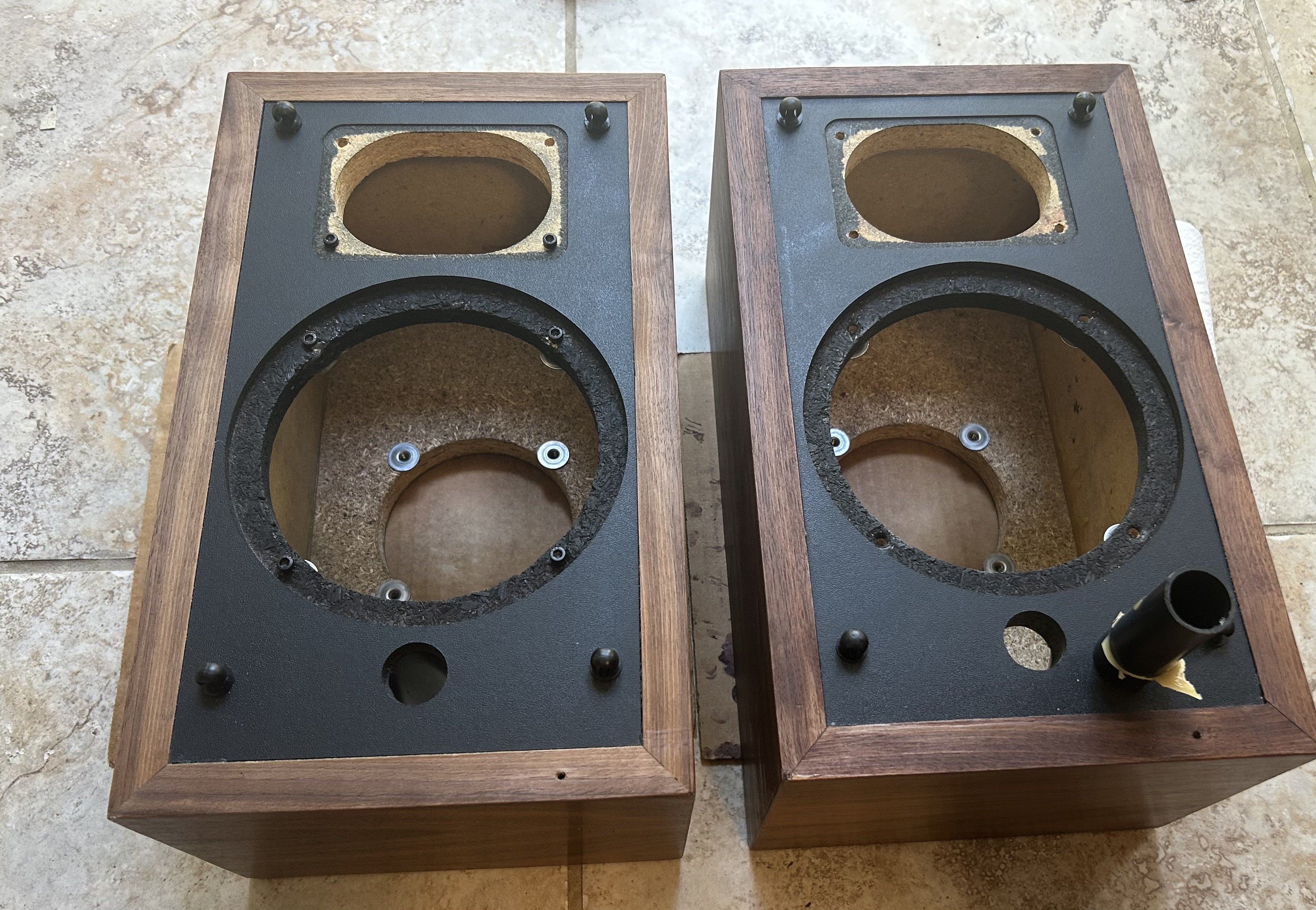

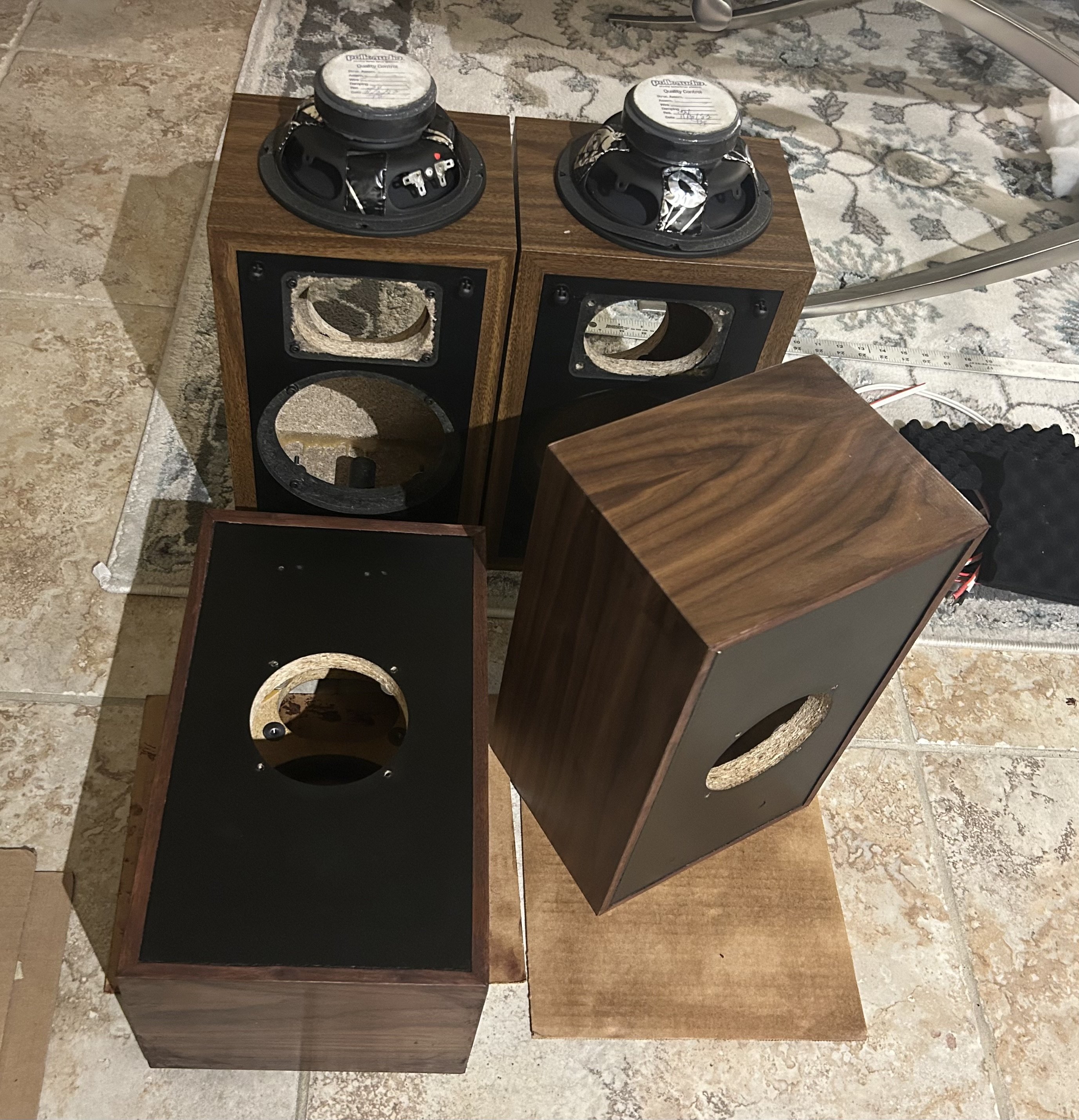

    Needs just a little more light sanding and the clear coat to finish the 1st pair.
    I think it would be cool to see what these sounds like if I swap out the MW6500 for the MW6502. Cool thing is I got 2 pair and could actually compare them to one another. Ordering some crossover parts as well.

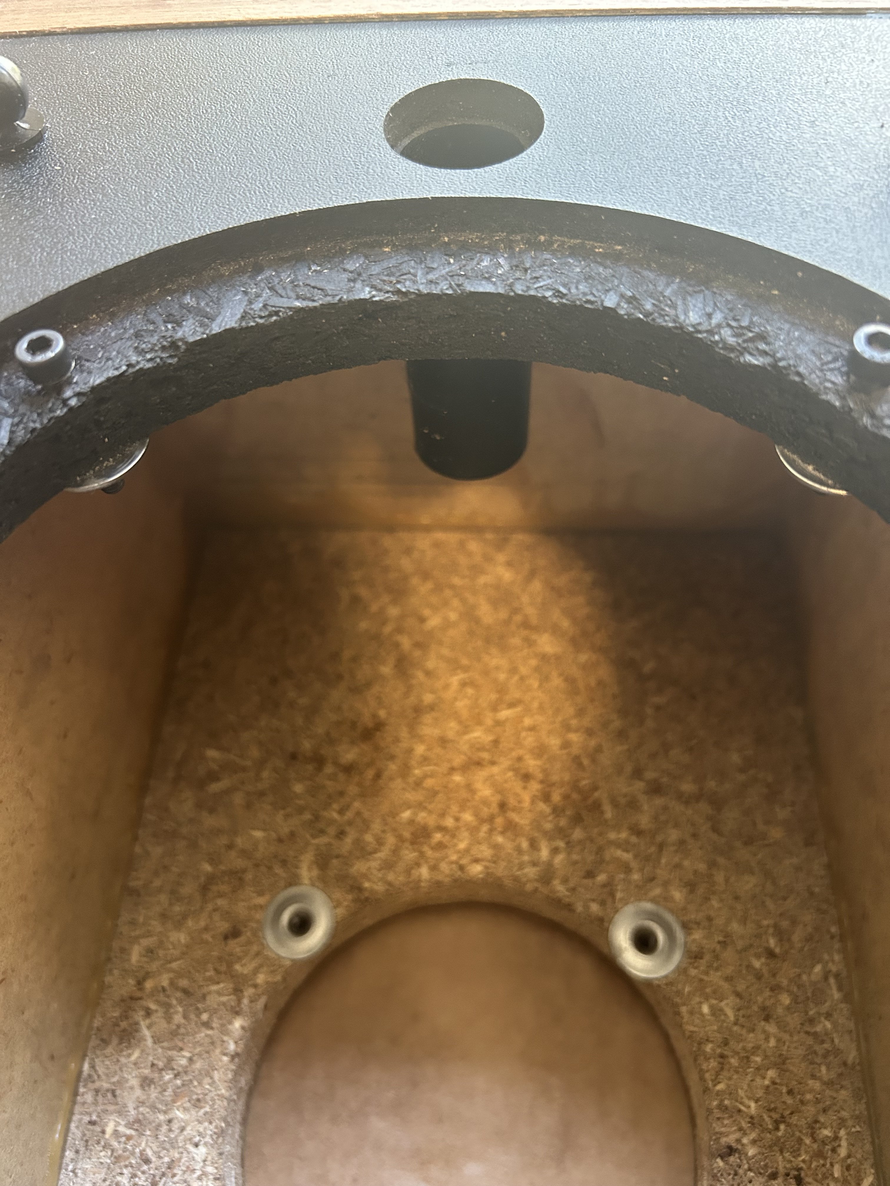

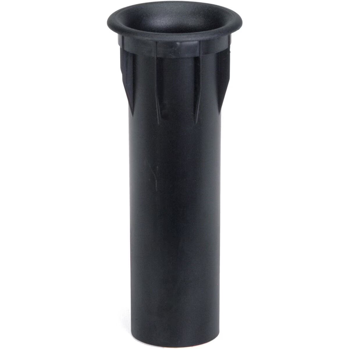

    Going experiment with a new style port tube. Something like that that would reach the front with the flared opening. Same length and diameter.
    "Equality is a myth to protect the weak. Some of us are strong in the Force, others are not. Only a fool believes otherwise." - Sith Proverb.
    xschop Posts: 5,796
    edited December 2025
    Good idea. I changed the port diameter and length, plus flared exit on 2 of the Billet-faced 5Jr's I built. It got rid of the chuffing at higher volumes.

    There's always a Power-Port retro fit option too B)

    The Thiel patent says: "The length of the vent tube is a function of the radius of the vent tube such that a larger vent radius requires a longer vent tube. Generally speaking, it is desired to use a vent tube having as large a radius as possible."
    So, figuring out the longest possible tube that can fit, even in a small enclosure such as this, is a good way to go to optimize sound quality. In this patent they even recommend an angular orientation going diagonally through the enclosure with an elliptical opening that also represents a desirable entrance flare. According to generally accepted guidelines (ref. Loudspeaker Design Cookbook) you do not want to have the end of the vent be closer than 3 in. from any enclosure walls which severely limits how long of a port they were able to fit in the M4, being that the early versions had an enclosure outer dimension depth of only 6-3/4 in., later increased to 7-3/8 in. in the later M4 and the M4A and then even further to 7-1/2 in. in the M4 Series 2 where they were able to get the -3dB point down to 53 Hz from 55 Hz in the M4. It also seems like they increased the diameter of the port in the M4 Series 2 to around 1.5 in. (judging from photos), from 7/8 in. in the M4 and M4A.
    https://worldwide.espacenet.com/patent/search/family/022469952/publication/US4785908A?q=pn=US4785908A
    M4 Series 2 port, with what looks like a small bevel added:

    Next. External backpack Duelund crossover network. 🤣 Nice work. I think there are more interesting surprises in store for those who appreciate this thread. 👌

  • Jstas
    Jstas Posts: 15,017
    I think there's going to end up being a structural failure of the rear baffle on at least one of those speakers given how uncentered the binding post plates are and how close to the edge of the hole at least 3 of the plate mounting screws are.
    If that's the surprises you're talking about, I'm in full agreement!
