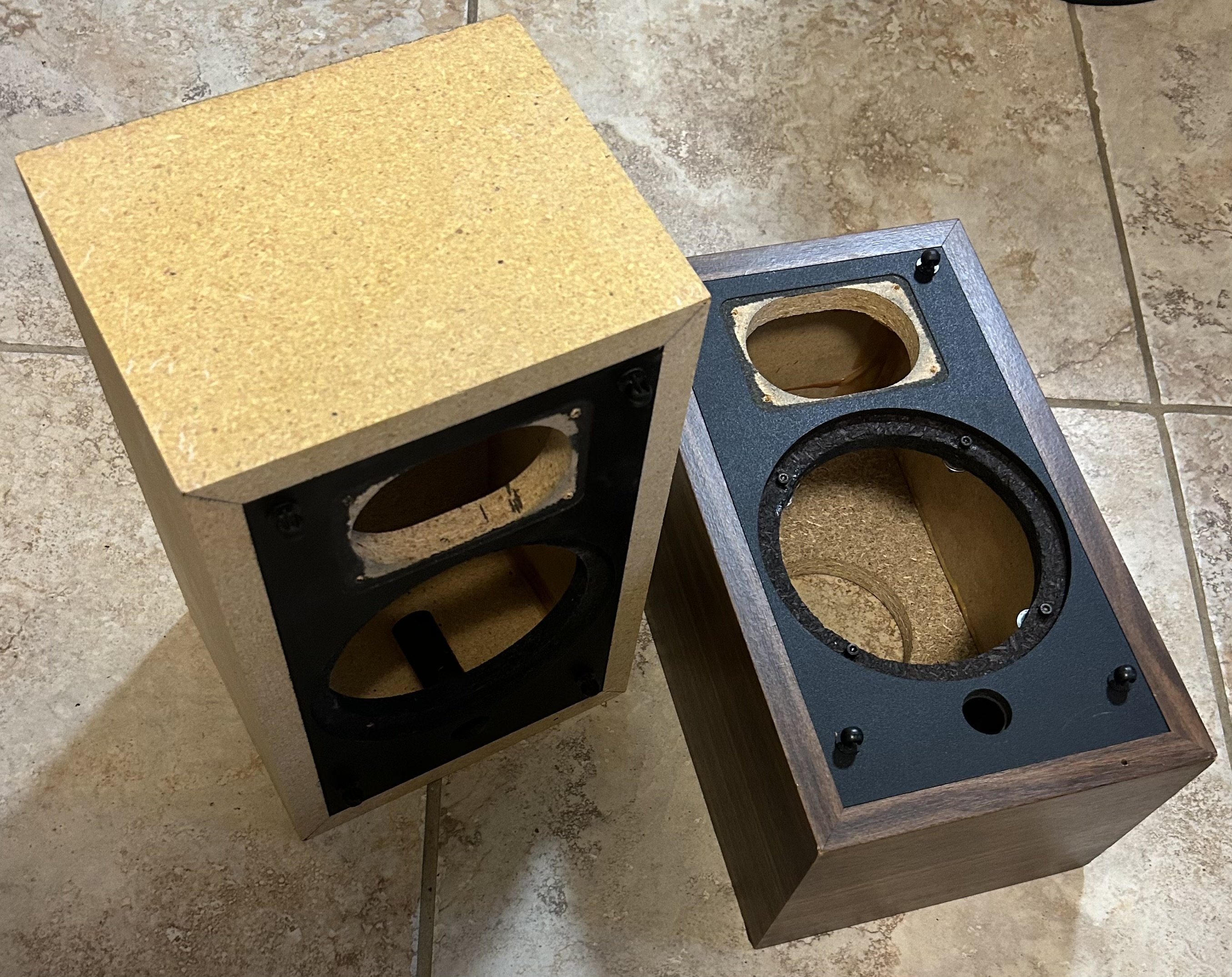

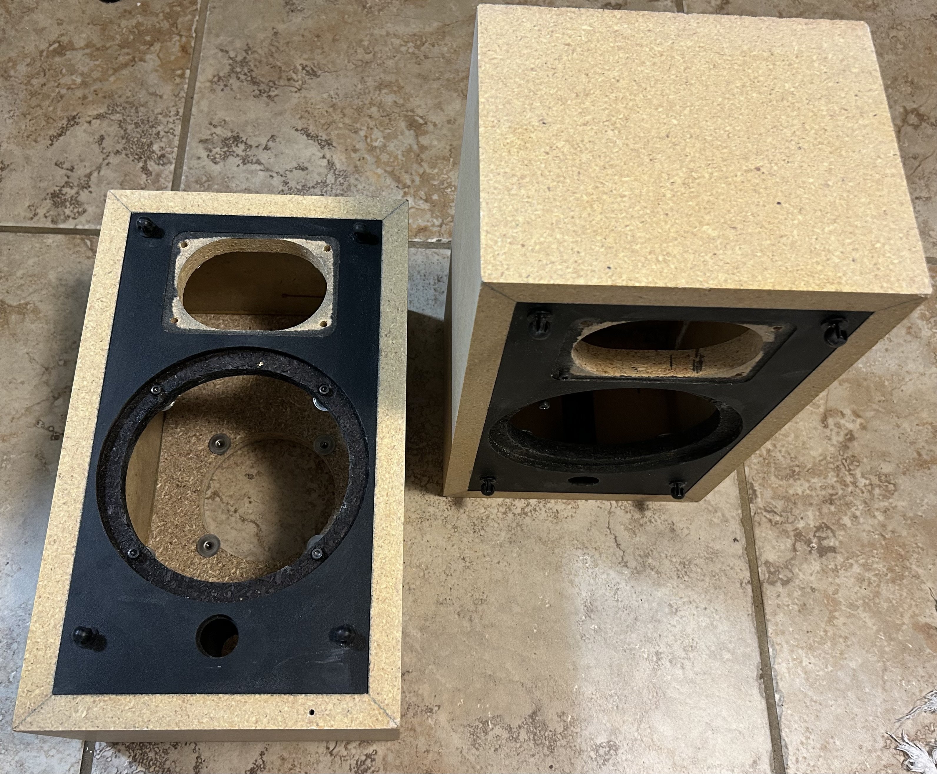

Monitor 4 upgrades
I had a whole roll of walnut veneer I used on my monitor 7s left over and thought these monitor 4s would look cool with some veneer.
Would also like to do something with the crossovers to try to make these at least half way decent.

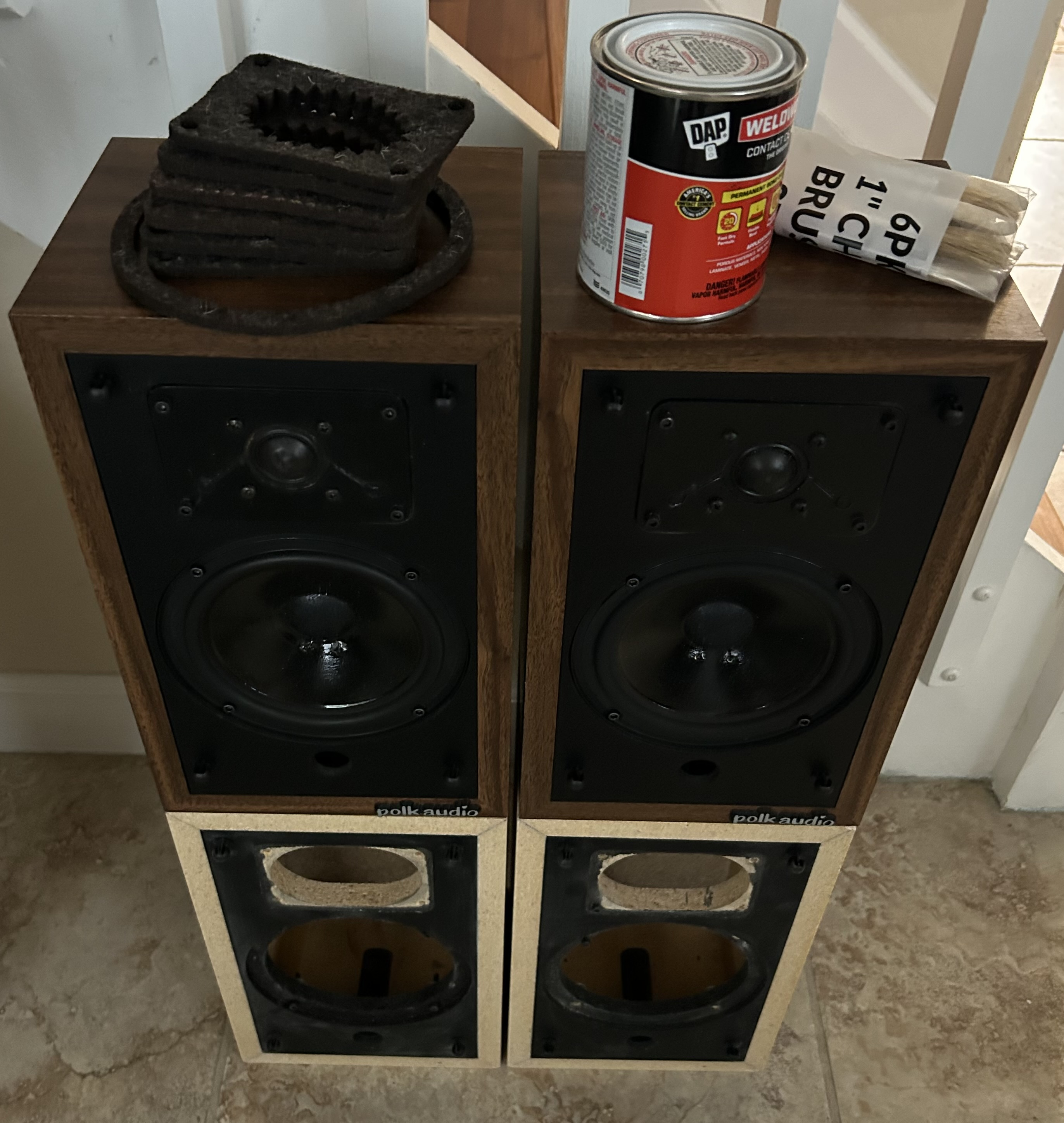

    @xschop Peerless! I actually have 2 pair, and I think enough veneer to do all 4 speakers.

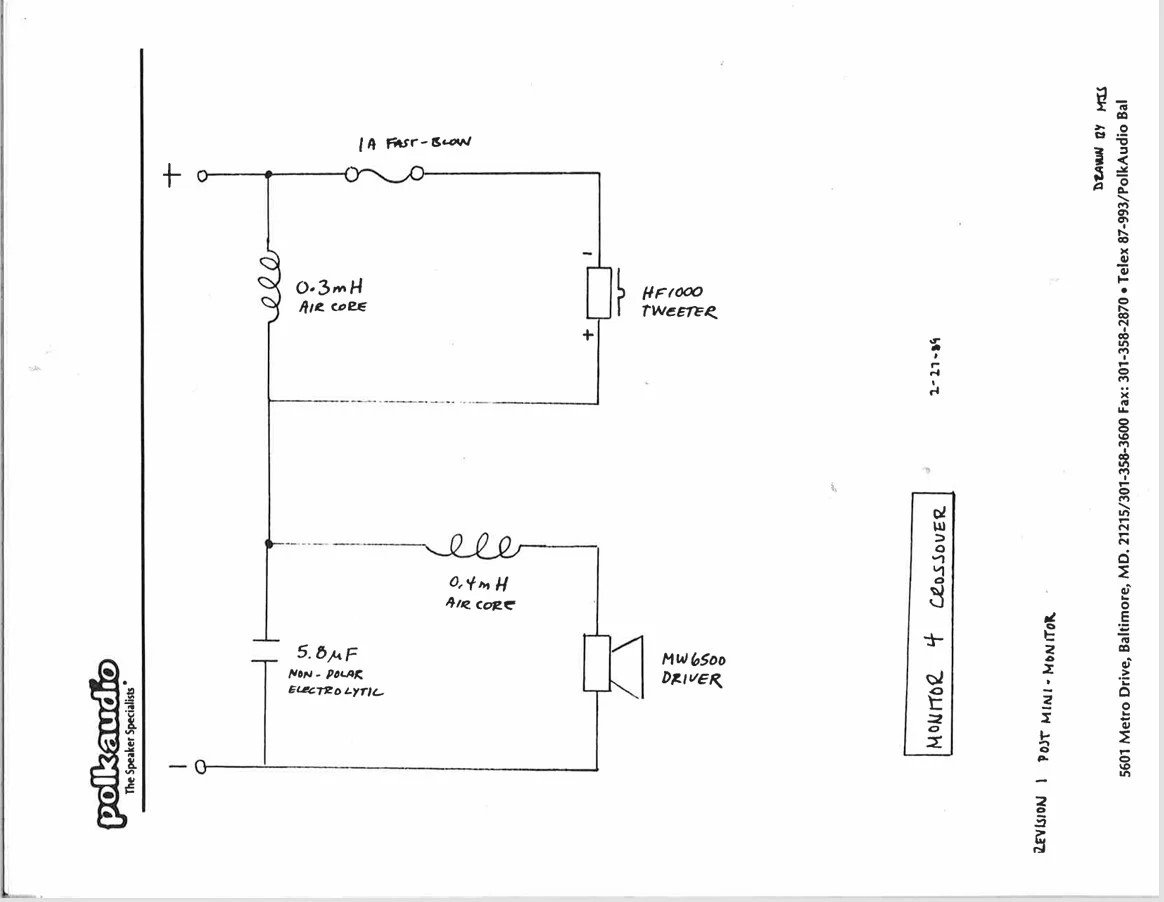

    The crossover is where I'm stumped. Was Polk on purpose trying to make a horrible sounding speaker?
    All the other vintage pre 1986 monitors for the most part use a 12uf cap for the hi-pass and the 34uf for the woofer. What's up with this 5.8uf crossover?
    There really isn't any difference between these and the monitor 5 except the cabinet dimensions and the port size. I think with a proper crossover the monitor 4 could sound decent.
    I got 1 pair stripped naked already

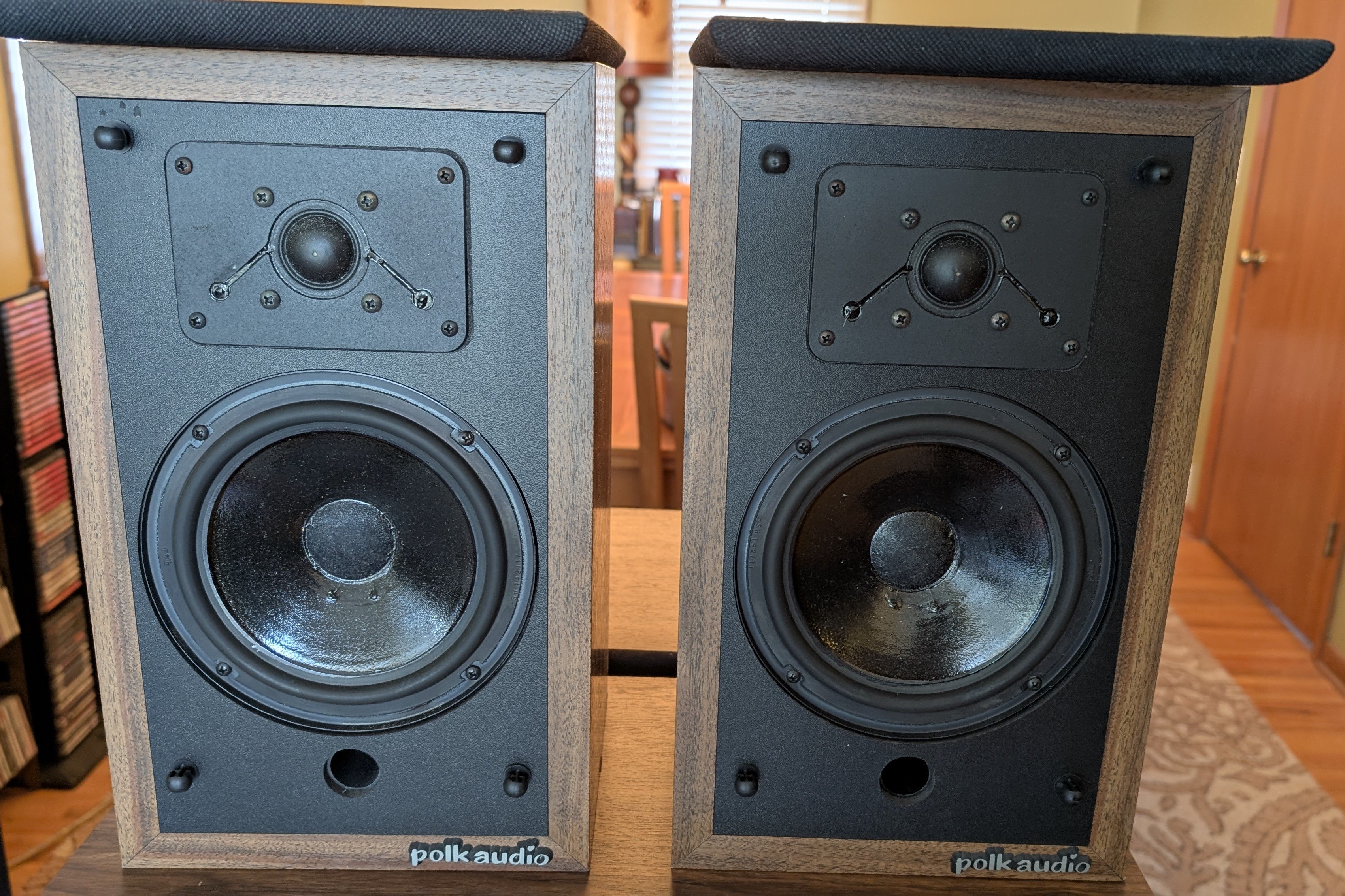

    mhardy6647 Posts: 35,417
    The original Monitor 4 was a good sounding loudspeaker, stock.
    Actually, I wish I had a pair of 'em... but I digress.

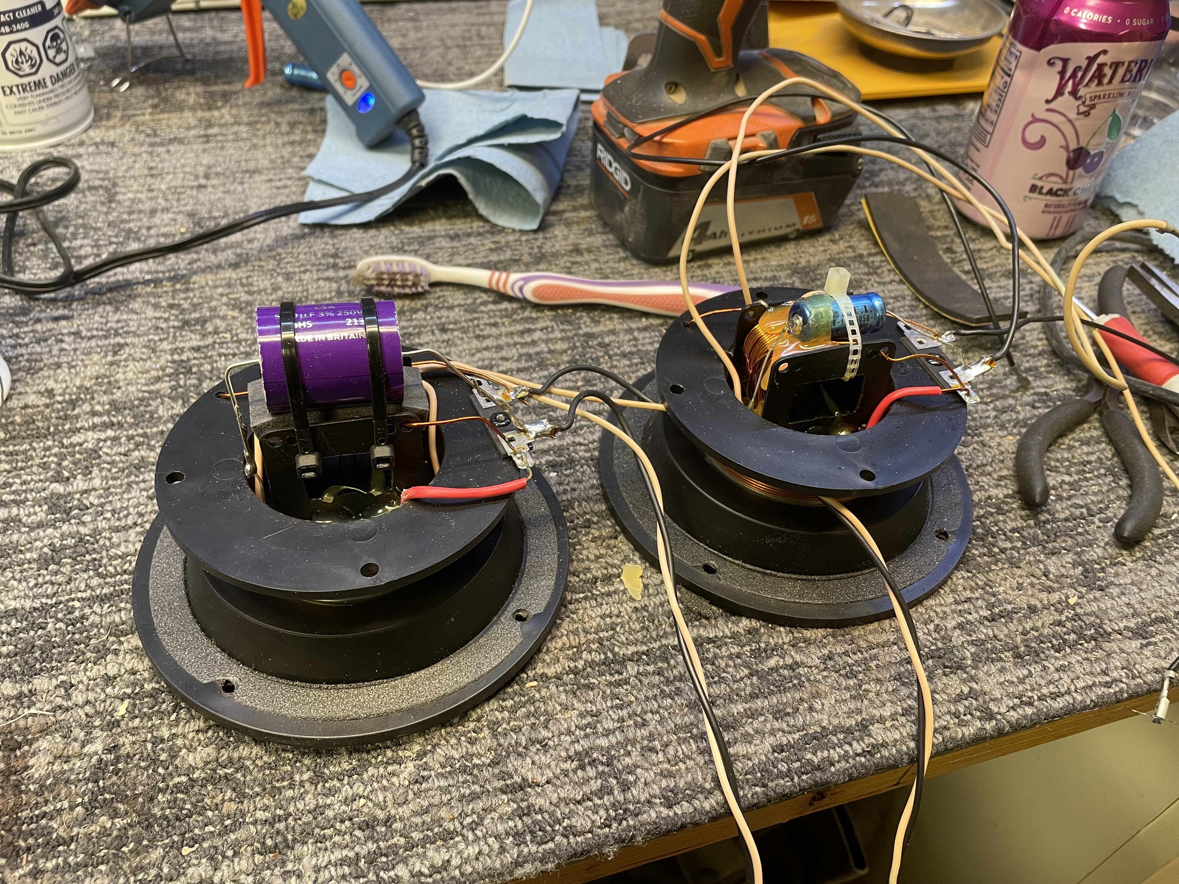

    The components are the same in these as the monitor 5 and I have extra set of monitor 5 crossovers so I'm going to try in these to see how that sounds. That makes more sense than the cheesy crossover Polk put in these.

    @xschop they all 4 came with MW6500 but I do have another pair of 6502s and extra pair of 5B crossovers so I could try it out with both ways.

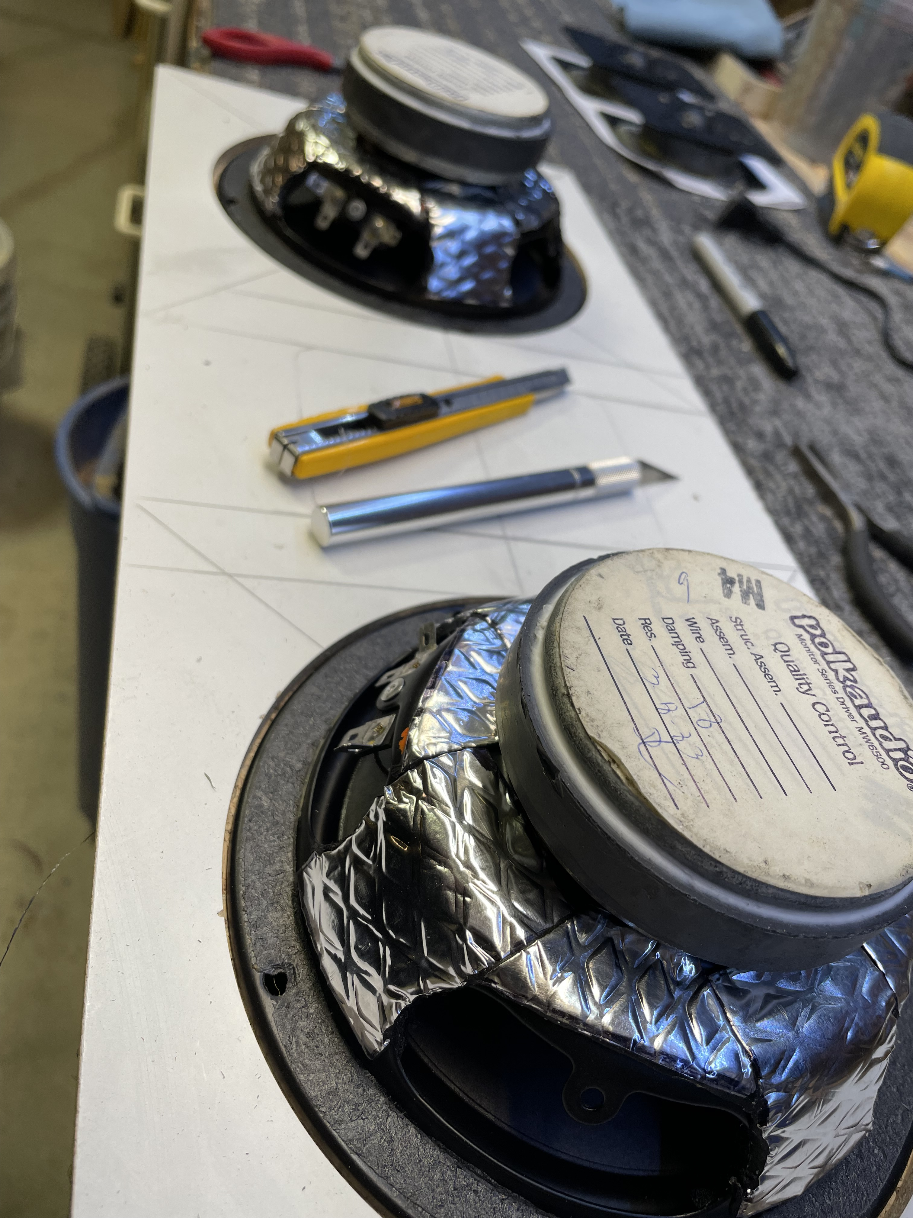

    @Gardenstater they all seemed overly stuffed! They all had egg crate material behind the woofer that had melted and turned green all over the crossovers. When I went to pull out the egg crate foam it turned to dust and disintegrated. They also had a wad of poly fill front of the egg foam.
    When I try it with the M5 crossovers I’m going to try with and without the foam. Maybe to try to get a little more internal volume.

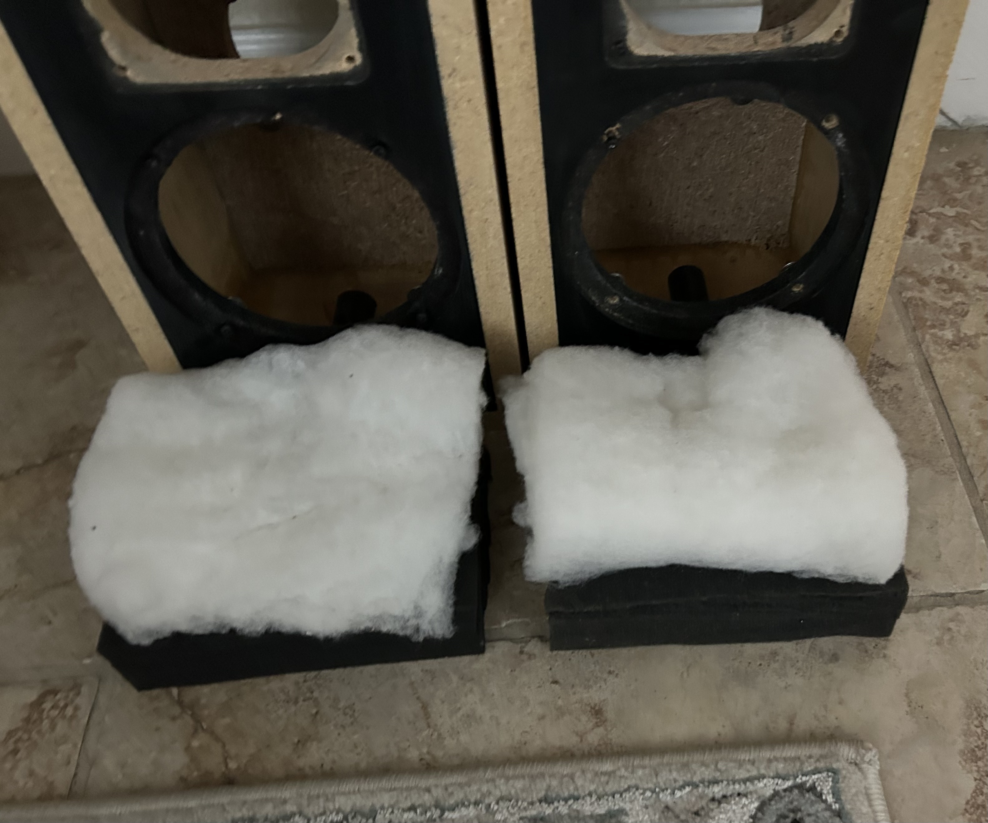

    @Gardenstater that’s what was stuffed inside the cabinets. The original foam disintegrated but I cut that out to the same size. The foam was squished between the magnet and the crossover. The poly fill behind the tweeters.

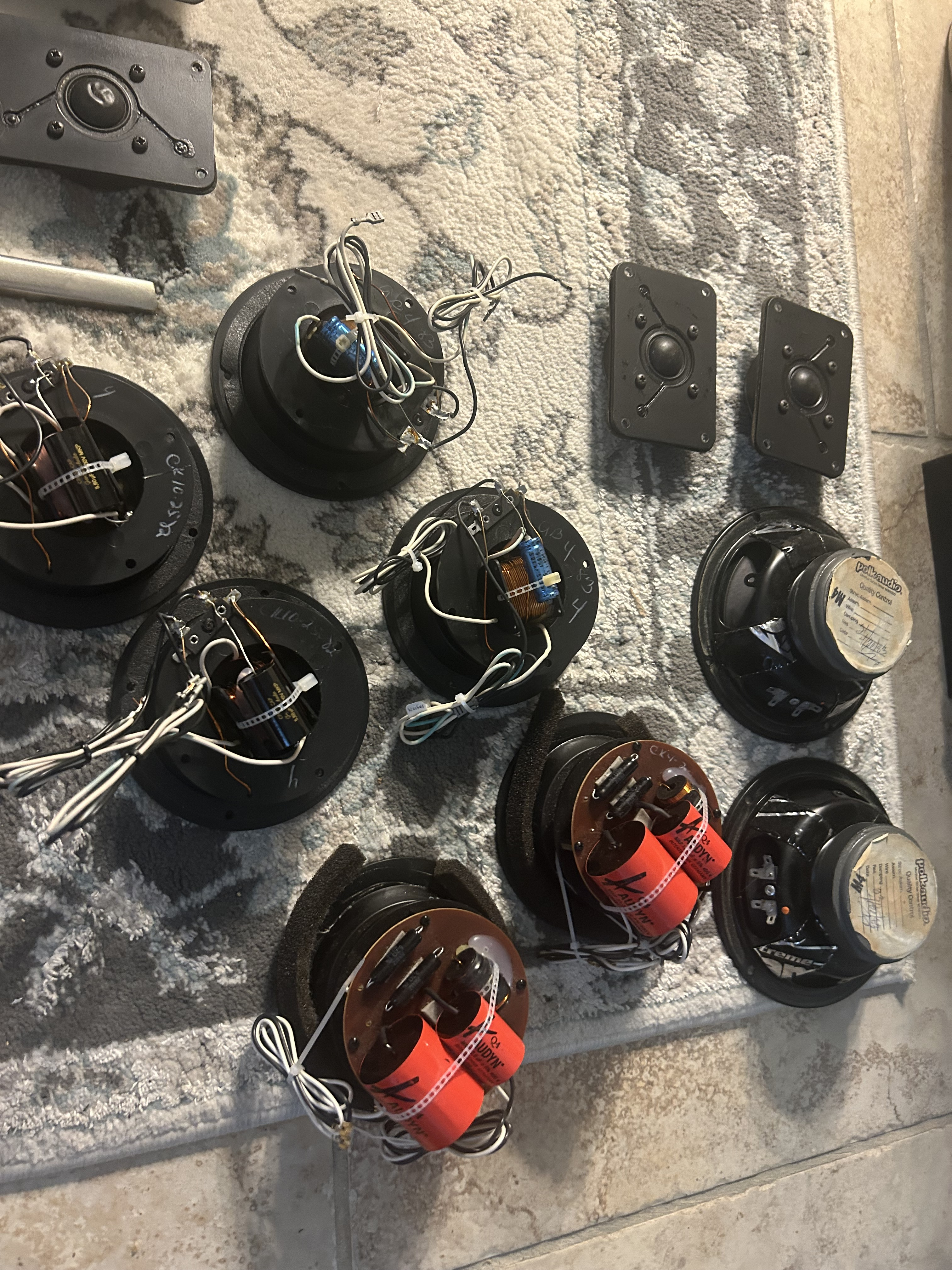

    Just upgrading the electrolytic cap made no real noticeable difference. There is no bass or lower midrange.
    The crossovers marked 1983 are original M4 unmodified, the ones marked 1982 I upgraded the capacitor, the ones with the red caps are upgraded 1981 M5 crossovers.
    Going to start cutting the veneer next.
    Then back to the crossover experiment.

    Found that in another post. HF1000 = Peerless

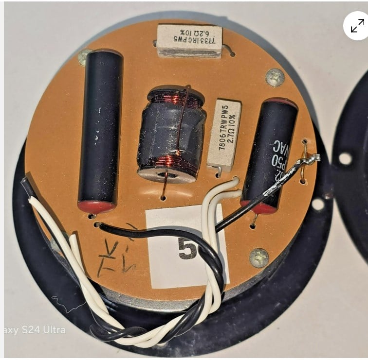

    @Ryan_Soundunited Any chance we could get this schematic posted in the Vintage Speaker section under Schematics (all except SDA)? Probably only the 2nd schematic we have existing of the Peerless days.

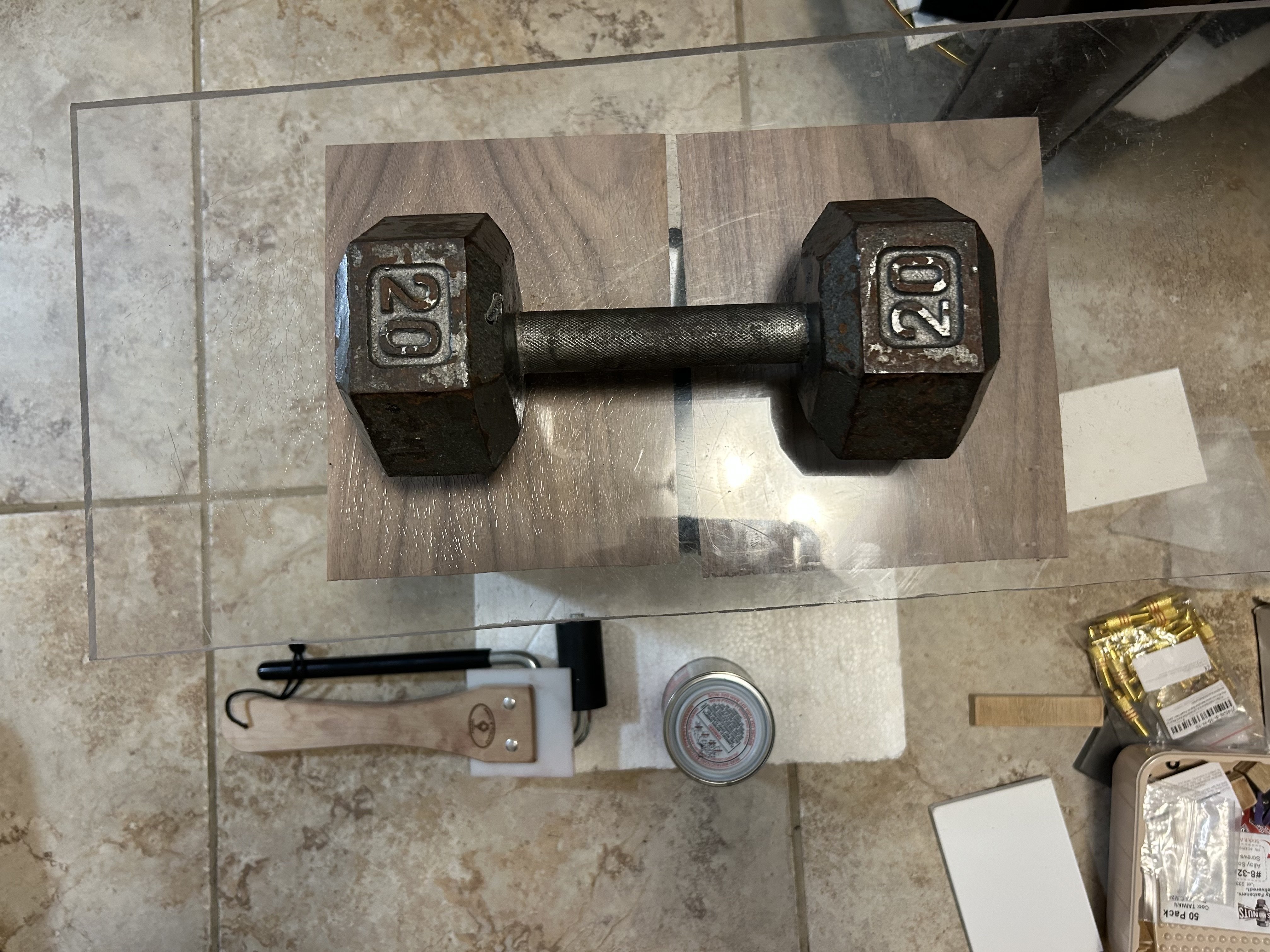

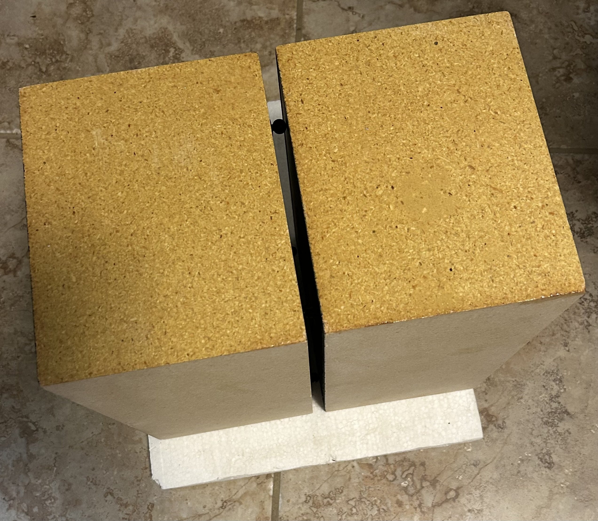

    I think I have enough veneer for all four of these and maybe a pair of Monitor 5s as well
    "Equality is a myth to protect the weak. Some of us are strong in the Force, others are not. Only a fool believes otherwise." - Sith Proverb.

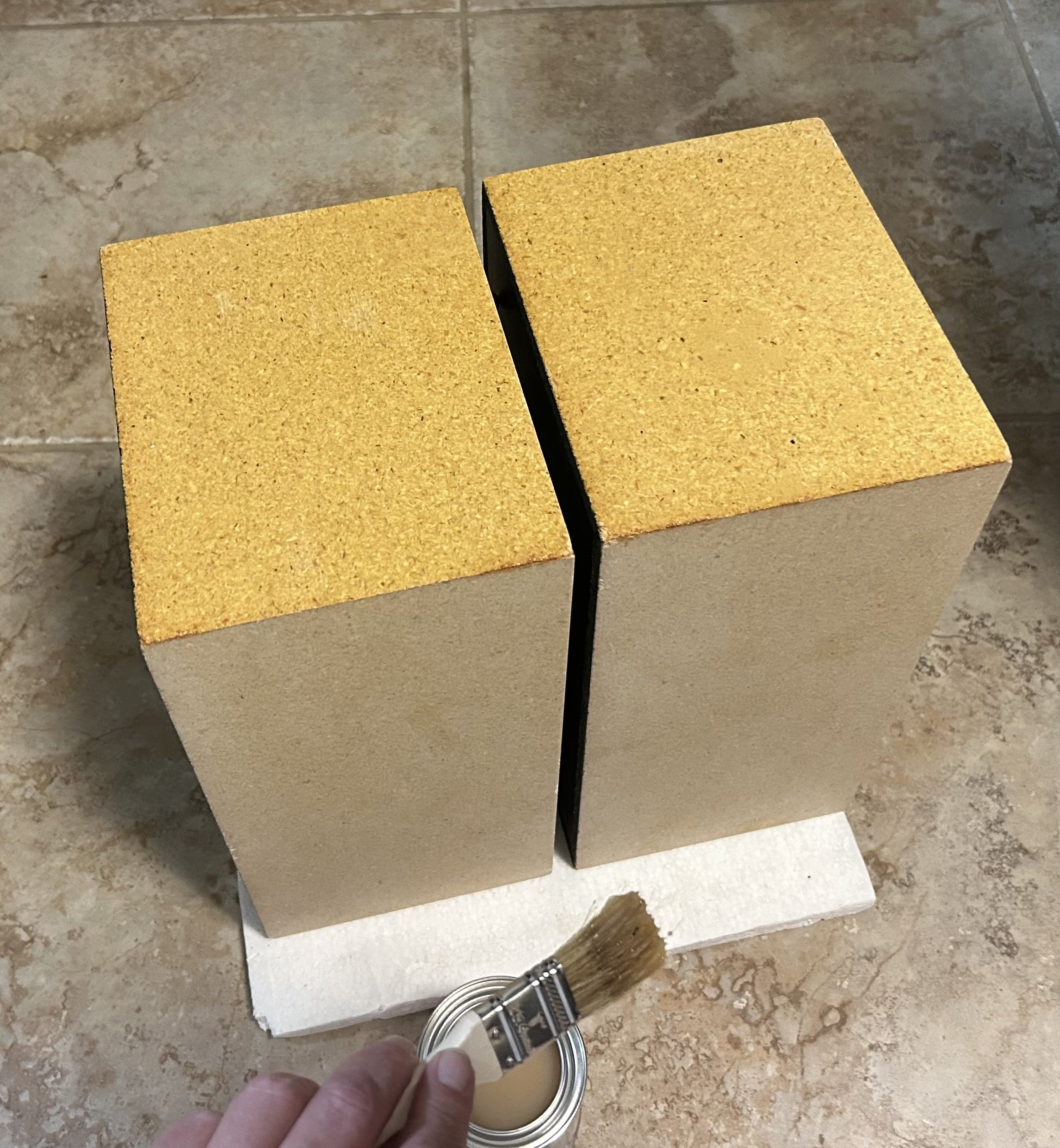

  • DeRod
    DeRod Posts: 249
    2 coats of glue for extra stick .. almost ready for the bottoms

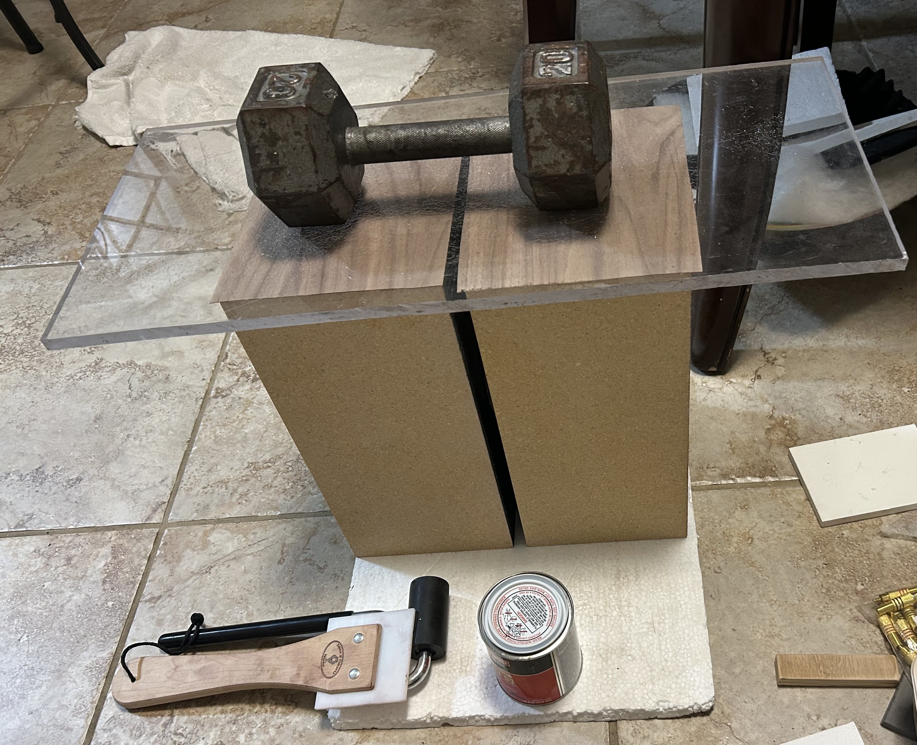

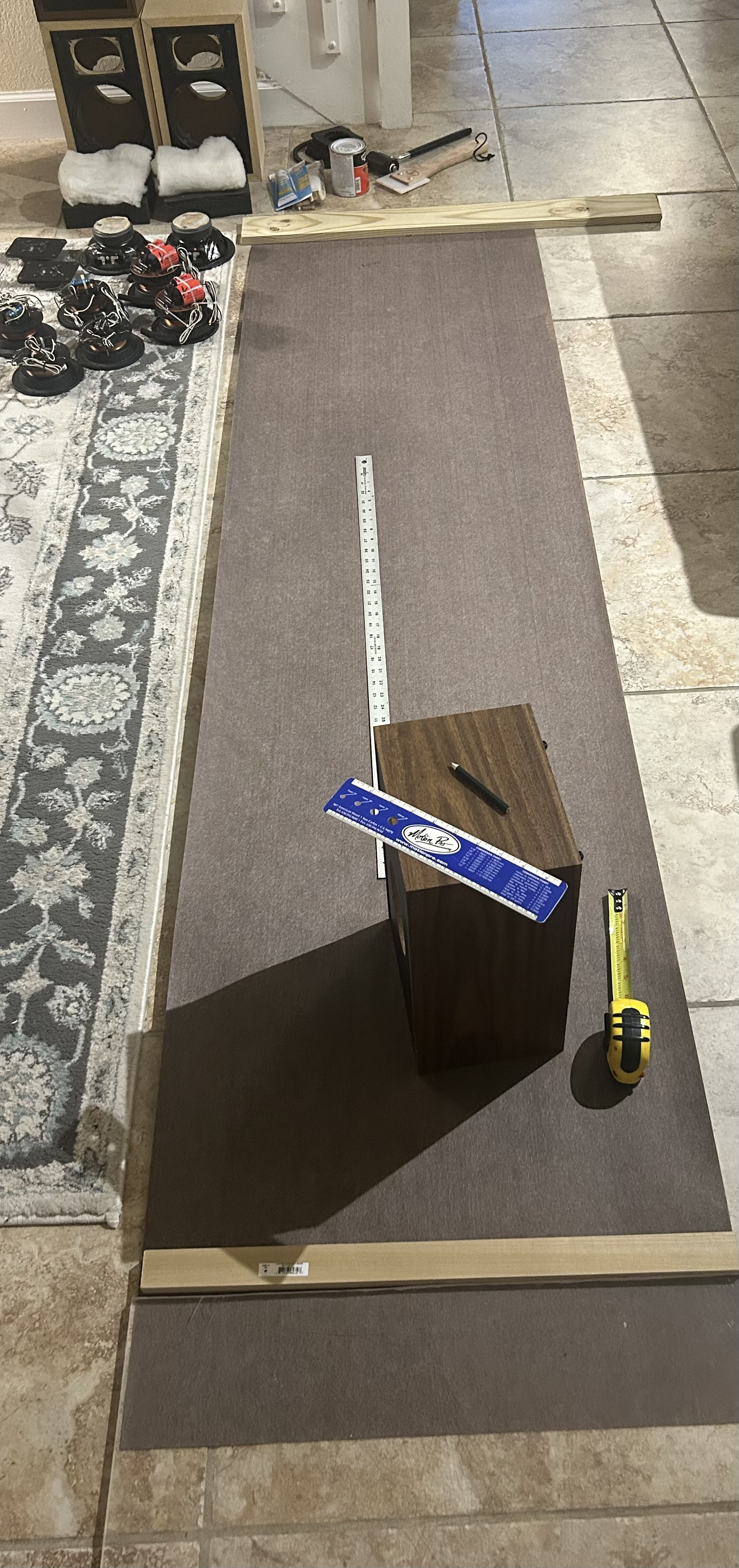

  • DeRod
    DeRod Posts: 249
    Bottoms

    Regarding the crossovers in different size speaker enclosures, using the same tweeter and MW, it seems like baffle size matters, for one thing. Here's some early 78 crossovers for the M5 that had dual fuses and note the tweeter series resistor value of 6.2 Ohms. More than the 4.5 Ohms used in the M7.

    I'd agree, that the odd X-over difference is related to baffle step compensation Polk did, due to the small enclosure. More curious if they did anything different X-over wise with the Monitor 4's that accompanied the LF-14?
  • Gardenstater
    And it is very interesting that Polk put the tweeter in reverse polarity in the M4, even though, as far as I can see, it is still a 2nd order crossover. But something about the baffle size changed things enough that they needed that to prevent a worse phase cancellation effect around the crossover point.
    I think you definitely need to verify tweeter and MW polarities, in case a previous owner chimped that up on you.

    @Gardenstater so I could change the 6.2k to a higher value? The one I'm playing around with is the same as that one but a single fuse.
    I was thinking something like that as that crossover is basically the same as the 7 with exception of the 6.2k resistor being 4.5k

    Maybe you might want to try that. Maybe if you don't the smaller baffle will result in overly bright tweeter. But then there is the reverse polarity which also comes into play. The diffraction wool pads will tame the tweeter a bit.
