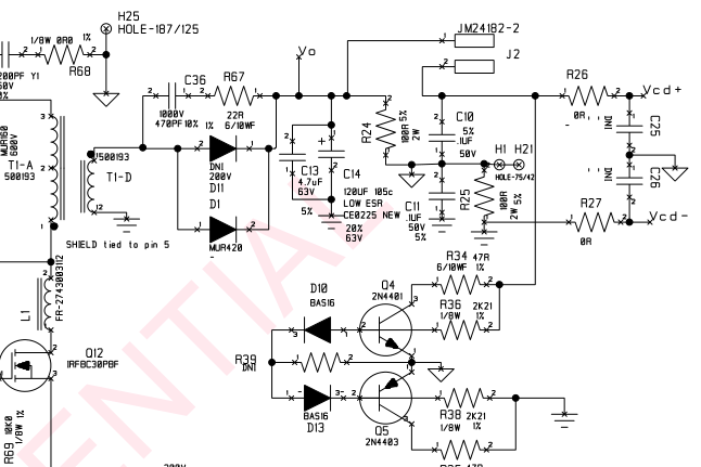

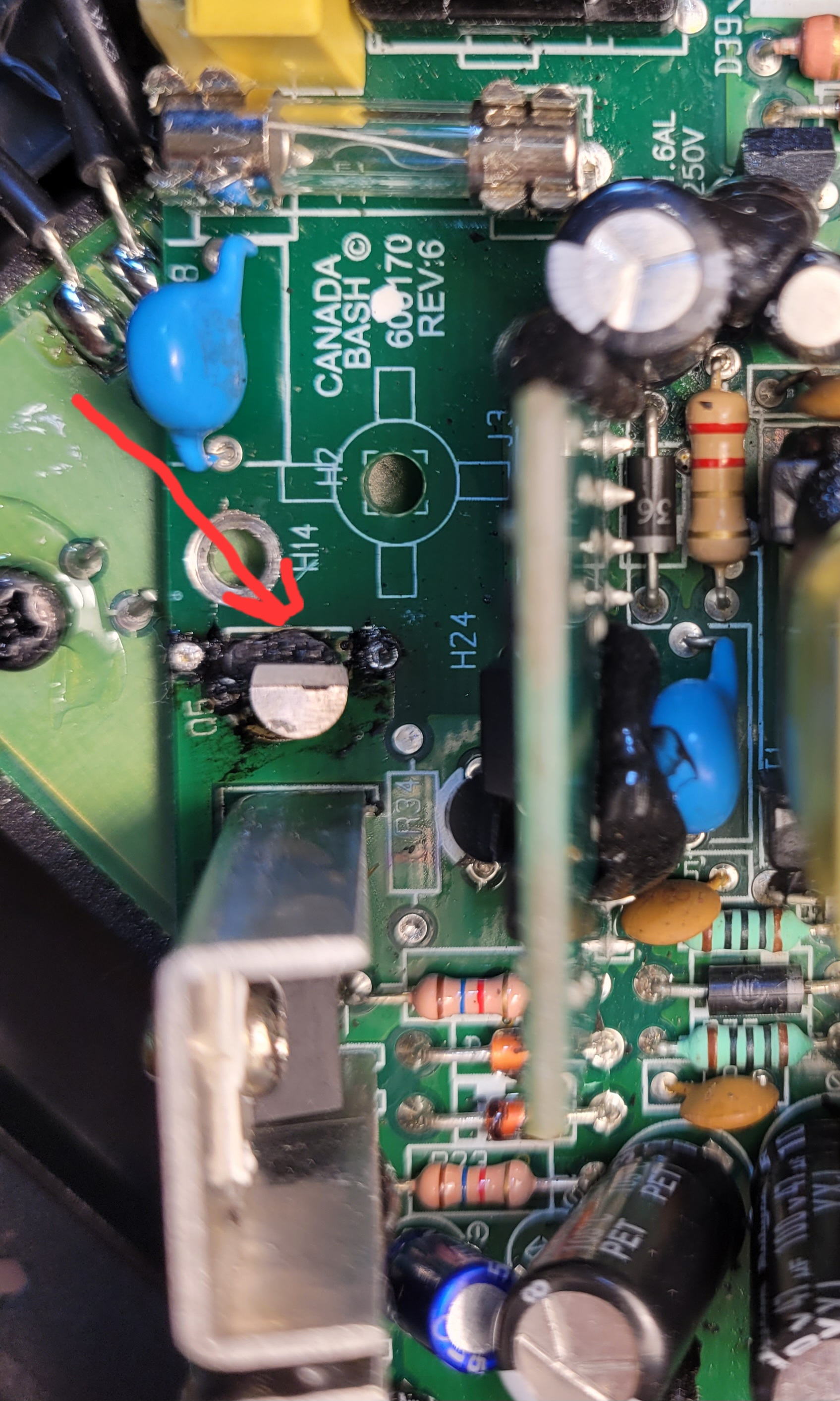

    After replace some Ecap. The resistor that near Q5 was burned after 1-2mins normal running. The R34 seems got high temperature also. I'm trying to fix it. Thank you..
    I just send it in your inbox.
    The part of the circuit with Q5 and R34 is for stabilize the virtual ground at the halfway up the voltage for the final power transistors. A single supply switching voltage comes from one of the secondary of the transformer after D1 and the filtering of Ecap C14, after Q4,Q5,R34,R35 end other components split the voltage. There is something that unbalancing the circuit

    .. A single supply switching voltage comes from one of the secondary of the transformer after D1 and the filtering of Ecap C14, after Q4,Q5,R34,R35 end other components split the voltage. There is something that unbalancing the circuit...
    First static split is operate by 2 watt power resistors R24 - R25, dinamic stabilzed after by Q4 and Q5
    Be careful that the supply voltage varies depending on the amplitude of the signal, using a feedback, this is the BASH amplifier patent to increase efficiency

    Before recap, only the indicator on but not working, also had little pop noise came out from spk at all mode(On/Auto/Stby).
    After recap, pop noise gone and working properly, but Unfortunately the resistor smoke and born after 1-2mins.
    did you also change the 120uF Ecap c14?

    C14 wasn't replaced.
    Today, I checked the components near Q4/Q5, including D10/D13, and found no problems. So, I replaced R34/R35, and it works normally. I've been running test for 3 hours, and everything is normal. It's strange that the resistor was overheating and smoking before.
  • C14 wasn't replaced.
    I don't know what to say, perhaps there was a faulty solder; desoldering and soldering the components restored the faulty solder. We'll never know for sure; all you can do is hope the problem is solved for good and doesn't happen again.
    pitdogg2 Posts: 27,048
    Some of these boards are covered in a type of glue that becomes conductive as it ages. Maybe the removal of the glue to get to the problem you inadvertently solved both problems unknowingly.
