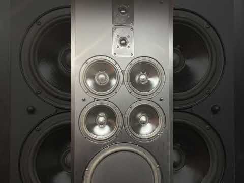

    I'll wager I foamed my baskets to a point no one else has.
    Preliminary bench report from 90 hours of burn-in for caps and Wuhans is positive.
    Clarity and separation is great. I can only compare to my other speakers, but I'm impressed.
    They don't sound lifeless. They're quite clear, with what I feel is the proper level of 'air' around instruments and voice. Spotify Premium (which I find has distortion on sections of all my music (streaming from my old iPhone on multiple sources, that isn't on Amazon Music).
    Recording was a little close, but it's just an anecdotal response. I might very well do this mod to my Monitor 12, if I keep them.
    Looking forward to actually A/B'ing the mod on my 5B.
    Abrupt cut at the end.
    https://youtu.be/TUlij8U4oKU
