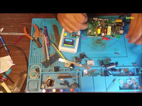

  • I'm having the same problem. Check the post from chros and also this link: https://www.youtube.com/watch?v=mdQQ6teY1YE
    It helped me to start to figure out what I need to fix.
    Thanks for posting that but unfortunately it's not an easy fix for the average person.
