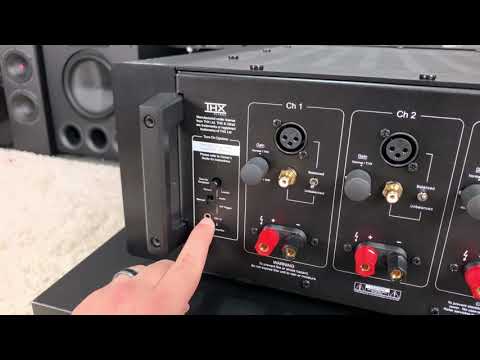

    Thanks for the suggestions all! I really like that JC5 but it’s out of my price range. I’m thinking the Anthem 325 is the best bet given that I need something for a center channel too.
    Don't sleep on the 3-channel Parasound Halo A31. The original retailed for $3000, the current version $3495. https://parasound.com/a31.php
    Retail price examples
    $3295 new, Dealer - https://www.audiothesis.com/product-page/parasound-halo-a31-three-channel-amplifier
    $3095.99 new, Dealer - https://www.ebay.com/itm/174701692706?chn=ps&mkevt=1&mkcid=28
    $2999 new, Dealer - https://new-age-electronics.com/halo-by-parasound-a31.html
    $2100 + $195 s&h used, Reseller - https://reverb.com/item/40465113-parasound-a31
    The specs are pretty much awesome. I have to repost these!
    • 250 watts RMS x 3, 20 Hz - 20 kHz, 8 Ω, all channels driven
    • 400 watts RMS x 3, 20 Hz - 20 kHz, 4 Ω, all channels driven
    • Current capacity: 60 amperes peak per channel
    • Complementary MOSFET driver stage and JFET input stage
    • 24 beta-matched 15 amp, 60 MHz bipolar output transistors
    • 1.5 kVA encapsulated toroid power transformer with independent secondary windings for each channel
    • 98,400 µF power supply filter capacitance
    • Power bandwidth: 5 Hz - 100 kHz, +0/-3 dB at 1 watt
    • Total harmonic distortion:< 0.2 % at full power
    • IM distortion: balanced 16 V rms < 0.04 %
    • Slew rate: > 130 V/µsecond
    • Dynamic headroom: > 1.5 dB
    • Interchannel crosstalk: > 78 dB at 1 kHz; > 63 dB at 20 kHz
    • Input sensitivity: 1 V for 28.28 V (THX Reference)
    • Input impedance: 47 k Ω unbalanced; 94 k Ω balanced
    • S/N ratio: 112 dB, input shorted, IHF A-weighted
    • Damping factor:> 1100 at 20 Hz
    • Adjustable gain for up to +6db over THX Reference level
    • Unbalanced RCA and balanced XLR inputs
    • Circuitry designed by legendary John Curl
    • High bias class A/AB operation
    • Direct coupled (no capacitors or inductors in signal path)
    • DC Servo and relay protection circuits
    • AC present, channel status, high temperature indicators
    • Heavy-duty 24k gold-plated 5-way speaker terminals
    • THX Ultra2 certified
    • Auto turn-on by 12v trigger or audio signal
    • Dimensions: 17-1/2" w x 7-5/8" h x 20" d, 7" h without feet
    • Net weight: 65 lb. Shipping weight: 79 lb.
    Reviews
    • https://hometheaterhifi.com/reviews/amplifier/power-amplifier/parasound-halo-a-31-three-channel-power-amplifier/
    • https://hometheaterreview.com/parasound-a31-three-channel-power-amplifier/
    • https://www.soundstageaccess.com/index.php/equipment-reviews/629-parasound-halo-a-31-three-channel-power-amplifier
    Unboxing
    https://www.youtube.com/watch?v=GcDOxSLpgZE
