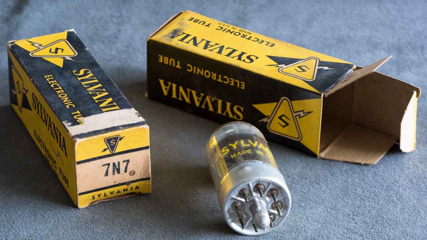

    oh , and of course, there's the Loktal base 7N7, which (AFAIK) really, truly is a 6SN7 in a slightly different package :)
    http://vinylsavor.blogspot.com/2015/02/tube-of-month-7n7.html
