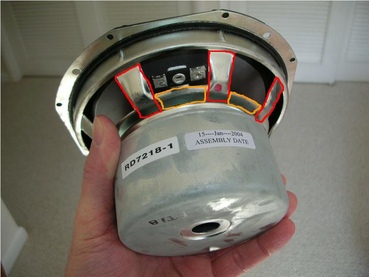

Getting ready to Dynamat everything...speakers, AVR and power conditioner. I already did my Blu-ray player last summer, but I'm going to add it to a few more spots on the 51FD. I'm hoping the Dynamat arrives later today or tomorrow, I'll have plenty.
I've read on here that it is recommended to do the spokes, which I outlined in red. I also know to stay away from the part that seals against the cabinet. I was also going to do the parts I marked in orange. Are there any other places that I need to apply the Dynamat?

    yep you got it. if the cap on magnet assembly rings a little wouldn't hurt either. I'd also put a red dot where it belongs on the dynamat...just so you know:)

    The cap does ring on the sides a lot, but not on the back.
    Would a one inch strip every couple of inches be enough, you think? I guess I'll know once I do it.

    then a couple of strips won't hurt.

    I'd cover the whole thing, and be sure to keep the vent hole open.

    I've got four square feet, so I should have plenty. I was going to do my fronts and center, and the covers on the AVR and conditioner (frames if there is room to do so). Then do the surrounds if I have enough. Haven't had the SC-05 or Monster conditioner open yet, so I don't know how much room is inside to apply it yet. The AVR looks pretty packed from looking through the vents. The lid is 50% vented, so I should have enough clearance to do the solid un-vented parts of the lid, at least.

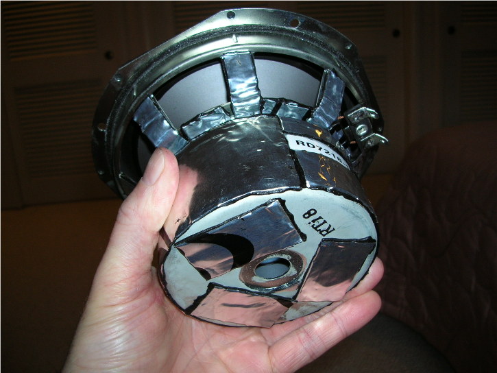

    This is my first one. Is this good, or do you think it's overkill? I didn't cover up the model number sticker. I'll check back in a few minutes.
    F1nut Posts: 52,151
    edited February 2014
    Overkill. A little goes a long way.

    So just do strips on the caps? One inch strips maybe?
  • westmassguy
    westmassguy Posts: 6,850
    I disagree Jesse. You want to add mass to the light gauge steel wherever possible. The Dynamat is cheap enough, that a few extra square inches isn't going to break the bank. Test it, tap on it. Exposed metal will ring or clink. The Dynamatted areas won't. Who knows what's under that magnet cover.

    This is the way I do drivers and PRs. It's professional looking, not Hodgepodge, and I never have to 2nd guess myself whether I put enough on.

    Well, no matter what, I'm going to do the matching driver on the opposite speaker the same. They have to match. YES, I'm that obsessive compulsive! The next problem will be tightening down the four screw to hold each one in place. I always want to go back and tighten each one a little more...then I end up stripping them. I should probably be on medication!
    F1nut Posts: 52,151
    There's nothing wrong with covering everything, but it's certainly not needed, IMO.

    Jesse, you're a stickler, in a good way, about anything wood related, but not so with something like this. Do it once and do it right. That's how I was taught. To the OP, do it whichever way you feel comfortable. If they were mine, there'd be no question, because every time I looked at the speaker, there'd be that little hesitation...did I put enough on, do I hear a ring. That's just the way I am.

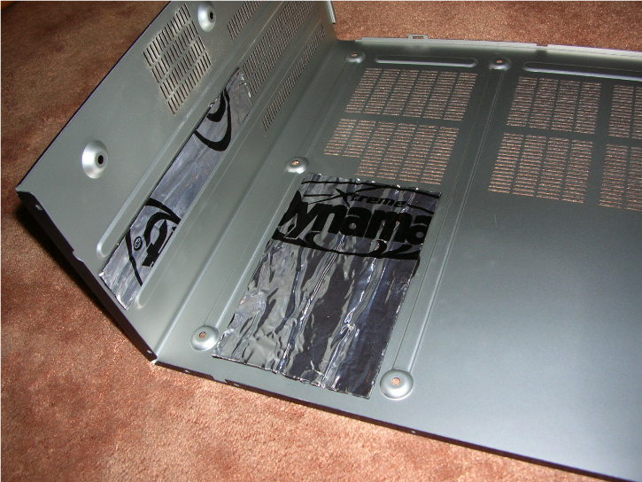

    After finishing the RTi8's, I disconnected my SC-05 and pulled it out. The lid actually seems really solid due to the ample amount of screws on the top, sides and back. I didn't hear any ringing, but wanted to apply Dynamat where I could. After removing the top, I saw that there really wasn't much room for it. Some of the boards come within a couple millimeter from the lid, and it has a lot of bracing that contacts the lid. I was able to to apply three pieces. One strip to each of the lid's sides and one square piece to the top portion.
    Didn't notice any difference in sound, but like I said, I didn't hear a ringing before applying it.

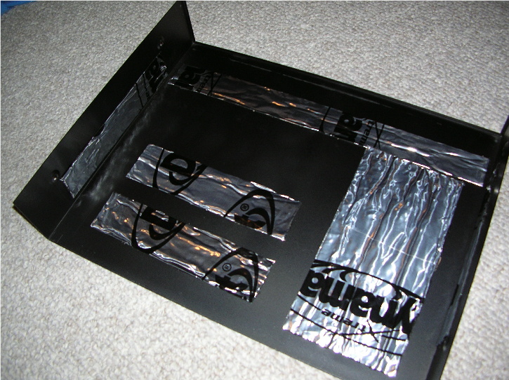

    Pioneer BDP-51FD
    Next I took apart my Blu-ray player. I started a thread last summer after I got it and applied some Dynamat to it. I know there are members here with that same player so here is the thread with pictures:
    http://www.polkaudio.com/forums/showthread.php?151519-My-Dynamat-Blu-ray-Player-Art-Project
    I strongly recommend doing this. Applying Dynamat to my source yielded the most drastic results of all my Dynamating. This time I removed the power supply board and was able to apply a good amount below it and was also able to get underneath the optical drive from the opposite side from last time. It doesn't sound like that big of a deal, but it is very difficult to find areas to apply it on the frame, so this really helped. I also applied a few more small pieces to the lips that come up one the sides of the frame that the lid screws to. This really is a great player. Blu-rays look and sound amazing. I know DVDs aren't known for picture quality compared to Blu-rays, but it does an amazing job with DVDs also. I have a Sony upscaling DVD player and there is no comparison between the two. And music CDs are crystal clear and detailed.
