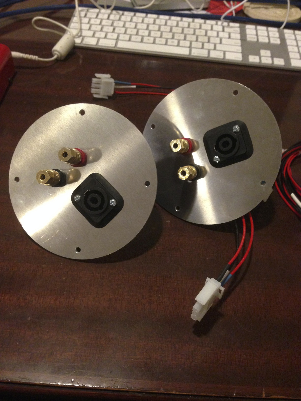

Nice job! I will be doing my project in the next few weeks. I ended up getting an entry level solder pot, imported from China, and Kester bar solder, to keep the costs under control. In addition to tinning the Cardas Litz with it, I am going to tin the ends of my Solen 16mH inductor with it, as I suspect I can get a better contact than scraping the insulation as I'd done previously. Unfortunately, my gear is all packed up pending some home repairs prior to putting my house on the market, so won't be auditioning these improvements for some time, but at least they will be ready to go when I set up shop in the next abode. Btw I like the fact that you have a Molex connector for your SDA inductor, I have two leads soldered to the board.Good music, a good source, and good power can make SDA's sing. Tubes make them dance.

I'm thinking of using some little strips of colored shirink tubing on either end of each cable I create in white, blue, green, and black as indicators of what the stock wiring color scheme was. The molex connectors make it pretty idiot proof. but being able to visualize the blue/green pairs in terms of the stock color scheme is handy when following the schematics.Good music, a good source, and good power can make SDA's sing. Tubes make them dance.
Also, I'm thinking of using the solder pot on the Cardas binding posts. I'd like to tin the connector for a few seconds in the pot, then it should be a breeze to connect tinned wire to the tinned binding post.Good music, a good source, and good power can make SDA's sing. Tubes make them dance.
Just realizing that your molex connectors are gold. Nice touch. Got part numbers for those? The pin connectors on your crossover boards are gold as well?Good music, a good source, and good power can make SDA's sing. Tubes make them dance.
The disconnects that plug onto the driver tabs are gold plated. The pins inside the Molex connectors are tinned brass. The disconnects are made by WBT (part number QD25). They were purchased from Madisound (75 cents each).Proud and loyal citizen of the Digital Domain and Solid State Country! -

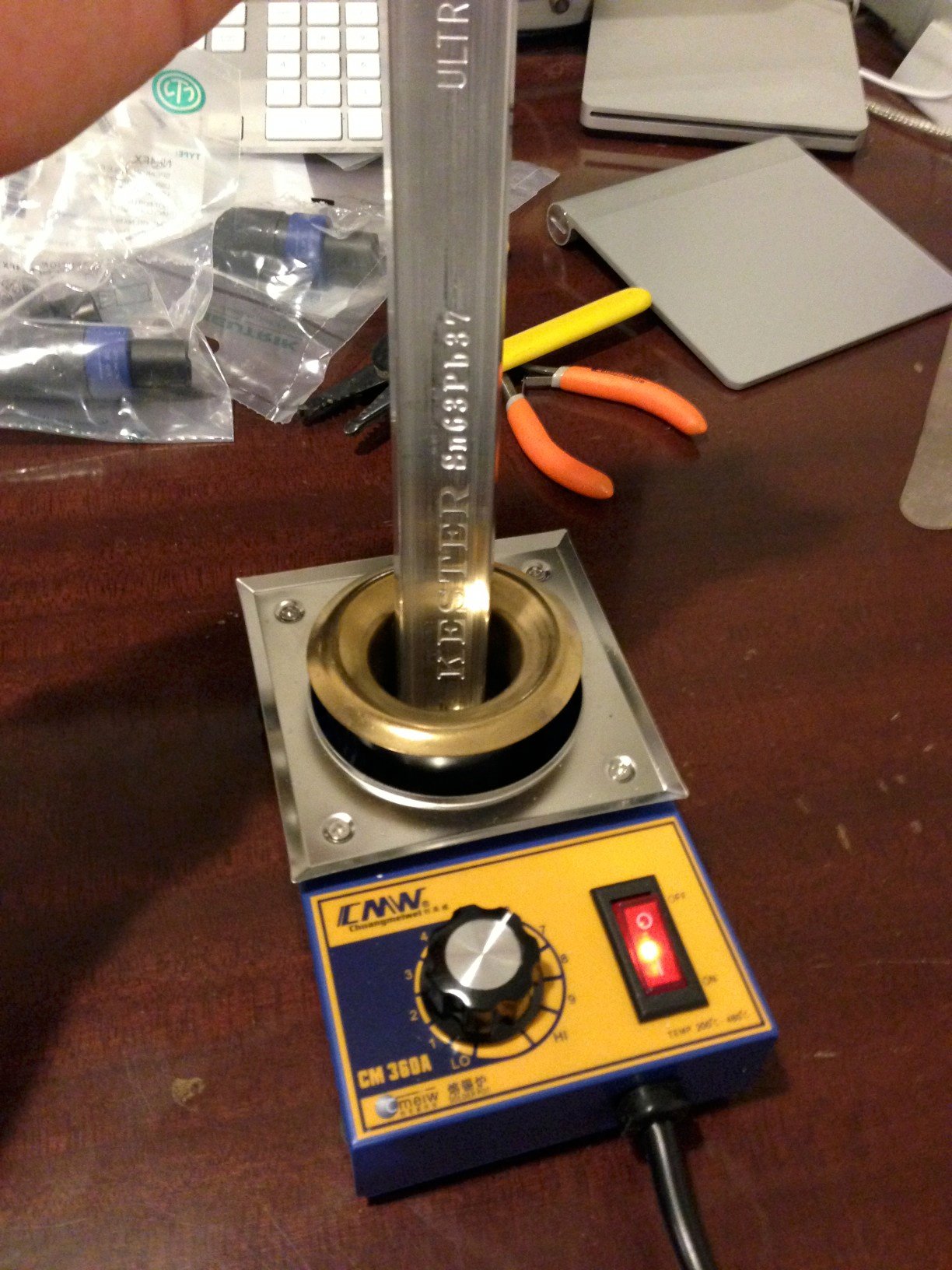

Thanks for that. Just double checked, the ones I bought from Mouser are the tinned brass. Ok, I'm in business!Good music, a good source, and good power can make SDA's sing. Tubes make them dance.
Well look what I've got!!!
Here's a few pics of the solder pot:

The solder pot is a great tool. Any time I need to tin a wire from now on, it's getting plugged in.Good music, a good source, and good power can make SDA's sing. Tubes make them dance. -
When I am ready to rewire my other two sets of CRS+s, I will get the American Beauty MP-9 solder pot.Proud and loyal citizen of the Digital Domain and Solid State Country! -
Or I could just loan you mine.Good music, a good source, and good power can make SDA's sing. Tubes make them dance.
Thanks for the generous offer, but I decided to go ahead and get the MP-9 solder pot now because I wanted to redo the CRS+'s AI-1 cables.

The Cardas bar solder and Cardas soldering paste (flux) were purchased from Parts Connexion (www.partsconnexion.com).
The grinding wheel and soldering wand method for removing the wire enamel works very well with Cardas small gauge wire. In most cases, the resistances of the Cardas 15.5 AWG wire segments were close to the theoretical reference values for 15.5 AWG copper wire: 0.004 ohm for the 13" segments and 0.006 ohm for the 20" segments (table 2).
Cardas 9.5 AWG litz wire was used to make replacement cables for the AI-1 Dreadnought. With the grinding and wand soldering method, the much thicker and more tightly wound Cardas 9.5 AWG wire segment resistances were far from the theoretical reference values for a 10 foot length (table 3). The reference resistance value for a 10 foot length of 15.5 AWG copper wire is 0.009 ohm. The resistances for the ground and wand soldered segments were three to four times greater.
The solder pot was set to the maximum temperature (there are no temperature markings around the dial). After 15 minutes, I used a Fluke model 561 infrared thermometer, aimed at the base of the solder pot's crucible, to measure the solder pot's temperature. The temperature was 560 degrees F, which was 200 degrees above the solder's melting point. Setting the MP-9's temperature below maximum did not work very well with the Cardas wire, as it took a very long time, 30 seconds or more, to tin the wire. After the 9.5 AWG cable terminations were removed, the wires were spread out a little, then dipped in solder paste, then dipped in the solder bath for three 10 second intervals. A trial run with a 1.25 foot scrap piece of Cardas 9.5 AWG indicated that three dips was required to get all the enamel off the wires. One ten second dip was sufficient to remove all the enamel from the 15.5 AWG wire.Table 2.
