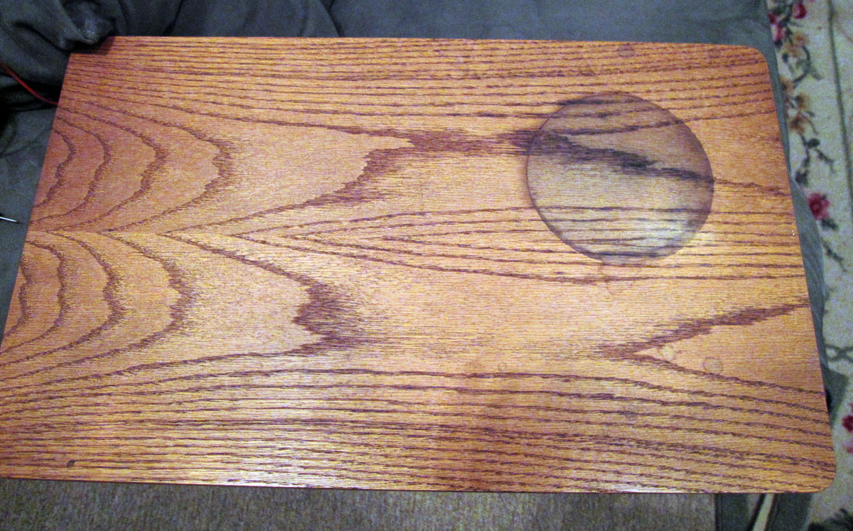

    How the hell did I do that??:eek:
    I think I remember reading on here that you are the expert in wood repair...one of these has a spot from a flowerpot or something...see photo.
    There's only one way to get that out, strip the finish, clean with mineral spirts, let dry for a few days, lightly sand with 150 grit in the direction of the grain to open the pores and then apply generous amounts of Oxalic acid. Follow the directions and do not breath the dried crystals. I would do both tops to keep everything the same. Repeat the application if needed. When you're satisfied that the black mark is gone, let dry for a few days, lightly sand again with 150 grit serrated in the direction of the grain until smooth. You are now ready to stain and finish.

    F1, it seems like you are a stickler for procedure when it comes to wood. Sounds like a lot of work to me for a water ring. Krylon makes a multitude of colors and you can be done in about 5 minutes. Fluorescent is even an option for that 80's retro look.
    Even a decorative place mat would fix it quick, and then you can set what ever you want on them without worries. Gotta stop watching HGTV.
    Either do it right or don't do it at all.

    I was pulling your chain about the 'stickler'. I would hope no one would be wanting to spray Krylon on these.
    Sorry Vmax for the derailing.
