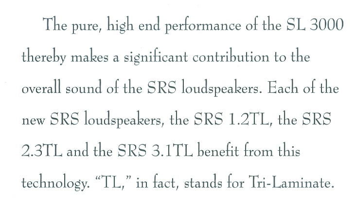

    "Featured in the Monitor 4.6, 5jr+, 5, 7, 10 and 12, the SL 2500 tweeter makes a major contribution to the improved performance of the Monitor Series 2. Sharing much of the technology of the incomparable SL 3000 tweeter used in the Polk Flagship SRS series, the SL 2500 is a highly refined refined, technically advanced driver.
    The voice coil, wound around an aluminum voice coil former, is cooled by an exotic ULV (ultra low viscosity) magnetic fluid. This material, which has a viscosity close to that of water, enables the SL 2500 to exceed normal listening levels without loss of performance or reliability."

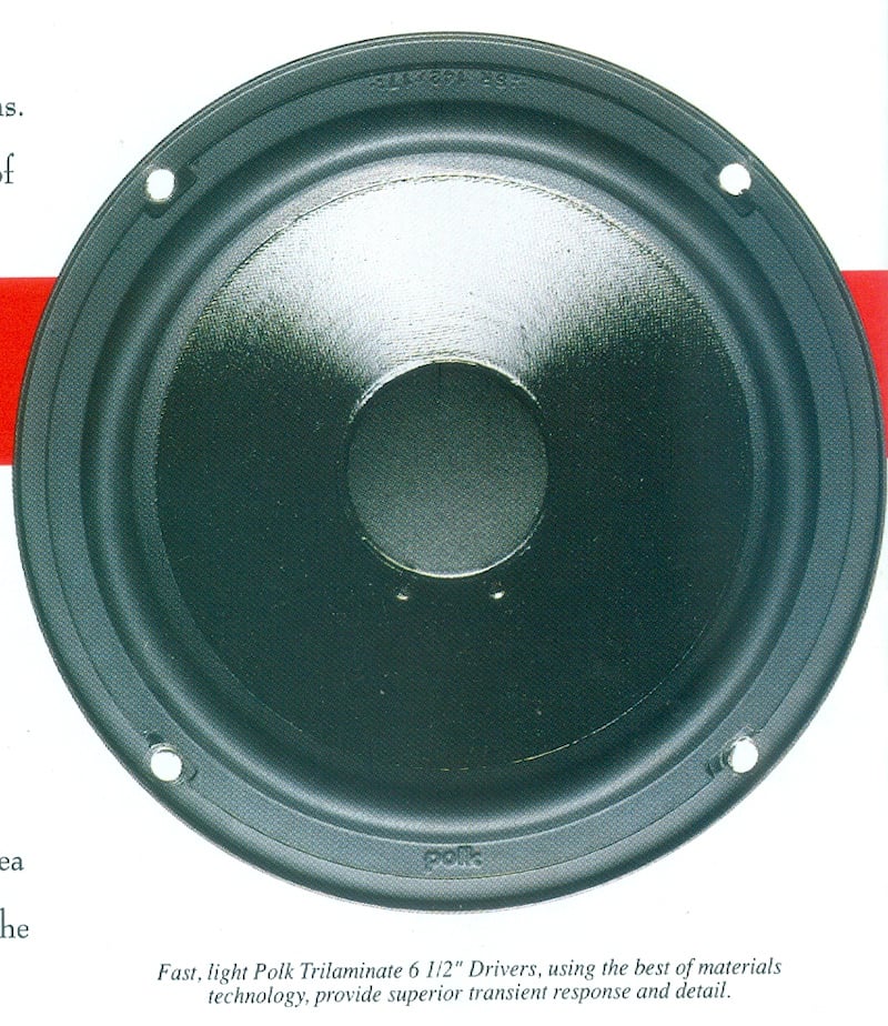

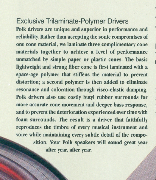

    I find it odd that the term "Tri-Laminate" is conspicuously absent from the brochure's description of the SL2500 tweeter, even though it says the SL2500 shares much of the SL3000's technology. The only place the term "trilaminate" is used in the brochure is on page 5, when giving a description of the midbass driver:
    "Polk's high performance 6 1/2" midbass driver is used in each Monitor Series 2 Loudspeaker. Its proprietary trilaminate polymer diaphram structure offers excellent transient response and near absence of midrange coloration."
    The defining technical aspect of the SL3000 tweeter is it's Tri-Laminate dome structure. I find it odd that Polk would mention that the SL2500 and SL3000 use the same ULV cooling fluid, but neglected to mention that the SL2500 and SL3000 also shared the same Tri-Laminate dome structure...if indeed they did
