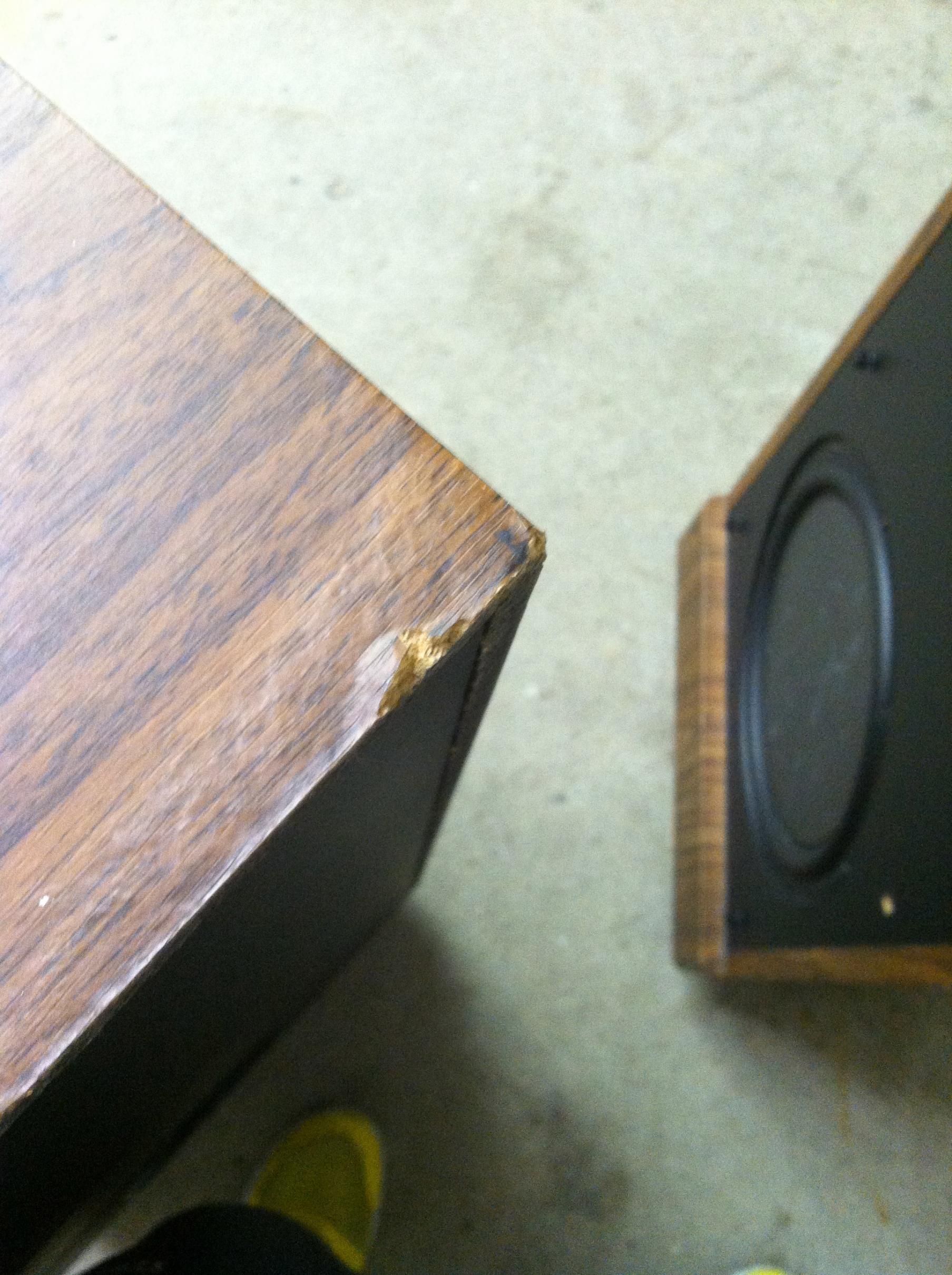

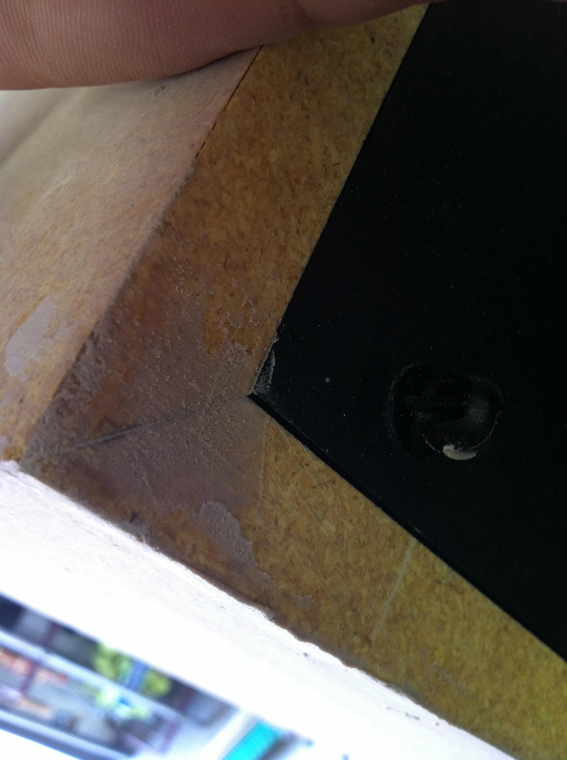

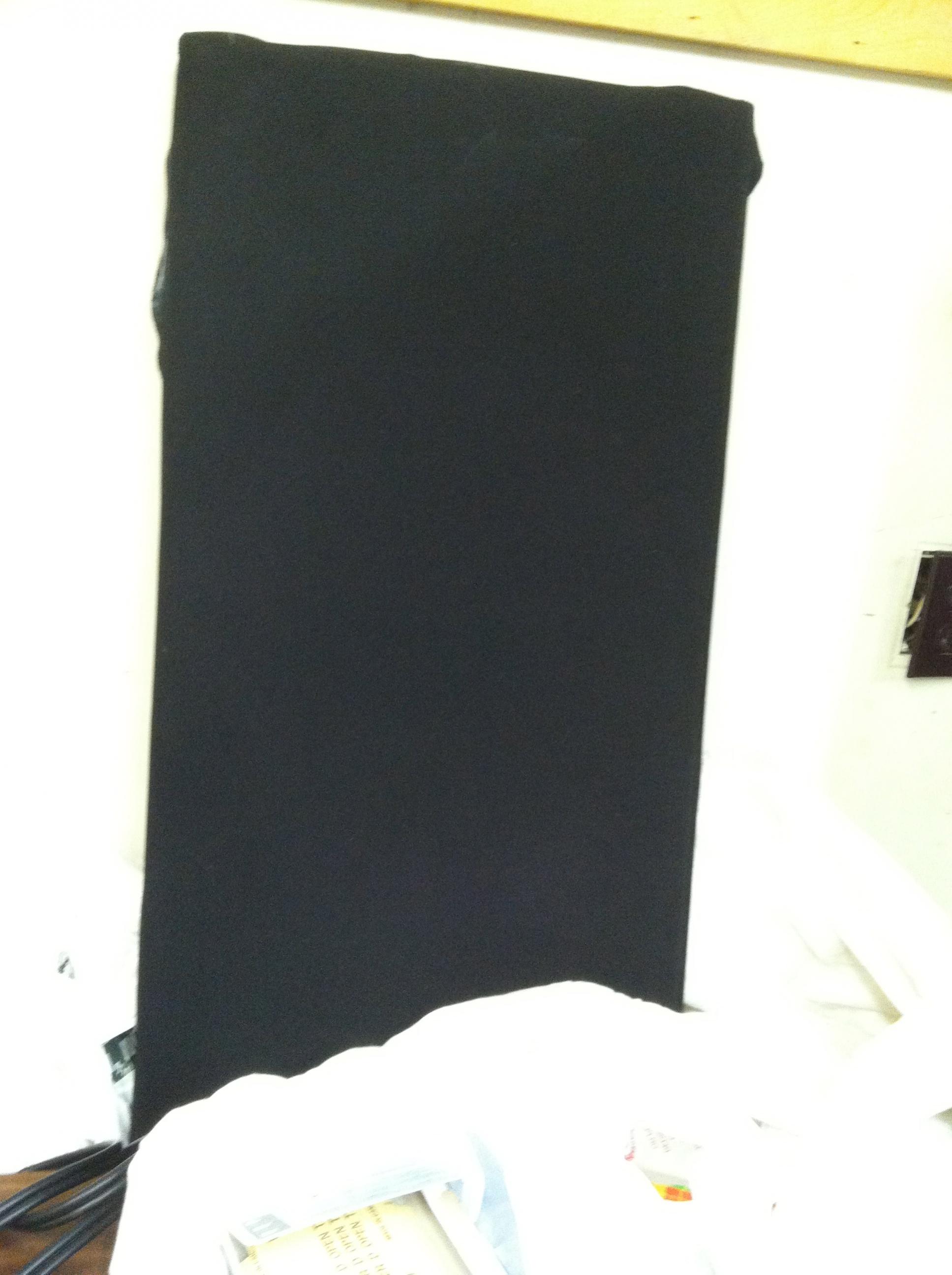

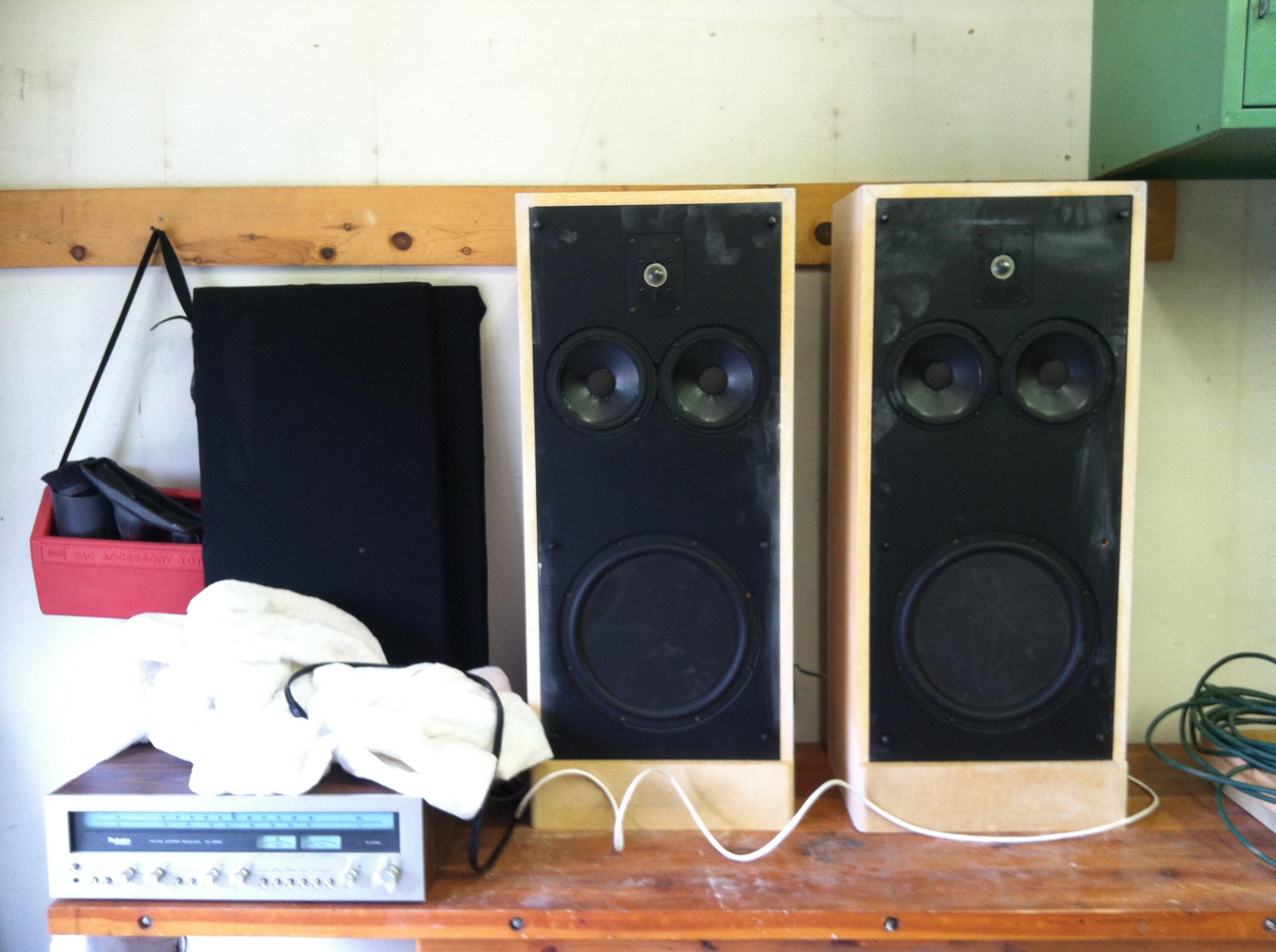

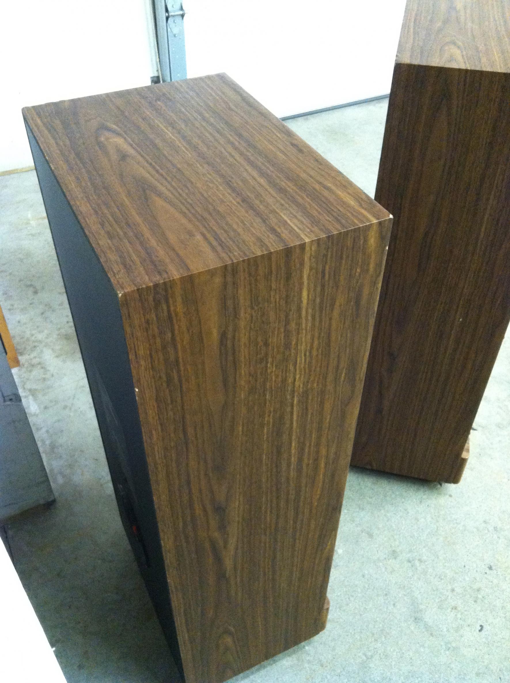

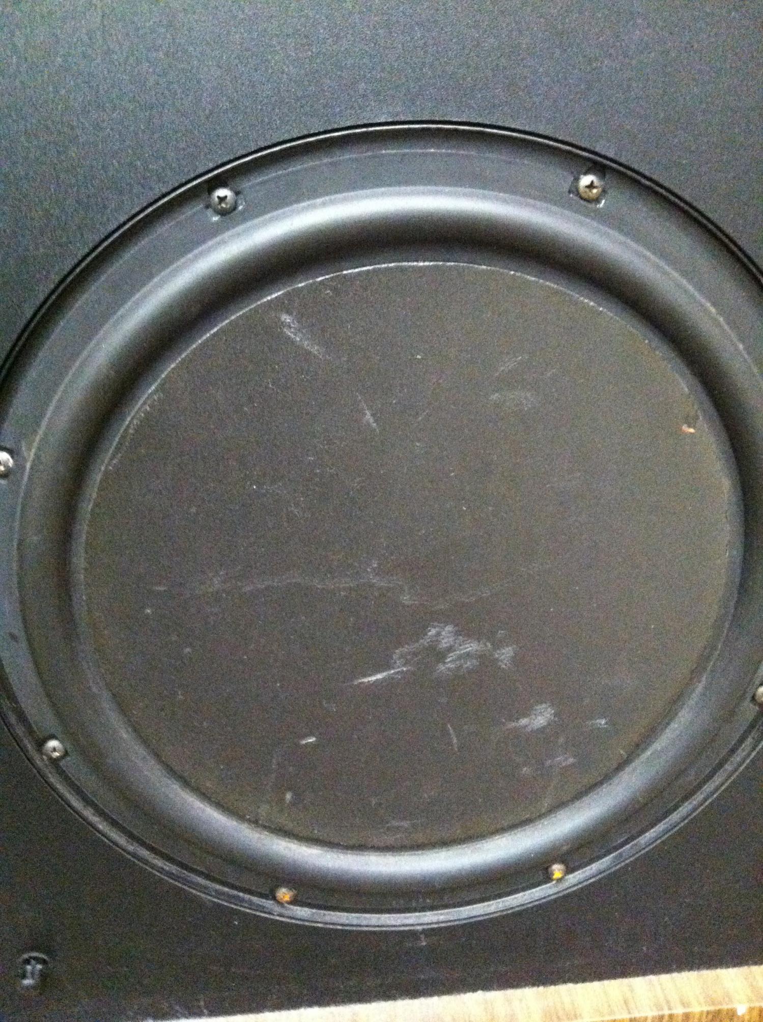

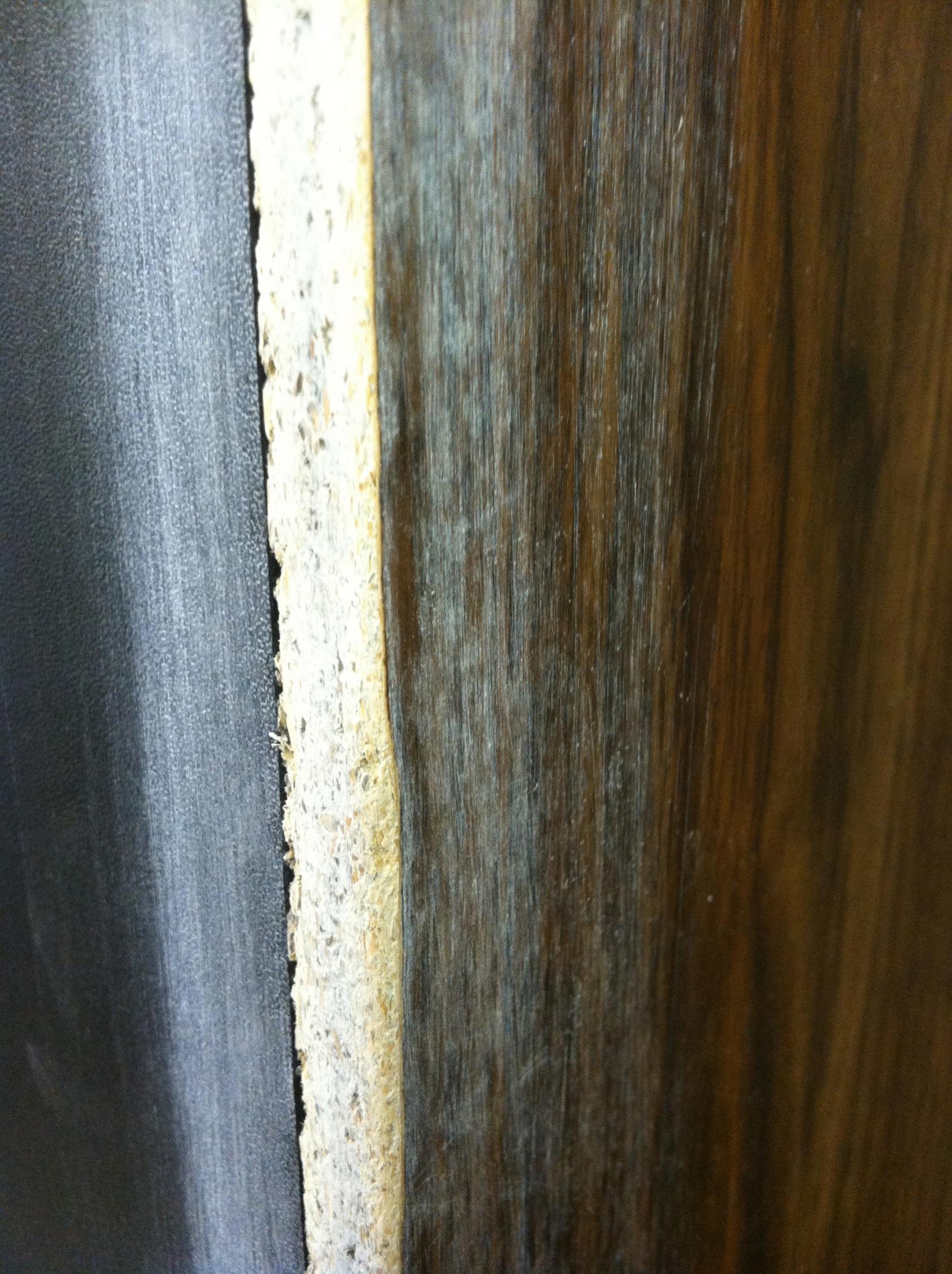

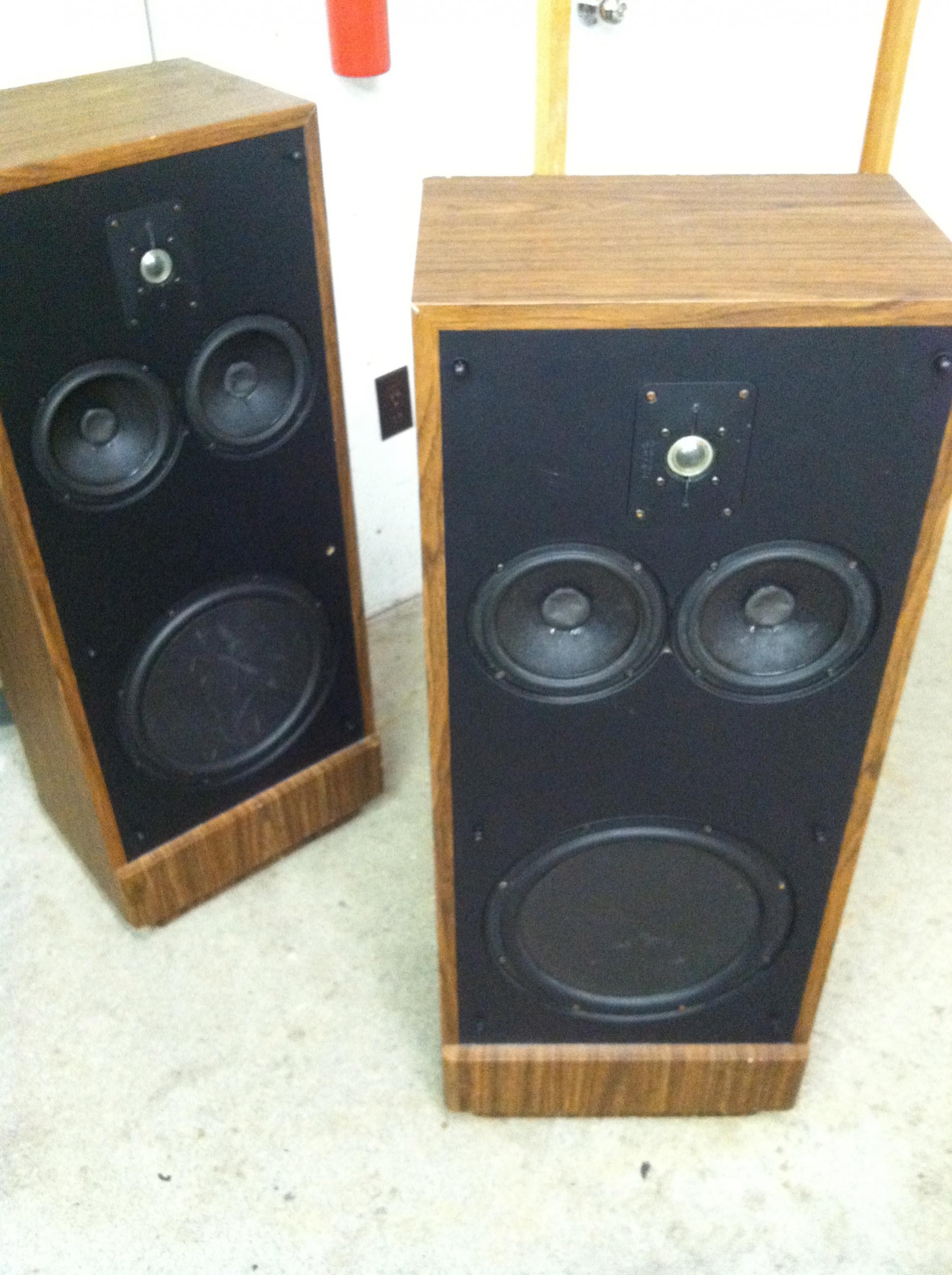

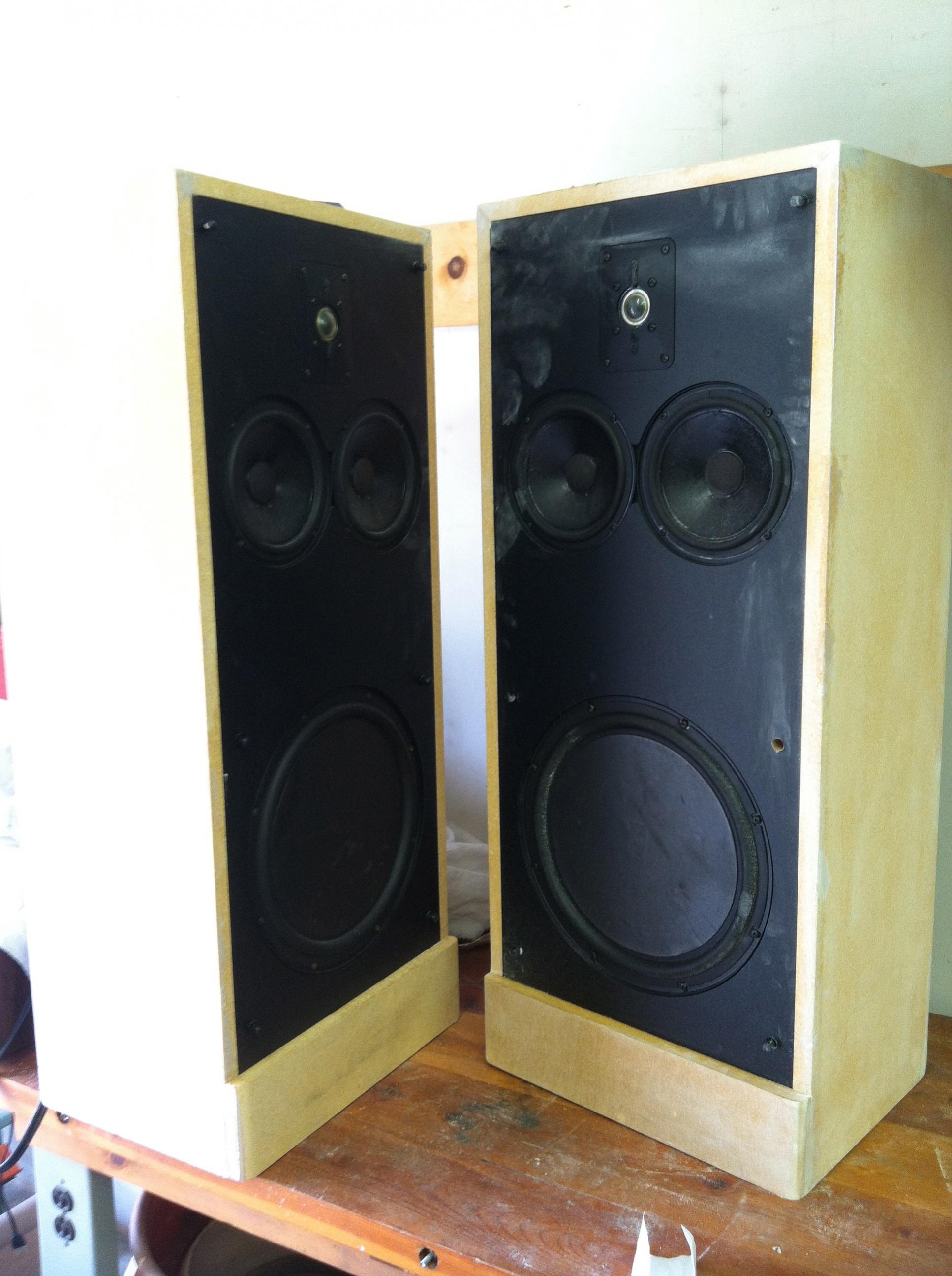

Well long story short, I ended up purchasing some SDAs from a local here in Minnesota. We have been talking about it for 2 weeks or so and finally was able to meet and I was able to purchase them. I was lucky enough to have you guys tell me that $70 was a unbeatable price for them, but I know this will freak you all out but I got them for way less then that. Before I talk about the price I wanted to say that I was able to test them out and listen to them on my receiver at a local gas station. I just ran a extension cable and connected my iphone with the USB and then tested the speakers. They all sounded really really well besides some visible damage to the cabinets and the speakers themselves. Never less, I thought of it being a project that I can do over the summer before going back to college.
Some back news about the purchase was that this guy was given these speakers by his friend because he didn't want them as they aren't in the best condition. Then this guy stored them in his mom's basement, until she was cleaning it the past week and was about to throw them out.... yes throw them out... So he took them and contacted my listing on craigslist that I was looking for speakers. He contacted me about them saying he wanted $75 or so for them. Well after long time of chatting back and fourth and finally meeting today. I jumped on the deal and got them for $15, yes I am not joking $15. When we meet again, he is bringing the grills as he forget them and I am purchasing them for another $5. So all in all, I bought the pair of SDA in rough condition for $20.
Here are some pictures of the purchase. Also, I am thinking that I need to rebuild them to make them better. I just don't know where to even start or before that what the cost will be to repair/rebuild them. One of the speakers (mid driver) scratches when pushing in, but that is the only speaker that does that. All 4 mid drivers middle cone fabric is pushed in but doesn't seem to affect the sound quality of the speakers. I don't know how to repair them if it is even possible at all.
Also, I believe these are SDA2A if I am not mistaken.
Here are the pictures!

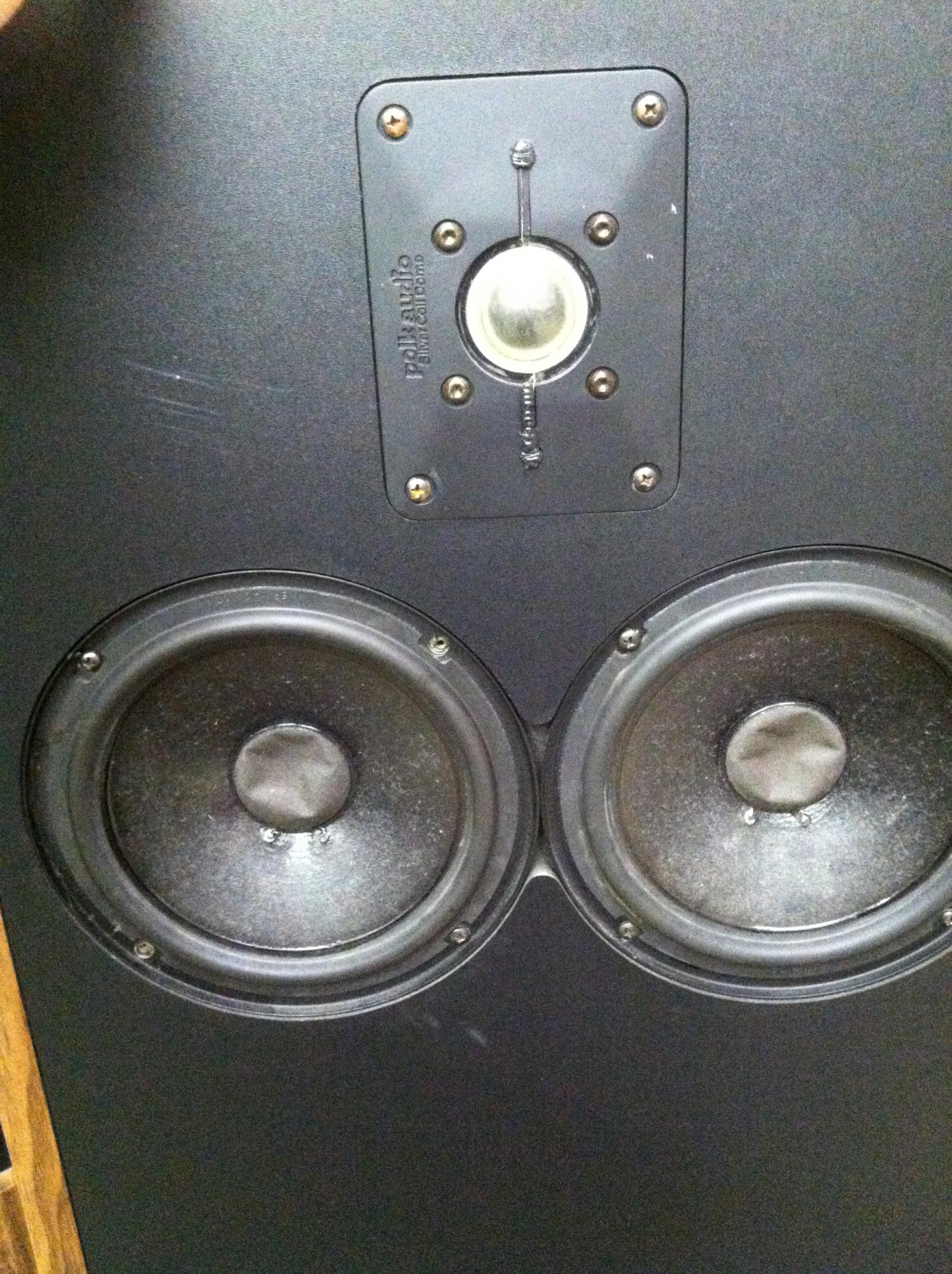

    That was a steal for $20, the scratchy driver can be replaced call Polk Customer Service, mention you are a club member for a discount. Start reading the SDA threads in the Vintage Speaker section. You can go as far as you want to as far as modding these speakers, did you get the interconnect cable?

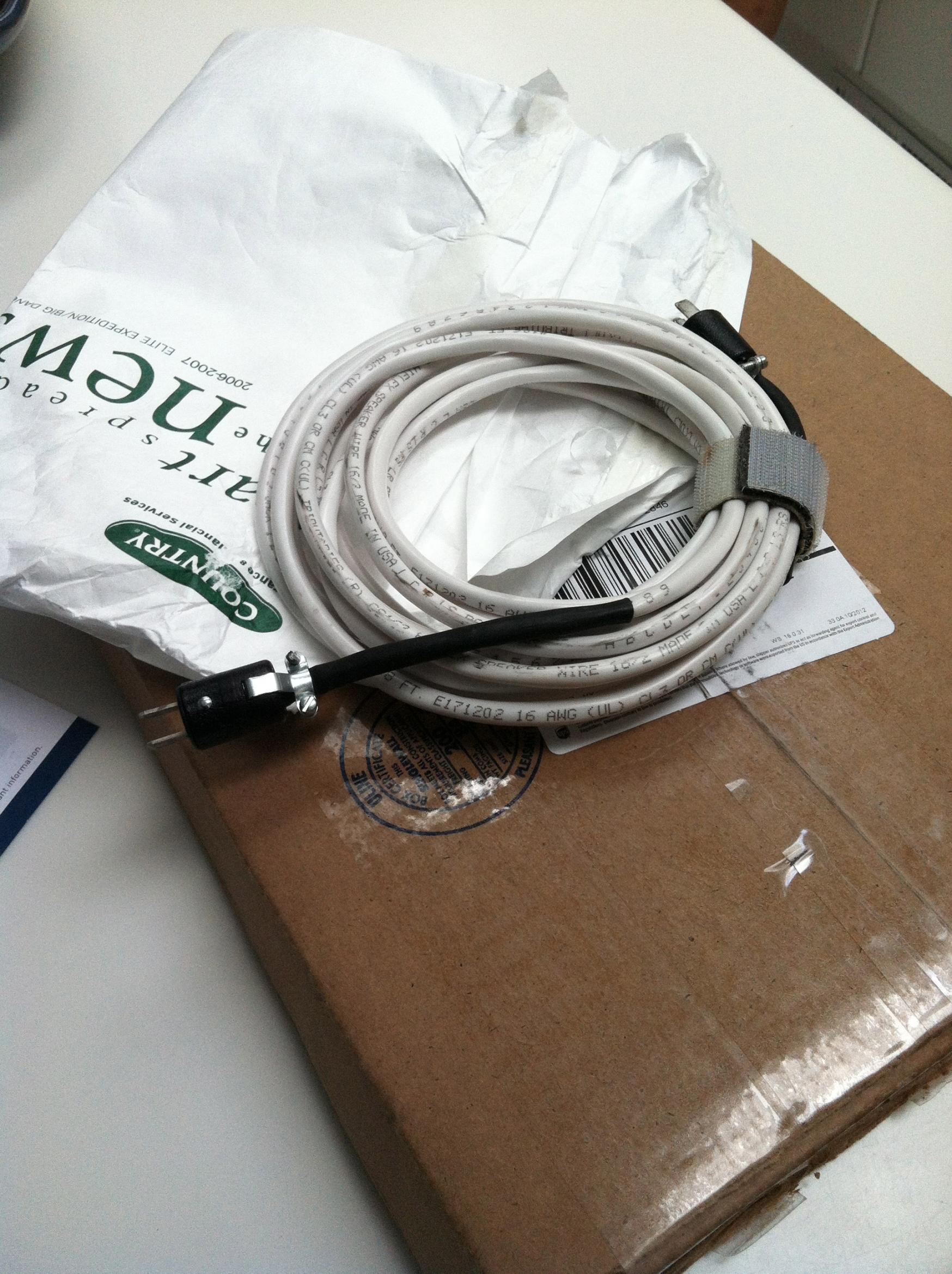

    There was no interconnect cable. Is it possible to make one? What is it used for? I also have an 8ohm receiver (denon 1912) but could I run the speakers in series to make them 8ohm?

    $20 is a robbery.
    Pushed in dustcaps can be pulled with tape or vacuum or glue trick.
    Use speaker cable with banana plugs to make pin/blade cable.
    If it's blade/blade, it's more work.

    Yes the unit will be fine with these speakers unless your room is 30x30 you wear a hearing aide and like the loudness and the bass at full. Is the IC connection a little round hole and rectangle or is it two rectangles?
    F1nut Posts: 51,686
    edited June 2013
    Those are 2A's with the blade/blade SDA cable. Polk still sells that cable. I'd be surprised if you ever see the grills.
    Do NOT connect the speakers in series.
  • PolkieMan
    PolkieMan Posts: 2,446
    edited June 2013
    I wonder why they still have the blade blade and not the pin blade?
    Probably because the pin blade was easier to DIY.
    DO NOT connect in series.
    (The scratchy driver can be replaced call Polk Customer Service)
    1st pull the driver there should be an Mw 65xx on the back it should be 6510
    The new drivers look different the voice coil wires are hidden and the cone
    has more of a rough texture.
    I like the vintage drivers they come up on ebay.
    The 6510 is fairly common.
    Do not throw the scratchy driver away usually they can
    be repaired. Always keep a spare.
    http://www.audiokarma.org/forums/showthread.php?t=202963
    Here is the SDA Handbook print it read it, please.
    vr3mods.com/uploads/SDA_Handbook_2011_Rev2.pdf‎
    http://www.ebay.com/itm/Polk-Audio-MW-6510-M8T-6-5-Driver-Woofer-Speaker-Pair-Tested-Sound-Great-/271209354108?pt=Vintage_Electronics_R2&hash=item3f2556537c
    http://www.ebay.com/itm/POLK-AUDIO-WOOFERS-MW6510-Excellent-CONDITION-MONITOR-8T-11T-SDA-CRS-SDAII-/221230912439?pt=Vintage_Electronics_R2&hash=item338263d3b7
    The company that made the blade/blade and pin/blade connectors was bought out many years ago, then years later that company was bought out. The current company makes a blade/blade connector that is similar to the original, but no one makes the pin/blade connector.
    Using an RCA connector works (sort of), but it doesn't have the blade part for added support or in the case of the AI-1, the necessary second connection.

    It looks like Cinch is no longer making the blade/blade connector as Mouser and Digikey list it as obsolete. However, it appears that Jameco still has some. http://www.jameco.com/webapp/wcs/stores/servlet/Product_10001_10001_248760_-1
    Note that the original blade/blade and pin/blade connectors made by Beau were a sealed molded design and Cinch's blade/blade is not.
    Banana plug is better choice and those with wider middle part fit so good and tight that no additional support is needed.
    The diameter of a banana plug is too large to fit into the pin hole.
    Ah, I see.
    So to use banana plugs, p/b terminal needs to be upgraded/replaced with binding post?

    He has 2As which are Blade/Blade.
    The best solution for the Interconnect Cable is Speakon Connectors

    That's what a lot of folks have done. Personally, I prefer Neutrik speakON connectors.
