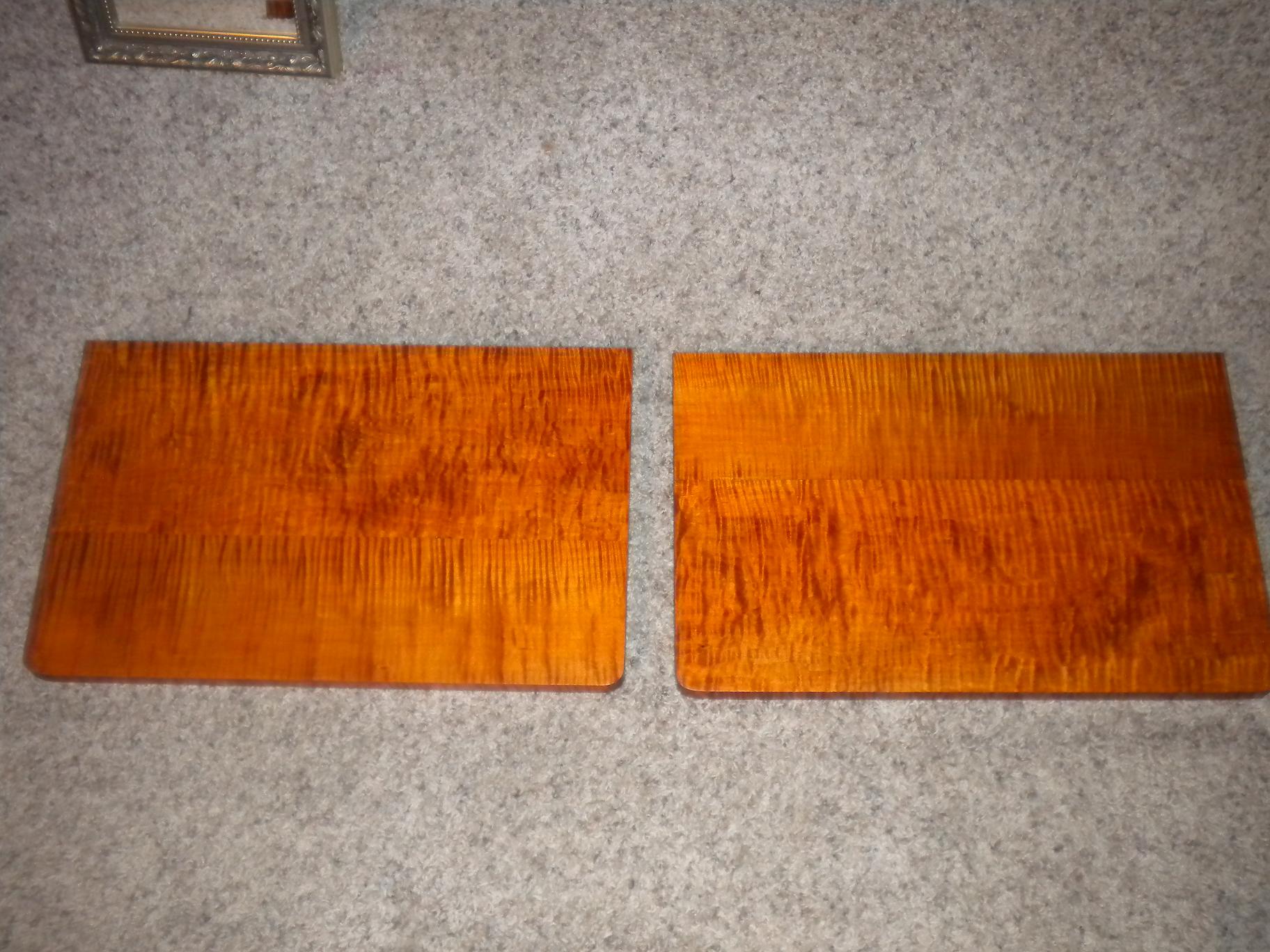

    Care to elaborate? Musky1963 is just using a solid rectangular slab with no joinery, and I think he's referring to the fact that most of the time, all you see of the caps are the edges (for the taller SDA's anyway) so the "eyes" wouldn't have the visual impact they'd have for a larger visible surface.
  • gdb
    gdb Posts: 6,012
    edited February 2012
    Joinery techniques can be used to edge the slab with an "eye- rich" piece of wood or, you could just content yourself with the knowing that the eyes are nicely visible on the top surface. I, personally, would edge with solid wood some MDF that was veneered rather than using slab wood but, that's just me and my preferences. For me it's more important how speakers sound, not their looks.

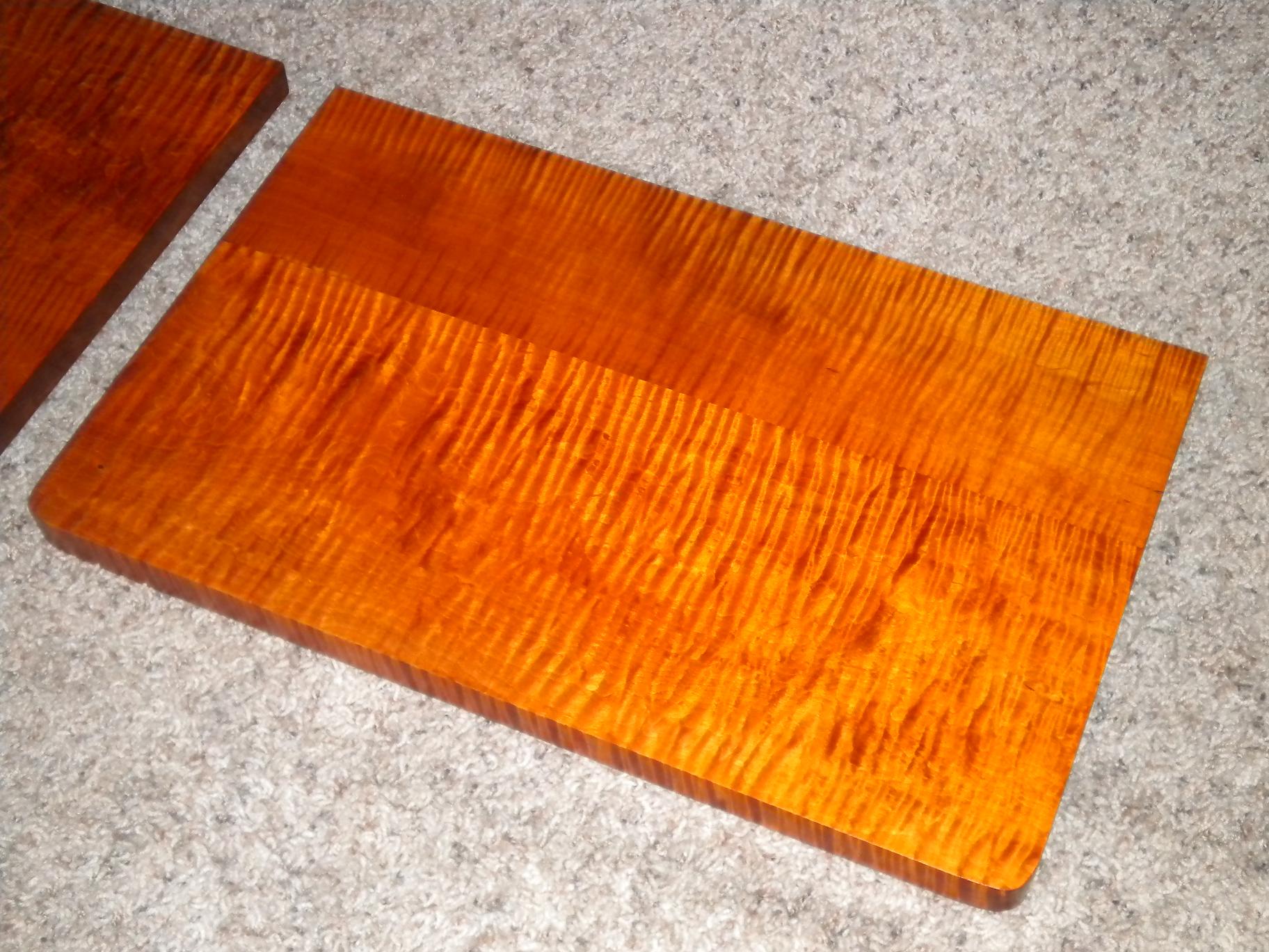

    The caps are 1" thick or VERY close. Sal, don't worry, you aren't in the back of the bus :lol:
    Jeff
  • Bubinga99
    Bubinga99 Posts: 283
    Musky, did you spend any time considering thicker caps? To my eye, the 1" caps look disproportionately thin (on the 2.3TL's anyway). I did a quickie mock-up a couple years back (stacked up layers of 1/8 and 1/4 mdf) and if my memory serves, I think I decided 1-1/4" thick was the sweet spot for the 2.3TL's, with 1-1/2" looking disproportionate in the other direction. Inch-and-a-half might work for the larger 1.2's though. Anyways, just wondering if you considered thicker caps and what you (or anyone else for that matter) concluded.

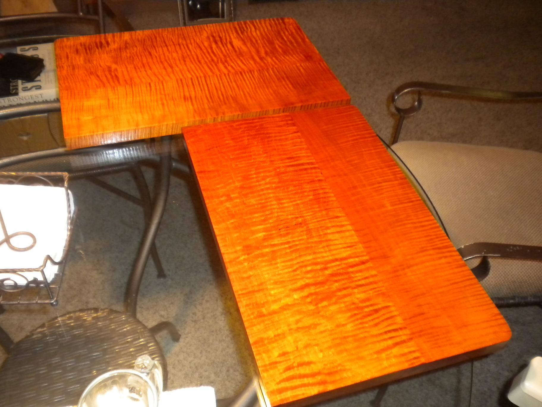

    Recieved my end caps from Jeff (musky1963). I am going to install them on Wednesday. I will also post some pictures after they are installed.
    Greg

    He's joining boards together to make the slabs.
  • musky1963
    musky1963 Posts: 275
    Using several boards or even ripping a single wide one into a few boards, then regluing them back together is better than using just a single wide board. It relieves the stress in wood and less chance of warping.
    Jeff
  • musky1963
    Also, I wouldn't consider gluing/ironing on veneer over mdf "joinery". Anyways, I have furniture that is pretty long in the tooth and rarely have I had any issues.
    Jeff
    F1nut Posts: 52,024
    I agree, was just pointing out to Bubinga99 that you are using joinery.
