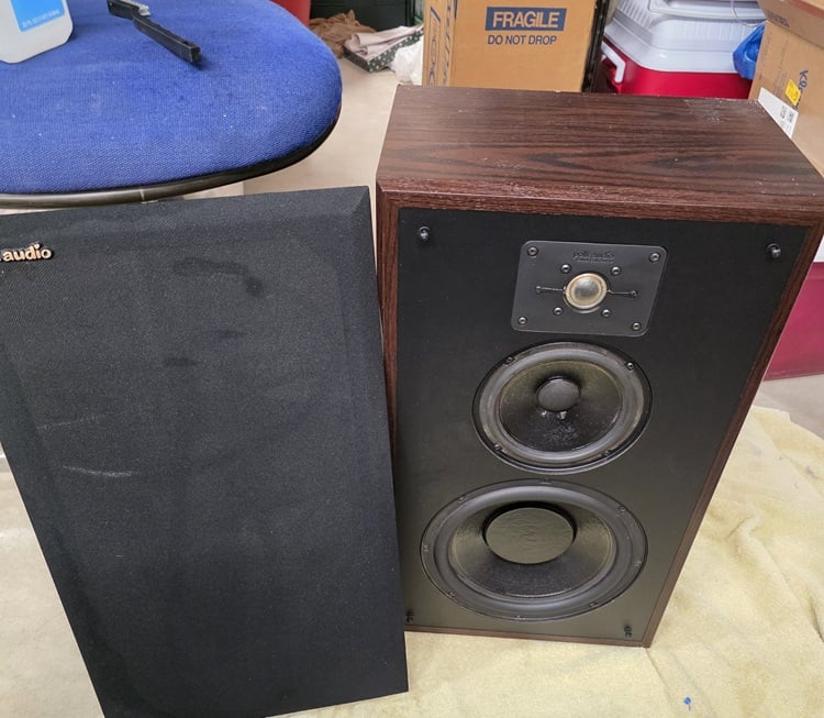

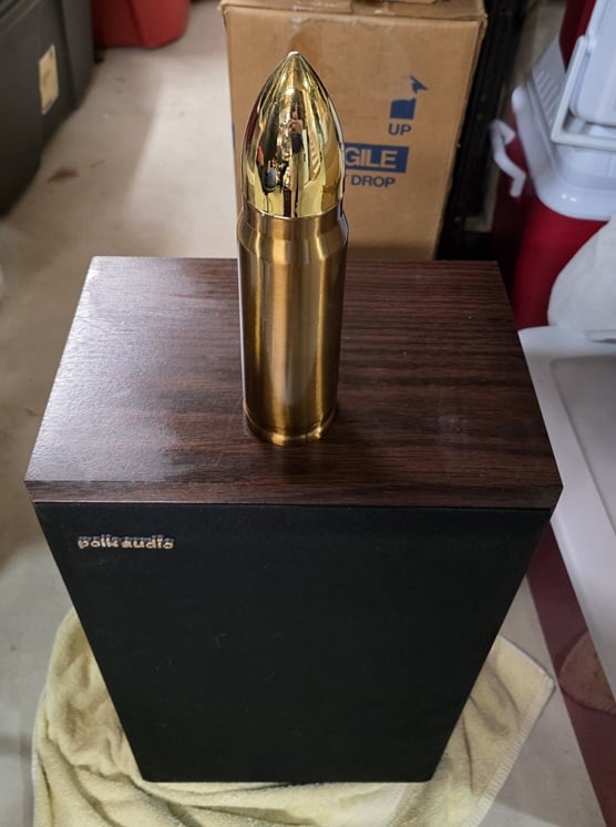

    I swapped in some 7C's Ed dropped off last Feb. He's been asking if they were OK. No loose magnets. They pass the push the passive radiator test, no leaks. Sound ok but they deserve some upgrades. They are in very nice condition with original matching serial number boxes.
    Carl chipped in with some Larry's rings. They had some surface rust so I sanded and painted them. Jay surprised me with RD0194's. I bet this project wont give me any trouble like open reel decks can.....

    Nice looking 7's. I'd like to karma a set of RDO plates to these beauties. If you'd like, just PM. What color are those cabs?

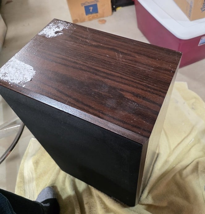

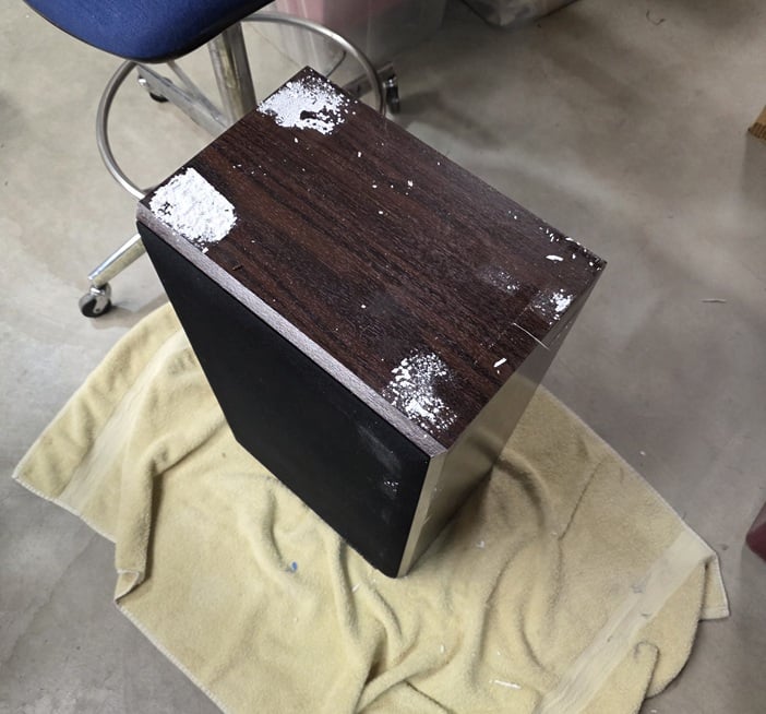

    Thanks! That's a very generous offer considering I haven't done anything for you! Carl swore he had a pair but couldn't lay his hands on them.
    They look like Walnut to me. They suffered some Styrofoam transfer, probably while in storage. I was leery of some cleaners as they can degrade the thin vinyl material. You can see how the corners look scuffed and dull compared to the unaffected areas. It's more noticeable with light from a certain angle.

    50% isopropyl alcohol wont affect the vinyl. Ive tested a couple times.
