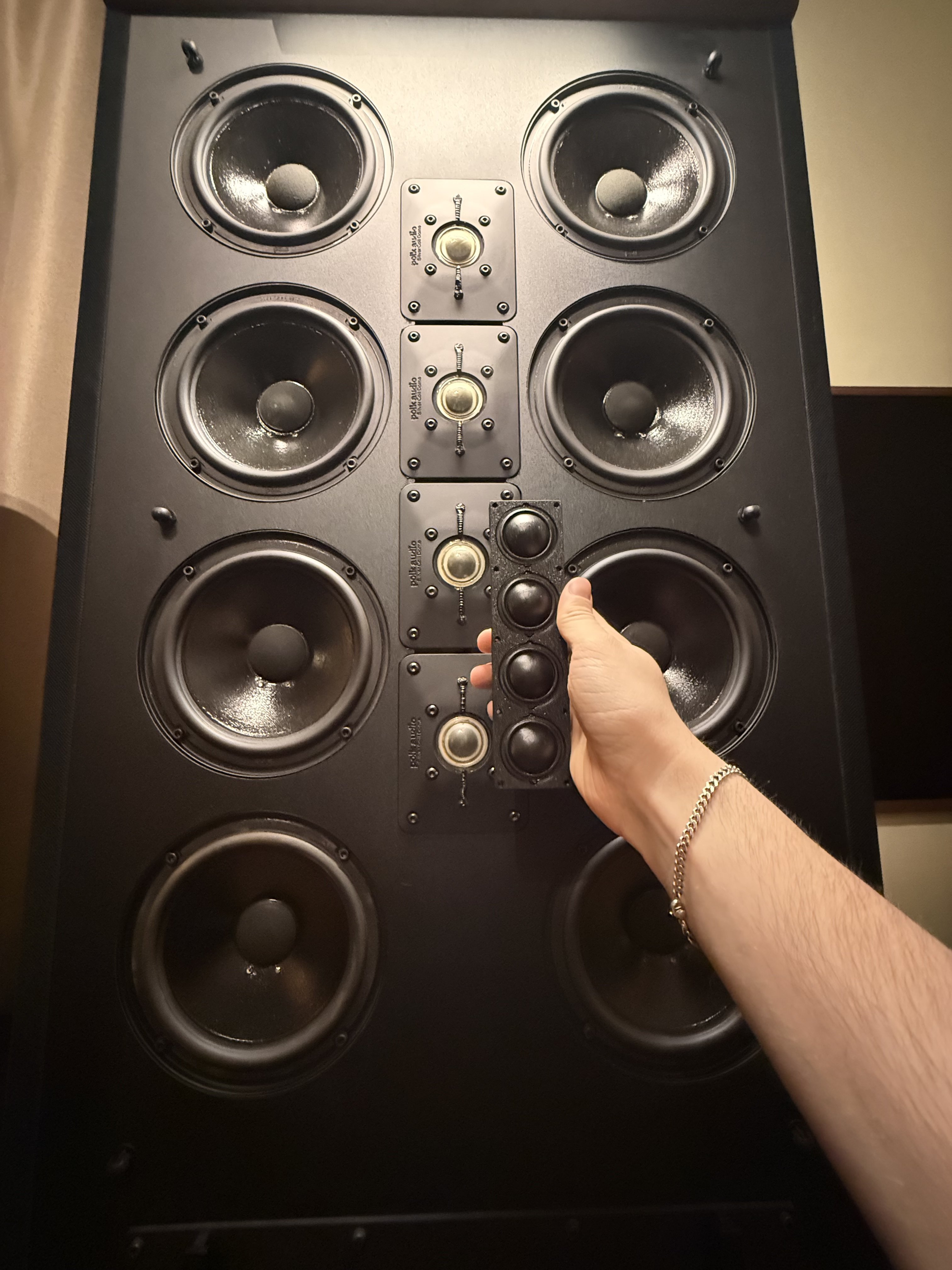

Hi everyone! I am building miniature versions of my SDA SRS speakers. I would like to have some pro help in my project. I have ordered mid and tweeters, and i am going to design the crossovers now.
I don't even know where to start. Every calculator is for 2-way systems, but i want to include SDA in the speakers. I know that it is impossible to get it exactly right with these components, but i want to try to get it as close as i can.
Down below are some images of the original wiring scheme with all the component values, and also the new speakers/tweeters for my mini build, along with pictures of the original speaker/tweeter specs.

    Just a disclaimer. This build is just an homage to my real pair. I know nothing will be exactly right, because of MANY factors. But i kinda want to try to get it as close as i can, just for fun, just for the nerdiness.
    My first thought was a usual 2-way crossover, and to scrap the SDA totally. But… then i thought. Why not make it as close as possible?
    So.

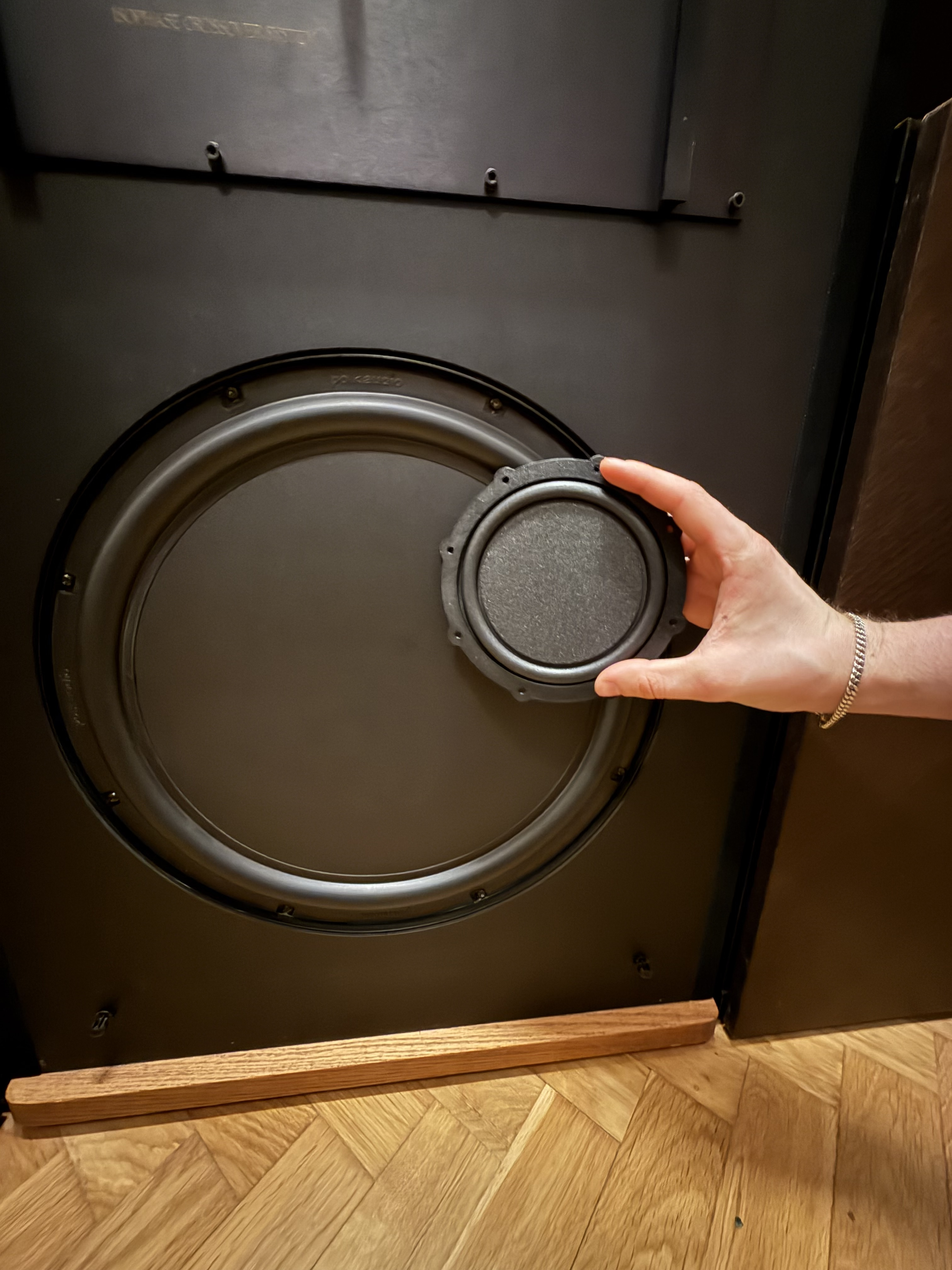

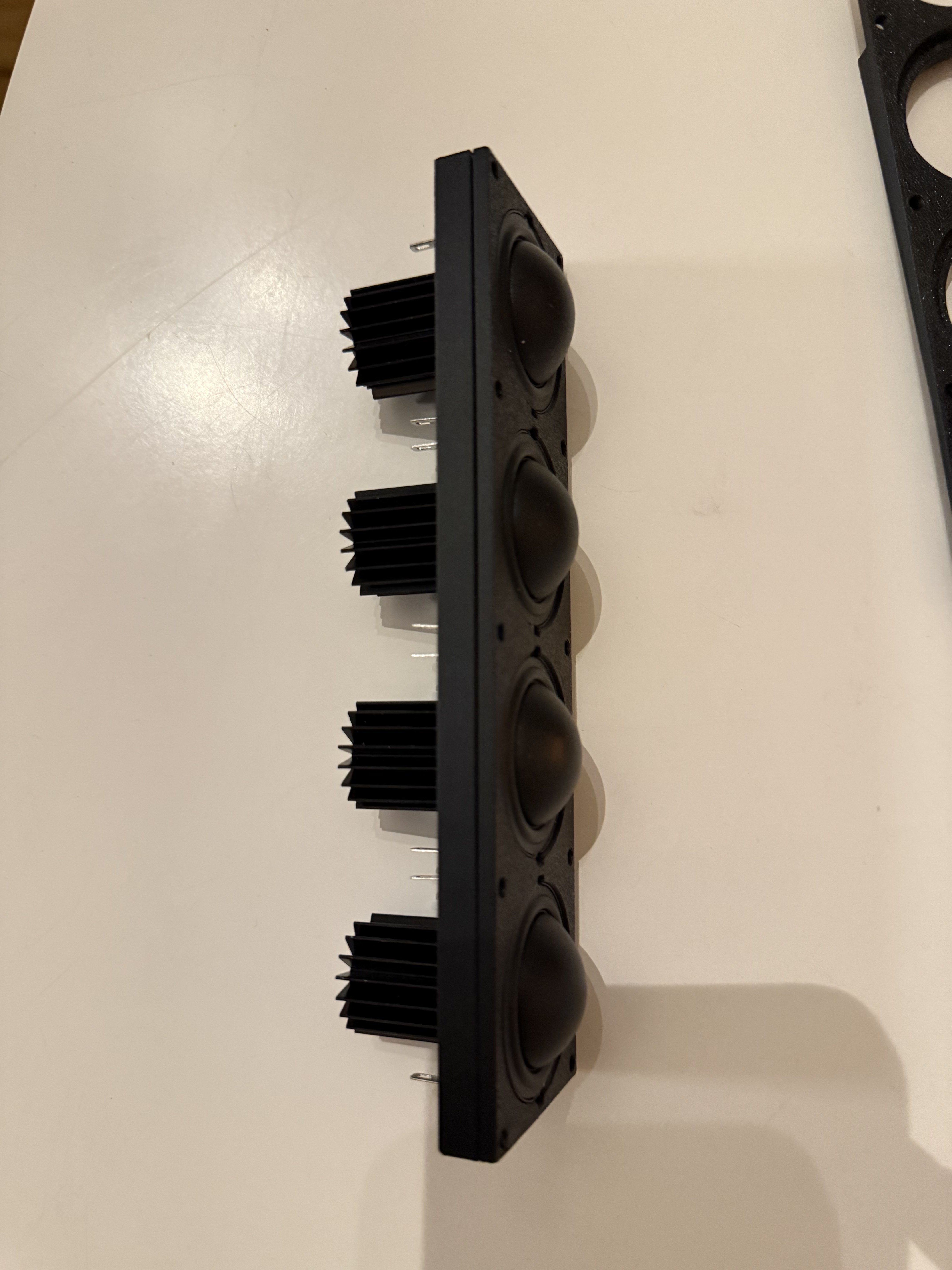

    Im taking every measurement and multiplying by 0.35. This results in 2 inch drivers instead of 6.5 inch. And the passive radiator in the bottom will be a 5.25 inch.
    I think i will buy one seperate 8 inch Sub to carry the heavy hz, so that won’t be a problem.
    In mm it will be 577.5mm in height, 192.5 in width, and 115.5mm in depth. Mostly made of MDF, and the top and bottom in pure oak.
    The SDA cable will be a gold plated 3.5mm AUX just for simplicity.
    I know i make trouble for myself by buying no-name speakers off amazon. But i don’t want the homage minispeakers to cost more than the original speakers… lol.
