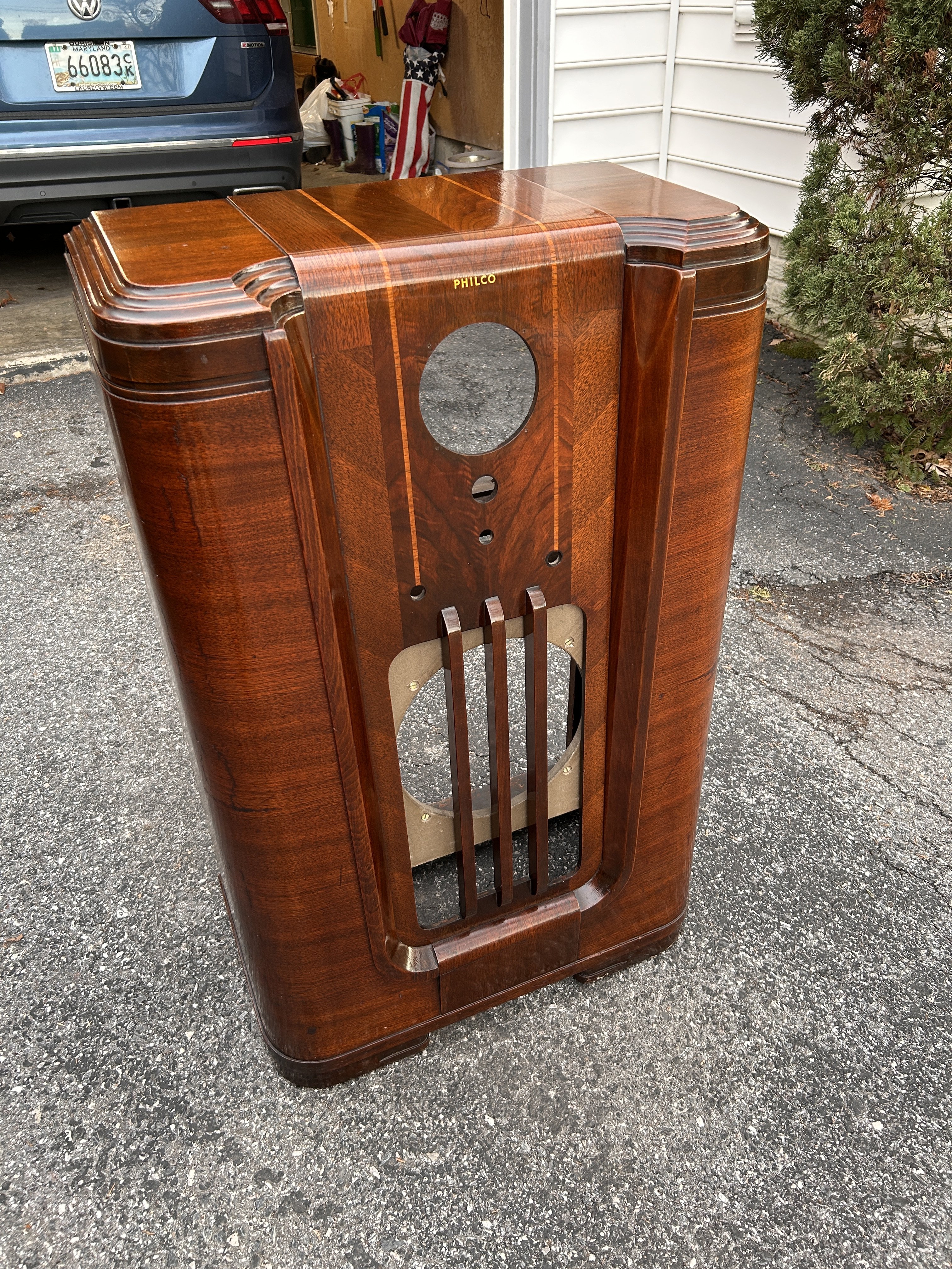

I have inherrited a couple Philco radios from 1937. One is a stand-up type (37-650) that belonged to my grandparents and the other is a table-top cathedral style (37-60) that was my father's. The cathedral radio is in good working condition and decent cosmetic condition. The stand-up needs work. Functionality is unknown and I'm not going to attempt to power it until I check some things and make proper preparations. Cosmetically, it isn't horrible but needs help. Jessie already gave me some initial advise, for which I am very grateful.

I want to get the 37-650 cabinet looking decent but don't plan on stripping the old finish. I believe it is a nitrocellulose lacquer. Then I would like to get the receiver working, if it isn't yet.

Do you have a variac (variable ac voltage transformer)? After a thorough inspection, old gear should be brought to life slowly. It's good to use an amp meter or a dim bulb tester (with appropriate wattage bulb) in series with variac to indicate problems before full voltage applied. In other words, seeing unit exceeding rated amperage draw before full voltage applied means stop applying voltage, shut off and diagnose what's causing it. (Though some like the smoke method of identifying bad components). Having tubes tested for condition is also helpful.

Dim bulb testers can be simple to complex adding multiple incandescent bulbs to match higher loads with built in amp/volt meter. Incandescent bulbs can be hard to find now. Some like the bulb over the amp meter as you have to watch the meter and components for smoke while a suddenly bright bulb is a bit more obvious.
Killawatt set to volts. I was comparing readings on the dim bulb display to the Killawatt. I can add second bulb with flip of switch. This dim bulb tester was built for a friend following someone's smarter than me design.

After looking at the wiring, it is with fear and trembling that I would power it up. I am planning to make a dim bulb tester. I wouldn't be surprised if my dad has a variac in the basement. I think I have 3 of those Kill A Watt meters.
For now, I think I'm going to focus on the cabinet. I got the receiver and speaker out. The stuff that F1Nut recommended to clean off the decades of Pledge really cleaned it up. https://www.genesisautobodysupply.com/product/2835/etalon-degreaser-silicon-remover-1-liter-etantisil-1?srsltid=AfmBOoqd-0dxeEPQY4YYGlzul4dX1n1Tw-y8ndFM35szGIizVTRb3U3AMfg

I did a little work on the cabinet so far. I haven’t touched the electricals yet but visual inspection showed that it has an “ambient air” tube 😳6A8G.

I cheated and I think I got the results that I was aiming for. I had read about the very thin laminate veneer that Philco used and that it is easy to burn through it when attempting to refinish. Many folks re-veneer but lose the varing wood grains in the process. I noticed that my father's old 37-60 table-top radio lost the bearlwood grain on the front bezel when he refinished it.
Since it is a laquer finish, I tried Howard's Restore-A-Finish first, figuring I could always refinish it if I didn't like it. The finish is very much improved, delaminated laquer on top is good now and it retained some of the old finish mild cracking for a patina that keeps it authentic.Stan

I cleaned up the tuning window and bezel and remounted it. Slow progress I know.
Time to start on the electronics. I managed to find my dad’s homemade variactor that we made back long ago.Stan
