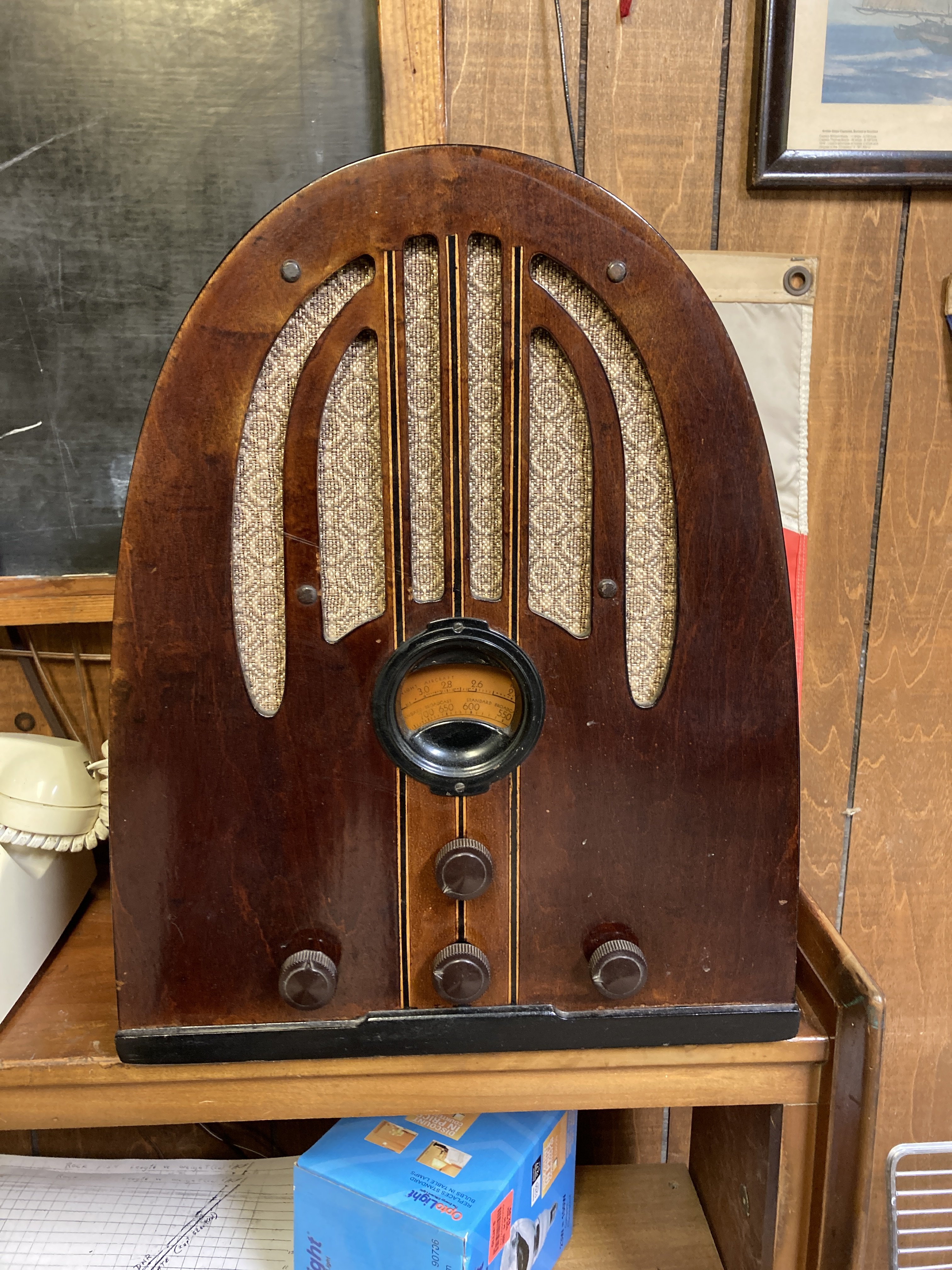

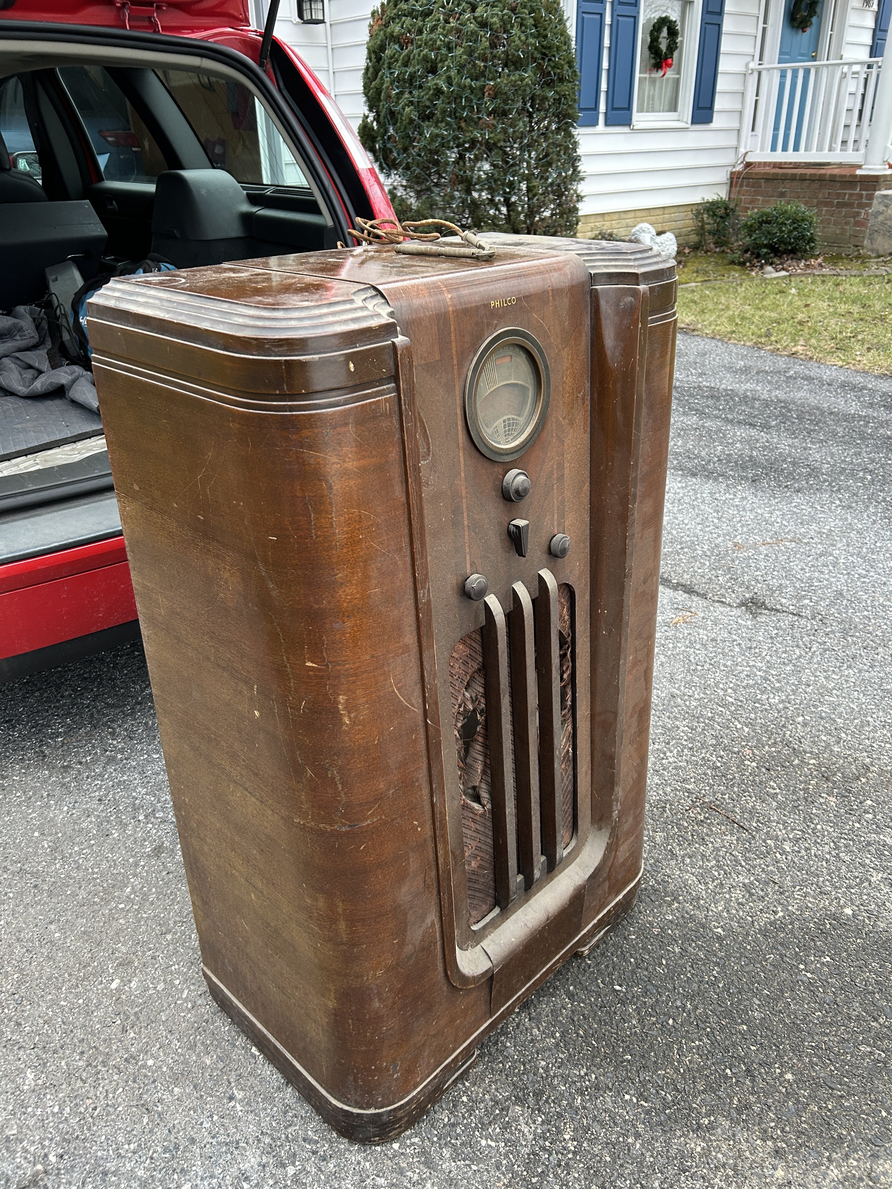

I have inherrited a couple Philco radios from 1937. One is a stand-up type (37-650) that belonged to my grandparents and the other is a table-top cathedral style (37-60) that was my father's. The cathedral radio is in good working condition and decent cosmetic condition. The stand-up needs work. Functionality is unknown and I'm not going to attempt to power it until I check some things and make proper preparations. Cosmetically, it isn't horrible but needs help. Jessie already gave me some initial advise, for which I am very grateful.
I started the thread originally in the Electronics forum but thought it better to continue as a project in the DIY forum.
https://forum.polkaudio.com/discussion/202283/1937-philco-radios#latest
I want to get the 37-650 cabinet looking decent but don't plan on stripping the old finish. I believe it is a nitrocellulose lacquer. Then I would like to get the receiver working, if it isn't yet.

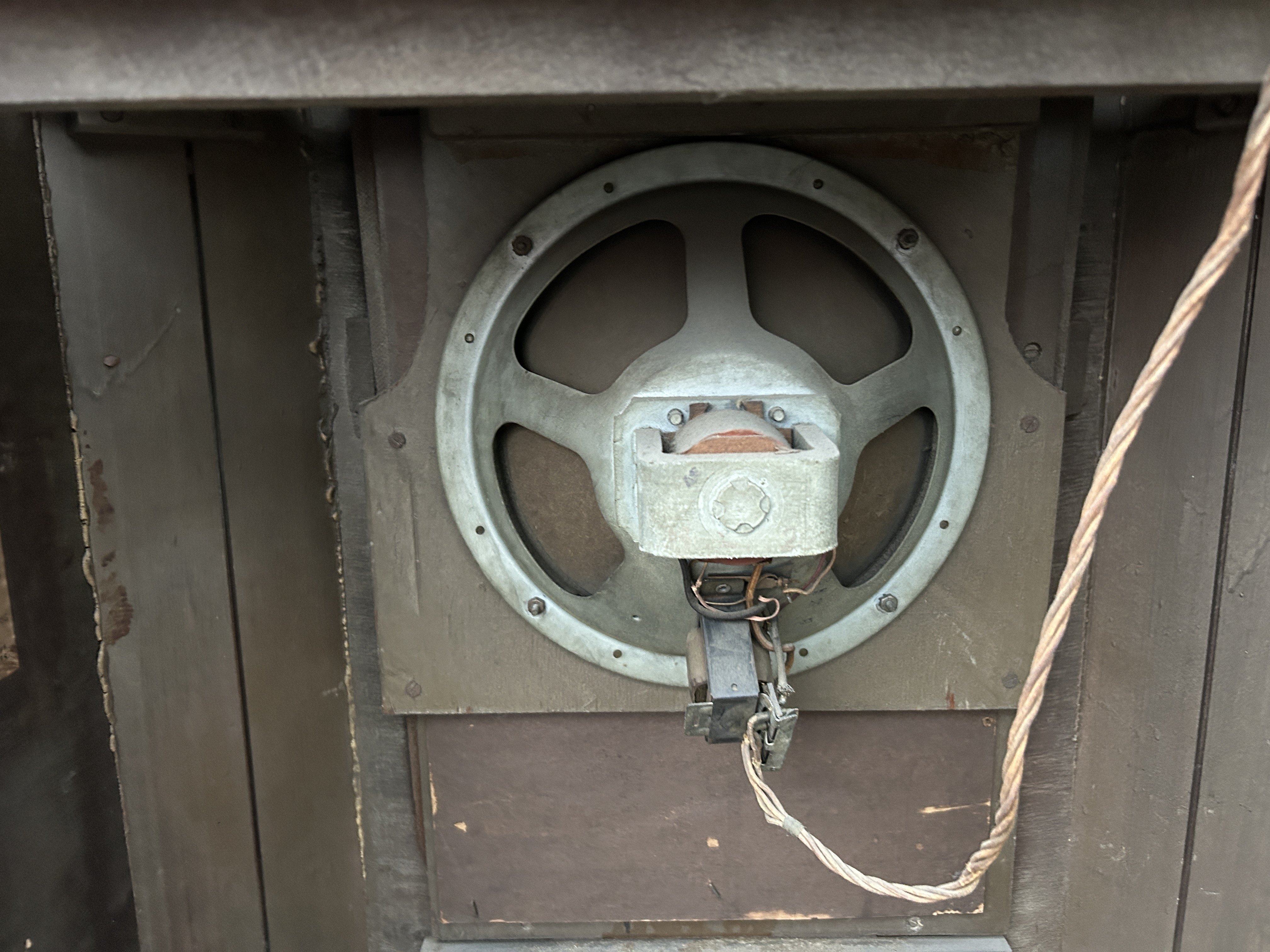

    For now, I think I'm going to focus on the cabinet. I got the receiver and speaker out. The stuff that F1Nut recommended to clean off the decades of Pledge really cleaned it up. https://www.genesisautobodysupply.com/product/2835/etalon-degreaser-silicon-remover-1-liter-etantisil-1?srsltid=AfmBOoqd-0dxeEPQY4YYGlzul4dX1n1Tw-y8ndFM35szGIizVTRb3U3AMfg

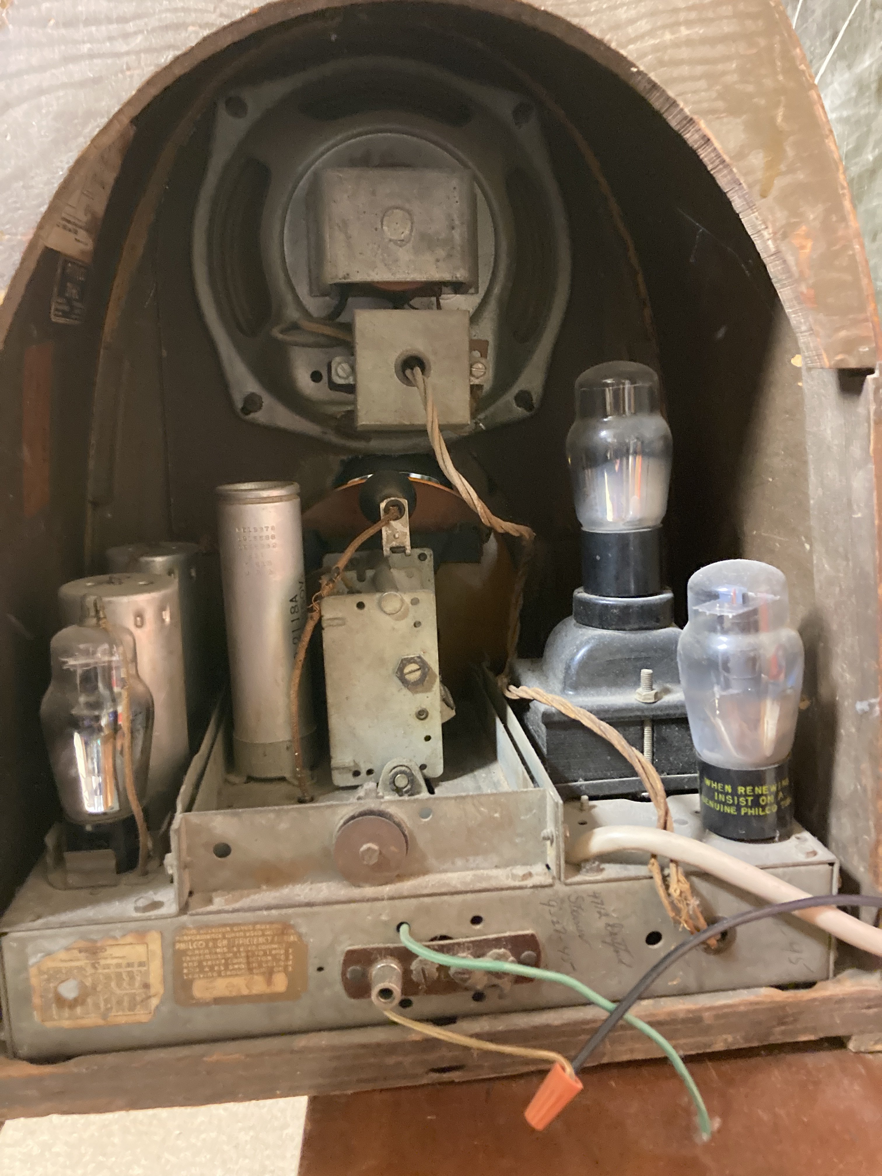

    I did a little work on the cabinet so far. I haven’t touched the electricals yet but visual inspection showed that it has an “ambient air” tube 😳6A8G.

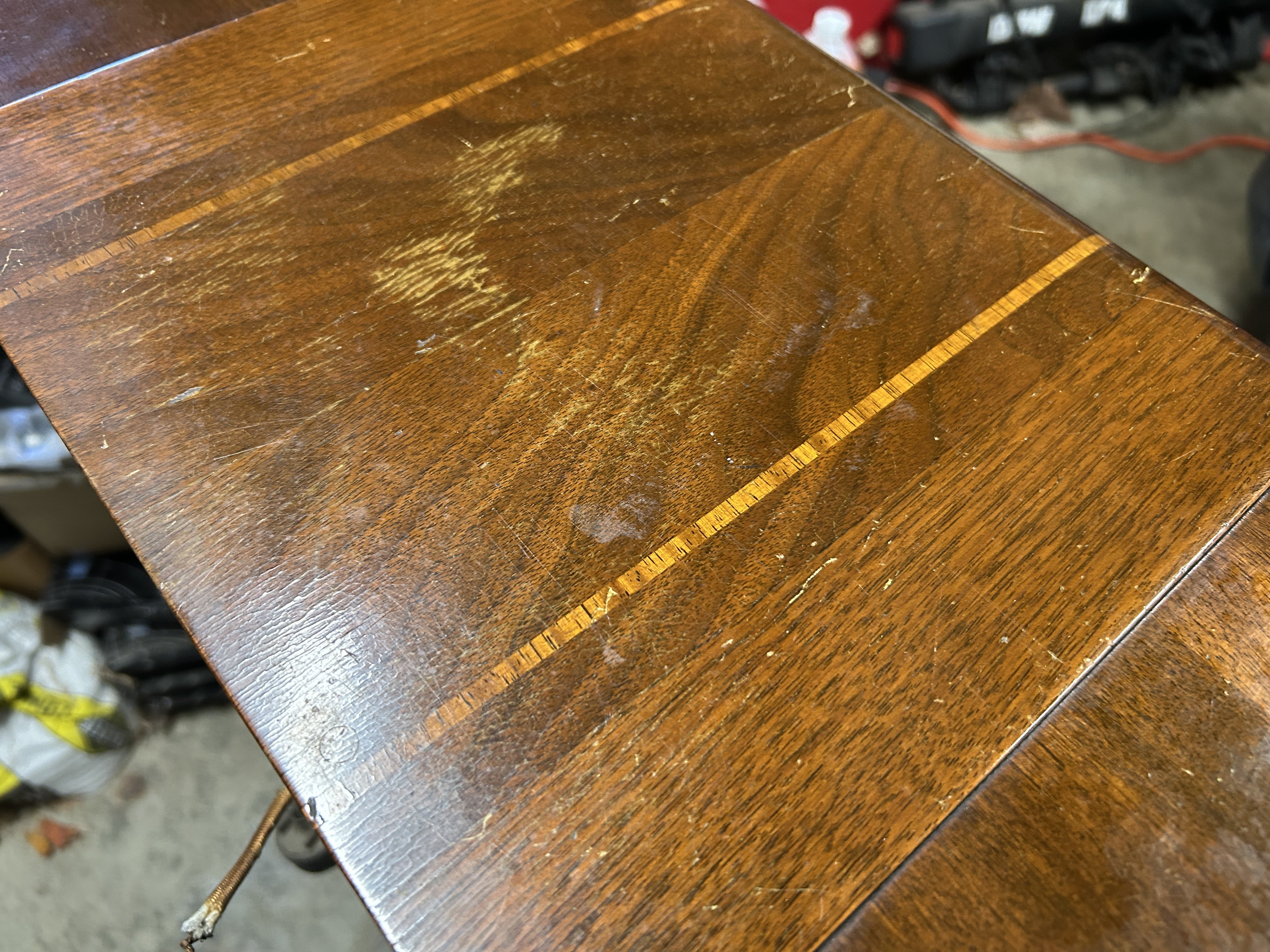

    I cheated and I think I got the results that I was aiming for. I had read about the very thin laminate veneer that Philco used and that it is easy to burn through it when attempting to refinish. Many folks re-veneer but lose the varing wood grains in the process. I noticed that my father's old 37-60 table-top radio lost the bearlwood grain on the front bezel when he refinished it.
    Since it is a laquer finish, I tried Howard's Restore-A-Finish first, figuring I could always refinish it if I didn't like it. The finish is very much improved, delaminated laquer on top is good now and it retained some of the old finish mild cracking for a patina that keeps it authentic.

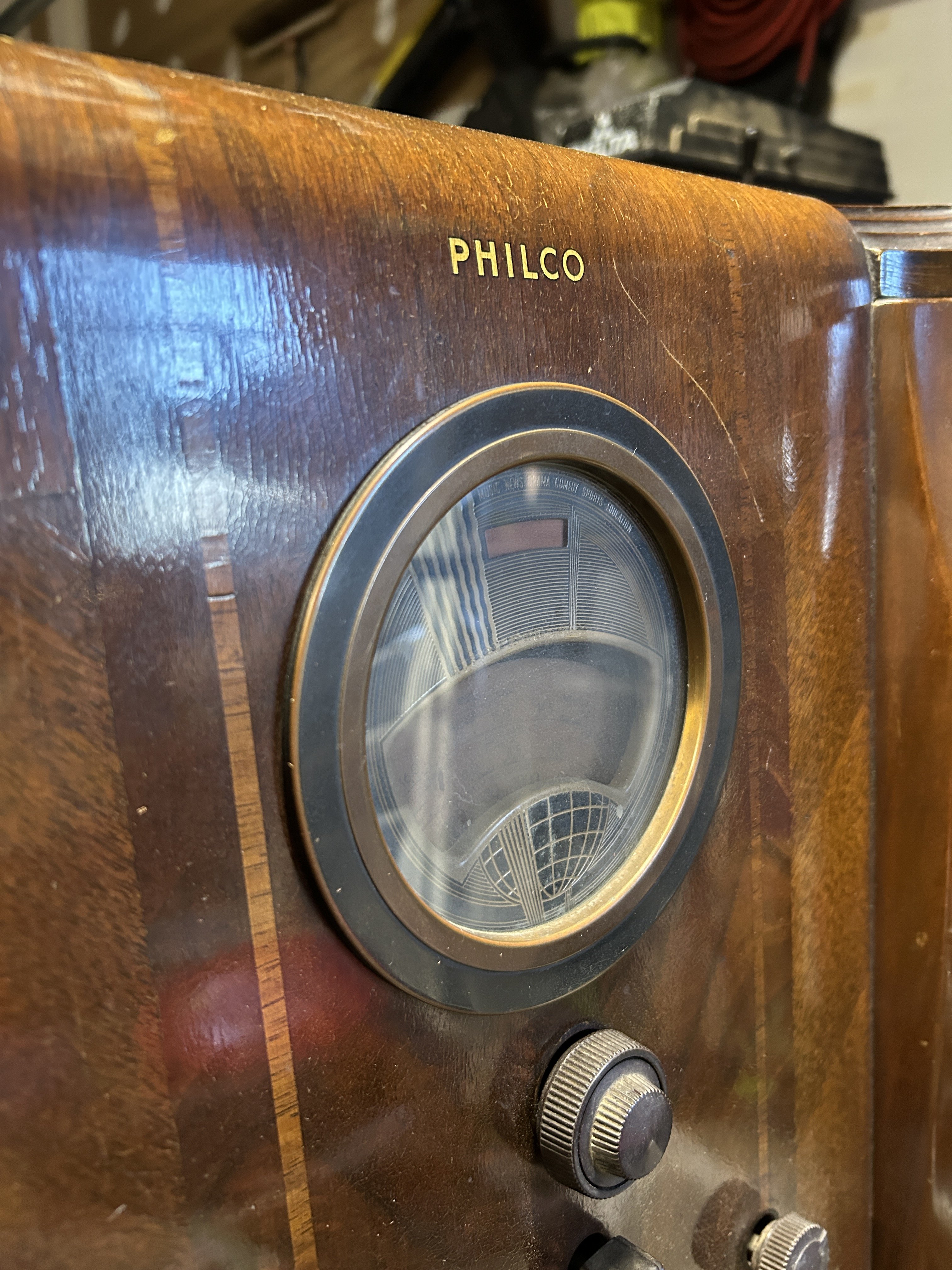

    I cleaned up the tuning window and bezel and remounted it. Slow progress I know.
