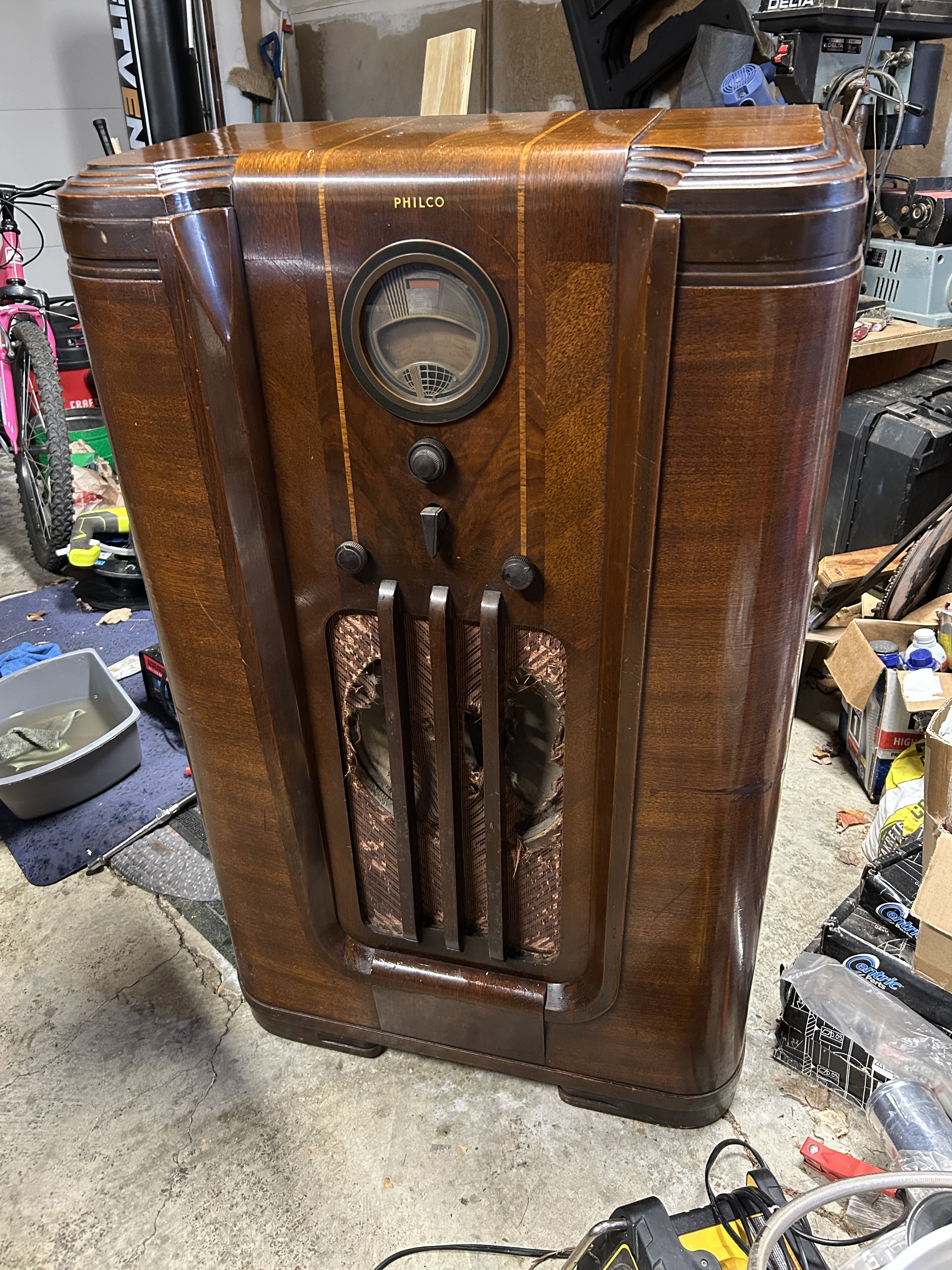

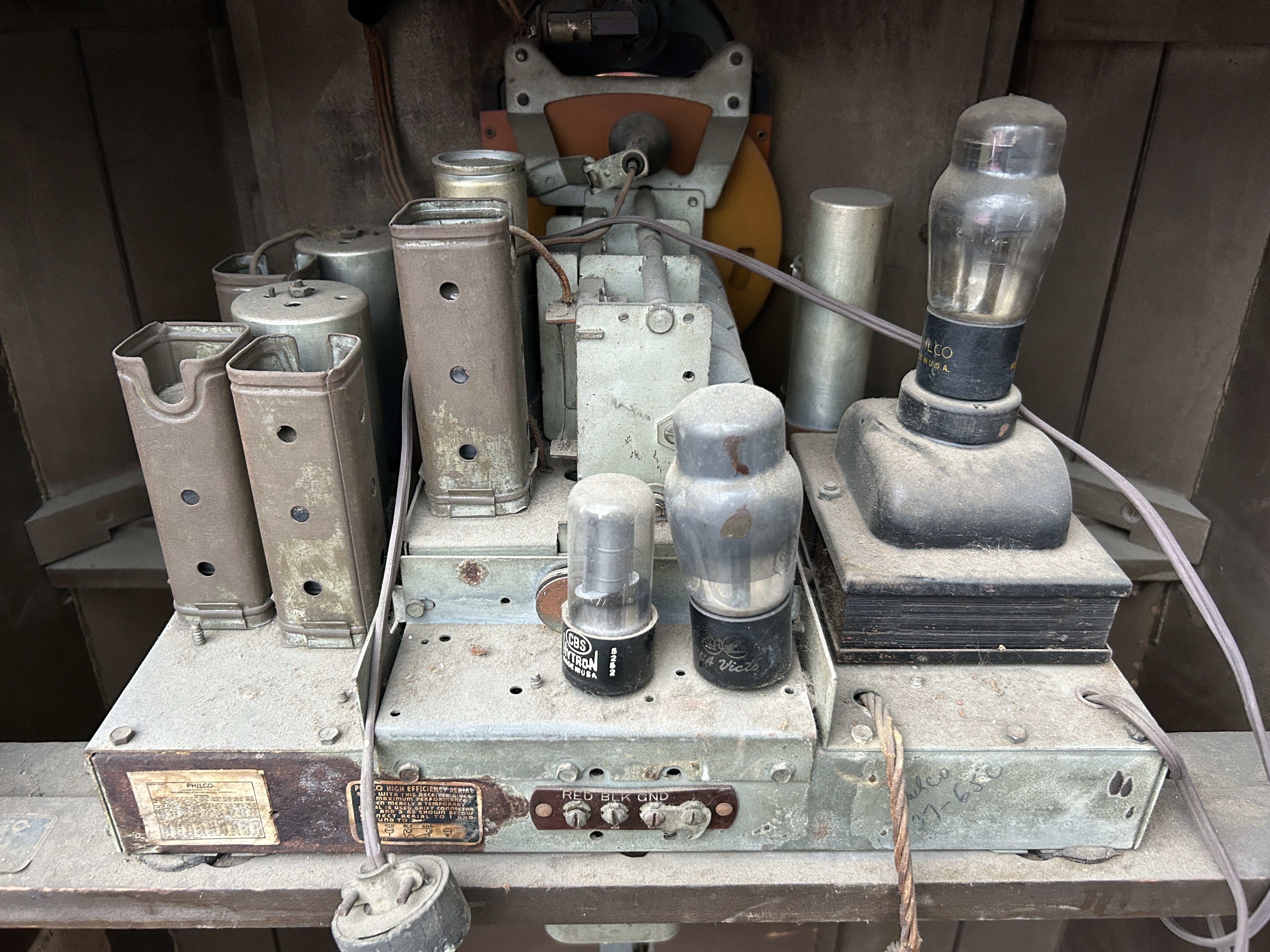

I have inherrited my grandparent's old Philco 37-650 from 1937. It has sat for many years unused. My aunt passed away in August, the house is being emptied to sell and I couldn't see this radio going to waste. It was dirty as he-double-toothpick and I was amazed how it cleaned up with vacuuming and some very dilute mild dishsoap. The cabinet need a little work and I'm hoping I can bend Jesse's ear for some advice.
I am not sure if it works yet and am refraining from trying to power it up without a dim-bulb tester. I have also read that the caps should be replaced before even trying.

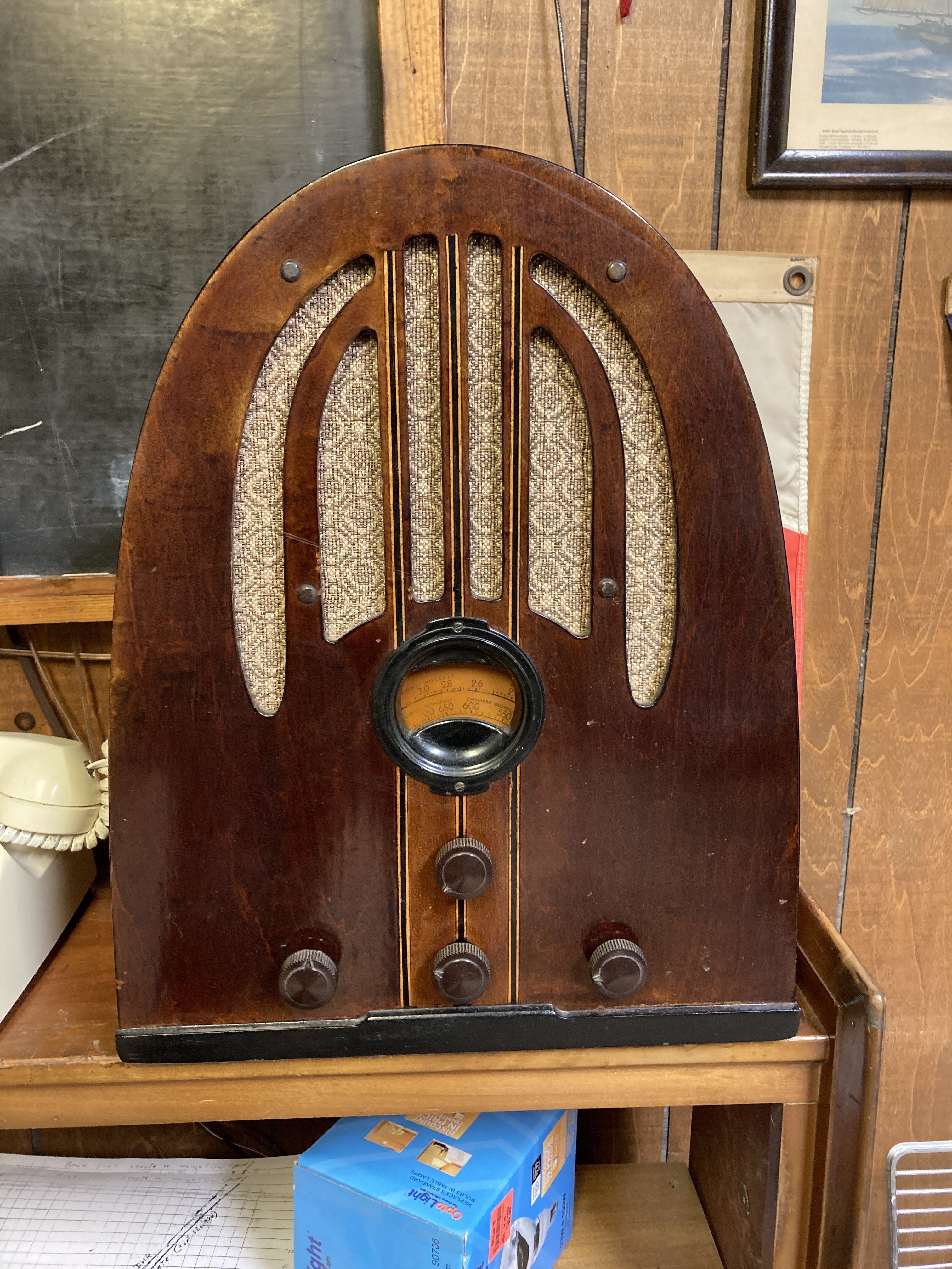

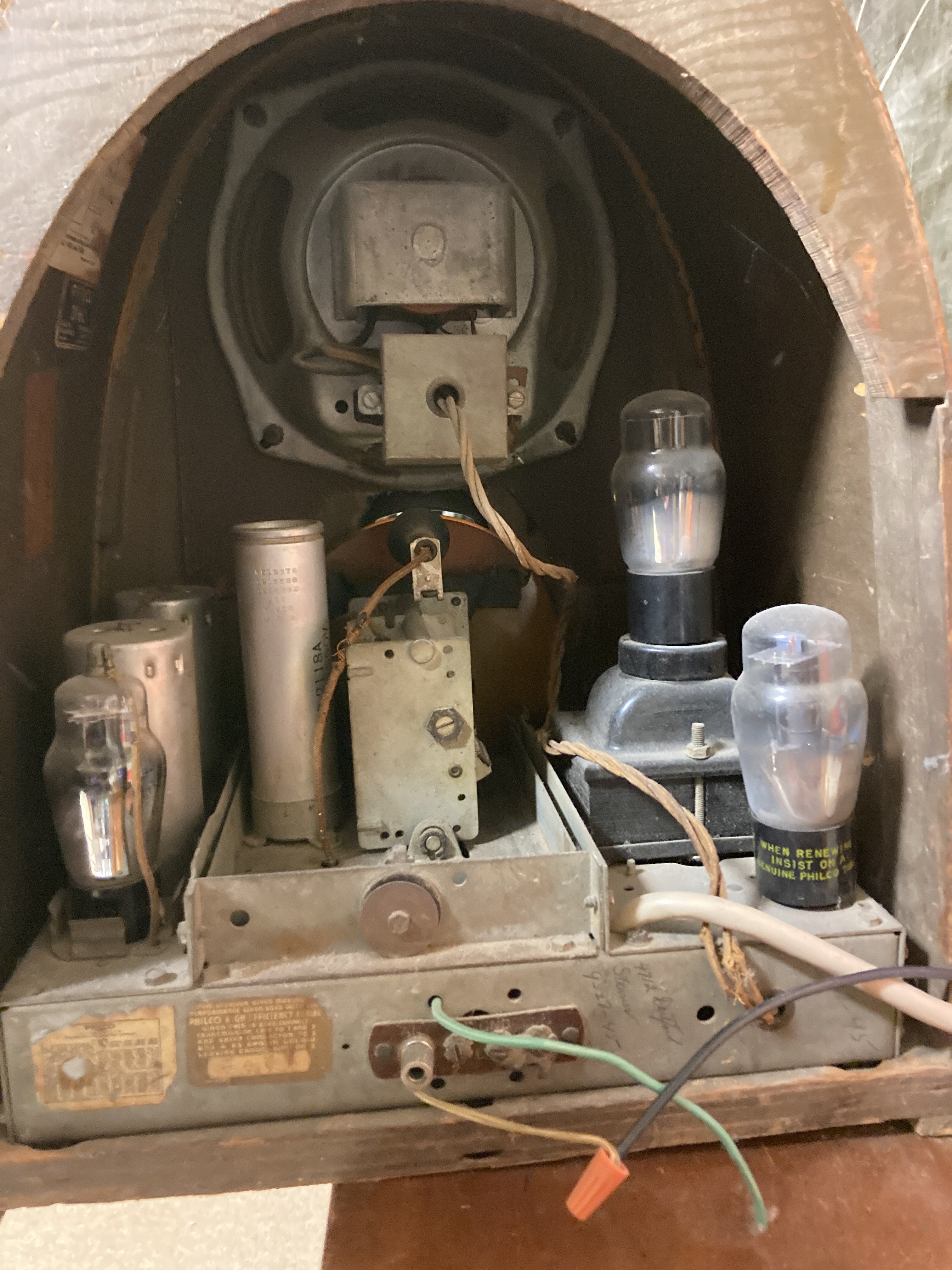

I am also inherriting my dad's old Philco 37-60, also from 1937. He has had this since he was a young man in Fells Point, dabbling in electronics. He restored it a number of years ago. Before he passed away in November (tough year), he told me that it still works.
Unfortunately, my dad gave away his Hickok tube tester and caddy of tubes :( .

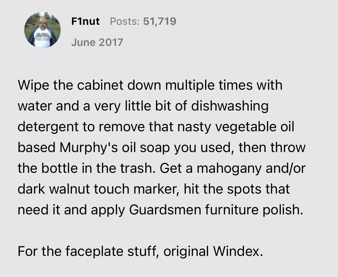

    I think Jesse made some recommendations in my thread about my tube stereo console as to how to clean those. I’d go check it out.
    From https://forum.polkaudio.com/discussion/177816/today-i-stole-me-a-piece-of-gear/p1

    Thank you. It sounds like I started ok. I rather like the idea of not refinishing the cabinet. There is a patina to what is there. I am wondering how to clean off the decades Pledge furnature polish that was likely used?

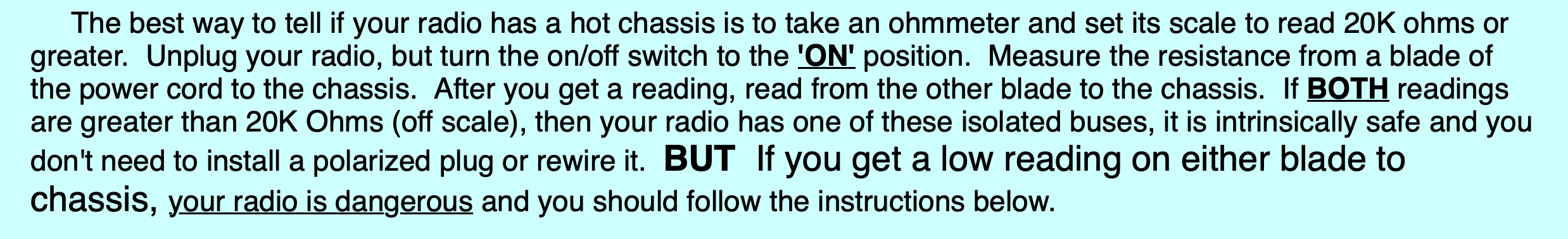

    It's very important to determine if the radio has a "hot" chassis:

    Wow, thanks for the info on hot chassis and on the cabinet touch-up. This is good stuff.

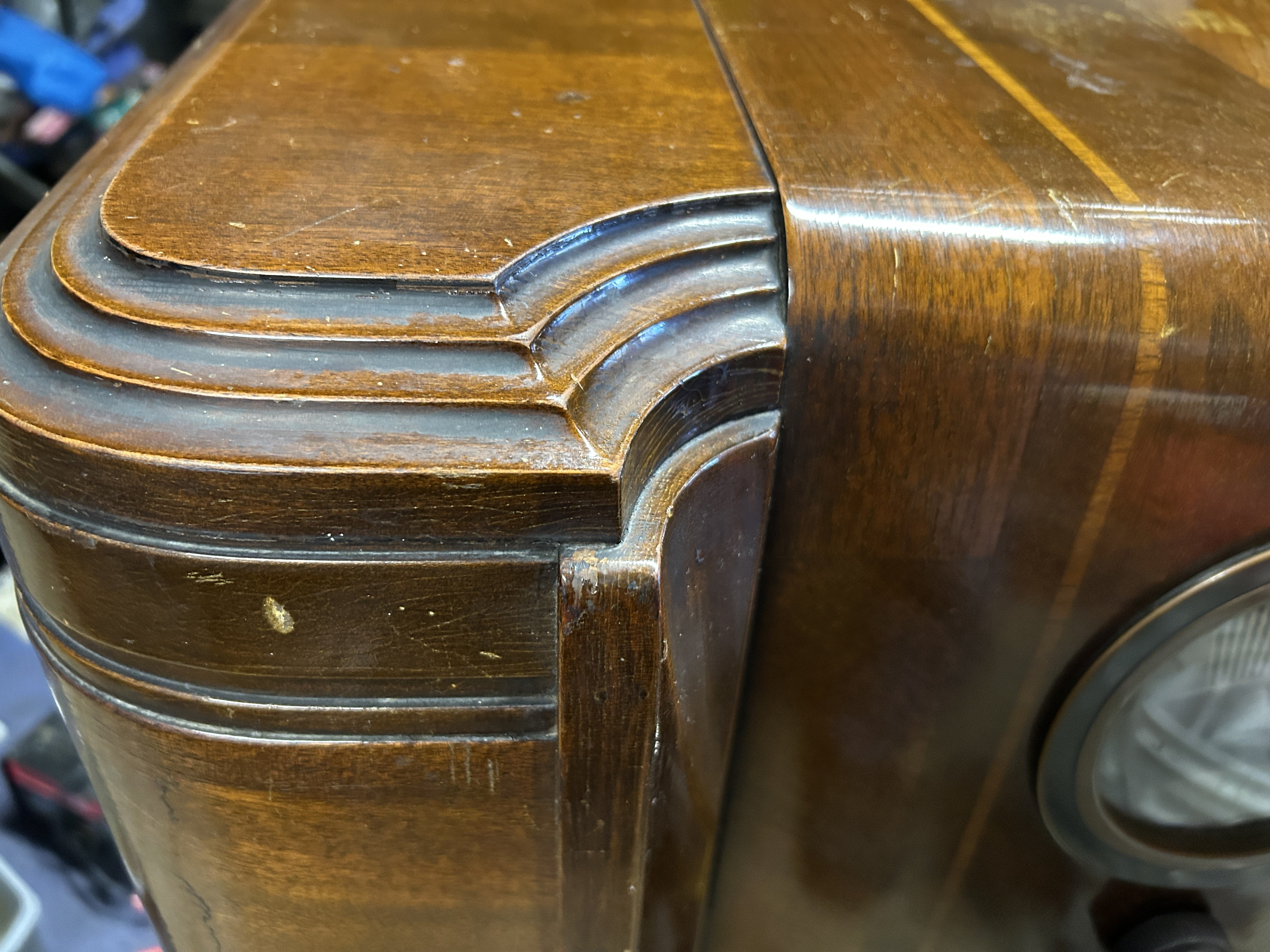

    Will the degreaser attack the finish? Also, any suggestions how to fix the top finish.

    F1nut Posts: 52,406
    It will not affect the finish.
    There is nothing you can do about the finish on the top. The finish has delaminated.
