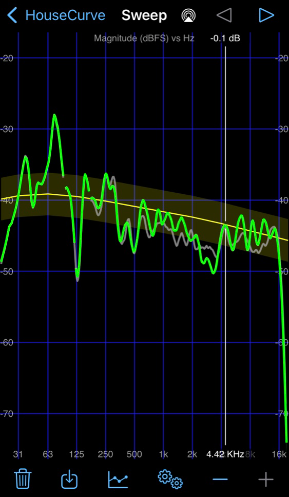

    This is the result of the frequency sweep:
    pitdogg2 Posts: 27,656
    Sounds like you have your work cut out for you. All those hard reflective surfaces will make it very lively.

    I'm guessing that with a fully concrete room, and the frequency response shown, you just have some very strong room effect that is boosting the bass. Corner traps could help, but you might consider if there is a way that you might be able to re-configure the system layout. If the room is a rectangle, there could be a different response if you had the speakers along the longer (or shorter) wall.

    This was why we used to use equalizer's, the answer is in the name.
