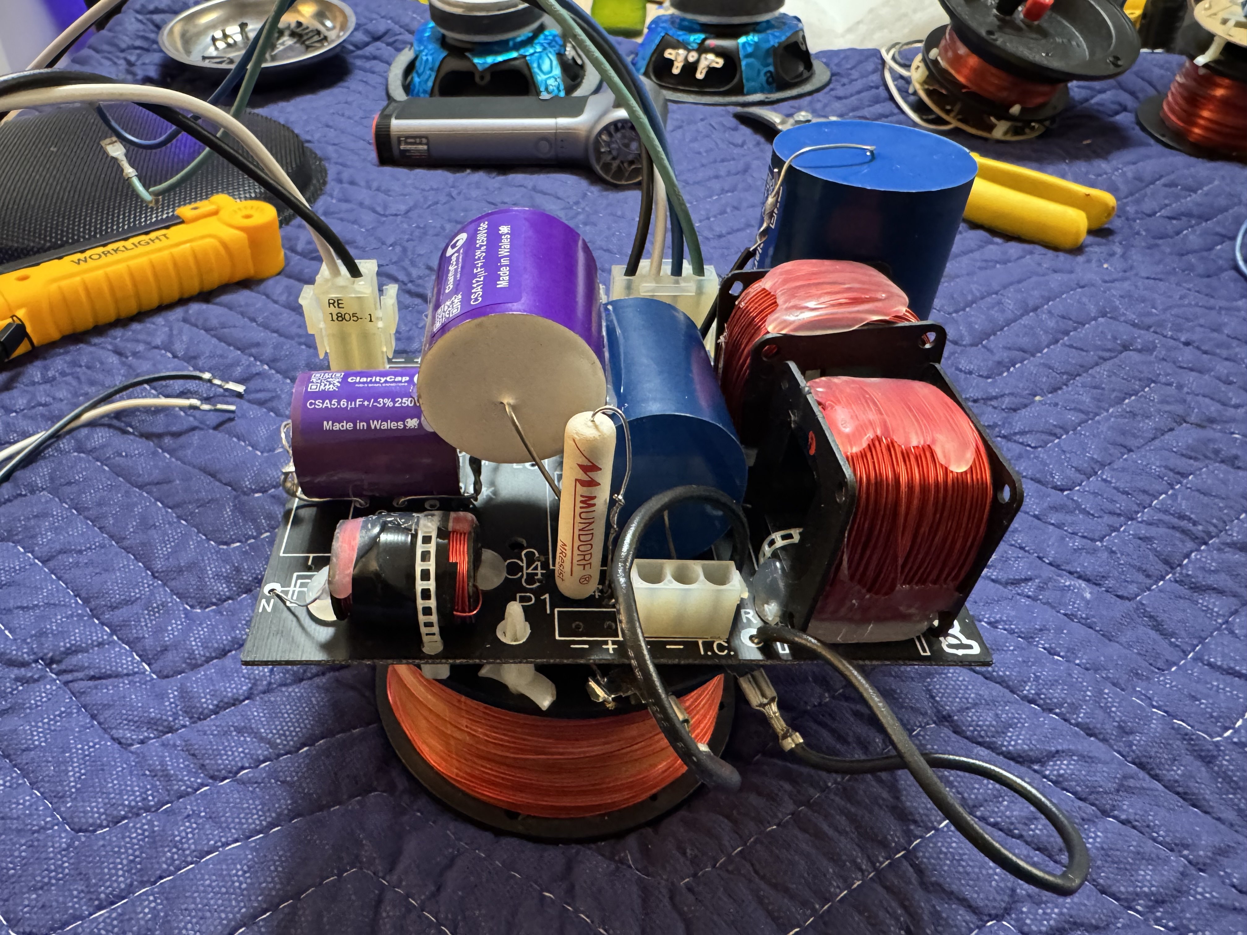

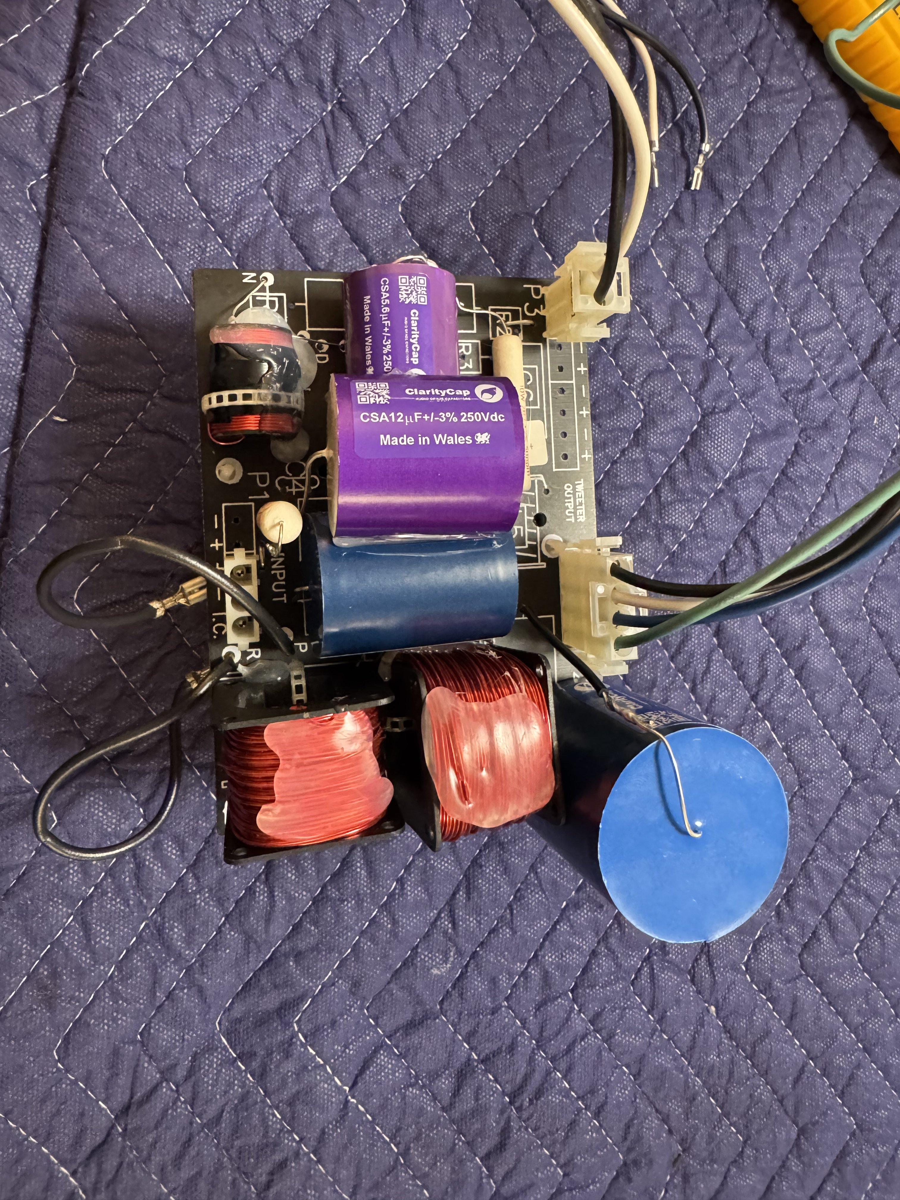

  • alright guys...I got everything I need...let me know if I have the right idea here before I start soldering stuff..
    https://dropbox.com/scl/fi/xswgjgefb3qiy380rzydu/SDA-CRS-Crossover-Rebuild.MOV?rlkey=1tfgke2mhke3jqx3gmgz5x37w&dl=0

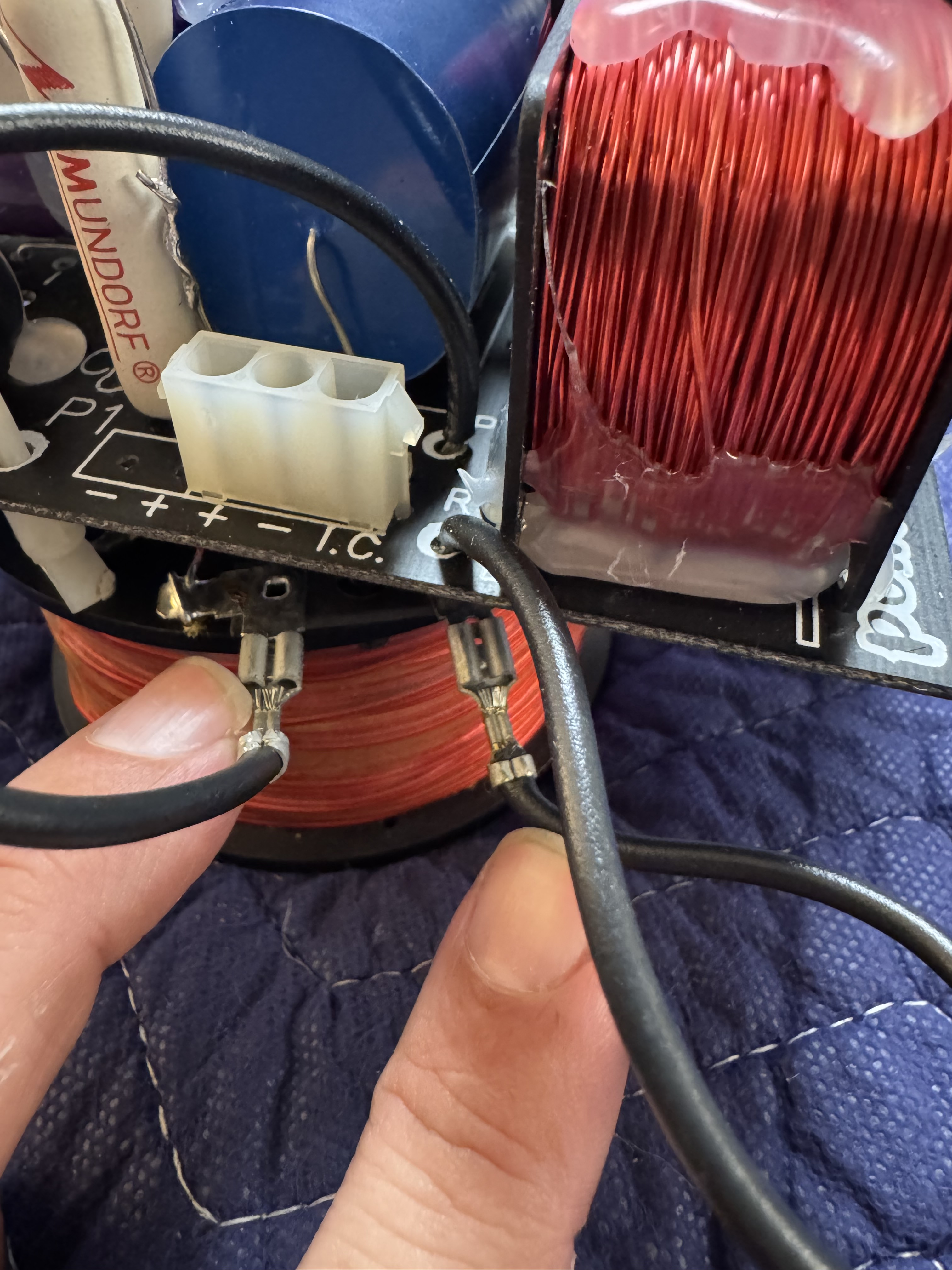

    Got the crossovers done. I’m putting one of the speakers together to test it out
    Does it matter which way these two wires go? There doesn’t seem to be any label or difference between the two terminals. I’d rather know for sure before I send any signal through this speaker.
    Toolfan66 Posts: 18,227
    It doesn’t matter..
  • All done. And they sound great. I only got 10 or so minutes to listen to them before I left for my gig today. I’m gonna let them burn in the next few days and hopefully sometime next week I’ll actually be able to sit down and really listen to them.
    Thanks again for the help.
