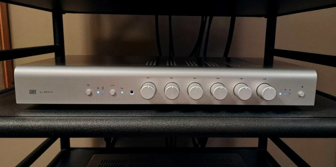

  • That's really what equalizers are meant to cure, problems with program material:
