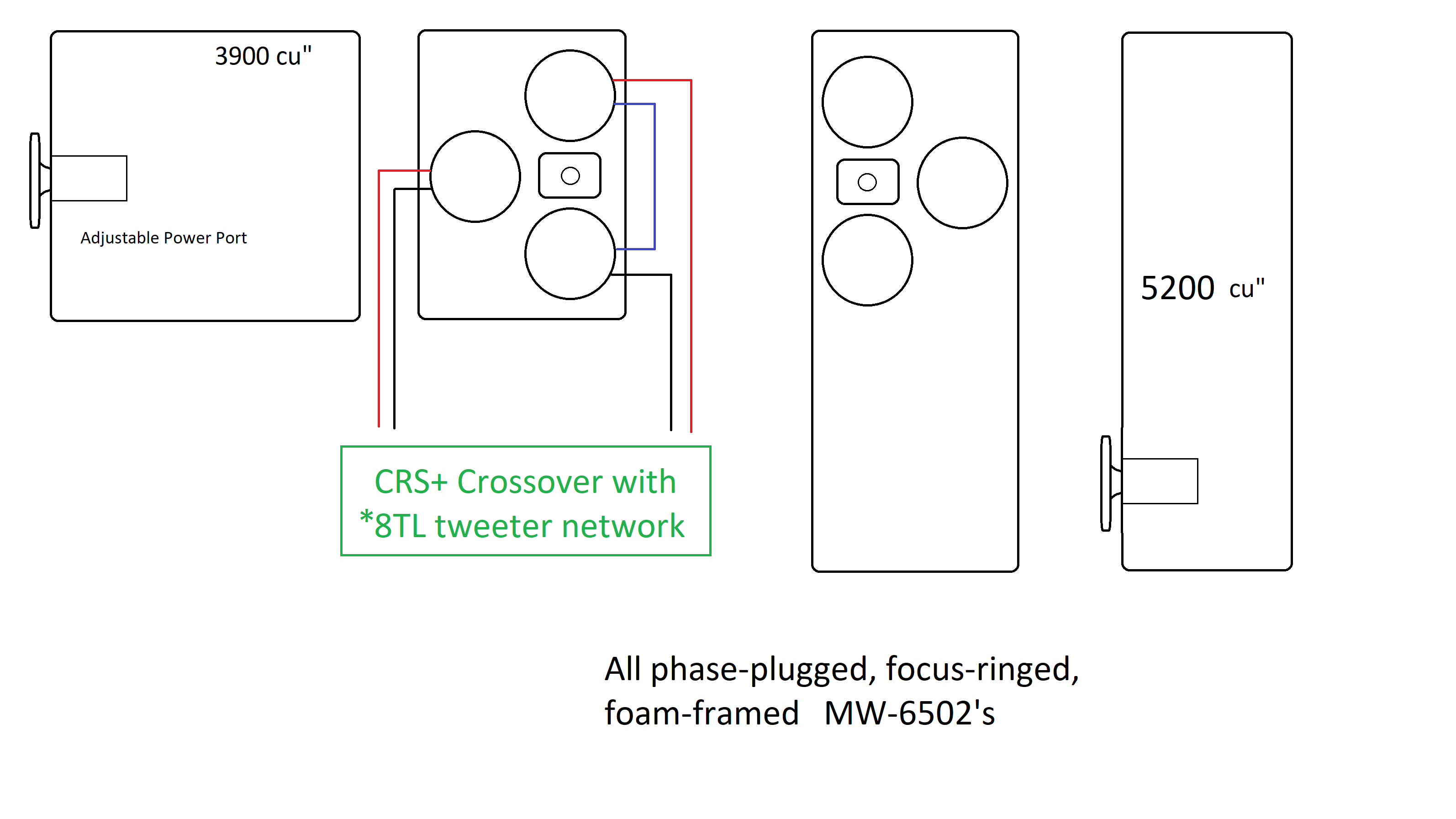

    Old School SDA...

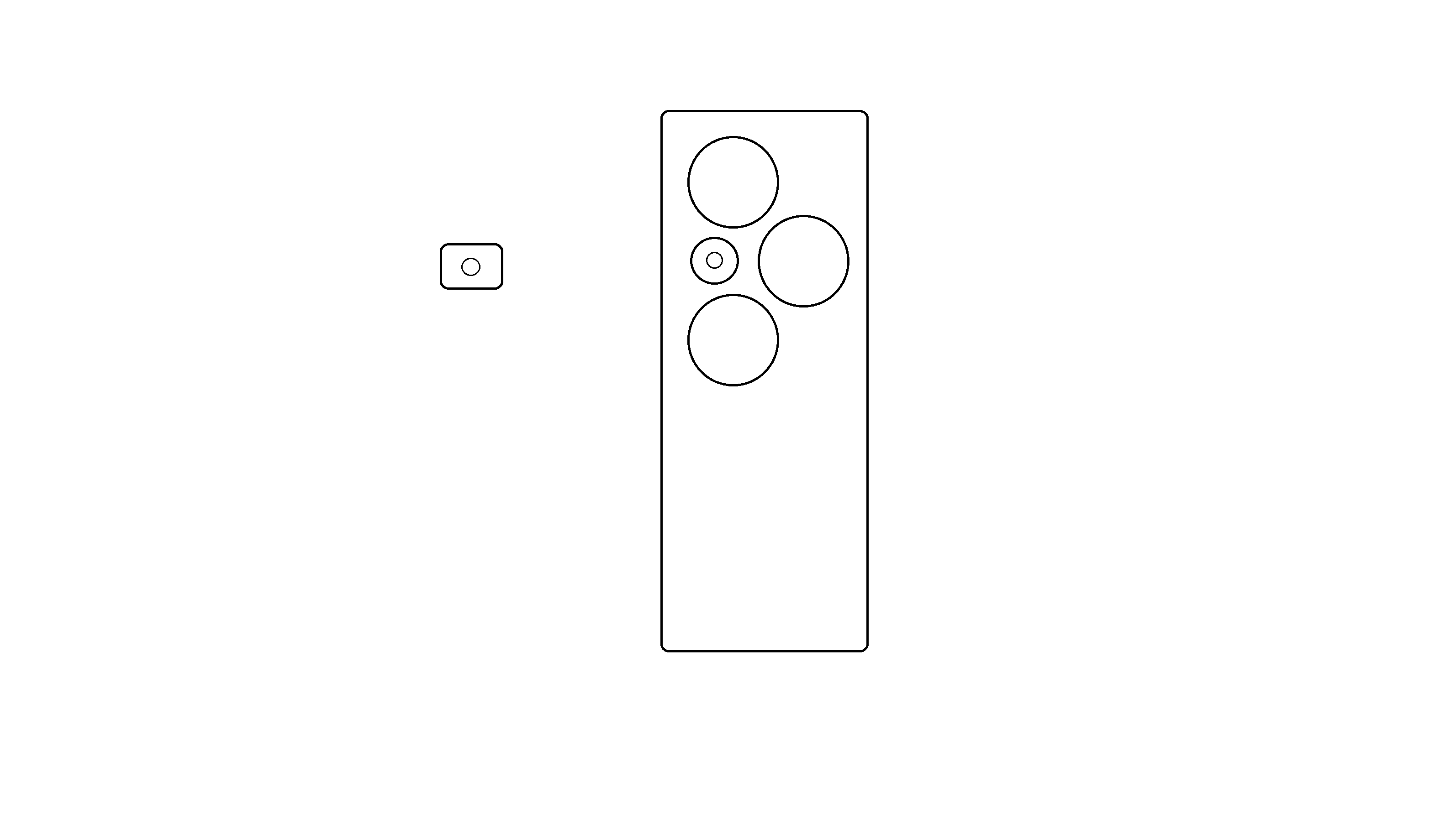

    New School....
    xschop Posts: 5,386
    If I make the RDO tweeter plate circular, I can squeeze the SDA driver closer to centerline. All the old POLK white papers say that the MWs were placed a "head's width" apart for the IACC to work. By default they could only get them 6.630" center to center. My ear canals are 5.7" C2C and I"m a big guy. Must have been some Neanderthals at Gallagher Mansion.
    XS-3B's?
    VR3 Posts: 29,541
    edited February 6
    Interesting experiment would be to create an angled baffle 15 degrees like the new sda and that would also help with diffraction issues with such a wide flat baffle
    Ie stereo drivers on a straight flat baffle then the sda driver on the 15 degrees portion

    VR3 wrote: »
    Would the CRS+ Crossovers work in a classic set of CRS+ if a new baffle was angled at 15 degrees either side?
    https://audioxpress.com/article/patent-review-head-related-transfer-function-equalization-and-transducer
    VR3 Posts: 29,541
    It would be something to mess with. The new ones integrated a tweeter to play up to 6khz I believe. The old ones around 2khz.
    The bass is 180hz and under which should radiate around the speaker regardless of the baffle.
    Relocating the driver at a 15 degree angle should translate to a wider more diffuse soundstage if I had to guess the outcome.
