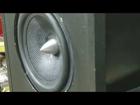

    Thought I'd post this here since it was a phase-plugged 6502 that developed a large crack in the surround and creased the paper cone. These were in may FIL's billet 5Jr's. Luckily he didn't blow the voice coil. I decided to experiment with a replacement carbon fiber cone since it already had the butyl surround glued to it.
    I simply chiseled off the old rubber surround and cut the old cone out leaving just enough of it attached to the coil and the electrical leads remained attached. Saves a TON of time and work. Then I cut out the carbon fiber cone center to 1.5" and glued it right to the base of the old cone. The glue I used is Superglue Fix-All and flowed all the interfaces nicely front and back of the CF cone.
    Will let set a few hours and glue surround to basket then test on the 5Bs...

    xschop Posts: 5,386
    edited April 2024
    Just meaured a CF surround and the fold-over is 0.50' wide on the CF, as compared to 0.40" wide on the factory. Th CF surround does feel a little more weighty however.
    No uG balance here, but interestingly the CF cone and heavier surround feel about same weight as old one I cut out, so the CF cone itself must be lighter?. The CF is MUCH stiffer than the factory paper cone and was very hard to cut with a new scalpel. It did not fray as that was my worry cutting it.
    Later, I plan on building a set of omnidirectional drivers using these CF cones, so was good practice working with them....
    xschop Posts: 5,386
    edited April 2024
    Bottom/center dry. Now have the surround glued and weighted down...

    xschop Posts: 5,386
    edited April 2024
    Cleaned up edges and used a 10mm leather punch for the bolt head clearances...
    Ill do a comparo after dinner...
    It is the phase-plug thread ya know...
    Post edited by xschop on
    xschop Posts: 5,386
    Loctite already set, so gave them the same wintergreen oil solution as I do the factory surrounds...
    Sad Old Red up first...
    xschop Posts: 5,386
    Mick, Sade, and Sting all passed the the test with flying colors.
    I wouldn't hesitate to do this repair again. The cone holds it shape at very high volume, zero distortion and hard to tell a difference between the plugged 6502 with damped paper cone.
    xschop Posts: 5,386
    Pet Shop Boys midrange was crystal clear with high volume accompanying bass...
    https://youtu.be/wz4pQGxK25Y?si=x2P2f6nYeGwTJ7UC
