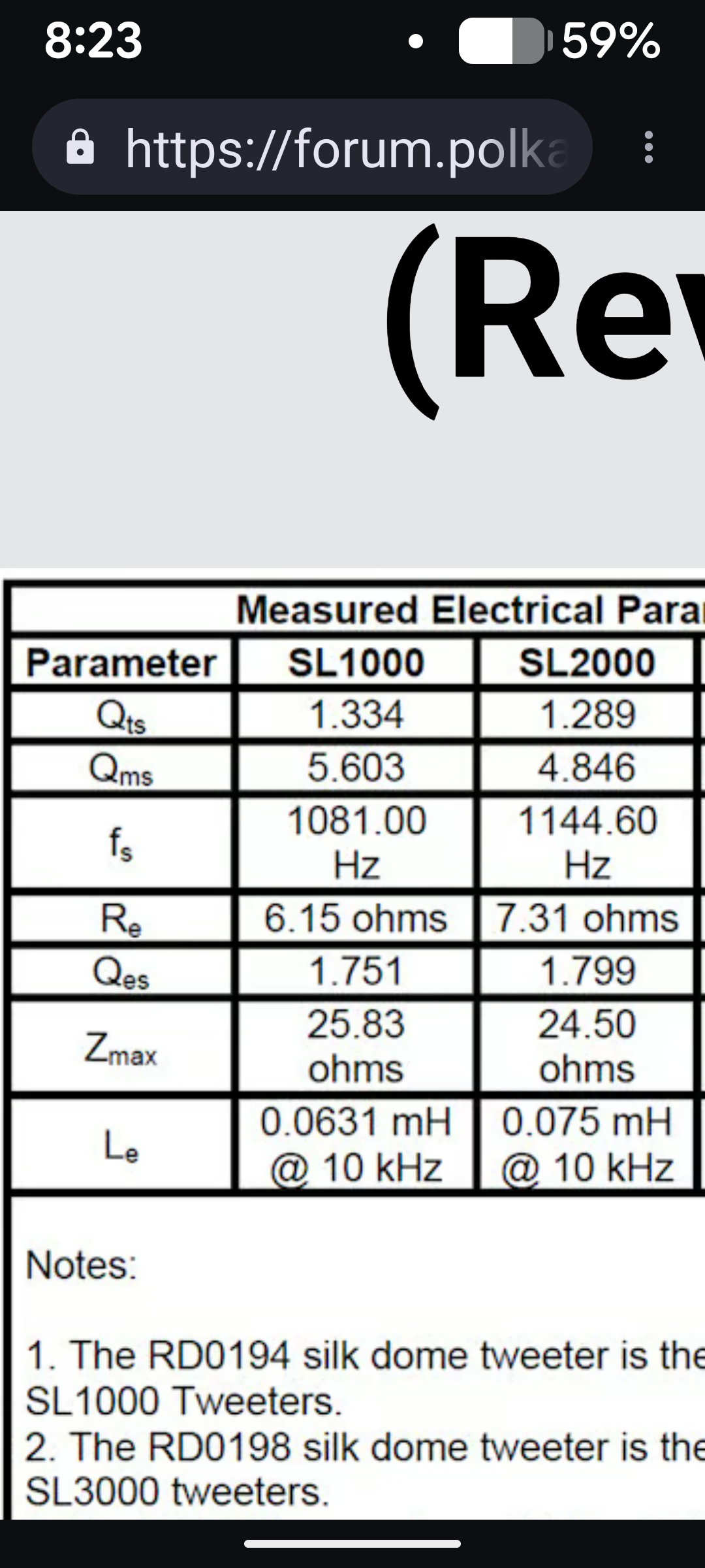

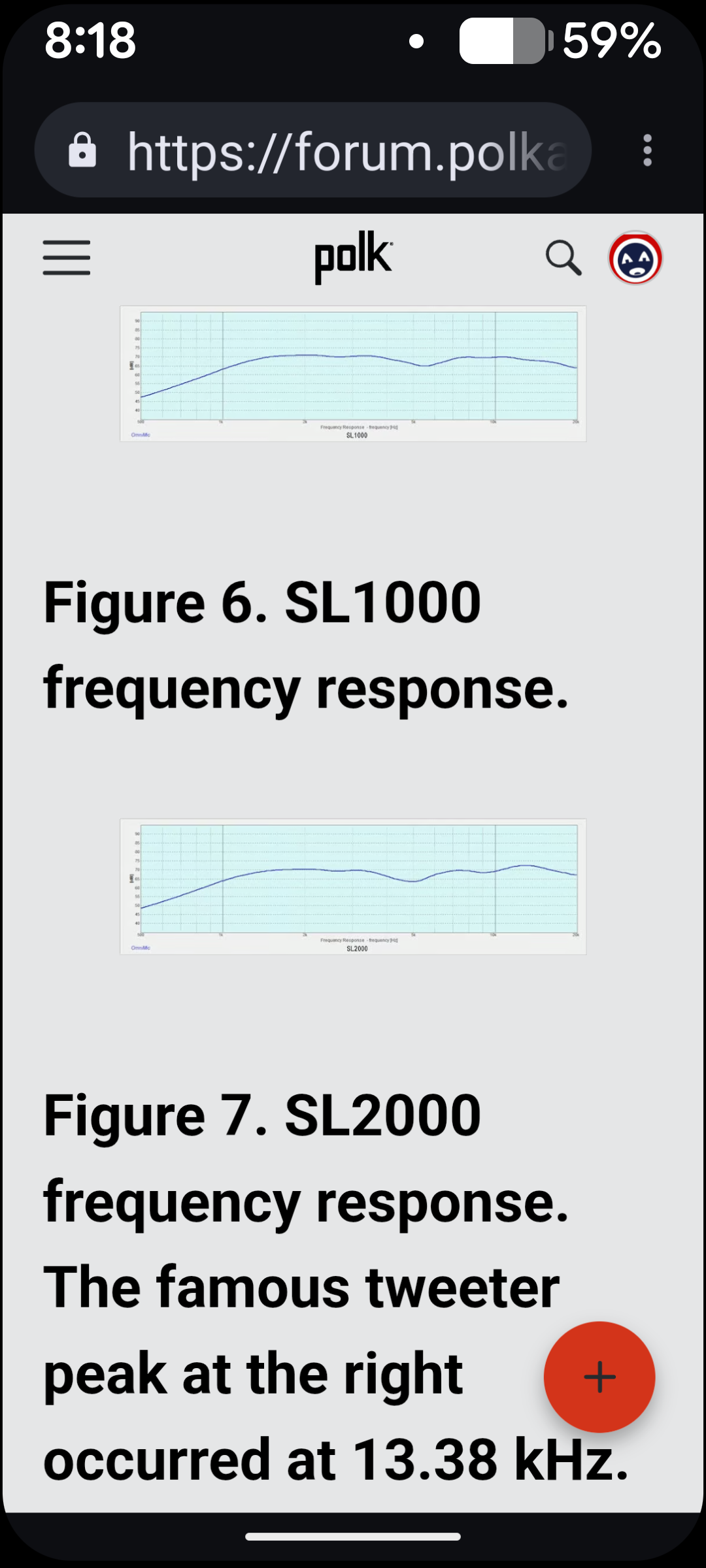

    I know it isn't your question but are you sure they are 7C and not late model 7B? I had *thought* that the 7C marked the change to the SL2000 tweeters. Late model 7B went from Peerless to SL1000 and they did have the grill not extending all the way to the bottom with the badge on the enclosure as you say. Did your speakers originally have the SL2000's?
    I've never understood how, apparently the SL1000 tweeter was Polk's attempt at making a better Peerless, and how when they made the switch in the 7B they saw no need to modify the crossover networks, yet people say that the RD0194 is a replacement for the SL1000 but not the Peerless. There is also the issue of how the SL1000 mounting holes and bezel size are the same as the Peerless but not the SL2000. There were some SL1000 that were purported to be NOS on eBay but I don't know if they are still there. Everybody seems to say they are harsh sounding. I haven't heard them; only Peerless.

    Having dissected both SL1000 and SL2000, I always assumed Polk added a few more turns on the 2K coil to tame the peak due to changing to the plastic bezel.
