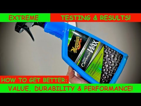

    It states first time use spray on then wipe off. Then after that spray on rinse offhsd75kshnb5a.jpg

    Ivan,
    I've been following this product since it came out and there are many videos on YouTube about the application and durability of the product. It's a ridiculously good value for only $14! From what I've seen, the best way to use it is to go "off label" and apply it to dry paint for the first/base coat. That said, applying it to wet paint works (less effective) fine as long as you massage it into the finish with a microfiber towel and then wipe off the haze with a separate microfiber towel. If you prep your paint first, wash with strong detergent soap, iron remover, clay bar, alcohol prep, compound, polish, then apply the final "top coat," i.e., ceramic or wax or, in this case, hybrid ceramic wax, you'll get the best results possible (longest lasting, most durable, best looking). It may seem like a lot of work but you'll only need to do it once a year as long as you maintain the finish at decent intervals. Bug guts, tree sap, bird droppings, etc, should wipe right off; easy peasy.

    Tuber called Car Craft Auto Detailing from Australia gives the best review of this stuff. Vid. won't load for some reason. He's by far a master and my favorite.

    Here you go!
    https://youtu.be/s1rMMrOqGTg
