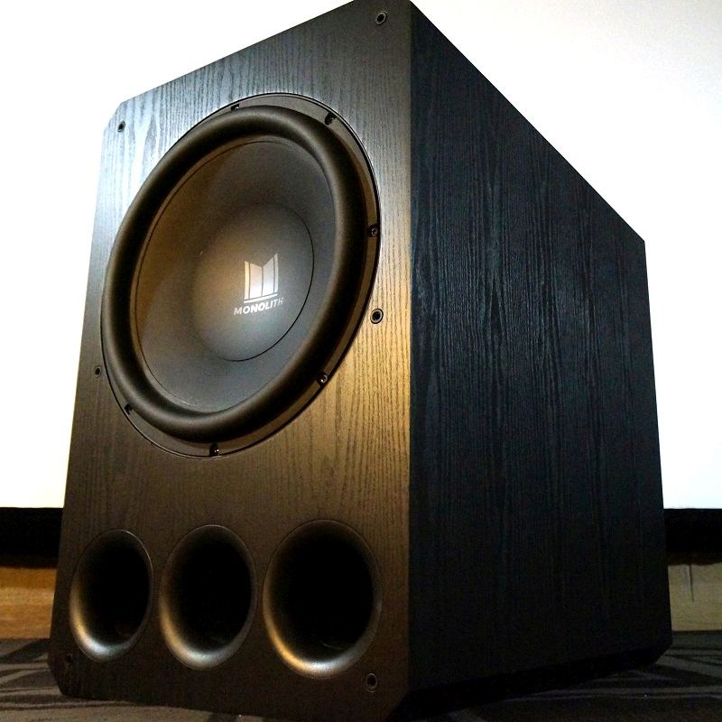

    I've always been a fan of large sealed sub and infinite baffle subs going way back to my car audio days. A sealed 15" is what I mostly like for the home. I've however listened to well integrated ported subs in the car, home, and beyond. I bring up car audio because many associate that with the 'BOOM' however, I've always been about accuracy. The car is where I learned to tune a ported sub to sound good. Even in a small hatchback optimized Sub Placement, Level , Phase, Polarity, Crossover will make a huge difference in the sound. I used to strive for up-front imaging and disappearing rear sub playing solo upright double bass tracks; I've used mostly sealed but I've done it with ported as well. Its hard to do because of the resonant nature in a car. Its takes proper integration of the sub to midbass to get it right.
    Acoustic and electric tracks I've used to tune bass by ear in the home and car.
    Bass Resonance Test (track 44)- [Album] Best of Chesky Jazz & More Audiophile Tests, Vol. 2
    Night Train / Christian McBride - [Album] Gettin' To It
    Flight of the Cosmic Hippo / Béla Fleck and the Flecktones / [Album] Flight of the Cosmic Hippo
    Etude / Lee Ritenour - [Album] Color Rit
    Bali Run / Fourplay - [Album] Fourplay
    Fast forward to the more advanced drivers, amps, DSP, and optimized enclosures subs today are much better. Ported or sealed can sound good...not to mention many ported subs have the port tune feature. The ports can be plugged to tune to a different frequency or sealed all together. So, yes you can have it all! One can tune the sub in their own space and decide on the sealed vs. ported debate. Maybe even sealed for some songs and ported for others?
    Even this big dark ported THX monster can sound good for music.
    Every part of this driver has been developed from the ground up and customized to deliver high output, low distortion, and accurate bass. Our unique hybrid cone combines long fiber pulp and fiberglass, taking advantage of the pulp's superior stiffness with the additional rigidity and lightweight properties of fiberglass, to deliver a driver of massive durability and excursion. The result is a cone that achieves optimal motion at all frequencies it is asked to produce and beyond.
    1. Lower Suspension
    FEA (Finite Element Analysis) modeling and Klippel laser based optimizations were used to design a cone that is capable of astounding >90mm peak-to-peak excursions. The lower and upper suspensions are designed together with the motor structure. The lower suspension is critical for maintaining very low levels of distortion at high excursions, which are required for high SPL at low frequencies.
    2. Spider and Cone Venting
    The spider is made from multiple layers of NOMEX with integrated tinsel leads hand stitched in place for low mass yet high strength and durability. The purpose of these vents are twofold -- first, they allow convective air flow to cool the voice coil and, second, they reduce asymmetrical compliance due to air compression under the cone/spider, which would appear as unwanted distortions.
    3. Woofer Surround
    FEA (Finite Element Analysis) modeling and Klippel laser based optimization were utilized to create this durable, high profile surround that’s made from a unique formulation of NBR (NITRILE RUBBER-acrylonitrile-butadiene copolymer). This formulation was developed after months of modeling and prototyping to ensure the highest levels of excursion, without sacrificing linearity or distortion.
    4. Motor Structure
    The motor is made of CNC milled low carbon steel in the modified undercut "T" pole assembly to focus the magnetic flux. Dual aluminum shorting rings are used to cancel eddy currents, further stabilizing the magnetic flux and significantly lowering distortion. The precision wound, high temperature, all aluminum bobbin (which has a lower thermal compression than copper) enable the voice coil to remain cool. The motor and suspension design is extremely critical for maintaining control of the driver's displacement over a very wide range of input signals, allowing the subwoofer to reach maximum performance and output levels while keeping distortion to a minimum.
    The Monolith subwoofer amplifier has an extraordinarily high power output of 1000 watts RMS (nearly 2000 watts peak), which can deliver massive amounts of power when needed. Each Class D amplifier is built around a Texas Instruments 48-bit data path (with 28-bit filter coefficients) DSP engine, allowing virtually unlimited design flexibility with the assurance of no signal degradation. Each amplifier's transfer function, power output limiting, and thermal protection are monitored to the millisecond and are customized for each individual woofer and cabinet air volume combination. This state-of-the-art Class D amplifier technology ensures maximum headroom capability, excellent transient response, high output, and very low distortion when driving the Monolith 15-inch THX Select certified subwoofer.
    Cabinet and Internal Bracing
    HDF (High Density Fiberboard), not MDF, was utilized resulting in a sonically inert cabinet. Internal bracing has been strategically placed to increase overall cabinet strength and limit unwanted panel vibrations that would cause discoloration and distortion. The strong cabinet and bracing combine to ensure you hear massive amounts of bass, not cabinet resonances.
    Ports and Grille
    The 15" model uses three 88.5mm port with inner and outer flares. Multiple ports are used to ensure high SPL capability at low frequency (fb=21Hz). The dual flares help reduce turbulence and asymmetrical distortions. Additional adjustments can be made by sealing the port with the supplied plug. The "floating" grille is made from non resonant MDF to provide rigidity, while the entire structure is offset from the cabinet to maximize air flow of the woofer and ports.
    The above is an example of a sub without the pretty looks, bells and whistles that was designed through FEA optimization to perform at a high level. Accurate linear performance throughout the sub bass spectrum. The reviews and measurements support the performance claims. Clean bass is clean bass rather it be for music or movies!
    The SVS Ultra SB16/PB16 is the pretty, feature rich, high performing sub that all would love to have. However, for $2000-$2500 I would take two of the Monolith 15's or 12's open box for $1099.99/$679.99 each. Then, get a miniDSP, AntiMode 8033, etc. for the clean articulate dual sub win. These subs have to port control option: One port, two port, or sealed!
    Or, two SB-3000's
    Or two Rythmik F12 or F15
    Or two HSU ULS-15
    Any of the above should be a worthy complement to the punchy SRS.
