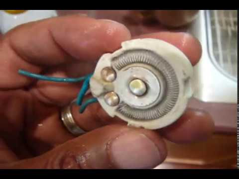

    The worst failure mode of the classic AR loudspeakers are the rheostats (not L-pads) used in the crossover circuit. They get really, really corroded and may be noisy or even essentially nonfunctional. They can be rehabbed (with a fair amount of effort) or replaced.

    I restored a pair Victor bought for his father. One rheostat was beyond repair, had to get a replacement off ebay.
    I can't find the pics, but here is a youtube video.
    https://youtu.be/mbrykpVC4-0

    SCompRacer wrote: »
    Dad still has them. He had to replace the woofers in the smaller speakers but the bigger 3-way (AR-2ax?) are still doing fine with their cloth surrounds.
