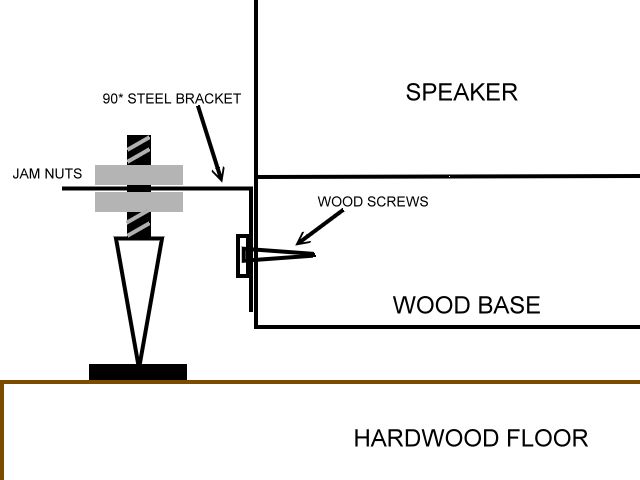

  • westmassguy
    westmassguy Posts: 6,850
    edited December 2013
    Ronnie, this is my Idea for your spike/height problem
    Home Theater/2 Channel:
    dhsspeakerservice.com/
  • TennMan
    TennMan Posts: 1,266
    David, thanks for the posting drawing. It is an excellent idea. However, As you can see in the photo below, I'm very limited in space between the bottom of the cabinet door and the top of the speaker. Just raising the speaker up enough to put the thickness of a nickel under the spike would cause the top of the speaker to hit the door.
    One option that might work is to mount a bracket outboard of the speaker as shown in the bottom photo. With that type of bracket it would be possible to adjust the spike up high enough that the spike would not touch the hardwood but when a thick disk is inserted under the spike the speaker would be raised slightly off the floor and the weight would be placed on the disk. The drawback to that is I don't think it would look good and I don't want to drill holes in the wood base of cabinets. I've not given up on this and I'm not in a hurry to get it done. Thanks again for your input. I appreciate it.
    Toolfan66 Posts: 16,983
    TennMan wrote: »
    Love the idea, except I would look into lag bolts not wood screws, I don't think the weight of the speakers will hold up to wood screws..
  • TennMan
    Toolfan66 wrote: »
    Yeah, the brackets would need to be mounted securely to support the speakers. I think 80 pounds is the weight of the 2Bs.
    Why not look at the bracket going underneath the speaker form one side to the other, and screw it in underneath the speaker?
    That way you only need two brackets per speaker, and you wouldn't have to put holes in the side of the end cap, and it would hold the weight of the speaker..
  • TennMan
    Toolfan66 wrote: »
    That's a great idea and I did consider it in the beginning. However, I decide if the bracket was thick enough to be rigid and not flex on the ends where the spikes would be located, they would be so thick that the speaker would be high enough to hit the bottom of the doors. The speakers have to stay down as low as they are now. Two quarters stacked will not go under them at the height they are now.
    Ronnie, your 2Bs are sitting on glides now aren't they? These would take the place of those.

    Toolfan66 wrote: »
    What wood screws? They're 1/4-20 hex head machine bolts, sharpened to a point, then hardened. Four of them will easily hold up a 2B. They're threaded down through the Hurricane nuts from inside, adjusted as needed, then locked with the clinch nut.
